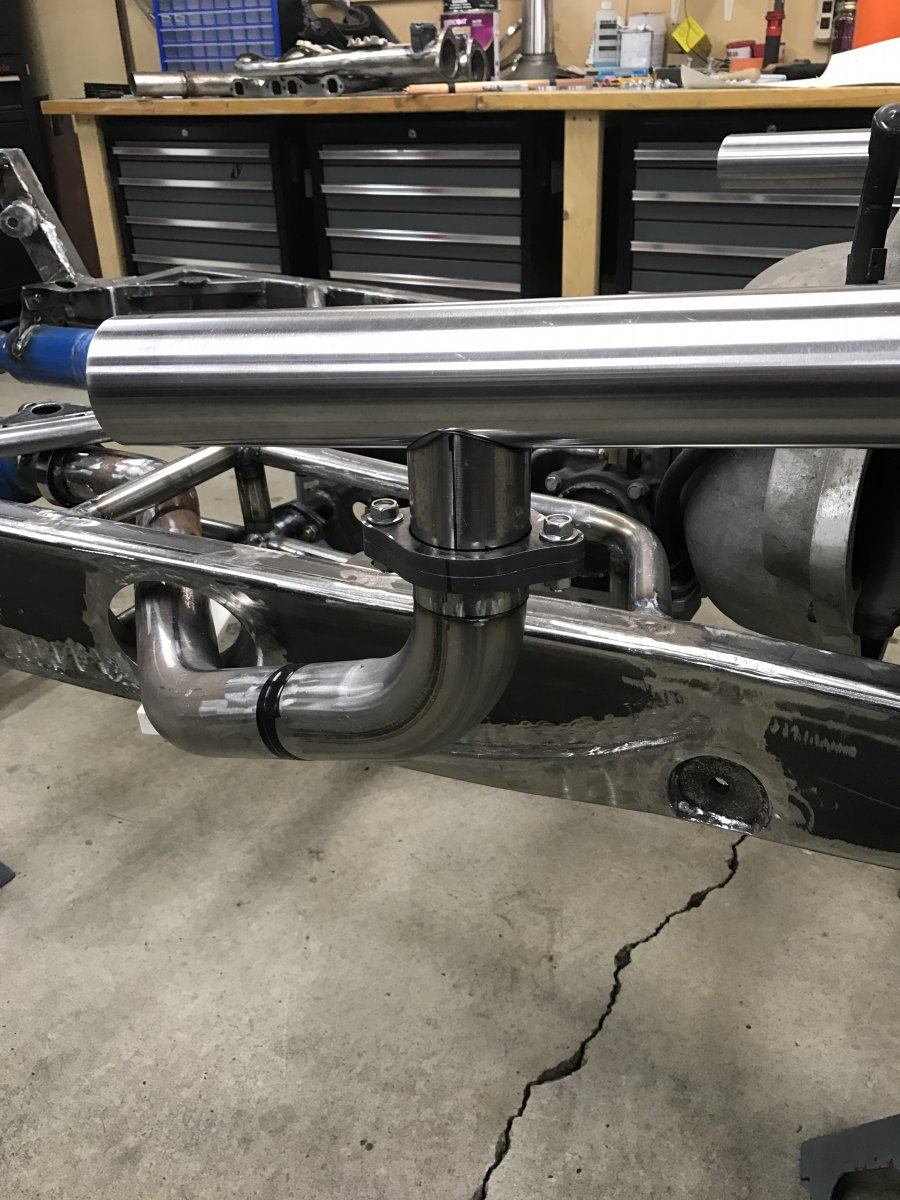

    I'm in the process of connecting my headers to the undercar exhaust, mine won't be as hidden as yours because I just don't have the room under the car up near the firewall like that.
    I have to drop off the collectors to a small flange and I have run my exhaust through the frame to the porter mufflers and out to the rear.
    I'm also going to have a couple of caps made for my headers like you have done, thanks for the idea.
    I'll look again to see if you posted a picture but I'm wondering what you have inside the collector to anchor the caps.
    Enjoy, that is one cool hot rod. :cool:

  8. Thank you!! Sounds awesome! Will where they connect be outside of the frame then? I don't think I've posted a picture of how they anchor down. But we welded a piece of I think 14g, half inch wide if I remember correctly and drilled a hole in the middle with a nut welded to the back for the header cap bolt to thread into. Awesome, those should help give you some rake! [emoji106]

    Yes they will. I really like the look of those tires.
    Here's a shot of the p***enger side exhaust, they go through an angled hole in the frame to the porter mufflers then out to the back over the quickchange.
    The whole exhaust system will be ceramic coated.
