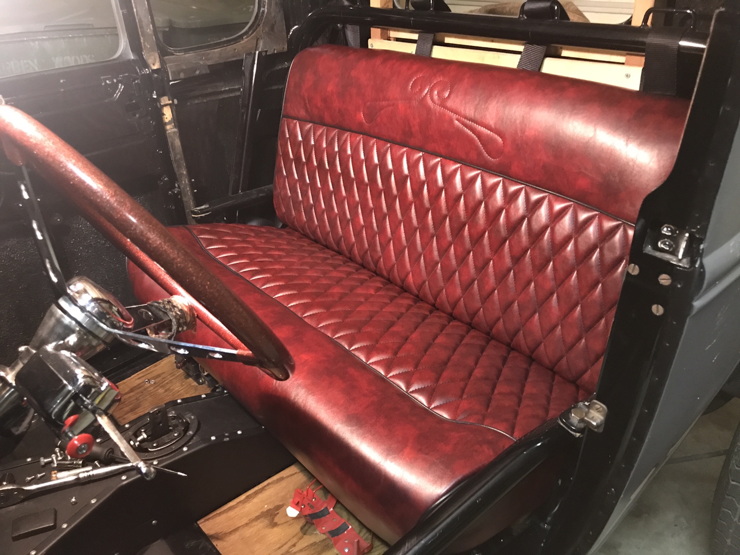

  18. As some of you may know I've been learning the upholstery trade for the past 2 and a half years. I've grown to really like it and am planning on doing this for the rest of my life. I've been employed full time at the shop I work at for 2 years now.
    Well I figured it was time to give this old dodge caravan seat some love and get rid of that 80's seat cover haha!
    I've always been a huge fan of oxblood vinyl and diamonds. I figured those would go perfect in my coupe.
    This is my very first seat cover I've designed, s***ched up, and installed completely by myself. My mentor just coached me through it. I'm very very proud of this seat.
    BEFORE
    AFTER
    Wanted to add my own touch to it so I came up with my own signature s***ch.... not easy to do hahah

    Well, damnit, you should be very proud of that upholstery job!
    All the way from the vinyl to the detail...
    That’s how it was done and has the perfect
    “Old Timey” look to it.
    But, should have expected that as the whole car is excellent.
  20. Thank you very much!! That's exactly what I wanted to is to have that old timey look. Thanks again!!

    Yeah ive been back and forth between the headers and the new seat t******* as far as my favorite part of this car. Love em!

    Hands down one of my favorite builds here! That Y-block sounds killer and the uphostery looks *****in' The only thing I would change is the name on the ***le ;)

    Hey Nathan... haven't been around much for a while until recently, and admittedly kind of lost track of your project. Pretty excited to see you putting the final touches on your hot rod coupe... including this latest Y block.
    I told your dad a couple years ago or so that knowing his and your p***ion, abilities and work ethic, I won't be at all surprised if you become one of those guys who hot-rodders seek out to do their upholstery. That seat seems to bolster my prediction.
    I very much wish for continued success for you.
