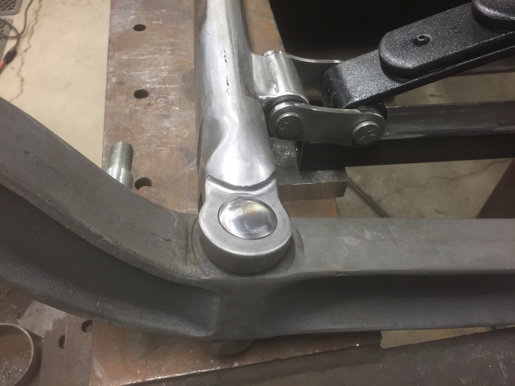

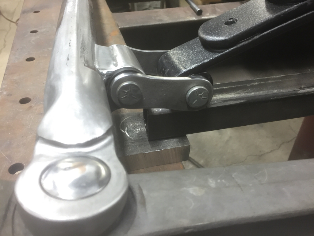

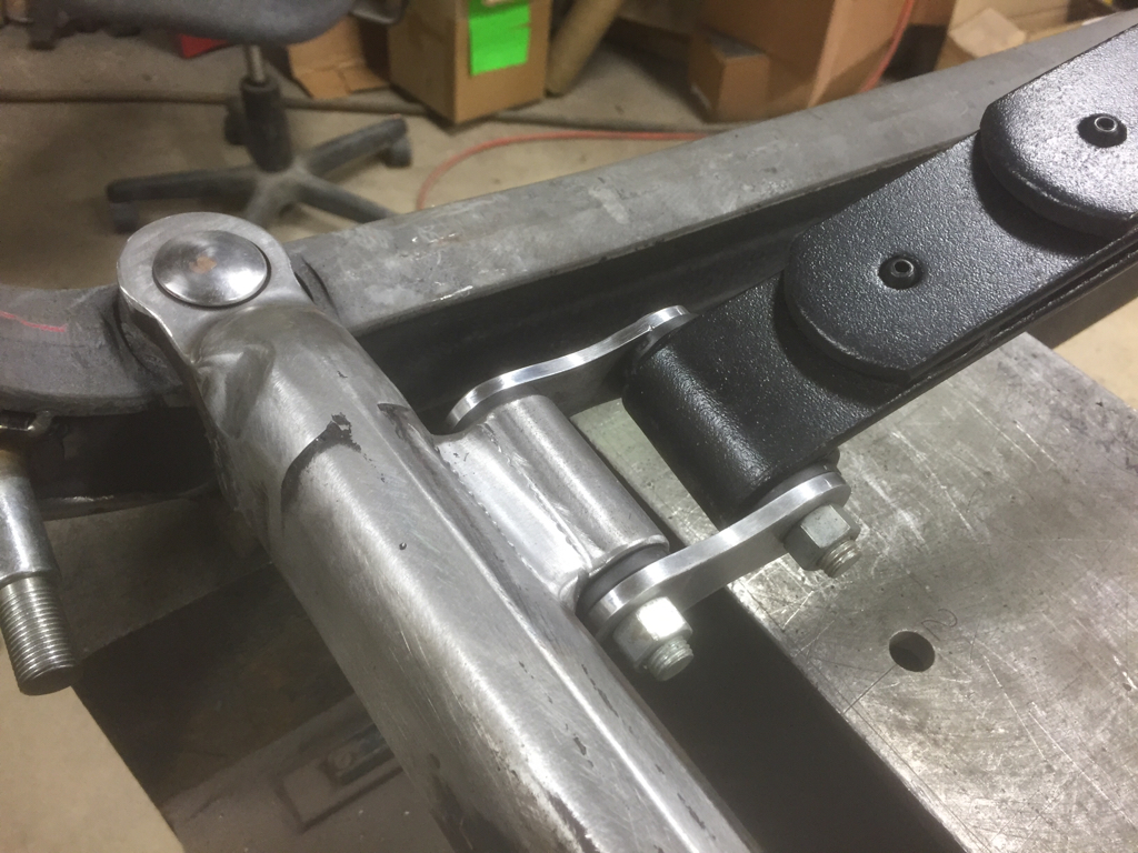

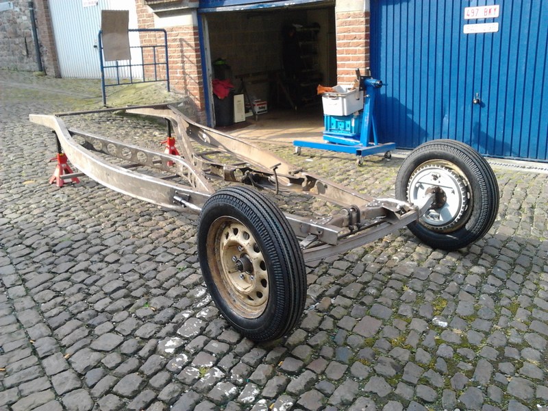

  21. I fabricated my own spring shackles 5/16" longer than original to get the shackle angle where we wanted it. Also can't remember if I've mentioned this before in the thread or not but I'm using '36 wishbones on the front . We moved the spring behind the axle, so we had our friend that's a machinist mill down the thick part of the bones where the spring use to mount. It looks more attractive that way.

  25. Got the coupe to sit the way we want it to. I'm using the original front wheels off my dads '40 Ford Standard Coupe, and the rears are '40 as well but we widened them to 6 inches.
    •Front wheels/tire: 5.00 16- Excelsior Radial
    •Rear wheels/tire: 7.50 16- Excelsior Radial

    So does this essentially drop the spring pack down which drops the car down with it? Because the longer shackle goes down further than the original?
    NathanxStewart likes this.
  27. Well we didn't do it to lower the car, normally that is the case. We did it because the new standard eye spring was a little too narrow for the spring mounts we already had welded to the wishbones.
