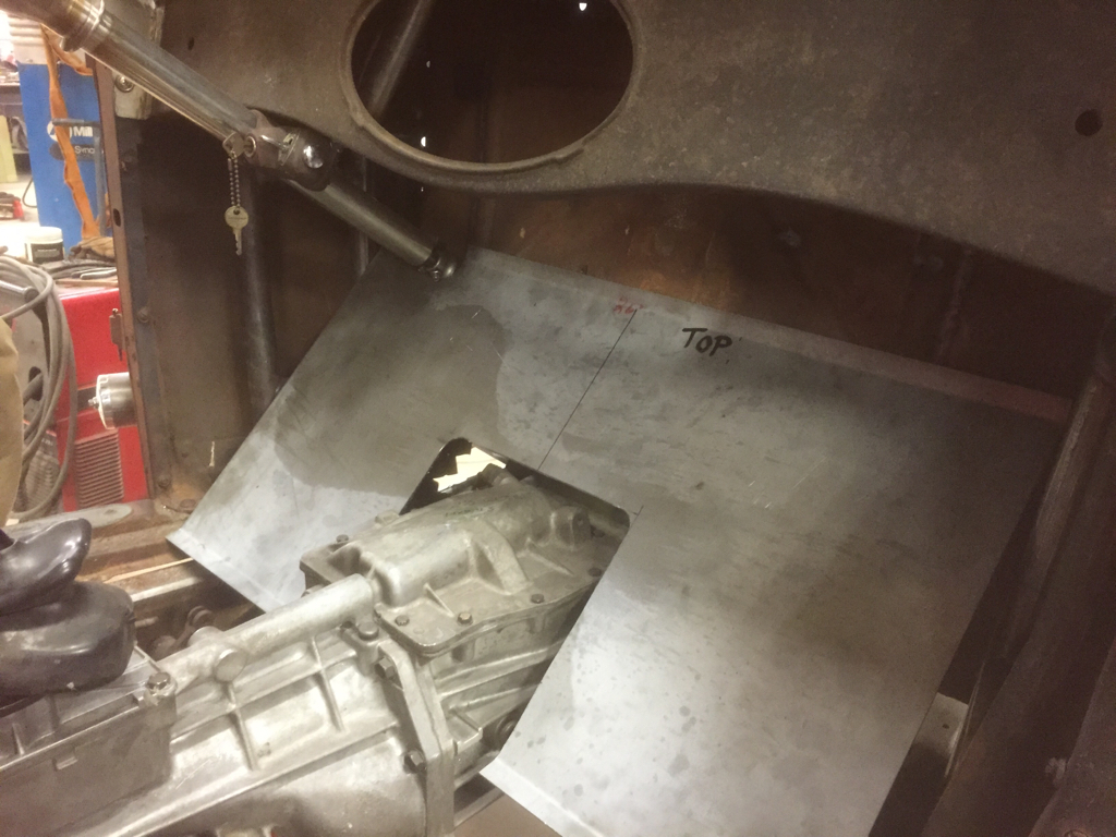

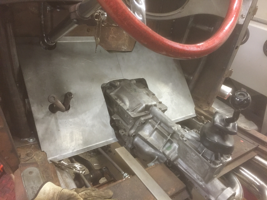

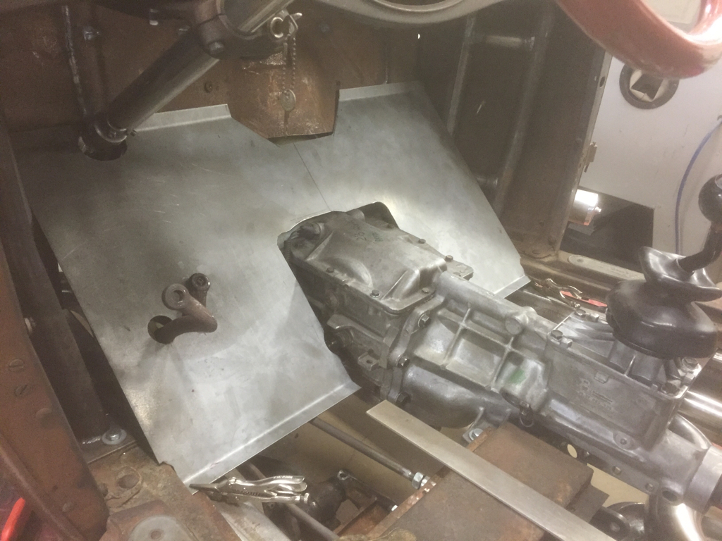

  11. Toe board is in, now time to build the transmission tunnel. Toe board is made out of 14ga steel.

    Looks like your toe board is using up a lot of real estate with the slanted portion making it all the way to the door opening. Your feet and legs will appreciate every square inch you can give them....I'd try to contour this area of the floor as much as possible to gain room.....even kicking the bottom of the firewall out a little bit to make room.

  15. Blue One
    Joined: Feb 6, 2010
    Posts: 11,507
    Blue One
    from Alberta
    You should try to mock up your seating position as closely as you possibly can to see if that toe board is at the proper angle for your feet.
    The angle of my stock model T footboard was way off because of sitting lower in the body than you do on a stock T seat.
    To have a comfortable foot - ankle angle to the toe board I was able to move the bottom of the toe board towards the firewall almost 4" ahead of the stock location.
    This made it very comfortable and added a lot of extra foot room.
    You might be able to do the same it makes a big difference in an otherwise crowded car.

  19. There's actually tons of room! We took the package tray out so the seat sits all the way back.
  20. Yep, we did! Surprisingly plenty of room in there. Took the package tray out so the seat sits all the way back. Thanks for the tips though!! [emoji106]
