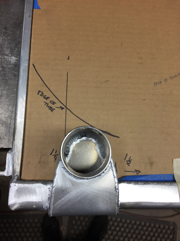

    Can you teach us a bit and explain why you went with brazing at the sections that have raised portions? I used brazing myself and had no problems but some of the members here hate it with a p***ion.

    Yeah, I was curious about the brazing too.

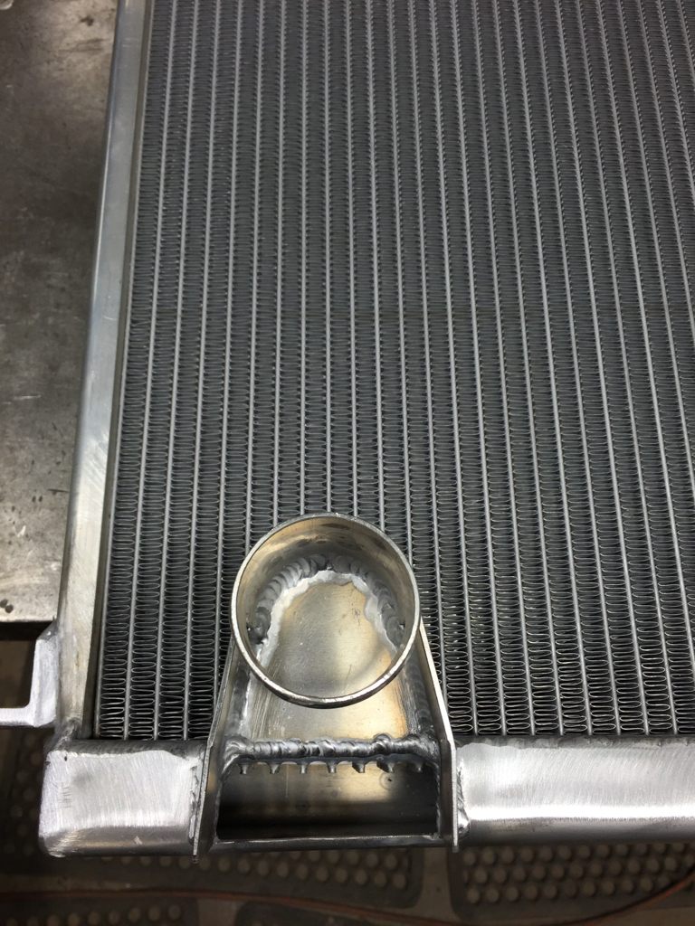

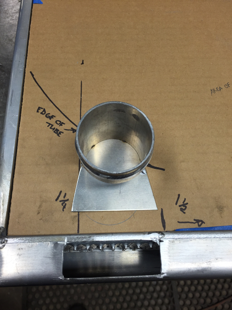

  10. @loudbang @Dino64 It's actually l not brazed! It's TIG welded with silicon bronze rod. Because it has a low melting point, and that means it can be used to fill a void with less warpage than steel rod. There was a slight void in those two spots where the original bead met the new piece.

  11. It's actually l not brazed! It's TIG welded with silicon bronze rod. Because it has a low melting point, and that means it can be used to fill a void with less warpage than steel rod. There was a slight void in those two spots where the original bead met the new piece.

    There really is nothing wrong with brazing. Just like any other method of joining two or more pieces of metal, it has it's place. It gets a bad rep because too many times the flux doesn't get cleaned off thoroughly, and the primer / paint will lift after a short time. I don't believe there is any good reason to braze bodywork in this day and age. I think it was used a lot in the past before MIG and TIG machines became commonplace in home shops.

    Exactly the problem. But I think the new mig and tig using the Silicon bronze rod is just brazing undated for use with the new machines. :p Whatever method you chose to use is still better for it's low heat needed.

    That's about right, but no flux to clean off and neutralize.
