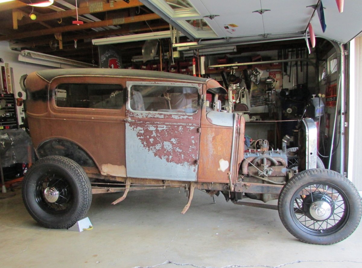

    Lookin like I'm about one year tardy into this conversation.
    I too am building a chopped A Tudor. Short story is, I started on the build of a Dodge Baby Hemi, not having a car to put it in. A chopped A Tudor, with pink slip, came to me almost before I was ready. So I jumped on it. A pinched 32 frame was ordered and is due mid Jan. 2021.
    I am eager to see how you have resolved "engine space",...i.e. radiator mounting and firewall. I'd rather not modify mine,....much.

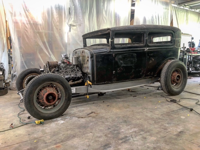

    Nice Sedan! I haven't updated this in a while.. I've been working on other things, but time to get back on this. I'll post some pics of progress. I have a 32 frame not pinched.
  13. Hurley50
    Joined: Feb 3, 2012
    Posts: 604
    Hurley50
    from NC

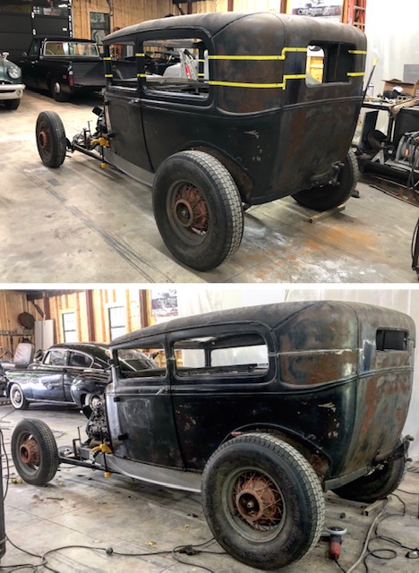

    A little update. I now have a 32 frame from Blackboards. This sedan will no longer be channeled. Obviously I chopped the top which has helped the motivation, I think it looks great with a 5.5" chop. My kids and a few friends helped on chop day. Still a bunch of fitting and welding to do. IMG_3331.jpg 271065AB-27AF-43BF-B094-05CBAA9521D4.JPG IMG_3313.jpg
