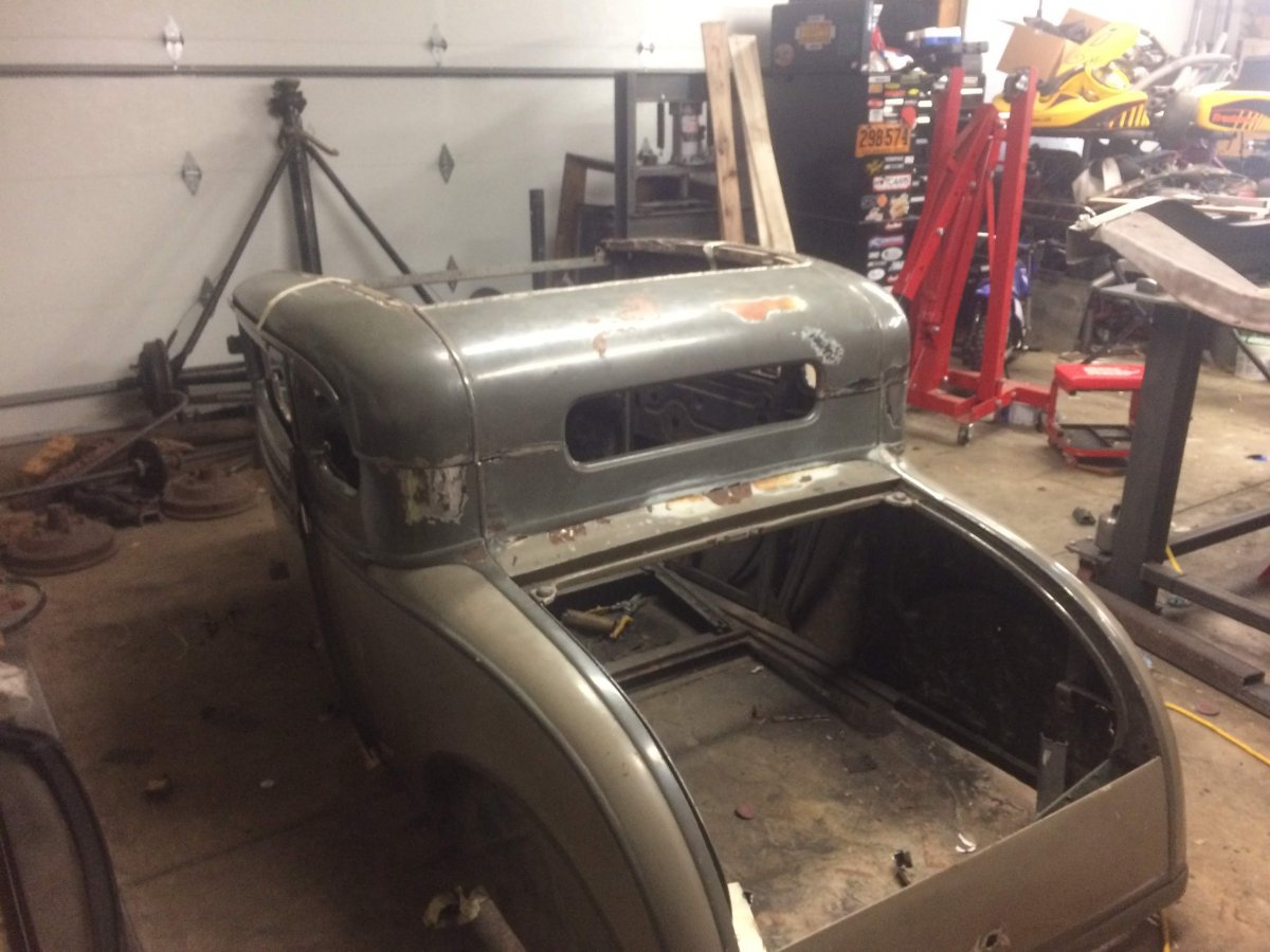

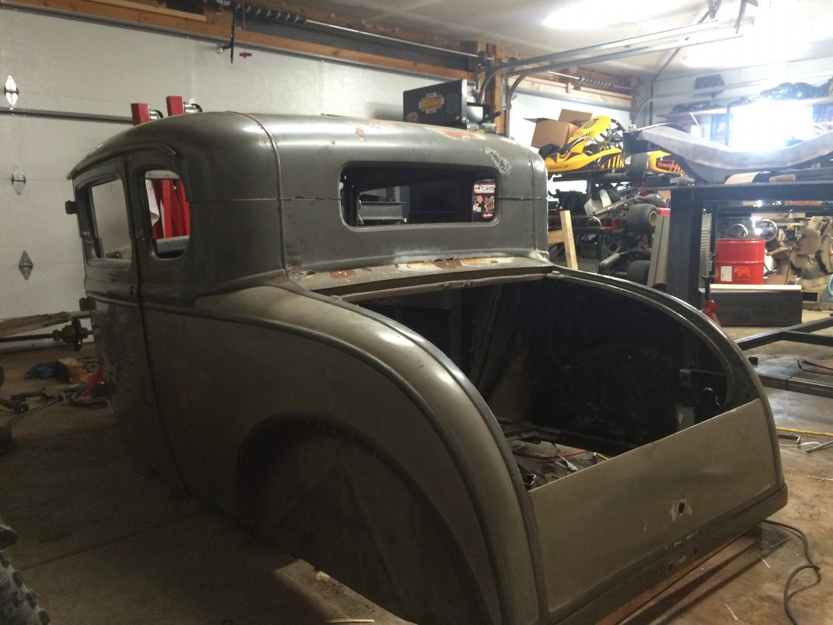

    IMG_2071.JPG Body Removed
    IMG_2075.JPG The A frame has been moved to the back yard this will be used for a 29 sport coupe in the future - see you in 10 years or so. IMG_2078.JPG

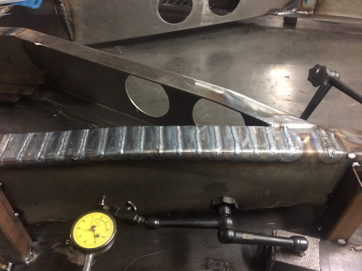

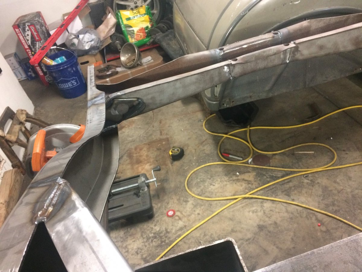

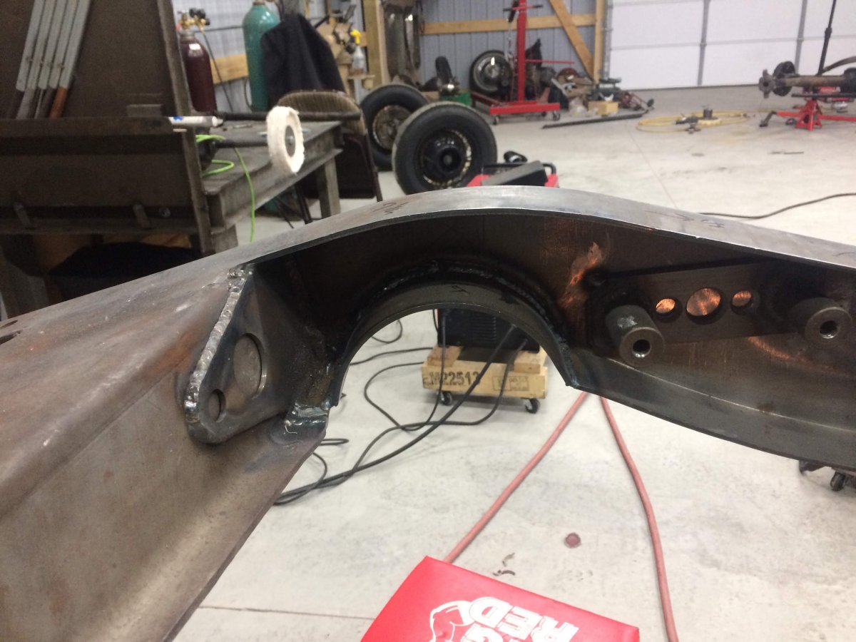

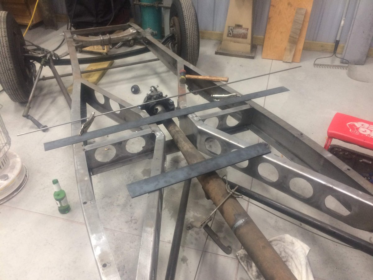

    IMG_2284.jpg IMG_2504.jpg IMG_2288.jpg IMG_4101.jpg IMG_4325.jpg IMG_4332.jpg IMG_4329.jpg IMG_4327.jpg IMG_4357.jpg Above is the ASC rails pinched in to match a model a sub frame, rear cross is a flattened out 32. X style member. Engine mounts.

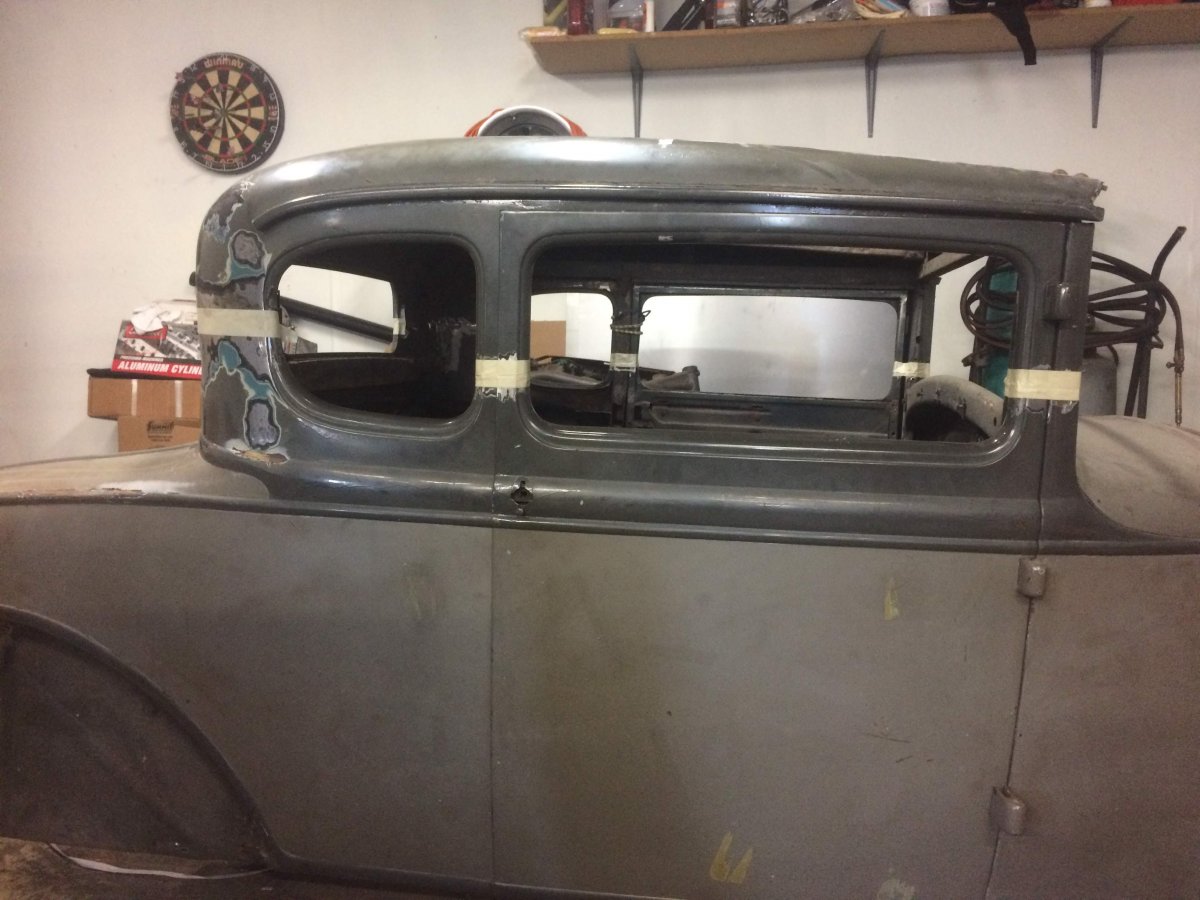

    I didn't like the first chop and I enjoyed doing it so much I did it again. its about 5". Lost count. IMG_4643.jpg

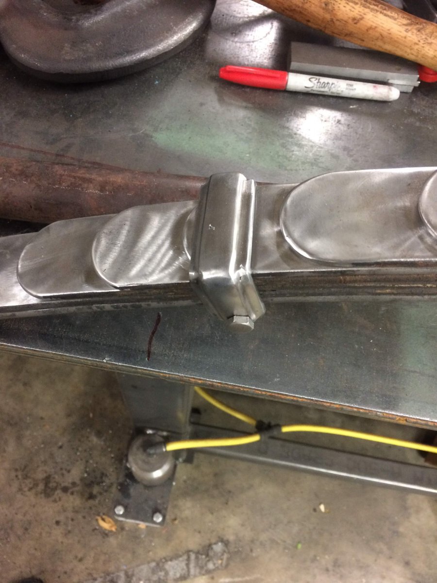

    I also reversed the eyes on the front spring and made the spring clamps using some 2" square tube IMG_5103.jpg

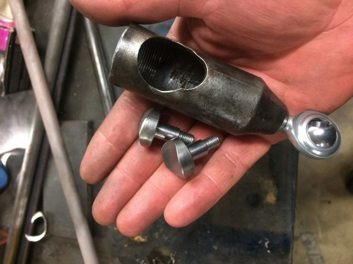

    I used a moded A tie rod end for the shock linkage, and the length is adjustable with the modern rod end. heated and bent in and out the Armstrong arm. using a wet towel to keep the body cool IMG_5900.JPG

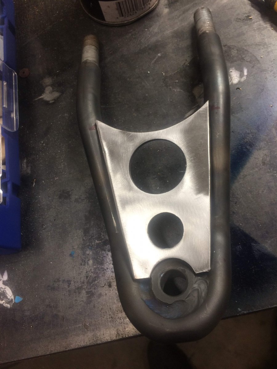

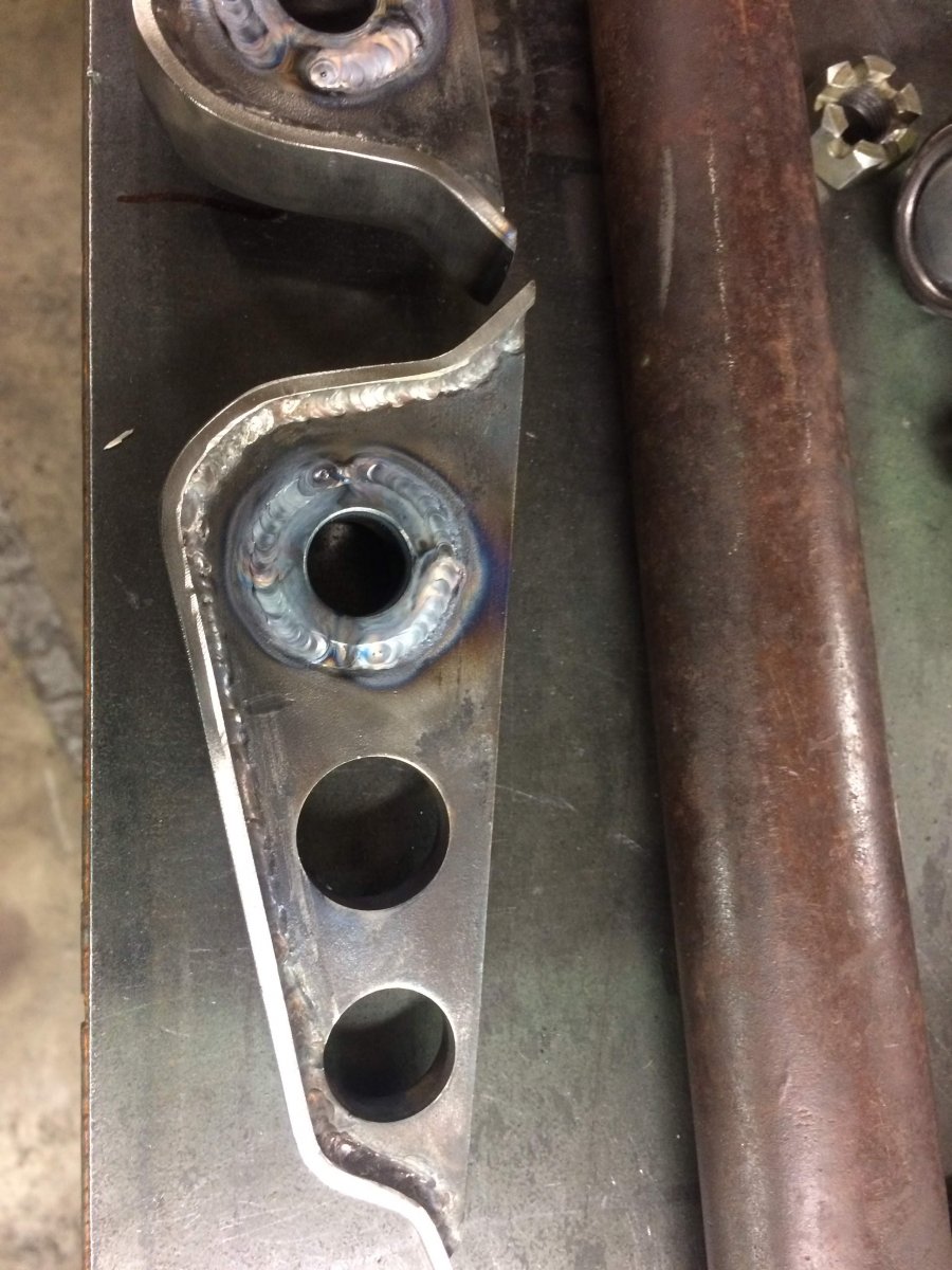

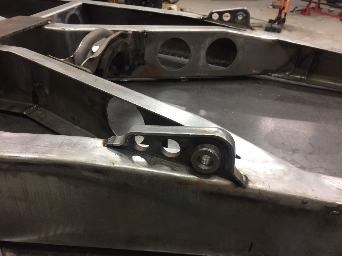

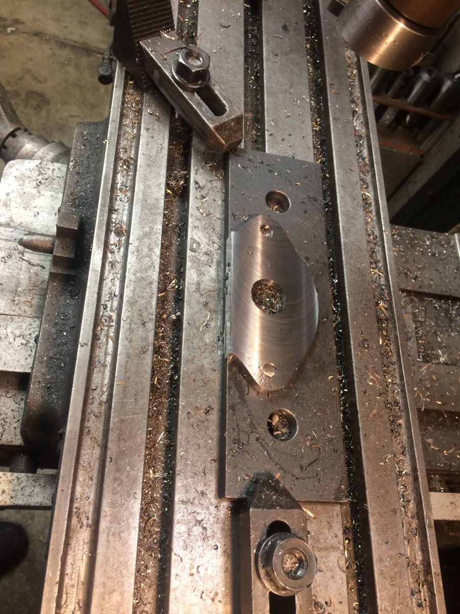

    THis is the rear shock bracket and little doodad that will be welded onto the axle bells IMG_6736.JPG IMG_4645.JPG

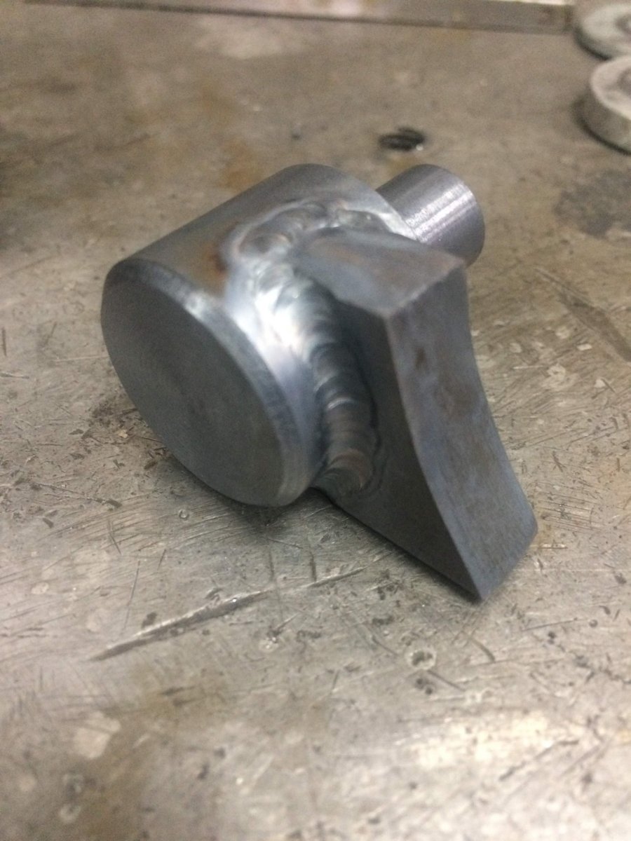

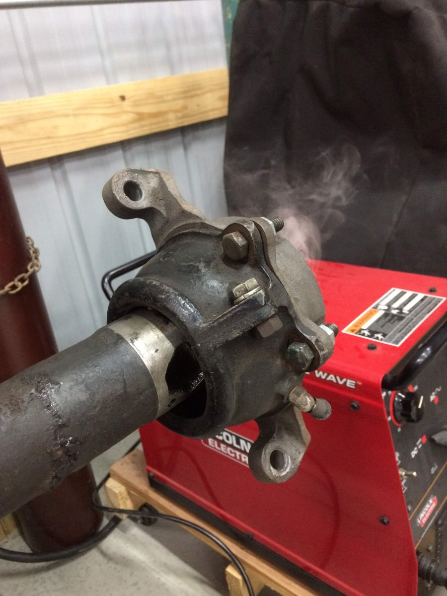

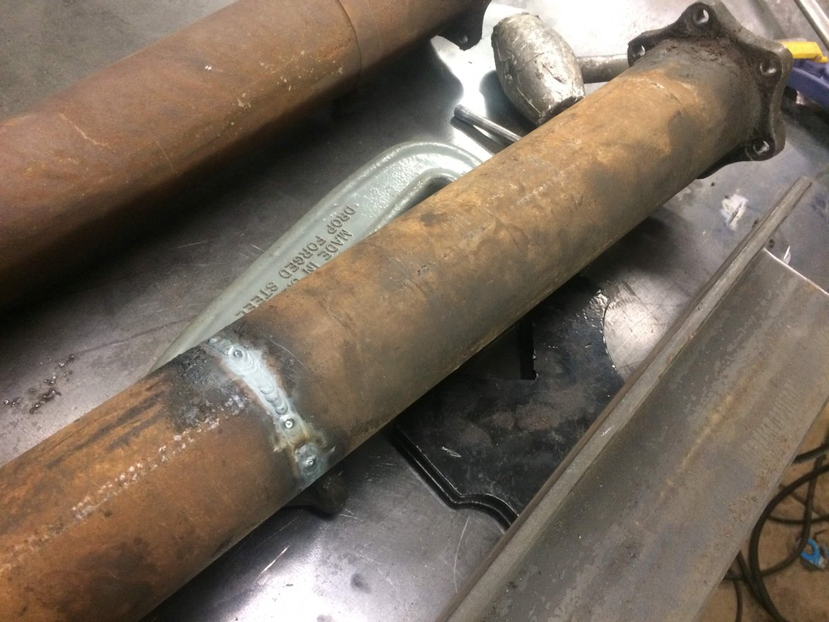

    For the rear rods I had to space them out so they missed the rails. I used a shock mount that was on a rear end I aquired. I then shortened the rods and welded them back together and made a new boss for the torque tube. I used the whole thing as a jig to weld it all back up. I had to make a drum puller before I could do this I had a old wire wheel which worked out perfect albeit hacked together. IMG_6647.jpg IMG_6651.jpg IMG_6653.jpg IMG_6654.jpg IMG_6773.jpg IMG_6774.jpg IMG_6775.jpg IMG_6776.jpg IMG_6777.jpg IMG_6778.jpg

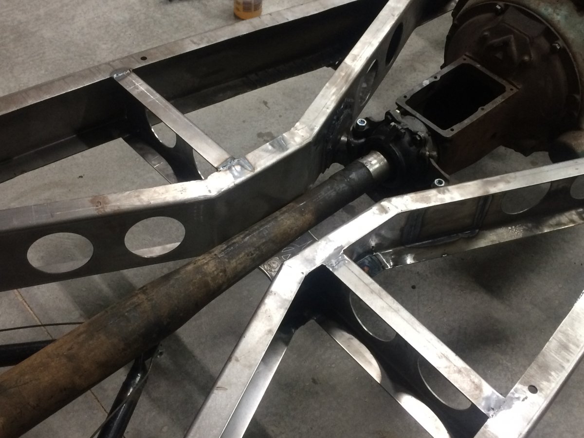

    This out of order but realized I missed it out, I needed to shorten the torque tube. IMG_4580.jpg IMG_4581.jpg IMG_4583.jpg

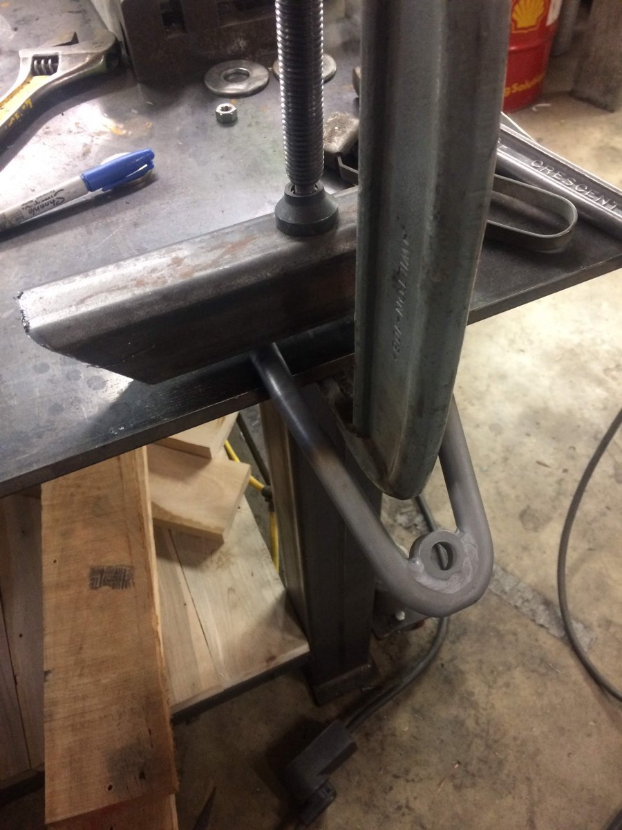

    I made this roller for a work project and luckily it came in handy to bend the c-notches! Also added some cross members to the X. IMG_5330.jpg IMG_6042.jpg IMG_6573.jpg IMG_6750.jpg IMG_6762.jpg IMG_6763.jpg

  24. Phil P
    Joined: Jan 1, 2018
    Posts: 569
    Phil P
    28-72866-1.jpg Nice fab work. Small point though a drum puller should in gage the center of the drum not the studs if the drum is on very tight you could warp it. IMG_6647.jpg
    Stogy and Willows like this.
  25. Willows
    Joined: Apr 12, 2016
    Posts: 77
    Willows
    Thanks guys. @sloppy jalopies i have enjoyed reading your projects. @Phil P good point, was trying to think about what i had at hand. Should not try to reinvent the wheel with a wheel!!!

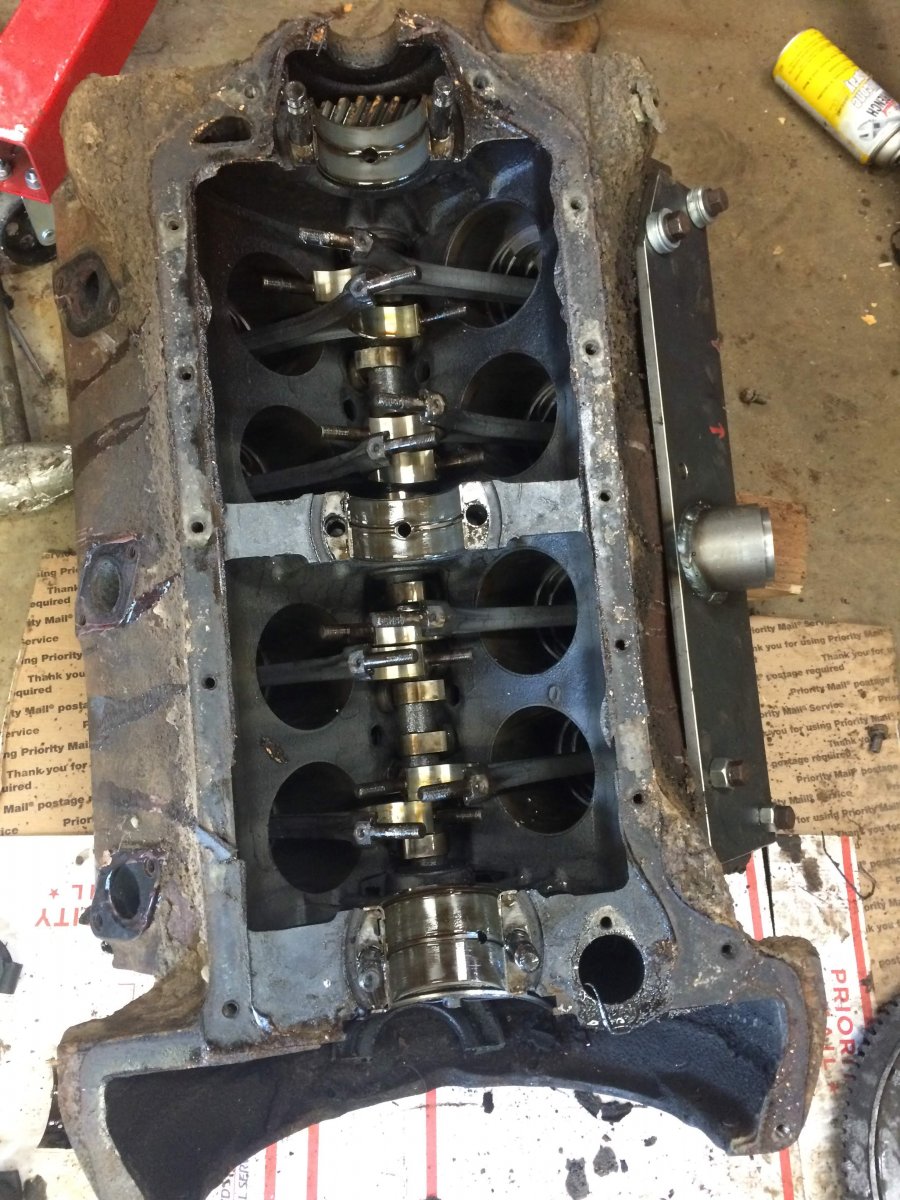

    Onto one of the Flatheads. This was done a while ago but thought id share some of my trials and tribulations. this motor actually turned over so i thought it was a pretty good candidate for the build. it was really crusty tho. to get the studs i would jam two nuts together and try to undo them together - this worked for a few.
    for the others find one of your wifes favorite candles, helps if its scented cos this 70 year old oil can really smell bad then weld a nut to the stud all the heat goes down the stud at this point jam the candle down on it some of that molten wax goes into the threads some goes on your hands. after they cool a little they all popped out really easily IMG_2143.jpg
    IMG_2087.jpg After removing the rod ends removed the crank and pistons IMG_2114.jpg IMG_2115.jpg the valve ***emblies were a pain in the *** i have the KD pry bar and could not get one out! So after removing all the clips i welded nuts onto the face and screwed in allthread and used a slide hammer type thing and they came out with ease. final picture was all the **** thatcame out. IMG_2151.jpg IMG_2144.jpg my wife came in wondering why i was burning scented candles in the garage, and proper bollocked me!
    unfortunately this was all for nothing as after cleaning and magnaflux turn out there was irreparable crack, ffs. plus four cylinders had been lined. oh well!
