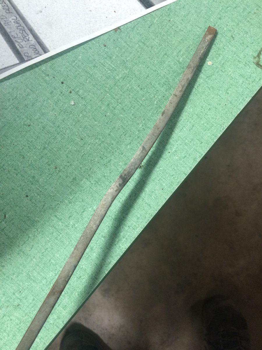

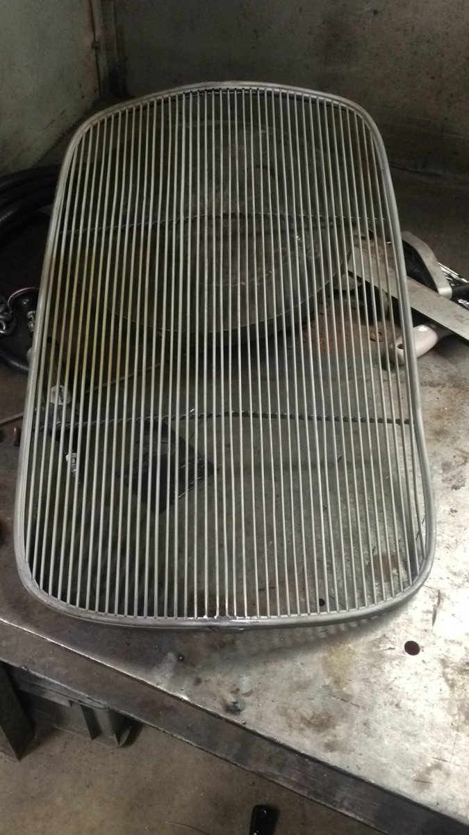

    I picked up a insert and shell. the insert had a bunch of bars missing but i had a handfull of bent and twisted bars, to straighten them i put a saw in a vice and hammered them back to straight over the blade.

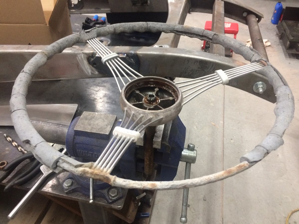

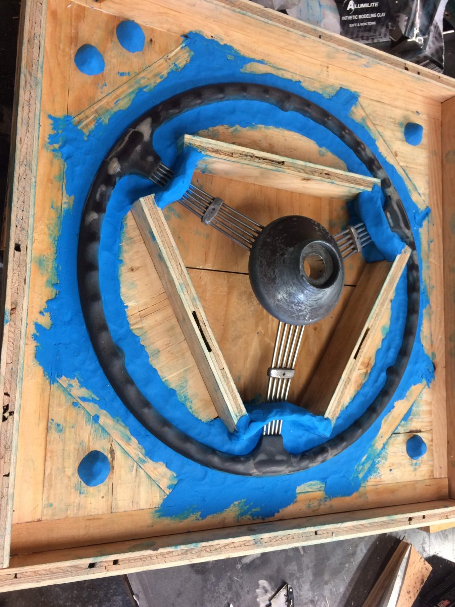

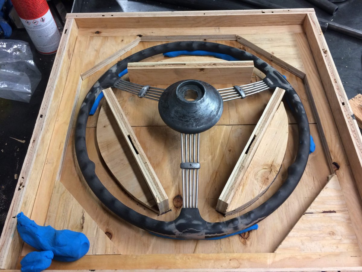

    Steering wheel work - got a little ahead of myself on this but wanted to restore my banjo steering wheel, lot of cracks and chips and dryed out.

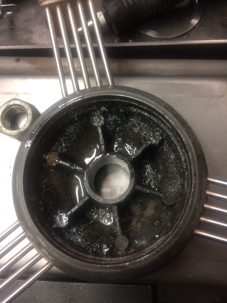

    first I wanted to make it fit my steering, so I milled out the keyed center then machined out the center with the right spline from a junk wheel, then pressed it in.

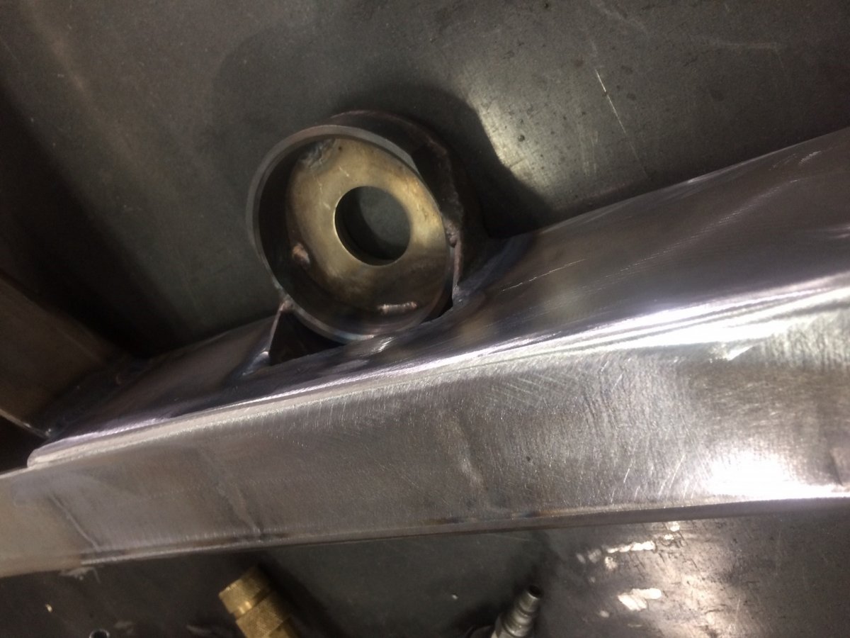

    Then I made a plate to weld the bushing too - the center of the wheel is aluminium.
    then made a cap
    I then wanted to restore the wheel so I first fixed the wheel rim with bondo and sanded it all smooth. then I made a mold from it using silicone.
    the mold is in two halves - first using a clay type putty you build it up around half the wheel. cover it in mold release spray and pour in the silicone, after it drys you pull off all the clay then spray mold release again anmd pour the second half. You end up with a void that you fill with a two part resin that when cures, is super strong but flexible. I have made a bunch of wheels as practice - its really hard to get it to vent right and you only have about 30 seconds of work time after you have dyed and mixed the resin. I have not removed all the old wheel down to the steel insert as im a little scared and wanna get it right first time! this was a lot of effort and maybe should of just bought a good wheel! but at least if I get this down I can buy the cheaper bad wheels and fix them. fingers crossed!
    A

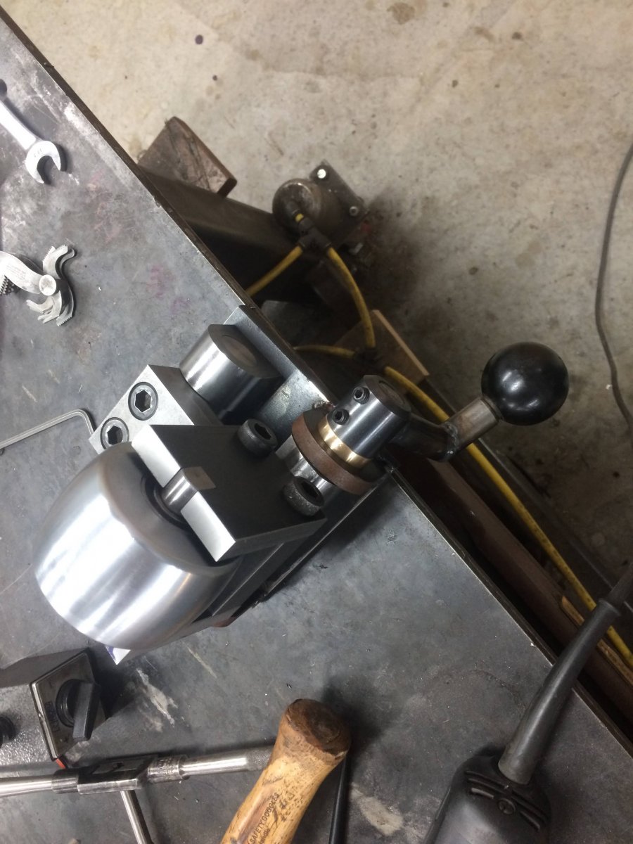

    Oh and I made this buffing wheel from an old motor I acquired. gonna need this as the steering wheels come out a little dull

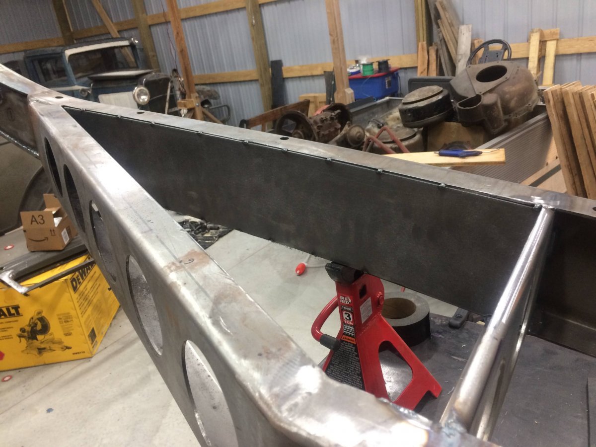

    Thank you for the compliments guys, really helps keeping me motivated. Which it feels like as though lately i have been lacking. its been very cold here in denver for the last few weeks and i have no heating in my shop so its almost unbearable. So not much progress to report:
    I started to box the frame. Then plasma cutter ****ped out, it apparently doesnt like the cold either. Luckily it was still under warranty and is being repaired.

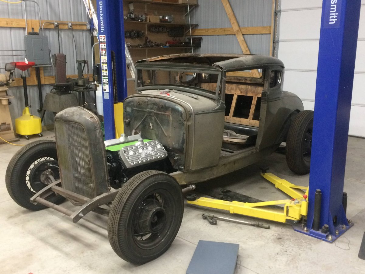

    Hi. To say that I am embarr***ed about it now being almost two years since last post is a understatement. I don’t understand why it is taking me so long to do this, I have all this energy to work on the car when I am not around it then I get home from work and not much happens. I feel overwhelmed sometimes maybe. I hope that I am not alone feeling like this.
    Needless to say we didn’t drive hotrods to Bonneville 2019, we were there and had a fantastic time per usual. 2020 did not happen for us. 2020 what a year…
    I have made some progress. Not as much as I hoped. But some. Chip chip away, right?
    I have managed to make some improvements to my shop also which has been great. Also some new tools.
    Ill follow this post with a download of latest trials and tribulations.

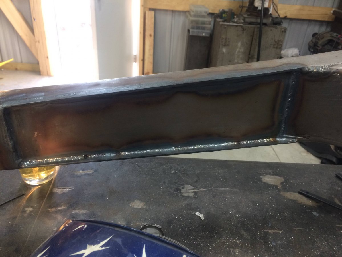

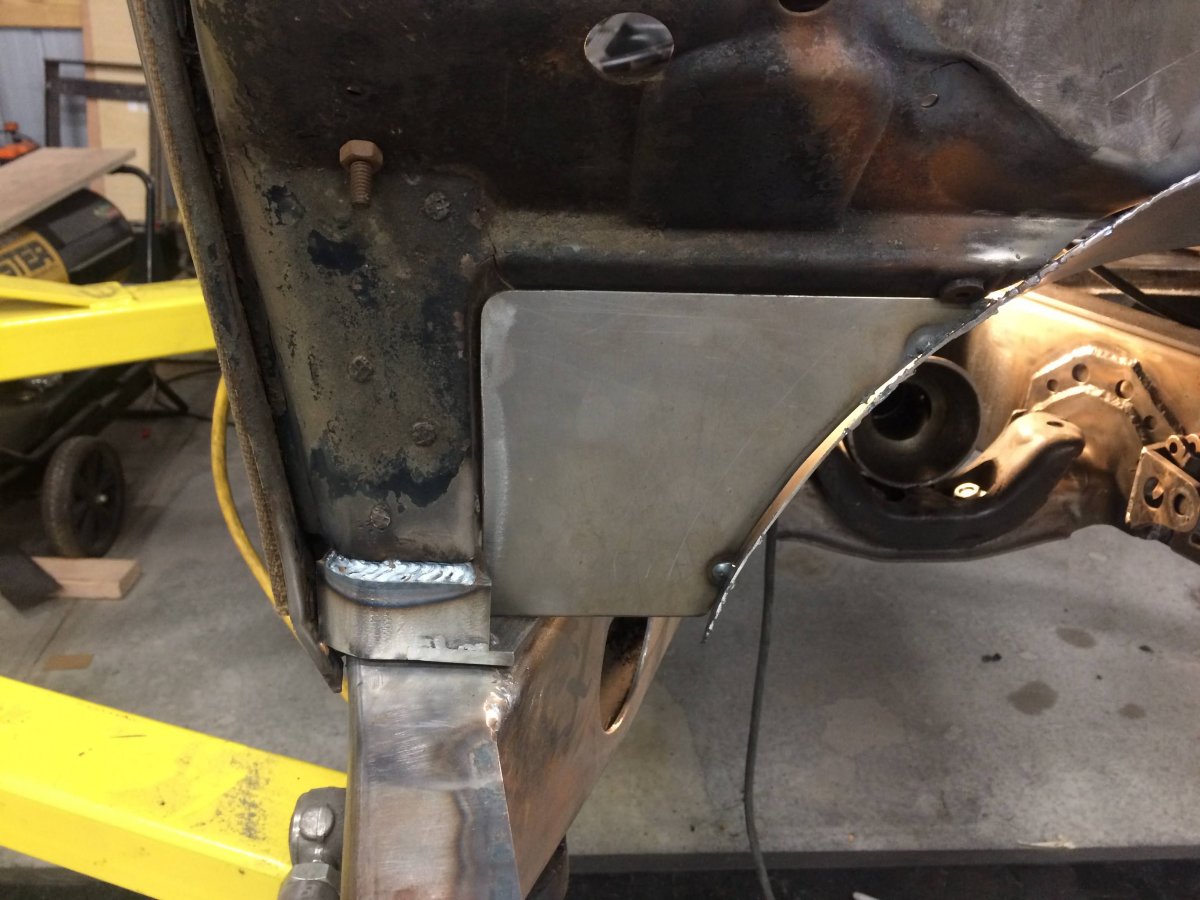

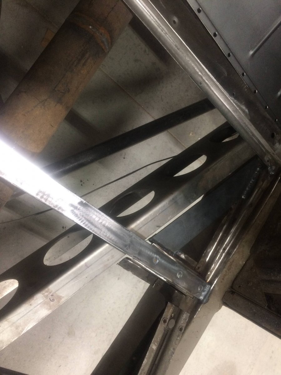

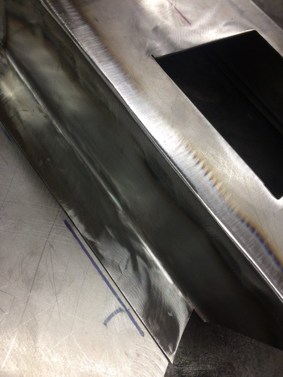

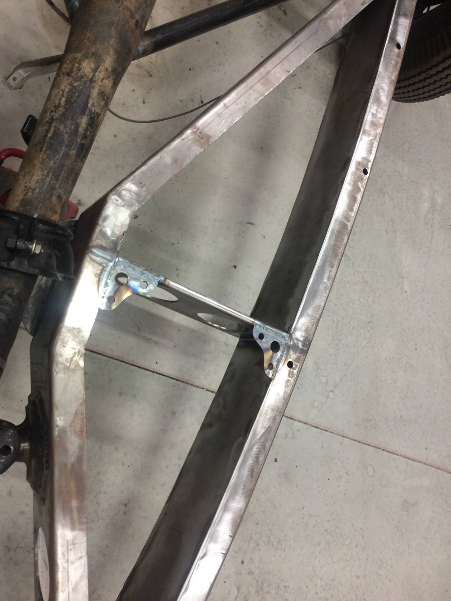

    I finished boxing the frame. i had screwed up on the center X section was interfering with sub frame. Trimmed the top and added some gussets
    . IMG_7306.jpg IMG_7307.jpg IMG_7308.jpg IMG_7309.jpg IMG_7338.jpg IMG_7489.jpg

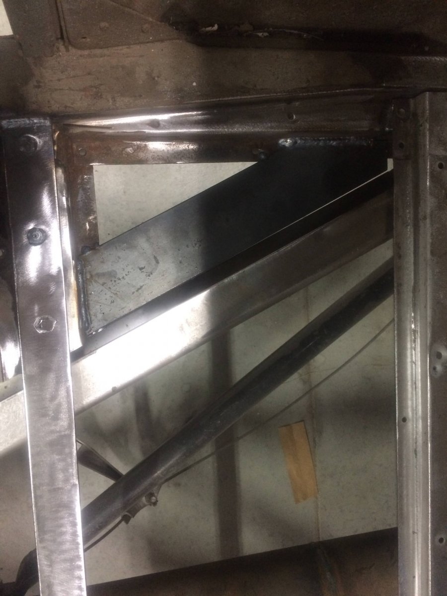

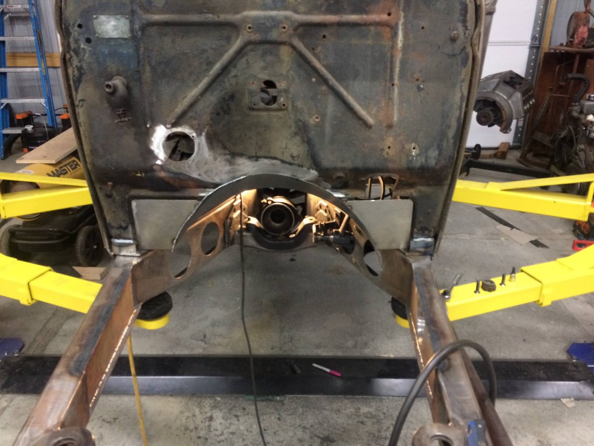

    Another mistake i made was not copying the angle and length of the x-member from stock. What i should of done is what my idol and man crush B*** does which is just remove one from a 35-40 and weld it in. What i did is got some bent channel drilled a load of holes etc.
    So when it came to the pedals i was forced into making my own, which ended up being ALOT of work. I can only find a few photos but i can take some new ones if anyone is interested.

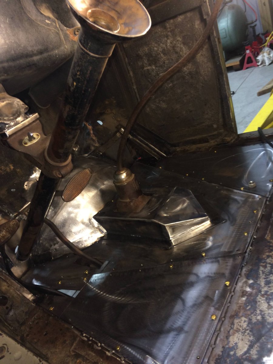

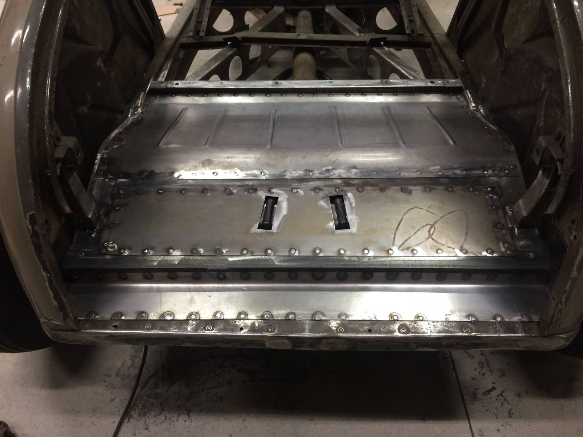

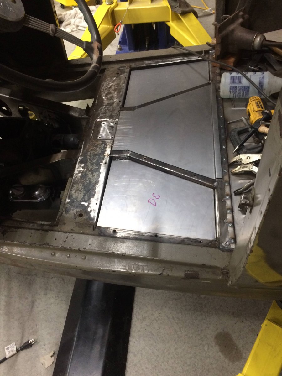

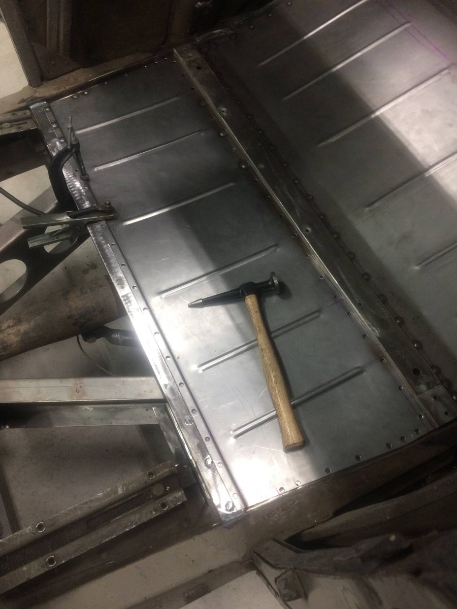

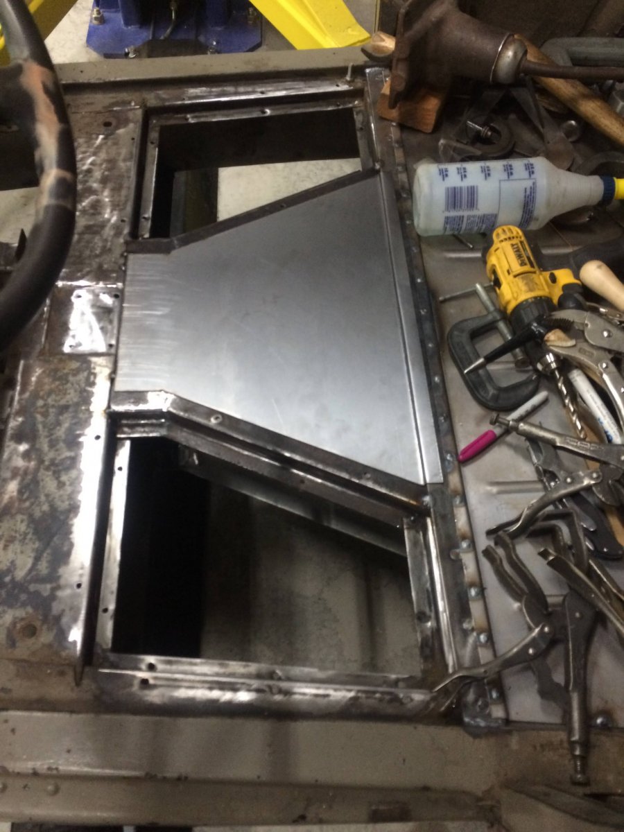

    Built the floor. i used parts of a cut up subframe to make pockets. the front floor is all removable for access to MC
    and battery which will be under p***enger. I had won a big box of large hinges at an auction, used some to make a metal brake so i could bend the rear section
    . IMG_0024.jpg IMG_0025.jpg IMG_0028.jpg IMG_0392.jpg IMG_0393.jpg IMG_0456.jpg IMG_0487.jpg IMG_0489.jpg IMG_0583.jpg IMG_0584.jpg IMG_9358.jpg IMG_9367.jpg IMG_9376.jpg IMG_9382.jpg IMG_9384.jpg IMG_9385.jpg IMG_9531.jpg IMG_9532.jpg IMG_9533.jpg IMG_9630.jpg IMG_9828.jpg IMG_9839.jpg IMG_9840.jpg

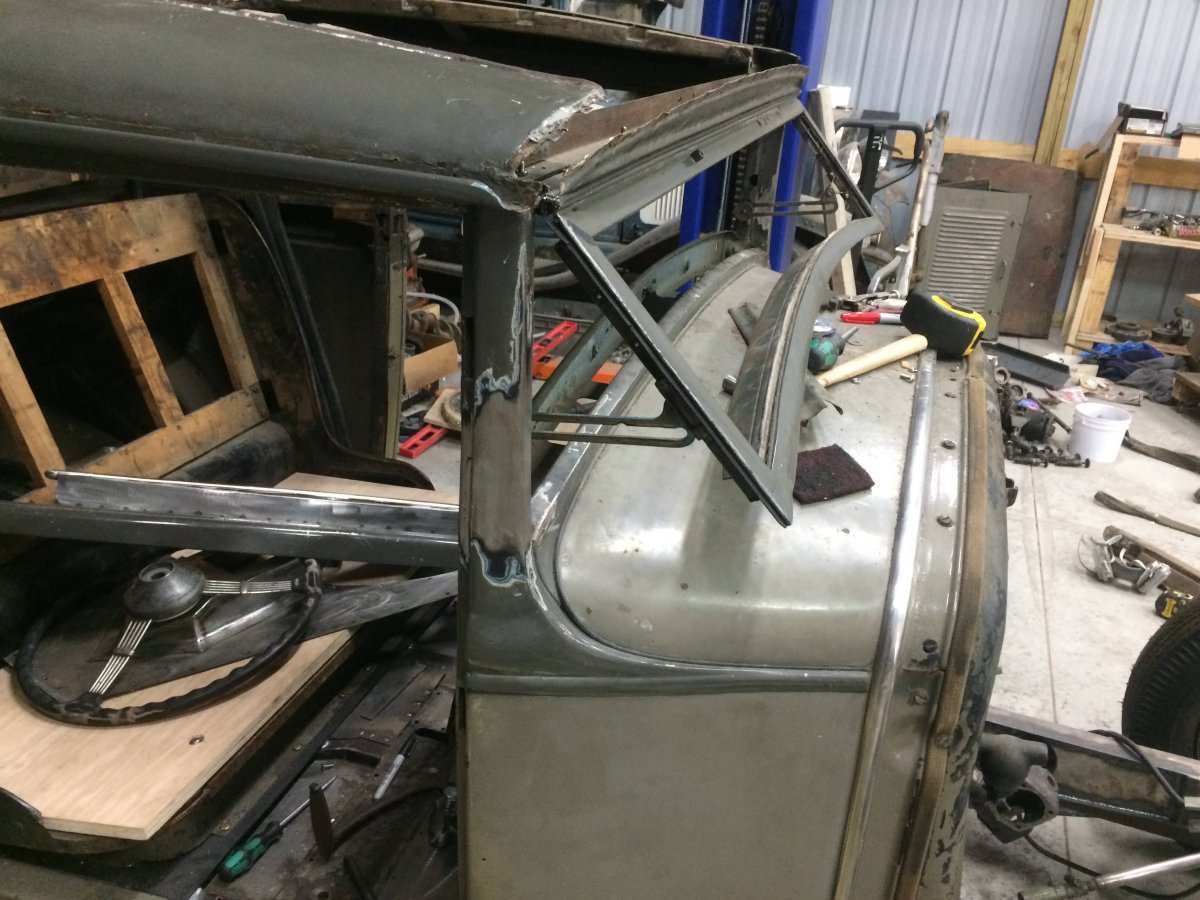

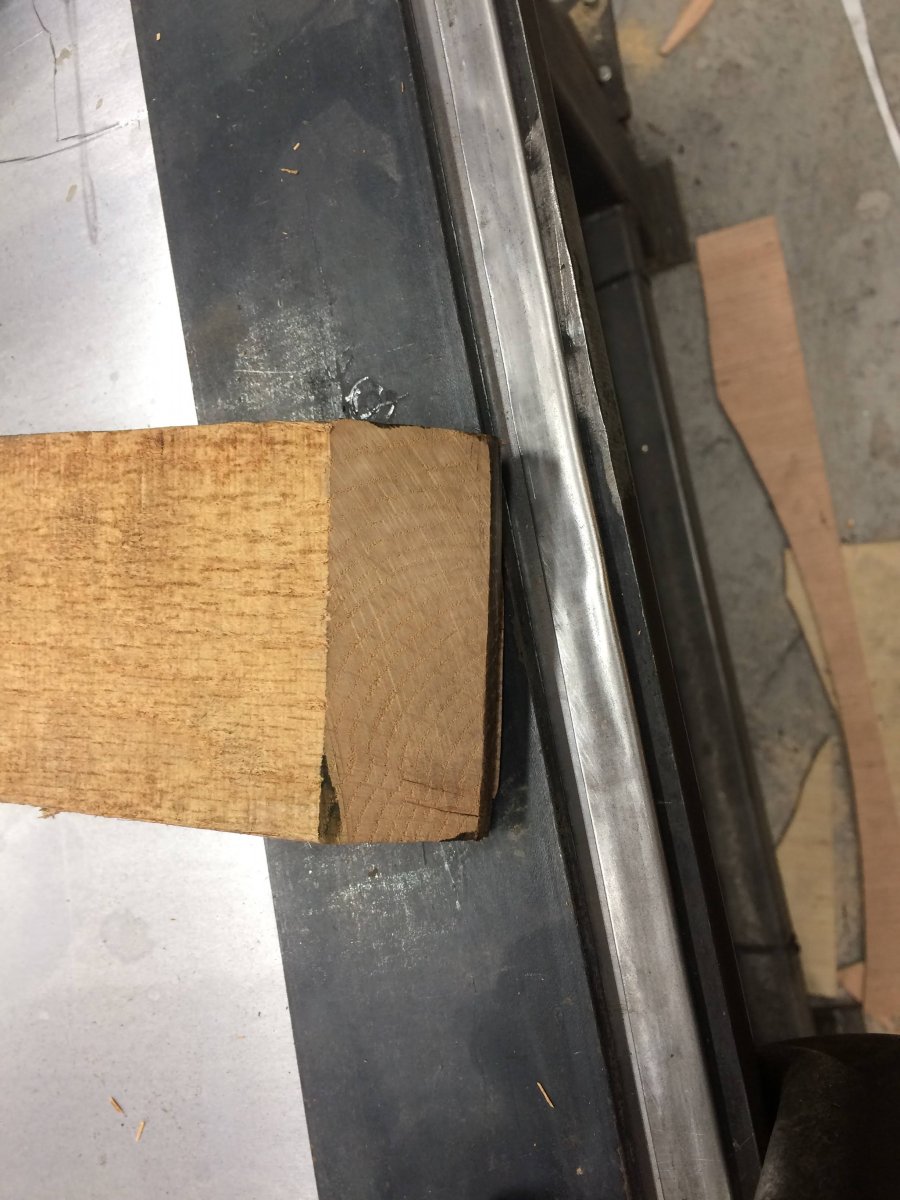

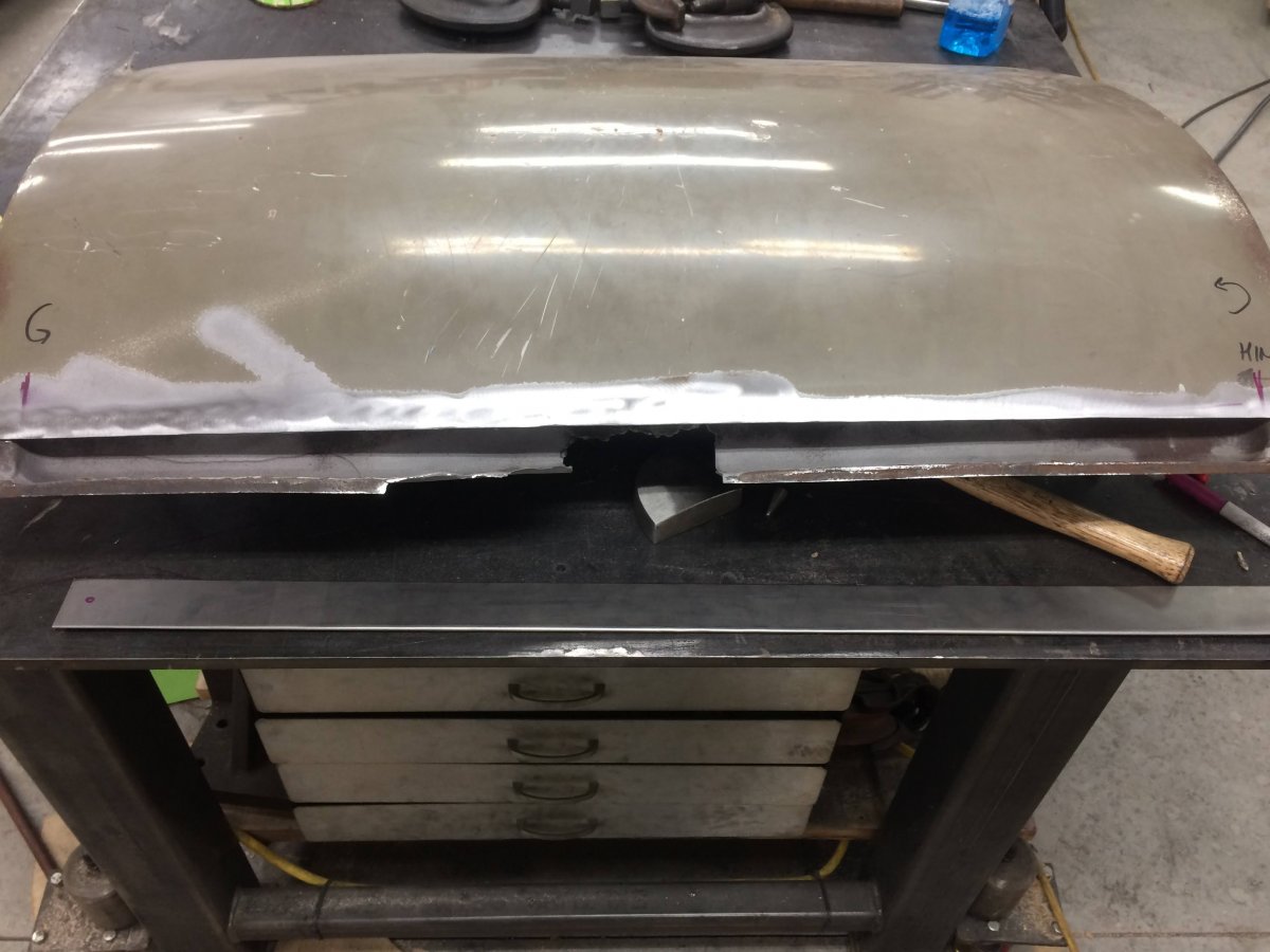

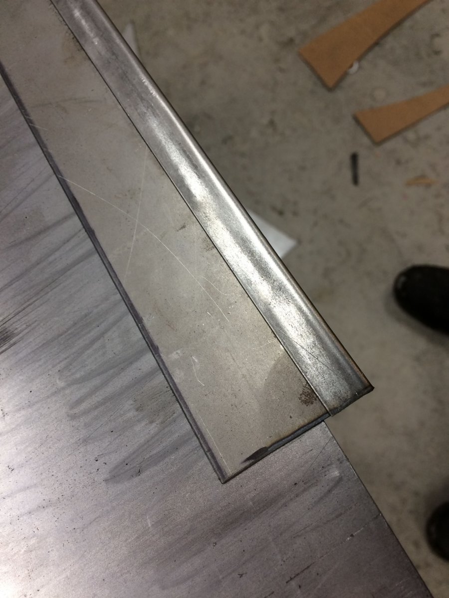

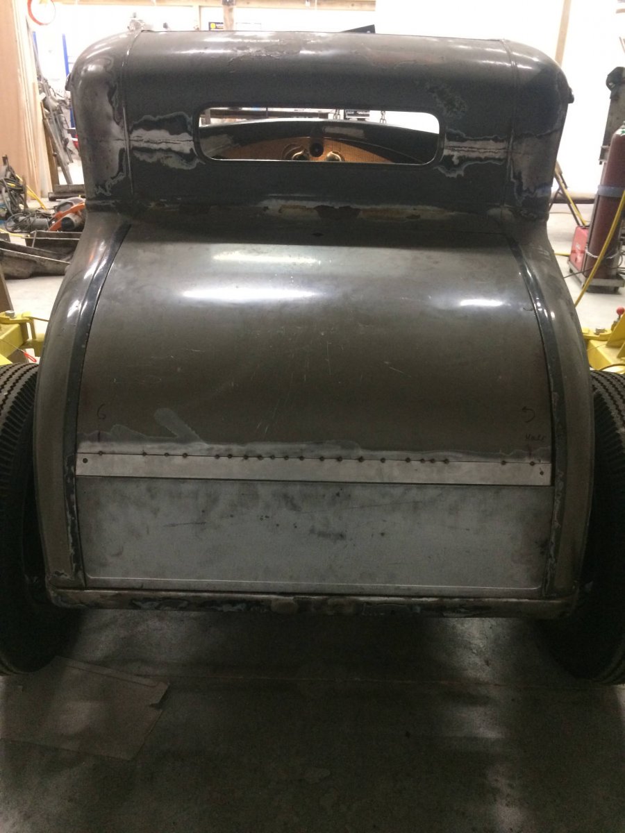

    Deck lid was badly rotted so needed to fix that. I used a piece of hardwood to fold patch piece on itsself and had a very damaged deck lid that i cut some parts off IMG_0612.jpg IMG_0613.jpg IMG_0614.jpg IMG_0615.jpg IMG_0617.jpg IMG_0625.jpg IMG_0626.jpg IMG_0637.jpg IMG_0639.jpg
  25. Willows
    Joined: Apr 12, 2016
    Posts: 77
    Willows

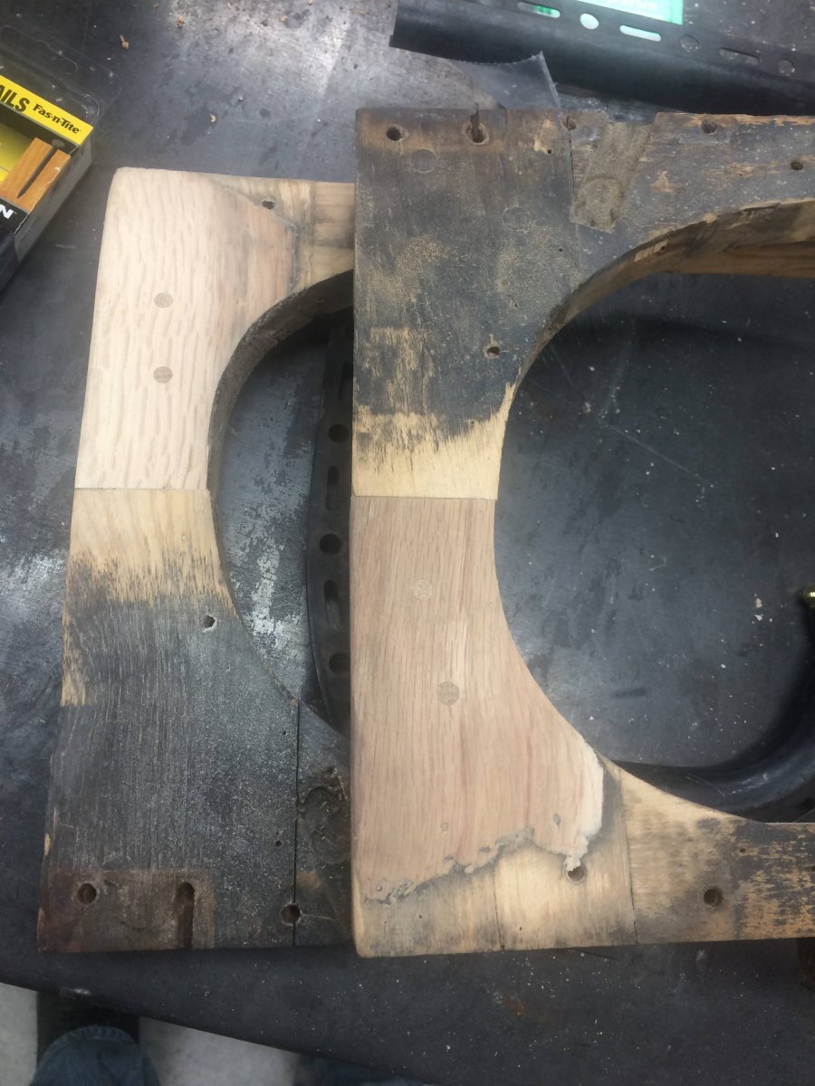

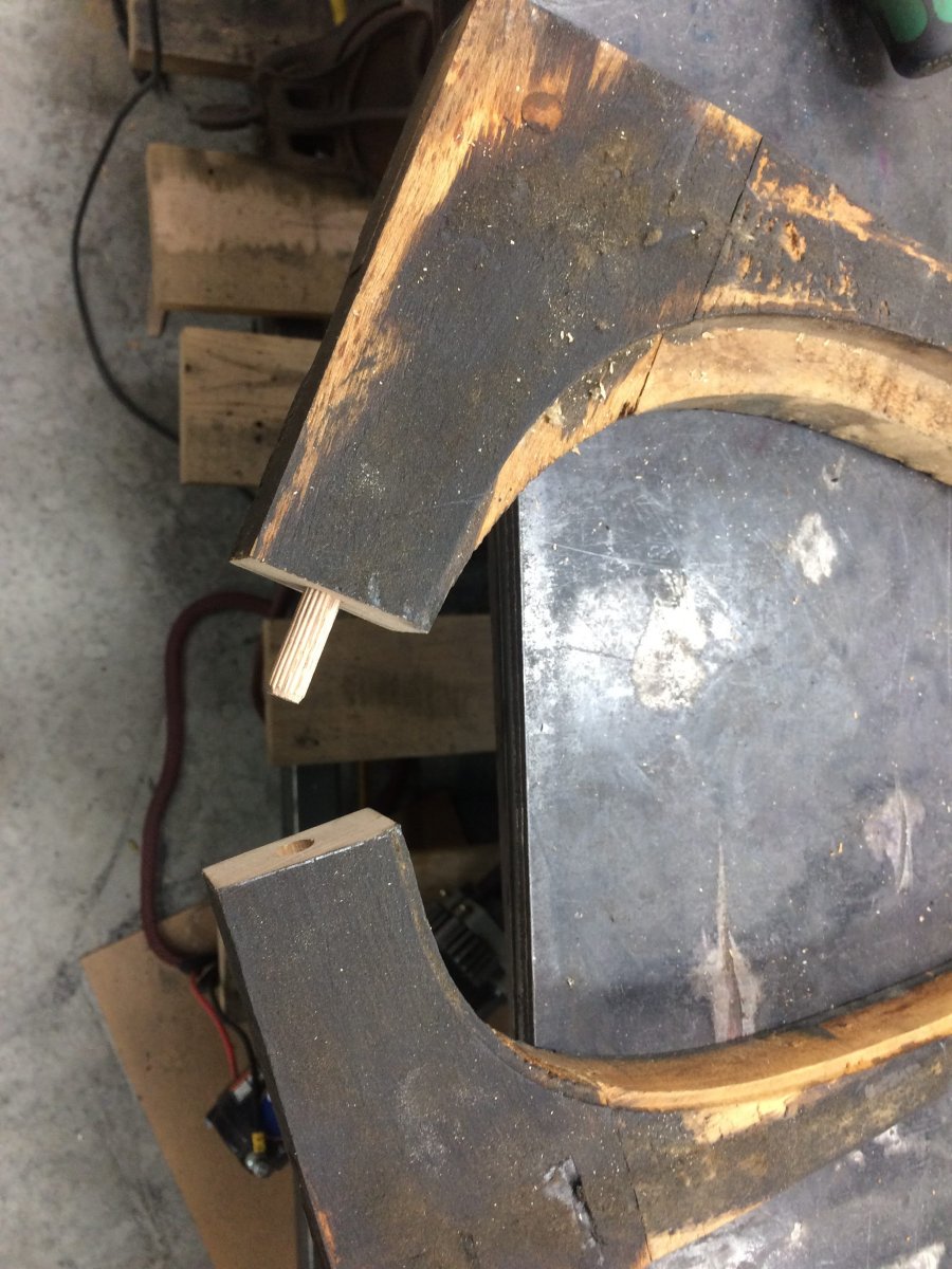

    I was so lucky with this car that all the wood and garnish molding was in it and in great condition (other than the roof, headliner etc) but after the chop i needed to shorten, heres the pictures showing that. i dowled and glued and added oak then sanded for the rear window. IMG_0703.jpg IMG_0730.jpg IMG_0731.jpg IMG_1106.jpg

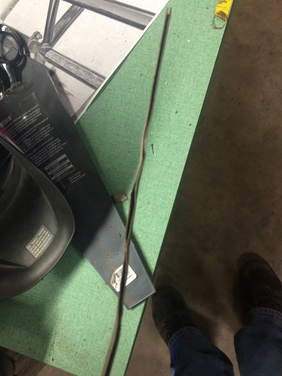

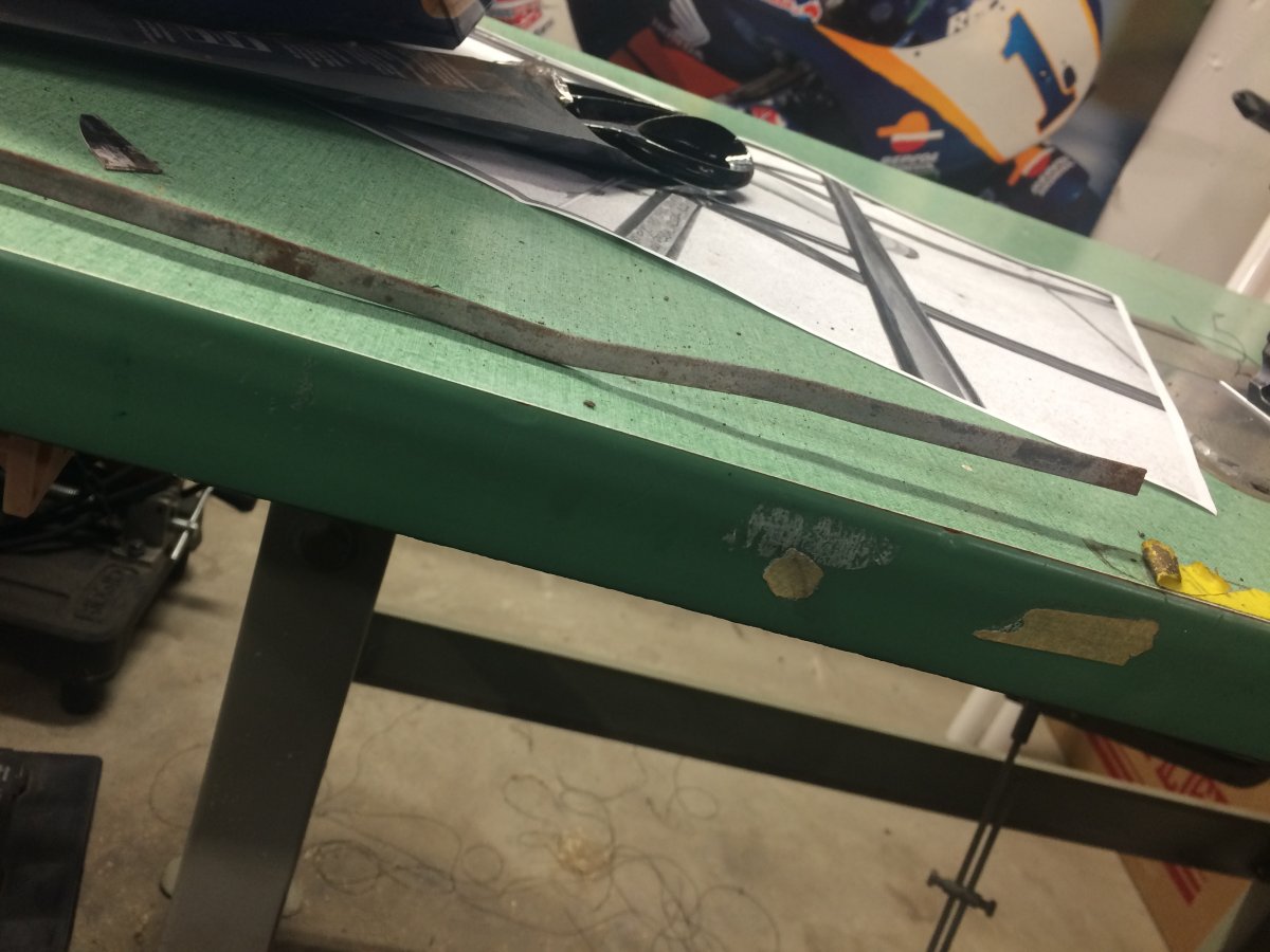

    These next pictures are how i tackled the front which some may be interested in. i made a little transfer punch to locate the holes. then made a really simple cup to do the new counter sink. sorry that the pics are not that clear
    IMG_2436.jpg IMG_2435.jpg IMG_2434.jpg IMG_2433.jpg IMG_2432.jpg IMG_2430.jpg

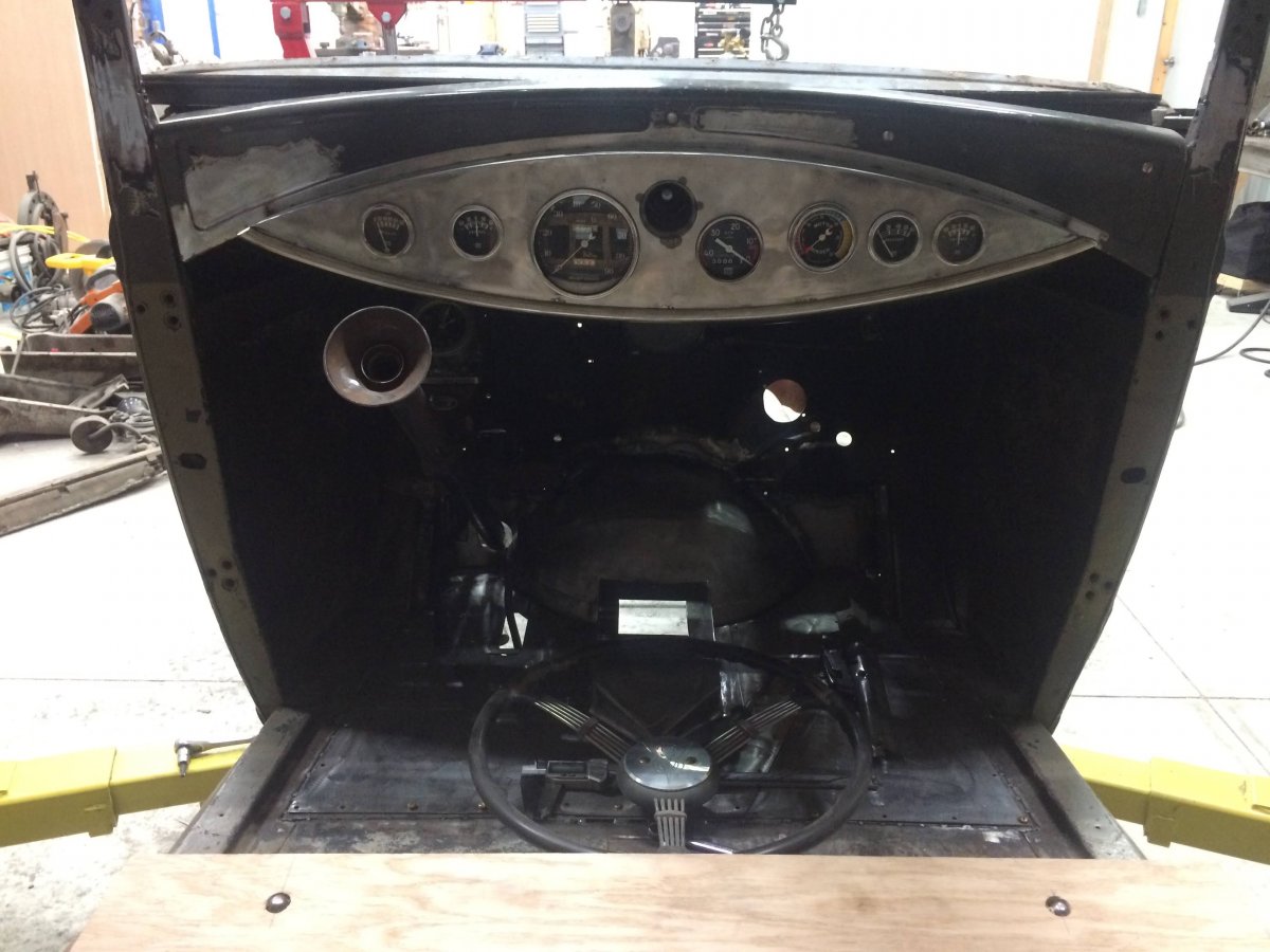

    dash work
    First there was some holes that i needed to fix. i am using the stock tank and wanted to be able to see the tank level dial, so a made a little fixture to make a trumpet shape. Using a harbor freight hyd press it made easy job of it. you can see the two pieces of the tool IMG_0512.jpg IMG_0513.jpg IMG_0516.jpg IMG_0518.jpg IMG_0519.jpg IMG_0520.jpg IMG_0521.jpg IMG_0585.jpg IMG_0912.jpg IMG_0915.jpg

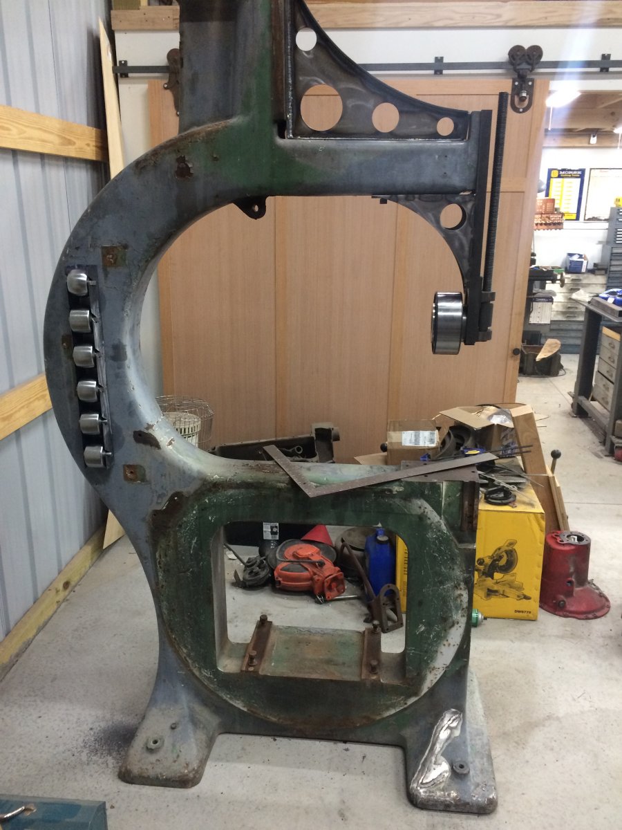

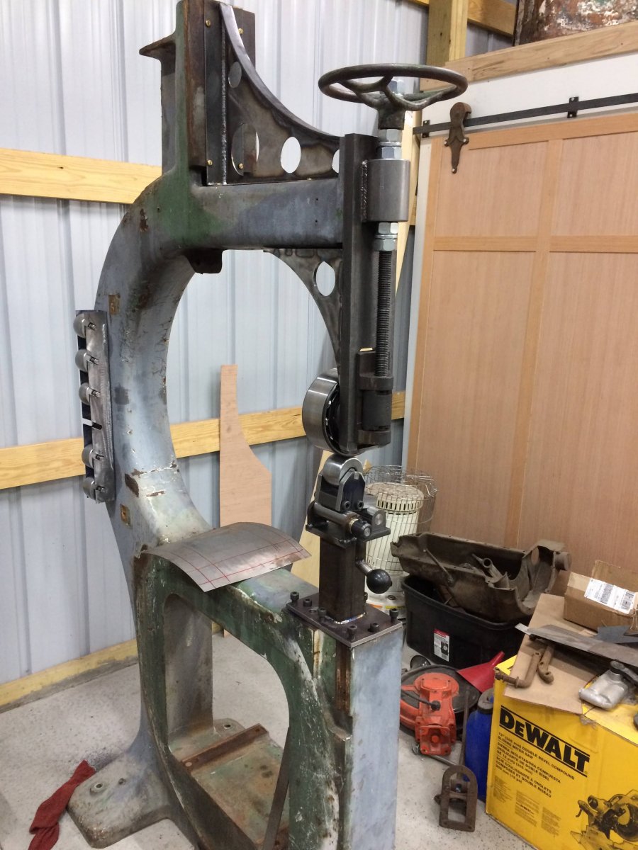

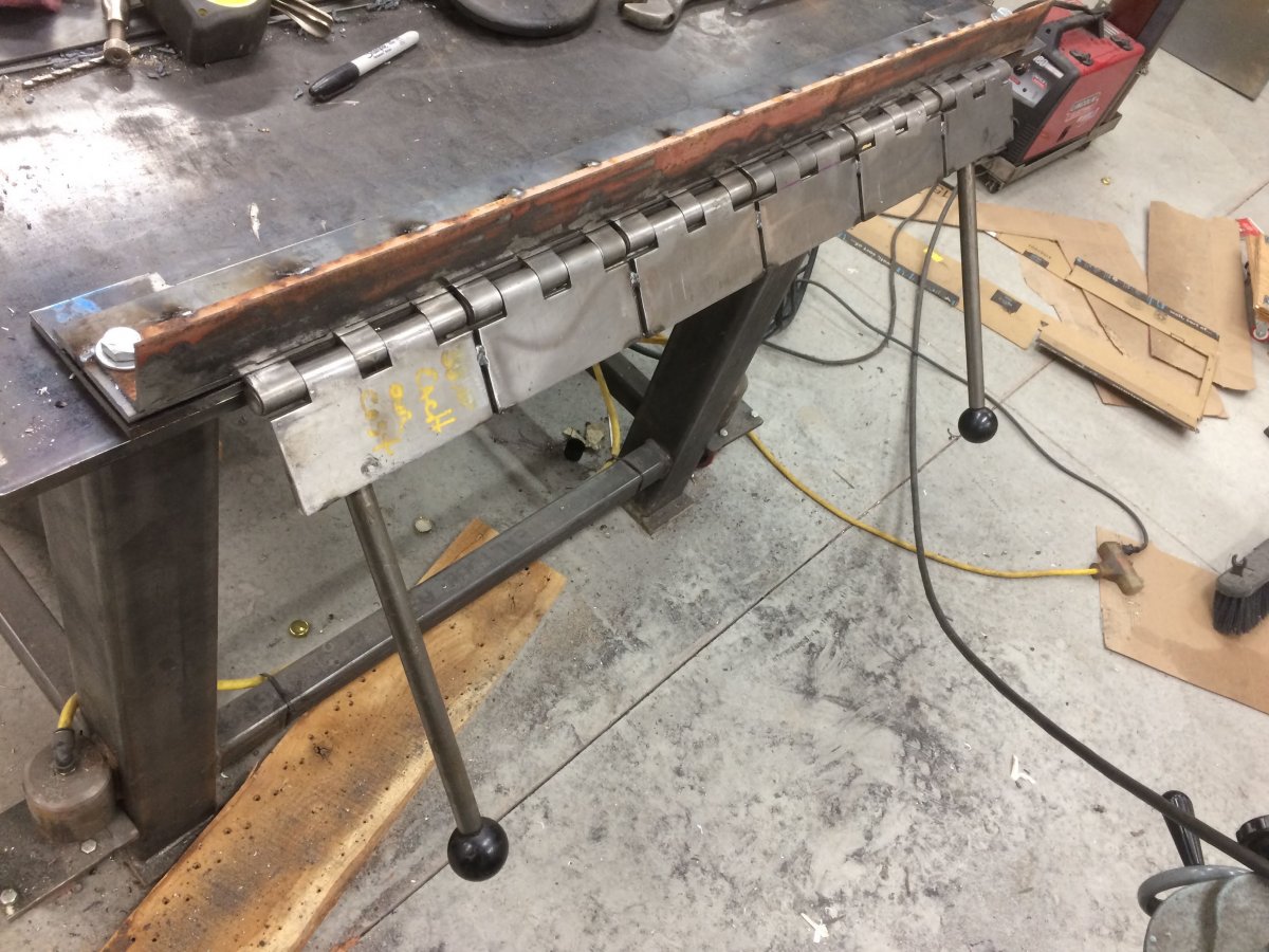

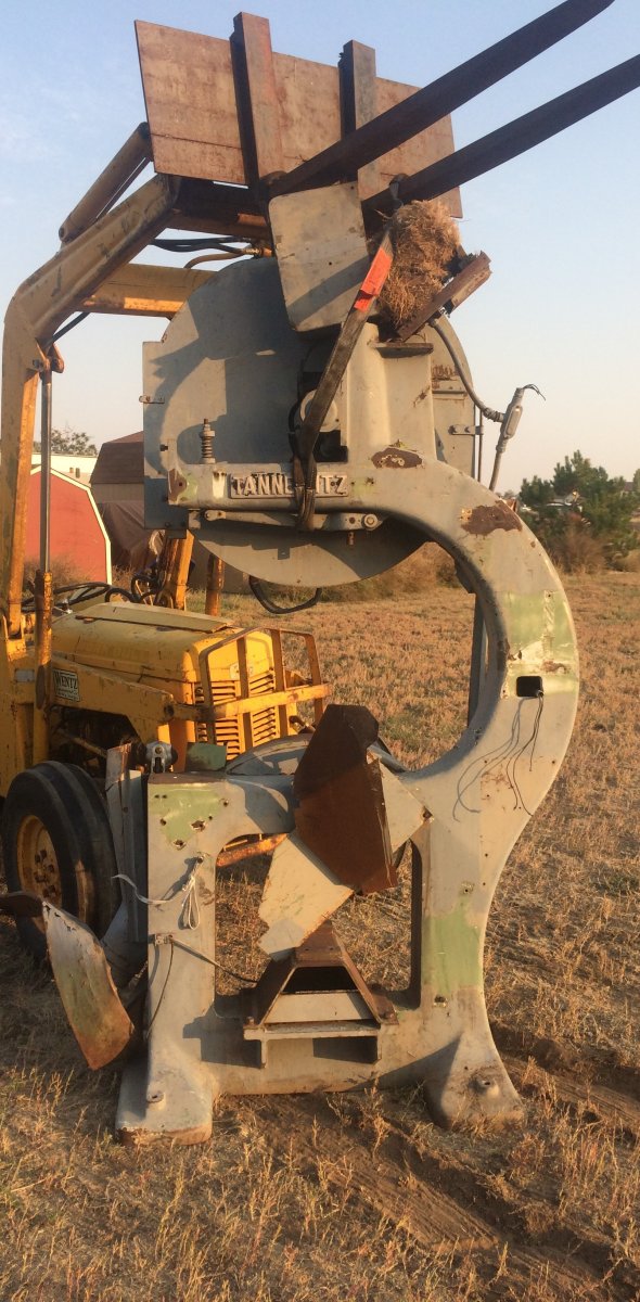

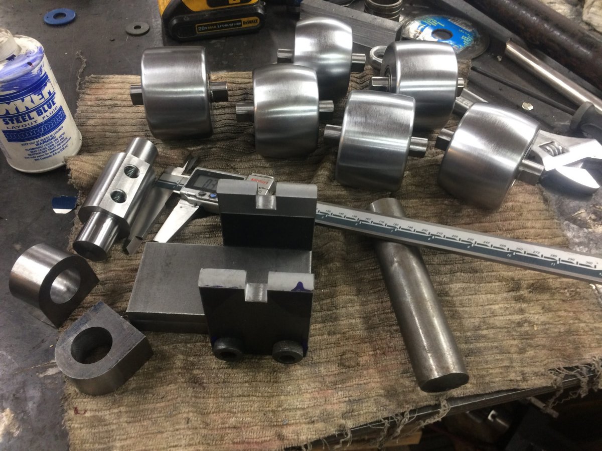

    english wheel. first i needed to make one, then i need to learn how to use it.
    I had bought from harbor frieght years ago some lower anvils. i dont think that you can get them anymore so it was lucky i did. i knew that i wanted to use the frame of a antique bandsaw. i just had to wait for one to come up. after a few years one did. it is insanely heavy, 1930's Tannewitz. the guy didnt want to put it in my truck. he was probably right. Hope this doesnt break the rules i know its not car stuff but i thought you guys would be interested. I plan on making the roof section
    . SFQT8997.jpg IMG_2003.jpg IMG_2077.jpg IMG_1999.jpg IMG_2244.jpg IMG_2220.jpg IMG_2328.jpg IMG_2329.jpg IMG_2327.jpg IMG_2078.jpg

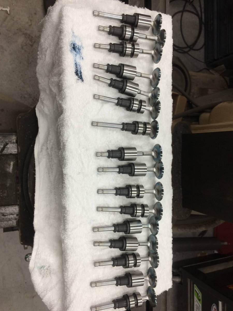

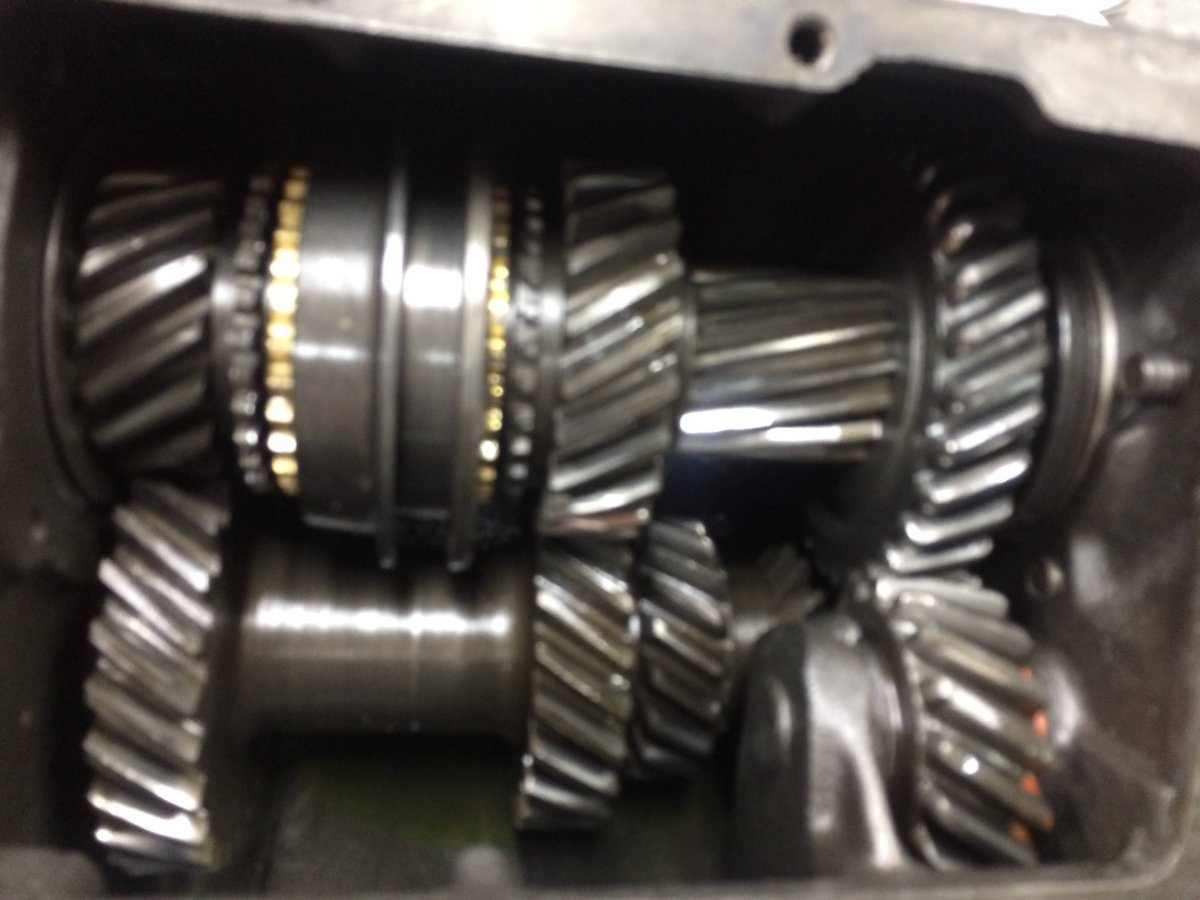

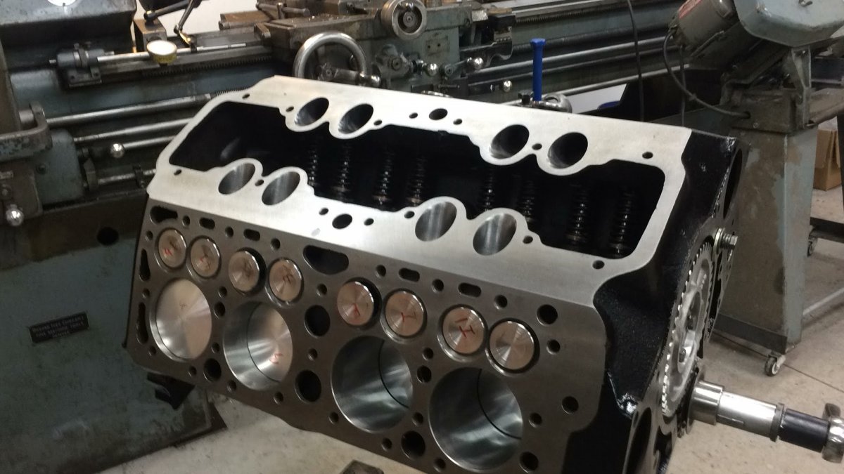

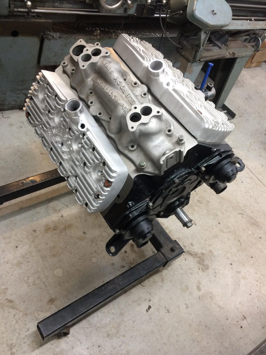

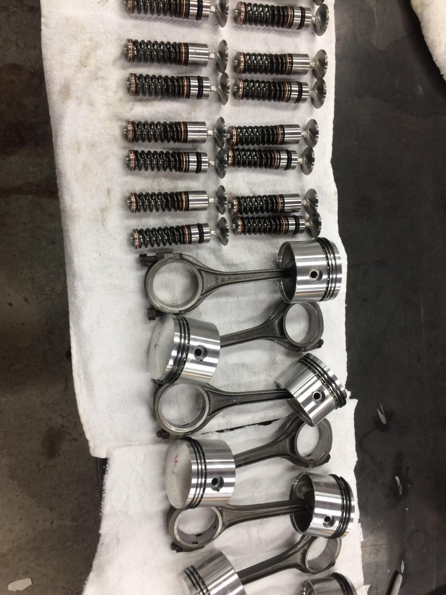

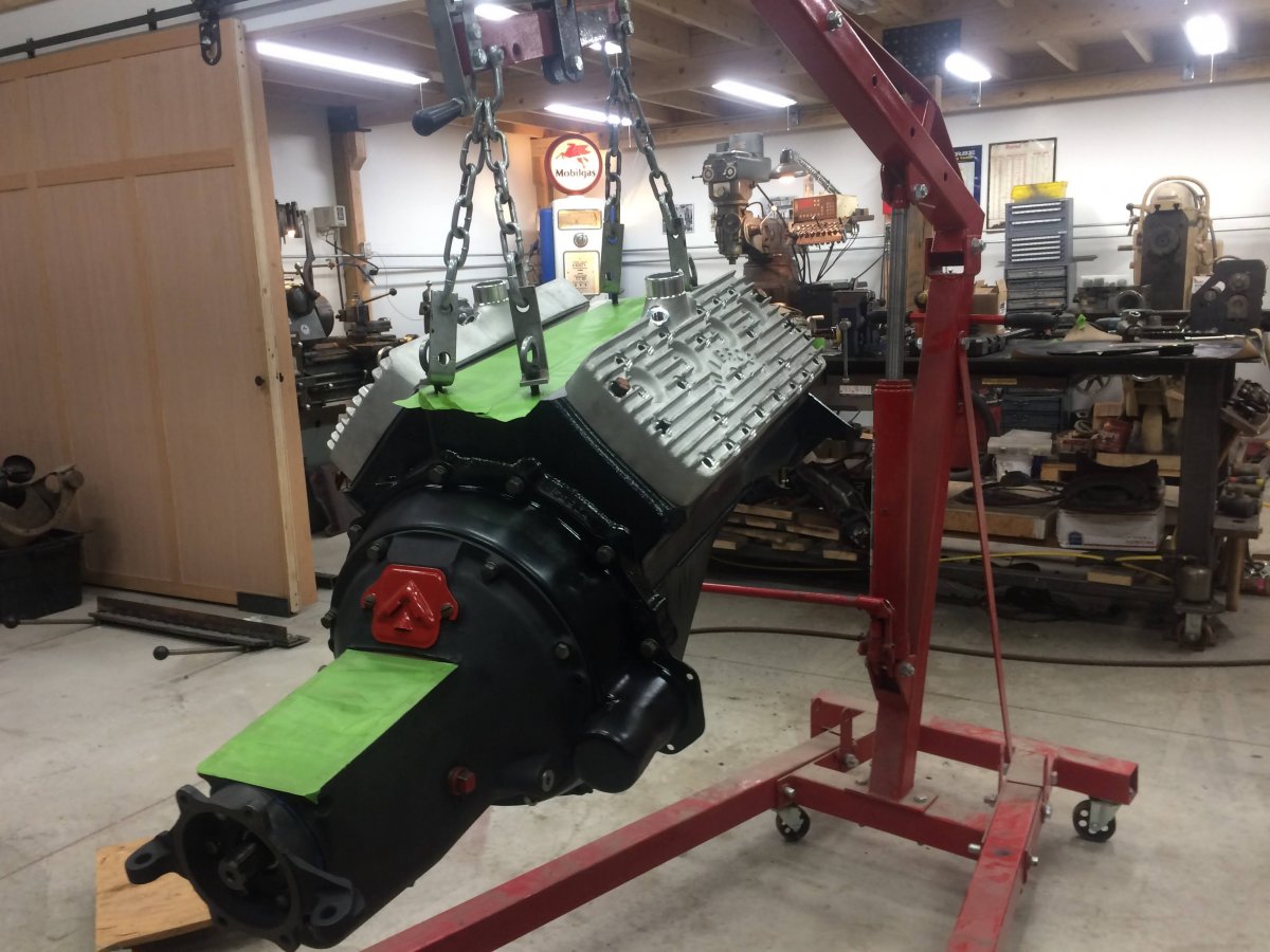

    Engine! So after the first core with cracks, the second with holes that was fully finished. the third block came back. it is a 8BA this time, specs: 3-5/16 Ross pistons, Merc 4" crank, 8BA rods, Harmon Collins 6372 (grind by Pete D&L absolutely incredible work!), old adjustable lifters (redone by Pete also), Fidenza flywheel (beautiful), edelbrock manifold and heads. I will build it like a earlier motor with crab dist. and earlier heads and manifold. All rotating parts have been balanced.
    First i built the gearbox i didnt get to many photos of this. I did machine o-ring grooves onto the main shaft and reverse idler shaft. That first picture i just included for fun, it went straight on the s**** pile.

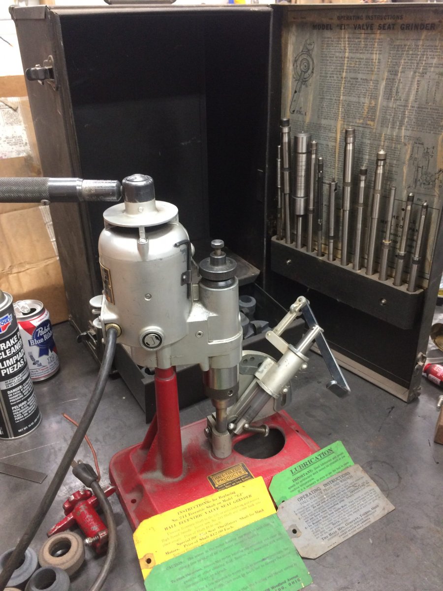

    I used this Hall to regrind the valve seats - this thing is amazing!
    ***embled the valves for each seat
    Then the pistons, rods and rings after gapping the rings.
    Heres the Cam.
    I ended up making a cam bearing tool to install the bearings.
    After grinding all the cast flashing and polishing the intake and exhaust ports. then thoroughly cleaning i painted it and ***embled it, i used Tardel/Bishop & Abbin books to get correct clearances and torque specs etc. I found that you really need both books for the job unless you know it all inside out which i dont.
    HVNX5525.jpg IMG_1686.jpg IMG_1692.jpg IMG_1745.jpg IMG_2340.jpg IMG_2341.jpg
    The new gasket sets come with a lip seal for around the crank snout. i made a new spacer out of ferralium which is pretty hard, you need a hard smooth surface for lipseal.
    the engine in car for first time. I have not run it yet, pineapple has run stand which we will do. I took many hours doing this, i was so nervous for this job and i am so glad that its done. i have so much into this engine i dont even want to think about it.
