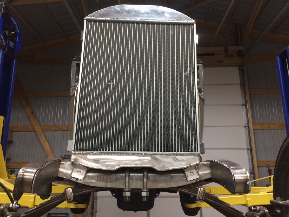

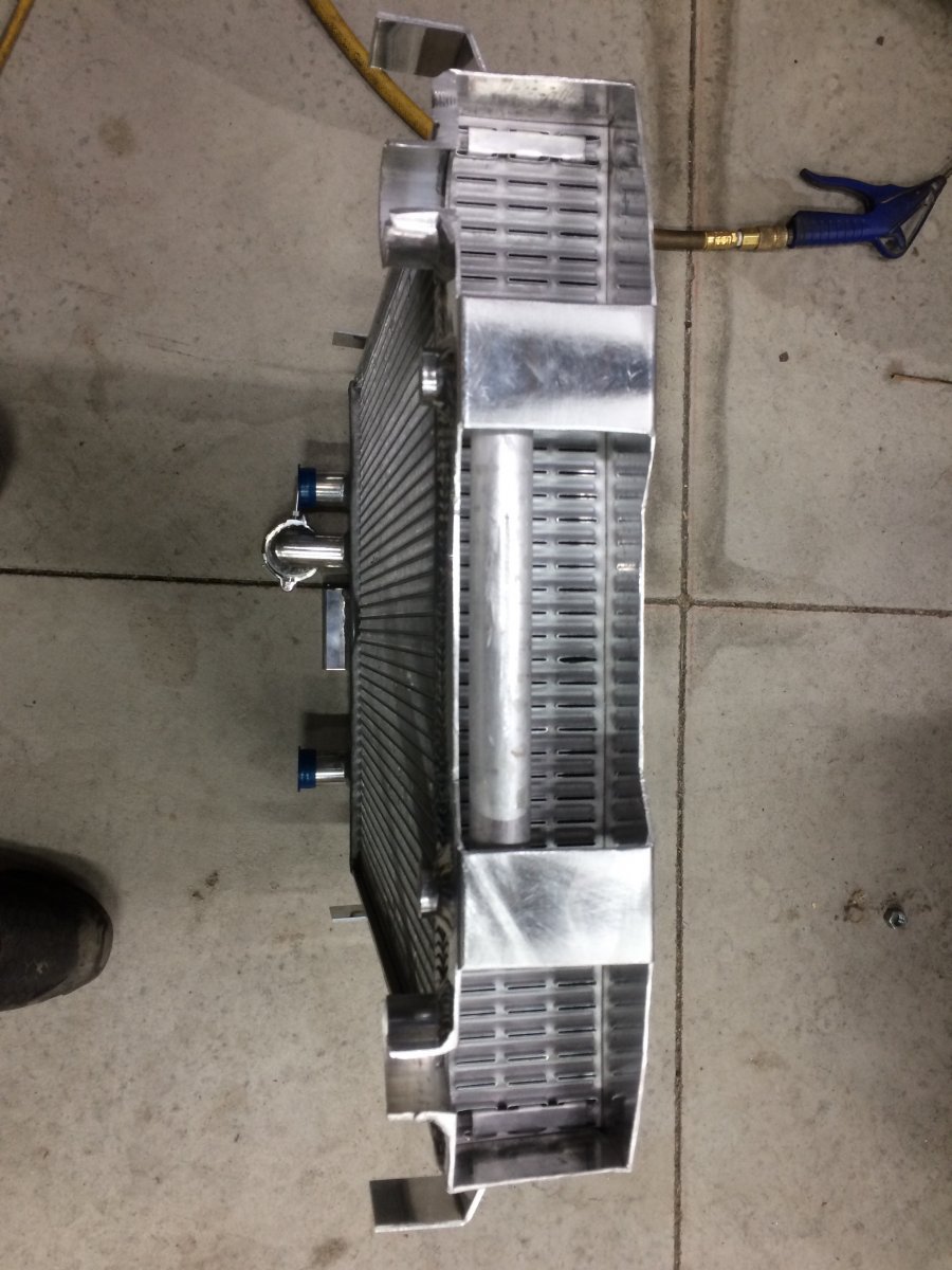

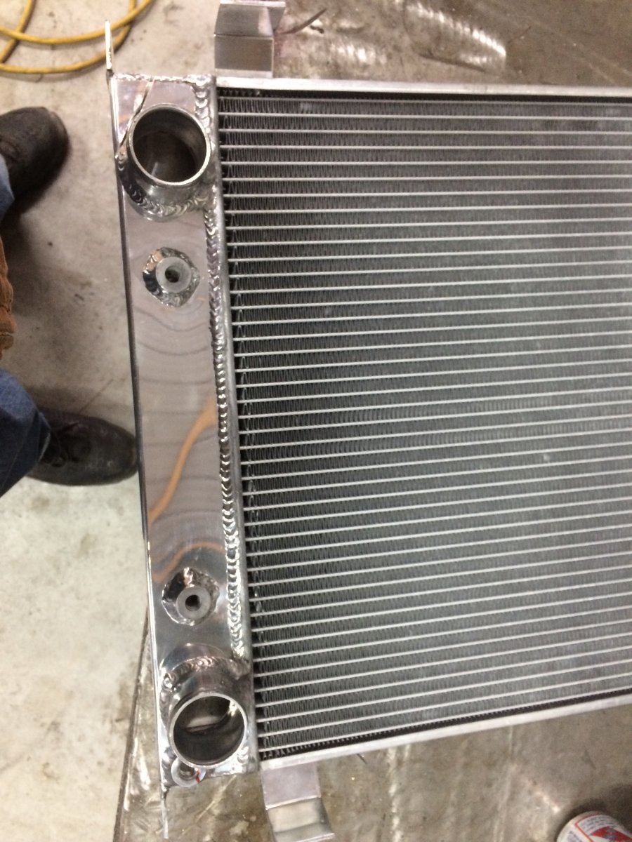

    This weeks work was on the radiator and headlights. I had bought a aluminium rad the closest height i could find that may work was a 25.5" one. Once i got i realised that it was still slightly too tall - with the grill shell on and it placed where i wanted it, it was about 2" too high. I am after a 1" drop on hood with 2" extension of hood, with a slight lean forward of grill. So i had to cut the bottom of the rad up and modify it.

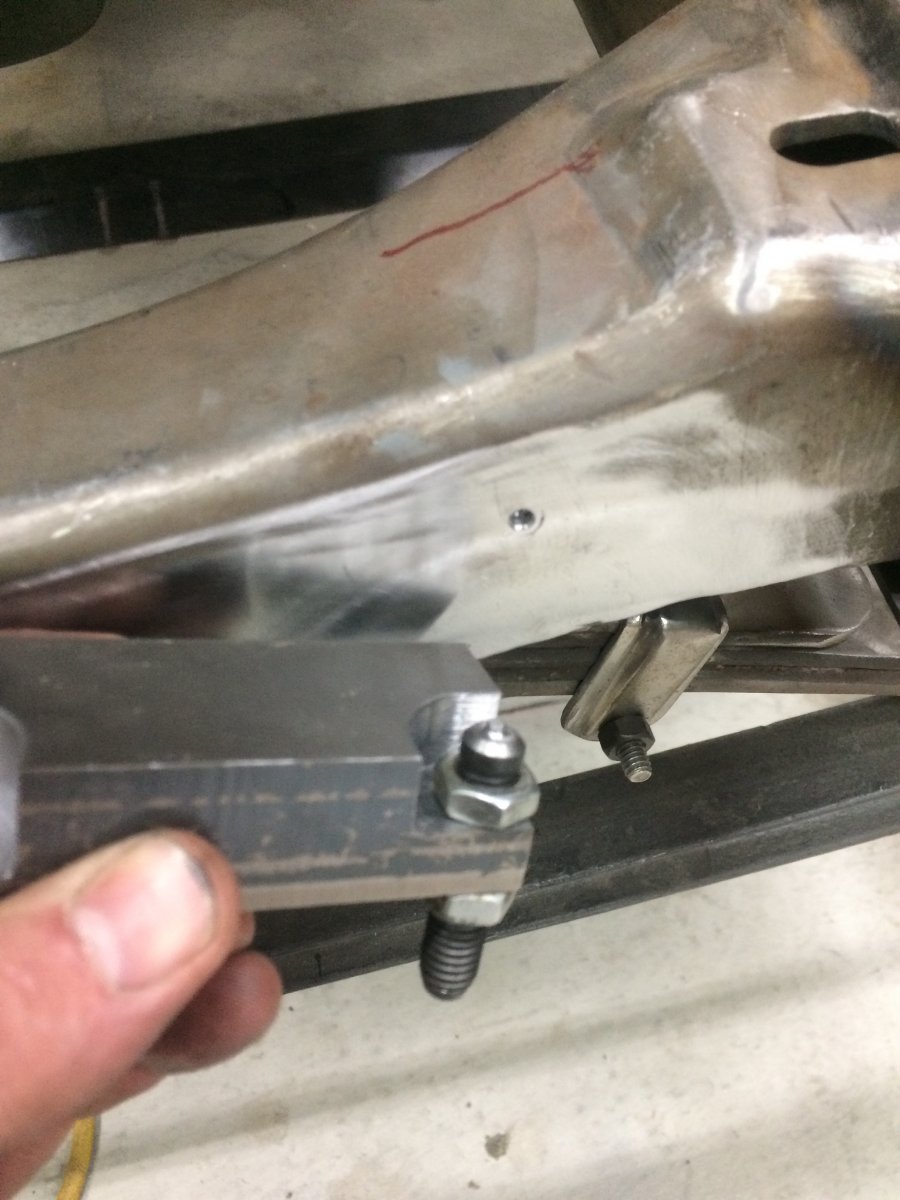

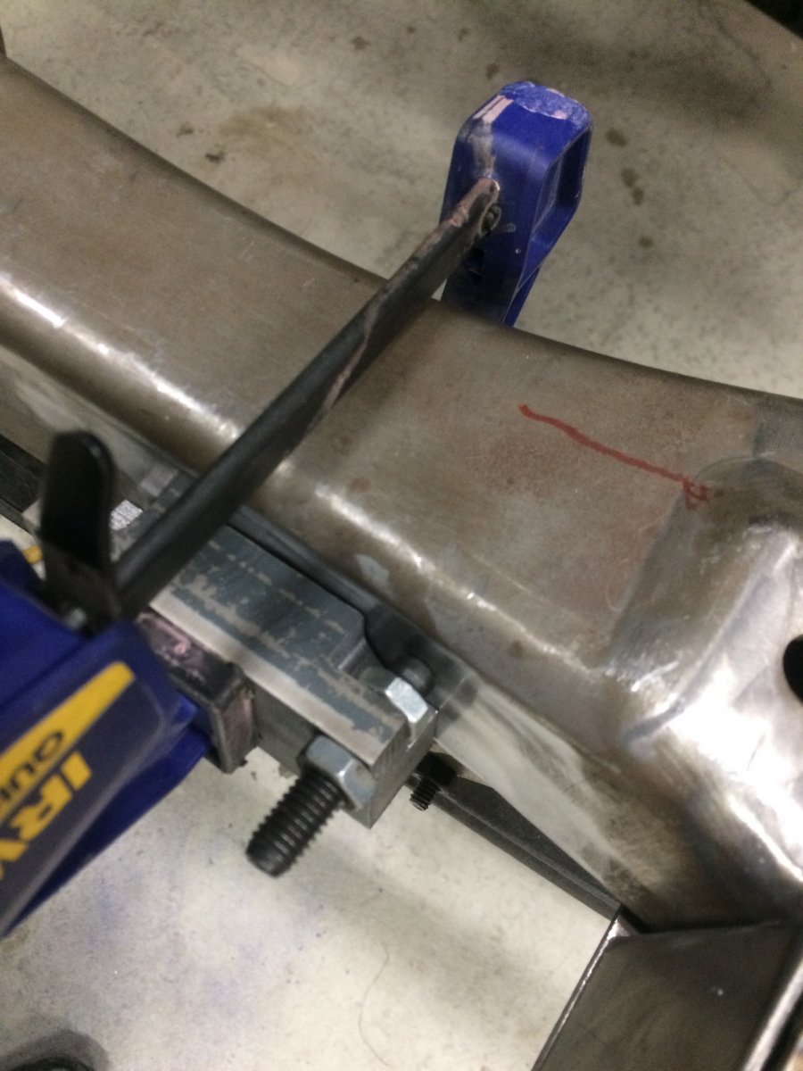

    I added mounting tabs on the bottom, then welded studs to the front cross member. To hold the stud straight in place whilst it was welded i drilled a small point to locate it and made a holder with access to weld.

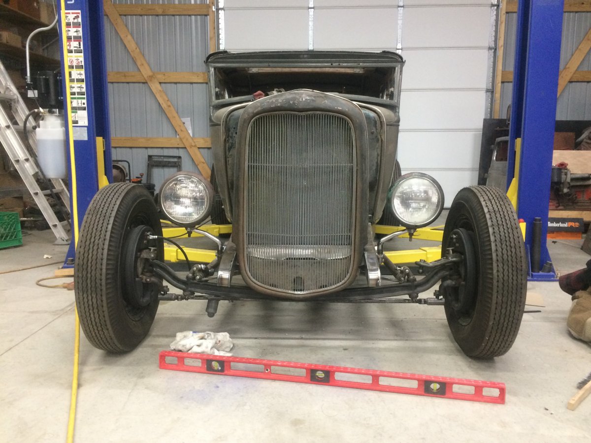

    Headlights brackets are bent F1 shock mounts with model A cups off a headlight bar. It was a nightmare getting them identical as i could, took a while! Healdlights are BLC 682.
    I also cut the frame horns shorter and boxed them in, i still havent finished welding them tho.

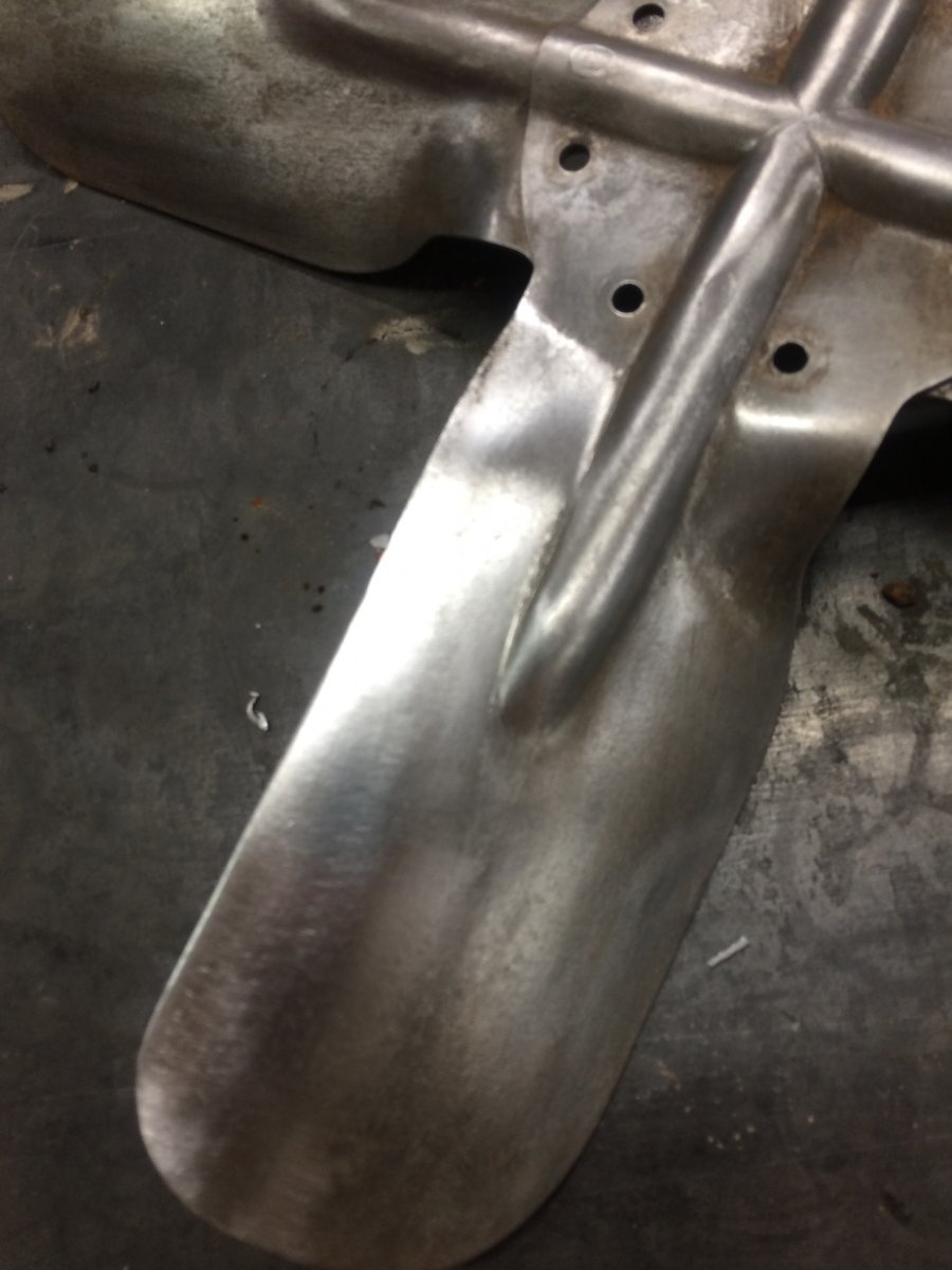

    Hi guys. This week i made a little progress on the car. Hopefully it will be ready to drive to Bonneville this year. I installed the studs, i wasnt looking forward to installing these i had bought Offy ones and i just wasnt sure if i liked the fit of them. With sone encouragement from Pineapple i did. Using #2 permatex in the block. I also wiped out the last threads in the heads by countersinking themm, now the plugs stick out nice.

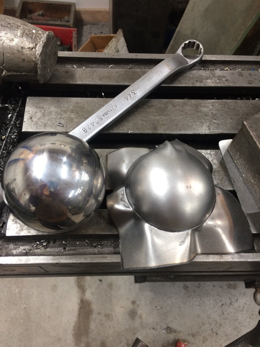

    Now i had a problem with firewall clearance and the manifold and fuel pump/oil filler. I got these big ballz this one is 3" using a press and a pipe with just over 3" i pressed a sheet of 18ga between and got this nice hemisphere, welded into a hole in the fire wall.

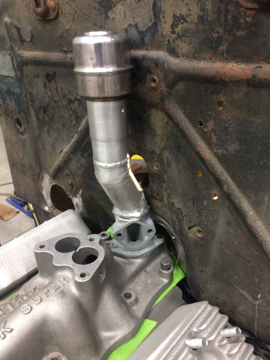

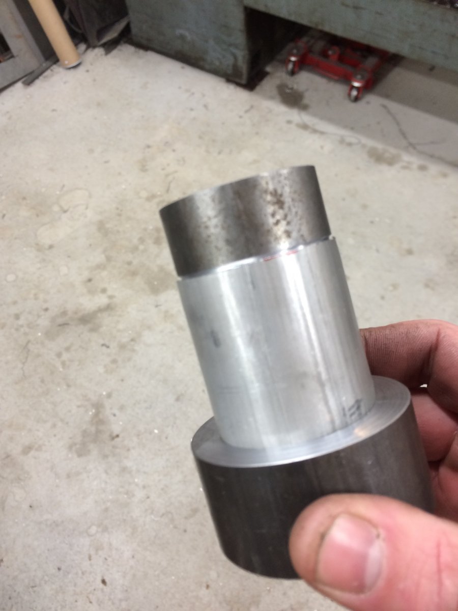

    to make the oil fill work i needed to make a offset pipe. I used welded aluminium 1 3/4 pipe, i needed to flare it so the fill cap would fit. I made a tapered pipe and pressed it in it worked really good. Then to make the dimples in the top i made another little tool with slots for the inside, with a coller on the outside and screwed in a rounded bolt which worked good also! pretty pleased with it, but these small little things take so long to do!

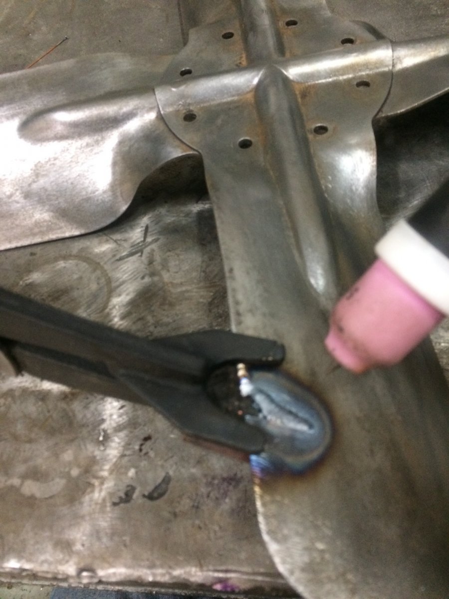

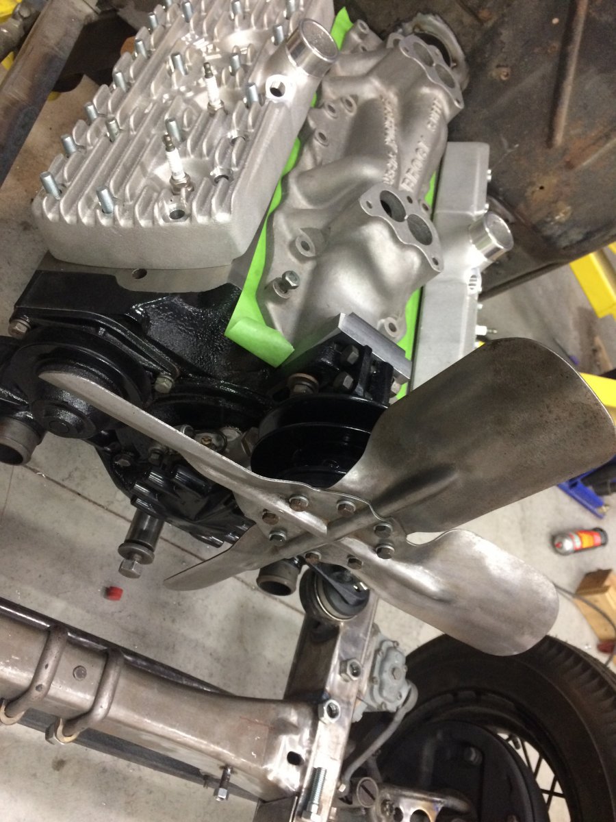

    also rebuilt and painted a oil filled fan, the fan had a big gouge in it so welded it up first. the vice grips that are on it are really neat they have a copper anvil on the bottom so they are great for welding in thin air.

    that oil filler pipe trick is awesome! Fantastic work as usual my friend.

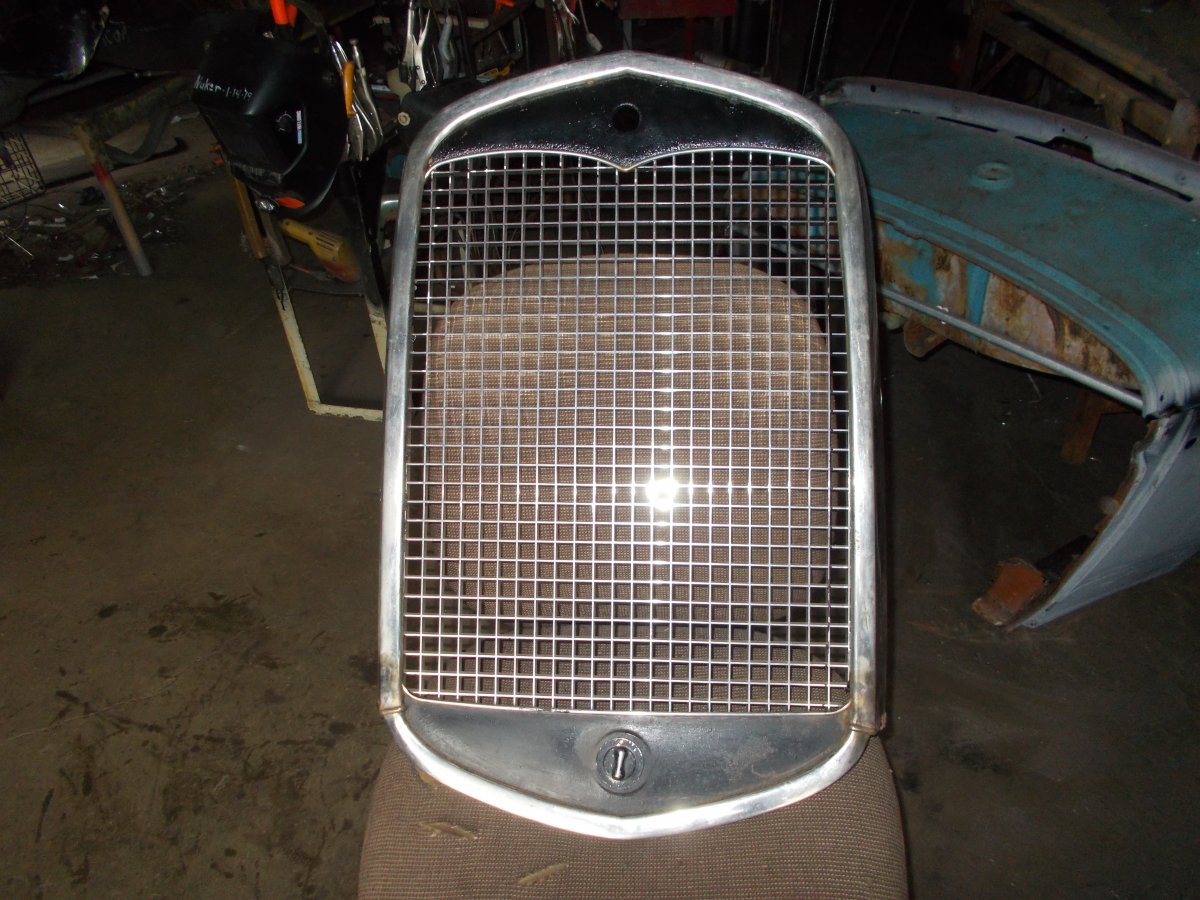

    Ordered a 3" chopped thursday, the '32 frame raises 1.5" from the cowl to the radiator...
    the A body did not, so the stock A radiator is 1.5" too tall... couldn't find a 1.5 or a 2" chopped...
    also the lower pans are like willows, just flat, he fixed his nicely...
    figure the extra chop should keep me from having to fix mine...
    the tanks will show, but a flat black the face and the use of a blacked out 4' fluerescent light defusers
    [small plastic squares] they hide the tanks and the pattern blends with a radiator..
    pix ; top unpainted, middle and painted bottom installed DSCN5458.JPG DSCN1073.JPG DSCN4376.JPG

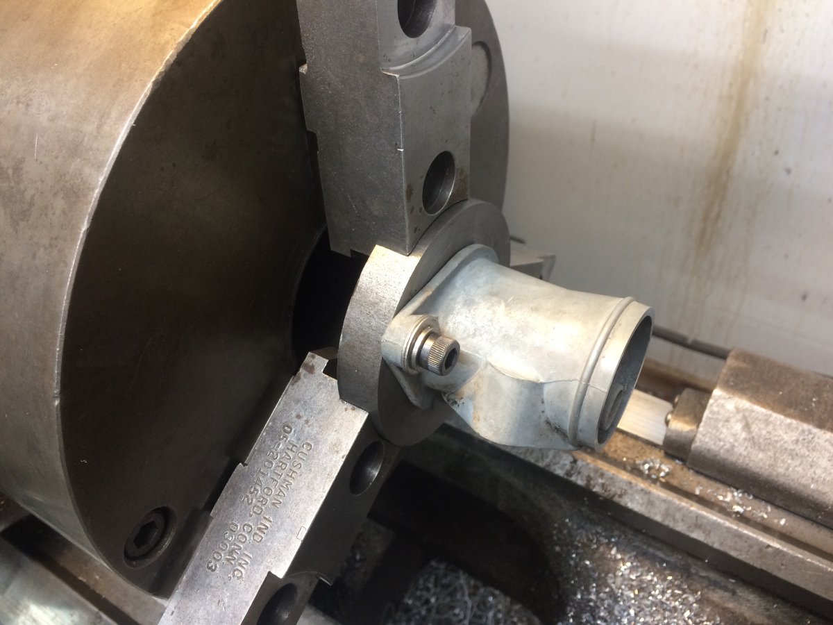

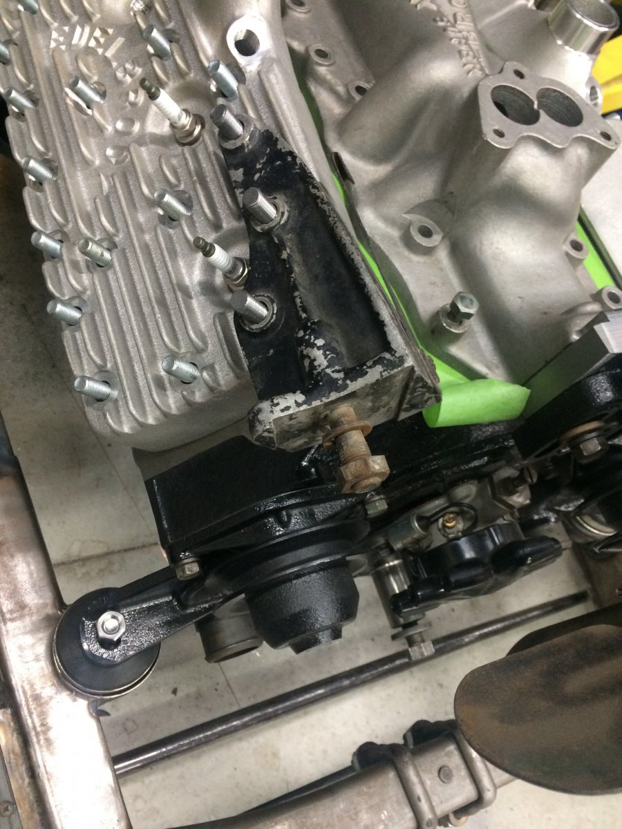

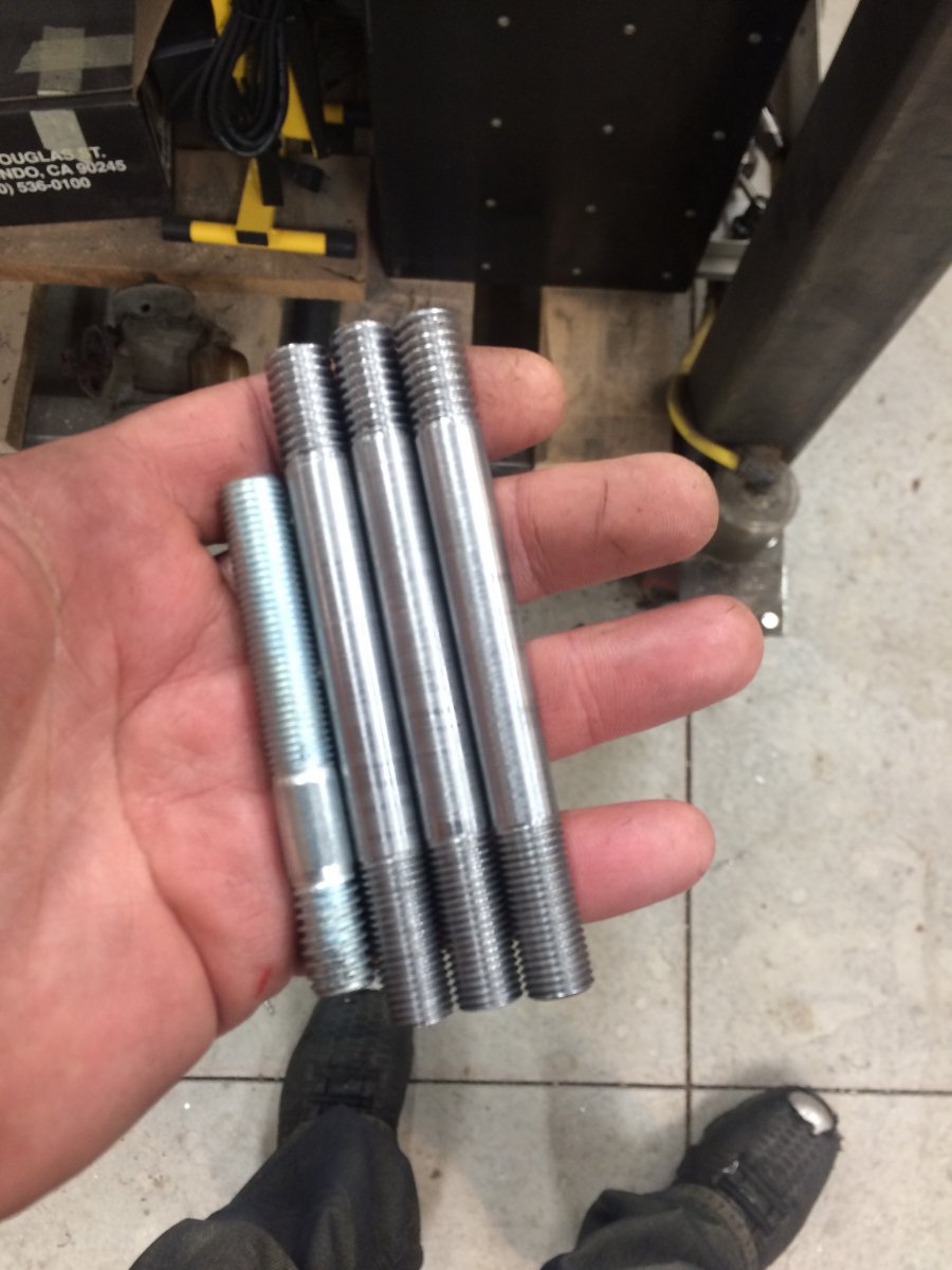

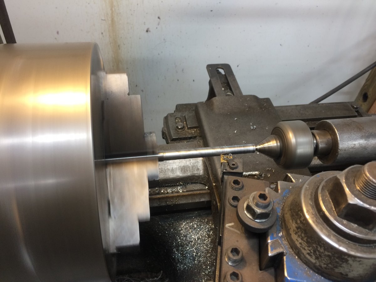

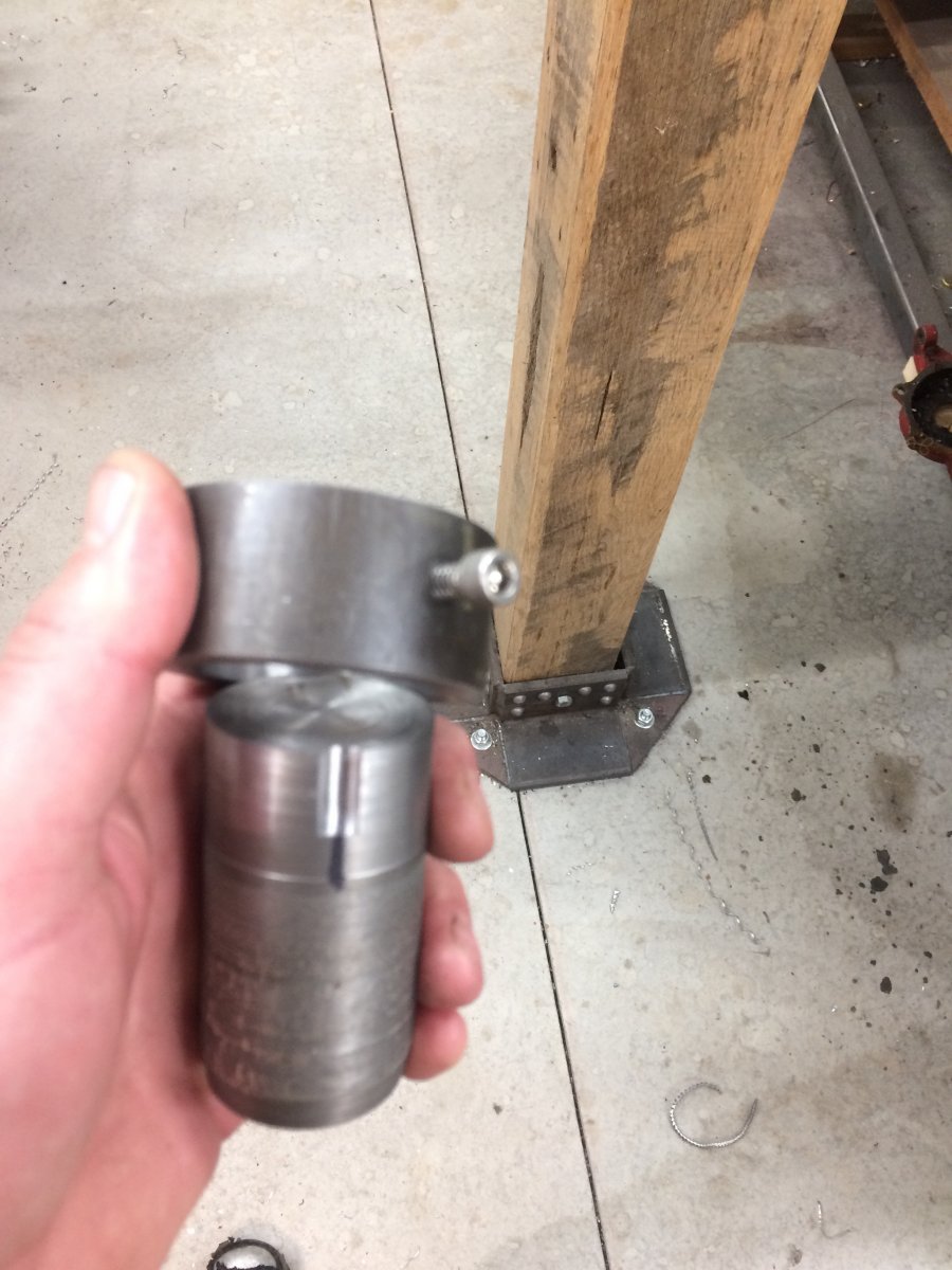

    Today i made some longer studs to use an offset gen mount. I was going to buy some but the ones i had seen were just 7/16-14 all thread. I didnt have any 7/16 crs to hand but some 1/2" so turned it down to a bit under - .431. I then adjusted the die so it was a real nice fit into the block. I had thought that the offy ones i had bought were a bit loose. I wish i had made the shorter ones too although 45 more didnt sound so fun.

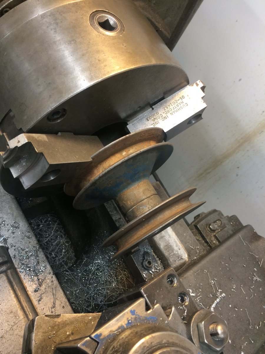

    I did also cut the hub down on the bottom pulley to line up the belts.

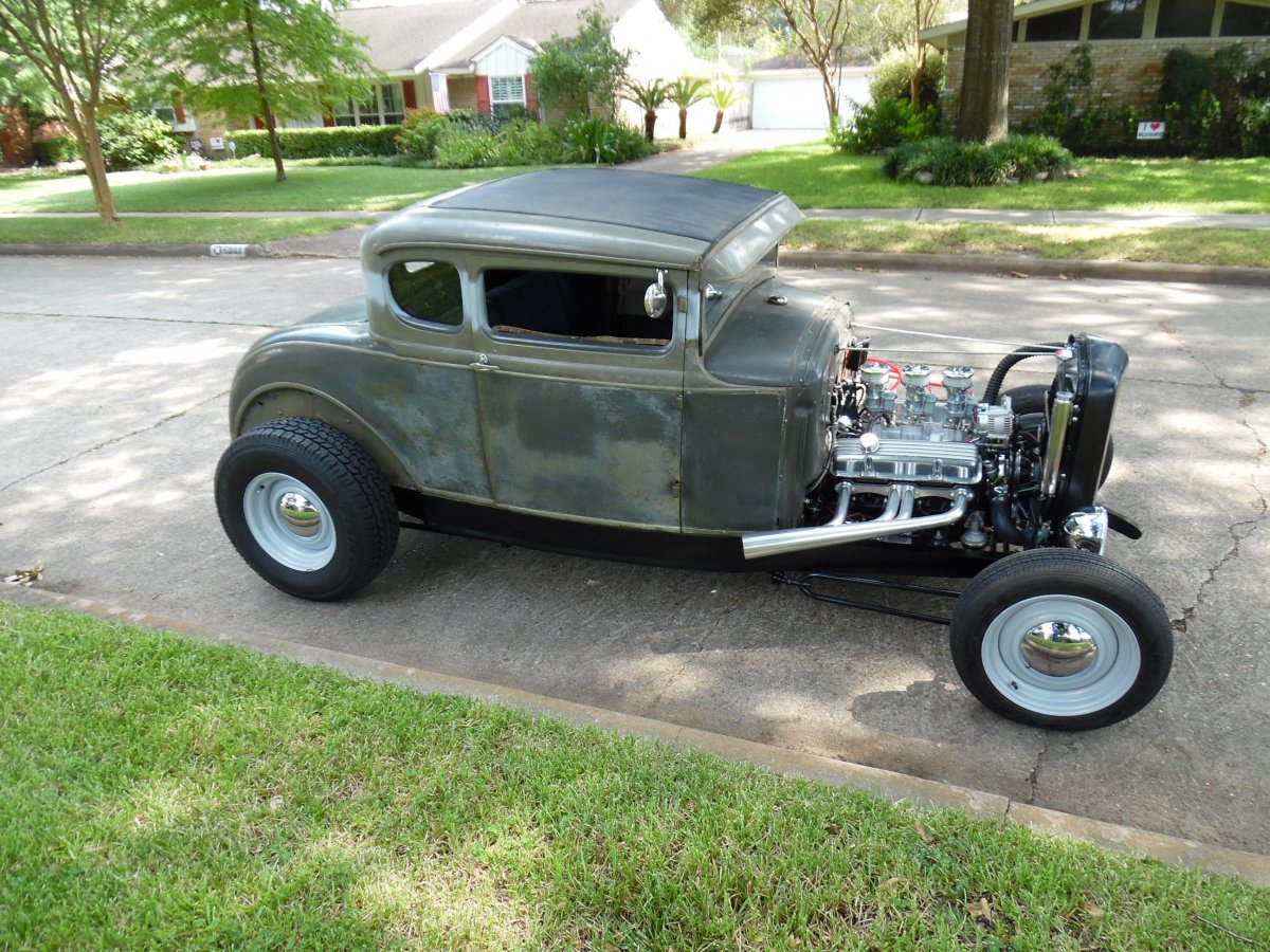

  26. m.ralph
    Joined: Nov 6, 2009
    Posts: 540
    m.ralph
    Hi Alan, here's mine 30 Coupe that I built a couple years ago. Before and after.
    alanp561 and Willows like this.
