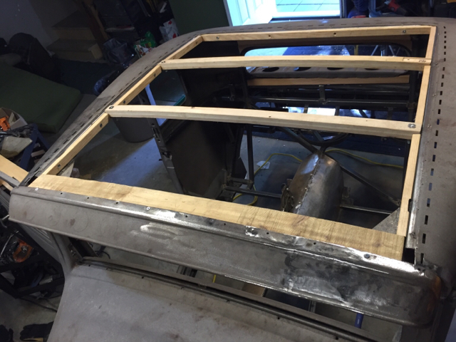

    The original material used typically was whatever was available, oak, ash, they were not particularly loyal to any one species. The brochures I read always just said "hardwood", I wanted something reasonably affordable which I assumed was their criteria as well! The material I took out of mine was softer although 50 years in a field might do that to ya'.

    More wood work this weekend.

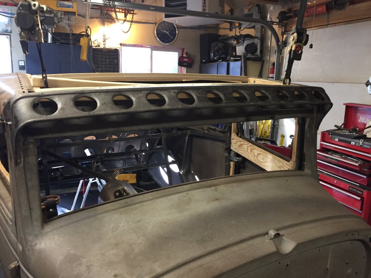

    And now if it rains and I had a windshield I could clean it.

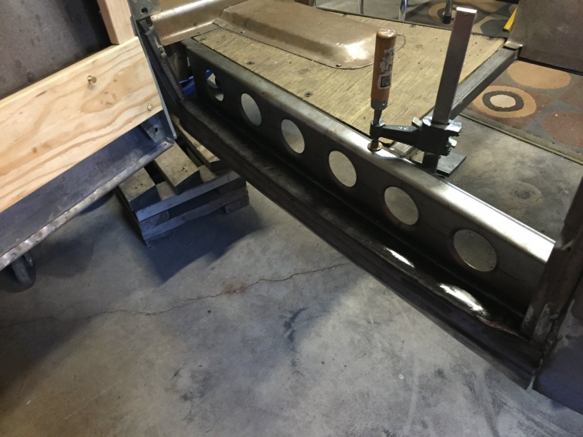

    New fender well installed sure does stiffen up the back quarter panels.

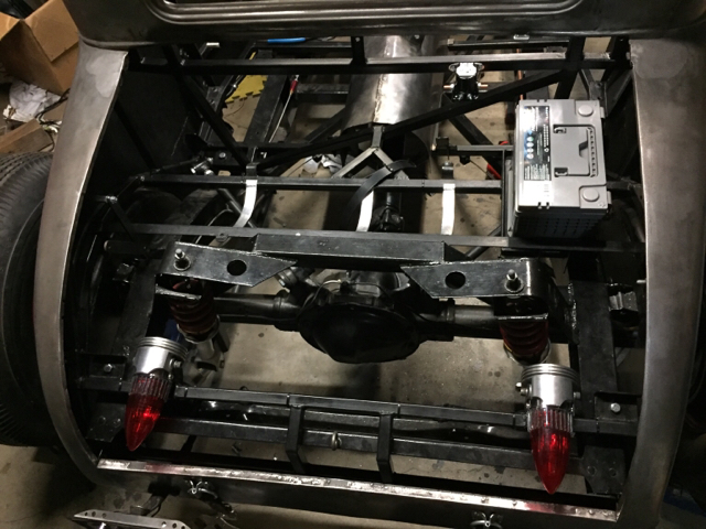

    So I had this idea that the Caddy taillights would poke out through the rear trunk. Had kind of a quasi-frenched in look. Unfortunately they struck out so far I couldn't open the trunk and so modification time. I had to pull the tail lights back 1 3/4" to clear the trunk.
    Mounting bracket Before
    After
    Plus I got to use up those two extra Pistons I had!

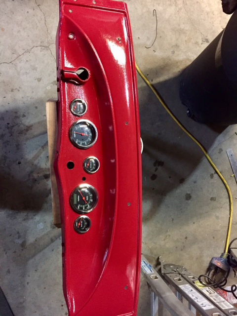

    Festive dash colors.
    Stogy, T-roaster and loudbang like this.

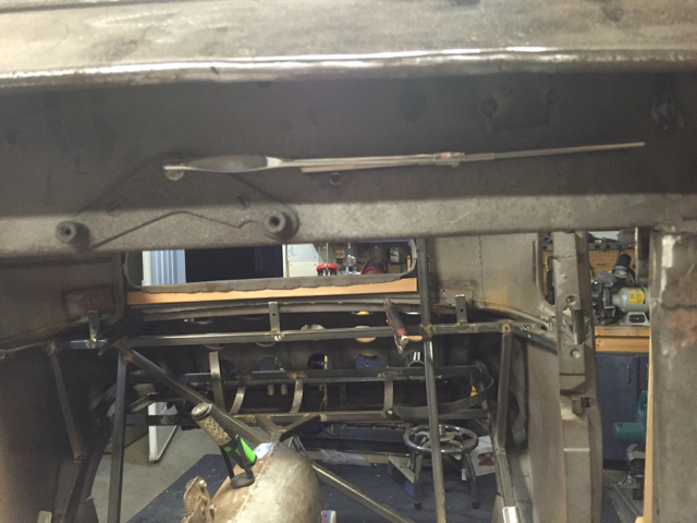

    I have an issue where the only reasonable route to the bottom of the radiator was through the frame. Basically the Axle gets in the way. So I tried to restrain and protect it best I could.
    And that took up a weekend!

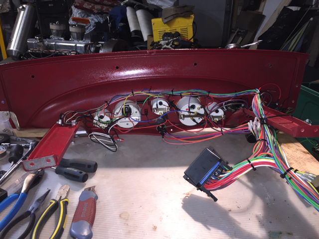

    Didn't follow the instructions very well step 1 was install the fuse box. But then step 2 would be lay on your back for 3 days wiring the dash so I did this instead, hope it doesn't bite me in the ass later.

    I think I've spent $500 in wire and connections! Picking up new custom battery cable tonight.
    Remote trunk battery means another solenoid required to avoid the live 1/0 cable running thru the chassis waiting to start a fire.

    Battery secured and looking very non de script after the cover installed in the end.
    Spoke with my local starter and alternator shop and they talked me into a Northstar battery, pretty good warranty, said they were as good or better than Odyssey?

    Battery posts on the side?
