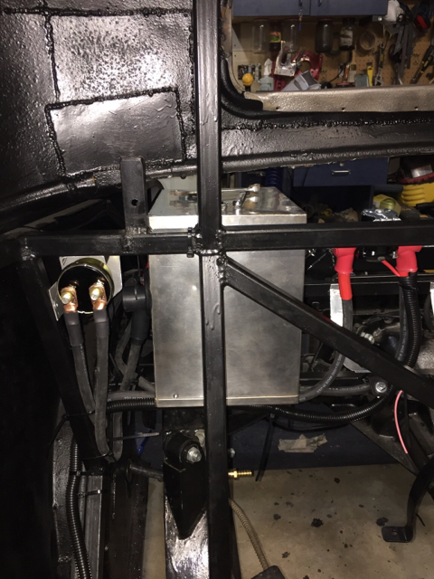

    Thanks they were a leather belt in a former life! Yes the posts are on the inside. Wired to a hidden kill switch and the remote solenoid so I didn't figure I needed much access I'm hoping I can boost off the solenoid if necessary.
