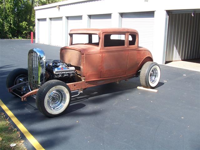

    ze fenders are too nice! keep them on!
  2. 66miles99
    Joined: Sep 14, 2010
    Posts: 295
    66miles99
    from Canada
    I'm not sure really where the fender debate started but...they are off...and not going back on :)
    Sorry to disappoint.
    kiwijeff likes this.
  3. Haha! It started with that full-Fendered badass photochop you posted!
    Oh and in case you haven't noticed, we are happy to offer our opinions whether you want them or not.:D

    OK OK. But try to leave the hood top.:)
  5. I agree, big chop ditch the fenders. Small chop keep the fenders!

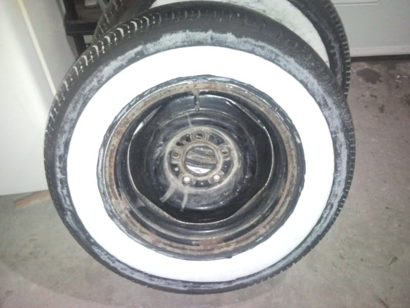

    So I tried a diy project, make your own whitewalls. Well not make em really more like uncover em, its interesting that most whitewalls today still have about a 2" wide strip despite it being only a 3/4" strip visible. Just apply a 4" grinder and voila.
    Just need to clean them up a bit. 1/2 hour invested.

    I'd dump the fenders too...fenders look cool on chopped sedans...not so much on a coupe, IMO

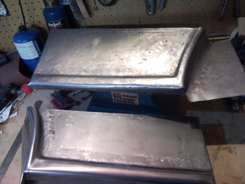

    Frame went into sandblaster yesterday to get cleaned up, 50 years in some field will do that to you. Also undertook some metallurgy today..I suck...trying to craft this
    to repair this.
    I got the idea that all this was possible from posts on here, who knows with another couple of hours invested maybe it will look alright? Or I'll try something else.
  22. That's looking good! A little planishing and she'll come up a treat!

    Will see...I'm hoping I can smooth it out quite a bit yet.

    I think I'm getting better. 10 more and maybe it will be perfect.
    It's a lot harder than I thought it would be to get it to look right. I want to try to get some of the body work done while the frame is gone and I have the extra space but 2 full nights and all I have is 2 small panels that I'm not to thrilled about.

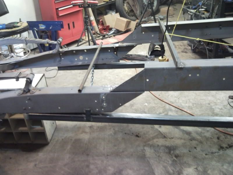

    So task at hand today, section frame. With it being 6 Deep it seemed like that would be the easiest amount to z the frame.
    Spent a lot of time making sure it would remain square after it was cut...to my surprise it worked...

    Thats a really good idea! I never thought of doing it like that. Keep the pics posted. Its coming out great:p
