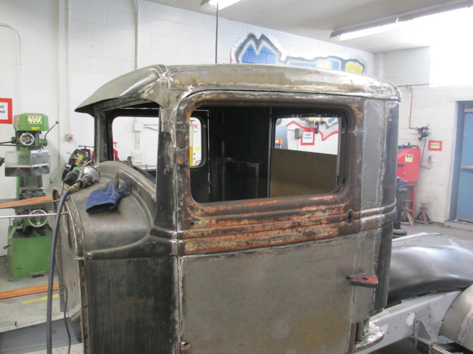

    That truck looks great Wild Turkey. I'll bet a guy who's good with a mig could do that with a steel cab pretty easy. There's your blueprint folks!

    I am 5'7" - 165 lbs and was really concerned about how small the cab seemed to me - cant imagine how you big guys are fitting in there at all. Struggled with what to do for awhile - them decided to cut it up.
    The cab was pushed back 2" on the frame, the firewall straightened out, and the door jambs spread in order to flush mount doors. With the 4" extension behind the door it adds up to a 6.5" extension in the roof. Now that there was more room for seats I could chop it 3" and still fit seats that let me reach the pedals properely.
