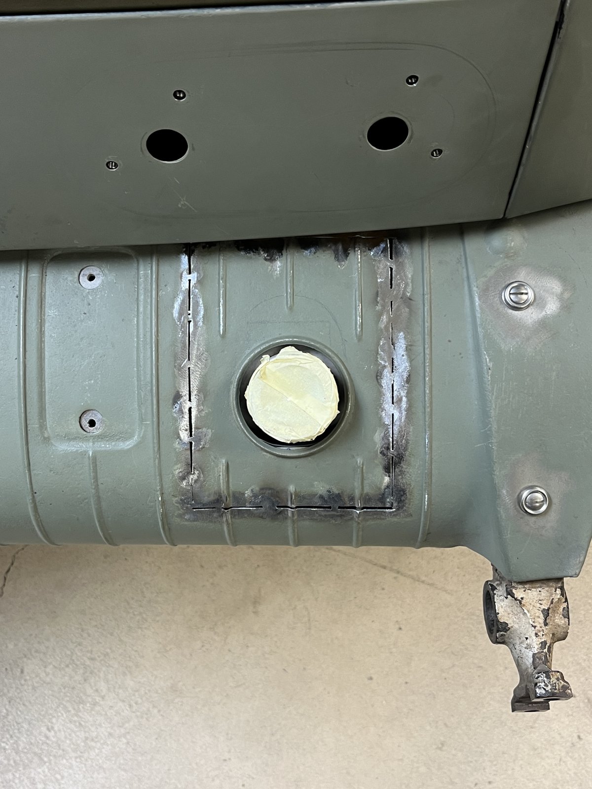

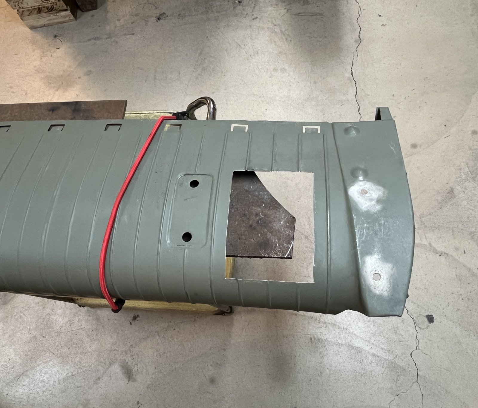

  9. 31 B'ville
    Joined: Feb 7, 2009
    Posts: 423
    31 B'ville
    from SE Pa

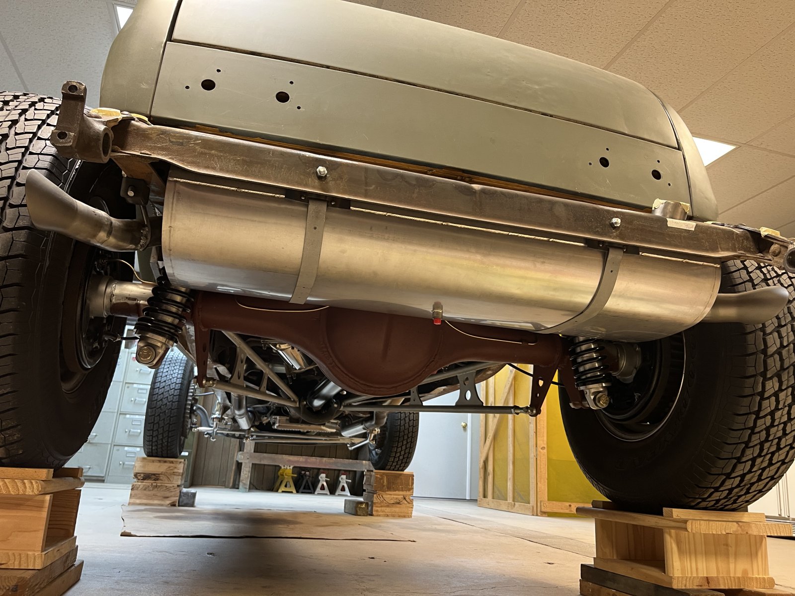

    7D8299EA-82B1-4AF9-A376-95223ADC0CD5.jpeg 308AD6A3-1370-4ECB-9929-F910BA7A1881.jpeg D737974C-FD8E-421C-A2D6-56EA2B13C259.jpeg DEBEA85F-E069-4DF6-98E4-97BE22C3E1BE.jpeg E4C2E4AB-AD88-4502-ABD6-9CAB8C9DA06C.jpeg I received the new gas tank and even though the dimensions matched my original tank it didn’t fit exactly the same way. The upper tank supports on the frame had to be trimmed and reshaped and the filler stub did not line up with the original hole in the tank cover.
    With the new tank mounted, my brother relocated the hole in the tank cover.

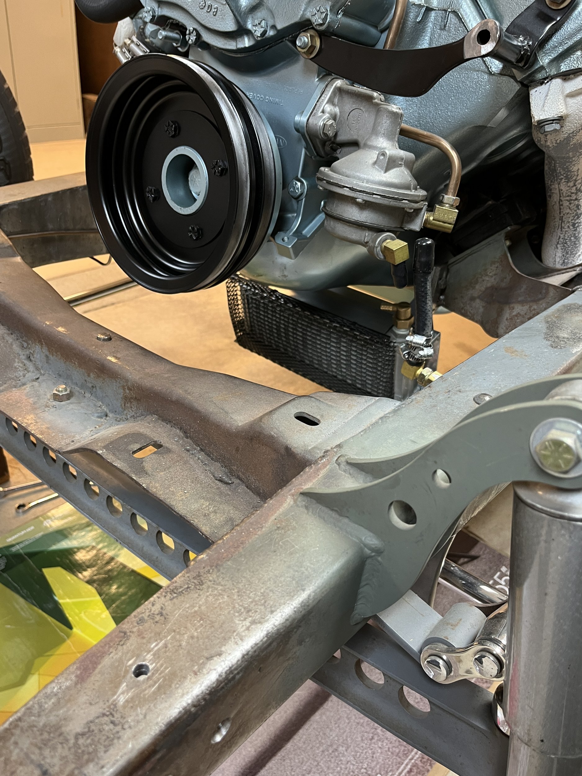

  14. 31 B'ville
    Joined: Feb 7, 2009
    Posts: 423
    31 B'ville
    from SE Pa
    Air cleaners are (were) 4 7/32” reproduction Corvette and SD Pontiac. Carbs are Carter 500s which are 5 1/8”, so my brother trimmed the bases larger and made aluminum spacers to match the carbs. Not sure, but I don’t think anyone makes that air cleaner to fit the larger carbs. IMG_7520.jpeg IMG_7521.jpeg

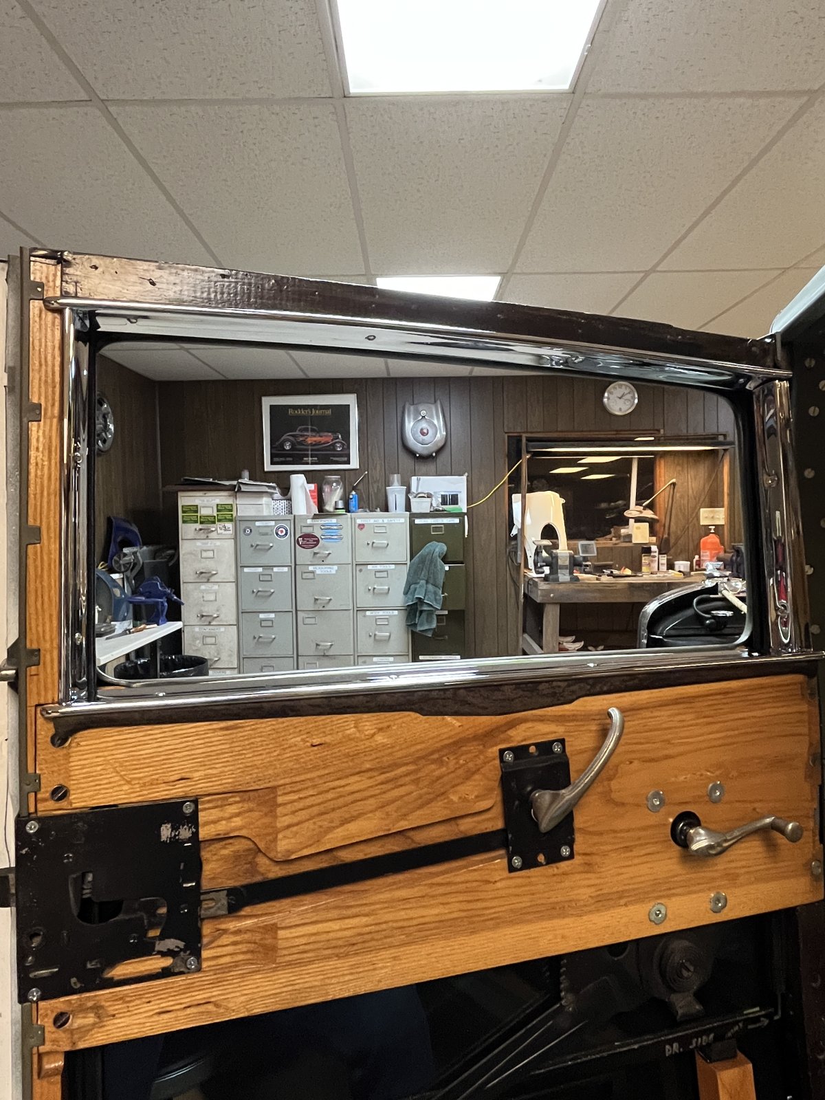

    IMG_7739.jpeg IMG_8070.jpeg IMG_8011.jpeg IMG_8075.jpeg All of the gl*** is cut (I chose the old green “E-Z Eye” tint) and all but the windshield are installed along with the garnish moldings

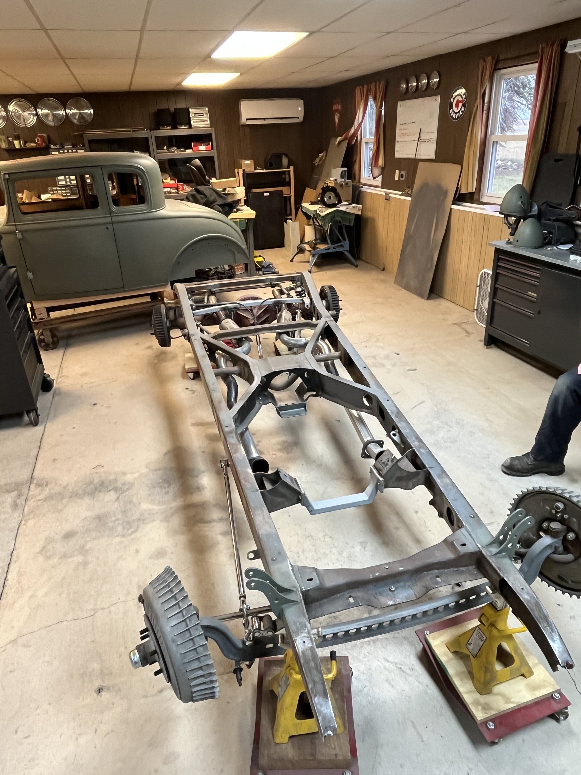

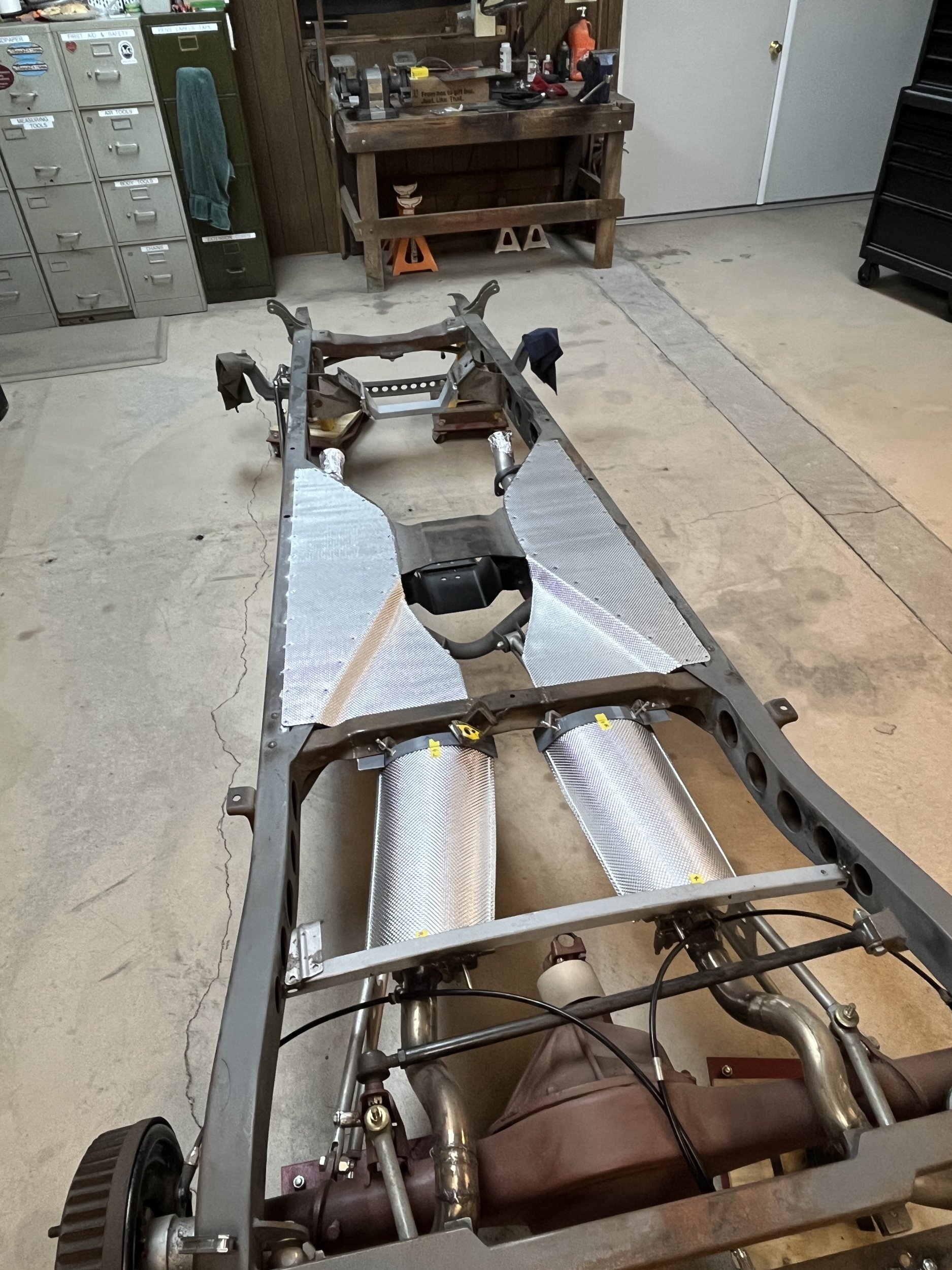

  23. 31 B'ville
    Joined: Feb 7, 2009
    Posts: 423
    31 B'ville
    from SE Pa

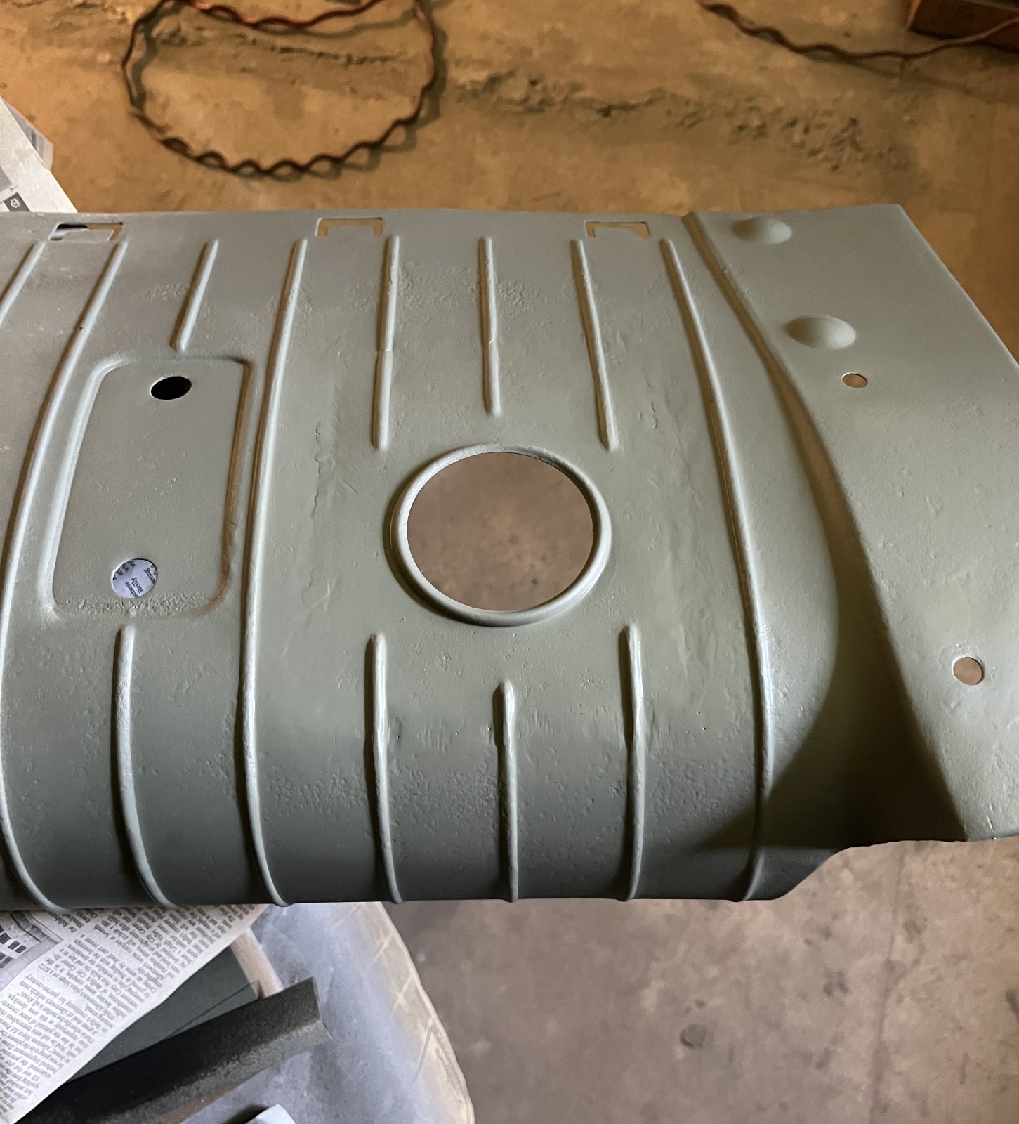

    IMG_8790.jpeg IMG_8848.jpeg IMG_8881.jpeg IMG_8900.jpeg IMG_8901.jpeg IMG_8984.jpeg I used a Mini ( early 1960s ) oil cooler for a transmission fluid cooler and coated the floor and firewall with 3 coats of ATAC paint from DEI. With the body removed from the frame I made heat shields from embossed aluminum to further keep exhaust heat from reaching the interior. Dis***embly continues to prep the frame and then the body for paint.

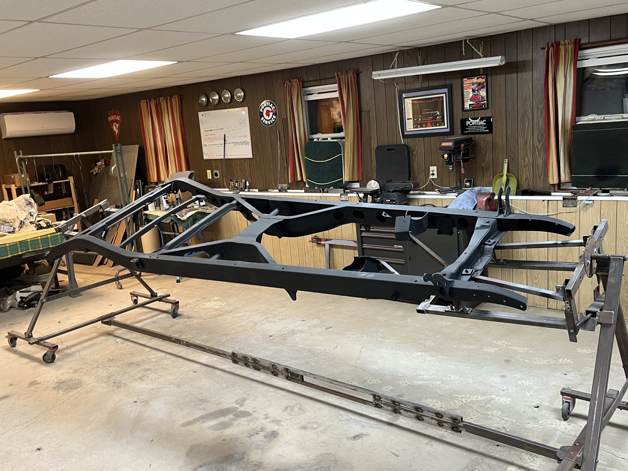

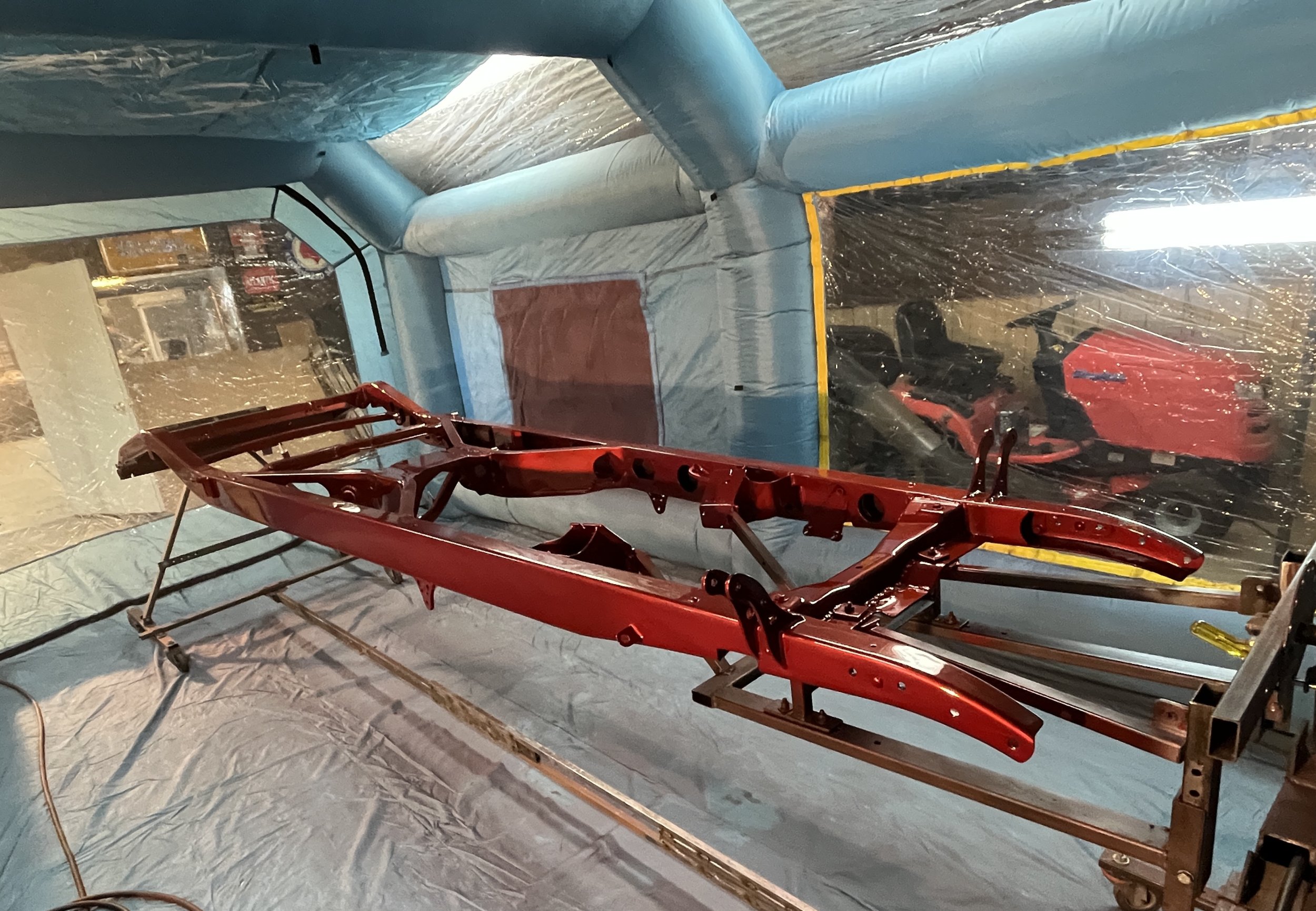

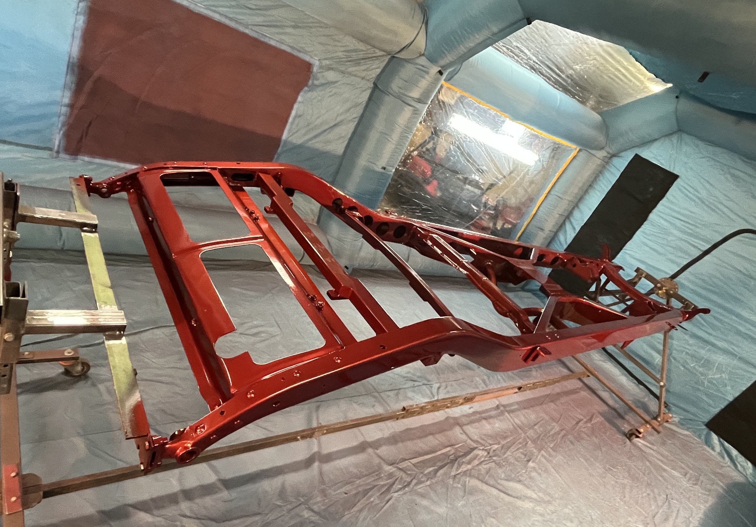

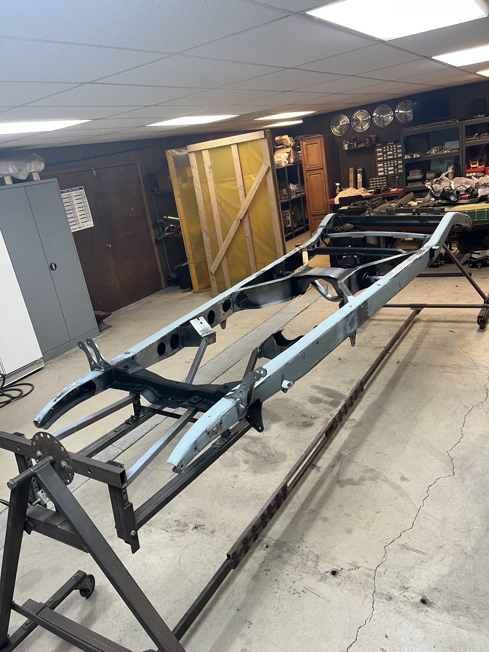

  25. 31 B'ville
    Joined: Feb 7, 2009
    Posts: 423
    31 B'ville
    from SE Pa

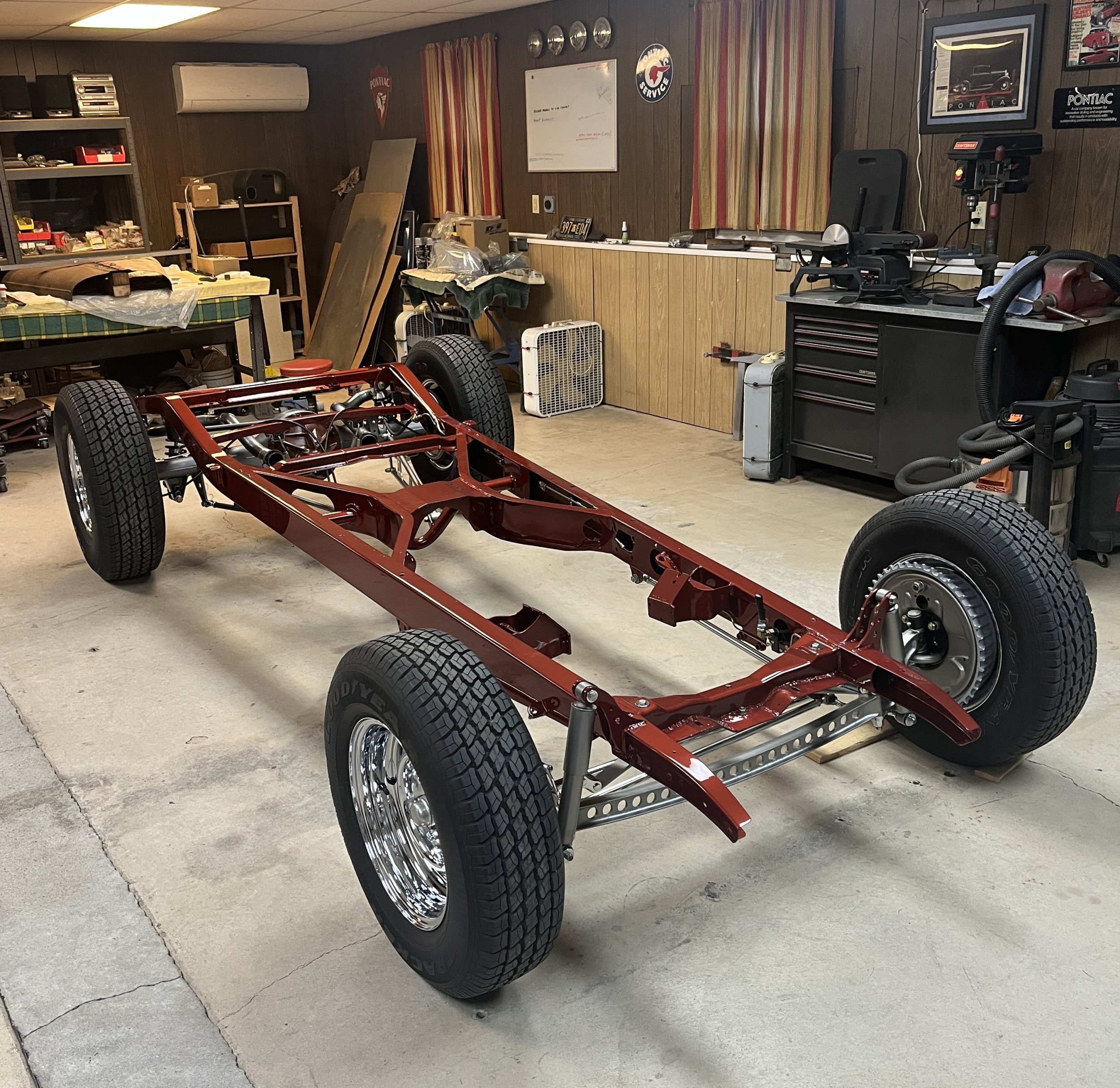

    IMG_9093.jpeg IMG_9121.jpeg IMG_9255.jpeg IMG_9256.jpeg After adapting a rotisserie designed for a vintage Mini to hold my frame and taking care of some last minute welding, we began the process of filling , sanding, filling, sanding, priming, sanding, priming, and more sanding. Finally it was time to paint.

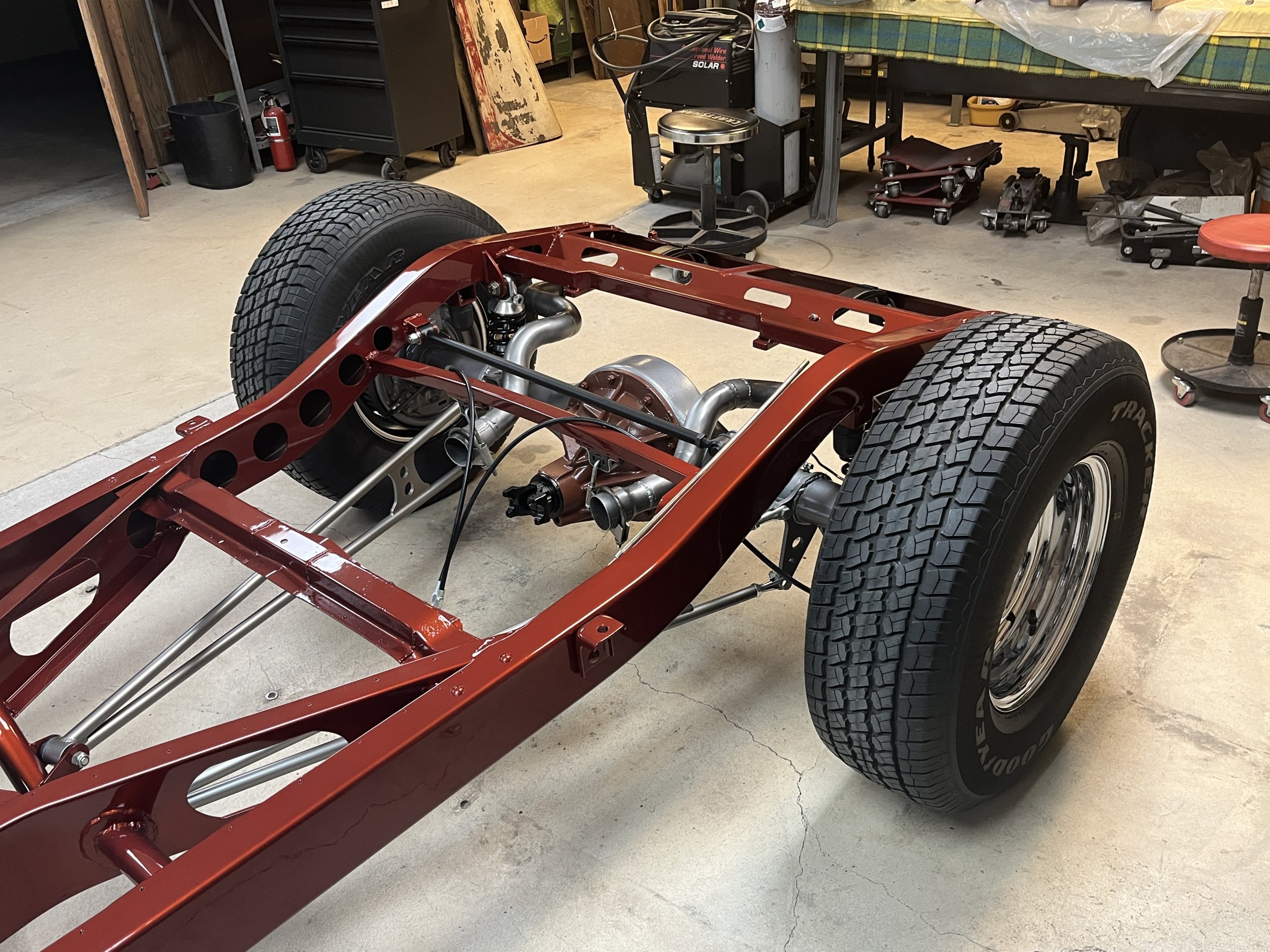

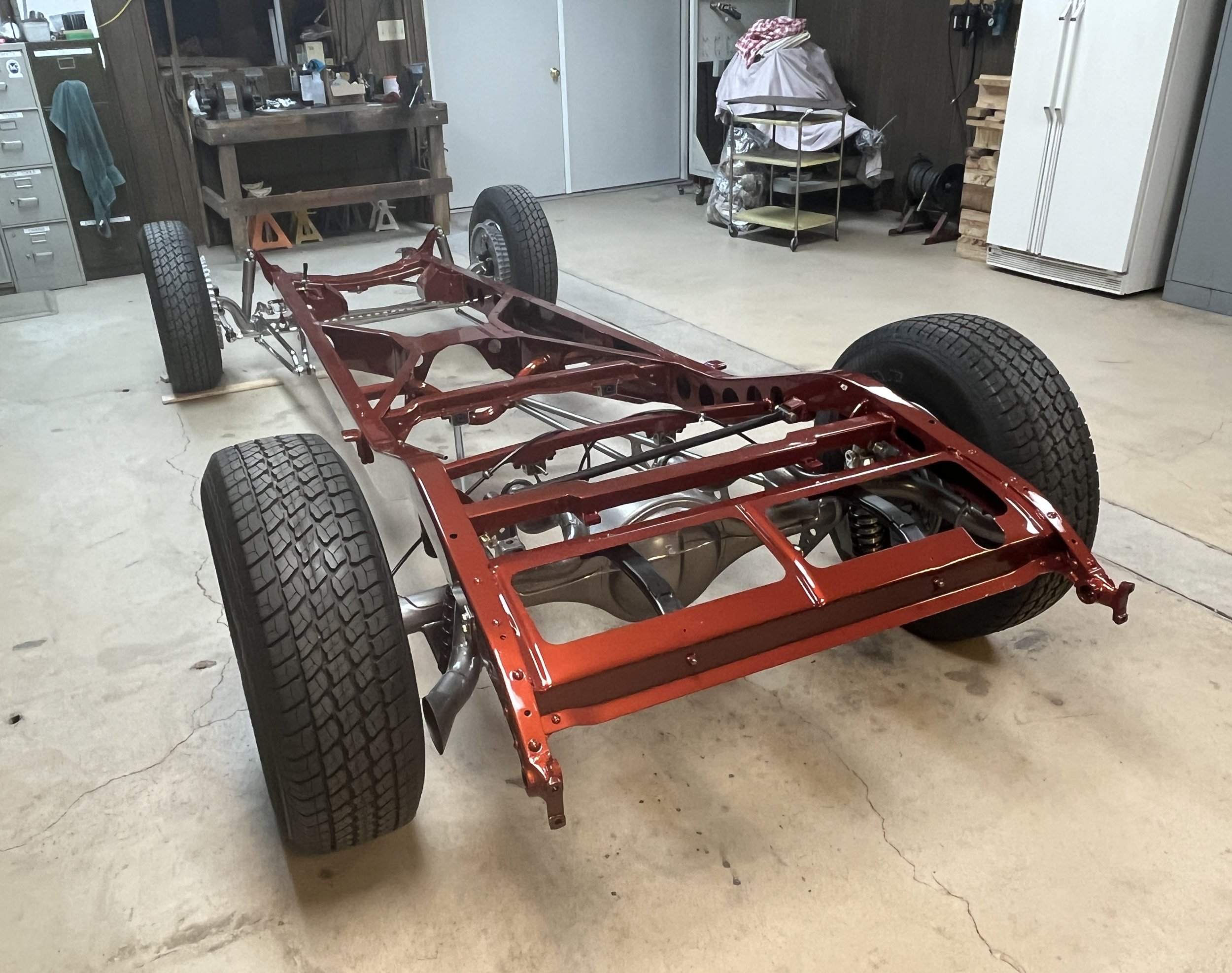

    IMG_9367.jpeg IMG_9368.jpeg IMG_9372.jpeg IMG_9369.jpeg IMG_9370.jpeg Off of the rotisserie and back on 4 wheels.
