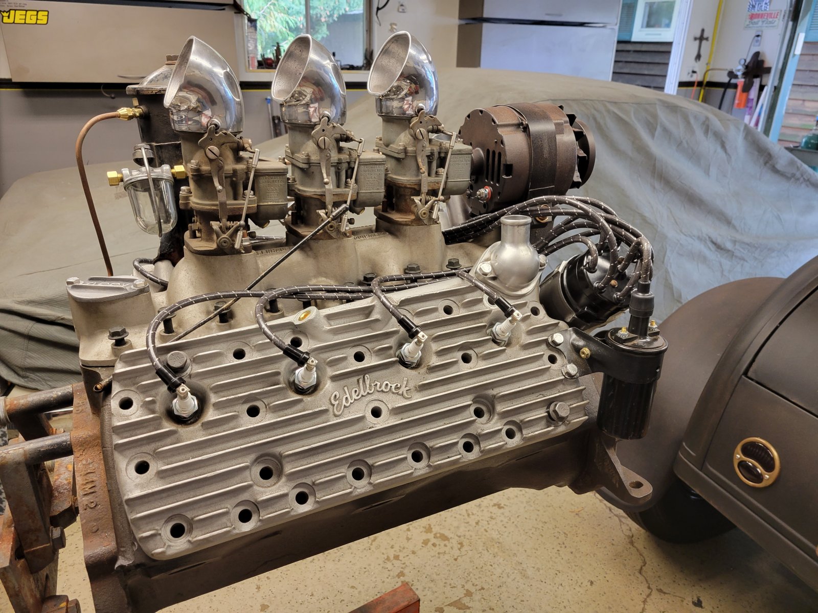

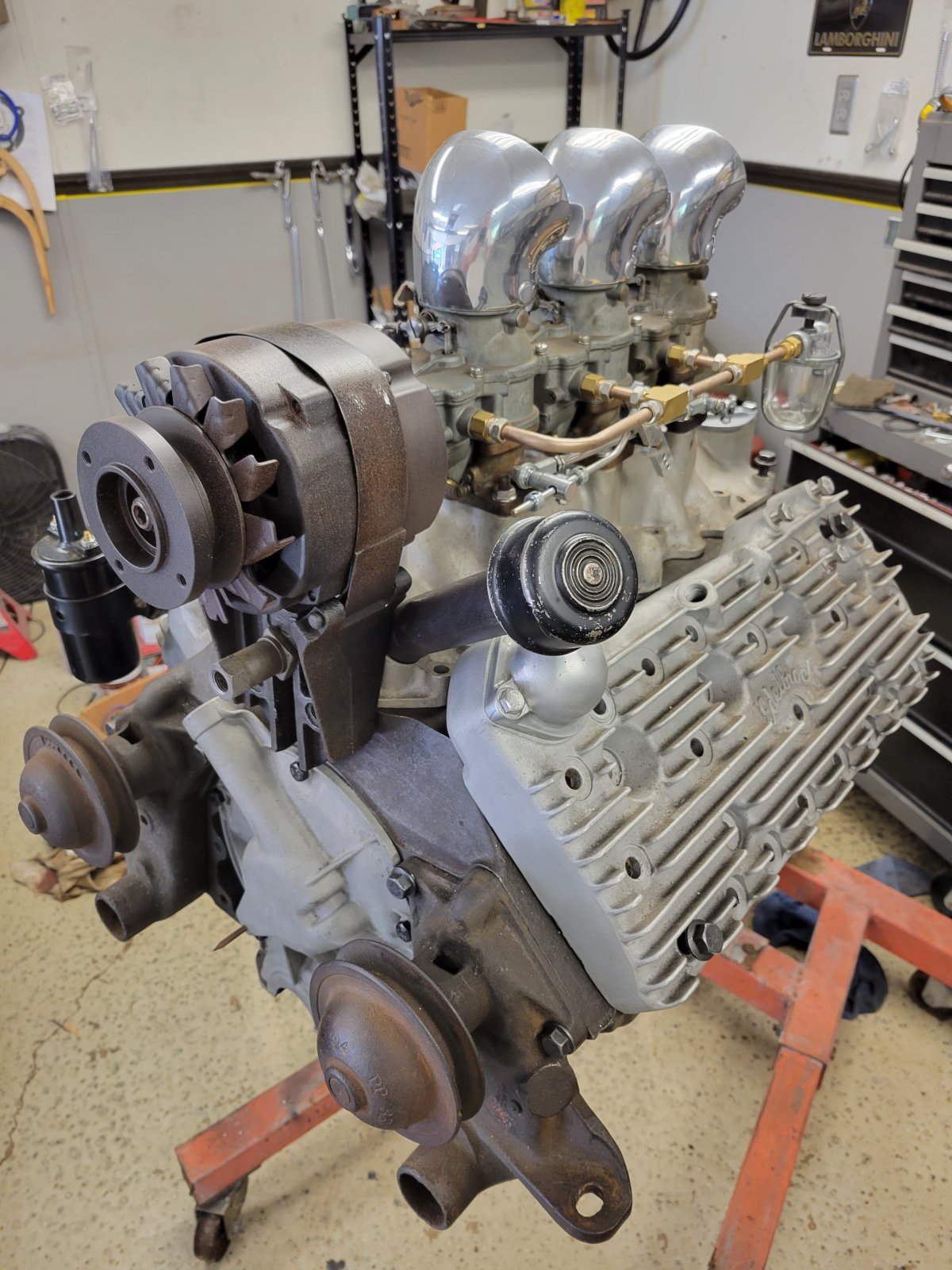

    With most of the interesting stuff pretty much done I have not posted anything. I have been working on the motor. Fixing broken exhaust bolts and putting a few heli coils in place. I decided I don't want to drop over $400 for a shorty generator and went with a one wire alternator. I know not very period correct for a 50's hot rod. But I did use the saddle clamp with a longer strap.
    1.375 x 13.0 18ga. I cut the mounting ears making it look a little more round. The front pulley works with my early 30's fan. A little faux paint and there you have it. 20210917_131730.jpg

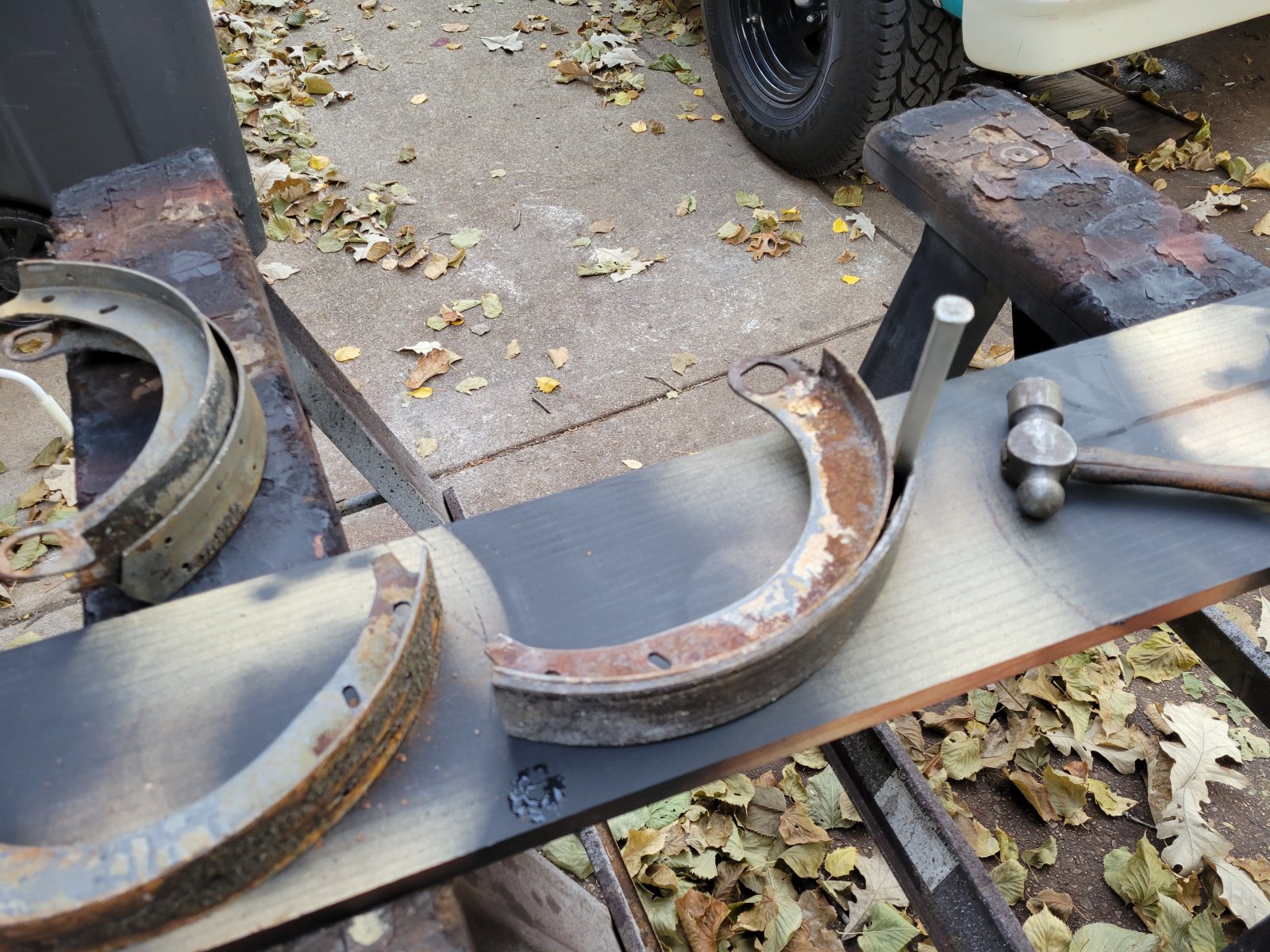

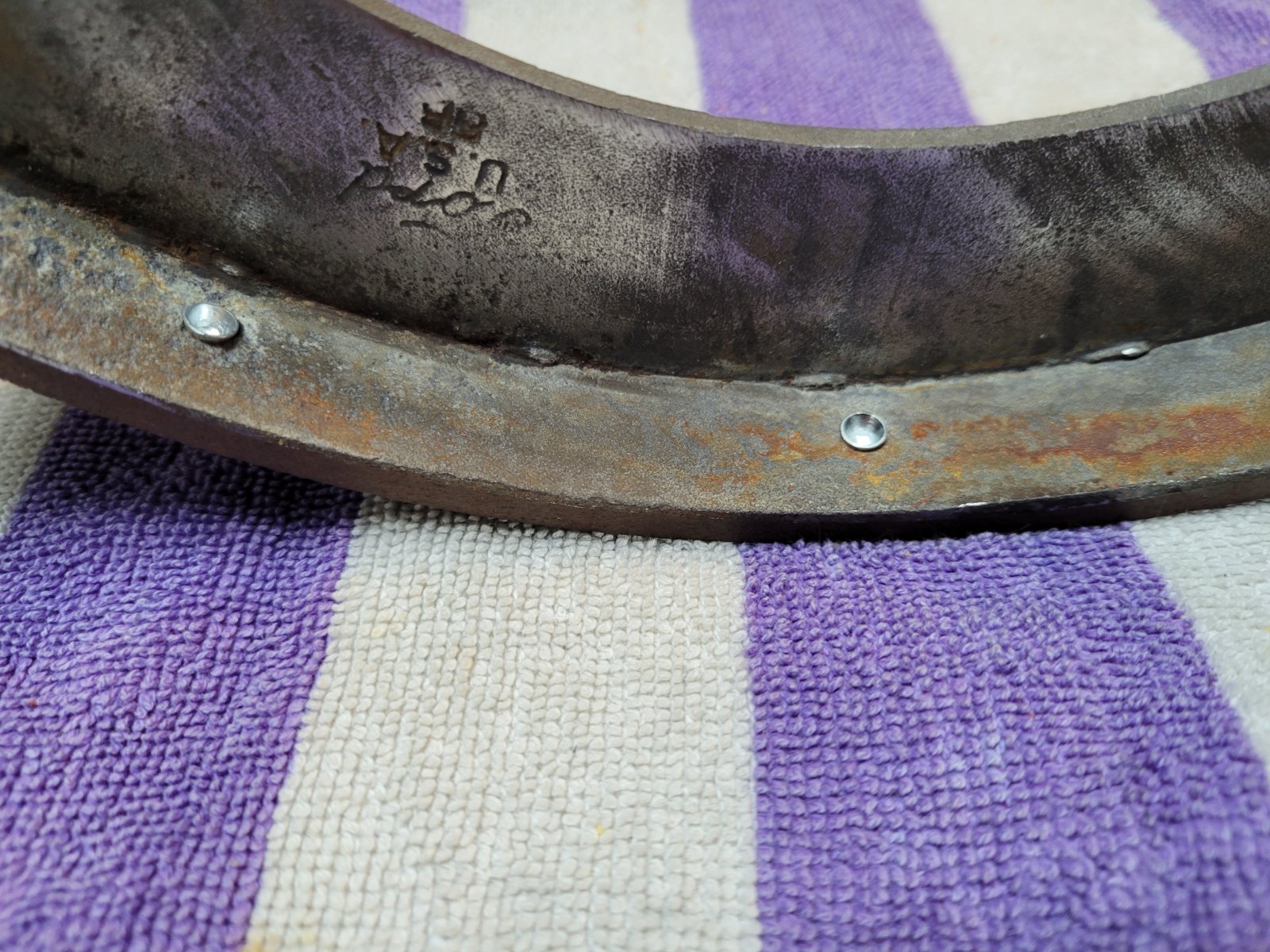

    I called around the local area for brake shoe riveting. Boy things sure change don't they. The old Wis brake and clutch company has closed up years ago and there is one company left that charges $120/hr. Not that was my plan but it had a nostalgic feel about riveting linings on like the old days. Sure you can buy new shoes for $120 but part of my build is experiencing the old ways of 80 years ago. Isnt this why we do this. A time with my dad sitting out front of the garage and me as a youngster watching him do hand work in admiration.
    My shoulder will not take bucking 80 rivets. A air chisel will come into play somewhere.
    Some of my shoes are glued replacements and come off with a chisel and hammer. A little roll loc clean up and I pondered again when things were simpler. The good old USA picture needs no comment..... 20211110_083954.jpg 20211110_090254.jpg

    20211111_104920.jpg I was able to figure out the rivet process. DONT RIVET THEM TO MUCH! YOU WILL CRACK THE LINING!
    I turned the air pressure down some and didnt stay on the rivet too long. You just need to get a nice mushroom. 20211110_132331.jpg 20211110_132344.jpg

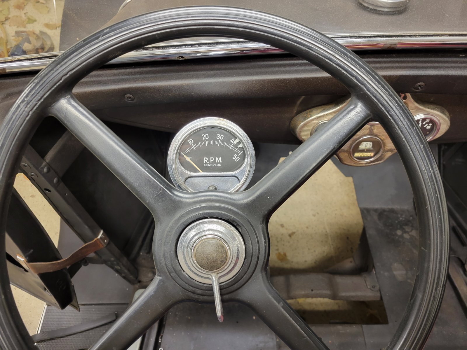

    Yeah sometimes we need to kick back and enjoy what we have. I am recently on disability and it puts a different view on things. Family, friends, free time, car parts and not necessarily in that order......
    Sometimes you need to seat behind the wheel and imagine this thing is going to run someday. If I look real hard I thought the tach just moved.

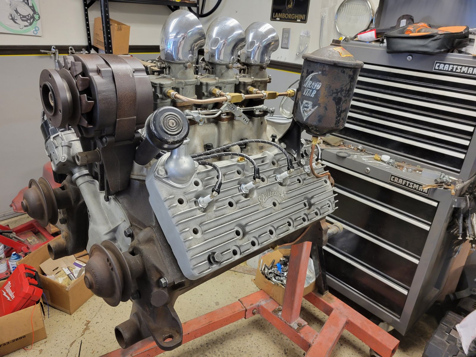

    Another milestone was reached yesterday. The motor went to the machine shop to get everything machined.
    I found a shop in Janesville WI called Pakes. Ask for Jim. They has an extensive background in flatheads.
    The total machine shop bill was quoted at $1275. That's if everything listed was needed.
    .010/.010 crank/check balance.
    Recondition rods both ends
    Block: hot tank and blast magaflux for cracks.
    Deck/bore (3.312)/hone/ line bore check
    New cam bearings
    Valve job.
    Heads sight resurface.
    I think that was a pretty fair price. What do you guys think?

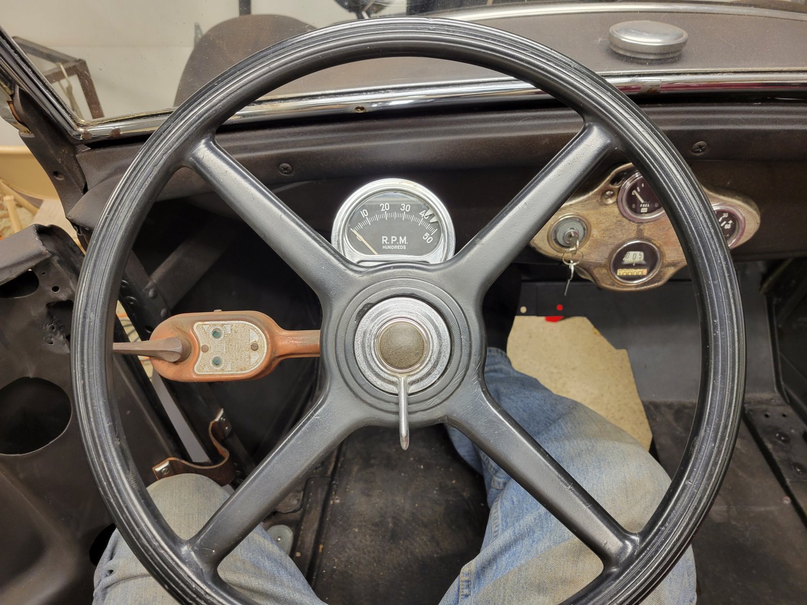

    Added this little jem (signal stat 700) to the steering column. It has the perfect finish to match the rest of the car. The front driving lights serve as turn signals with the use of LED switch back units. More on that when I start the wiring. 20210719_173301.jpg 20211118_154625.jpg

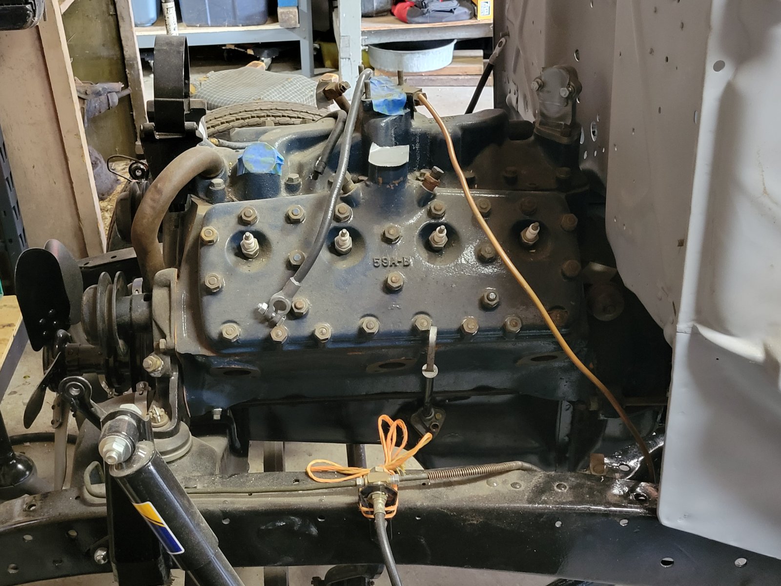

    Bad news today. I got a call from the machine shop and my block has a crack in cylinder #1. The block was questionable with a very deep gouge running down the cylinder.
    I was hoping worse case it needed a sleeve. The machine shop didn't feel comfortable with sleeving a cracked cylinder.
    So I called a friend who had a free 8BA motor but it is frozen tight on 4 cylinders. I spent most of the afternoon busting pistons up. Stock bore so it should clean up .125" over.
    Tomorrow I will tackle the valves. Hopefully this block with p*** magnaflux.

    Update on free 8BA block. This one is worse than my first one.
    On to number 3!
    oliver westlund likes this.
