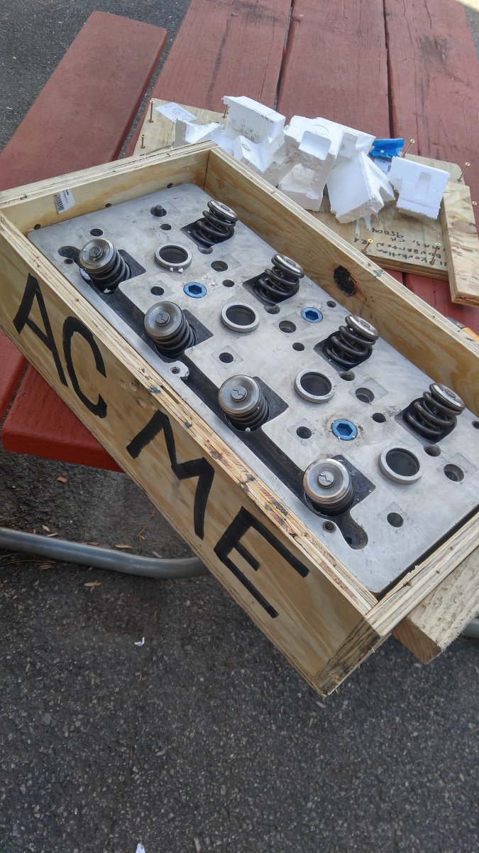

    20180126_135323_HDR.jpg Back to the "MYSTERY CRATES"...... They finally arrived from my buddy Joe Hickenbottom on the other coast. Ck these out!!!

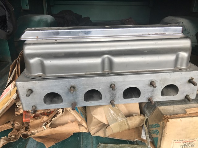

    Screenshot_2018-01-29-20-28-48.png At first i thought these heads were early donovans but i now believe they were made by Al Sharp in 1963... Way cool stuff
    Stogy, loudbang, Chucky and 3 others like this.
  5. Cabbage
    Joined: Apr 17, 2006
    Posts: 741
    Cabbage
    1. S.F.C.C.
    Message_1517271868199.jpg As you can see they are quite different from stock.....im gonna need serious adapter plates to make these work. The ports are rather serious
    Stogy, Woogeroo, loudbang and 5 others like this.

    20180129_195829_HDR.jpg Hows this for cool?
    EVL401, Stogy, Woogeroo and 8 others like this.

    im guessing around 64 or 65 @higgin's henry

  8. Doctorterry
    Joined: Sep 12, 2015
    Posts: 686
    Doctorterry
    That's just too gnarly
    Spoggie and loudbang like this.
  9. 402BOSSMAN
    Joined: Jul 26, 2015
    Posts: 499
    402BOSSMAN
    Those are pretty interesting heads. More pics!
    loudbang and Dog_Patch like this.
  10. Those heads are crazy

    getPart-8.jpg D shaped exhausts but not as massive as the 417 donovan heads. I think these should flow good
    Woogeroo, loudbang, Dog_Patch and 2 others like this.

    Hey Nick @402BOSSMAN The intake ports are almost as wide as the OD of the runners on the hot heads tunnel ram! Im sure i can open up the intake some. Any idea how much HP that tunnel ram can support? I know Gene Adams had a hand in that one and didnt you guys use it in the Engine Masters competition?
  13. 402BOSSMAN
    Posts: 499
    402BOSSMAN
    Just because it is big doesn't always mean it flows good. It may surprise you, especially some of the stuff I have seen. I'd be happy to take a look at them for you.
    That Hot Heads intake was designed around Injected Nitro for A/Fuel and works great for 9000 RPM. Anything less it doesn't make that good of power due to a really short intake runner when you start looking at the harmonic length side of it for a N/A engine. Blower apps its fine. For the Engine Masters deal (my Profile Picture) it was filled with epoxy internally to make the runners as long as possible. I think it ended up at 23" for a total intake tract length which was ideal for the Engine Masters Rules and 2500-6500 RPM pulls. Think of it as making a internal stack injection inside that Profile Picture. Rules that year stated no stack injection ie individual runner (Hilborn/Enderle), required a single plane manifold when using EFI, a 4 hole throttle body, no external modifications but any internal modifications. This was pushing the gray area just like what Kaase did this past year with his cylinder head/head gasket deal. The result for us in 2012 was Runner Up, Torque Monster, Editor's Choice Awards followed that one not to mention a few articles in some magazines. Always boils down to engine design, lots of math, and understanding the application in which it is to be used.
    loudbang, saltflats, Tudor and 2 others like this.

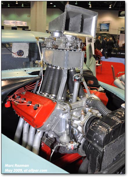

  14. Cabbage
    Posts: 741
    Cabbage
    1. S.F.C.C.

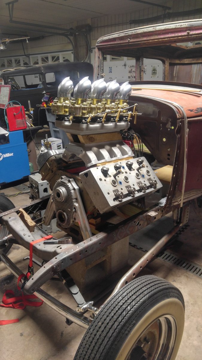

    blower.jpg Extra long runners huh??? Something like this maybe?

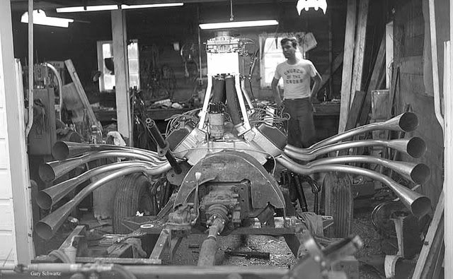

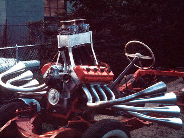

  16. Circus Bear
    Joined: Aug 10, 2004
    Posts: 3,238
    Circus Bear
    I always love seeing high and mighty pics. Gotta love seeing adjustable intake runners. I bet someone could use the same set up for tuning than make a matching sheet metal intake once things are figured out.
    Sent from my VS501 using H.A.M.B. mobile app
  17. 402BOSSMAN
    Posts: 499
    402BOSSMAN
    "High & Mighty" if the Chrysler Engineers were at it today. Wild idea that works and works well. Still need to compile my info into a video but you all catch the drift.......Its real and it works!

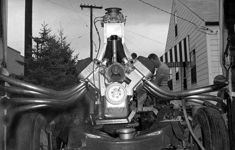

  20. Circus Bear
    Posts: 3,238
    Circus Bear
  21. Here's one more - Russ we are hijacking your thread :D
    Woogeroo, Bowtie Coupe, Tudor and 2 others like this.
  22. The original was a little smoother about it. Lol
    On a side note, see how those Chrysler engineer designed their header flange and primary tube direction ?

    No worries on the hijack Nick. Very cool stuff you got going there. Im wondering if i could make a rubber hose manifold to get real HP. Back in the day they were running 12s with the high and mighty i believe

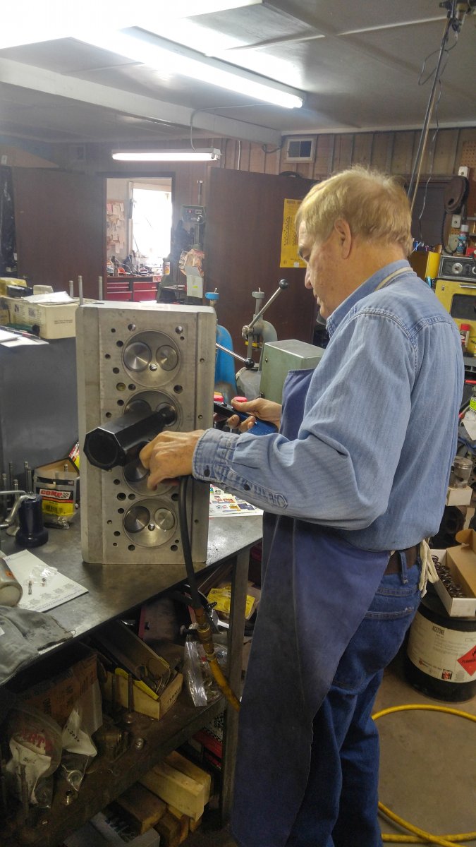

  27. Cabbage
    Posts: 741
    Cabbage
    1. S.F.C.C.
    20180130_113900_HDR.jpg Heres Johnny Thomas "the man himself" taking a look at the heads
  28. Cabbage
    Posts: 741
    Cabbage
    1. S.F.C.C.

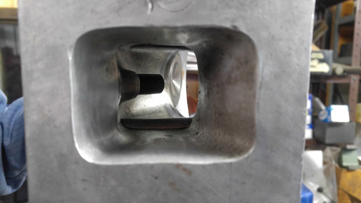

    20180130_114121_HDR.jpg The Intake ports sure look racy. Pushrod holes have been sleeved and ports opened way up

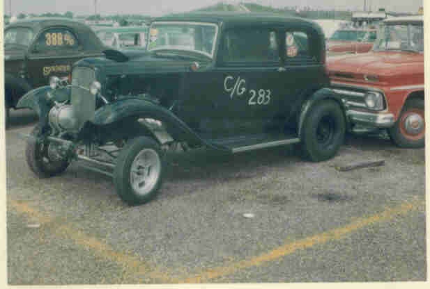

    1. S.F.C.C.
    1932 FORD VICKIE GASSER INDY.jpg Another gasser inspiration pic... A Vicky at indy
  30. elgringo71
    Joined: Oct 2, 2010
    Posts: 3,862
    elgringo71
    That's The Samsel Brothers Vicky called Teddybear, early on.
