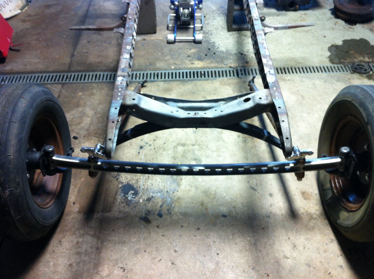

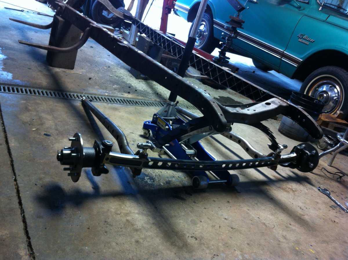

    Ok on to the front suspension! Ive had these drilled bones for a while waiting for something cool to put them on.... is this cool? upload 1-15-16 761.JPG

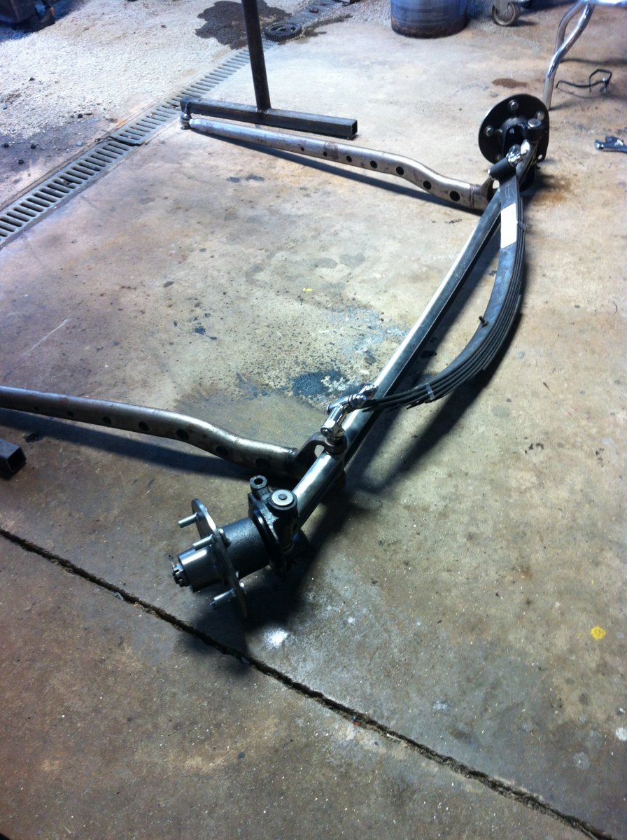

    Drilled model A axle and the spring was made special by posies (who I do NOT endorse... long story) upload 1-15-16 764.JPG

    Maybe it's the lack of backing plates, but the hubs look odd. Bob

    Bob those are 40 hubs from Speedway but it does look odd. Brakes are on the way from TX

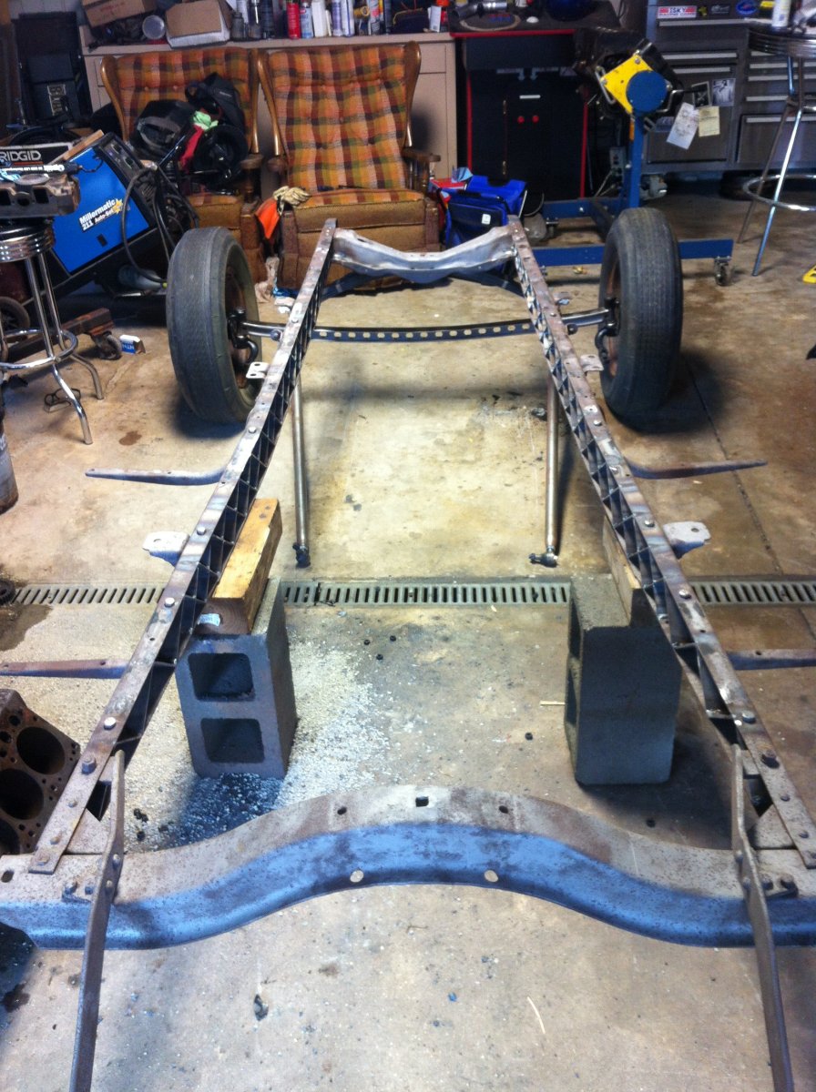

    Screenshot_2016-03-27-09-39-43.png Ok moving right along. Now that the frame is ridiculus stiff its time to reset the body. For those unfamiliar with the Victoria these cars were unique a**** the model As. They were kinda of a transition car. They were the first to have flush fit doors like the 32s. Also they had the slanted A pillars and a factory chop and longer doors but the biggest difference is the floor. Other model As have a metal subrail with wood boards for a floor. The Victoria has WOOD subrails with metal pans in the middle! Thats right WOOD subrails! The whole body is tack nailed to the wood and the wood is bolted to the frame. It only makes sense from a cost standpoint because back then wood was cheap. Now this combo is great for 35hp and 35mph. Not so great for 700+hp and 130mph. So out it comes! Tonys in there helping get it free, thanks man!

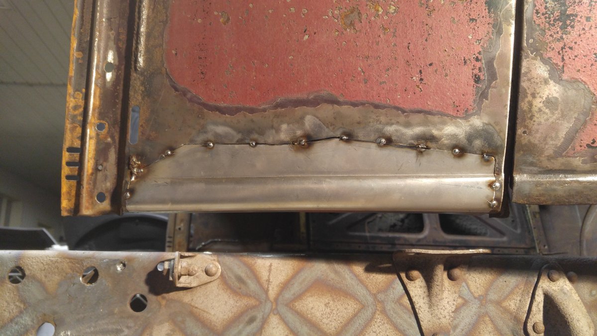

    20160202_135021.jpg While shes swinging its a perfect time to patch the cowl seeing how i havent got a clue where to start on the floor. Lets fix this. Progress is good

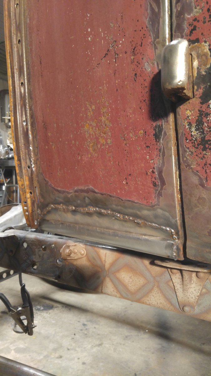

    Message_1454555765815.jpg Thats better. I always try and save as much of the original ford steel as possible
