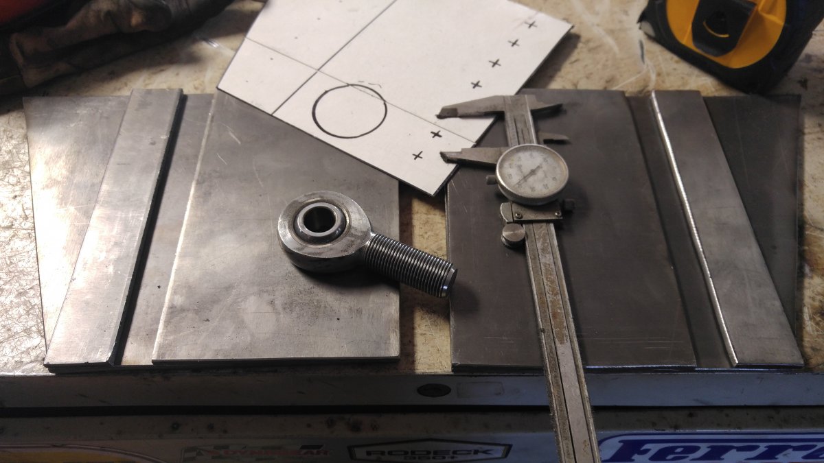

    Im using 3/16" 4130 chromoly plate. I added a strip on the front and back for the tie rod taper holes so theres enough depth to be safe. The taper holes are 9/16 deep. Also im building in lots of adjustment just incase. What the heck its just extra holes ; ) Message_1457389031836.jpg

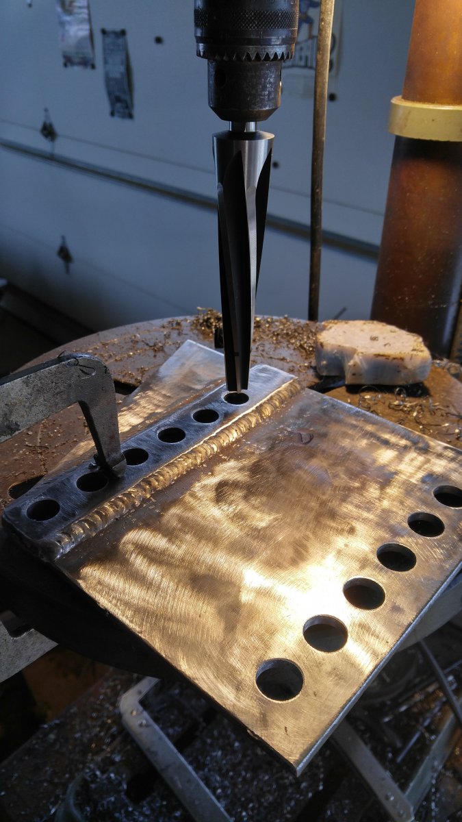

    1. S.F.C.C.
    Message_1457982805447.jpg adding the tapers to the holes. Boring stuff :)

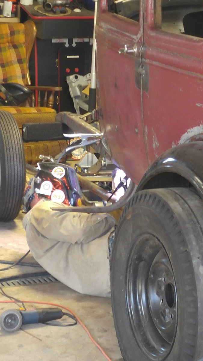

    Message_1458248416680.jpg This is my buddy Jon Ruble he welds nuclear power plant gear. He is a professional welder and since im not and this is kinda a serious weld hes running the TIG i borrowed from Tudor. Thanks Jon and Josh! My TIG is in for repair. Jon threw down a few nuclear welds on the Vicky

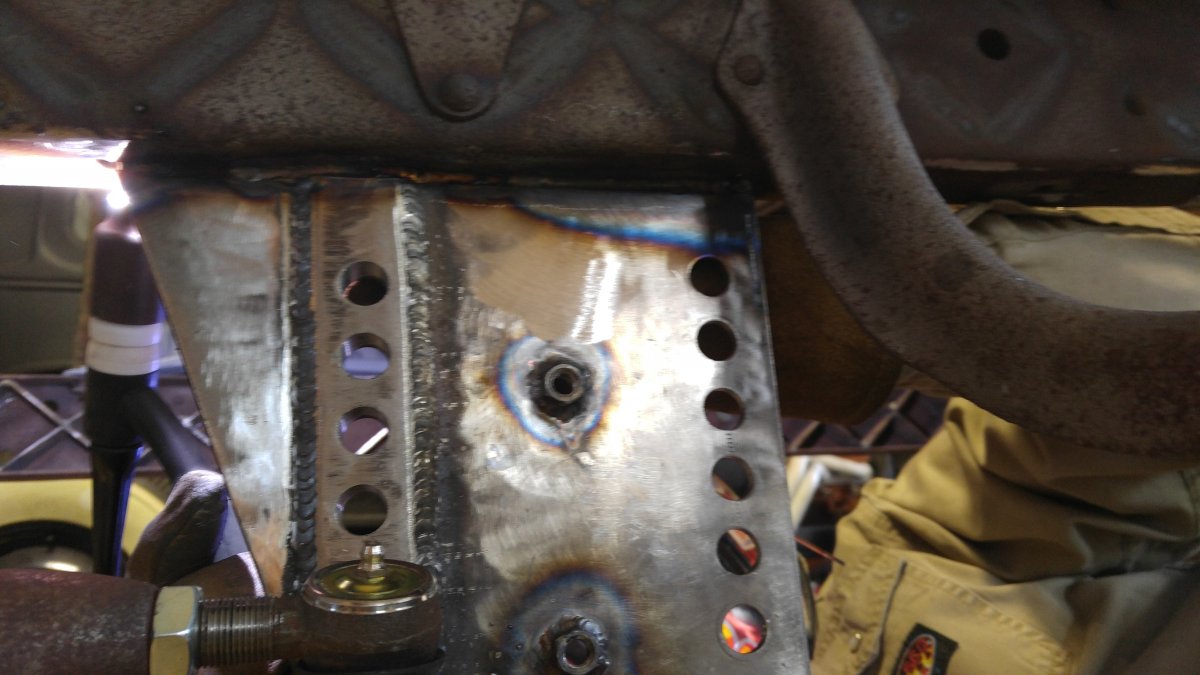

    Message_1458443166328.jpg There we go! Finally its melted home. Not light but plenty strong

  17. 4130 should not be mig welded. Just a heads up.
    allwilly and stealthcruiser like this.

    It can be provided Cabbage is using ER80S2 and is using the proper technique. The problem with MIG over TIG in 4130 is the cold start and the embrittlement problems it can create.
    Dog_Patch likes this.
  20. stealthcruiser
    Joined: Dec 24, 2002
    Posts: 3,750
    stealthcruiser
    I was gonna' aks why he chose 4130, other than it welds and cuts nice!
    Ain't it supposed to have some normalizing / stress relieving action done to it after welding, ( Mig or Tig)?

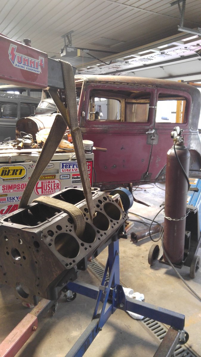

    1. S.F.C.C.
    20160222_103642.jpg Heres a shot when i was taking the block back to Johnny Thomas to double ck the deck and final bore before ordering pistons

    Thanks Chuck! Im using 4130 because its stronger and i dont want shit breaking. All the structural welds are TIG also. Thanks for the comments guys its moving along pretty good. Rear suspension is next! STAY TUNED....

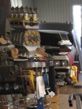

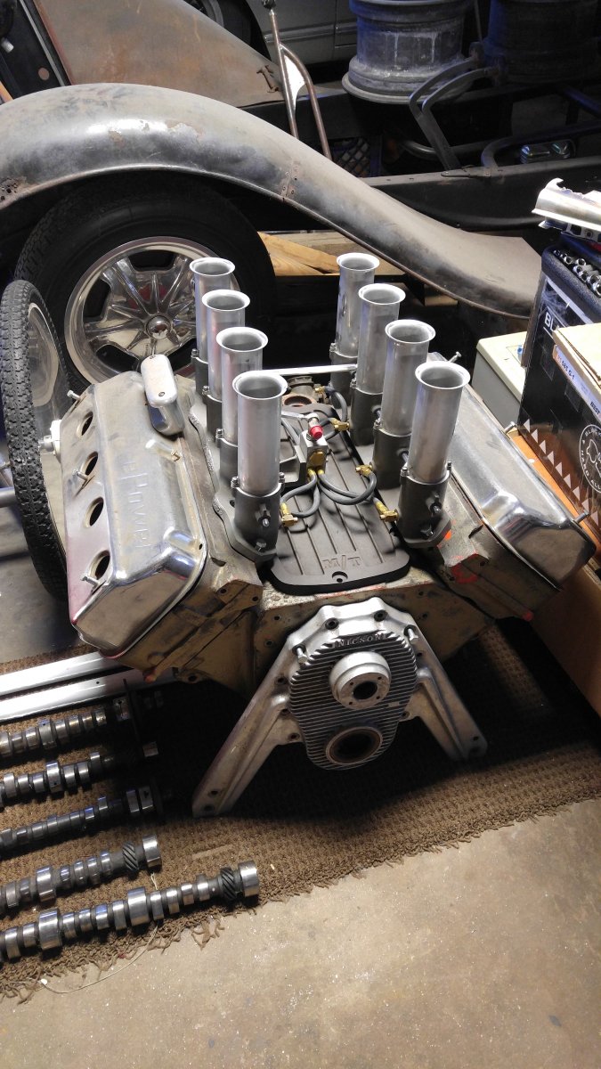

  27. Sounds like your mill is coming along nicely - what are you planning for induction?
  28. Cabbage
    Joined: Apr 17, 2006
    Posts: 740
    Cabbage
    1. S.F.C.C.
    20160227_150506.jpg Well thats a good question Mike. I couldnt figure it out until Tony offered to loan me his 1965 magnesium Hilborn set up... Lets try this on for size! Thanks Tony! What do you guys think... Is this gasser or what?
  29. I was thinking this rascal would have been damn cool !
