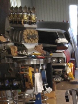

  3. Ive not seen a set of hemi heads with the boss for the water crossover cast in but not machined and opened into the water passage.
    What's the application that they are from?

    Thanks Tim and Enloe! 31vicky that roto faze and 8x2 setup is for the 32 tudor you can see in the pics. I gotta get back on that one sometime. I have most of the stuff now. Southeast cars are all normally aspirated no blowers allowed. Those heads are plastic man. Dummy blocks are much easier to mock than a real hemi

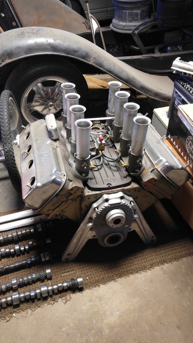

    Message_1458525264815.jpg The next goal is to get her into roller status. That means ladder bars, Brackets, spring mounts and narrow the rear housing. Custom 35 spline axles will be coming from Mark Williams along with other bits from fabcraft like the billet 1350 yoke. Pondering ladder bracket design, i like this shape

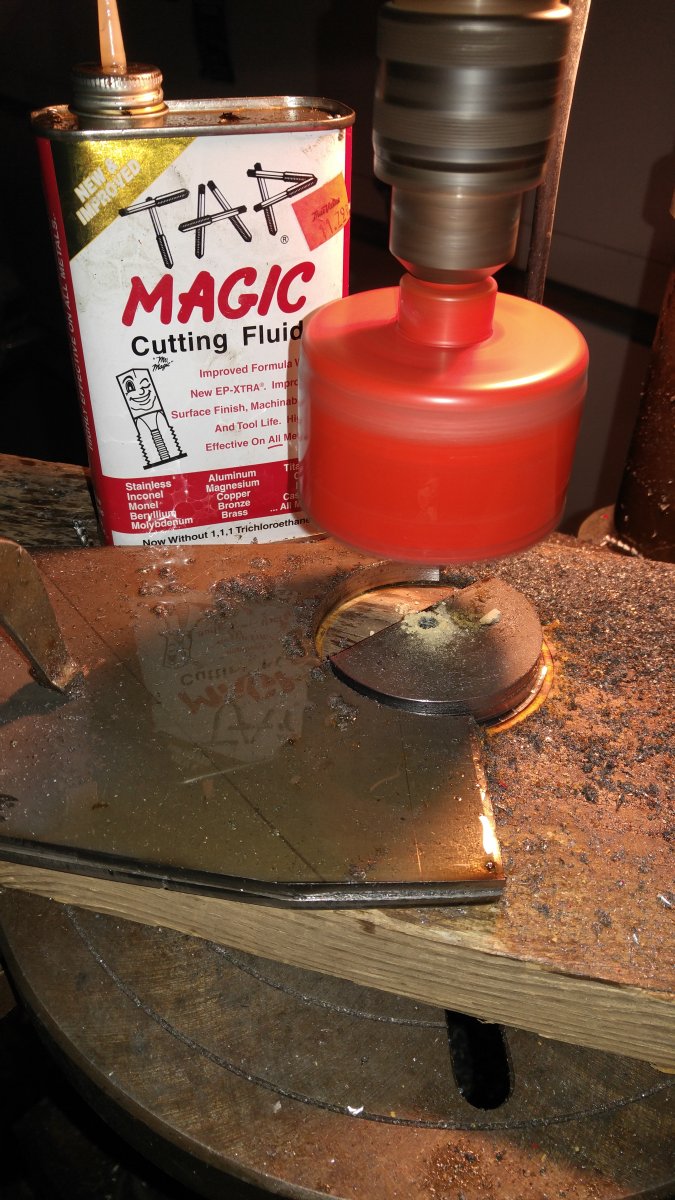

    Message_1458780229808.jpg More 4130 plate gets the nod for the rear brackets. Here we go! No plasma or cnc here. Cut off wheels, drill press and an old swap meet drop band saw gets it done but it doesnt go quick.

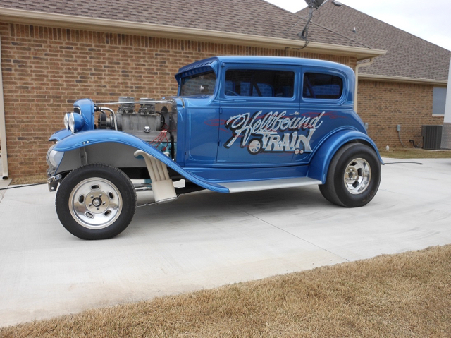

    Cabbage I dig your build man this thing is gonna be awesome here is a pic of a friend of mines car he has since sold it thought it might be a bit of inspiration it is a Chevy but it is a Vicky it has Pontiac power with clutch turbo if I remember correctly it also has a Pontiac rear end too
    biggeorge, kiwijeff, AHotRod and 7 others like this.
  20. A '31 CHEVY Vicky... And I thought my 5 window was rare - I'm still shaking my head. Since I bought my coupe in 1995, I have never seen one before - That is one killer looking gasser as well!!

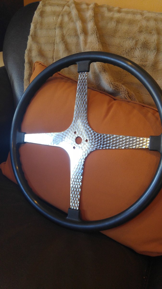

    Message_1458657487261.jpg Thanks guys. Yeah i love that hellbound train gasser. Very very cool. Anybody goin to the coker tire cruise in tomorrow? We are gonna ride up and ck it out i need to get away from the lakes and the garage for a bit. I did score this killer steering wheel for the Vicky. 17 inch, i think its perfect.
