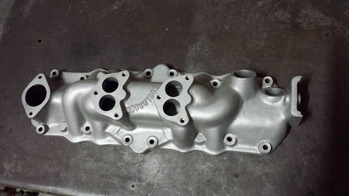

    My intake is an early one with the block letters but it is a low rise version so I think I want to put some of those 4" aluminum risers that are on ebay.........I will snap a picture later for everyone because everyone loves to see Flathead speed parts!

    Bruce, I plan on going so I will take you up on the offer for a beer.......here is the intake that showed up for the big flathead, I put a straight edge on it and it wasn't warped so I was happy.

    Now get them risers and throw'm in the blasting cabinet to match that beaut!

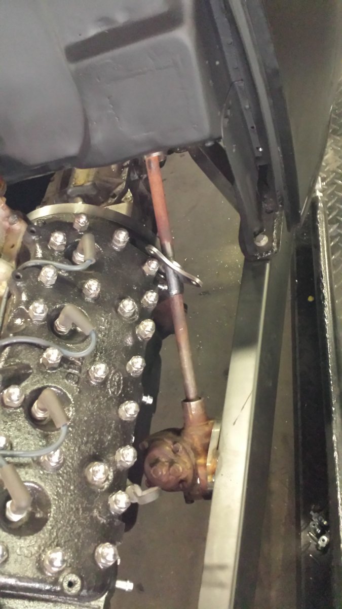

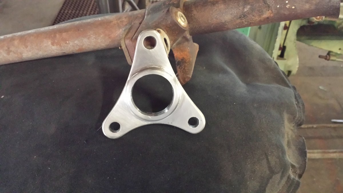

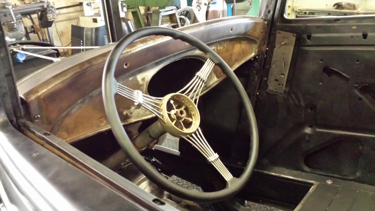

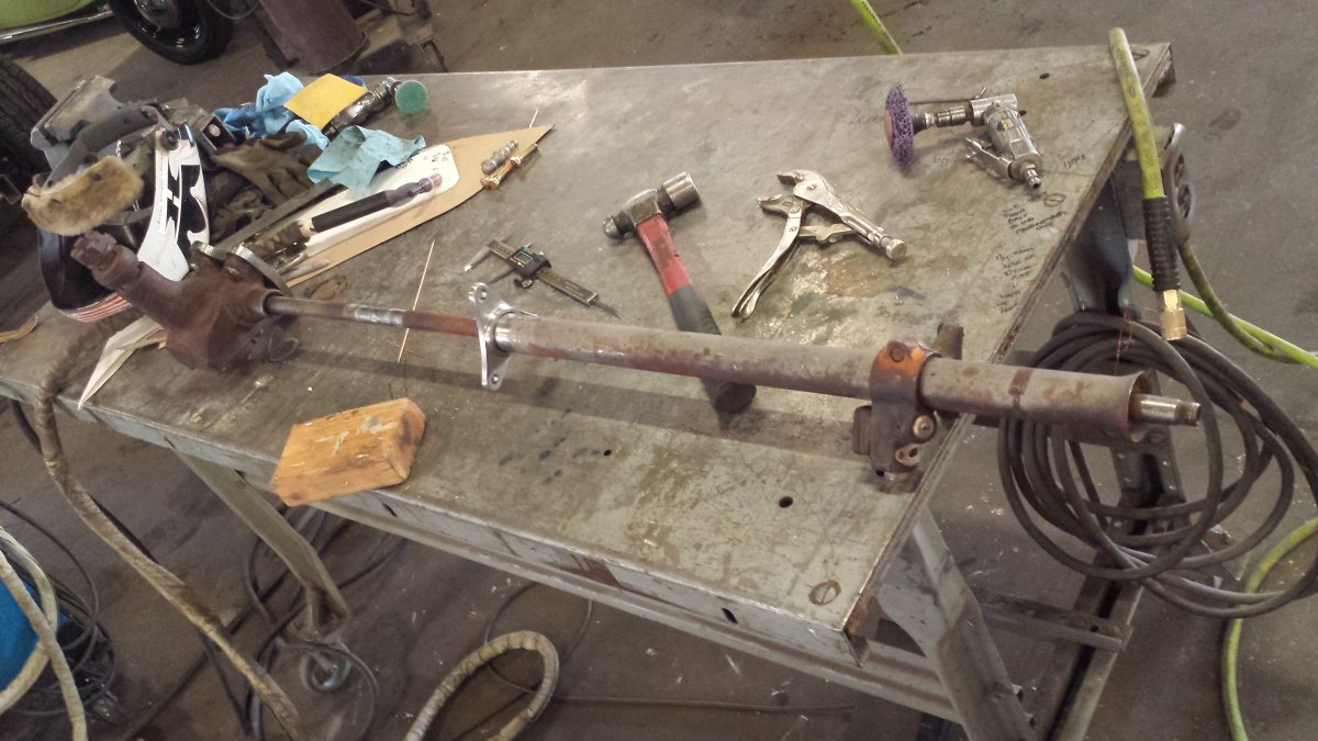

    You know I should have just ordered a TCI ch***is with a I did it column, and a vega box so I could put my car together with a crescent wrench, but that would be lame so we spent 7 hours using original Henry parts and designing the column support, hanging the '39 Merc cross steer box and fabricating a cool mount to weld the column too and bolt to the toe board
    The lower column mount Nick fabbed up.....
    Here is how it looks when attached to the column
    The drivers side header will have to reworked a little but the plate has threads welded into it and we don't have to hack into the frame boxing, an idea I stole from the famous Cory Taulbert

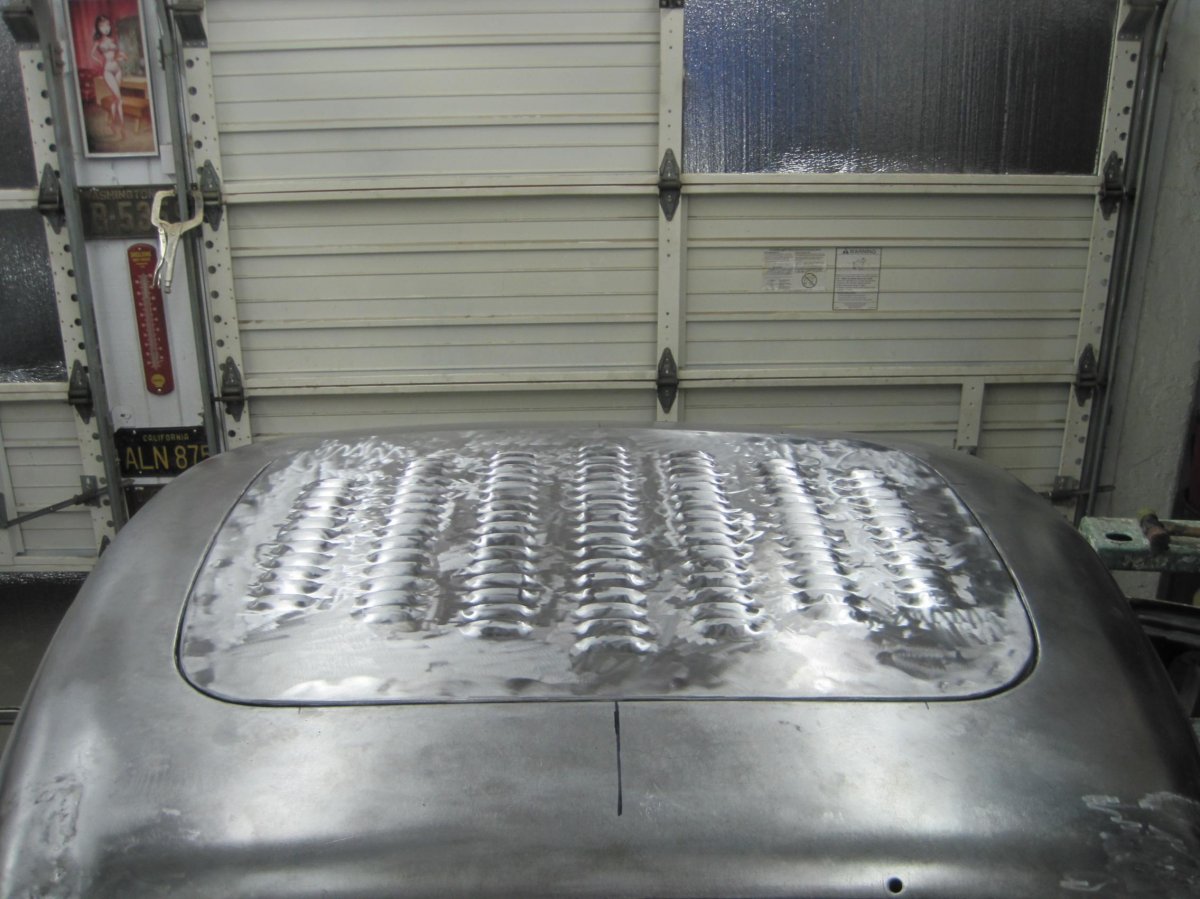

    I just picked up some aluminum to make the roof insert, we are using 3003 aluminum that is .063 thickness, the plan is make two inserts,both with a crown of course but one smooth and one with louvers like below, that way I can swap them out depending on my mood.
    Something like this.....
