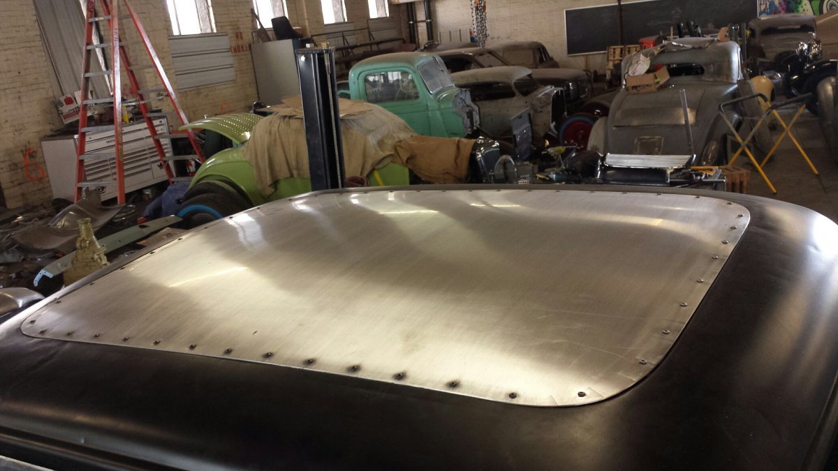

    Well, I worked solo on Friday afternoon for a couple of hours finishing up a few little details:
    I also mounted the push bar after painting it brushed aluminum which will match the roof insert, eventually it will get nickel plated when the car gets gloss black paint.

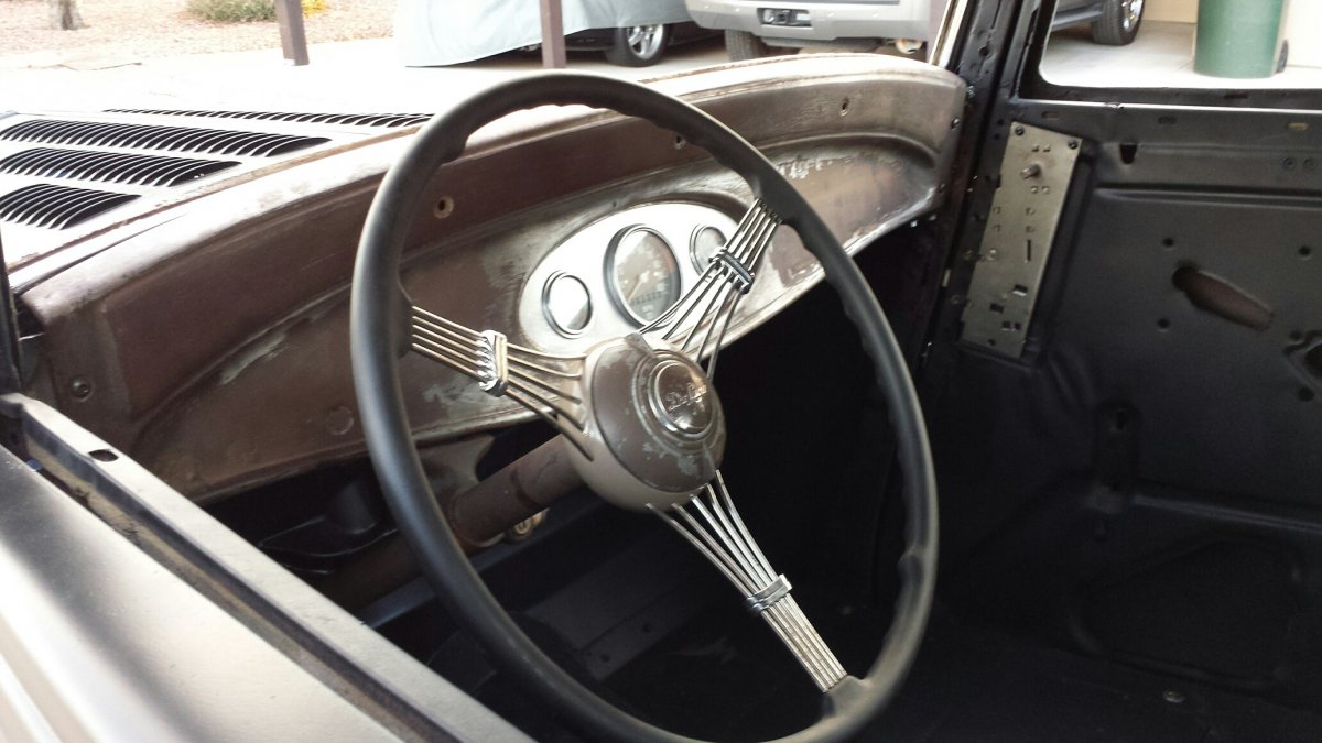

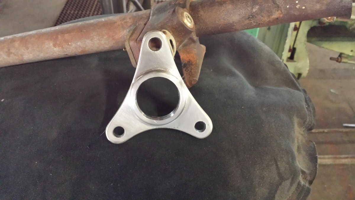

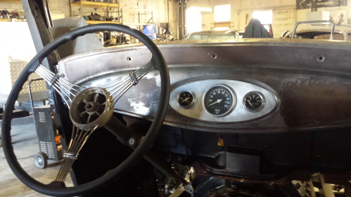

    I made a gusset for the column mount 3/4 square tube that we ran behind the dash and then mounted the dash cluster to see what it looks like with the banjo wheel,

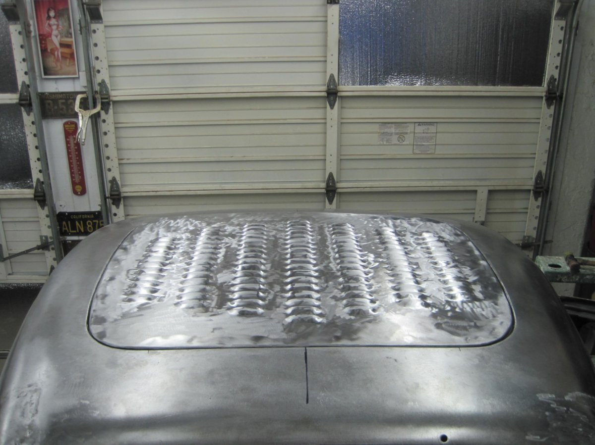

    Mike cut out the aluminum .063 3003 insert and once Nick shapes it with a nice crown and I am sending it over to Chip to punch some louvers in one and I am keeping another one flat in case I want to stay dry

    If I may ask, how are you planning to attach the roof inserts? Will it be weather sealed if removable? I would love to see photos from the inside when you get to that point because I was thinking the same thing for my 5 window.

    My plan is to use a ****on head screws around the perimeter of the original insert hole so it looks like rivets on the aluminum but yet removable , then I plan to use some thin weather stripping around the underside of the insert so when the ****on head screws are tightened down it creates a weather tight seal, kinda hard to explain so once the insert is shaped and ready to be installed I will get some pictures.

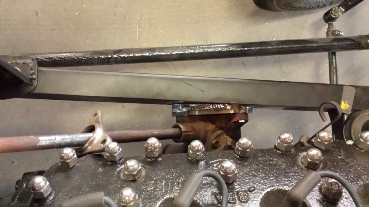

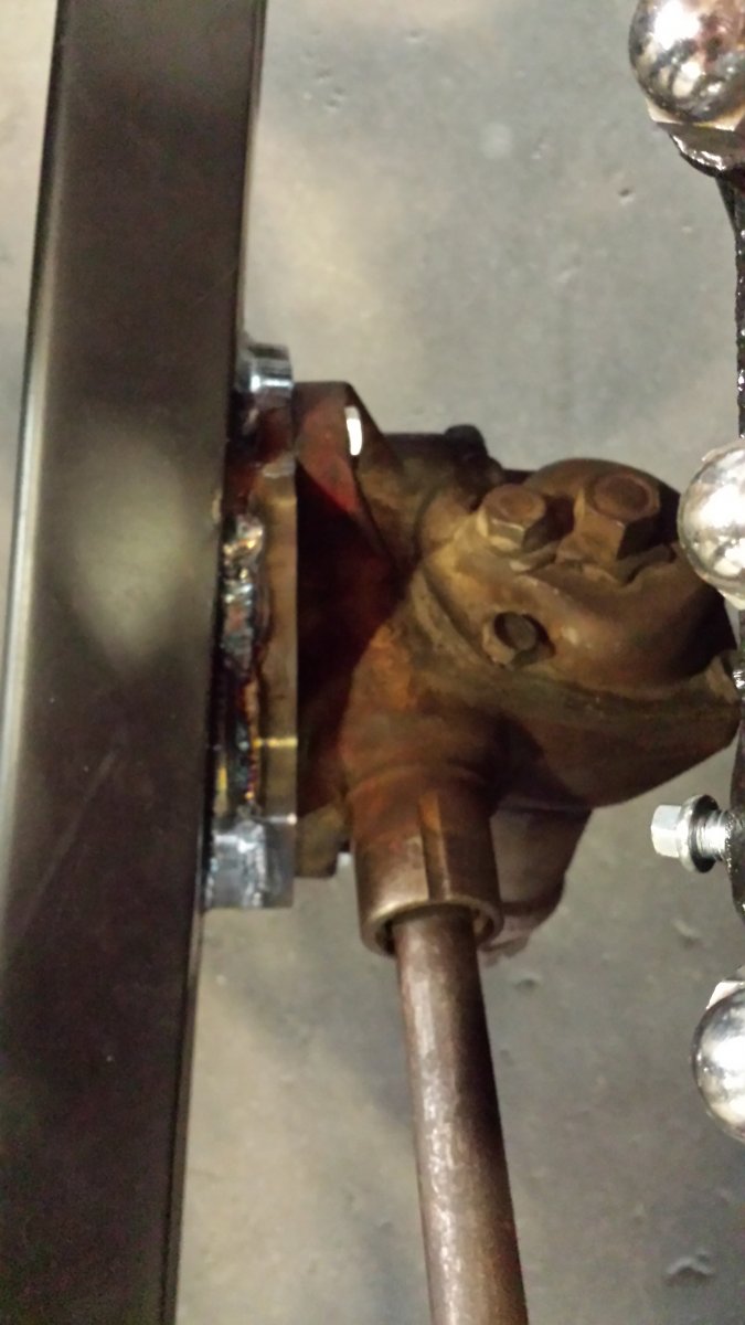

    More updates today, so since Nick (the owner of Hubcap Hot Rods and Kustoms) is moving his shop back up to the Deer Valley area in October so he is dedicating most of his time to finishing up my car before he makes the move, which makes sense because it is one less car to move, right?
    Today's progress is he finished TIG welding the '39 Merc Steering box mounting bracket to the frame today, and tomorrow the plan is to get working on grafting '40 pedals into a CE X member , unfortunately I did not get any pictures today but I will grab some before the week ends. Stay Tuned........

    As promised, the cross steer bracket is TIG welded into place

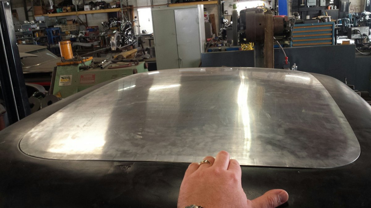

    Nick and Mike put a nice crown in the aluminum roof insert before the louvers get punched into it

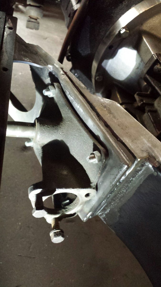

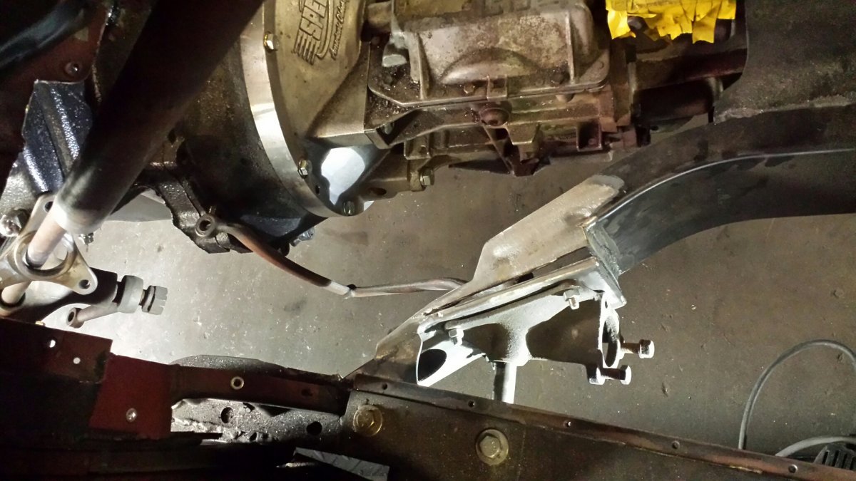

    Many people on this forum have asked how to put early Pedals in the Ch***is Engineering Cross member, well it can be done but requires cutting the pedal mount area on three sides and bending it out about an inch to get your pedals to face forward, if you don't do this your pedal point towards the front left tire, it also requires you to clearance the top side of the X-member some, the '40 pedals I used will work well with the '40 style cross-shaft clutch fork.

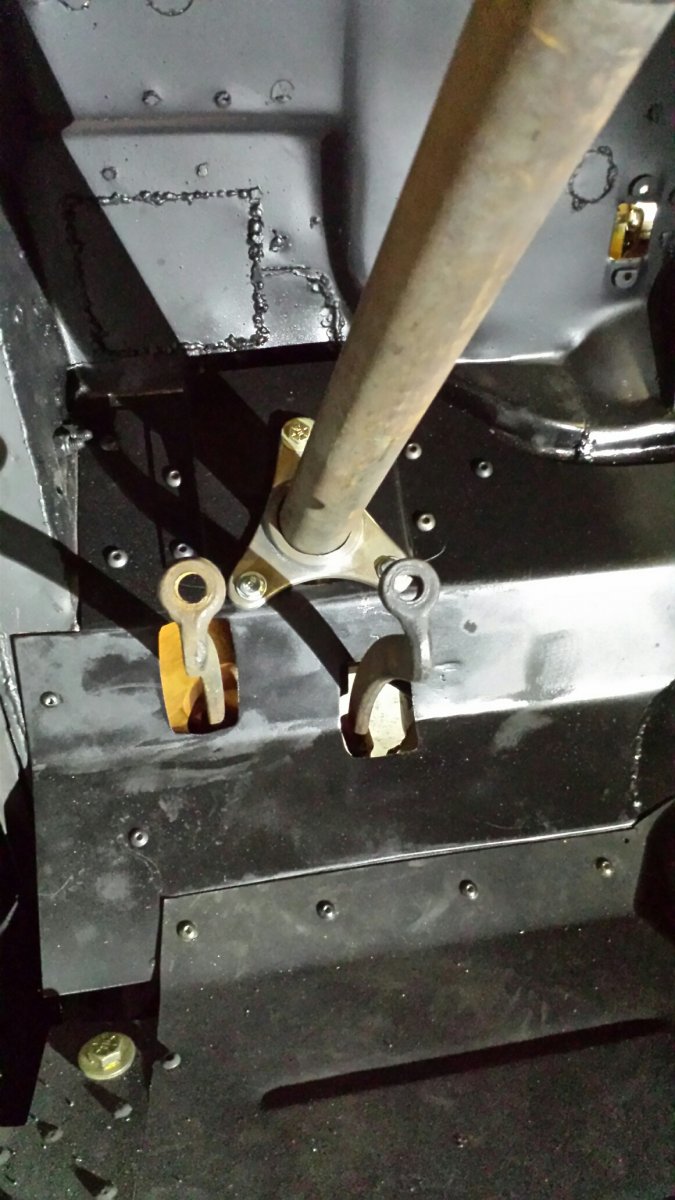

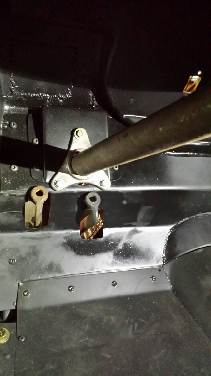

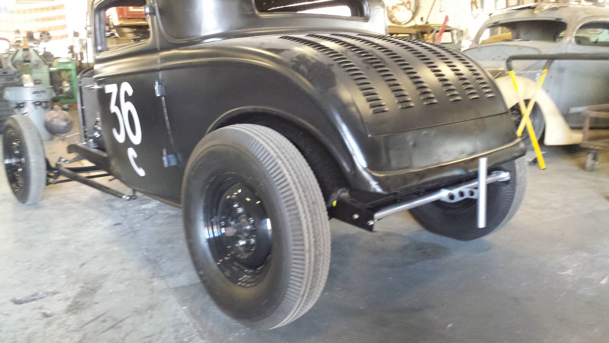

    So I stopped by the shop today to check on the progress and the guys got the aluminum roof insert installed using ****on head allen head screws which look like a rivet but are removable, the plan is to make two inserts, one solid and the other louvered.
    Mike got the pedals all installed and the floor back in, here is how the column mount tri-bar bracket looks mounted to the floor, sorry for the ****py cell phone pictures, they are very dark now the roof insert is installed.

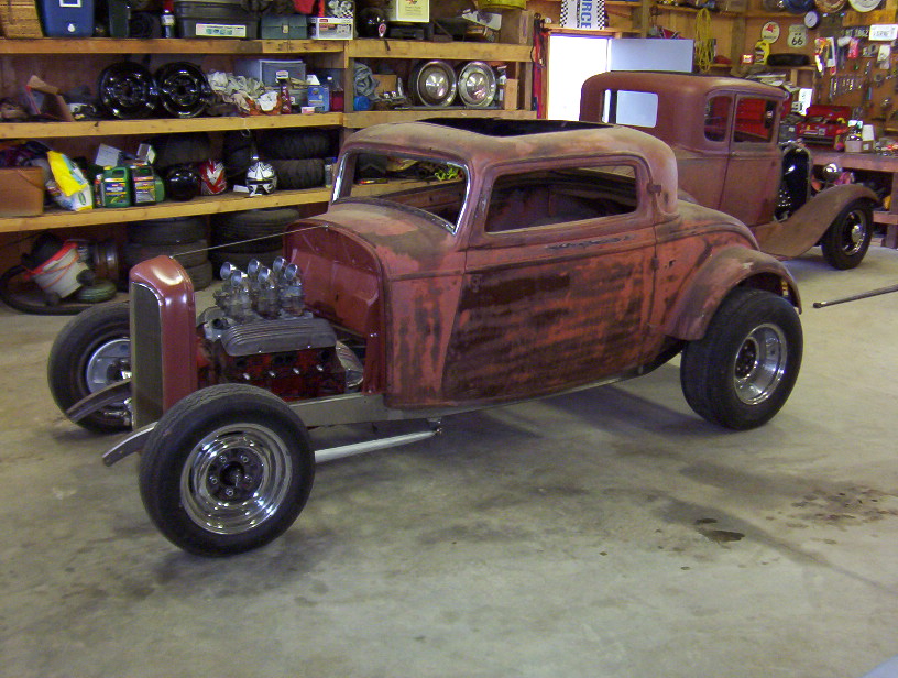

    But here is where we started almost 10 years ago in Colorado.........
    To a very different look and late '40s Dry Lake racer look or should I say her roots.....

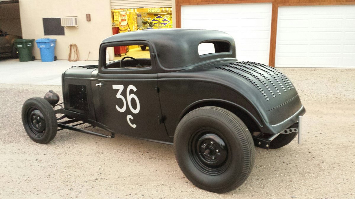

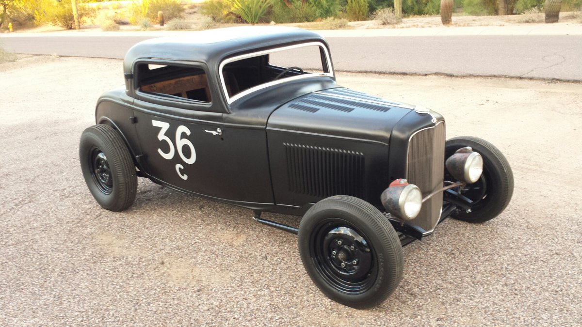

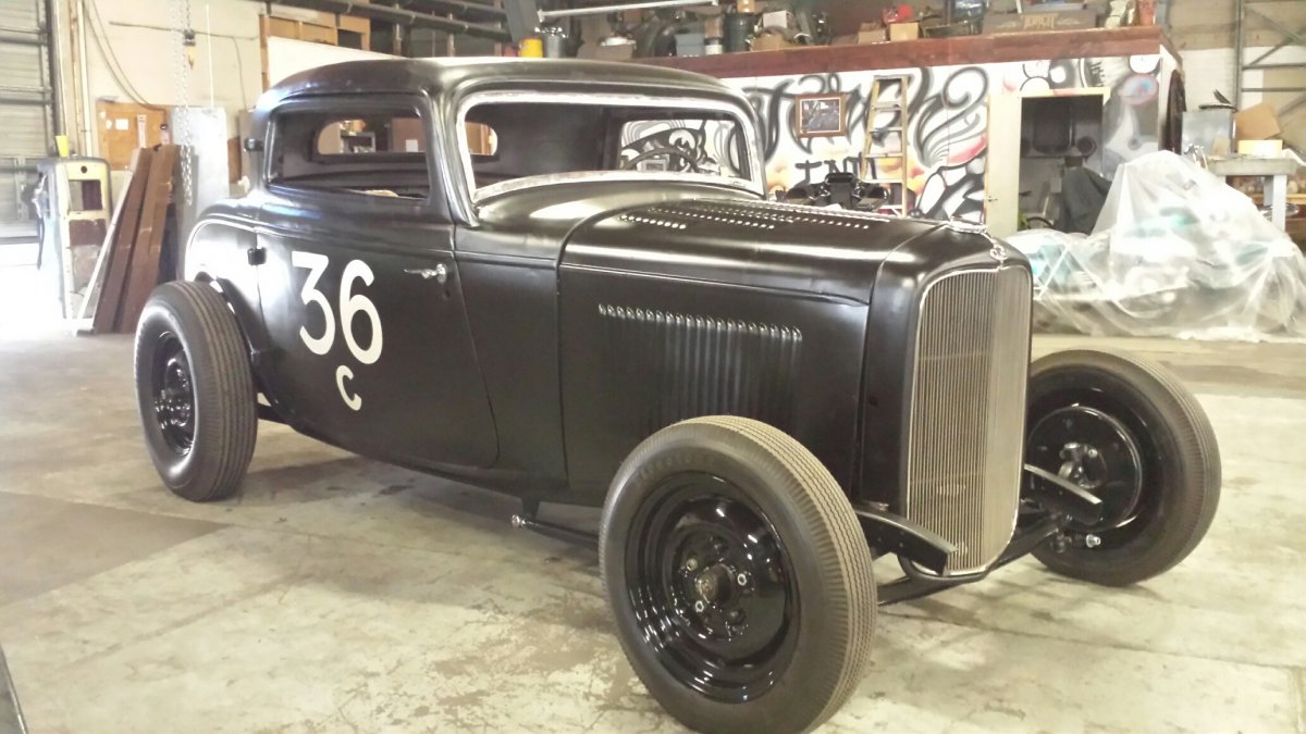

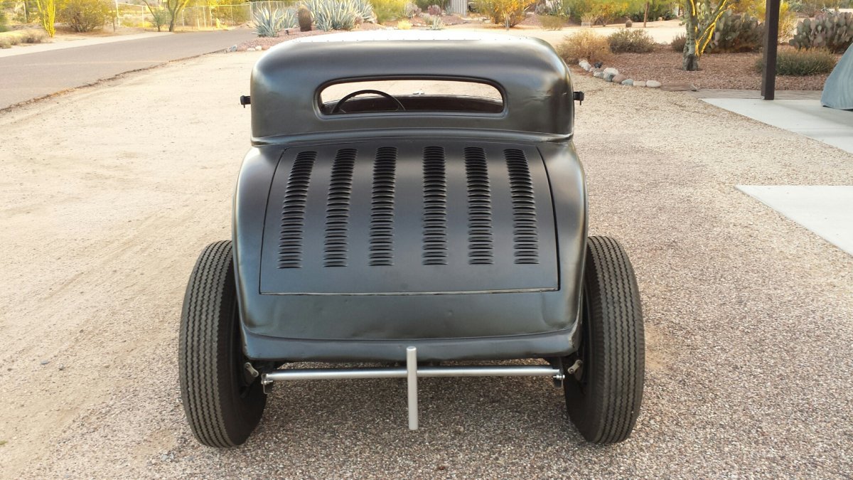

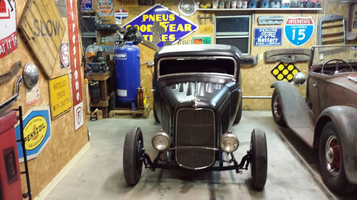

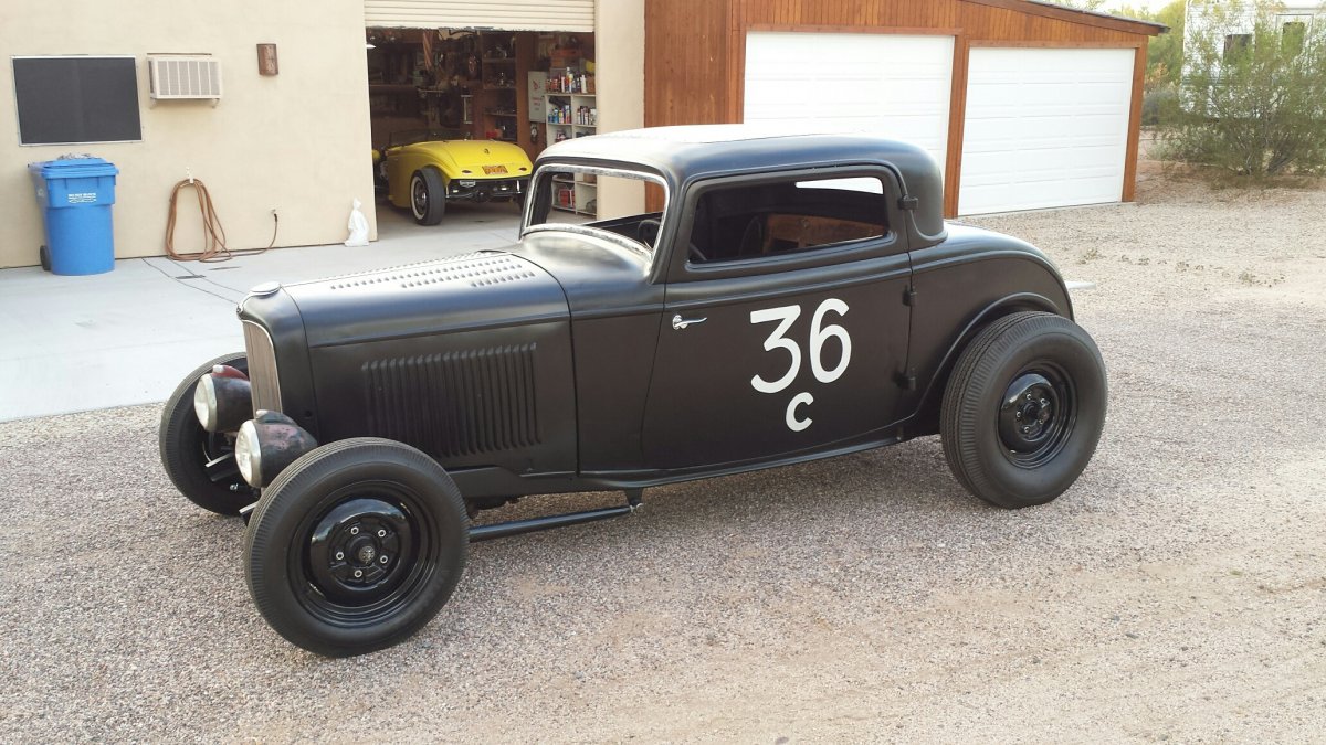

    Well I got the coupe home last night and it is the first time in daylight for 2 years, wipped the dust off and got some pictures....
    I had to put my original Deluxe horn ****on on as well.......
