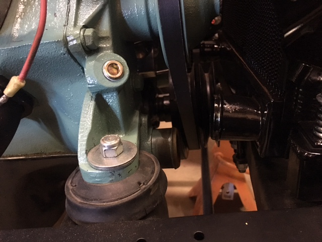

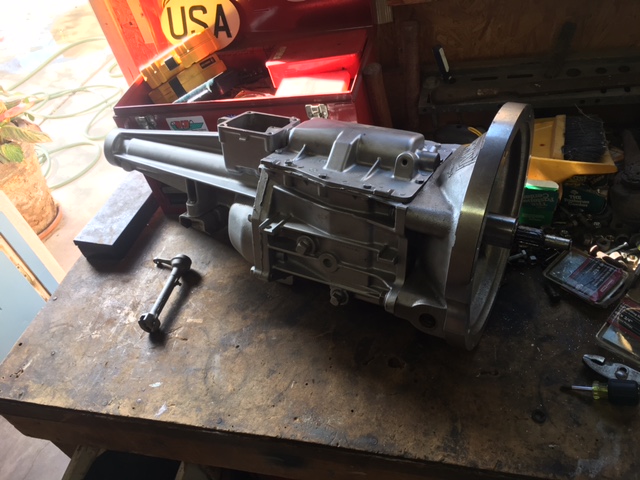

    UPDATE 12-11-17......Well I got my flathead back from Wayne and he got it all dialed in on the test stand and the tuned the Stromberg 48 carbs, I had the S-10 T-5 resealed and mounted it to the engine last weekend so Saturday I went ahead and stabbed it in the coupe with the help of a neighbor, unfortunately I ran into an issue with the rear transmission mounting holes that were drilled for the SBC when the frame was originally built were too far forward by like 2 inches, so I have to re drill them further back and build an adapter plate because they would be right where my rear '36 wishbones forward mounting tabs are, apparently the flathead/T-5 combo is actually longer than an SBC and there are no adjustment holes like the hurst saddle mount had ,no big deal just takes more time.... IMG_0632.JPG IMG_0634.JPG IMG_0645.JPG IMG_0648.JPG

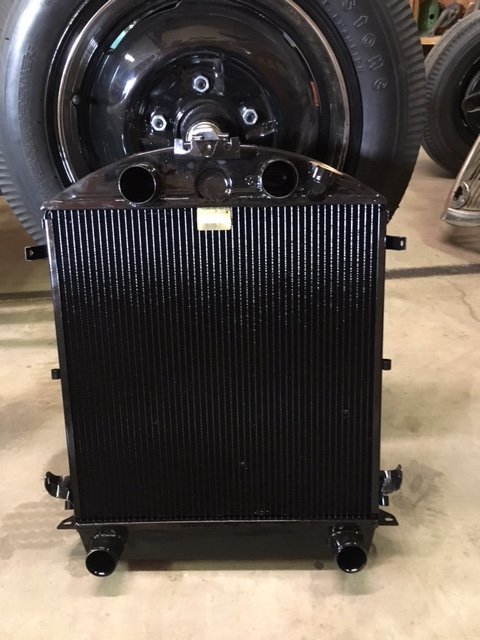

    Thanks El Roach.........................I bought this used 3" chopped 4 core Walker 32 radiator for $300 for my 2 inch channeled coupe when it was going to be SBC powered a few years ago so just I had it converted to dual inlets and outlets for the mighty 276 ci Mercury Flathead.............the only bad part is the delivery girl dropped it and dented the top tank so it is back to the radiator shop to fix their mistake. IMG_0646.JPG IMG_0647.JPG

    UPDATE 12-18-17: Spent Saturday building an 3" x 4" adapter plate that relocated the transmission mounting holes forward to the original mounting location, IMG_0650.JPG I then centered the transmission in the X-member and re drilled the holes, bolted it up with grade 8 bolts so the engine is officially in place...WOO!! HOO!!.... so then I fabbed up some basic radiator mounts to locate the radiator in the proper place to run a louvered full hood which is a must. IMG_0665.JPG so you ask why did you need to do this ??? Well here is the why behind it, First my Walker radiator is chopped 3" and my car is only channeled an 1 1/2", also since my chassis was originally built for '60's style SBC powered hot rod with no hood we lengthened the wheelbase by inches to 108" to give us some radiator clearance which I think looks better on fender less Deuce, so my problem was I needed to fab some mounts that raises the radiator 1 1/2 " taller and that moves the radiator back 2 inches so the stock hood will fit which is a must on my car.

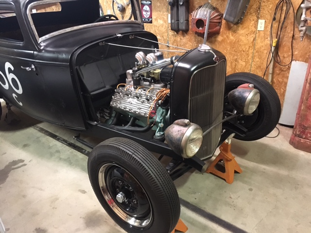

    HAPPY NEW YEAR UPDATES......Well I decided to stop ignoring my family and take a little time off between Christmas and New Years but I did sneak out to the shop to get some work done. First thing is the lower water neck connection on the radiator needed to be angled down to clear the water pump belt IMG_0671.JPG so I dropped it back off at the Radiator shop and had them tilt the lower connections 25 degrees down which did the trick. So I uses a set of 49' Ford car lower hoses 8BA style that I cut down dramatically to make the connection and they worked great and even had the FOMOCO logo on them so they look better too.... IMG_0712 (003).JPG
    Then I decided to clear my headlight bar in satin and run it in the bare metal look since I am not ready for chrome or nickel plating IMG_0683.JPG
    I also mounted my new Bee Hive oil filter on the firewall, then I installed the upper hoses, grill shell and mounted my headlight bar with stainless hardware IMG_0678.JPG IMG_0719.JPG IMG_0721.JPG

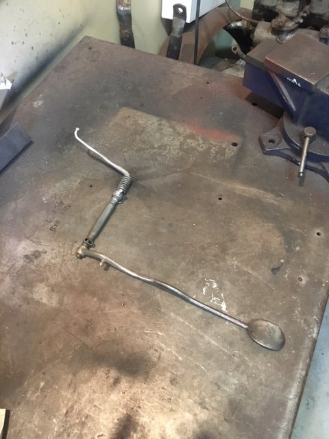

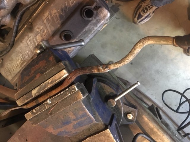

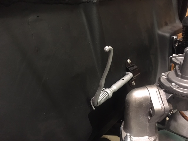

    Weekend Updates: Well I got some work done in the shop on Saturday, first order was to get a throttle pedal linkage set up for my coupe. So I found two '32 V8 pedals from a HAMBER ( thanks Bill!!) on the east coast and decided to modify the one with East Coast acne ( rust pits) IMG_0780.JPG
    Since the original firewall in my car came from a heavily channeled car it locates the stock throttle linkage mounting position much higher, so I needed about 5 inches additional pedal length, so I cut the spoon off the original one and cannibalized another $10 swap meet spoon pedal to make a longer version IMG_0781.JPG
    , I also had to cut and rotate the throttle pull to pull from the outside instead of the factory inside position to work with my 2x2 linkage. Here is the finished product that looks and works well IMG_0796.JPG IMG_0799.JPG IMG_0808.JPG

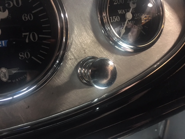

    Then last night I got this USA made 2 position ignition switch that I can use with 1940 style push button starter button off ebay which is really cool, Cole Hersee branch made in Boston, its a brass one that is used on boats but has a very vintage look and the key is even retro looking
    Then I installed this cool art deco headlight switch I got from Mr. Dash on ebay that I think looks great in the car and fits the build style
