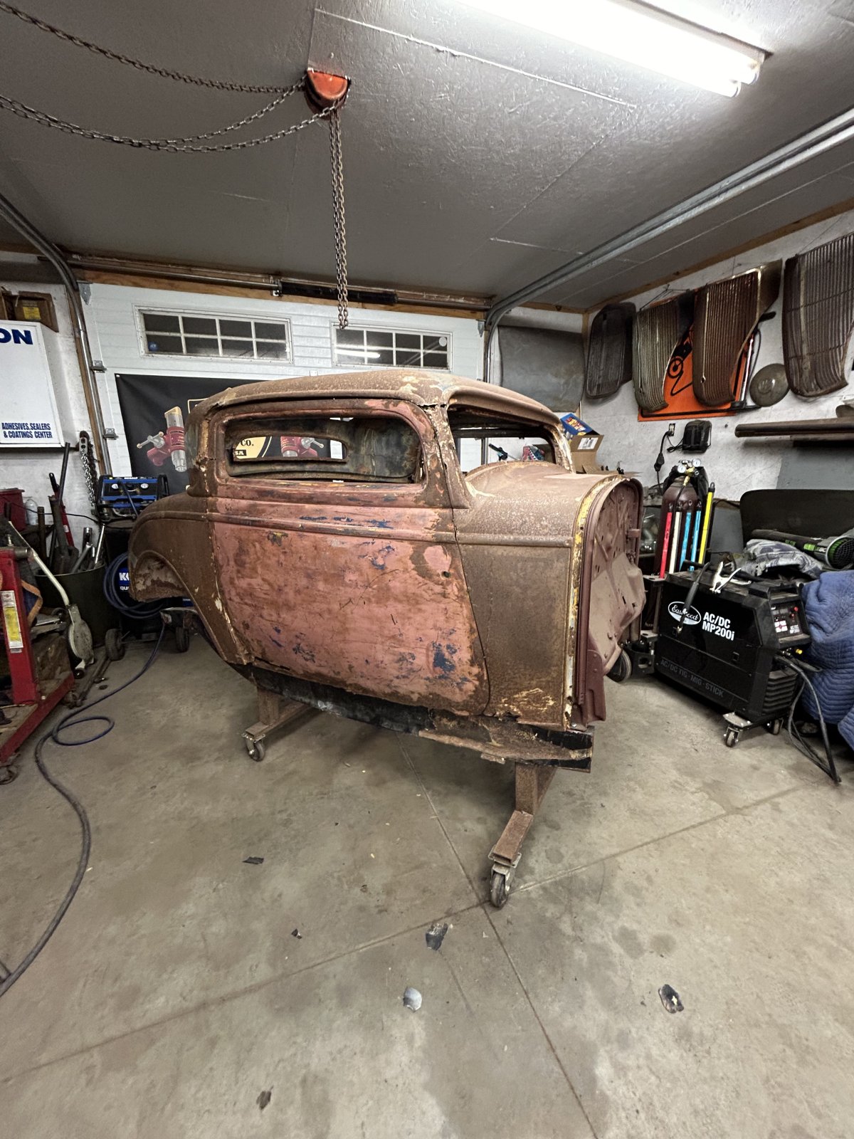

    Hello All,
    I am lucky to say the least to own one of hot rodding's best. A real 1932 3w coupe, or what's left of one. haha
    So here it is...
    so there are holes on the roof, welded doors, and a decklid area thats been removed. the holes on the roof are very distinguishable. havent found any pictures of the car yet but if anyone has seen this car please drop some info.
    EVL401, Joe Blow, Stogy and 37 others like this.

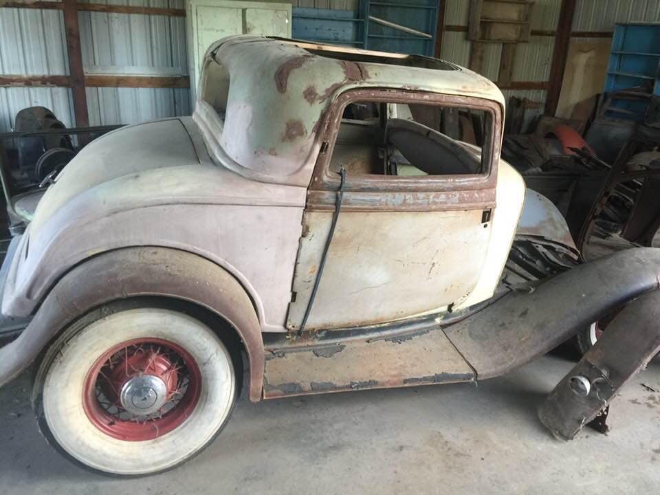

    Reminds me of this car
    If anyone has any pics from back in the day of 3 windows with a similar chop in yellow or blue post up pics! Most likely east coast car but ya never know

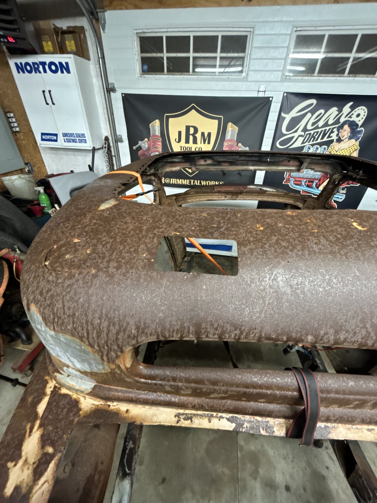

    here are some pictures of the B pillar that was used in this car. it seems to be a 28-29 Closed car A post. with Model A engine mounts used as feet. pretty neat but i wont be using them. just cool clues on the history of this car.
    also heres a better picture of the roof where the cage cut outs are.
    its nice that this car still has the header and dash structure in it.

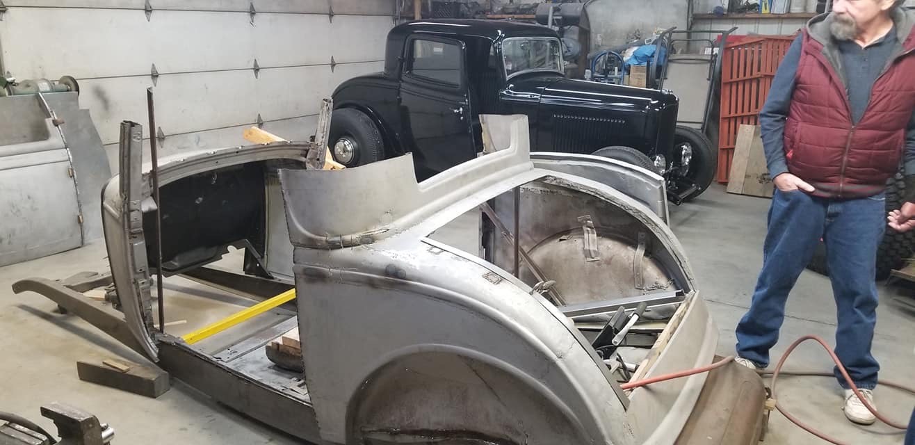

    My 32 was in similar shape when we started on it a few years ago. I had little or no jambs so I bought the tins from Brookville and welded 1/8th flat steel to the back of them and then reinforced them where needed. We had to cut the body apart and fit it to the doors on front, back, top and bottom. My car was in Andover Kansas in 2017 but I have no history before that. I wish I had pictures of it right after it was sandblasted. It can be done with enough time and patience.

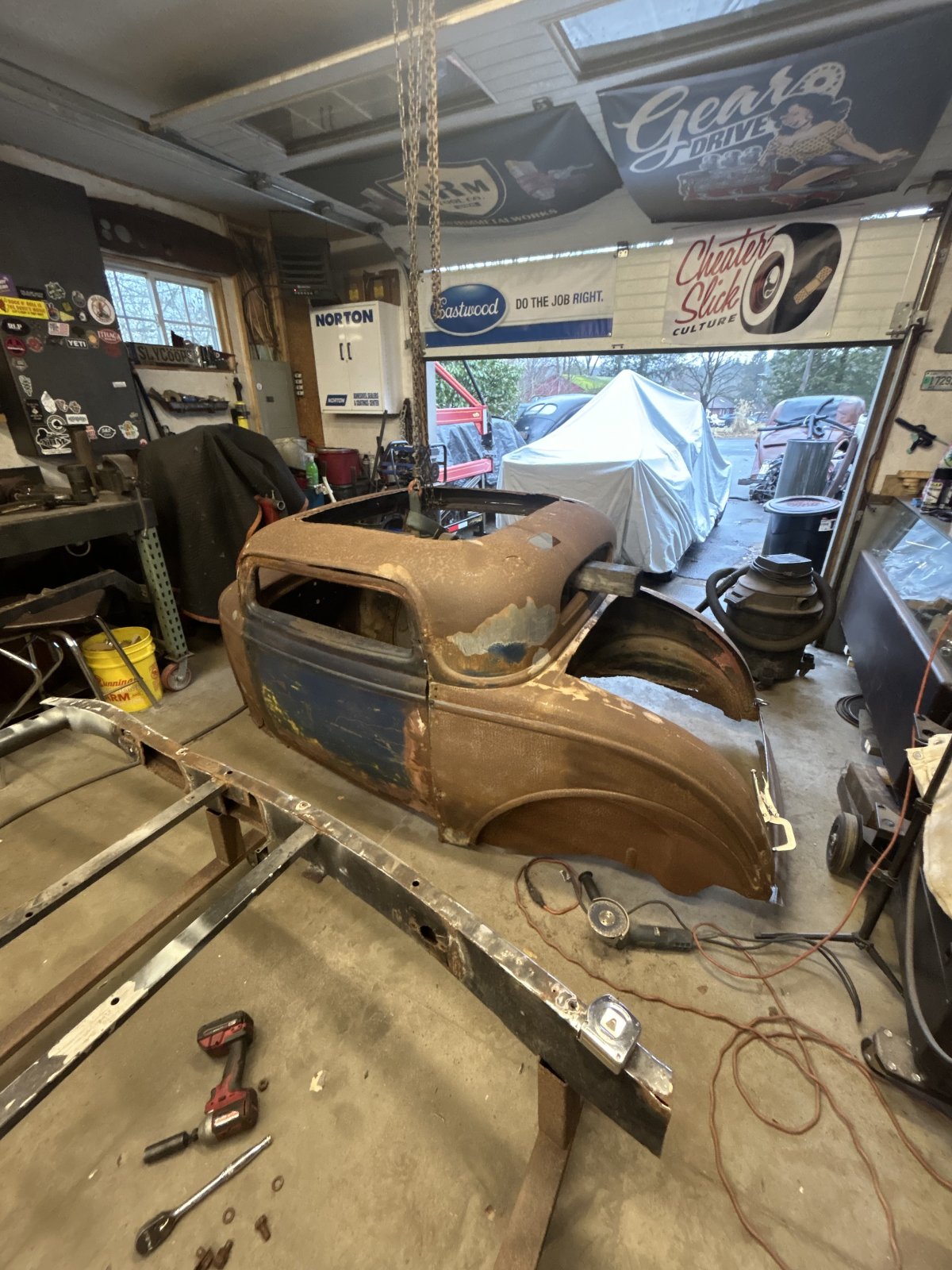

    been collecting parts at the moment but i think i have enough to get started on something.
    this is the first piece i started fixing. picture above is after, picture below is before.
    i want to save this piece as a buck/template for dies and such for making my own roof corners.
    my wife Kelly and I are working nights on the car so progress should be steady.
