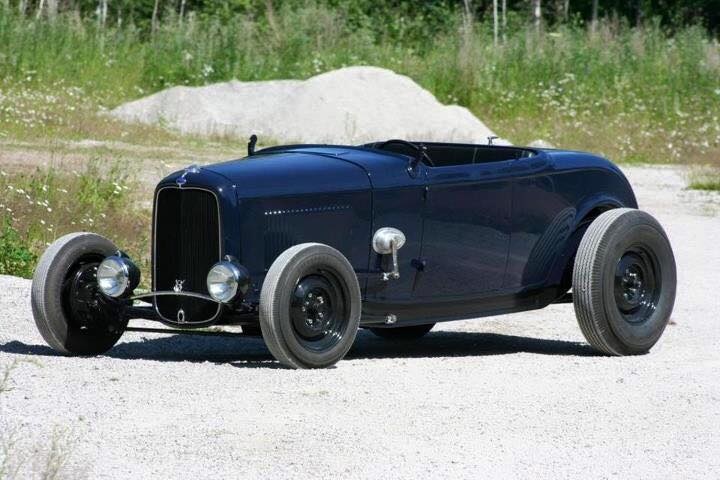

    I can measure my roadster door openings if you want, the back is close I believe the back pannel above the decklid is 8" longer thus shorting the ****pit about that amount , the decklid is clocked slightly different as the lower pannel is also slight different
    The major differance is the cowl top and the reveal and the rear quarter fender reveal , the rest could be fudged and nobody would probably know
    You start breaking records though and people will get their measuring tape, frank currie got dis qualified at bonneville in a record runbecause the bump under the windshield wasnt there I believe image.jpg

    If you are going to go fast and plan on breaking records make all precautions nessesary those old guys don't like giving up their records and will snivel and protest at any means possible , STR and a few other cl***es are the most picky ... So read the rule book inside out..
    Ron Joliff had some issues with rules and old timers on his 34 , finding loop holes are frowned upon ...especially for the new kid on the block
    Was kinda BS what happend to Currie but rules are rules

    This is probably not a big concern of yours but as "thirty two" said coupe and roadster rear wheel openings have quite different shapes, with the roadsters' quarter panels having much more of a flowing radius down to the opening.
    Google George Poteet 5 window with roadster quarters.
    Masterfully done by Dave Lane @fastlanerodshop.com
