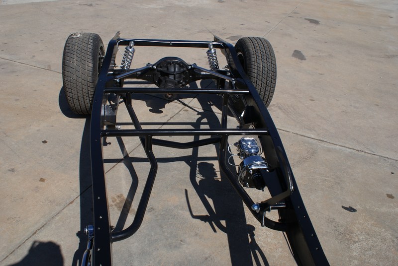

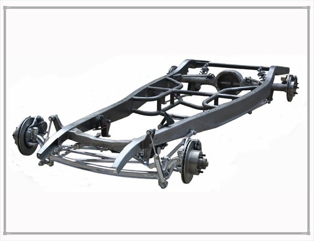

    I wouldn't consider a body without the inner bracing. Also well aware of the amount of work to get the body right before paint.
    Guess it will come down to whether I want/need the flip out windshield and working cowl vent (currently considering the New Age) or without (Downs). Once I decide on the body I will start beating people up on ch***is. Some are single tube some are double tube. I would think the double tube would be much stiffer and overall better.
    3 pictures are 3 different builders. 2 are single tube center crossmembers and the last one is dual tube. Thoughts there?

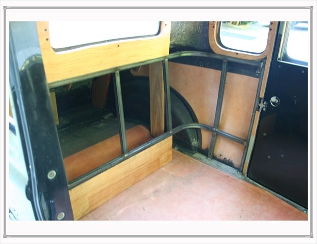

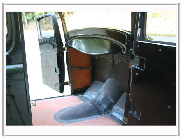

    Same on body bracing. Everything from 1-1/2" round with 1/4" plate to 1" square with hardwood.
    First 3 pictures are NAM, last 3 are Downs.

    Personal opinion, but I'd go with single tube it makes routing your exhaust easier and IMO will be just as rigid. I boxed an original frame and added a 2 x 2 trans crossmember with just two legs toward the rear, looks like a backward K member. It's been driven all over the Midwest and is extremely rigid, never an issue with creaks and groans or doors popping open.
    BTW, the inside of that New Age body is about as close to stock appearing as you can get. Nice!
