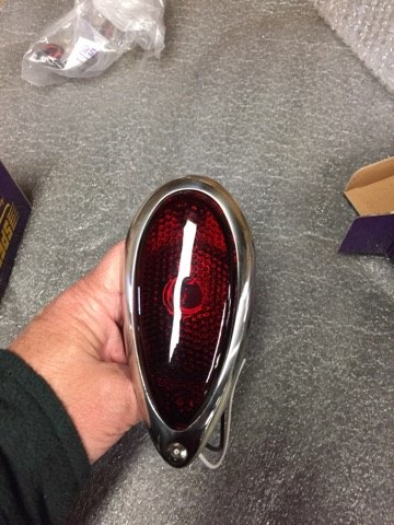

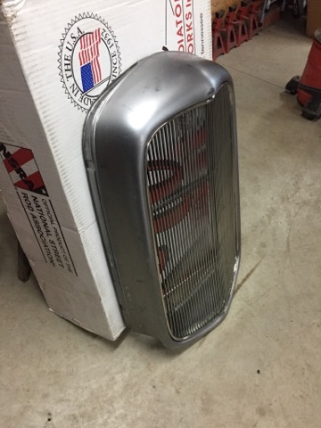

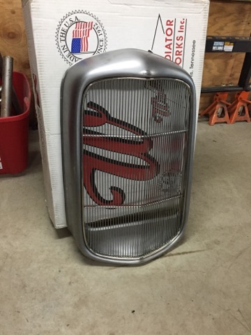

    Grille shell and insert from Brookville are here. Very nice.
    Walker radiator is here.
    Tanks Inc 11 gallon tank is here. Also got the tank gussets.

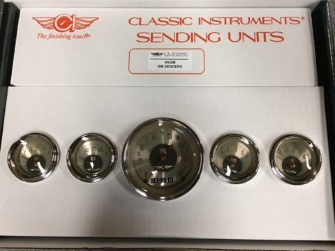

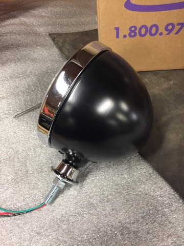

    Got my gauges, steering column, lights, tires and wheels.
    Rebuilt the C4.
    Got the SBF down to 29" bell housing flange to tip of fan. (Wanting to keep mech fan).
    Should be fun!
    Thanks to all the responded, I really appreciate everyone sharing their knowledge!

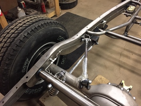

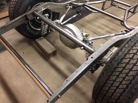

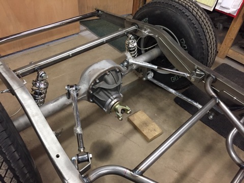

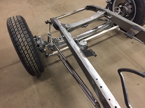

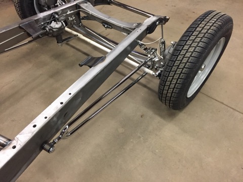

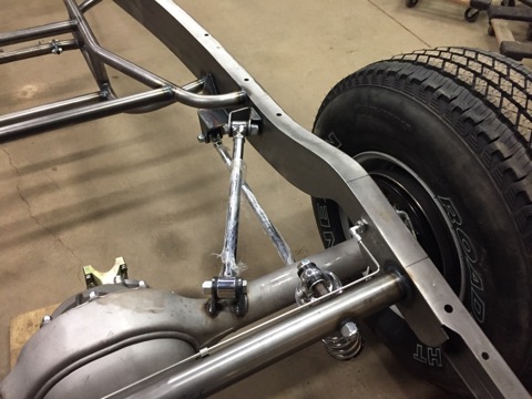

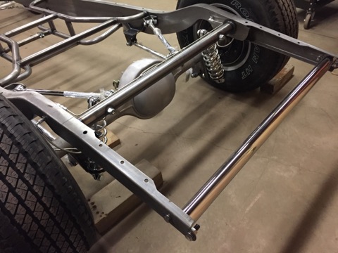

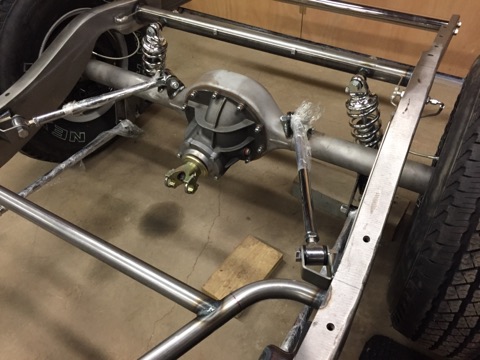

    Brought the ch***is home last Tuesday. Didn't get a chance to post due to holiday travels and ****py internet.
    SPark

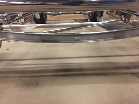

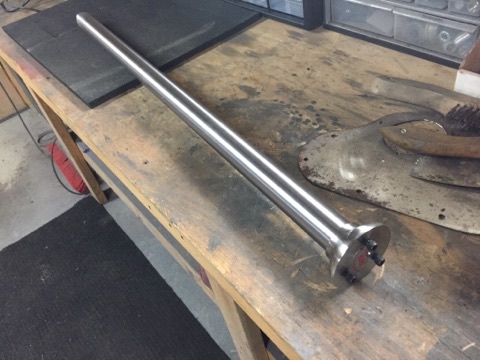

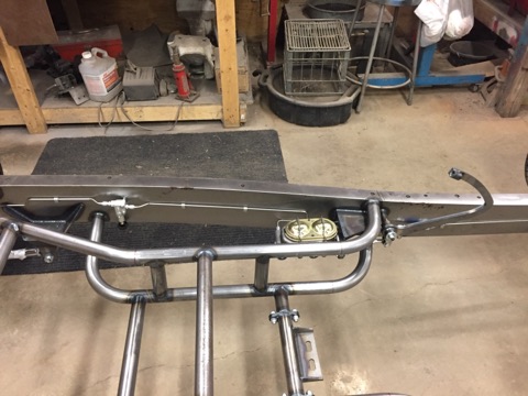

    Another update. Exhaust mounted, all stainless. Fuel lines routed and most of the clamps in place. Again, all stainless lines with bulkheads on each end of the hard line and switched to -6AN push lock hose on each end. ****** cooler lines run. Again hard line converted to -6AN PTFE flex lines at the front and hard line the rest of the way back to the ******. Gaining ground.
    Still a few clamps and brackets to make. Finish weld the exhaust. Talked to the driveshaft shop last week and they are waiting on the exact measurement. Need to set pinion angle and get that going this week.
    Appreciate all the feedback early on and now we're waiting on a body!
    SPark

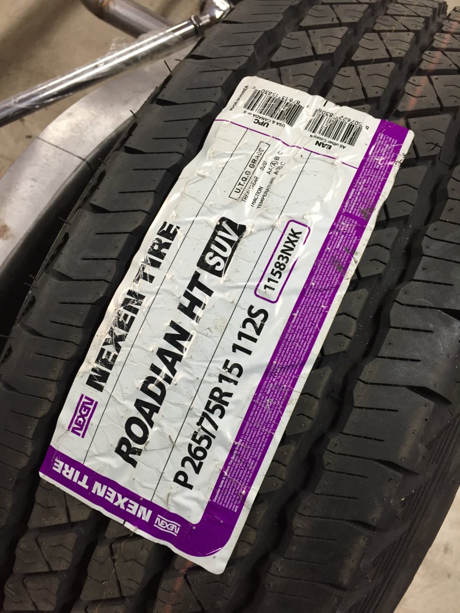

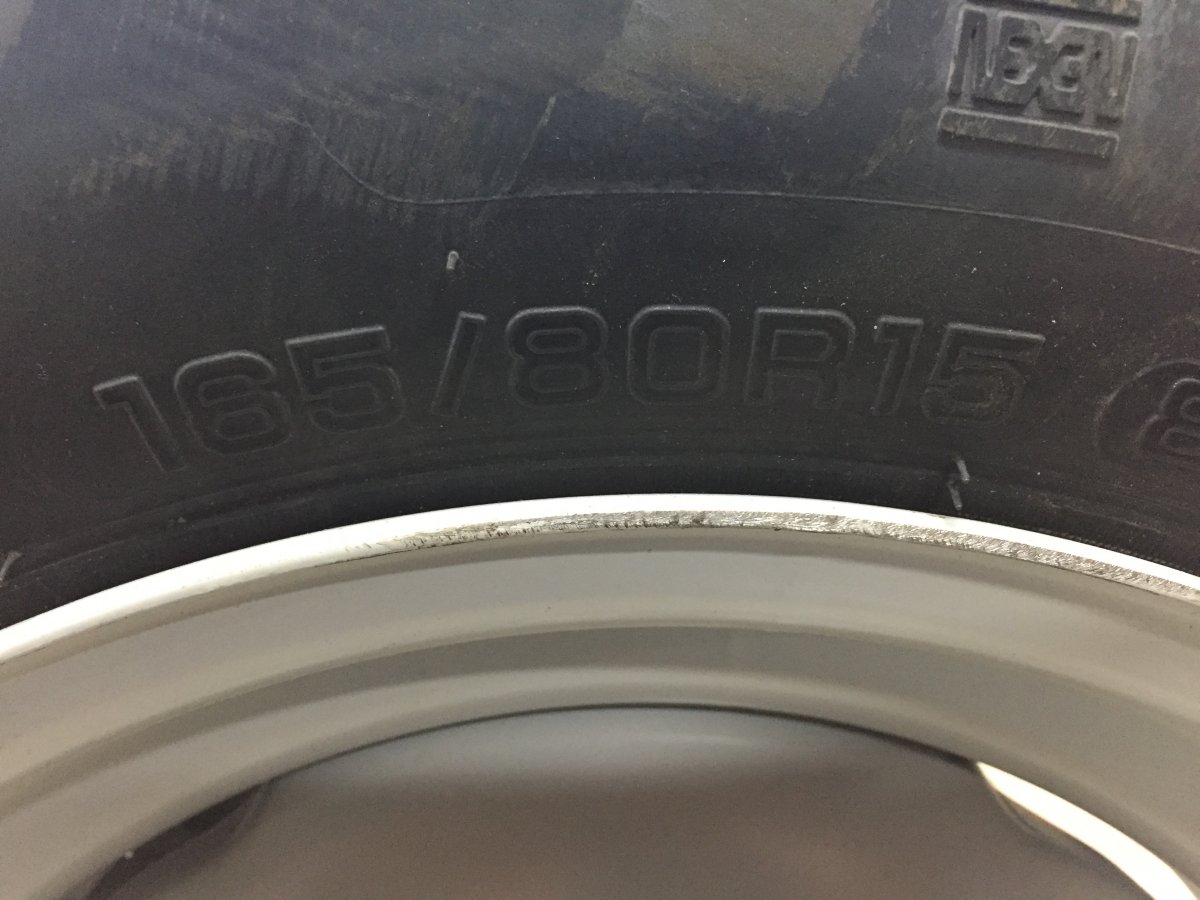

    Looks fantastic! Could you give tire details please?

    Put a little bit more loop on the rubber hose from your tank pickup so you can pull the tank out of the way and reach the clamp for removal when the body is on.

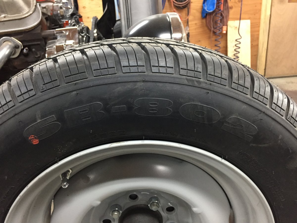

    Pics of rear tire sticker and front tire sidewall below. Rear wheels are 15x8 and fronts are 15x5. Wheels Vintique series 14. Will have ribbed trim rings and 41 to 47 Ford center caps eventually. Haven’t decided on the year yet.
    I will have an access door in the trunk floor and should be able to reach it from the top side thru that hole. Will also let me plug the line before removing the tank that way. Gives me access to the tank outlet and sending unit without removing the tank. That’s the plan at least.
    Thanks for the feedback. I appreciate it.
    SPark

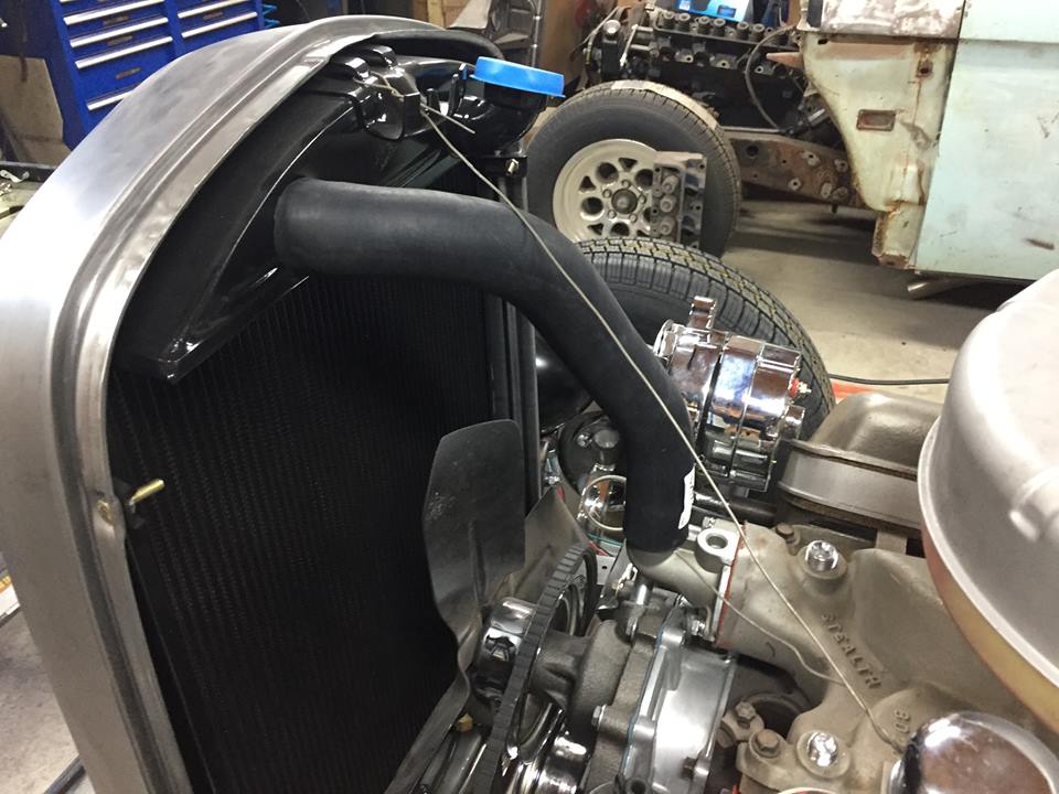

    Put a sleeve thru the left front upper crossmember tube to ease running the fuel line. Big enough to pull the -6AN fitting thru with the hose connected. One of the drawbacks to the SBF engine is having the fuel pump on the left front. Have to run fuel lines with brake lines and pedal in the same area. Figured this was a decent way of doing things.
    Also found a nice fitting set of radiator hoses. Only needed to trim the upper hose a couple inches on one end and the lower hose is the center 90* bend from a long hose I cut up. Look like factory made hoses.
