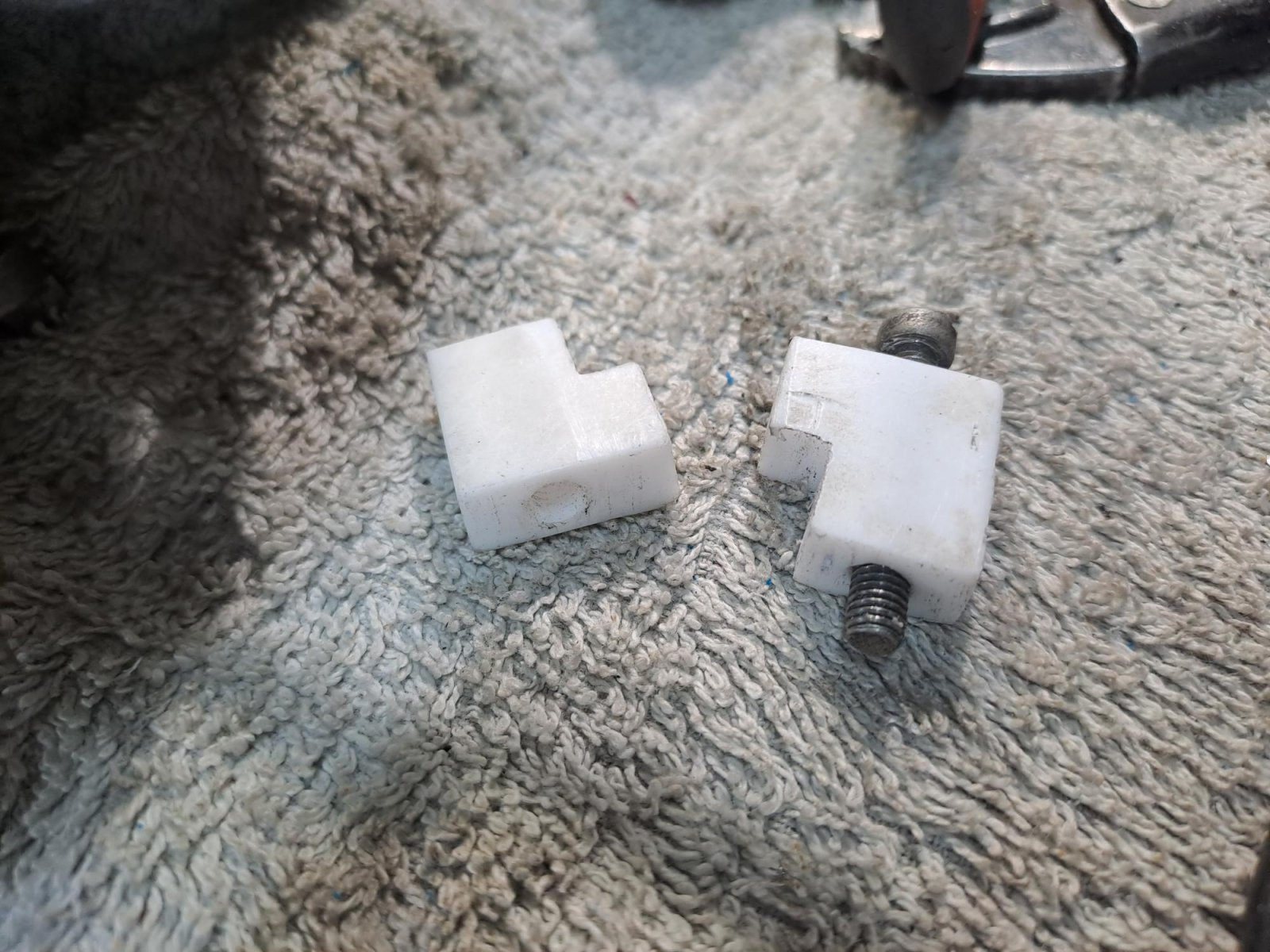

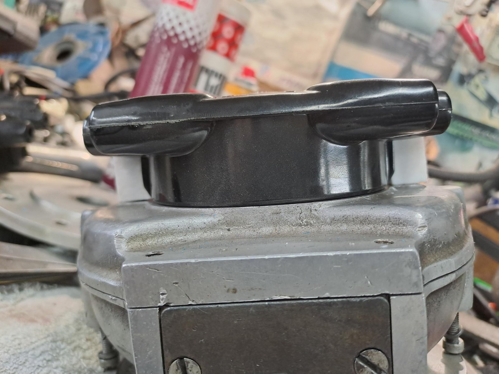

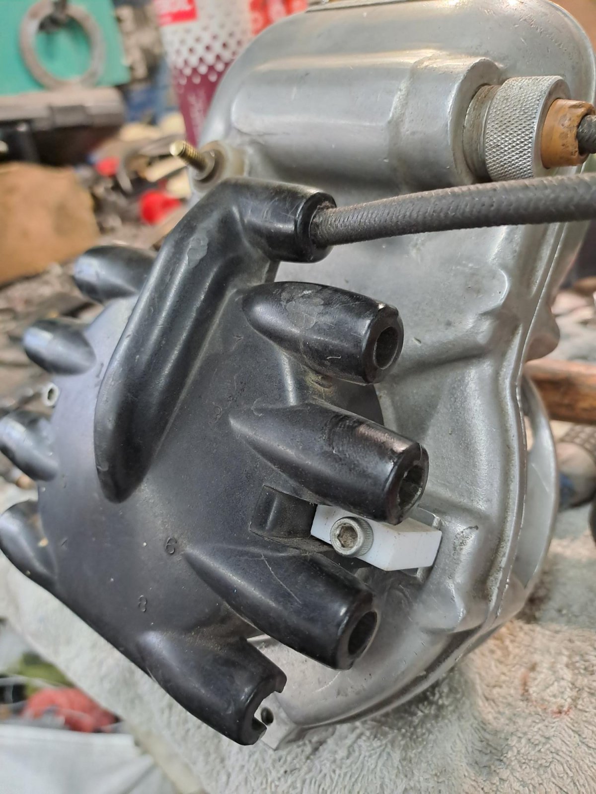

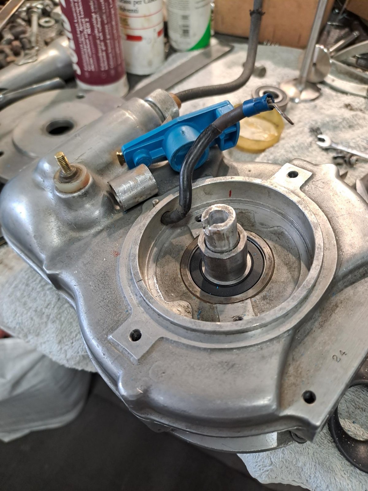

    Today i continued with Harman Collins magneto. I made adjustable rotor and distr.cap holders.
    Aulis
    rod-coupe533.jpg rod-coupe534.jpg rod-coupe535.jpg rod-coupe536.jpg rod-coupe537.jpg

    interesting way to dial in some advance!

    Been years since I messed with mag on a vette; but seem to remember always set at max advance that why hard to start on street duty. Manually retard to start they let in advance. Guess Audi’s has this one set to start & somehow he has added advance mechanism.

    Harman Collins mag hasnt advance. I have never need that. Flathead total advance is +20dec, easy fire up engine cold or warm.

    you can move the rotor instead of the mag housing--same result--and your english is every bit the equal of mine!

    I do not understand the purpose of the mag & rotor add on if the mag is always set at 20 degrees advance. Been years since I used one

    Everybody has own opinion how to built car, how to adjust magneto....
    I do my way, have had 5pc those Harman collins.
    - First engine turned 24-25dec advance. 20dec makes more heat. Need to remember that if you have good new parts in Your engine, engine is internal balanced etc etc. 24-25dec is not very much. Of course need to have good cam, lobe maybe 112 - 114.... and of course good quality fuel, unlead with good RON
    - Second bottom plate need to turn right position. If You want strong spark, need to be installed just right position, then gives all "load" out. I use little smaller points cap than magneto manufacturer is told. Also coil need to be recoiled because those +70y old coils are leak (maybe work fine when cold, but not give spark when warm)
    -Third. Now advance is OK, magneto position (points opening timing) OK.
    Adjustable rotor: I can be sure that rotor shows direct to cylinder nr 1, I turn it and tight with stop screws.
    That is my way to do it, maybe wrong, Im just trainee
    Aulis
