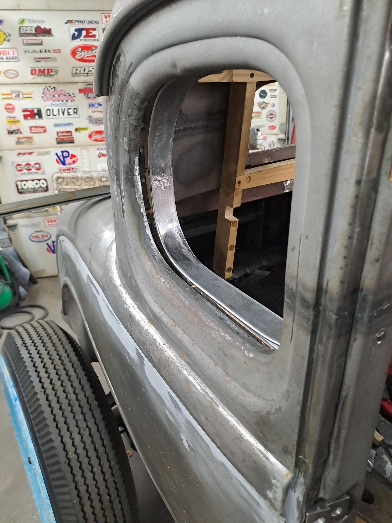

    Driverside ready. When chopped top, I stretch it 19-20mm (3/4"). Now Need to drill all mounting holes new place.
    Quarter window woods I have chopped 90mm (+- 1mm).
    Rear window I chopped only 70mm, less than top, because many times rear window hole look more or less "mailbox" opening.
    sheetmetals above doors fits good. Those I have also stretched 19-20mm.

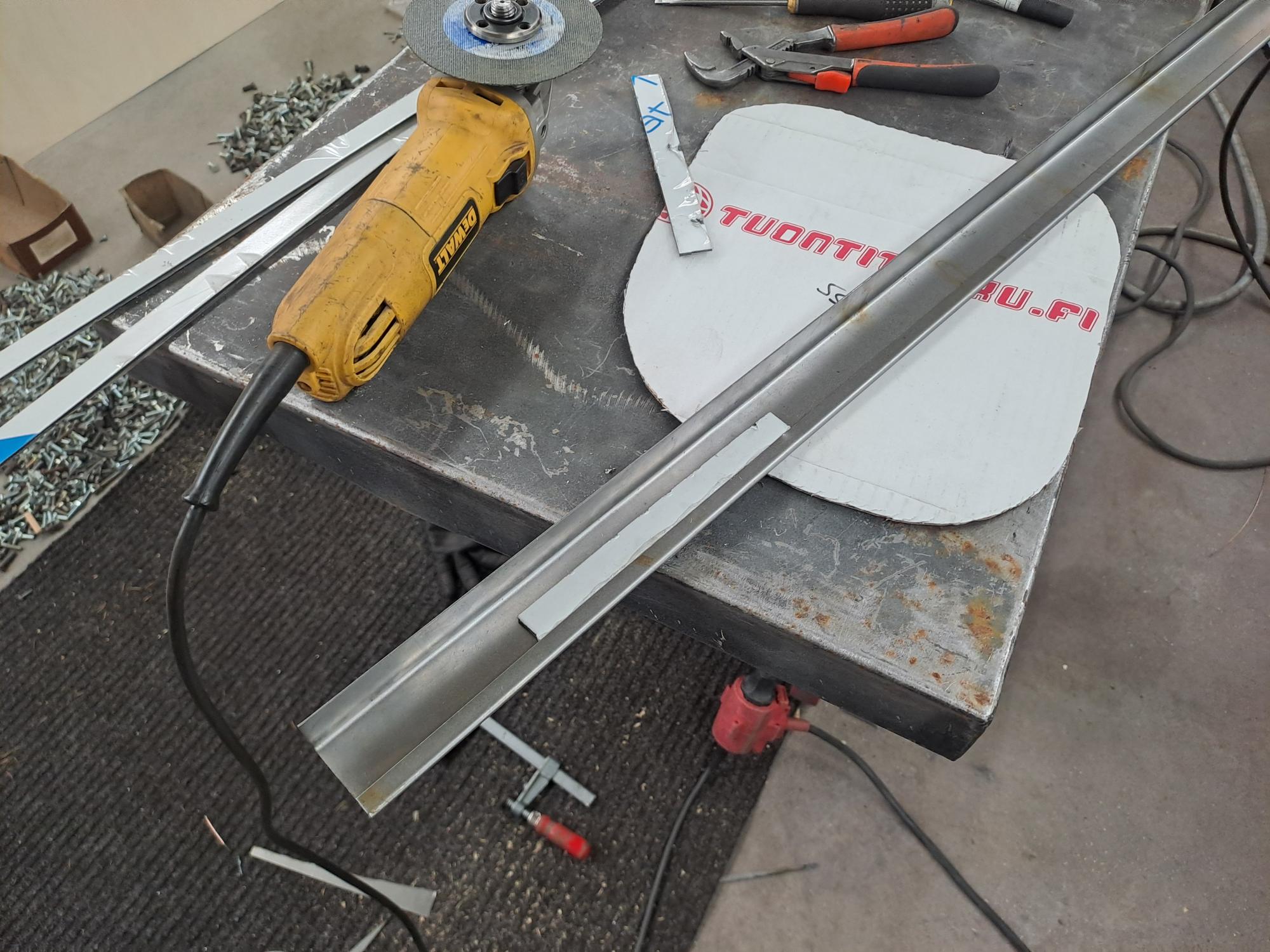

    Friday I made DRV side garnish moulding.
    Now , Monday, Im just welding P*** side.
    Rgds,AULIS

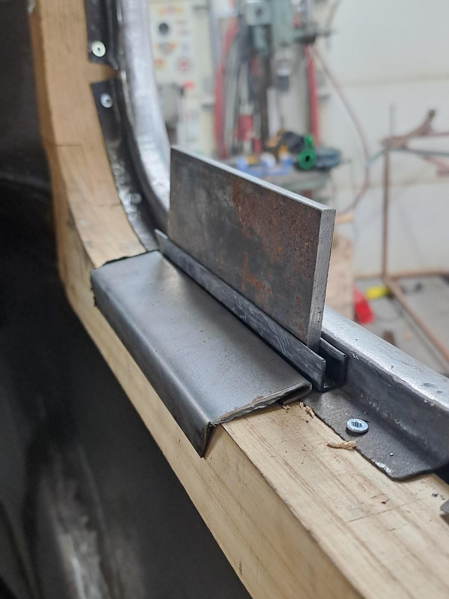

  7. AULIZ
    Joined: Oct 28, 2005
    Posts: 1,793
    AULIZ

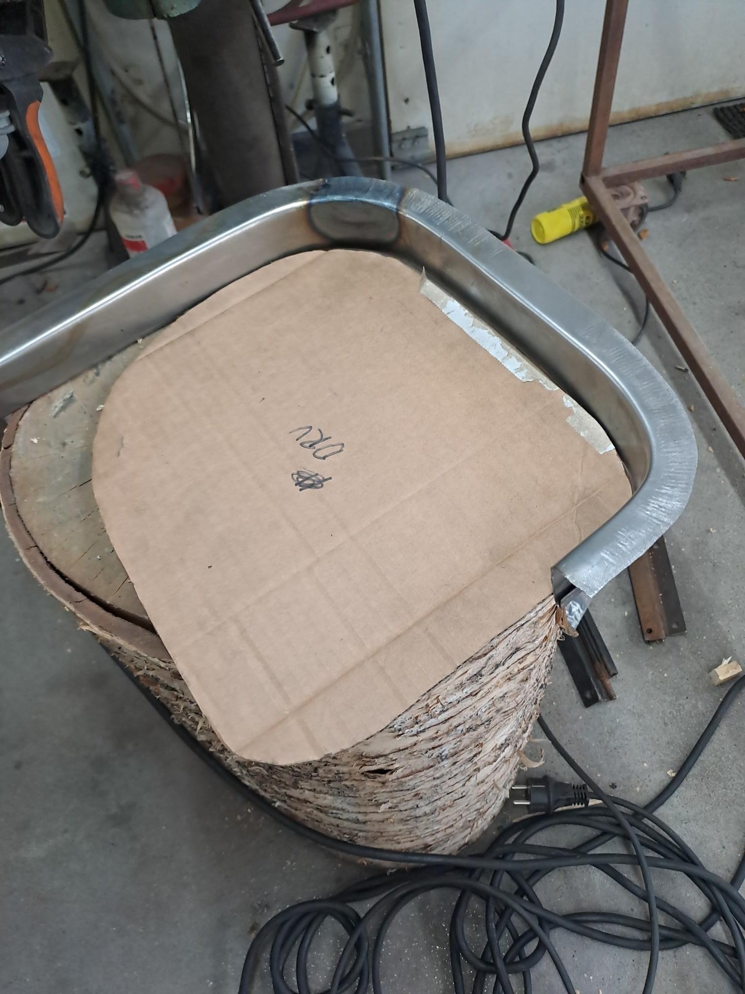

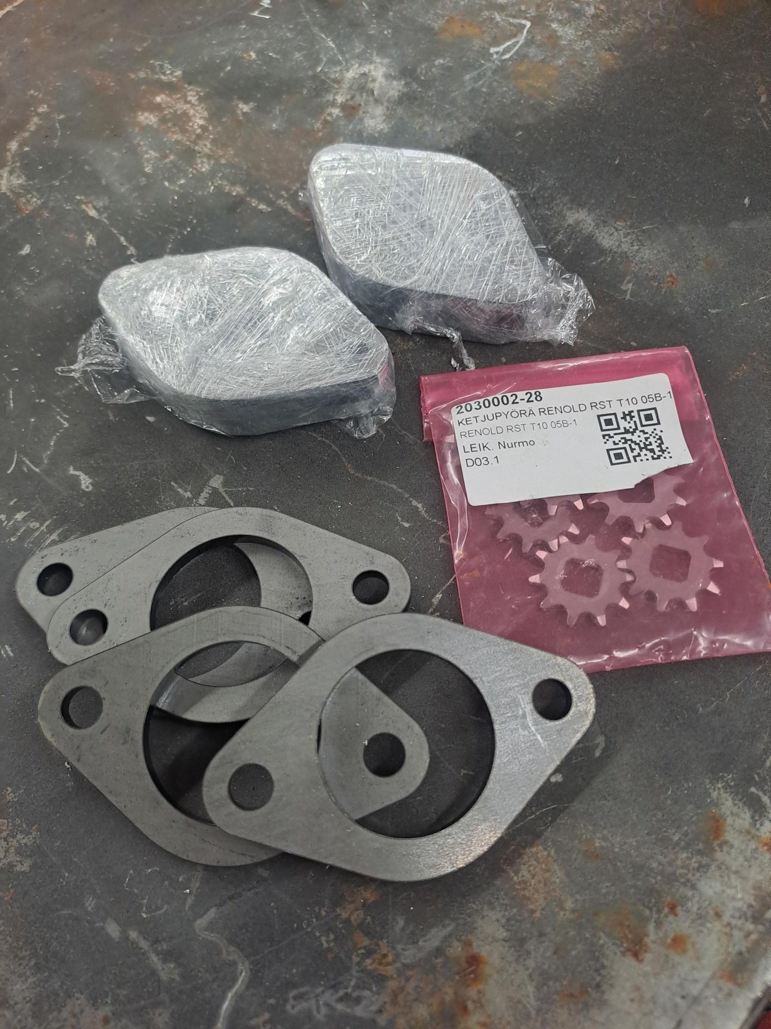

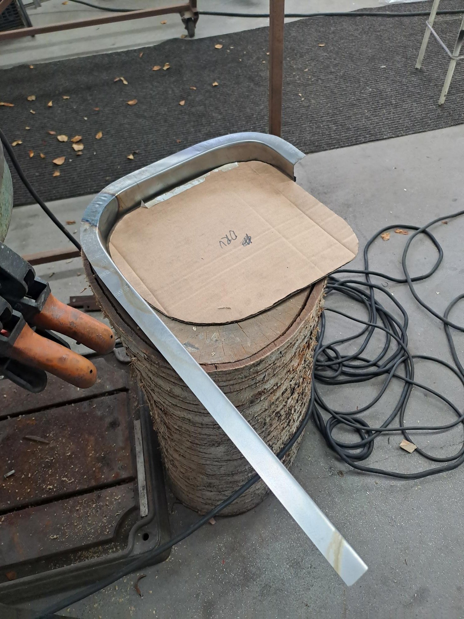

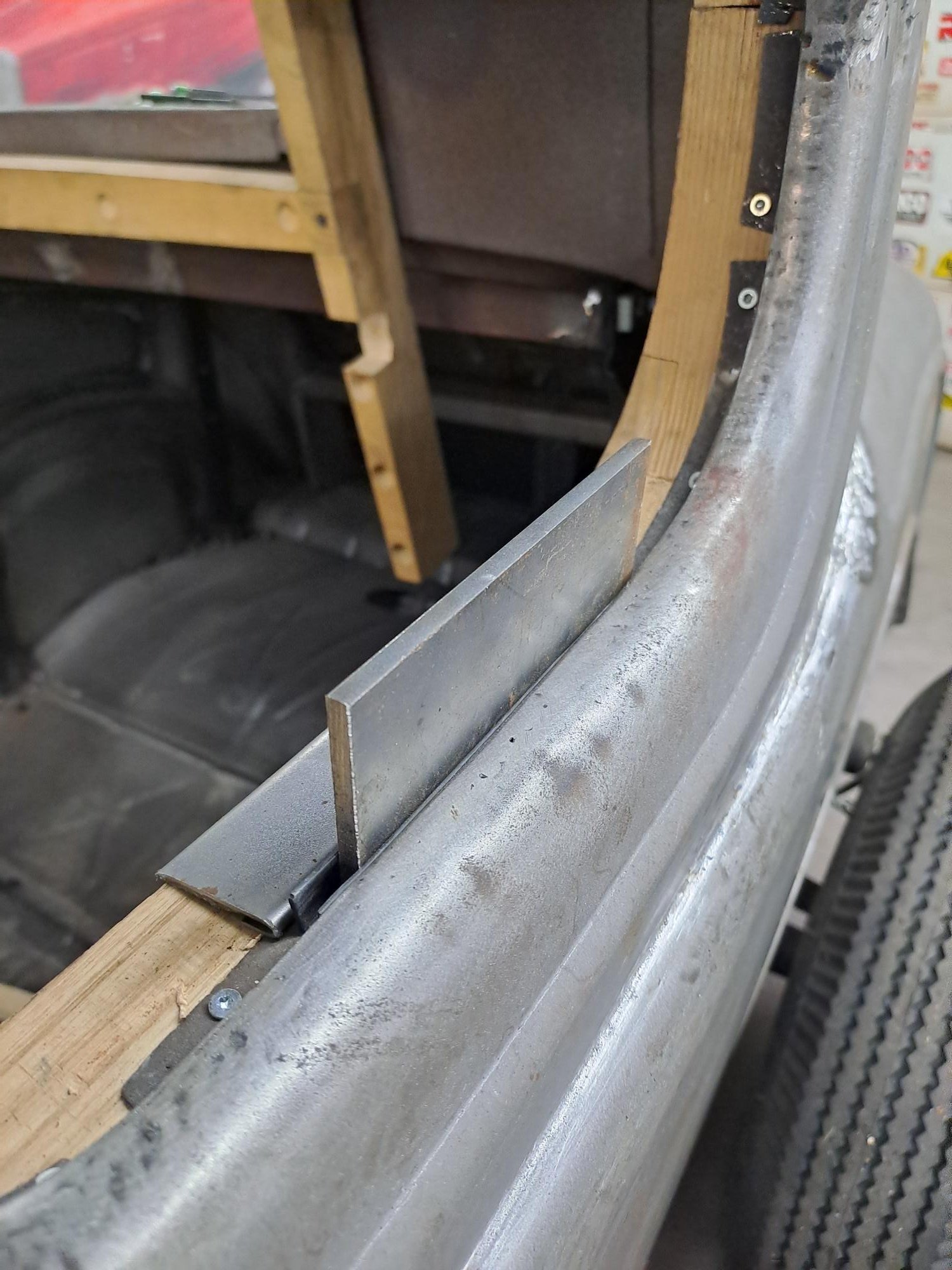

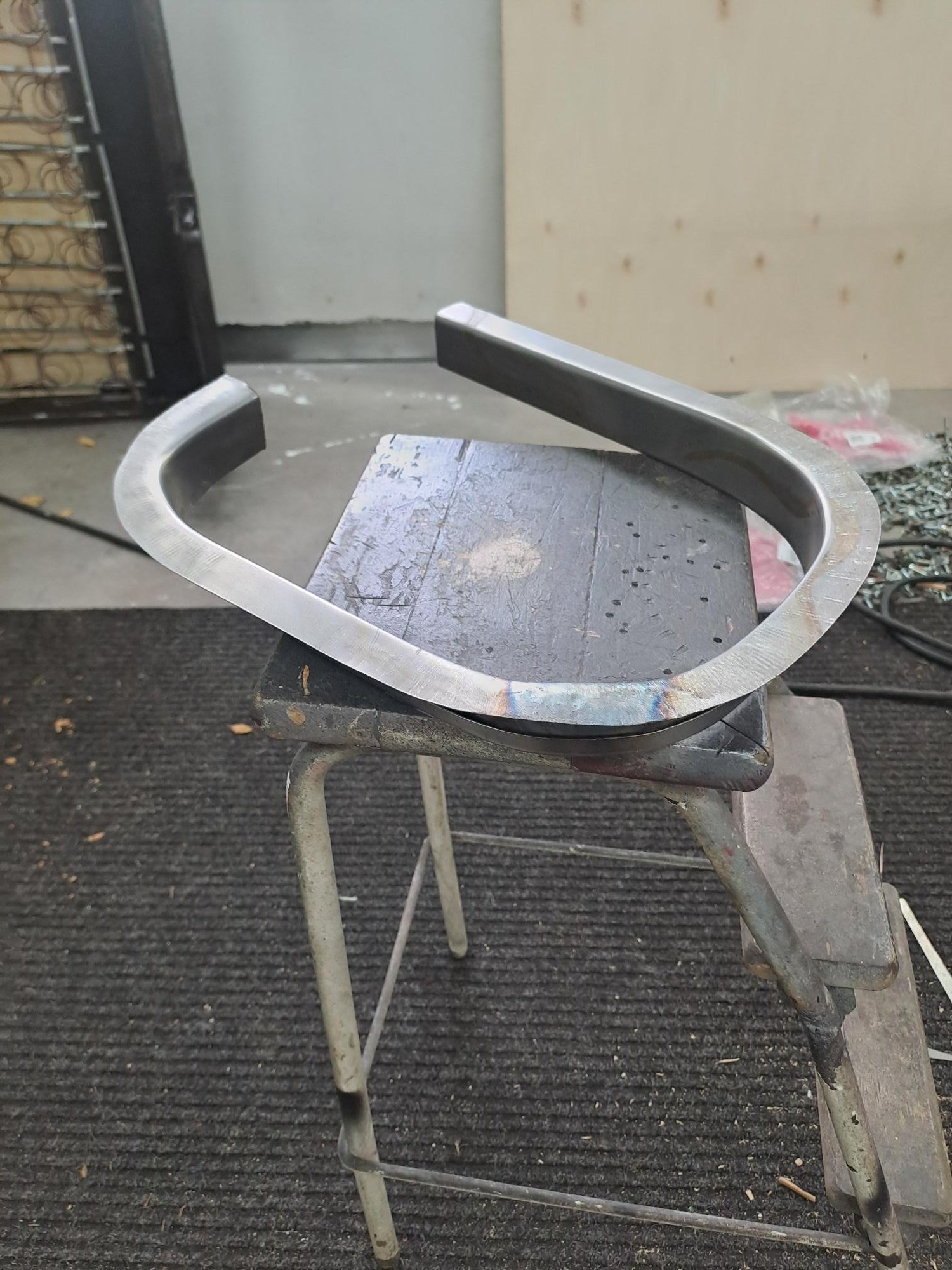

    Monday P***anger side garnish moulding.
    Tomorrow quarter window mouldings. I have two width garnish moulding material which I have turned in my friends company where they make tubes/c****s for bigger buildings air condition/climate control. They have big automated benders.
    Tomorow morning I drive there and made 3meter 5mm wider. Two last pic: I install 4mm plywood between garnish wood and garnish moulding. That´s why need to made wider garnish moulding material.
    first pic: One friend has company which makes machines to food industry: They laser cut me header flanges. Good quality.
    Aulis

  9. AULIZ
    Posts: 1,793
    AULIZ

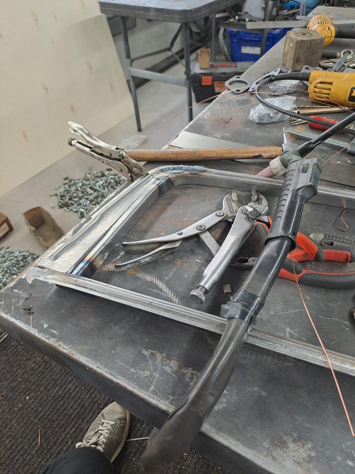

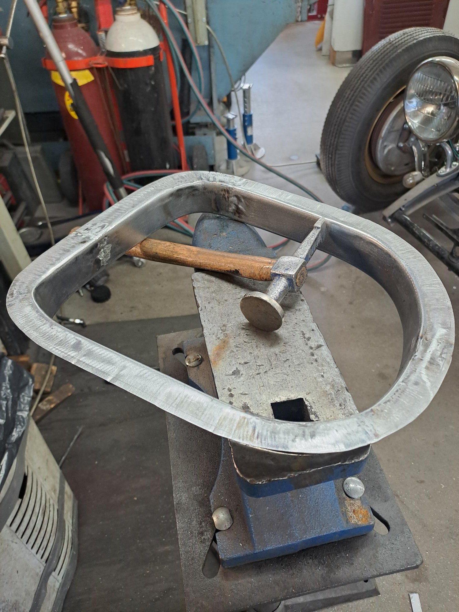

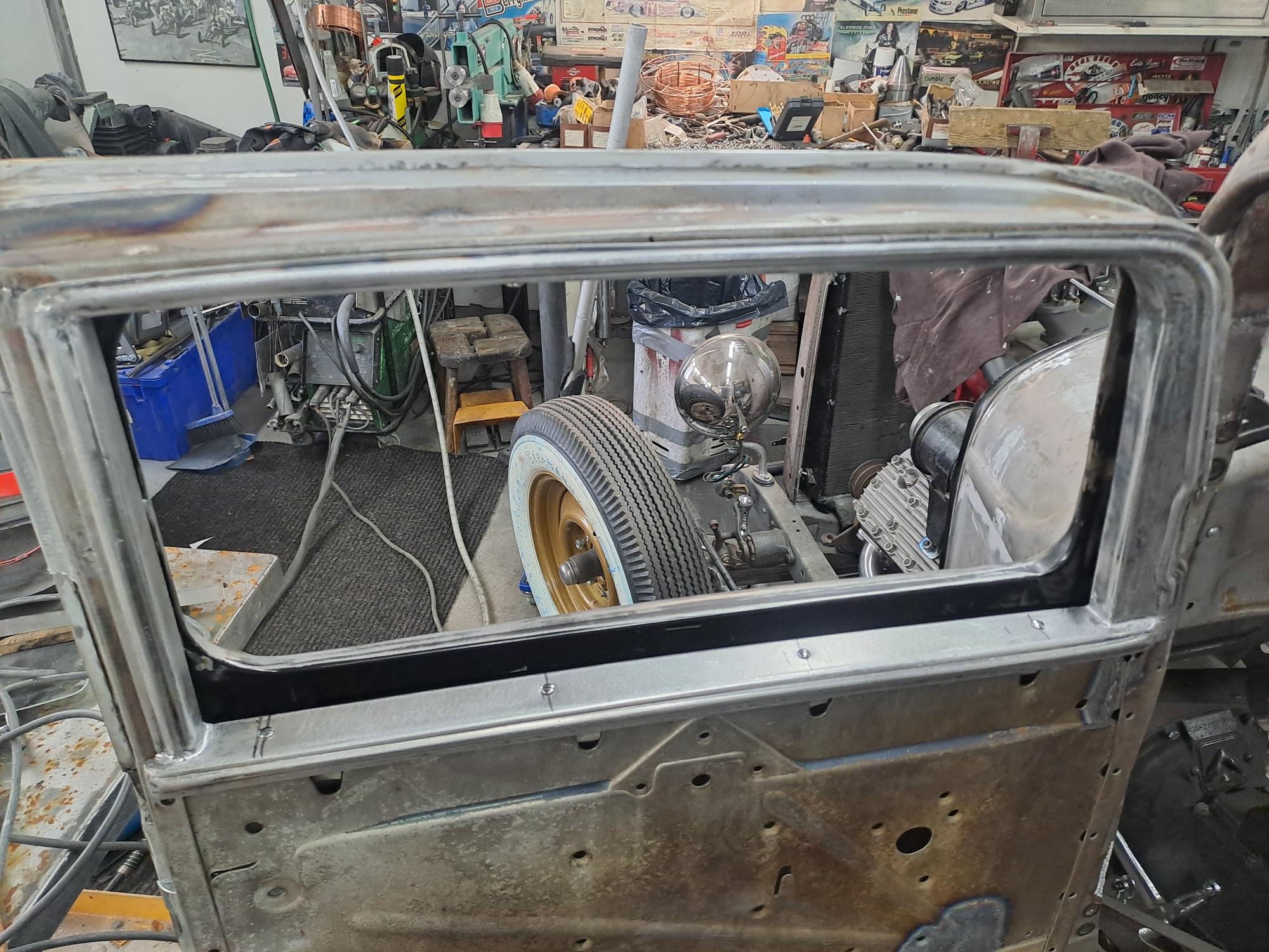

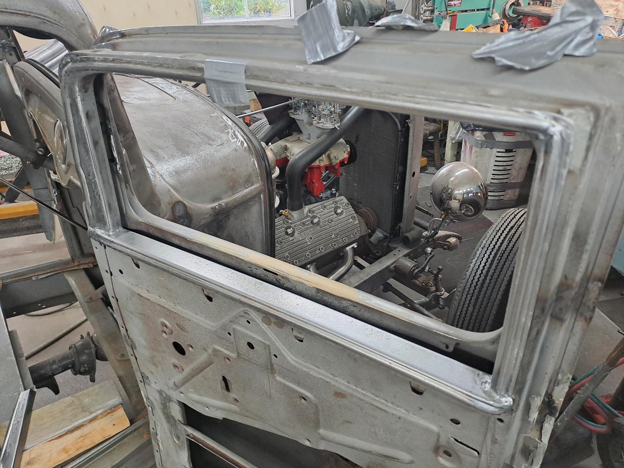

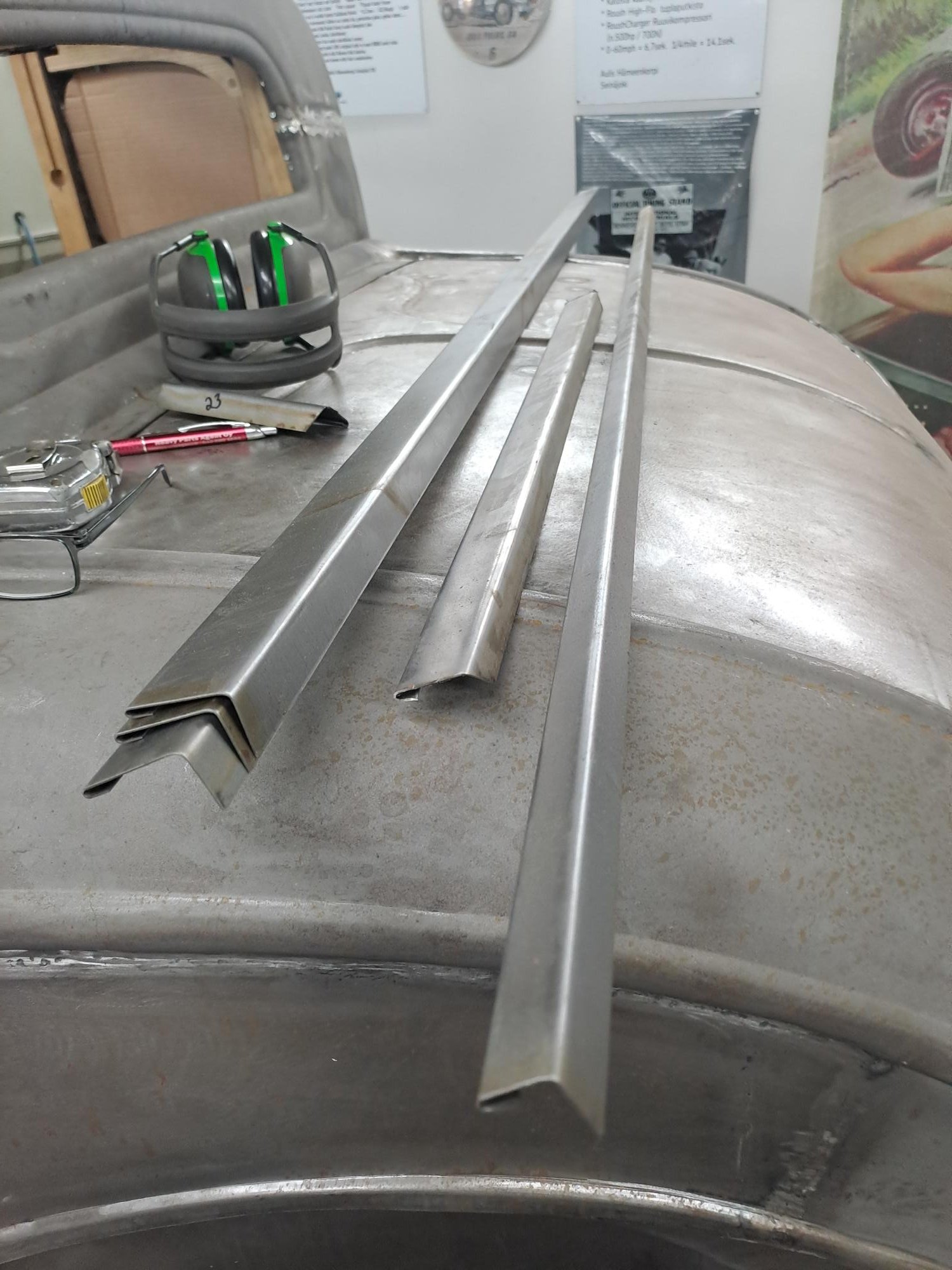

    Pic1 : Door mouldings are drilled and bolted on.
    Pic2: there is needed three different "deep" material. left = for quarter windows, middle = for doors and rear window, right = for doors.
    P*** side quarter window garnish moulding "under construction".
    I was work with it 6hours, still not ready. Maybe better way to do those is do it 2pieces and weld together.
    Now I tried to do it one piece... Not good yet, but tomorrow it looks better.
    Aulis

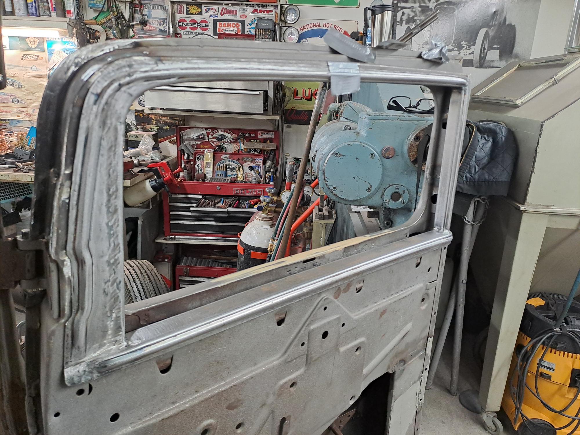

    Thank You !

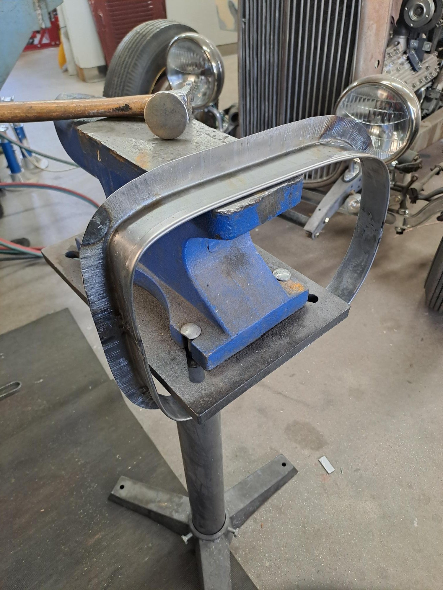

    Wednesday morning I was hammer moulding, made flange + bending ...
    Now its enough OK for me.
    Aulis

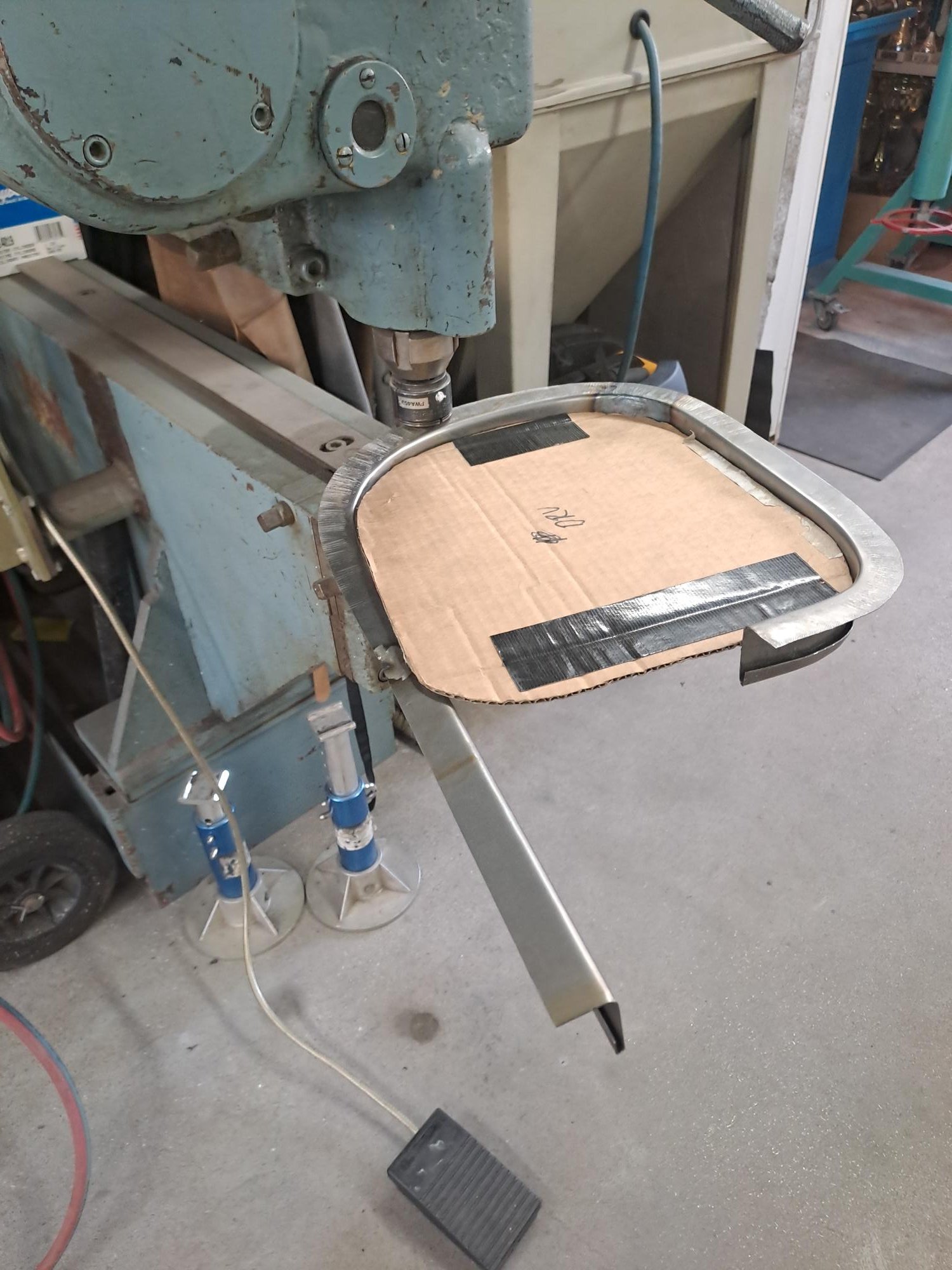

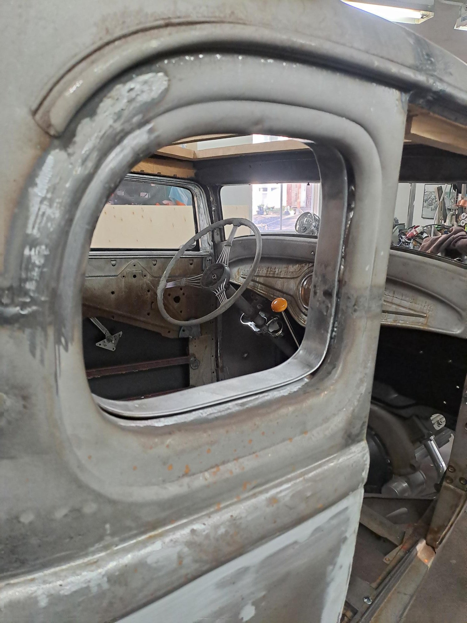

    Driver side quarter windwo moulding ready. It was only 4-5hours to make it.
    Aulis

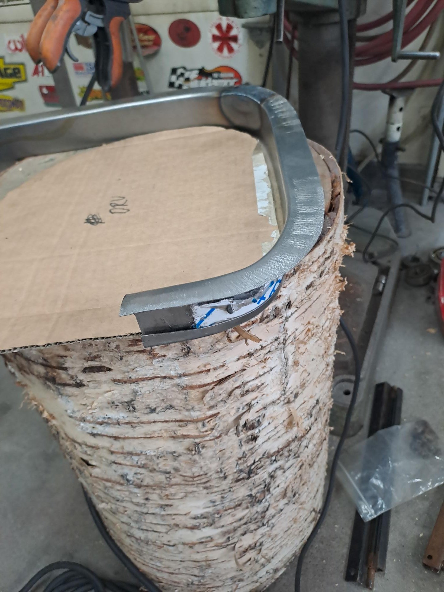

    Friday. rear window moulding is nearly ready.
    Note! my old shrinker/strecher bench. 283cid chevy sb valve springs has been harder use last 25 years than before that.
    Aulis

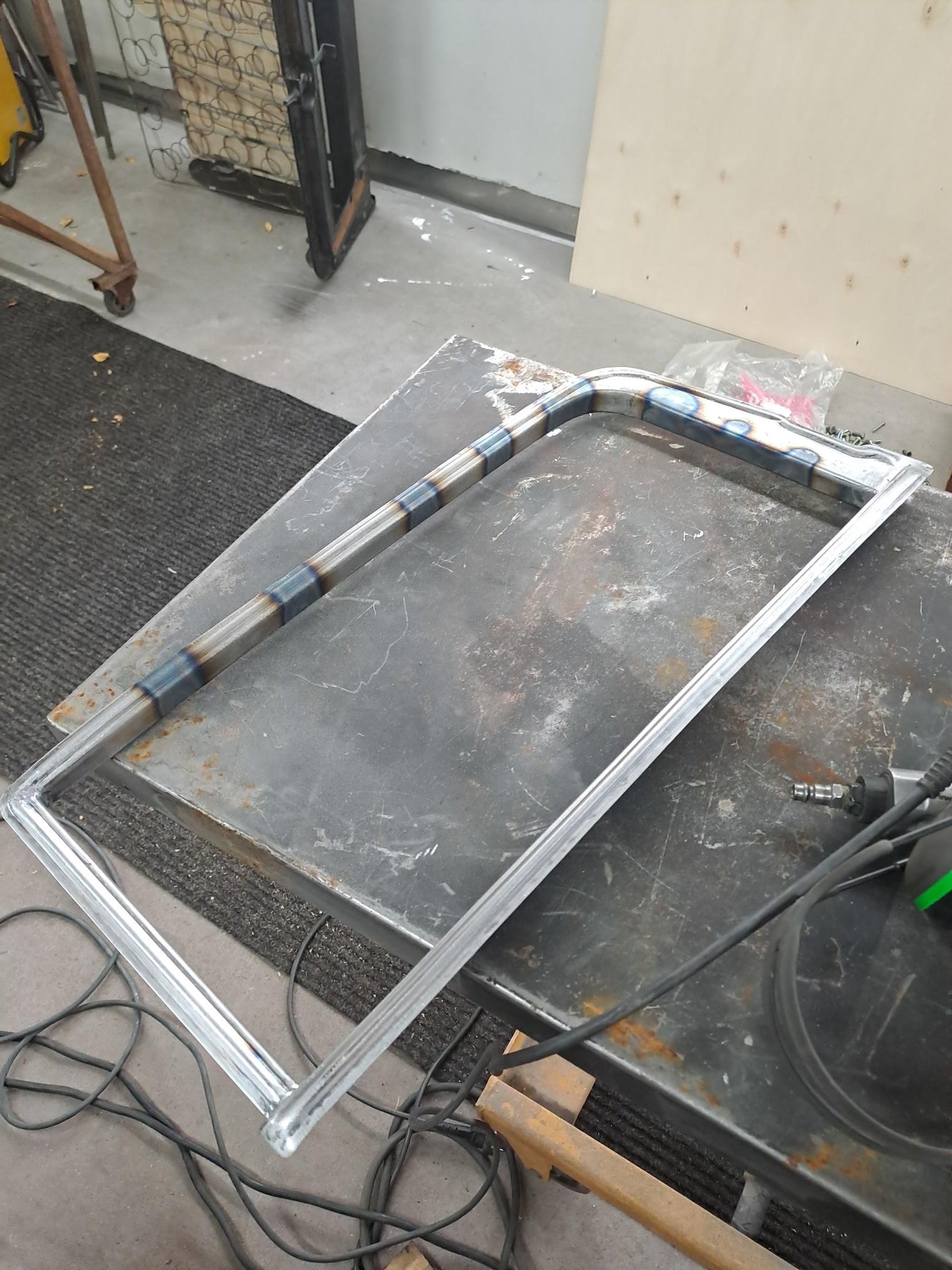

    Rear window moulding ready.
    I turned 1mm sheetmetal and stretched small corners to door mouldings.

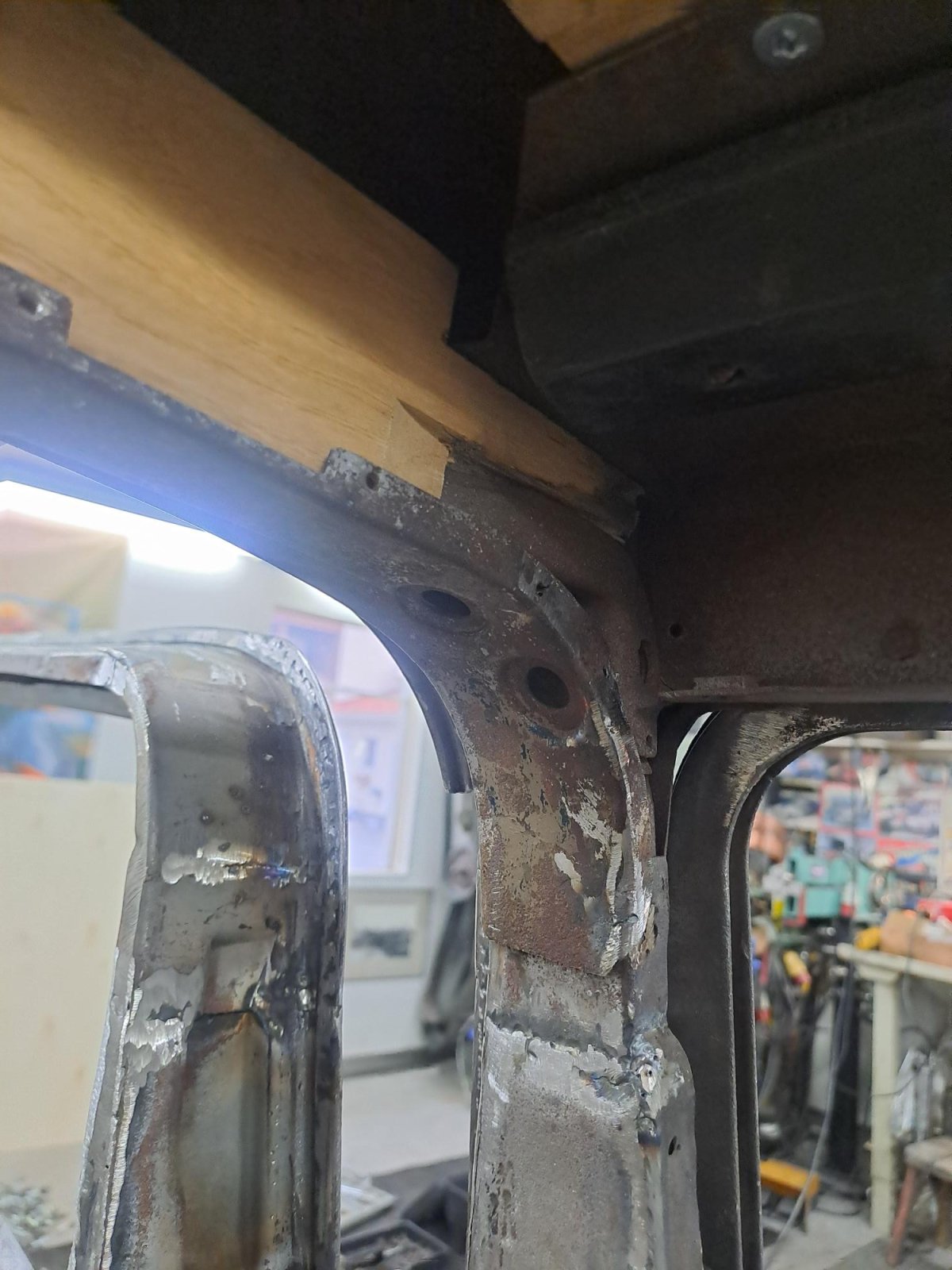

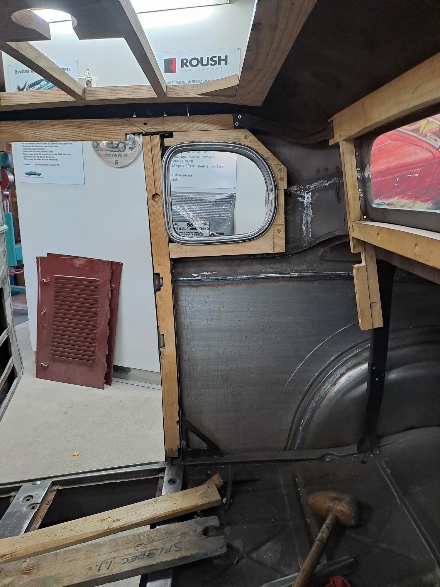

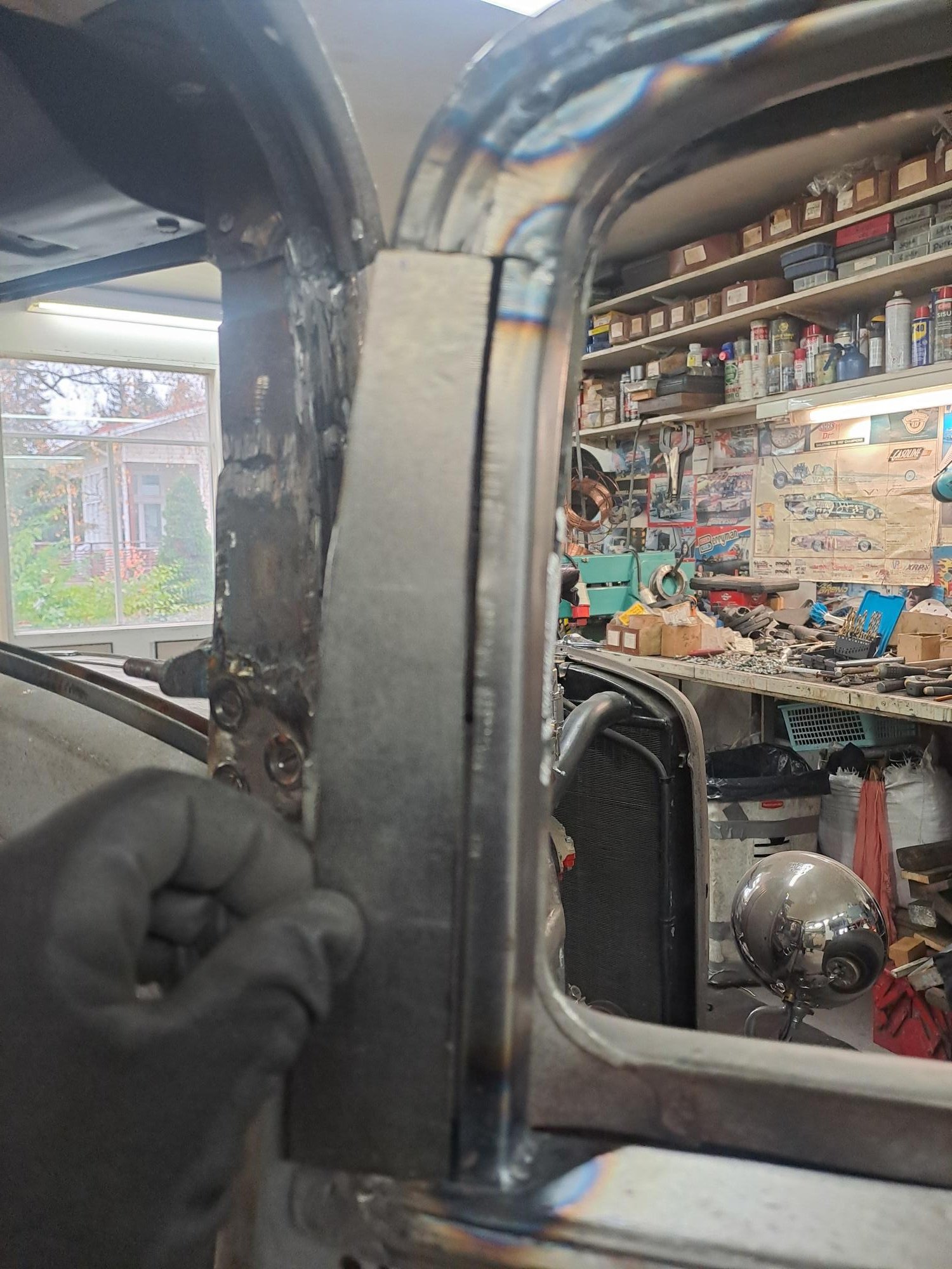

    This building is most interesting thing. OK, its nice to own hot rod or drive long ride,...but building gives good vibrations.
    Today I heat and turned thos suppots between top woods and side woods. Im not sure what is original style, but I did it like in pic. I used circular saw and made those oak trims inside of door where I screw garnisch mouldings.
    10mm x 25mm x 550mm size fits good in their places.
    Tomorrow need to make cardboard models and start to cut interior plywoods (kickpanels, door panels, rear quarter panels, rear wall panel.....)

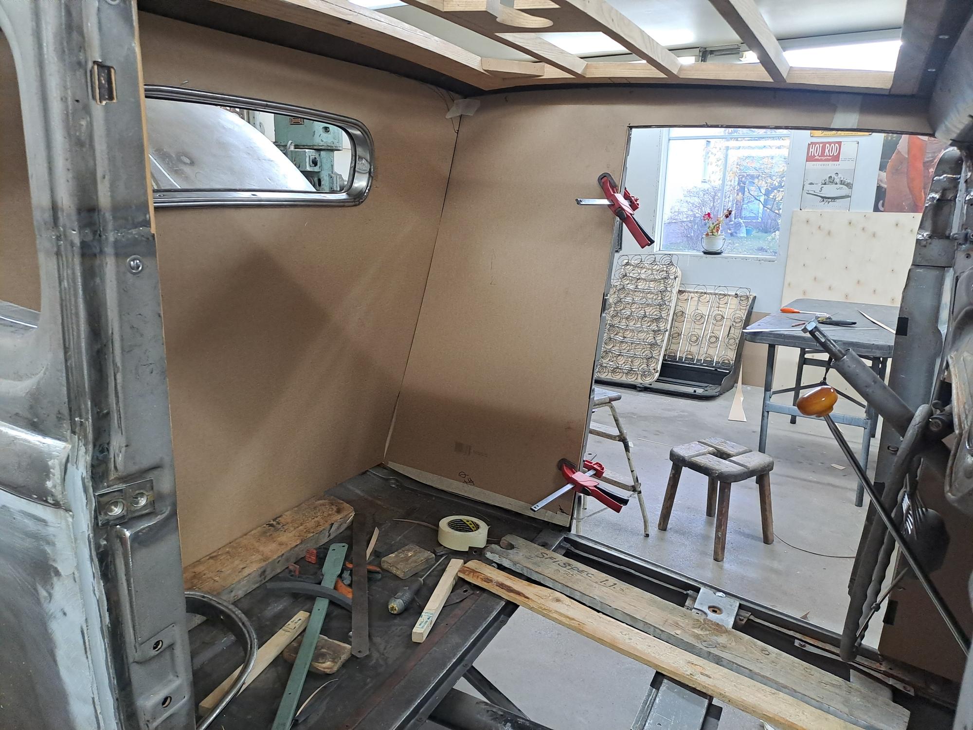

    Rear panel ready.
    Aulis

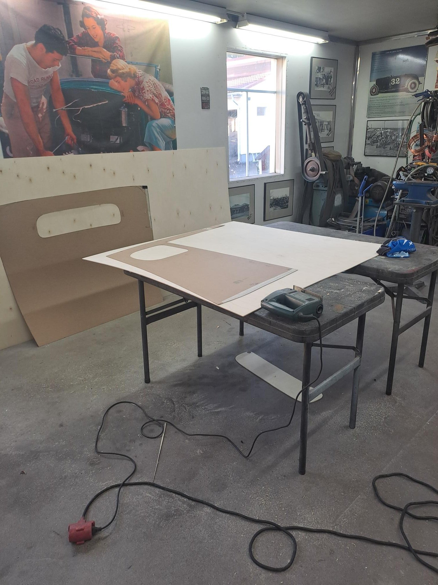

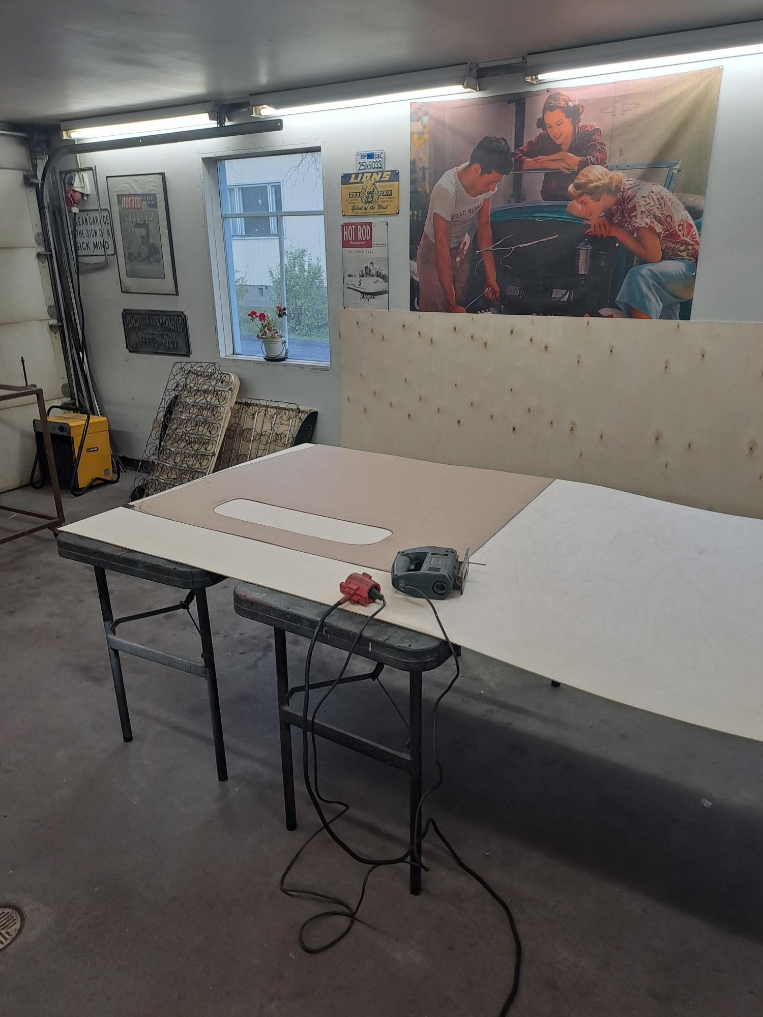

    Now all panel models ready. Next need to start cut 4mm plywoods
    Aulis

    Today started to make those plywood panels.
    Two panel ready after Monday.
