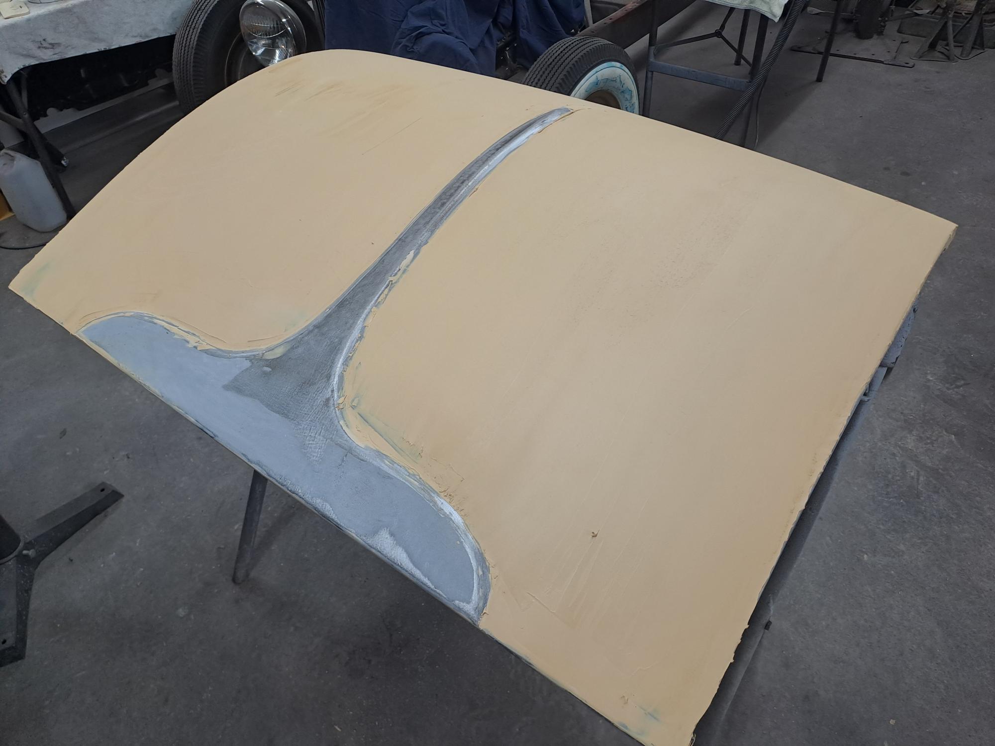

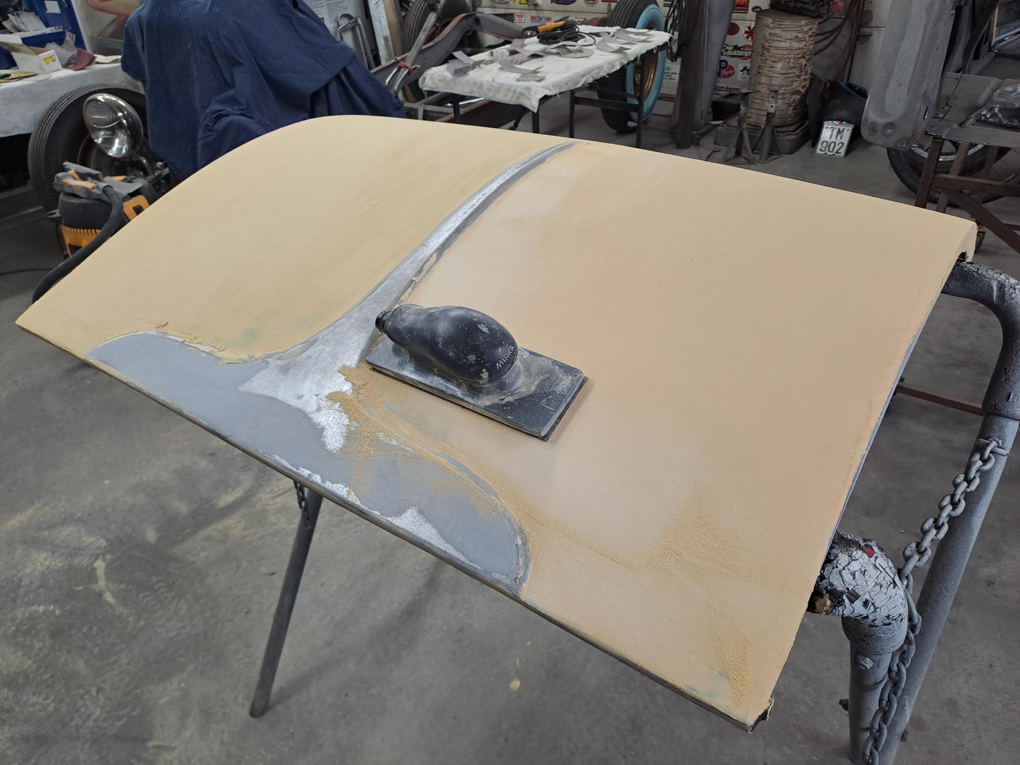

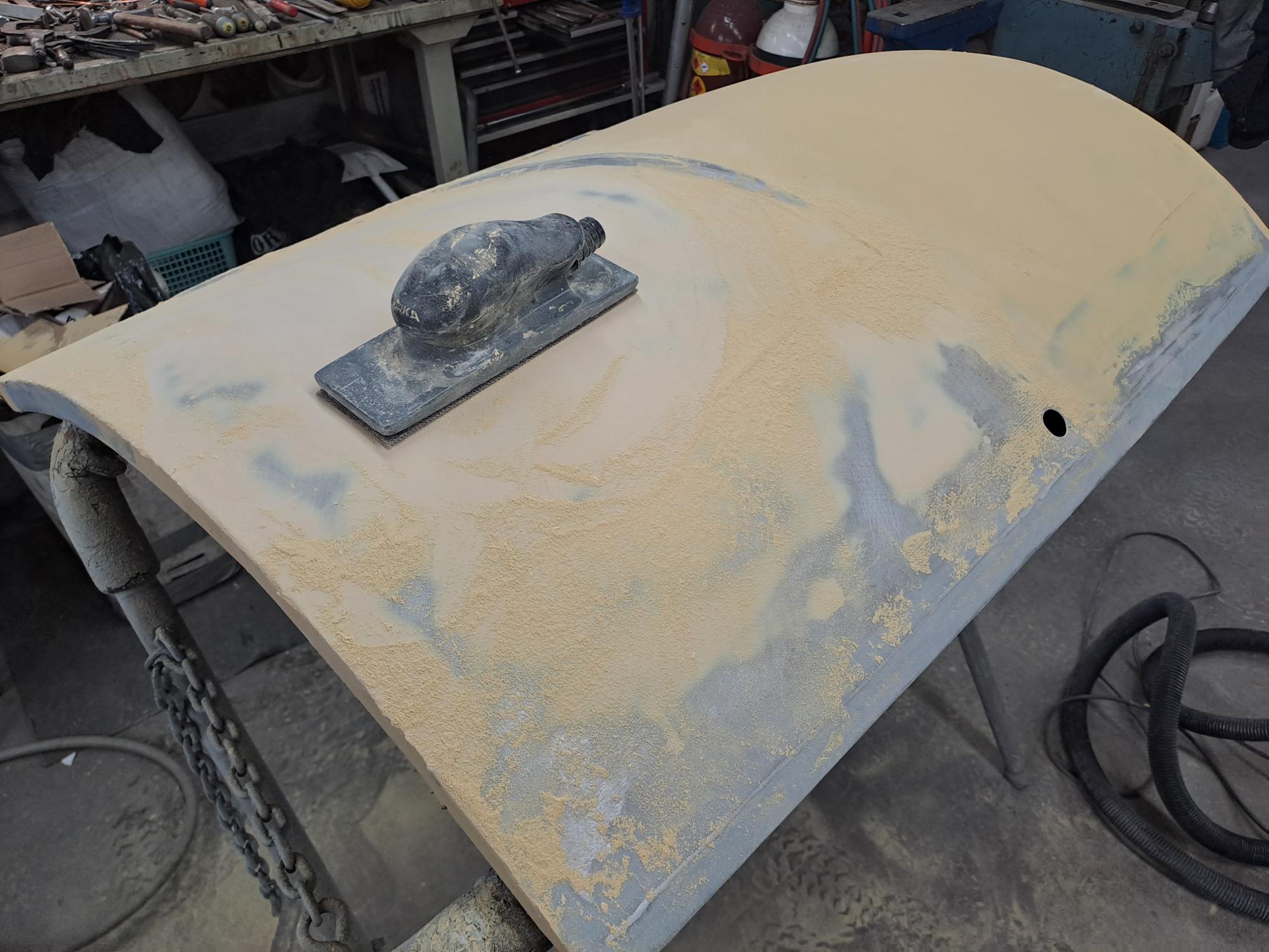

    Metallic putty to weldins, then normal medium soft 2k putty.
    Today 3-4hours worked with trunk lid. Tomorrow 2-3 hours more and its ready for epoxy primer.
    Ou ****, I like sanding (and welding, grinding weldings...). When I was younger skills were not so developed, but I think all what You have done long time before this day is good learn and step by step have learn something...
    Those who are doing these jobs daily are very much faster, but they are professional....
    Aulis
    Yes, I know. Too much pictures,... but my opinion is that pictures are best thing rod-coupe750.jpg rod-coupe751.jpg rod-coupe752.jpg rod-coupe753.jpg rod-coupe754.jpg rod-coupe755.jpg rod-coupe756.jpg

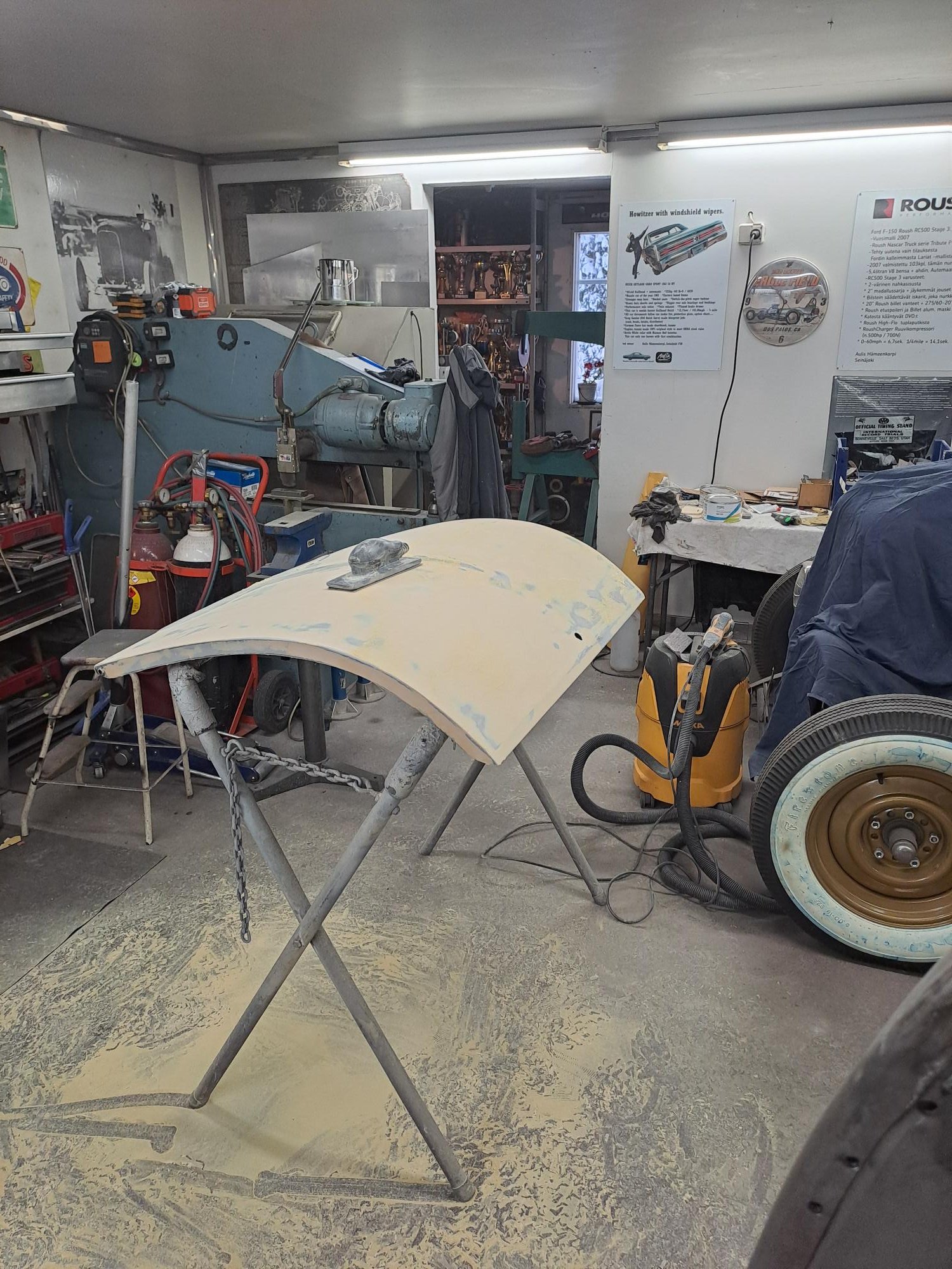

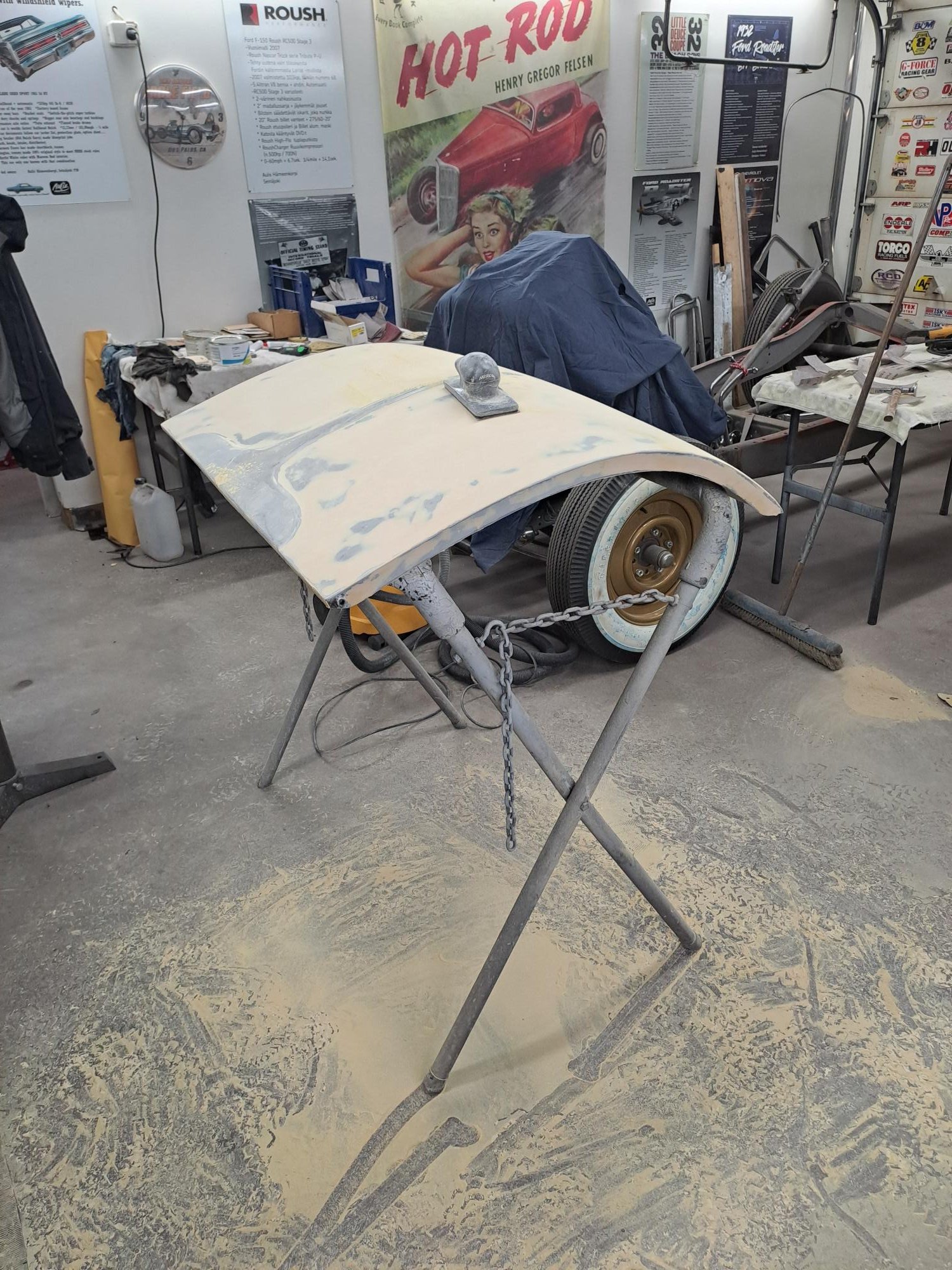

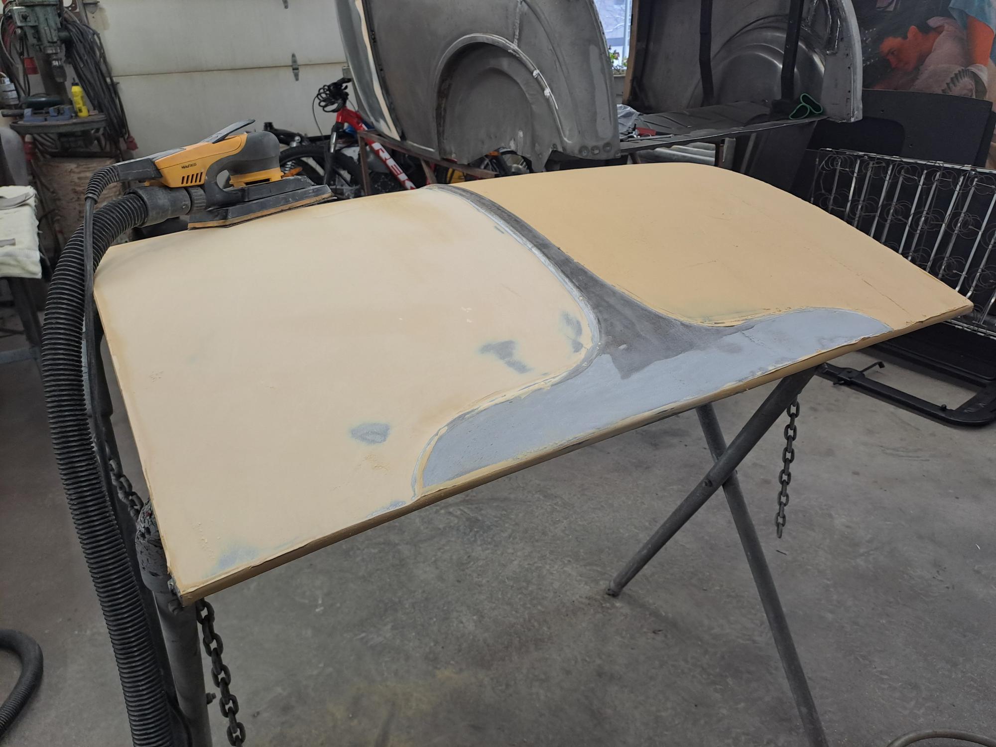

    Today get trunk lid ready. both sides.
    Cowl lid I get to right shape. It was too flat, now more curved to same "r" than cowl top.
    Also drilled panel below trunk lid. That is UP newproduction stuff. Good quality.
    After painted body and panels, just bolt on. All holes are 1mm too big. Helps adjusting when finally installation.

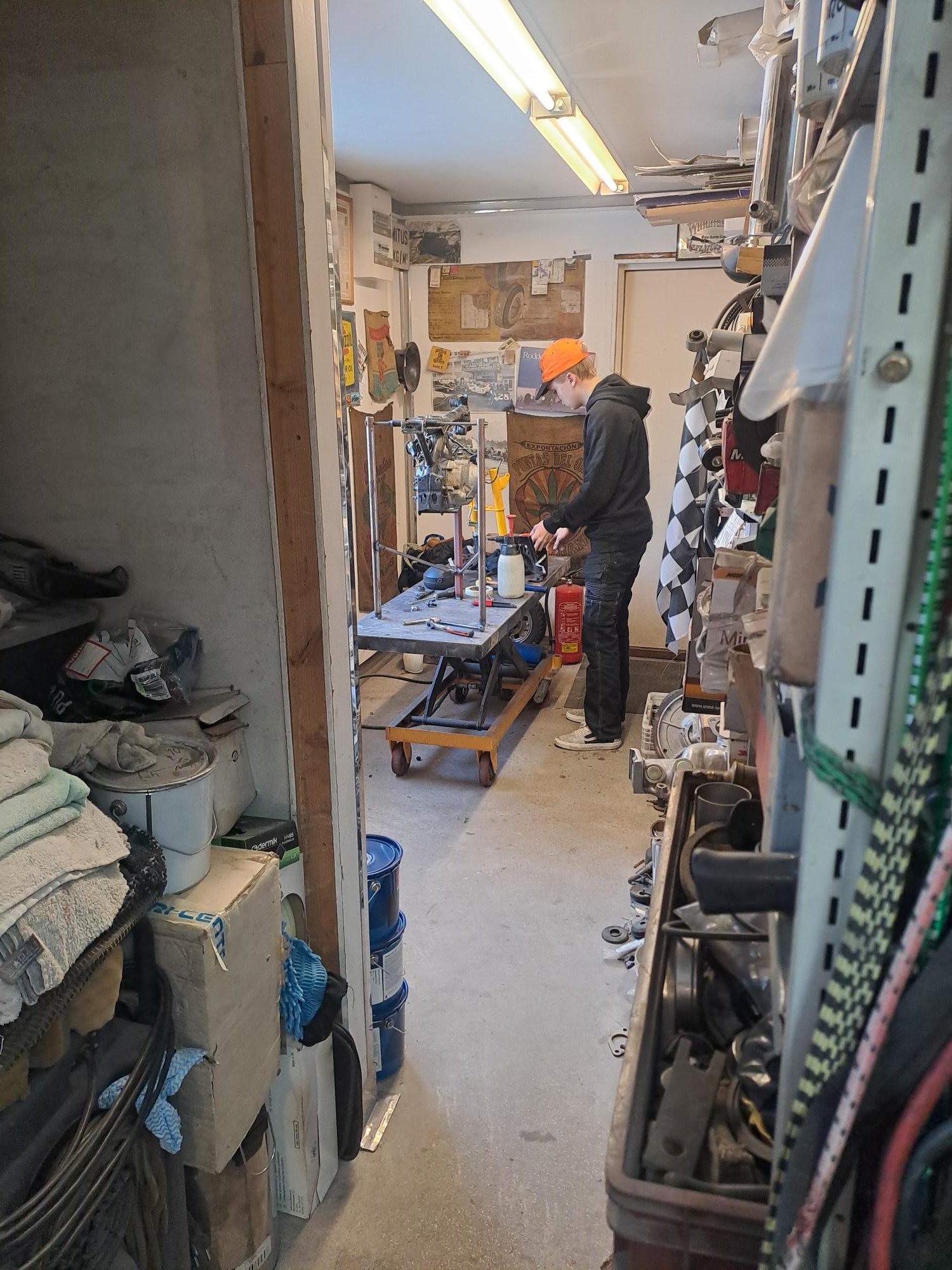

    Sunday we were open boxes in my another small garage. There we have rather much Honda Monkey stuff.
    I sold 1.5y ago 1932 ford cab (Twin spark plug 21bolt engine). Yes, I get money + very much Honda monkey stuff + with 2 ready monkey and 2 project (Benetton, Rothmans). Oskar has now all ready for this Honda rebuilding.

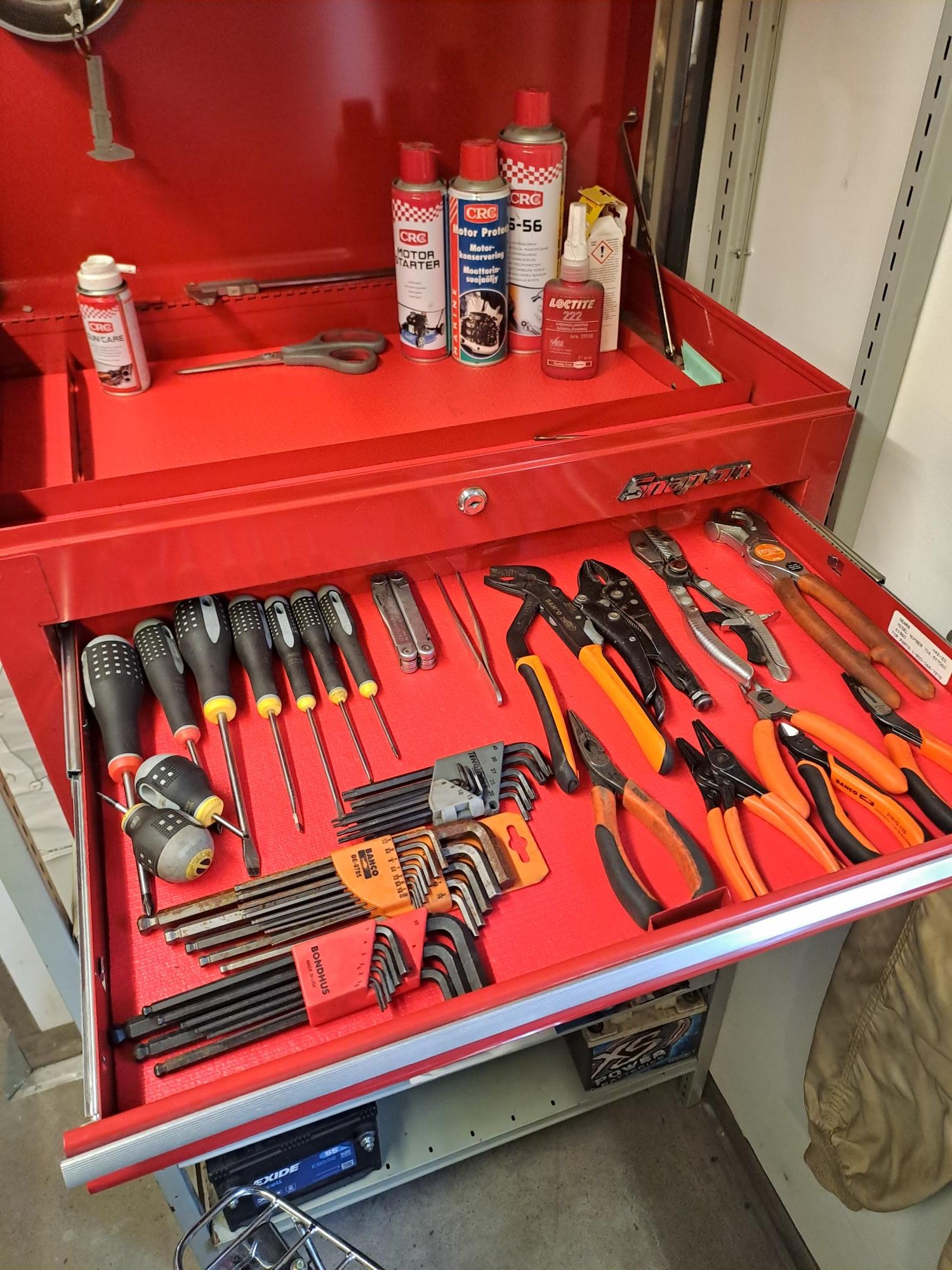

    I also found unused sendra boots, I was bought 5-6y ago. I didnt like those. Now Oskar had "Christmas" , so many nice things.
    A
