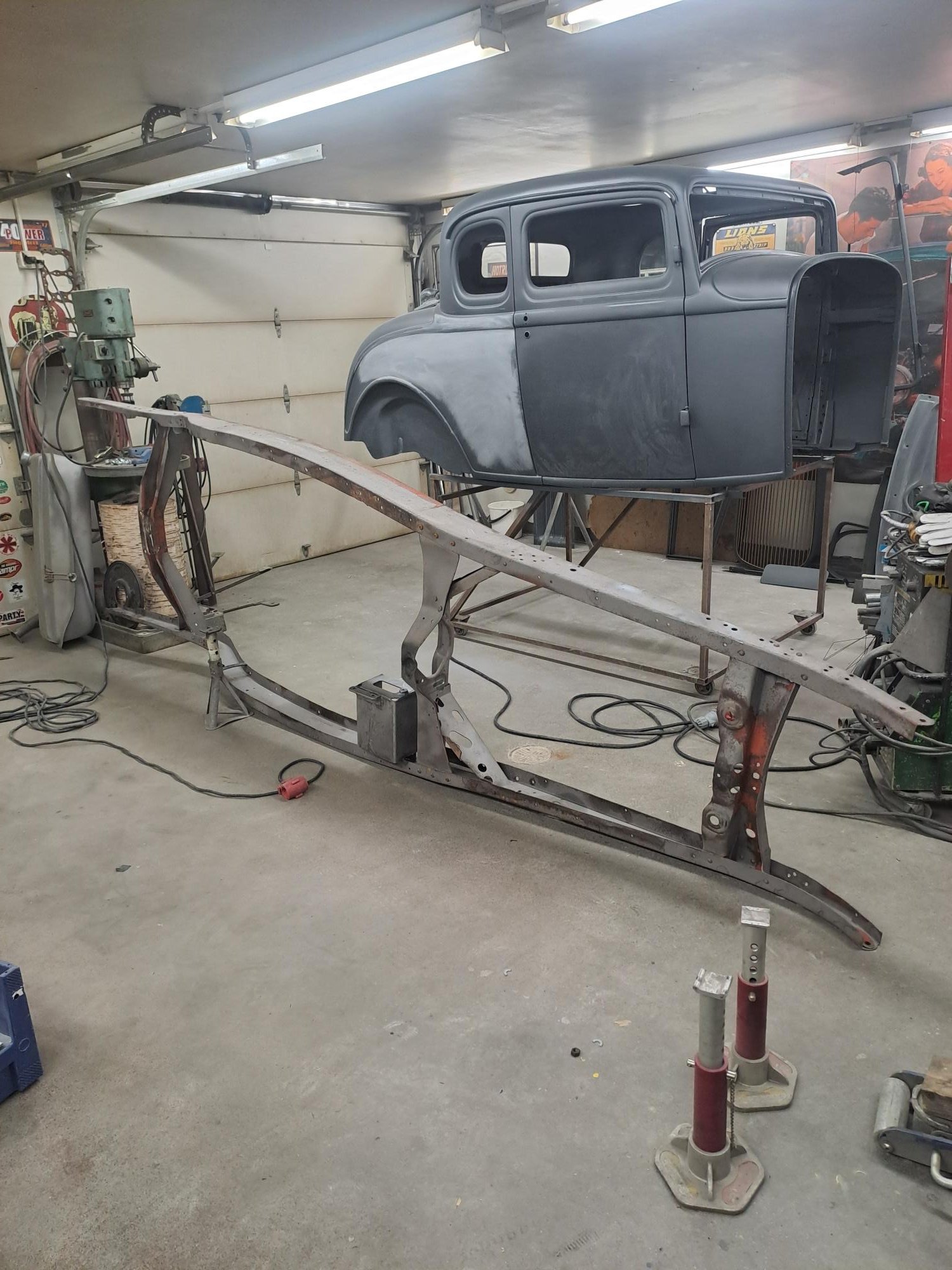

    Finally im doing frameworks. Batterybox with cylinder is made for A-ford. I bought it from here HamB.
    I turned it 90dec and make brackets for my combination. Tomorrow need to finish job. Arm need to shorten and drill new holes. Pedals are original 1932 ford.
    A rod-coupe888.jpg rod-coupe889.jpg rod-coupe890.jpg rod-coupe891.jpg rod-coupe892.jpg rod-coupe893.jpg rod-coupe894.jpg

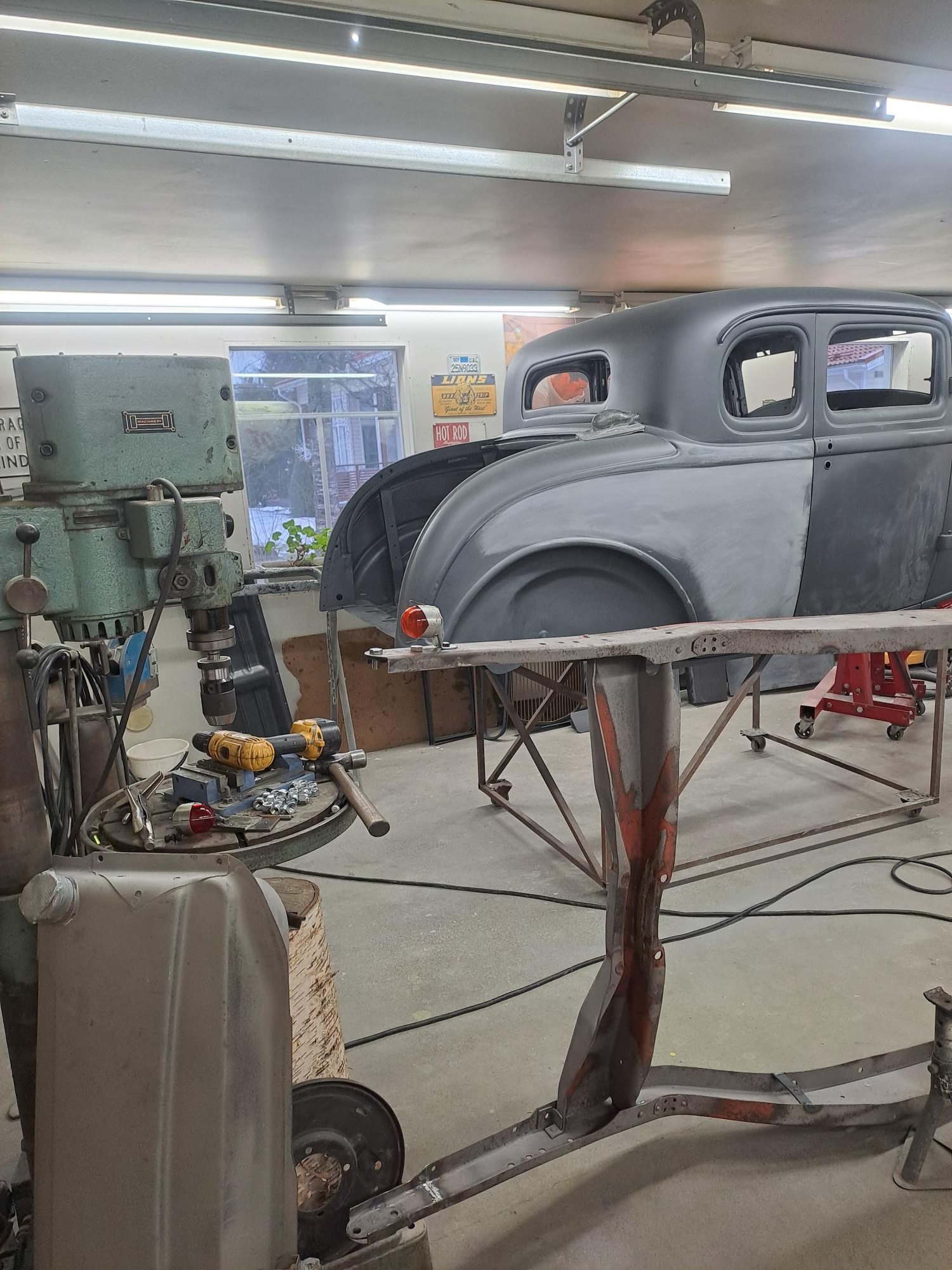

    Driver side exhaust
    a
    brEad, The 39 guy, hook00pad and 6 others like this.
  24. AULIZ
    Joined: Oct 28, 2005
    Posts: 1,793
    AULIZ

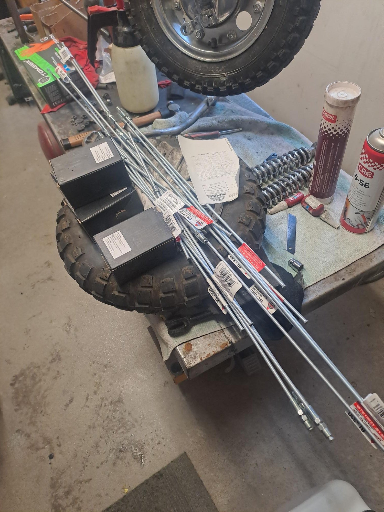

    2days, 12hours exhaust tubes are ready welded and installed. Friday-Saturday I drive down to Tampere. Our company has workers "job wellness" days.
    Its nice to built when have all small stuff very much own stock. I have overordered stuff what I think to need.
    Yesterday made small under 100usd order to Rockauto. Ready braketubes, new bendix brakes wheelcylinders... I have old cylinders and rebuilt kits, but new ones are so low price in rockauto.
    exhaust tubes, curves total +100euro (+100usd). Swedish Biltema is lowprice place. Those tubes are good quality and low price. Once again I bought too many different angle curves, but maybe I need those when built next car (1955 cameo carrier). Oskar 3D print new key fob, looks that youngman is interested in vehicles... :)
    Miss Paula called. She is making interiors. I had 2 x brown cow hide, she ordered pearl gold leatherette.
    She started to make panels ready. Doorpanels, rear wall, top, seat are increased pearl cold truck n roll pattern.
    I drive her place on Monday and pick up seat. She told that rest spring pattern is too big. Not looks harmonius.
    I "cut and paste" lower part of spring pattern.
    Aulis rod-coupe919.jpg rod-coupe920.jpg rod-coupe920.png rod-coupe921.jpg rod-coupe922.jpg rod-coupe923.jpg rod-coupe924.jpg rod-coupe925.jpg rod-coupe926.jpg rod-coupe927.jpg rod-coupe928.jpg rod-coupe929.jpg rod-coupe930.jpg rod-coupe931.jpg oskar-119.jpg

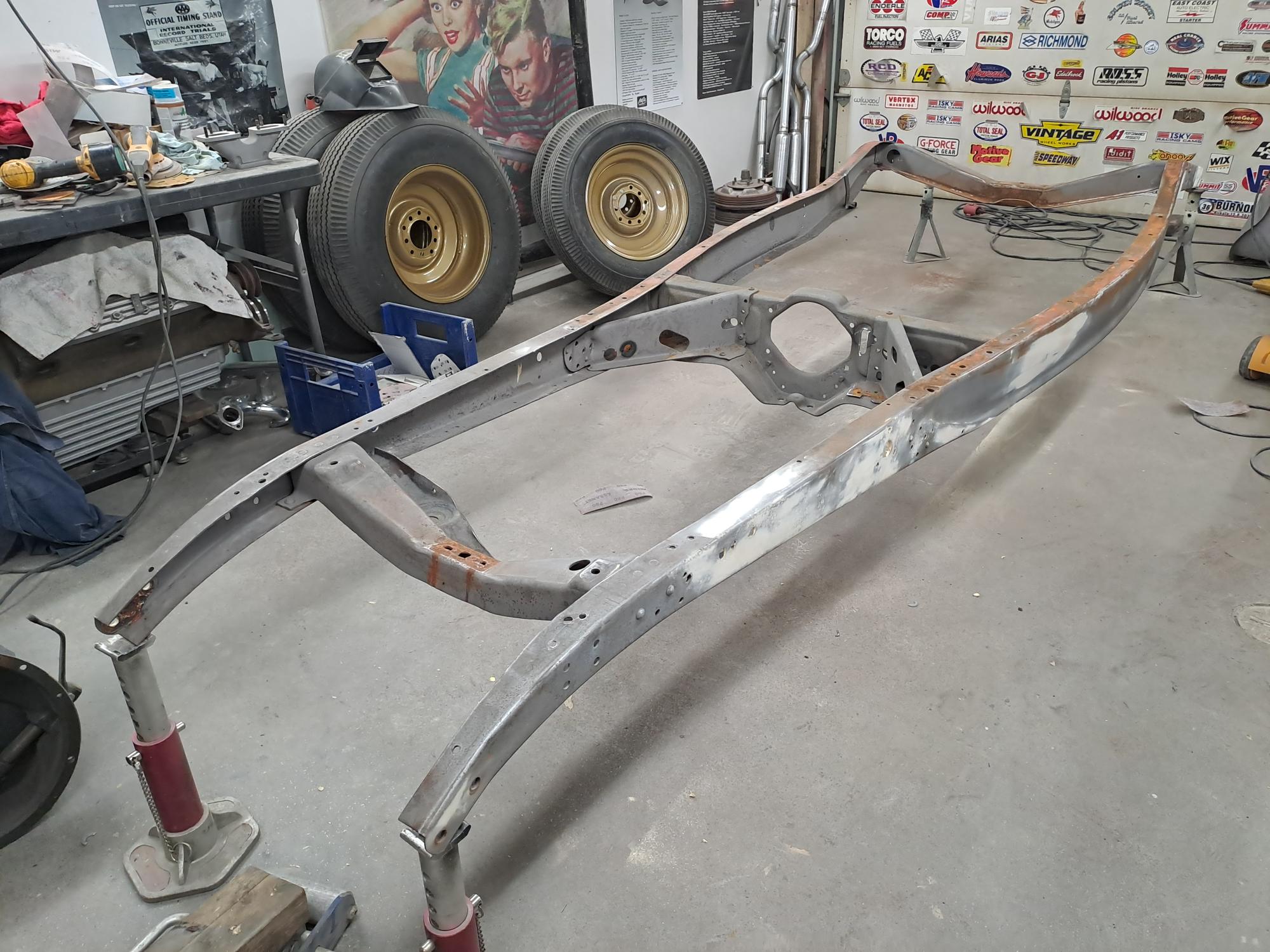

    Friday - Sunday I was on the way. Monday I was drive to see my upholsterer. I moved seat bottom springs 3" frontway. Now looks better, Miss Paula can make seat ready.
    Today I removed all stuff from frame. Also made new column tube. I had old Maybe late 30´s tube on stock. Just cut it to right lenght and made hole for column drop steering lock.
    Note, Oskar was made in their handcraft lesson in basic school (metalworks) chopper bike. He told its very good to drive... maybe I belive him :)
    Tomorrow need to weld and sand frame also I need to change 20litre Argon bottle (140euro), buy 10litre tinner, 5litre brakleen,.... Thursday I paint frame, end of week I need to paint Rear axle, driveshaft, ******, engine.
    One time paint: acid primer + 2K acryl.
    Aulis
    rod-coupe932.jpg rod-coupe933.jpg rod-coupe934.jpg rod-coupe935.jpg rod-coupe936.jpg rod-coupe937.jpg rod-coupe938.jpg rod-coupe939.jpg rod-coupe940.jpg oskar-120.jpg

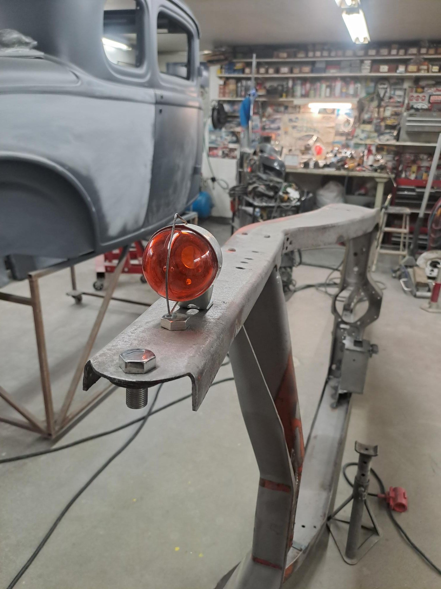

    Today welded frame, grinded and little putty to those places where corrosion dents.
    I change rear taillights to 1941 Grimes landing lights. Brackets are fourty ford brakehose brackets after modified.
    Today arrived Rockauto shipment. Brake tubes, new wheel cylinders and some flathead spark plugs.
    Argon bottle changed too. I think price is higher than last winter. 20litre bottle change to full one = 150euro (160usd). Tomorrow need to paint frame (epoxy primer), maybe small frame parts too.
    Aulis
