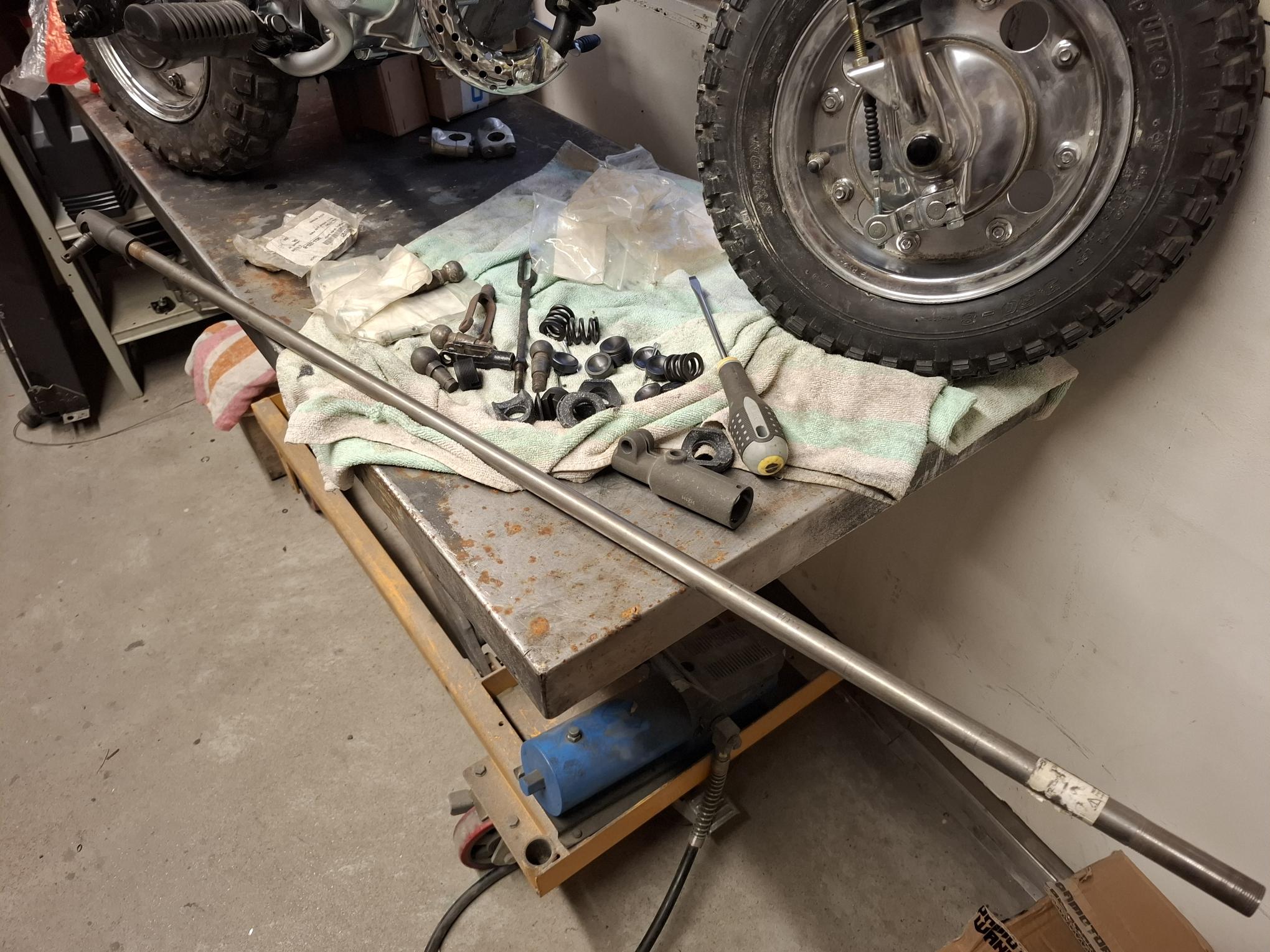

    Evening I helped Oskar and his Friend to built Honad ready. They need rather much ***istance, hope they learn somehing every day
    Also made some lathe jobs. I cut 4mm from Lincoln brake drums inner sleeve (brake surface). Also made 2pc sleeve between inner bearing and spindle bottom. Seal is 1 3/4" x 2". Original 1932 ford spindle OD. is 1 3/16".
    So I made sleeves 1 3/16" x 1 3/4" x 7/11". I also tranfer inner bearing 2mm from bottom to more near seal.
    Sleeve + bearing transfer are need to do when use Early Lincoln bendix brakes with original 1932 ford spindle.

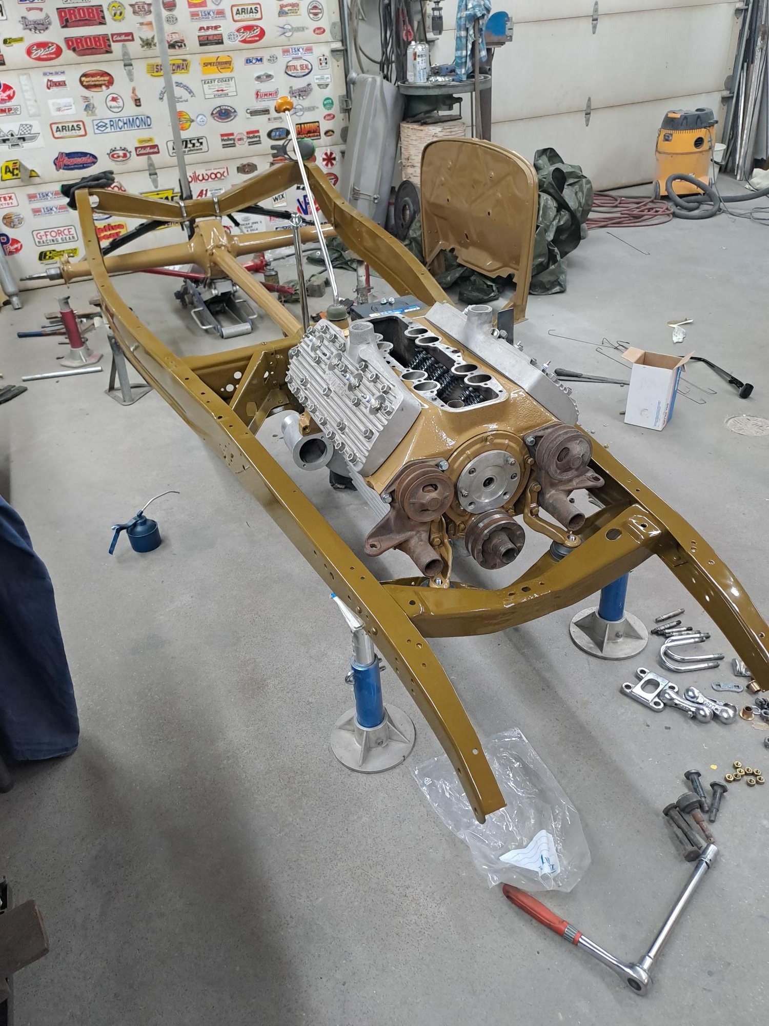

    Today I "repainted" frame. I was not happy about my first painting.
    Now very good. OK, there is some small notches (I dont know what word You use in english) and I was not fix those off with putty. I like that frame need to show that its old and original.
    Only thing was my paintjob was not good. Sanded little down with 320 paper and repainted it.
    One wet round Glasurit green (little lighter than Dupont) and one wet round dupont Harley Davidson Olive green. Dupont is not cover very good even if paint two or three wet .... thats why I have nearly same color normal 2K acryl basic.
    Tomorrow I paint Engine+******+rear axle
    Aulis

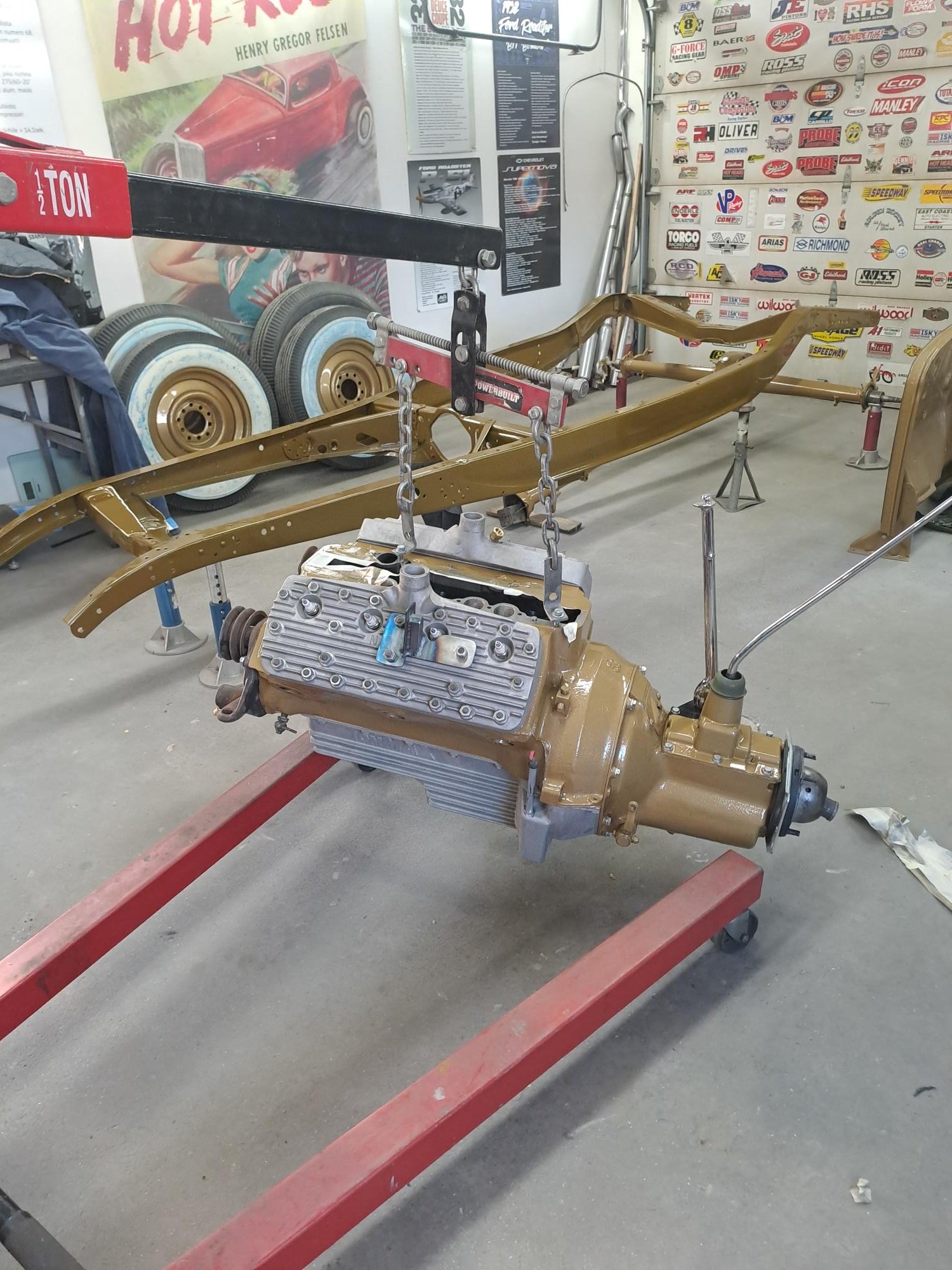

    Saturday morning I tape engine, ******,.. 2K primer + 2K acryl wet on wet ...

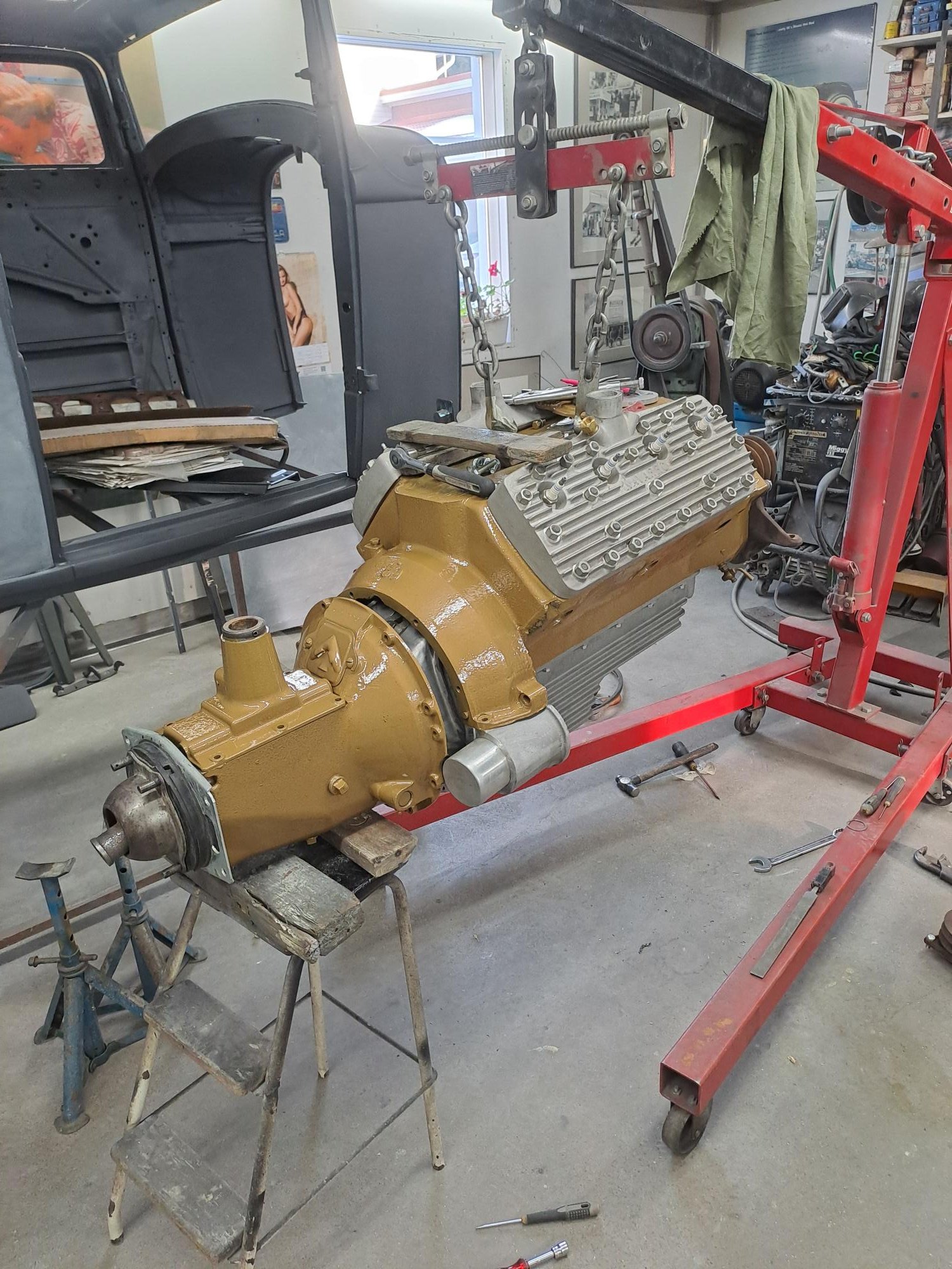

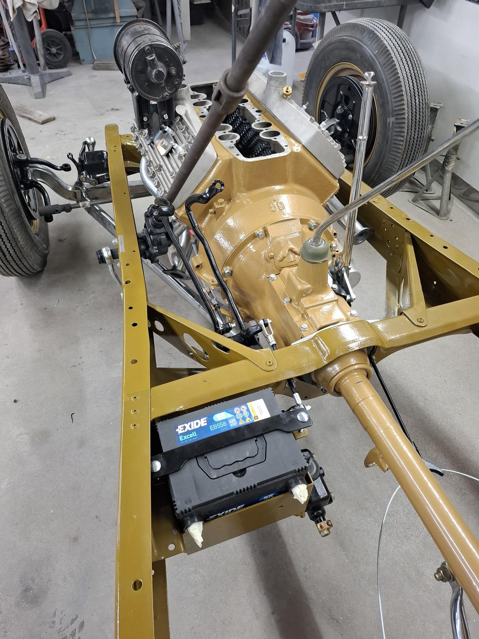

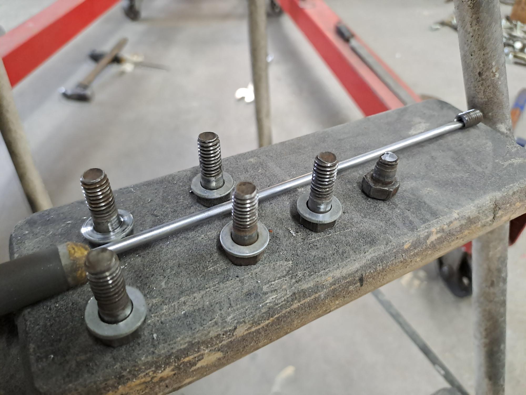

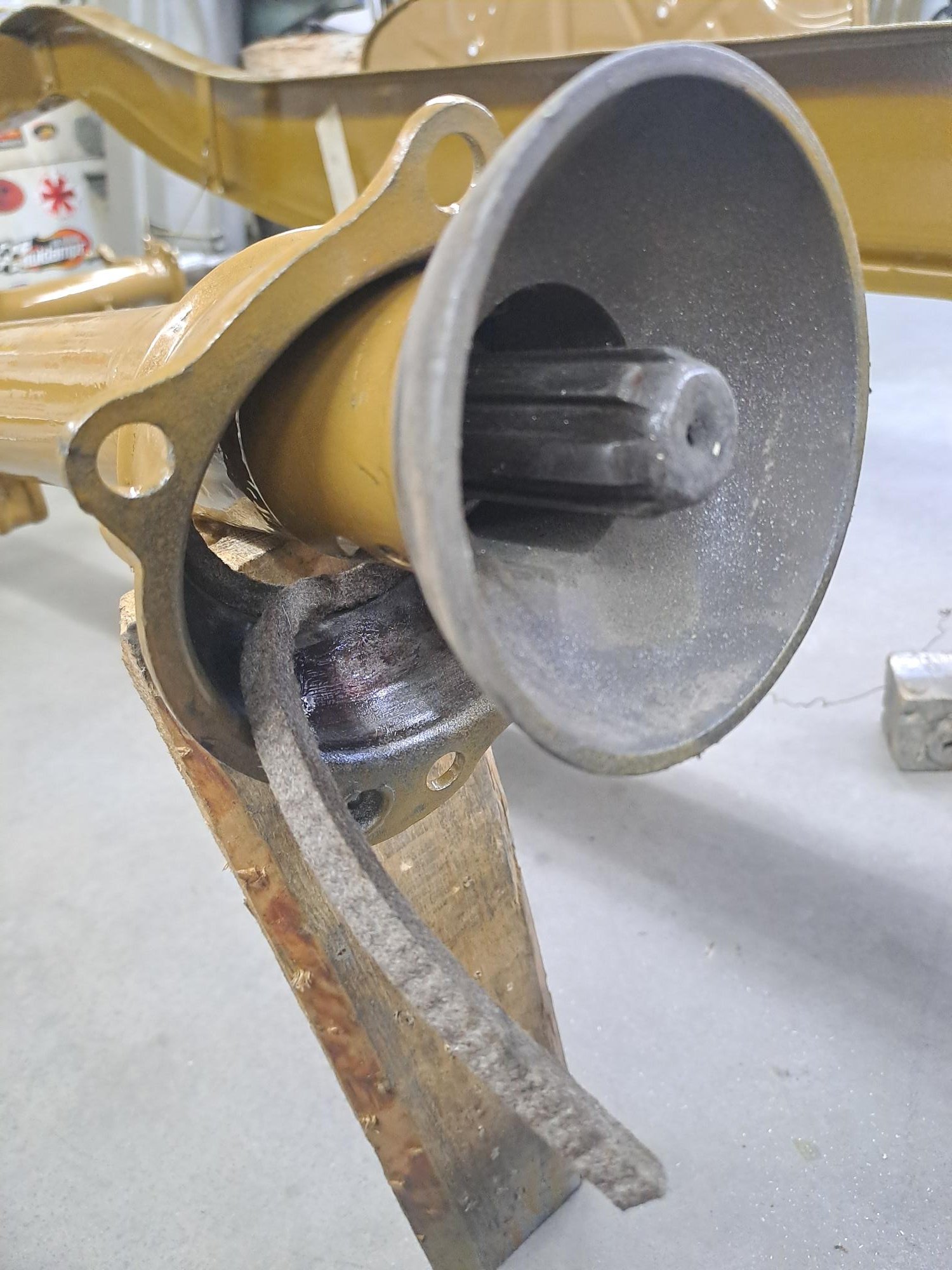

    AULIZ

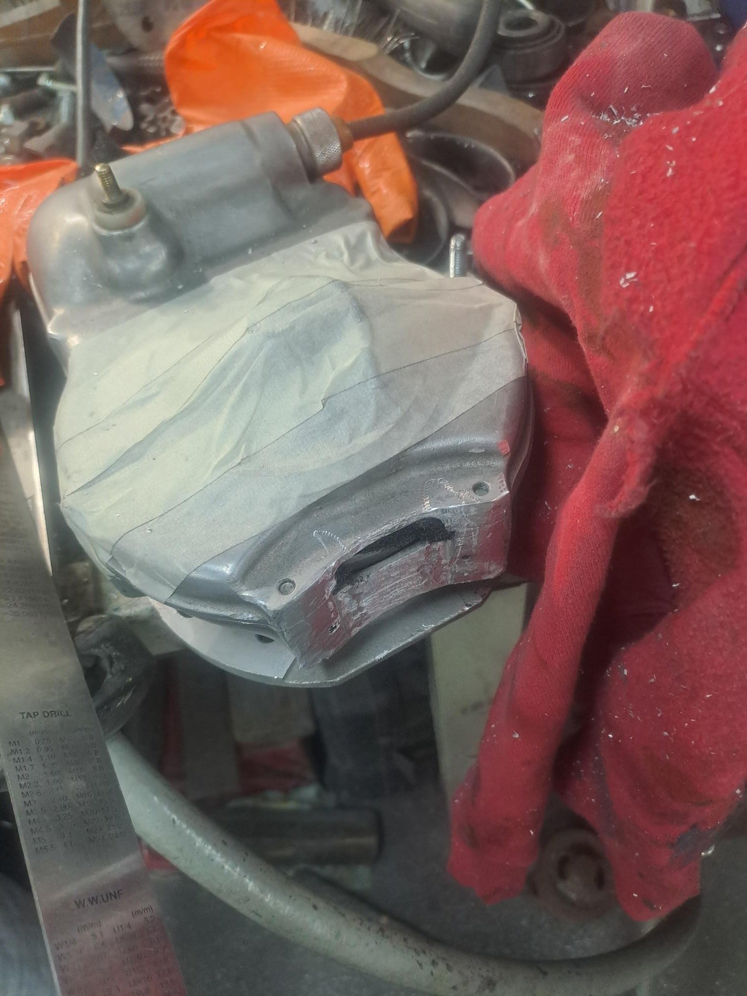

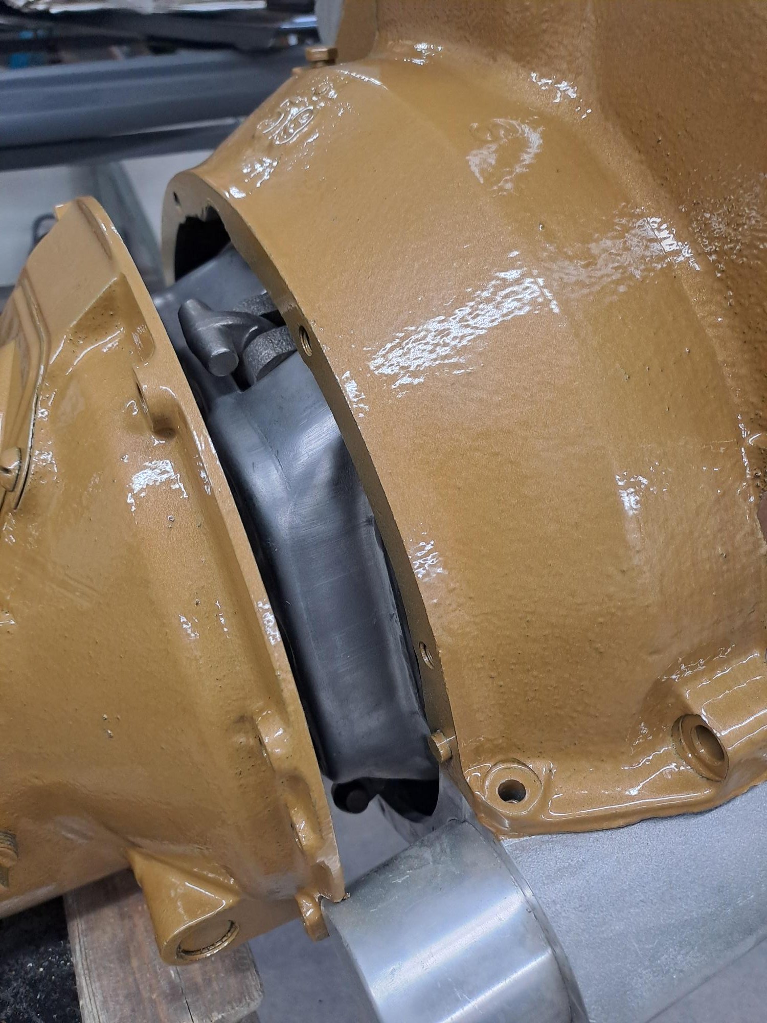

    Monday is done.
    One pressureplate bolt cut. I was lucky, I get broken bolt out without removing flywheel. As we know, pre 1948 flathead flywheel can be removed after removing oilpan..... I use Aluminum racing flywheels all my flatheads. Little losing low RPM torque, but I get it back with bit CID enginesize. I like more engines, which is taken fast RPM up and RPM is come down faster too. This Schiefer flywheel is taken 10" clutch. New pressureplate and clutch plate. Normal orig. heavy flywheel and very heavy shortblock moving parts is like nightmare.
    Rear axle is installed too. Installed 10mm x 11mm felt to driveaxle cup, oiled it and greased all moving parts.
    Tomorrow rear brakes, shocks, front axle... I want to get frame like rolling. Helps my working in small garage if frame is on tires.
    Yesterday I lathe crankpulley smaller. As small as possible. Also removed rather much alumium bottom of Harman Collings magneto. Now all fit there and can move magneto enought both way Left and Right.
    Aulis

    I like Harman & Collins magnetos. Big magnetwheel (5" OD), big coil, very strong spark... only minus is to fit it on its place....

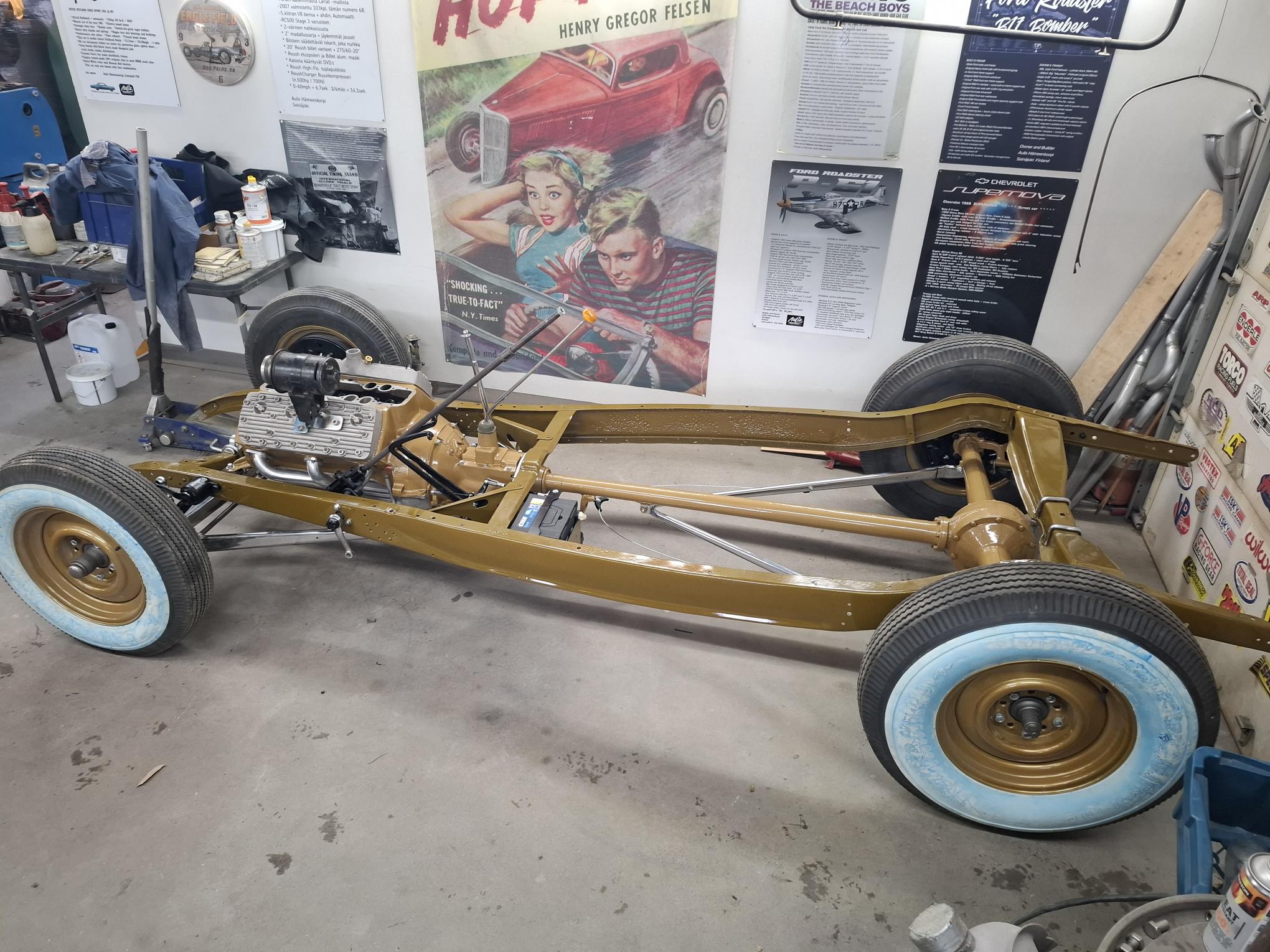

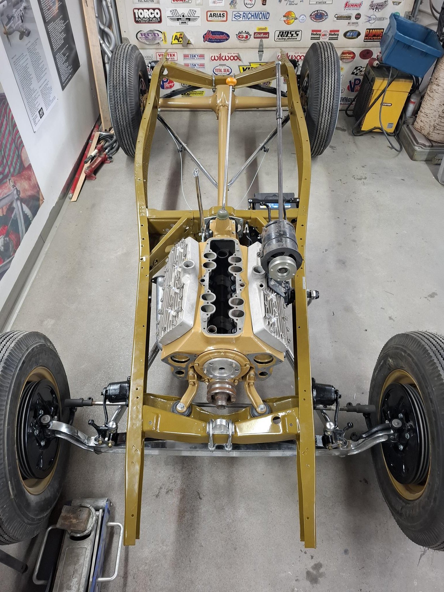

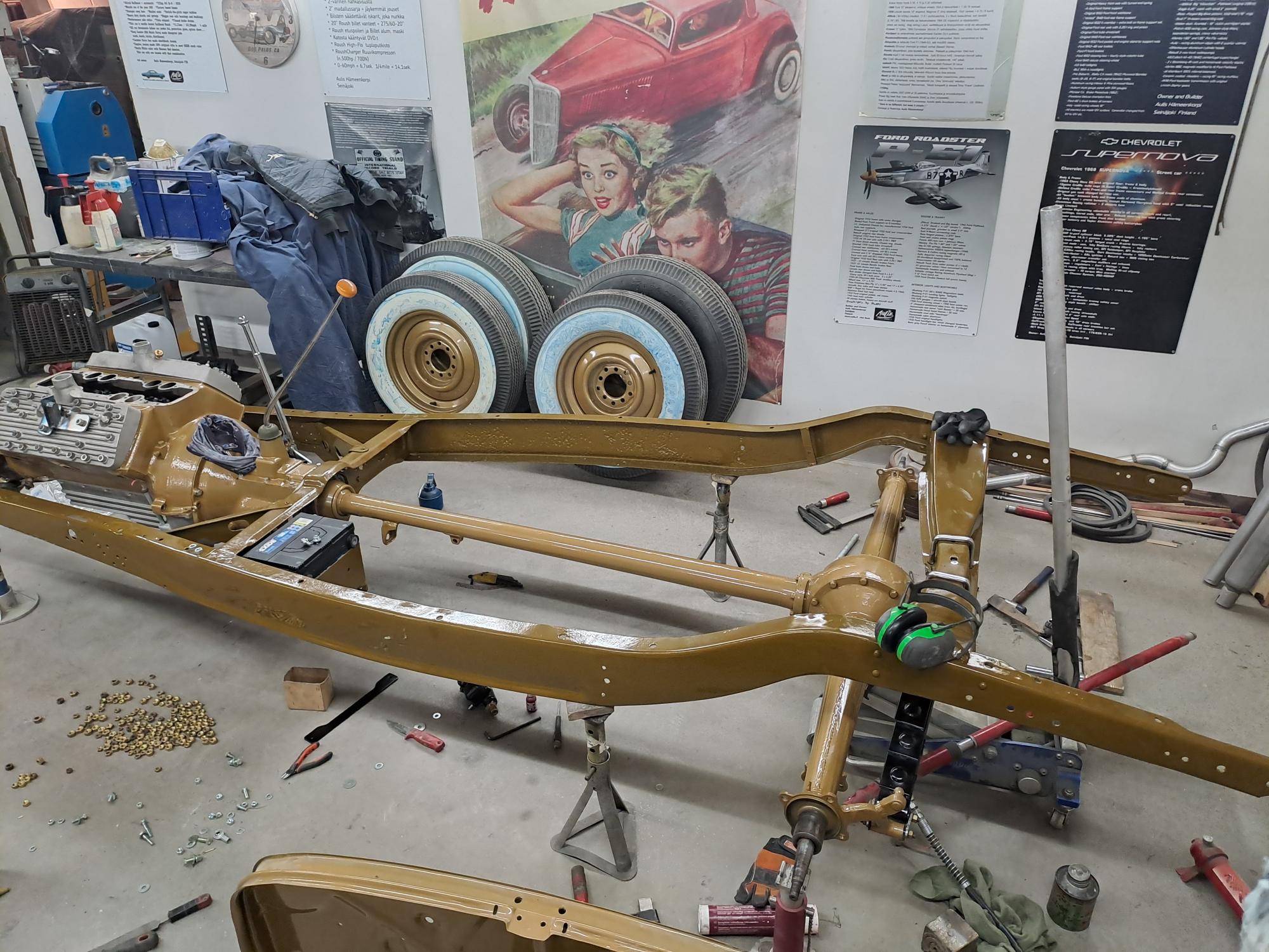

    Today installed pedals + mechanism, emerg.brake stuff.
    Rear: Shocks+dogbones, backing plates + Drums, radius rods
    Front: wishbone, front axle, spring, shackles, shocks+dogbones, backing plates + drums.
    Aulis
    rod-coupe1018.jpg rod-coupe1019.jpg rod-coupe1020.jpg rod-coupe1021.jpg rod-coupe1022.jpg rod-coupe1023.jpg rod-coupe1024.jpg rod-coupe1025.jpg rod-coupe1026.jpg

    AULIZ
    Today Rod is sitting on floor. Headers, steering box, tires, tie rod...
    It took more time to fix garage. It looked more like battle field.....
    I dont have drag link, maybe I need to make it myself. I like more those orig.style tie rod and drag link.
    Original 1932 draglink is fixed, I want that there is possible to adjust it.
    Tomorrow I continue sand epoxy primer. Need to get rest of parts + body sanded and spray primer on.
