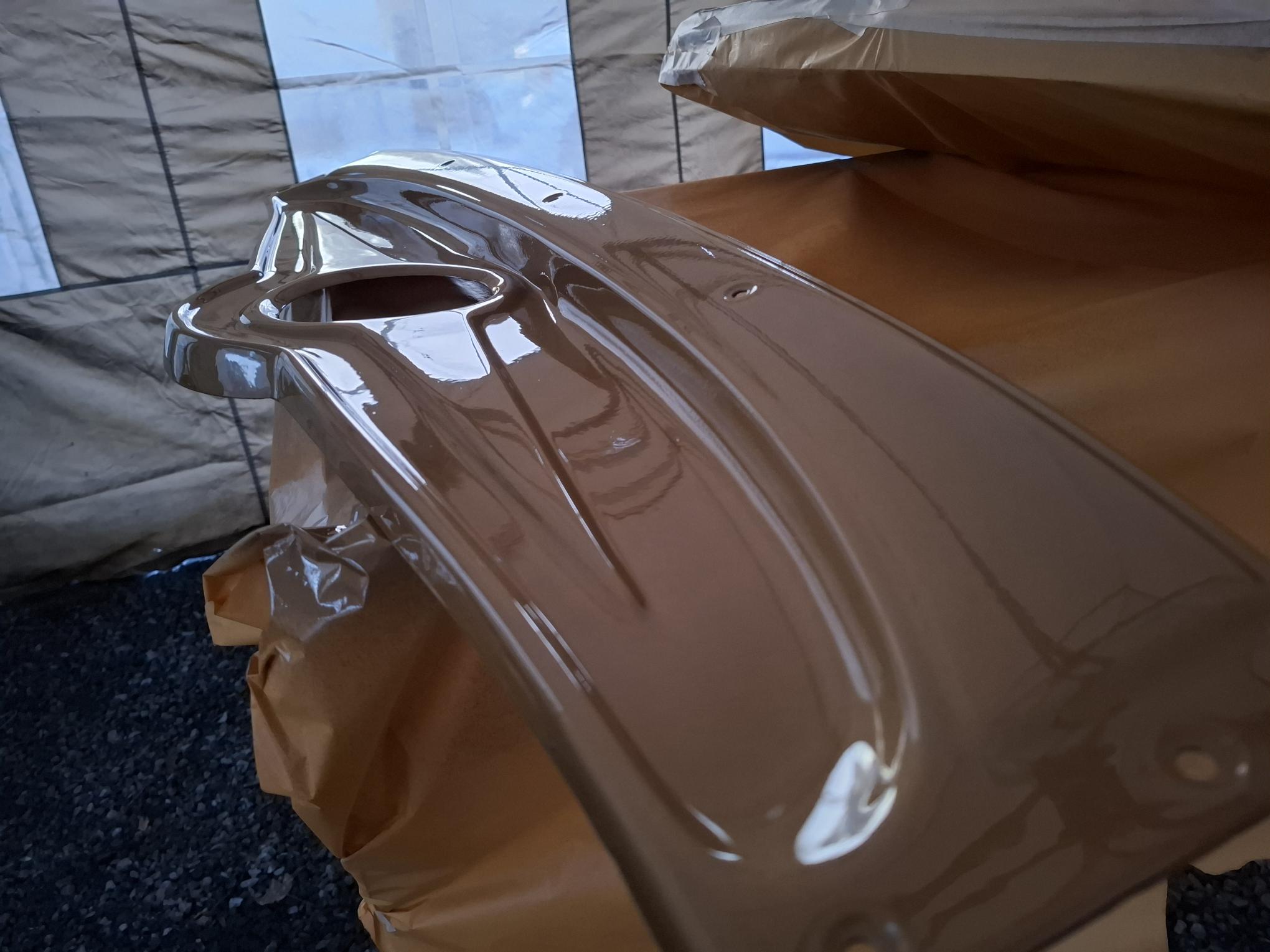

    Today sanded bodyparts for final olive green paint.
    This week I start to paint those.

    First thing in the morning was that I washed tent inside using pressure washer.
    When it was dry, I hang some stuff and painted.
    first picture: Glasurit 22 2K green, other pics DuPont 2K H-D olive green. Wet to wet. Two round, not more.
    Not professional quality, but good for Hot Rods.

    some parts more final painted.
    A rod-coupe1069.jpg rod-coupe1070.jpg rod-coupe1071.jpg rod-coupe1072.jpg rod-coupe1073.jpg rod-coupe1074.jpg

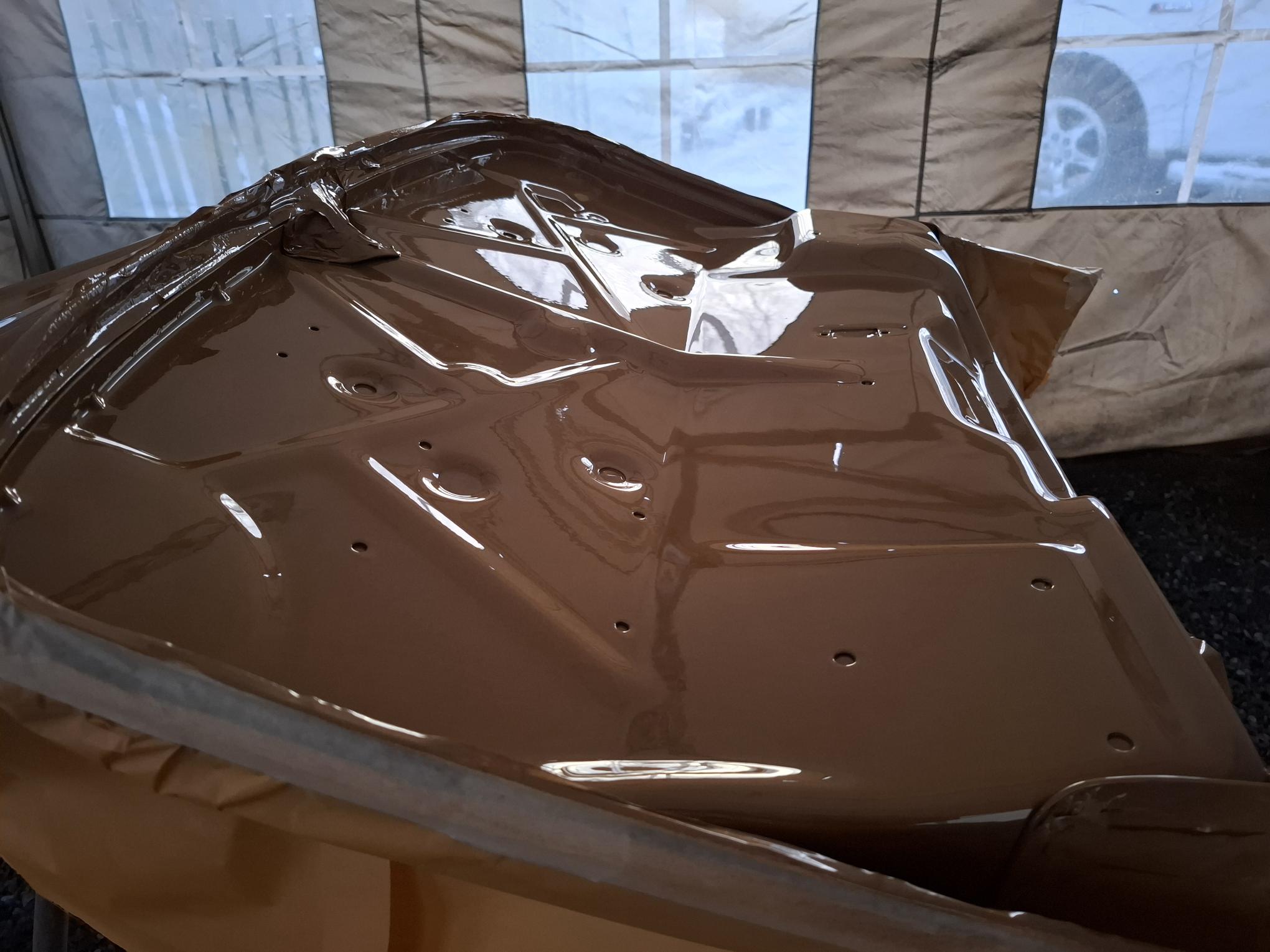

    Today I painted body. Not good.... I have one big problem with DuPont HD olive green. I bought this project 2016. 2017 January I bought paint, I was think that I built this car during next 12-20month. That was not good plan.
    I have built 2 x 32 roadster, one 1936 pick up ... and now after 7 years I get this car ready.
    Paint is not working like it have to do. Paint´s composition is not good anymore.... OK its more stiffen and not mixture anymore 100% .... I have increased little extra thinner (reducer) and try to mix paint with drilling machine.
    You can see one pic, there is extra stuff in filter.
    Paint is not leveled like It must do... First I paint that glasurit green basic, it works OK. This Dupont is not easy to get leveled, specially vertical surfaces.... If try to increase more paint, I can see that its nearly falling down,... ...
    And of course Im going old.....
    Im leaving like it is. When 2 months gone, I polish little. Yes, I know "street rodders are polishing paint",... but this time I need to fix little..
    Aulis

  30. Deutscher
    Joined: Nov 12, 2024
    Posts: 343
    Deutscher
    from Germany
    That's really bad luck, but with wet sanding and polishing you can improve a lot, the way you do it will be perfect.
    Regards Harald
