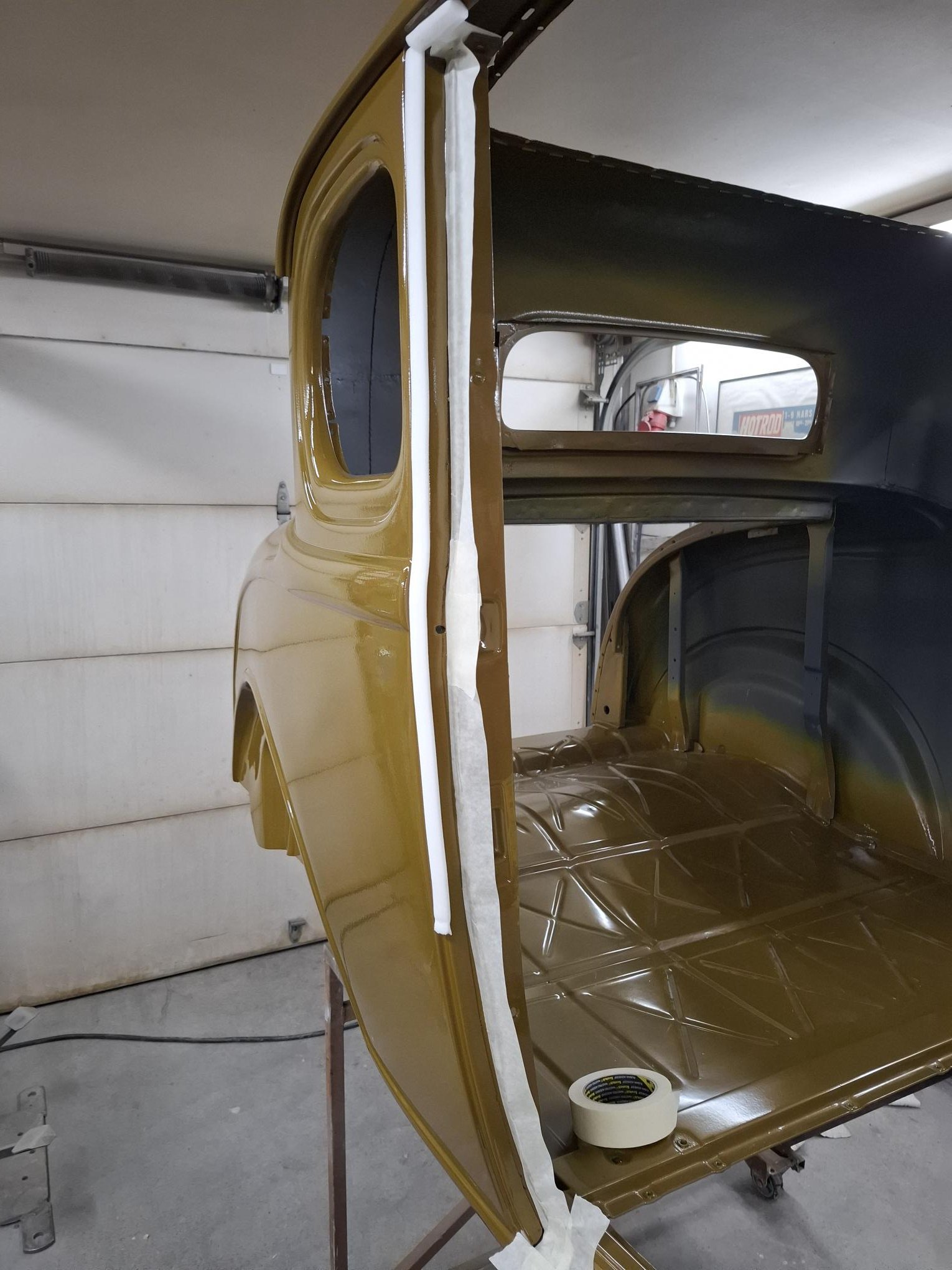

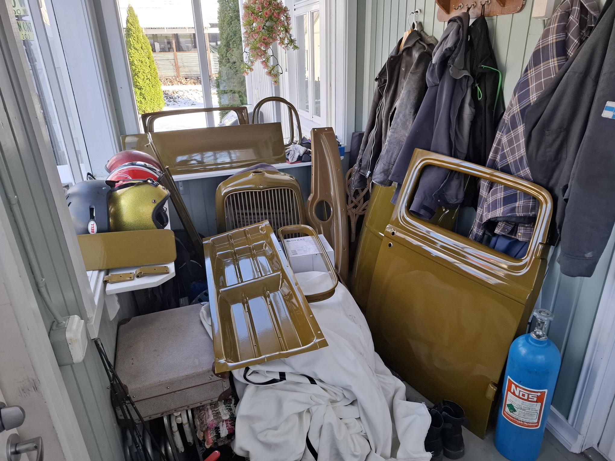

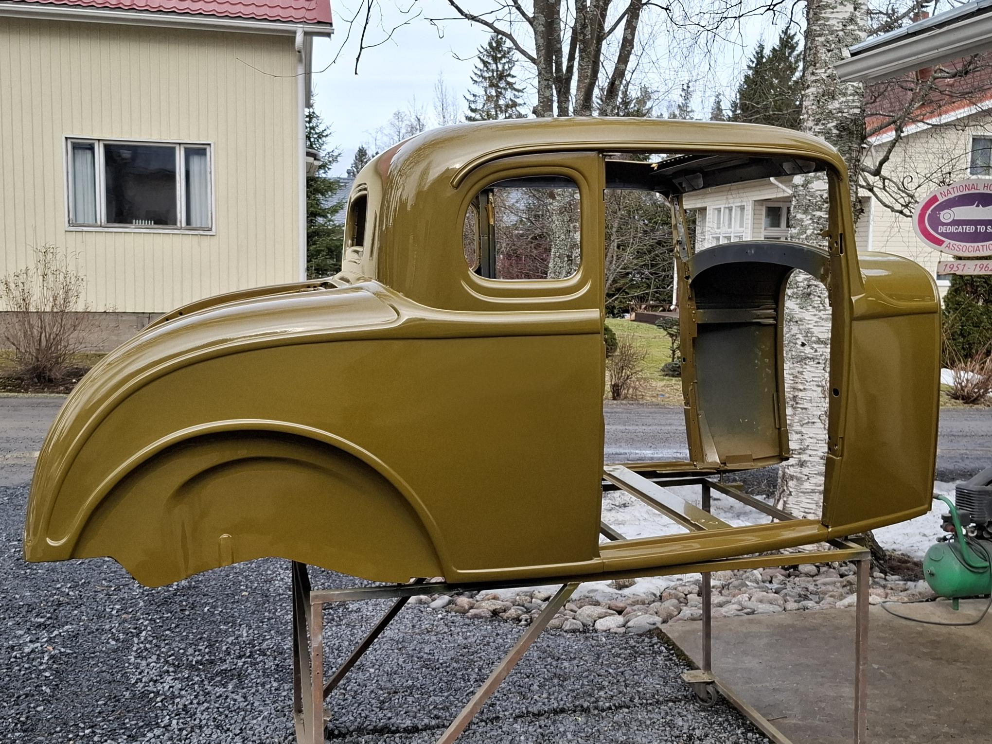

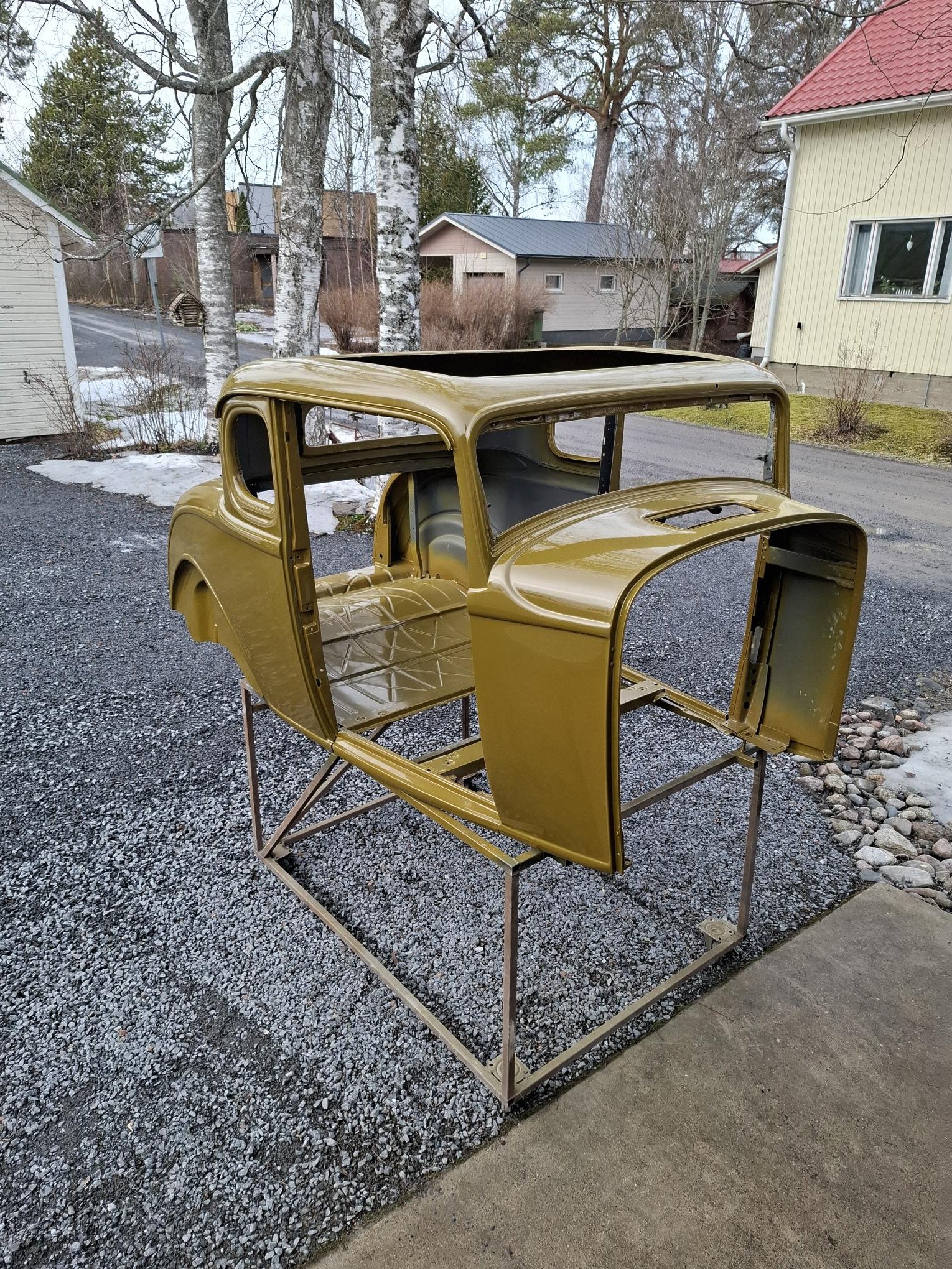

    Pictures are nice,... Sides and cabin backwall are terrible. I was try to increase paint there, but never get good surface. Surface was nearly fall down... "norway mountains"
    One problem is that Im blind. I note that I was left both sied doorposts dry.... so today I painted with mini airbrush.
    Aulis

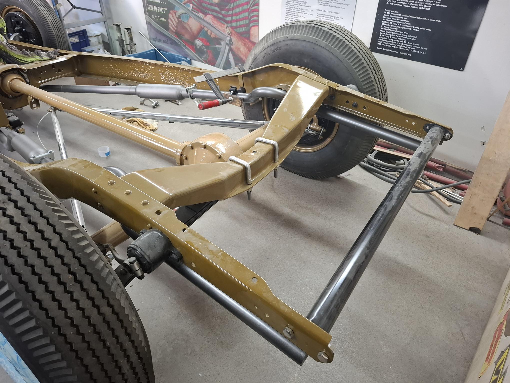

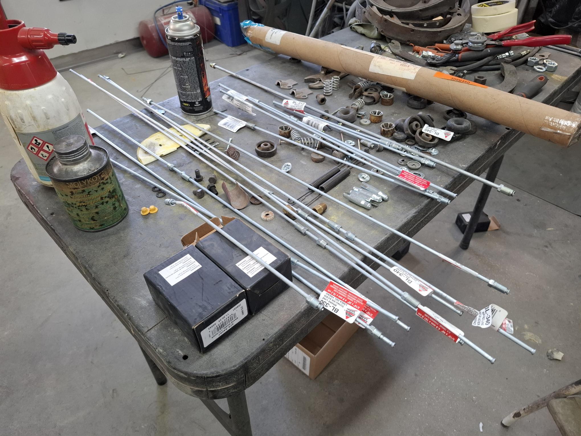

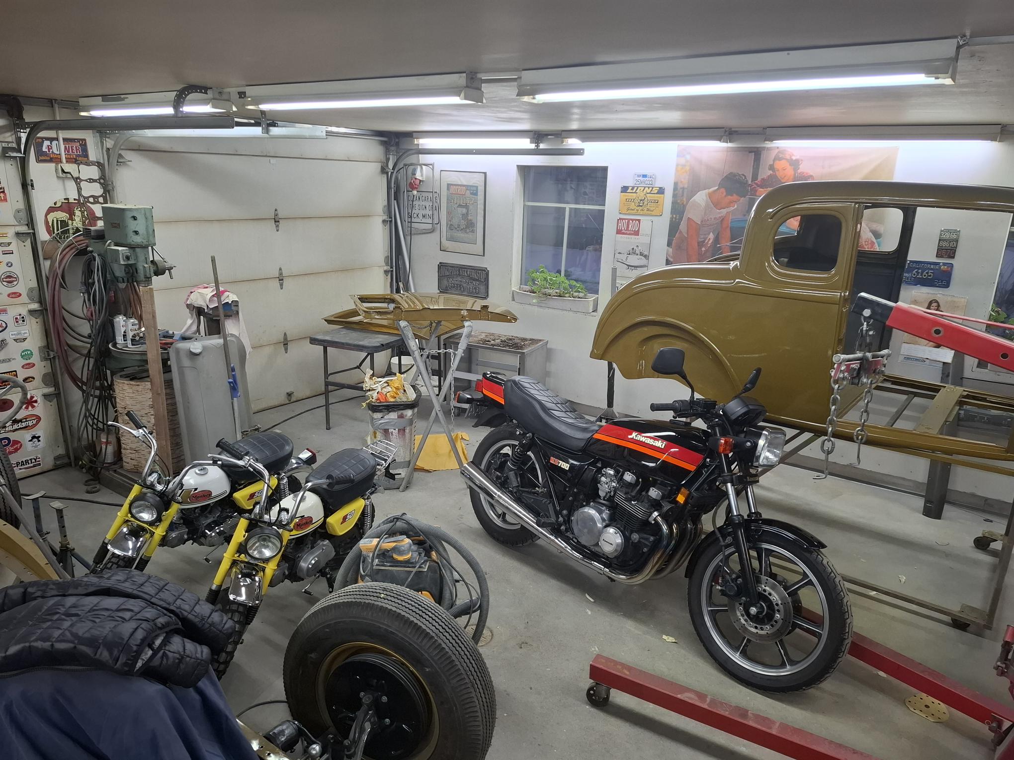

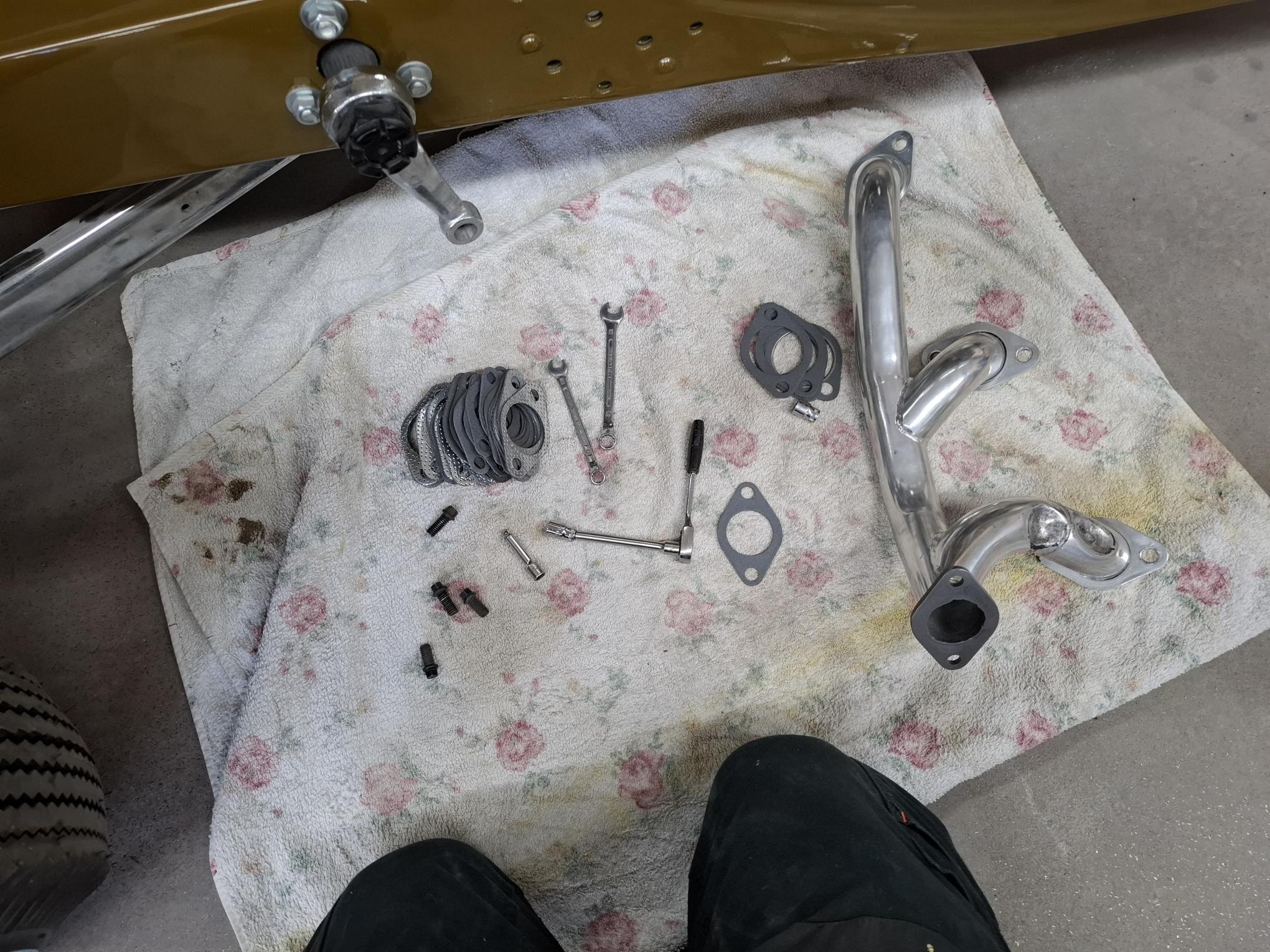

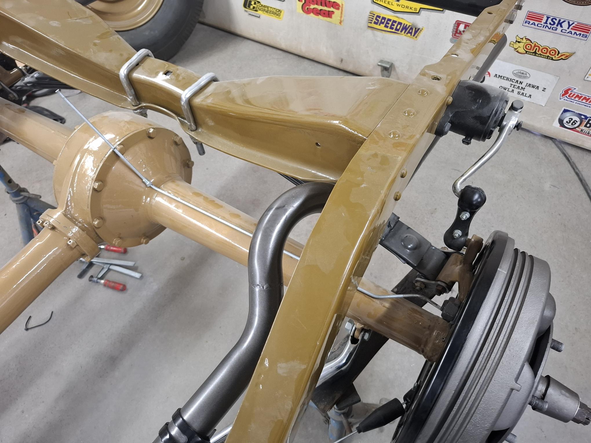

    Weekend they had small motorcycle show here in our city. Oskar had there 2 x Honda Monkey. My California model Kawasaki (1984 KZ700) was also in show. We spend rather much time there. Oskar´s new Monkey inspected there to Historical vehicle registeration (Cars >30y old, Motorcycles/mopeds >35y)

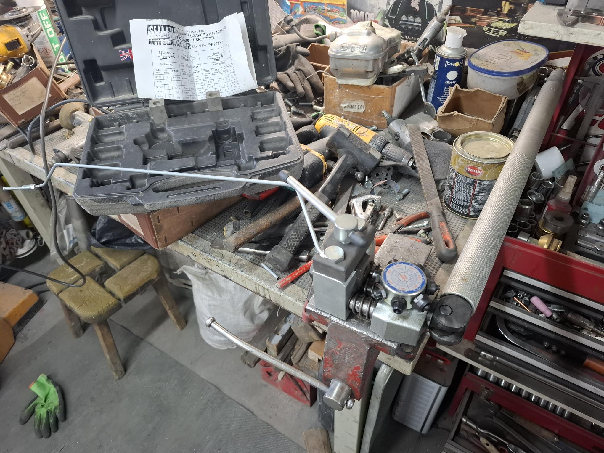

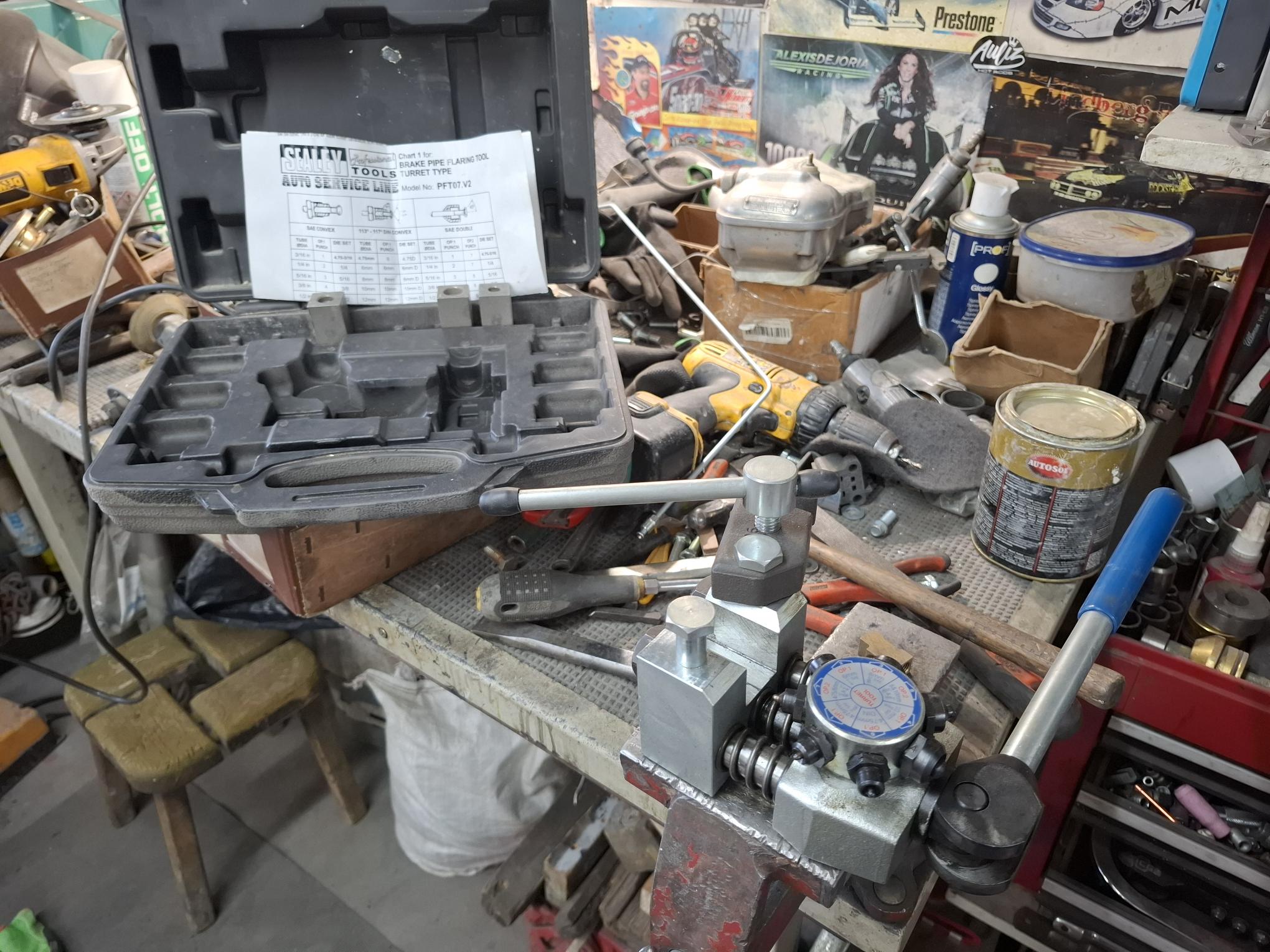

    Today I sanded exhaust , painted and installed. Also installed all brakestuff inside of rear drums. New cylinders, al other used stuff.
    Last hour or two made those two brakelines. Tomorrow need to make rest of brake lines.

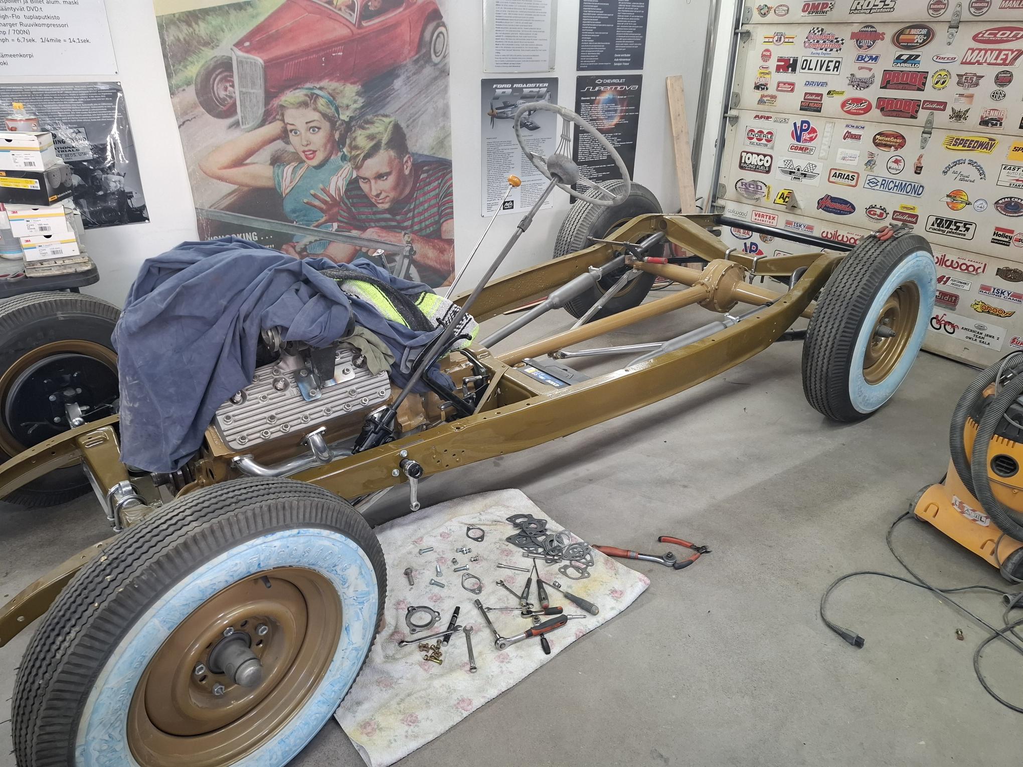

    Brakelines nearly ready. Tomorrow morning I fix those ready, make mountings to frame etc.
    Aulis

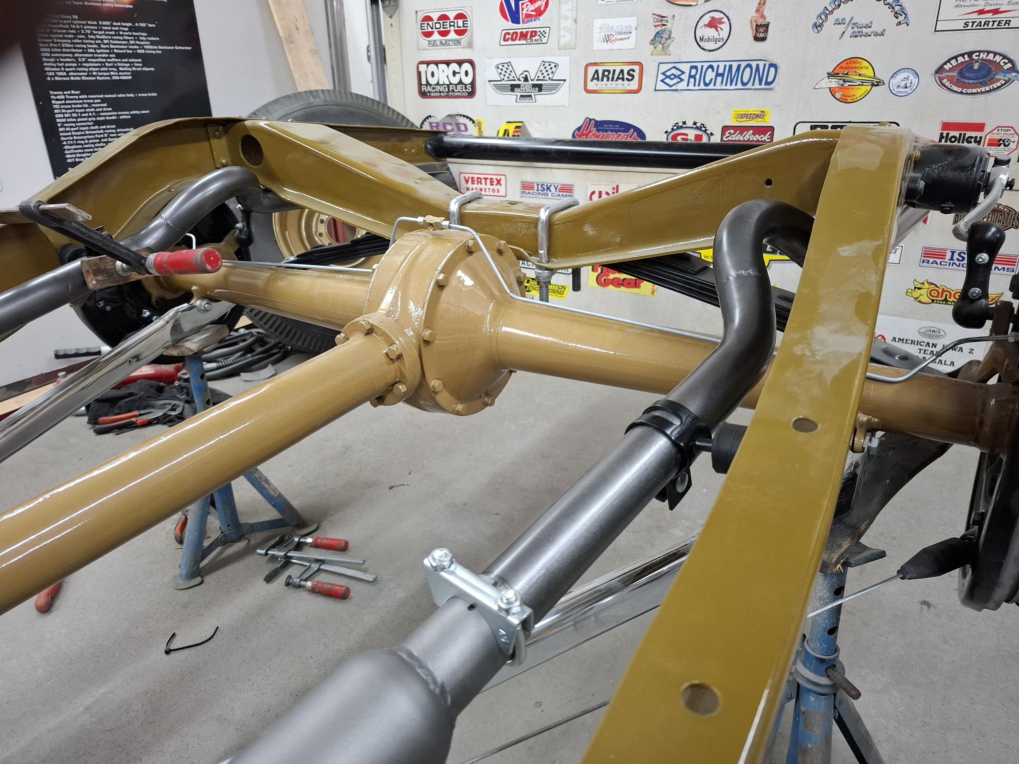

    Brakelines are mounted, fittings tighted.
    Front brakes also put together and connected to brakelines.
    Fuelline is also waiting for firewall. Driverside I use original fuelline mounting clip.
    Aulis

    AULIZ
    Sunday.
    I was 4hours in garage. bolted top wood, lifted body on frame.
    Feels good, very good.
    AULIS
    rod-coupe1154.jpg rod-coupe1155.jpg rod-coupe1156.jpg rod-coupe1157.jpg rod-coupe1158.jpg rod-coupe1160.jpg rod-coupe1161.jpg rod-coupe1162.jpg rod-coupe1163.jpg
    brEad, bymanr, '28phonebooth and 12 others like this.
