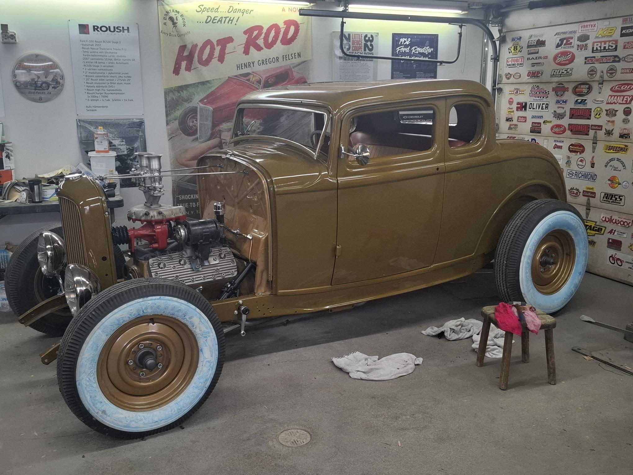

  7. AULIZ
    Joined: Oct 28, 2005
    Posts: 1,793
    AULIZ
    Cowl lid finally installed. Lid hinge rivets need to drill out etc.
    Tomorrow morning I install final time all woods inside of body.
    Today test bolted trunk lid on its place. Tomorow morning I remove it and fix little.
    Column drop works fine. I was bought key blank from USA, now locksmith grind it ready. Original key was wear, good reserve key.
    Aulis
    rod-coupe1181.jpg rod-coupe1182.jpg rod-coupe1183.jpg rod-coupe1184.jpg rod-coupe1185.jpg rod-coupe1186.jpg
    brEad, swade41, Tim and 11 others like this.

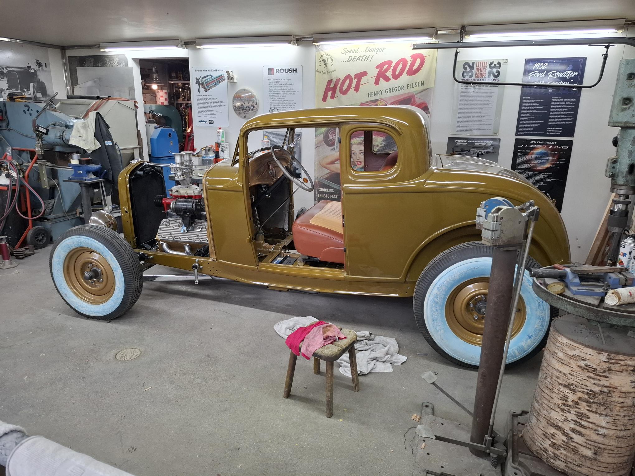

  9. AULIZ
    Posts: 1,793
    AULIZ
    Today only 4hours in garage. Homeworks take so much time. Sunday I try to install driver side panel. Once more need to remomve woods. support bracket from horizontal wood to top wood need to straight and turn again. I did that p*** side too.
    Need to increase 3 woodscrew more, then already installed panel is on its place.
    Quarter and rear window seal is bought from UK. Clive from Stromberg bought it and increased to same shipment where are my other stromberg parts.
    Aulis
    rod-coupe1194.jpg rod-coupe1195.jpg rod-coupe1196.jpg rod-coupe1197.jpg rod-coupe1198.jpg

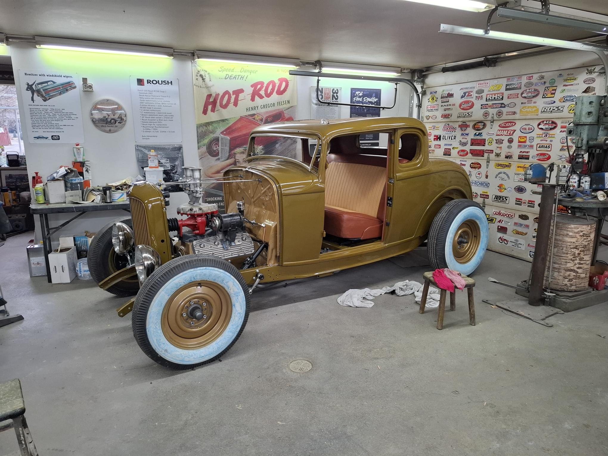

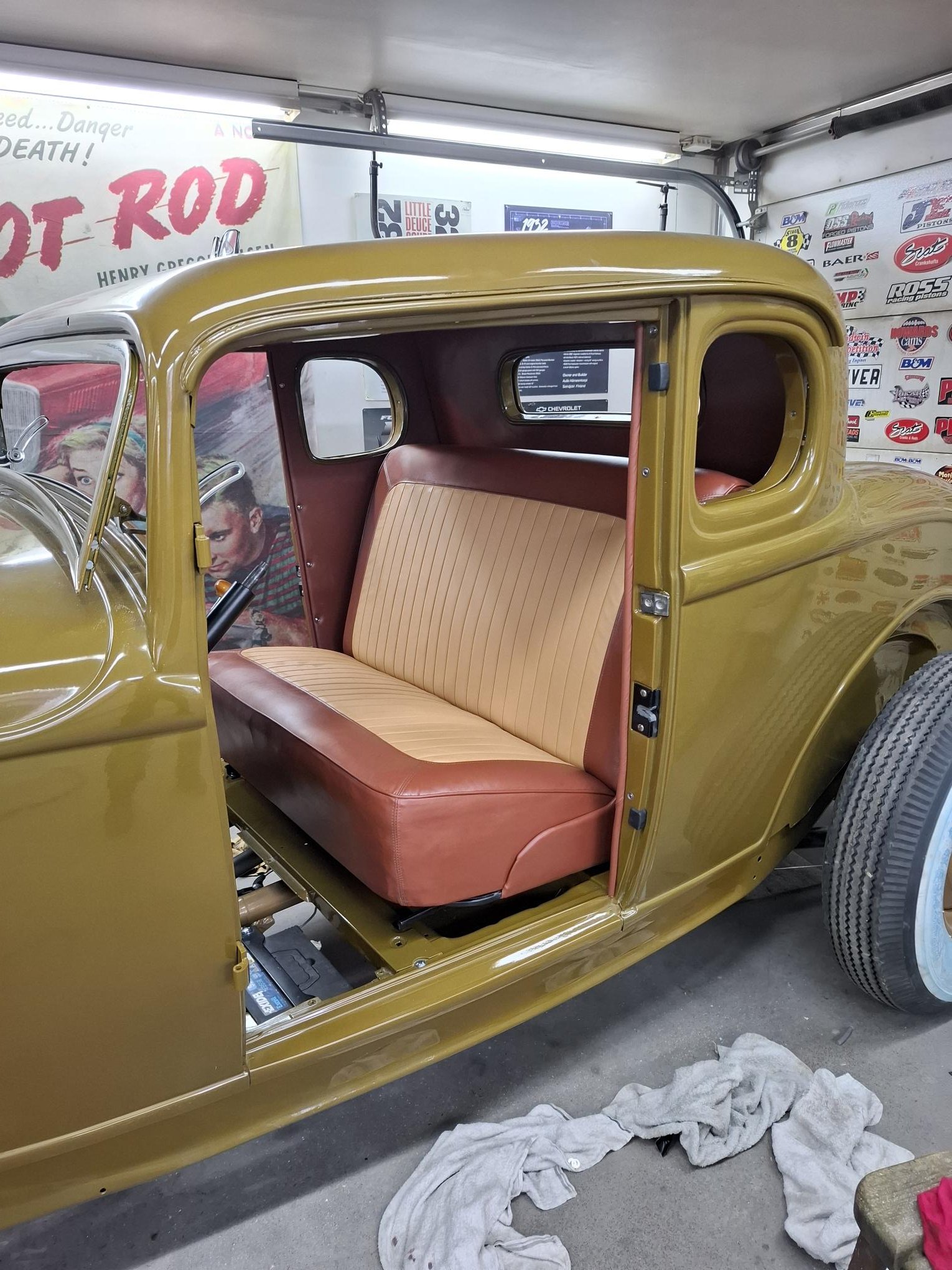

  17. AULIZ
    Posts: 1,793
    AULIZ
    Seat with sliders are bolted on. Doors, stoppers, latches, male dovetails... installed too.
    Aulis
