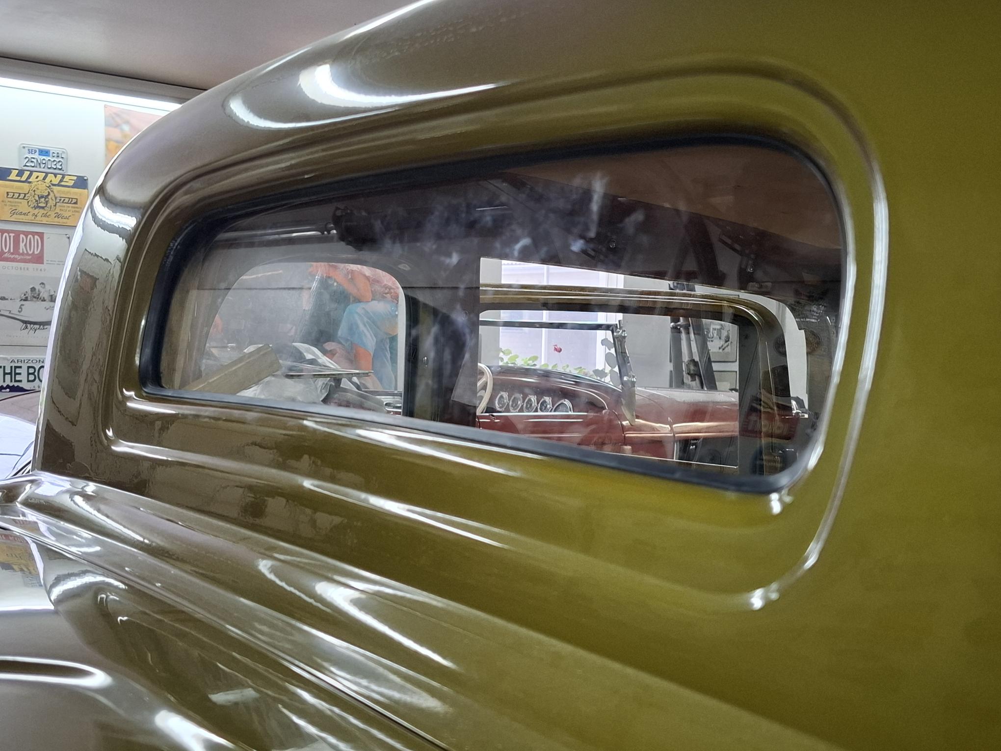

  4. AULIZ
    Joined: Oct 28, 2005
    Posts: 1,793
    AULIZ

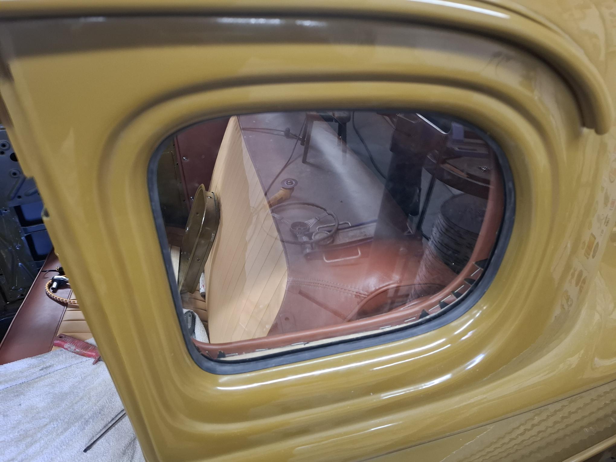

    Quarter windows are installed.
    Aulis
    rod-coupe1232.jpg rod-coupe1233.jpg rod-coupe1234.jpg rod-coupe1235.jpg rod-coupe1236.jpg

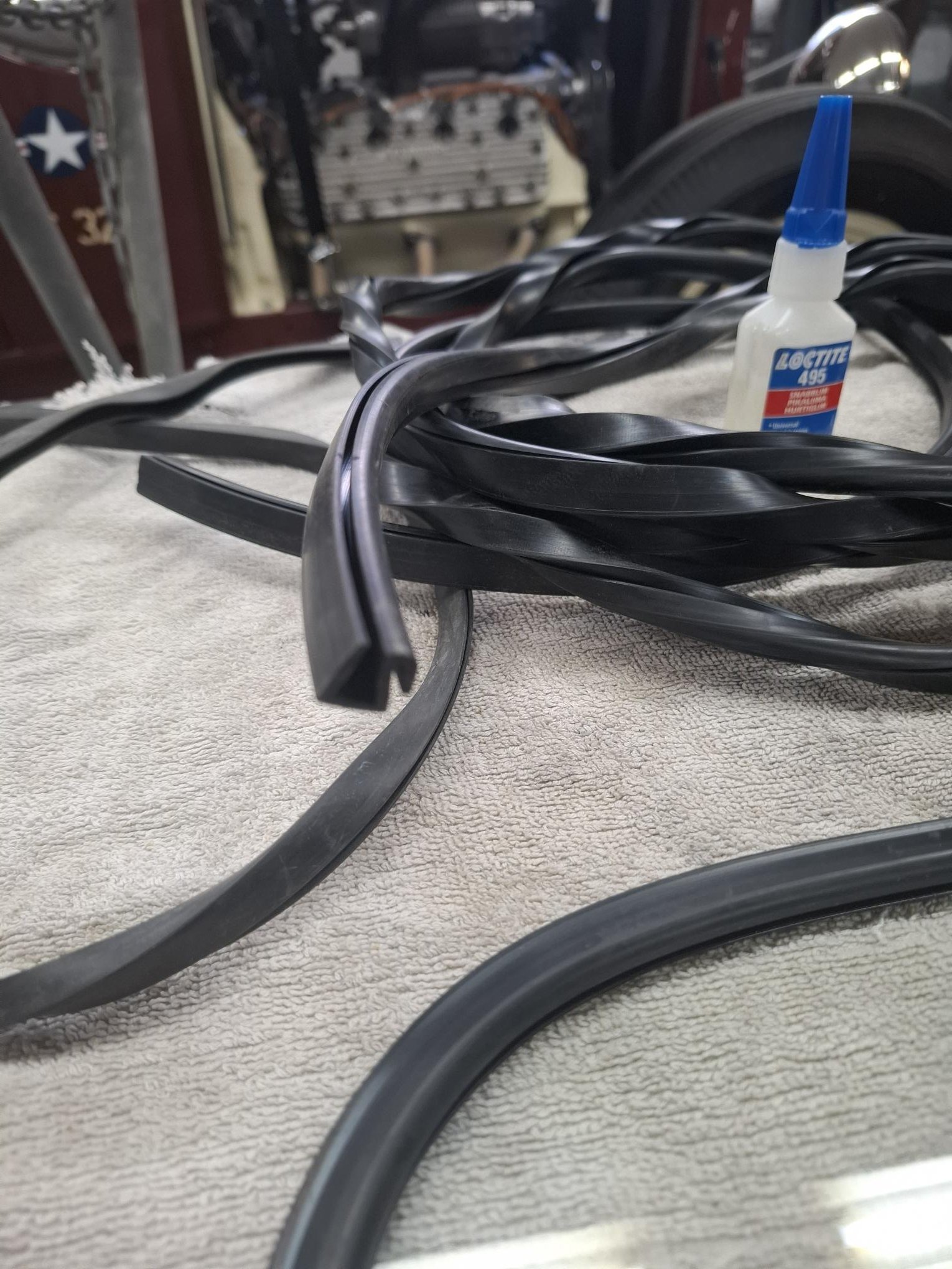

  5. Deutscher
    Joined: Nov 12, 2024
    Posts: 468
    Deutscher
    from Germany
    Hi Aulitz, what's your seal for the rear side window?
    What's that?
    It looks better than the original U-shaped one.
    Regards, Harald
  6. AULIZ
    Posts: 1,793
    AULIZ
    You can read my former postings 2-3weeks ago.
    From UK.

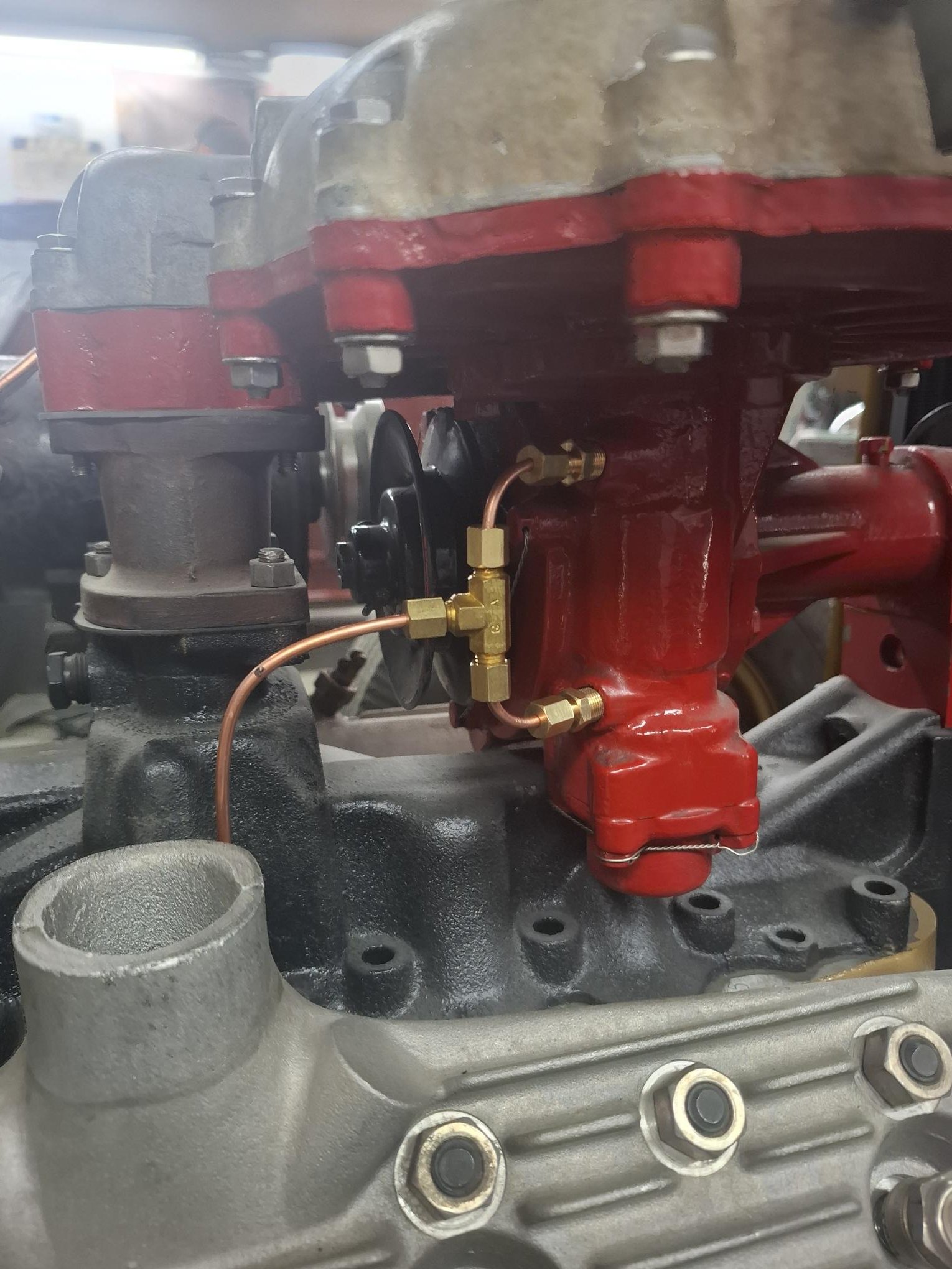

    Today had few hours time to install rest of gl***es.
    Also get small shipment from finnish "small stuff seller". McCulloch oilpipes are ready.
    Aulis
    rod-coupe1237.jpg rod-coupe1238.jpg rod-coupe1239.jpg rod-coupe1240.jpg rod-coupe1241.jpg rod-coupe1242.jpg rod-coupe1243.jpg

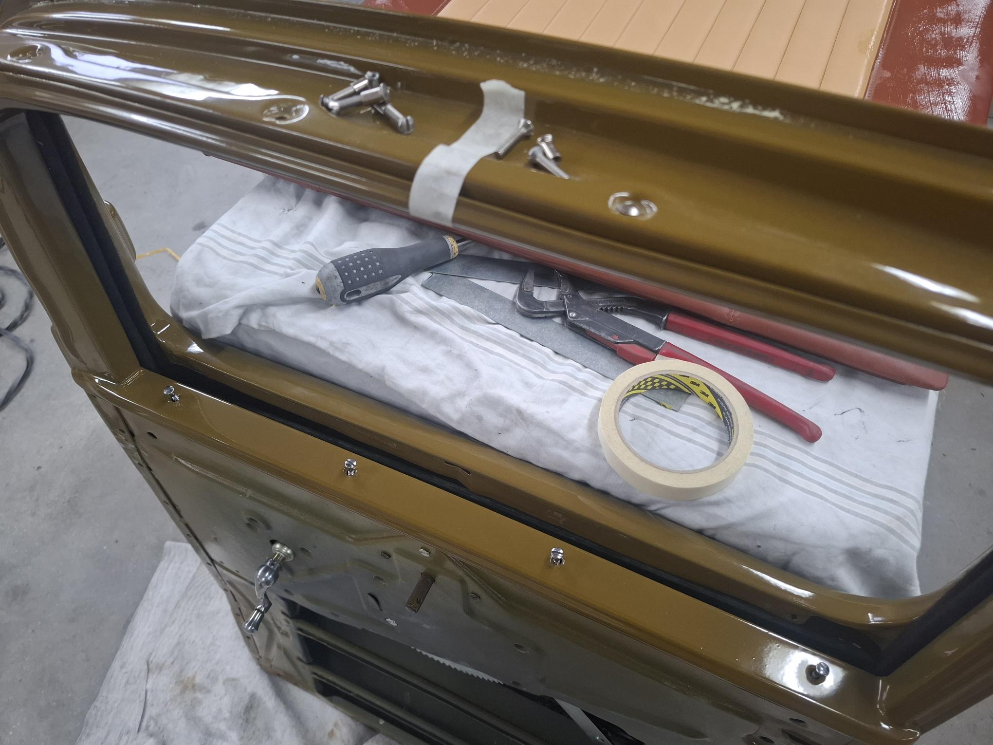

  8. AmishMike
    Joined: Mar 27, 2014
    Posts: 1,568
    AmishMike

  9. Robdski
    Joined: Jun 28, 2024
    Posts: 182
    Robdski
    Thanks for the detailed photos of the window seals.
    You are making great progress!

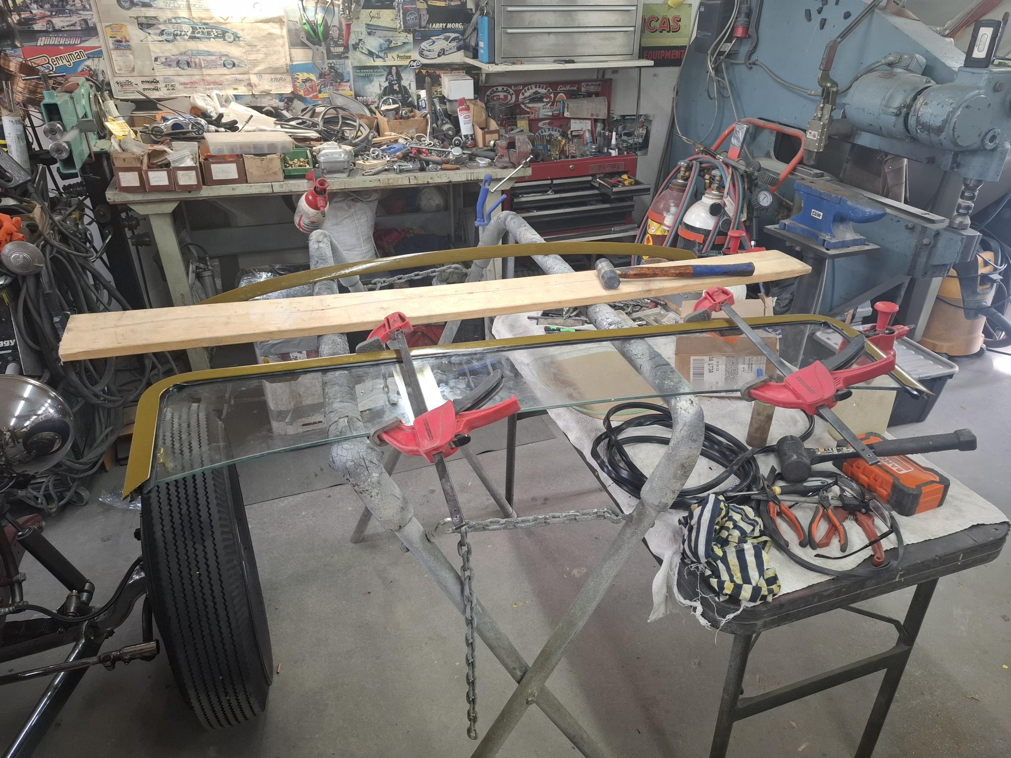

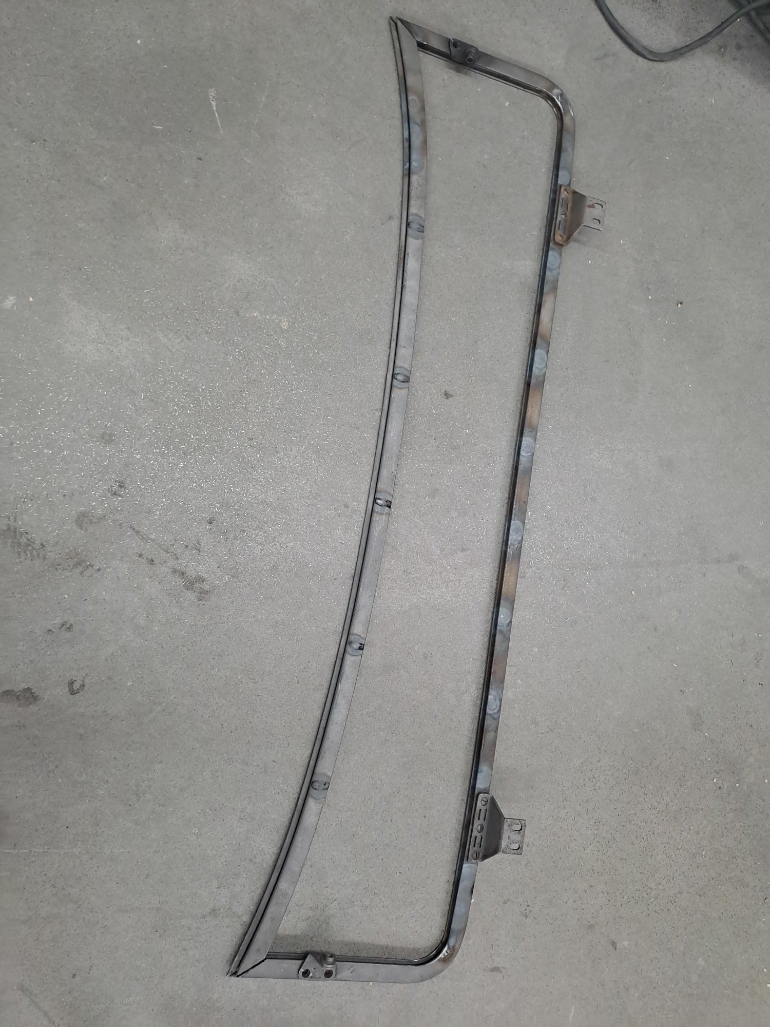

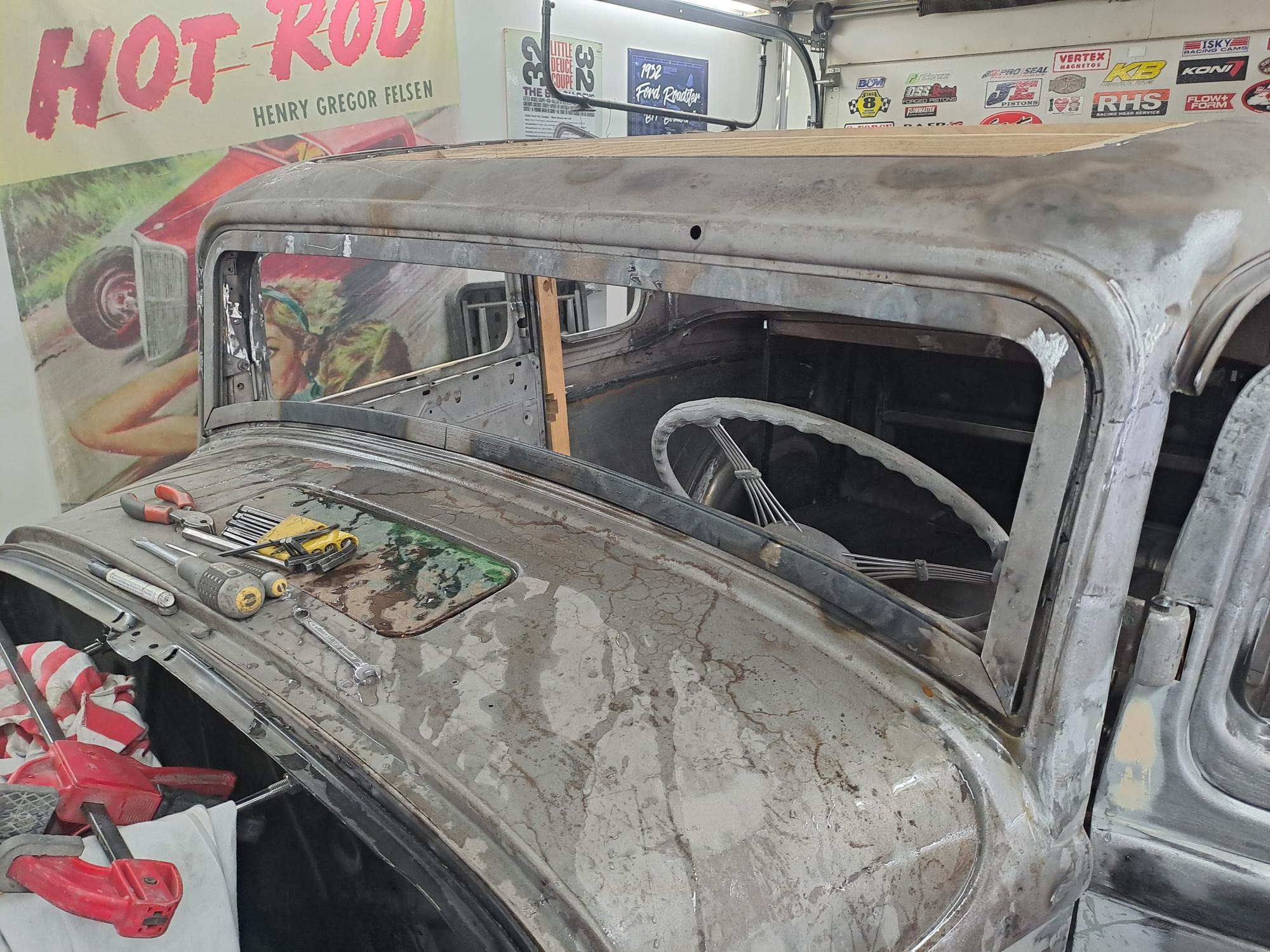

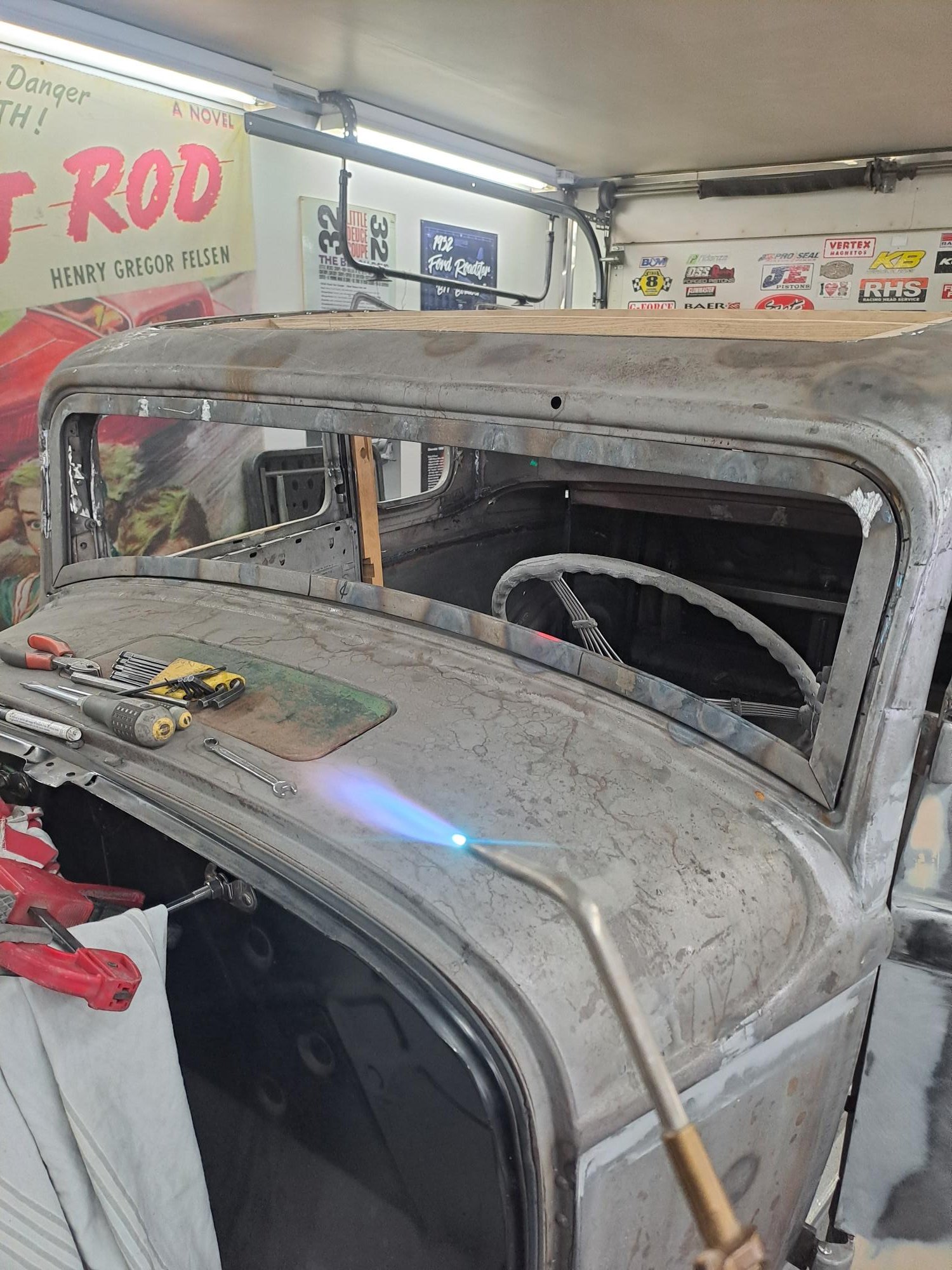

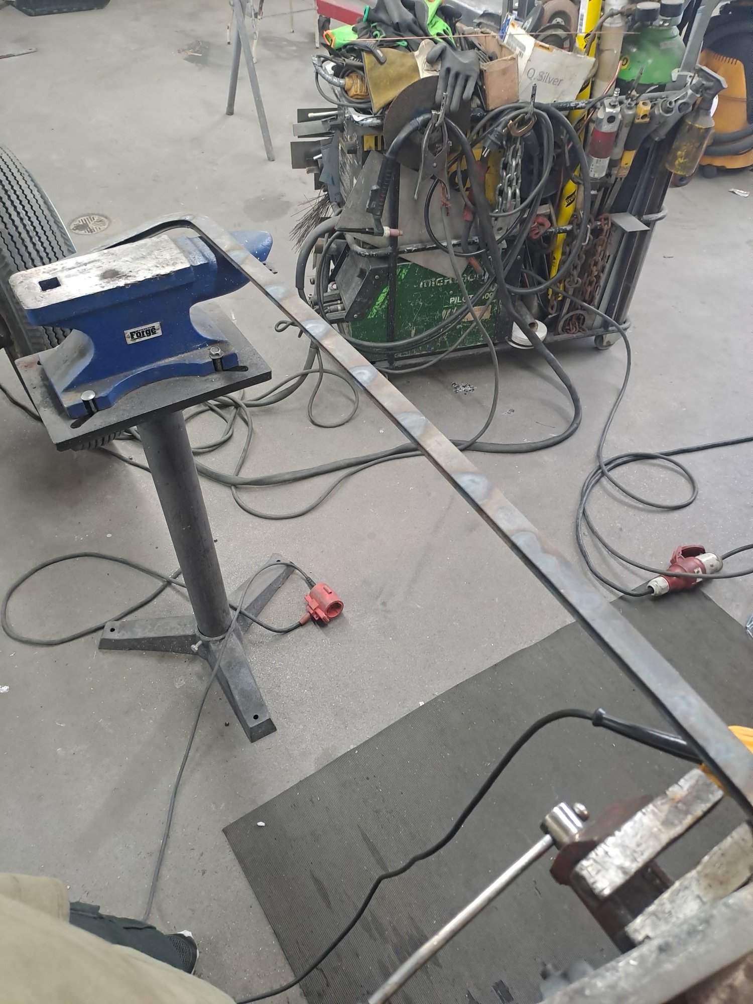

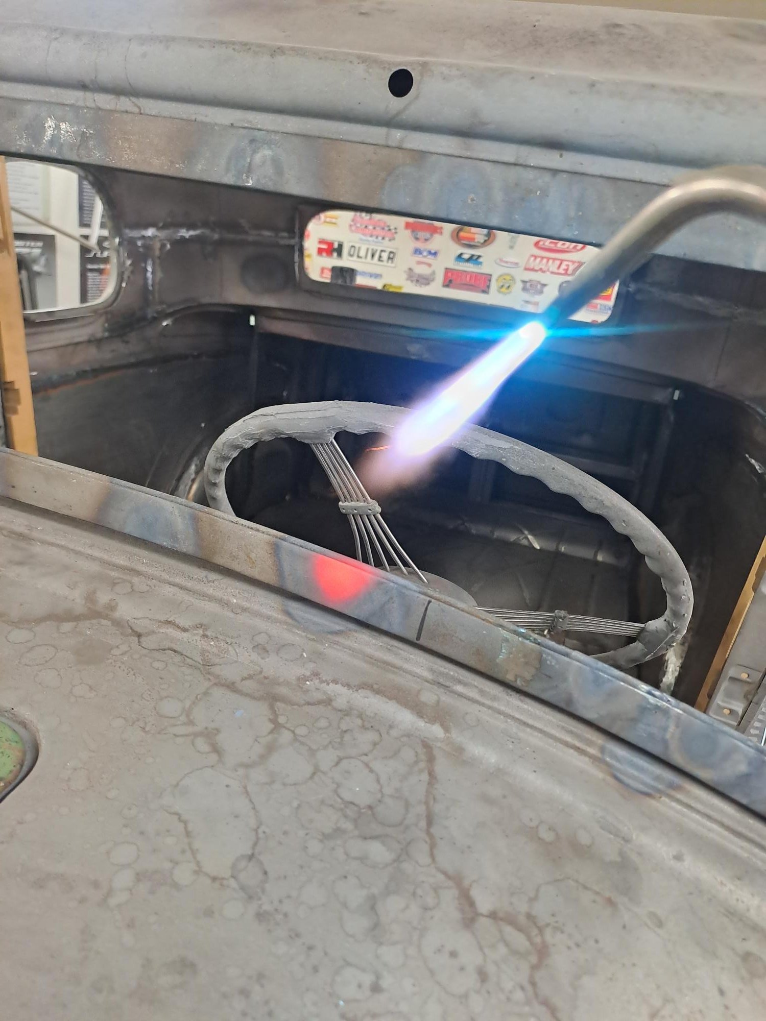

  11. L. Eckart
    Joined: Jul 8, 2005
    Posts: 651
    L. Eckart
    I may have missed it. Did you show the process of cutting your windshield frame down?
    PONTNAK123 likes this.
  12. AULIZ
    Posts: 1,793
    AULIZ

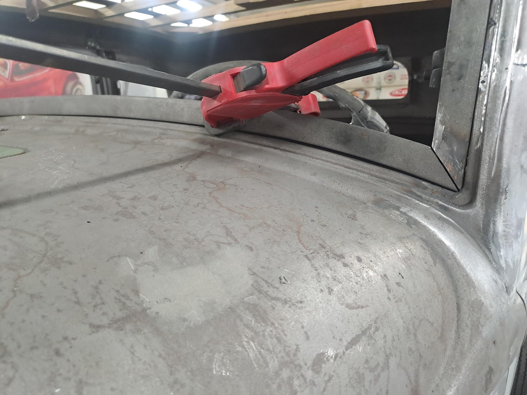

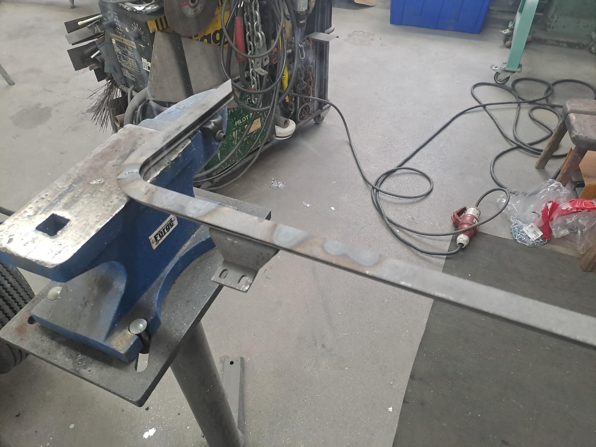

    Thank You Everybody.

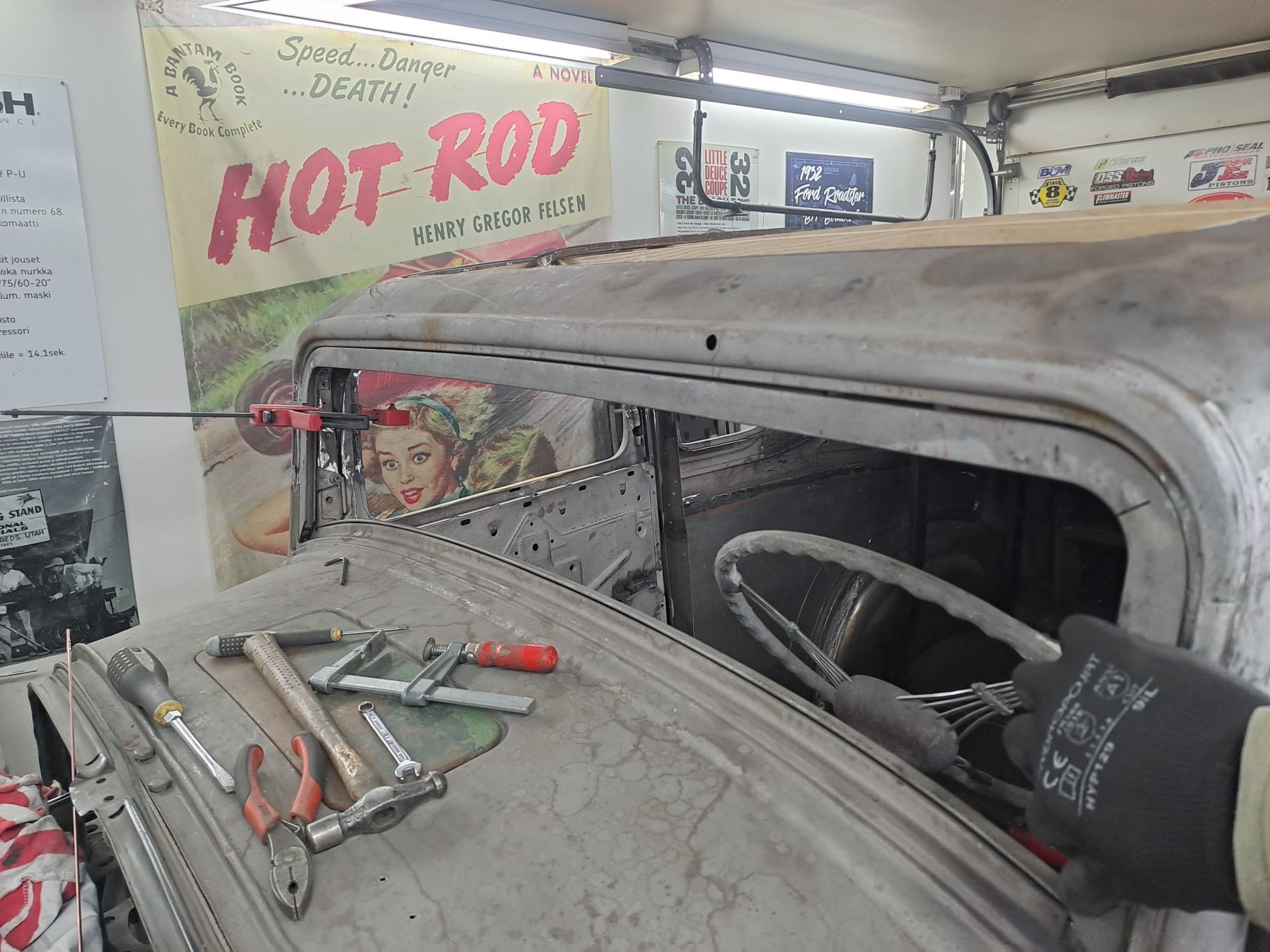

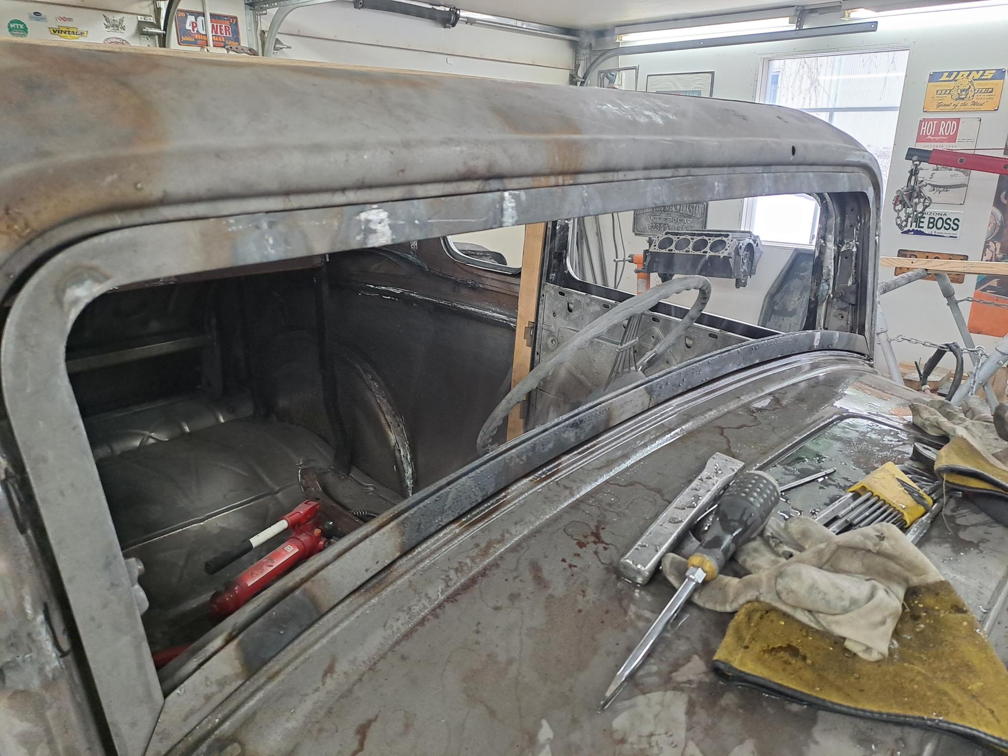

    Only few pictures about windshield. First I try to get it straight, maybe it was met bullets in its early life.... or
    somebody was drive over it.... When You chop top, windshield frame and A-pillar angle is change too.
    Its more V-letter style than when original height.
    Here few pics.
    Now breakfast is eaten, very much coffee and fireplace is ready. I install garnish mouldings, windshield frame on body (Yesterday I broken one windshield, they cut and grind me new one. Good thing, it was only 30euro (30usd).
    Aulis
    NB. Now I have decided that I send this HotRod to USA 2026. Plan is that car is in east coast August 2026. I have start to put money "2026 USA Trip Fund".
    I want to drive coast to coast slowly in 2-3 part ( 2-3 x 4week). I want to meet face to face hot rodders there, I want to stop different American Car / Drag Race / Hot Rod / Swap meet -weekends. From East coast up to northern states, down to same way with missisippi, middle states, south,... Next winter I try to put all timeschedule on paper. Also need help keep my car there in Garages when Im while back home.
    rod-coupe520.jpg rod-coupe521.jpg rod-coupe522.jpg rod-coupe523.jpg rod-coupe524.jpg rod-coupe525.jpg
    rod-coupe526.jpg rod-coupe526.jpg rod-coupe527.jpg rod-coupe528.jpg rod-coupe531.jpg

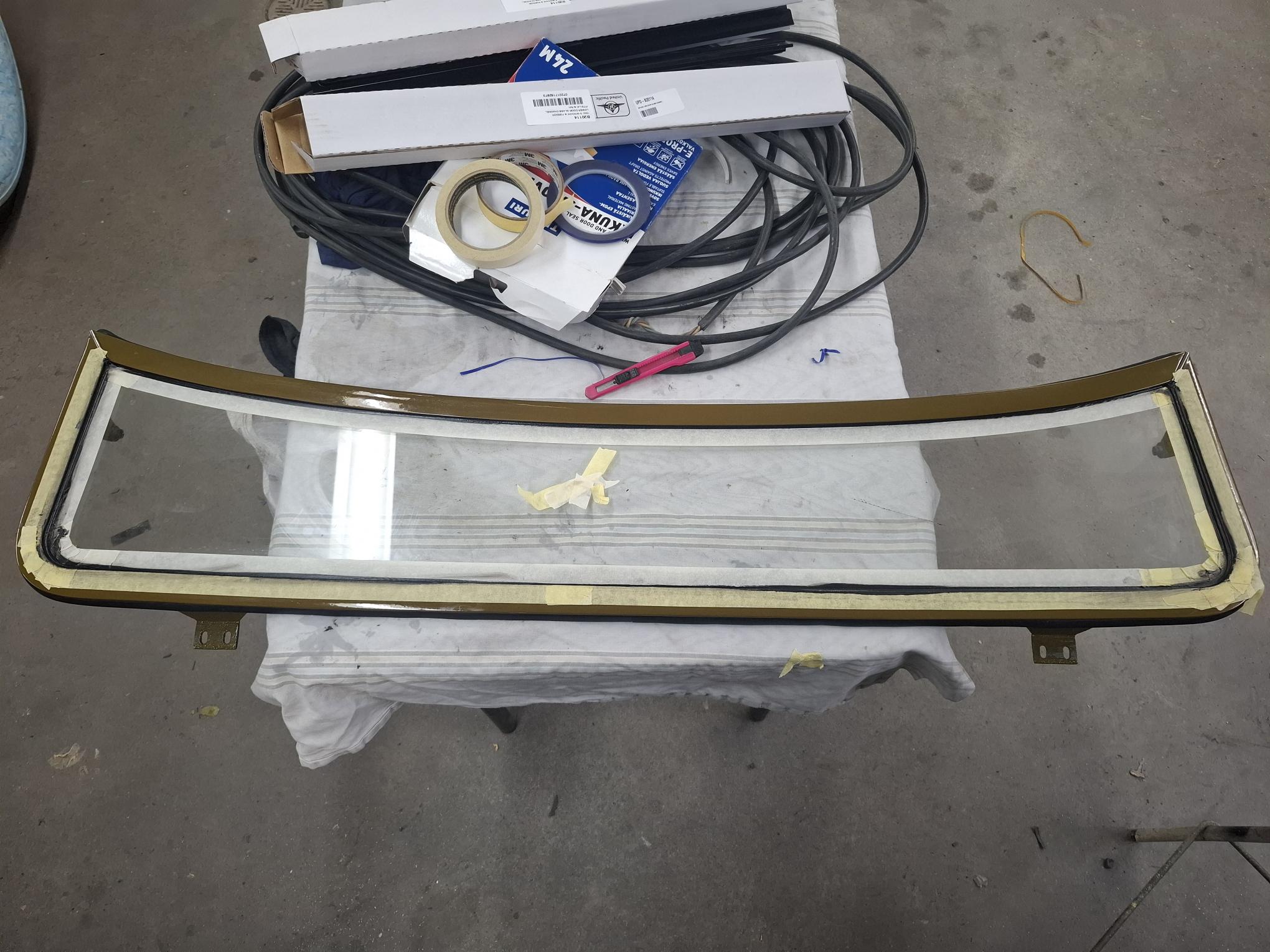

    Today we were 5hours in garage, afternoon.
    Oskar worked with his Benetton Edition 1990 Honda Monkey, I get windshield installed.
    WIndshield frame seal is very tight. I hope its more bendy when weather is warmer.

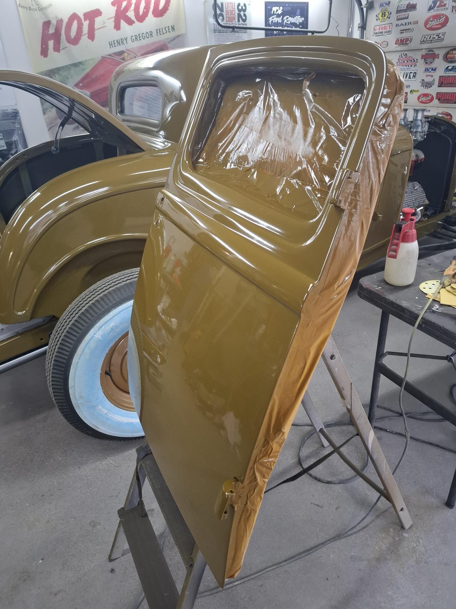

    Few days gone, nothing happened in garage.
    Today installed p***.side door ready, kick panels, windshield... Also cut, raised and welded trunk lid latch striker plate. Trunk lid innel panel is not original, so maybe latch is located 10mm upper than originally.
    Aulis
    rod-coupe1245.jpg rod-coupe1246.jpg rod-coupe1247.jpg rod-coupe1248.jpg rod-coupe1249.jpg rod-coupe1250.jpg rod-coupe1251.jpg rod-coupe1252.jpg rod-coupe1254.jpg rod-coupe1255.jpg rod-coupe1256.jpg rod-coupe1257.jpg

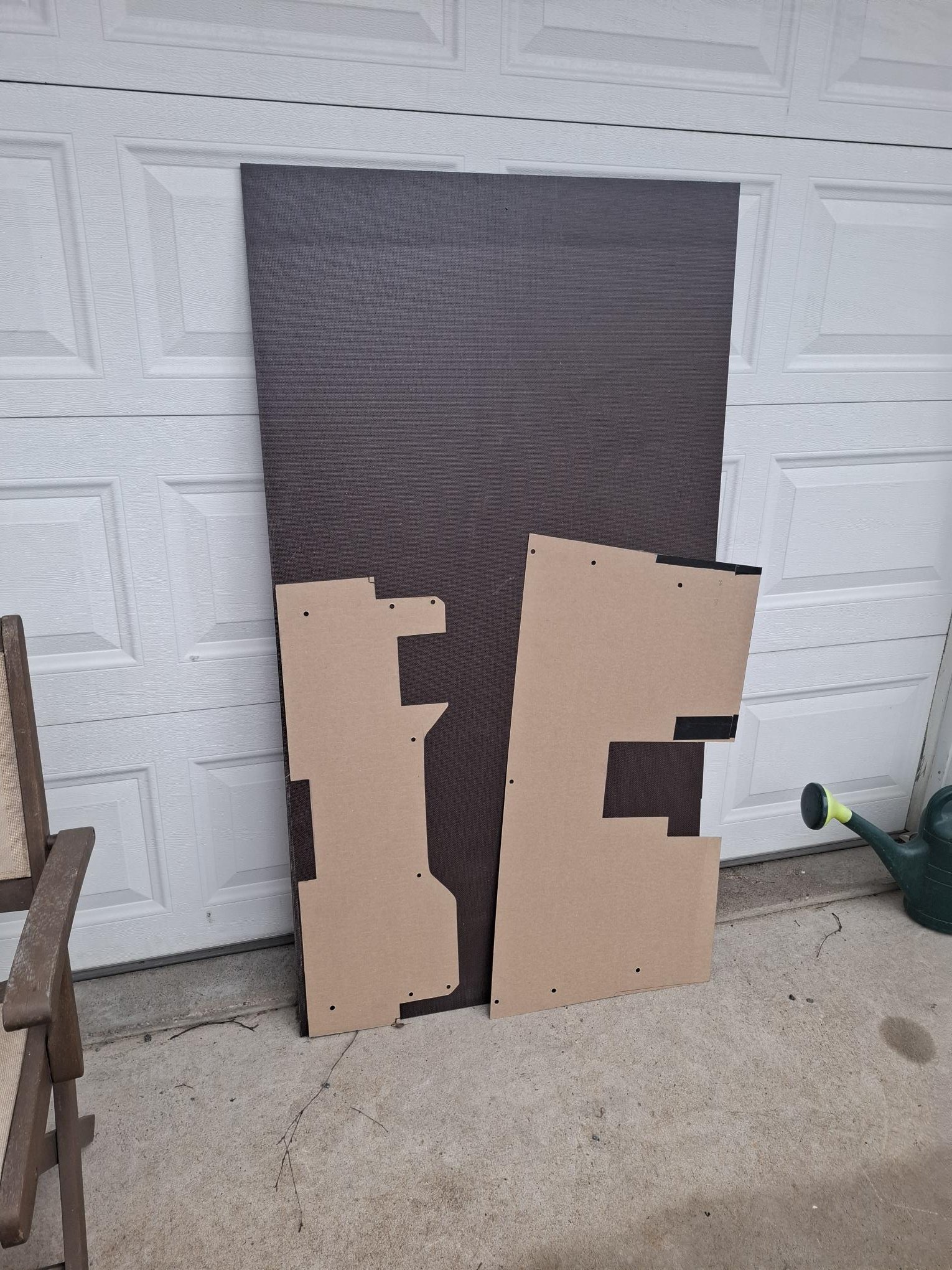

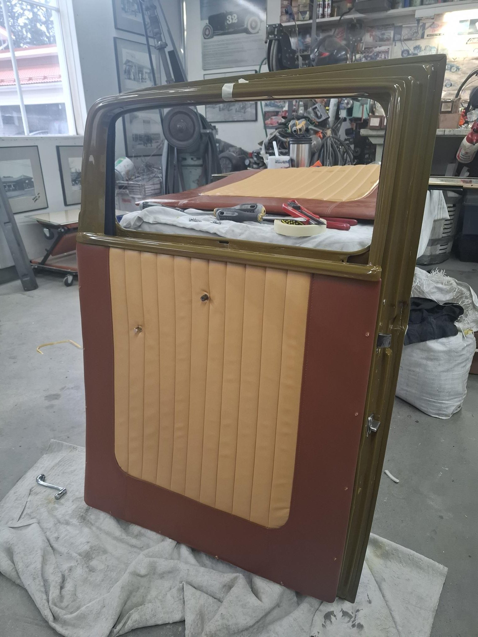

  29. AULIZ
    Posts: 1,793
    AULIZ

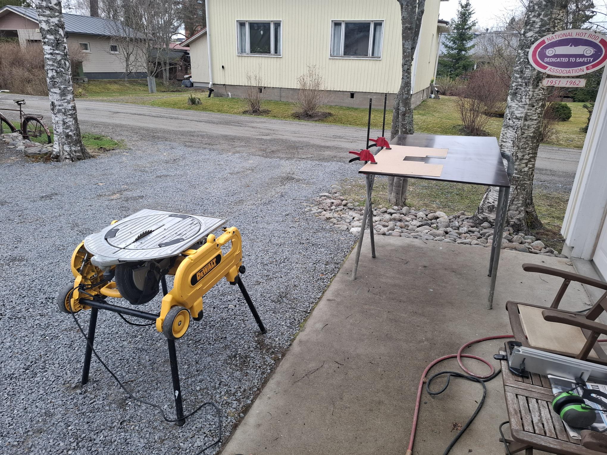

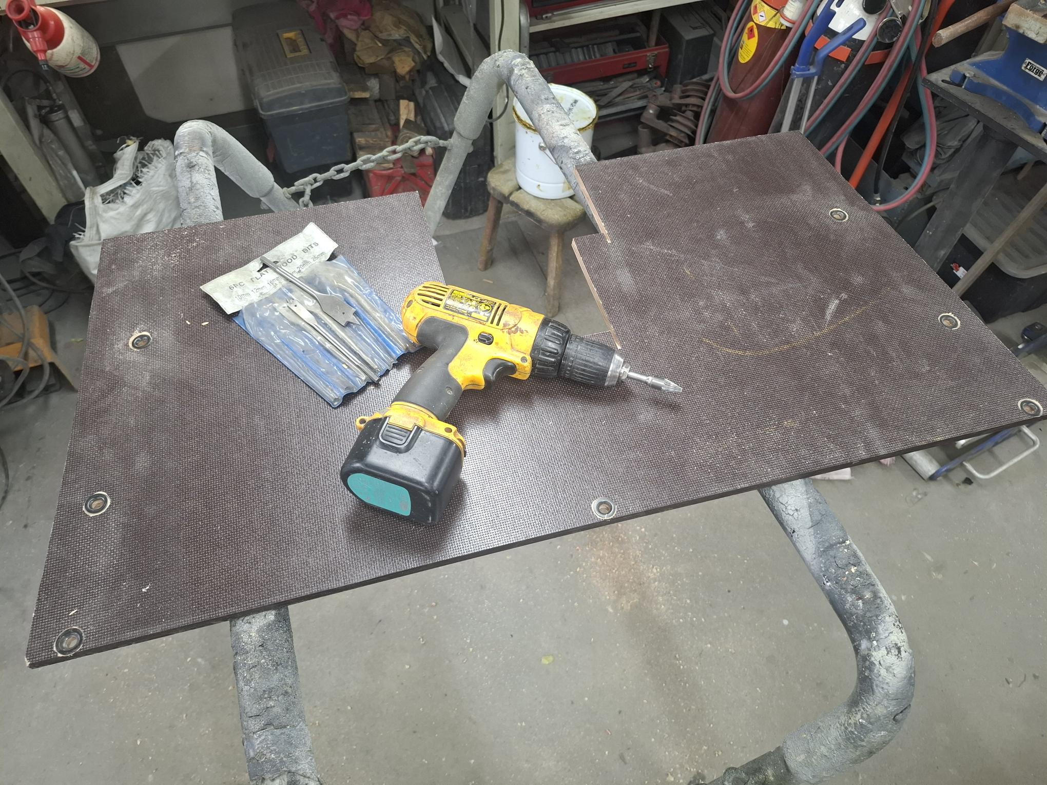

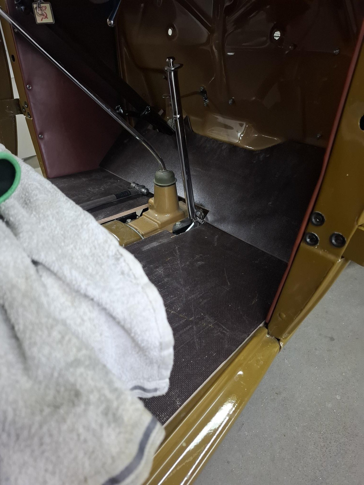

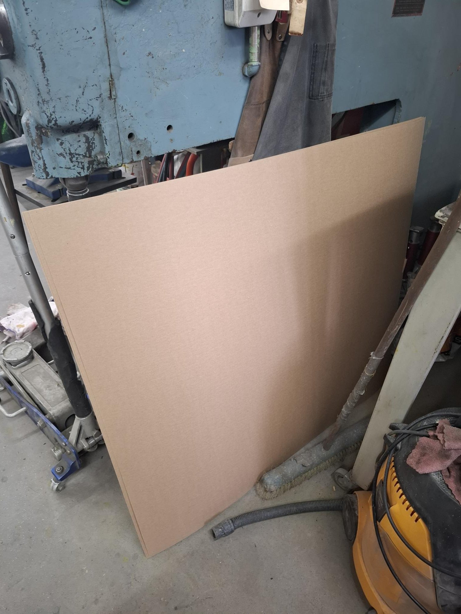

    Easter is over. We spend one long day in garage. I need to repaint p*** side door. Not big deal and paint.
    Today I Started to make floor panels (Exterior marine quality plywood). I bought 2m x 1,5m piece and few cardboard from one of local hardware store. Cardboards need when I make top panel drawing. Im gonna use 1,5mm aluminum on top.
    Aulis
    rod-coupe1259.jpg rod-coupe1260.jpg rod-coupe1261.jpg rod-coupe1262.jpg rod-coupe1263.jpg rod-coupe1264.jpg rod-coupe1265.jpg rod-coupe1266.jpg rod-coupe1267.jpg
    Vic Walter, 63fdsnr, brEad and 8 others like this.

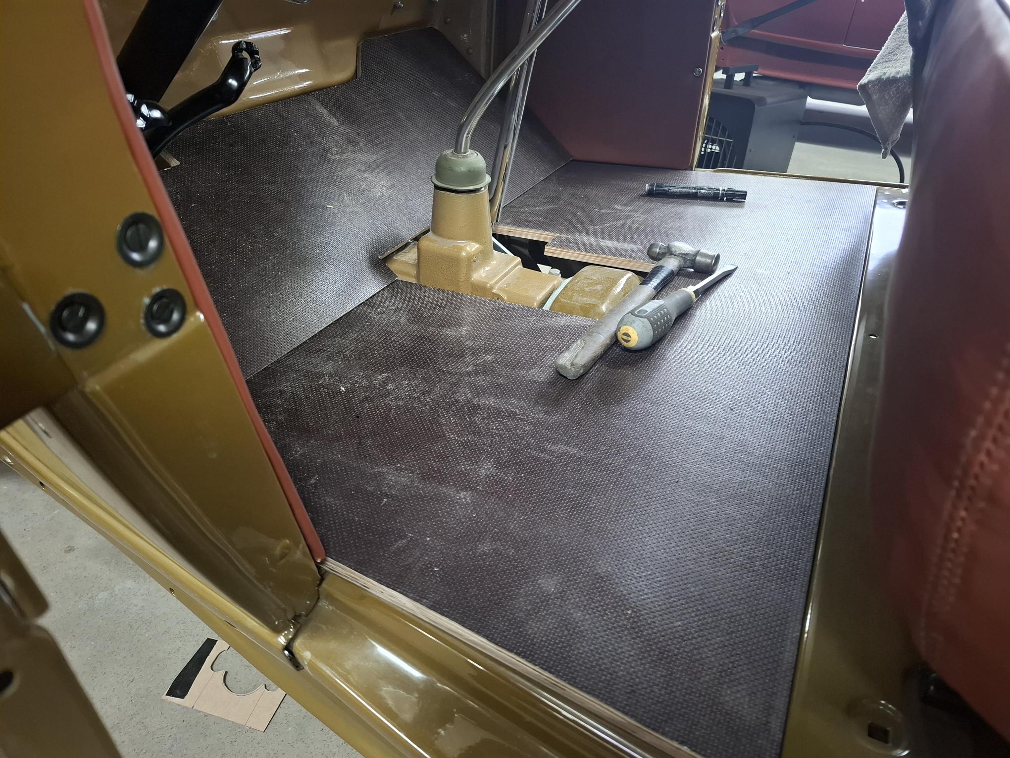

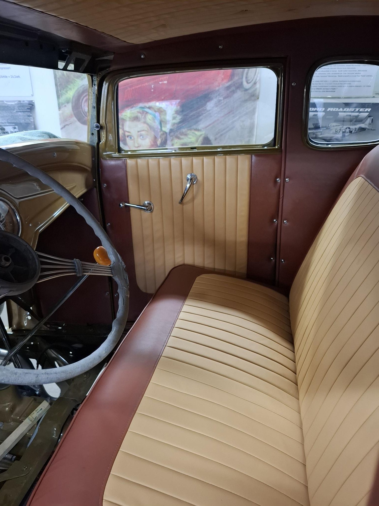

  30. AULIZ
    Posts: 1,793
    AULIZ
    today I continued 5w coupe project.
    Floorboards are nearly ready.
    also drilled and installed door window felt.
    Aulis
