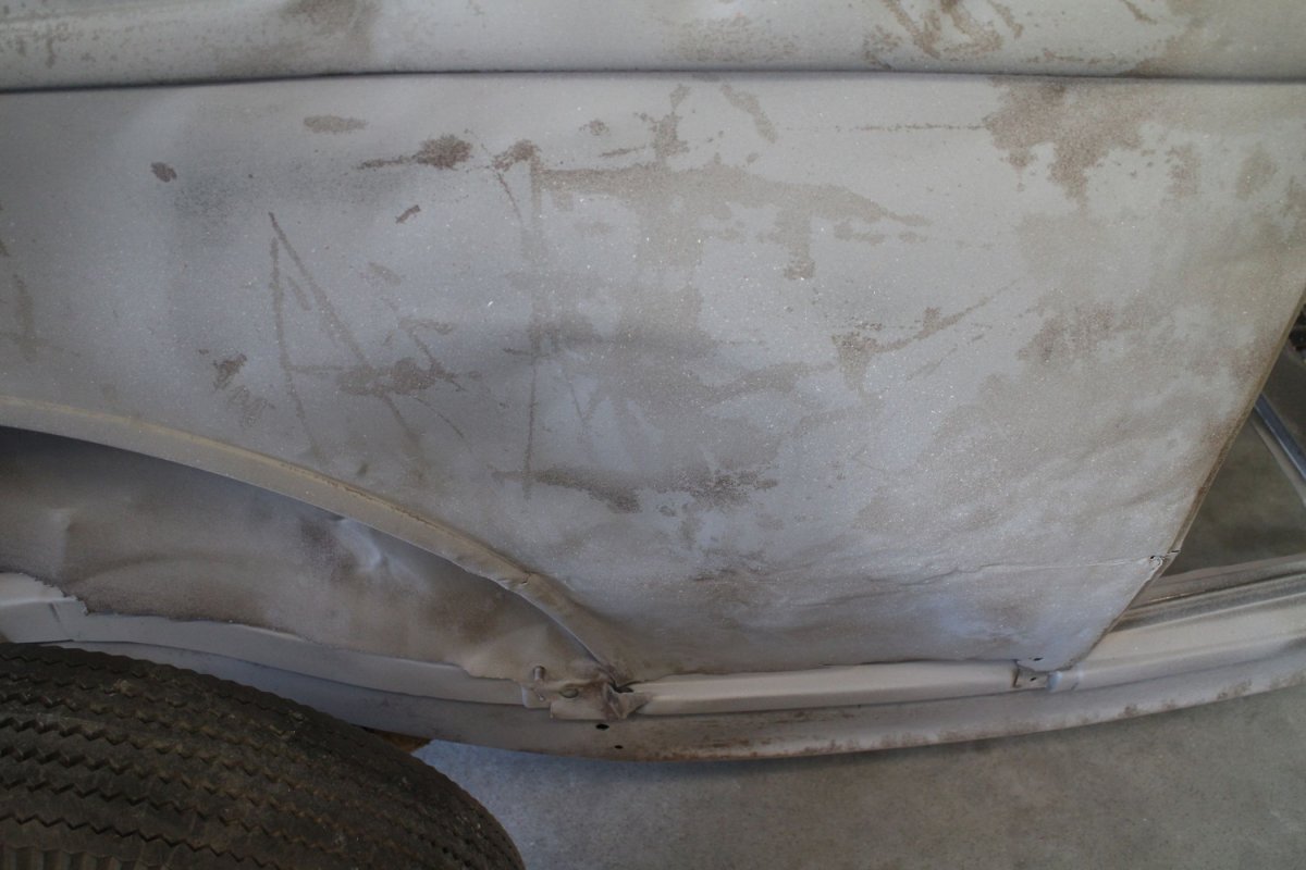

    But ,when car arrived, there is so much cracks all over body, too much missing sheet metal,... so,
    too bad body for "original style patin rod".

    First I make new rear quarters, door skins, LH cowl side, trunk lid,....then I see what it looks and decide if I cut 1" from top.

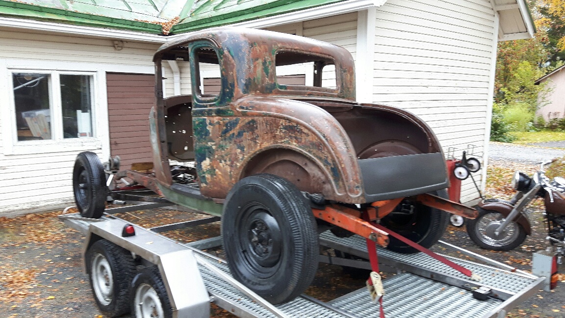

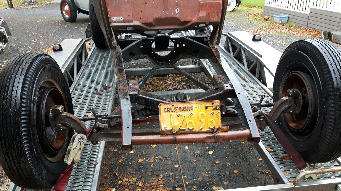

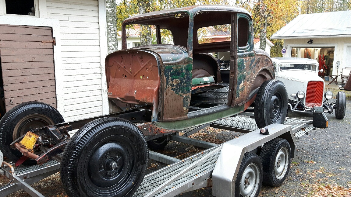

    I found one "sunny" pic of new familymember. Took in Customs after container unloaded.

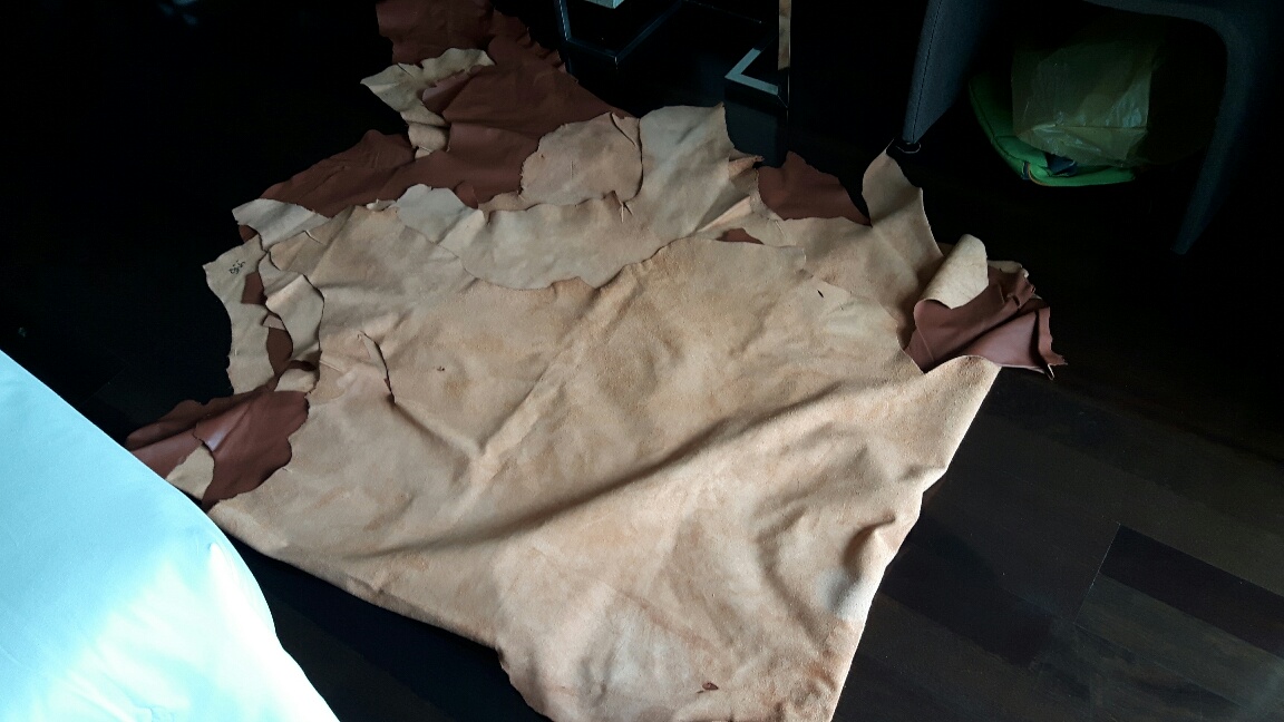

    110 sqf top qulity leather bought and packed in to travelling bag.
    Bought some crocodile tail leathers.

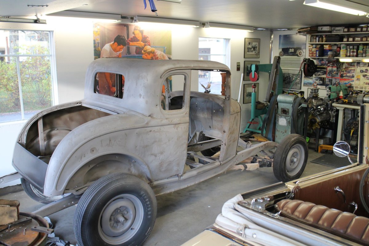

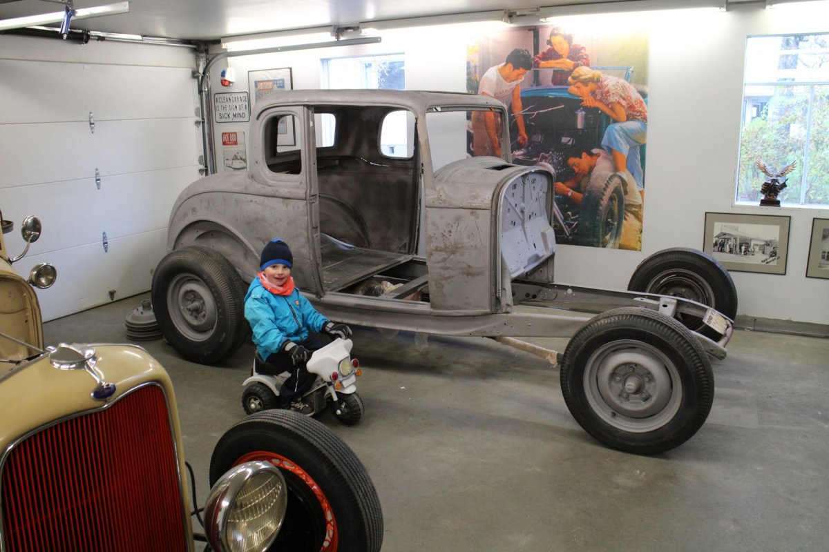

    Slowly going foward.
    Today I push car in and started to remove parts.
    During weekend I leave body for sandblast.
    Body is ****. I wonder it has not collapsed.
    Both rear quarters need to make new, over 40 dent in top, both cowl sides car strech....
    This time I paid too much. Good thing is that I can do all myself, but takes so much time....

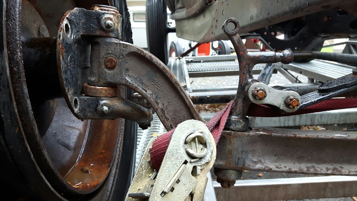

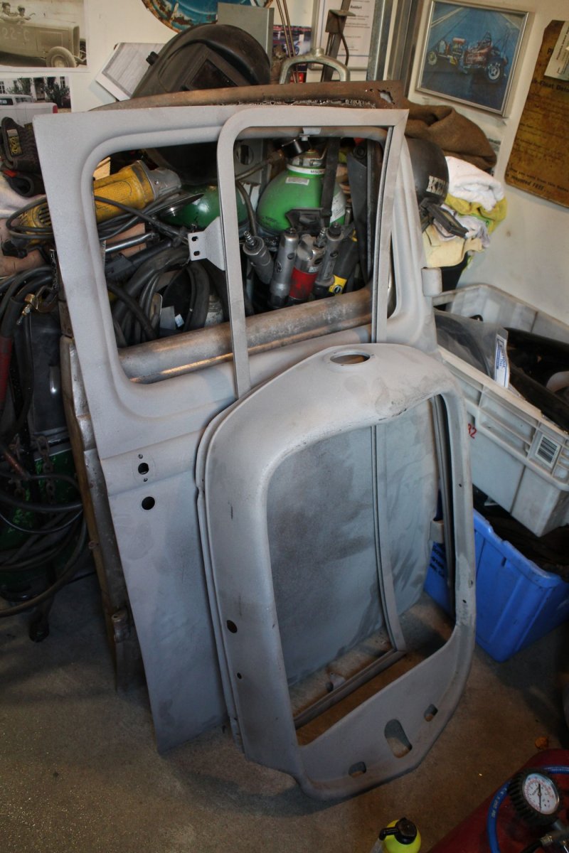

    Ready for sand blast.
    I like that Front axle. First time I see well done 1932 Heavy axle dropping

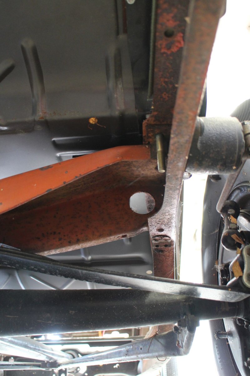

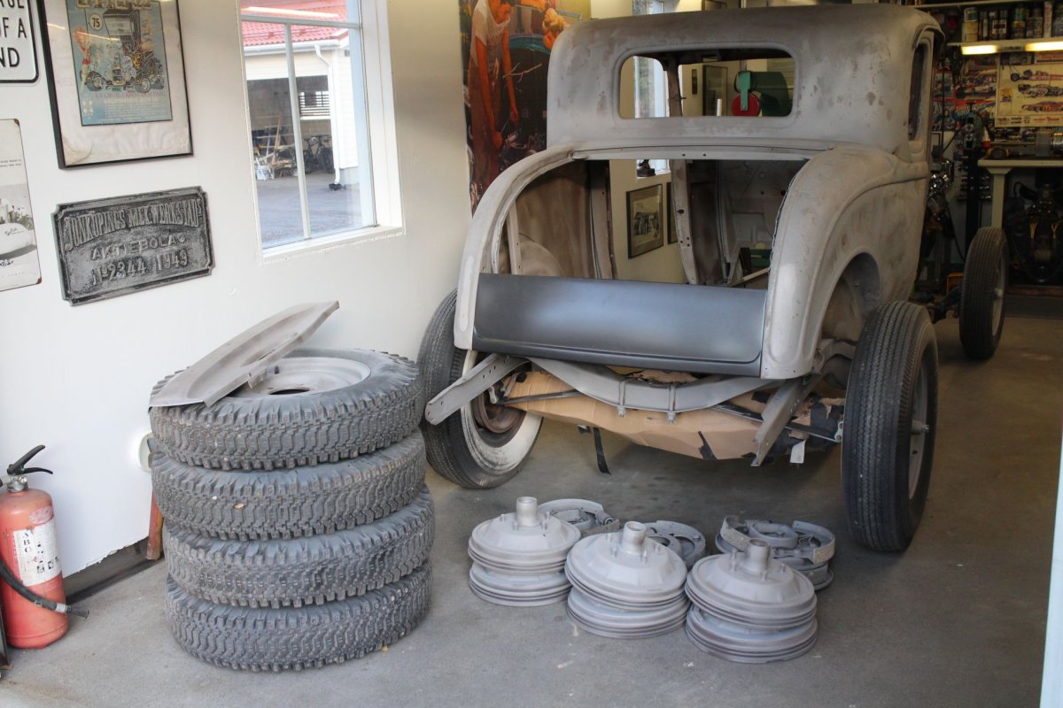

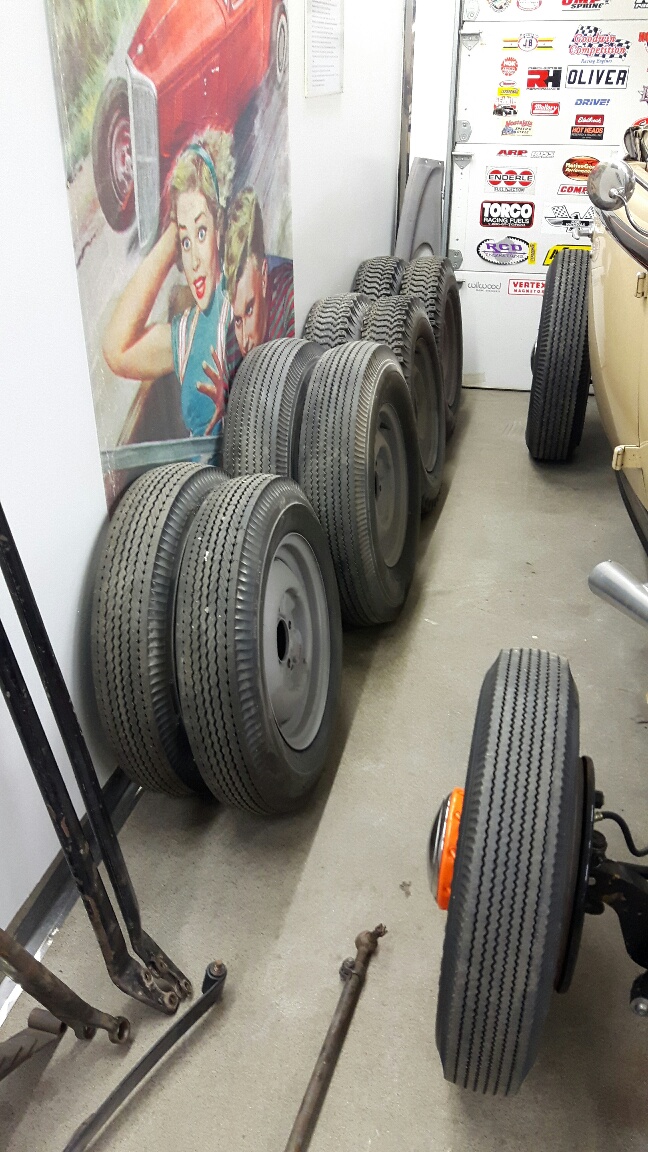

    Slowly start with this Project. Today picked up from sandblasting.
    3 set very good Lincoln fron drums + hubs.
    Nokia Hakkapeliitta 16" winter tires (60y old, but good condition). First Nokia made Wellington boots, tires, televisions,...and finally 80´s telephones. Now they are leader in Network business (before next down time,..)

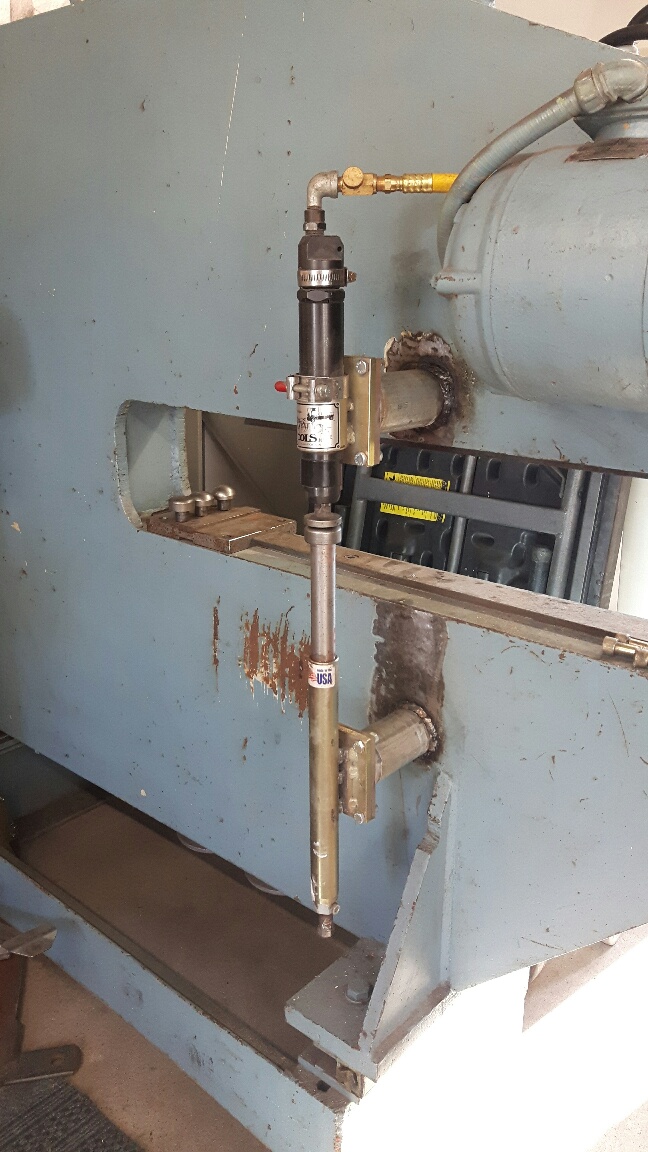

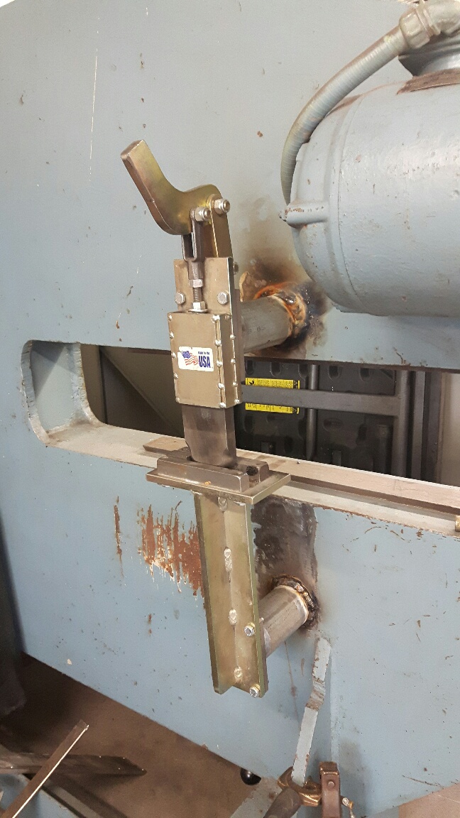

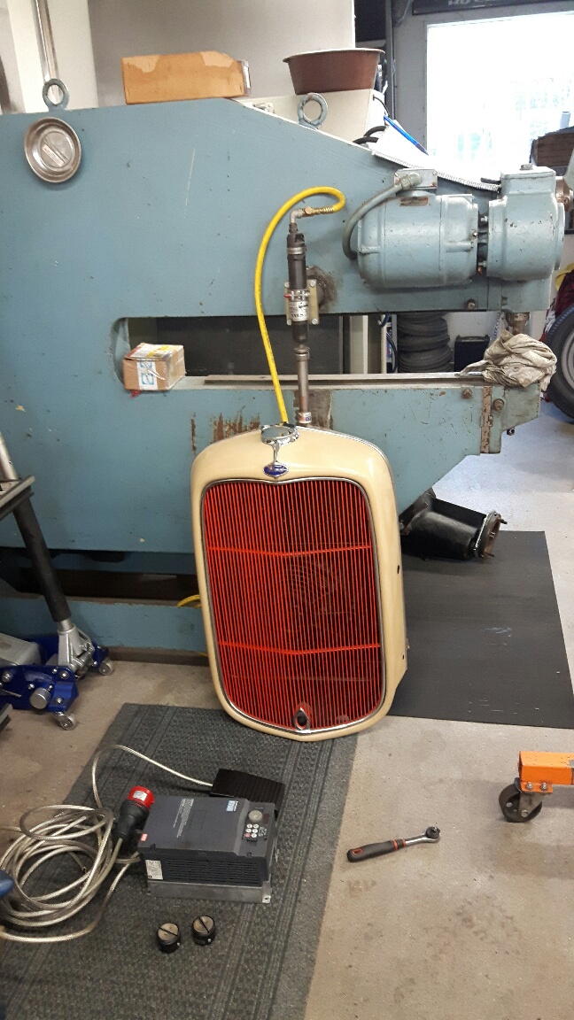

    Last week I welded mountings to my Pullmax 5 right side. Now can have bolted on power hammer or louvers dies.

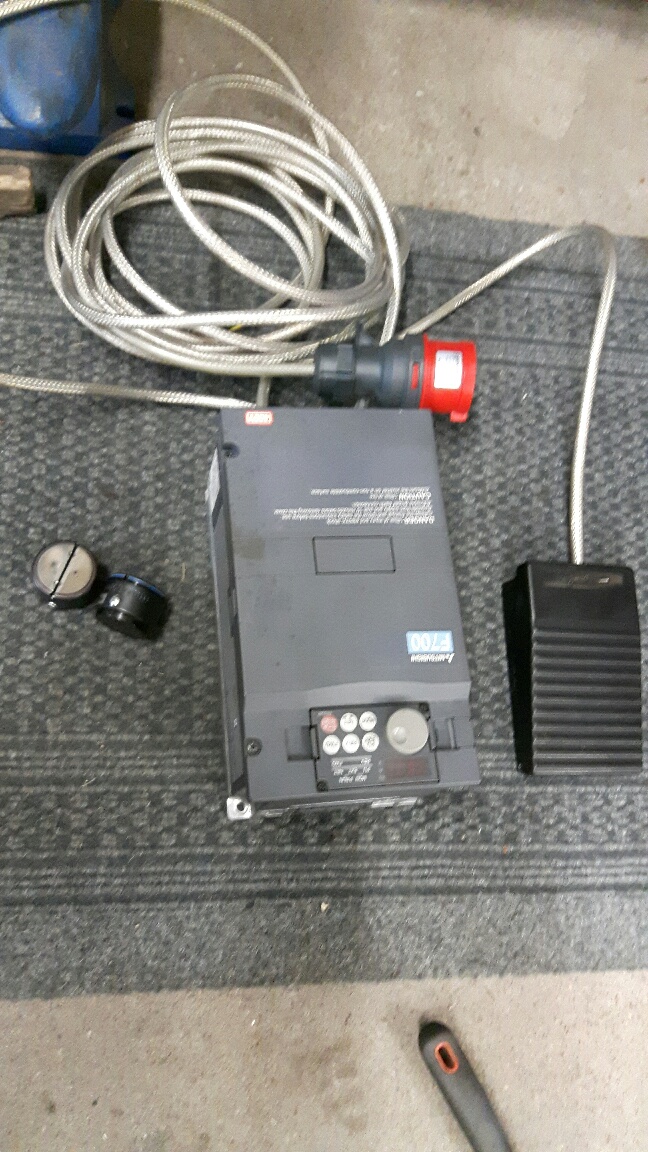

    Last week I ordered shrinker dies from Eckold (switcherland). frequency convertet (need to get RPM down) + food pedal. When installed Eckold dies and those electrical equipments, can test use.
    Here few pics.

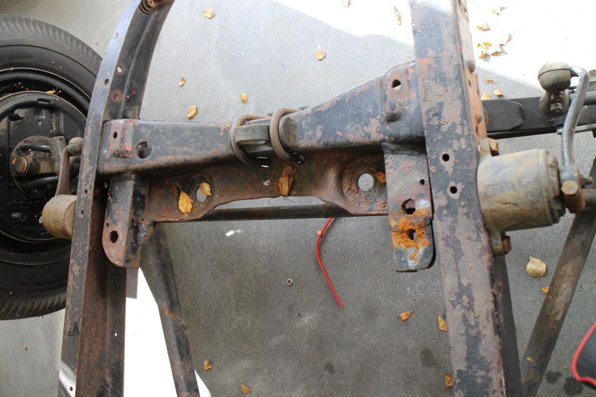

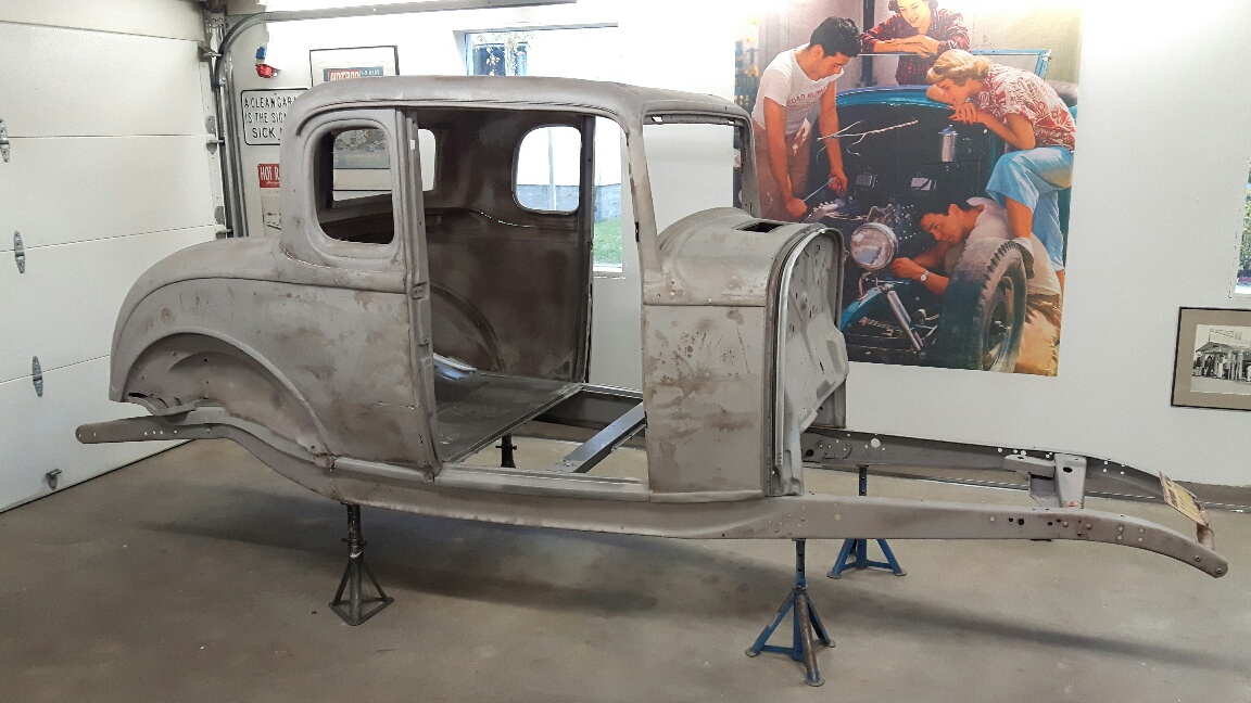

    roller car pieced.
    I like that dropaxle. First time I see original heavy axle which has droped good.

    image.jpg What a great set up you have there.I look forward to seeing this project move along.I agree with you about the axle...what a nice job someone made of dropping that.

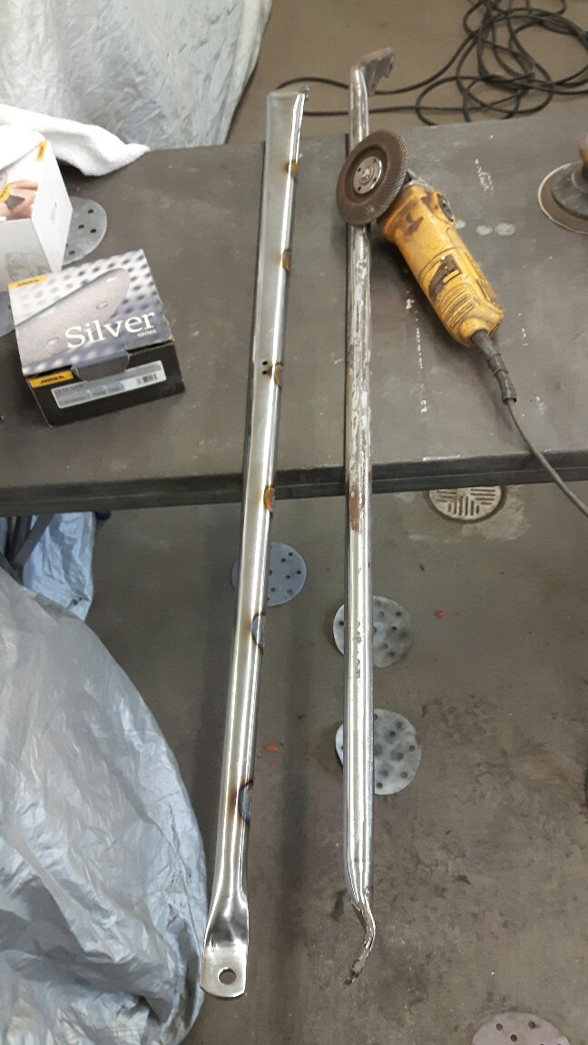

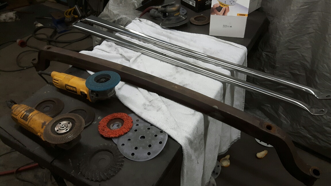

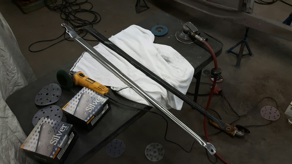

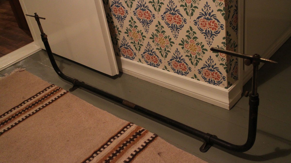

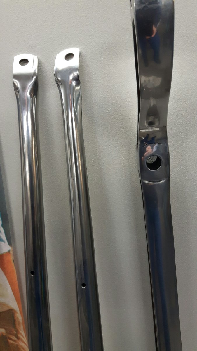

    Radius rods sanded and polished. Final sanding 500 and polishing (heavy cutting).
    2 x 6hours. RH radius rod was little curved, but get it pressed straight. Same time TIG welded upsides.
    Next front axle and last front wishbone.
    I send all those parts to Cromium plating.
    Aulis

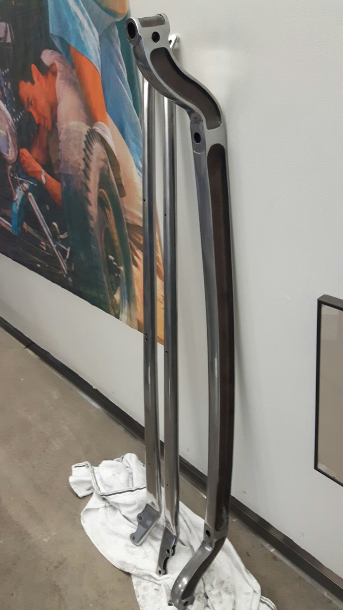

    Front axle grinded, sanded and polished.
    It was hard 7hours, those forged heavy axles are so heavy stuff,....
    aulis

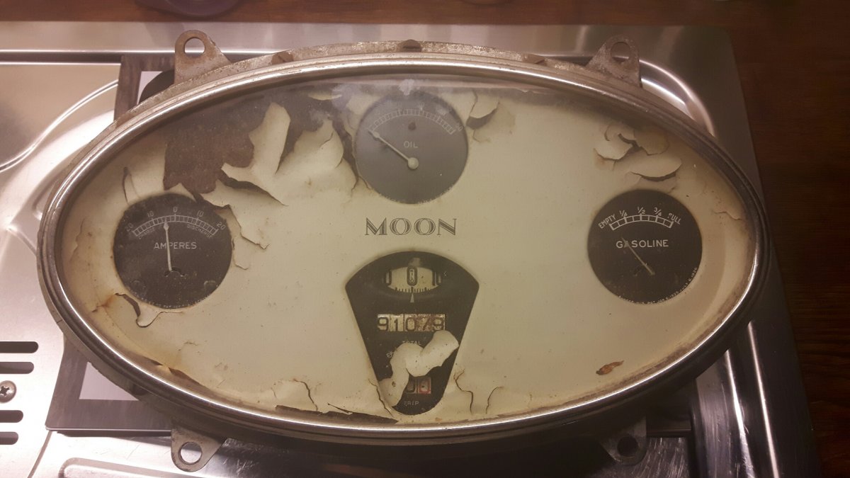

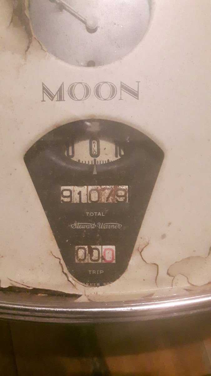

    What is this SW "moon" gauge set?
    Just bought it. Needs rebuilding. I have few ideas this car gauges. This is one of those .
    A

    You (late to the party) are right. Moon motor car Co. gauge set. I open it and restore that set.
    If all works, that SW set looks good.

    Today arrived Eckold shrinking dies to my Pullmax 5.
    Need to make mounting brackets for pullmax. 3/4" x 3/4" shaft I have 3meters waiting for that.
    One friend has made me food pedal & Equalizer --> can drop down Pullmax RPM.

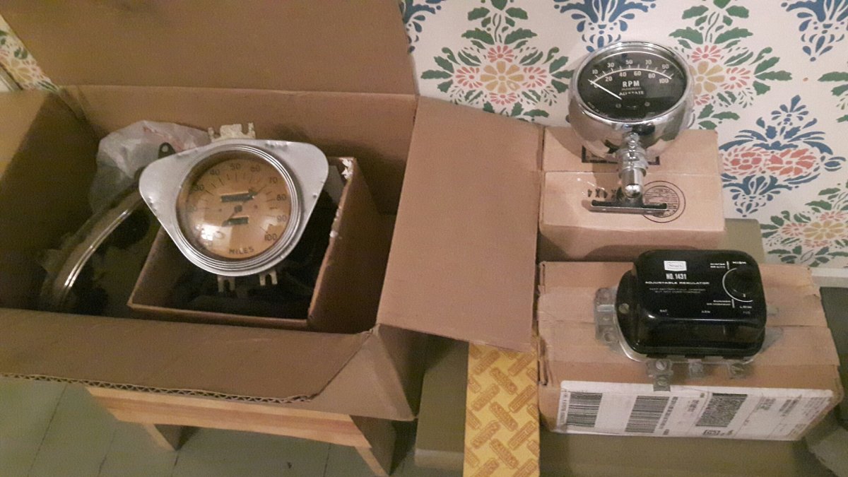

    New hot rod parts shipment, to my hot rod shop, arrived from CA.
    in same shipment I get some "Christmas presents" for own Project.
    (Gauges, regulator front wheel alingment tool etc.)

    OK, this pullmax is off topic, but I will need it very much when I start to make new sheet metals to this Project.
    Yesterday i got Mitsubishi frequence converter + food pedal.
    Eckold shrinker dies arrived week before.
