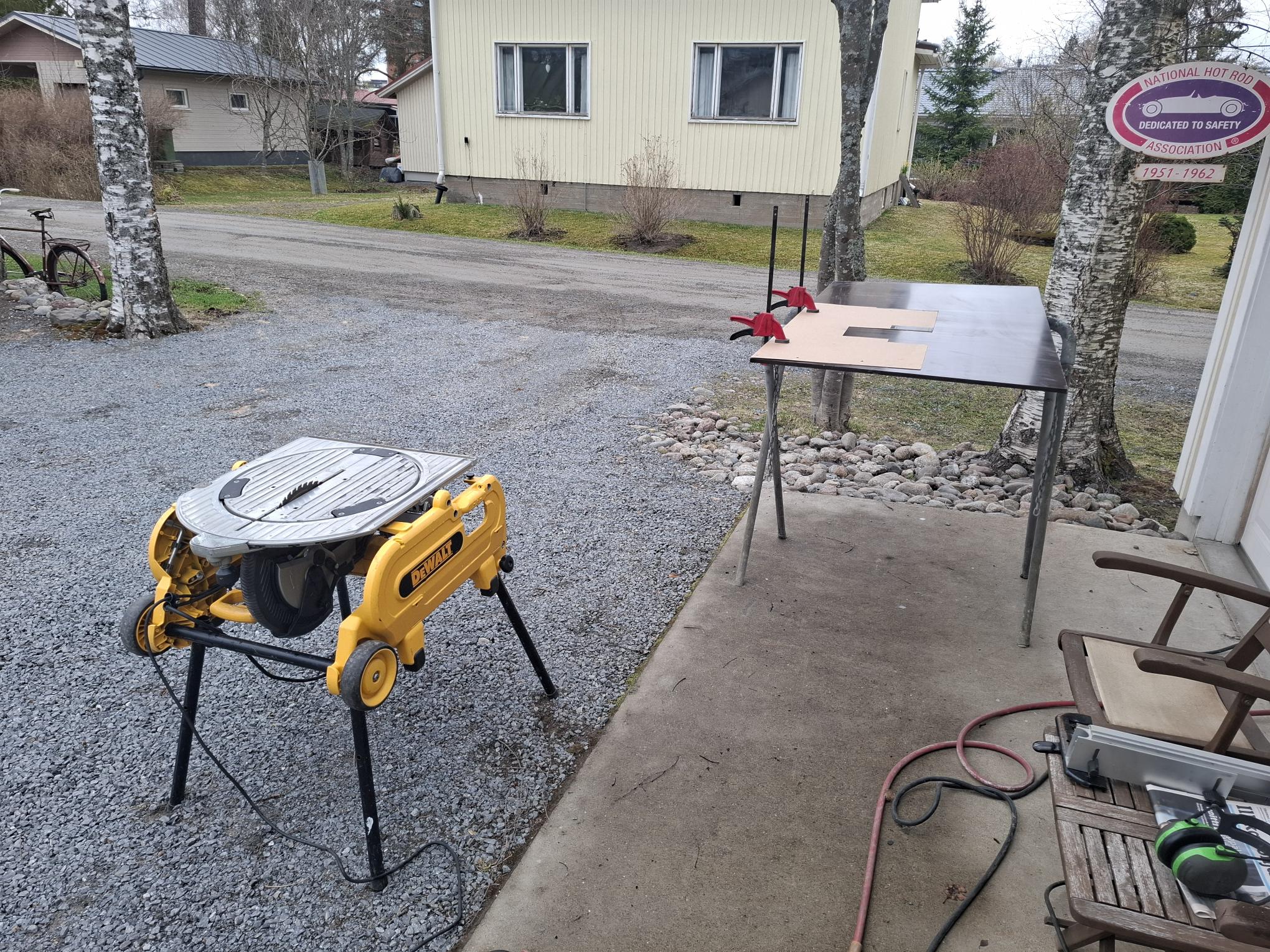

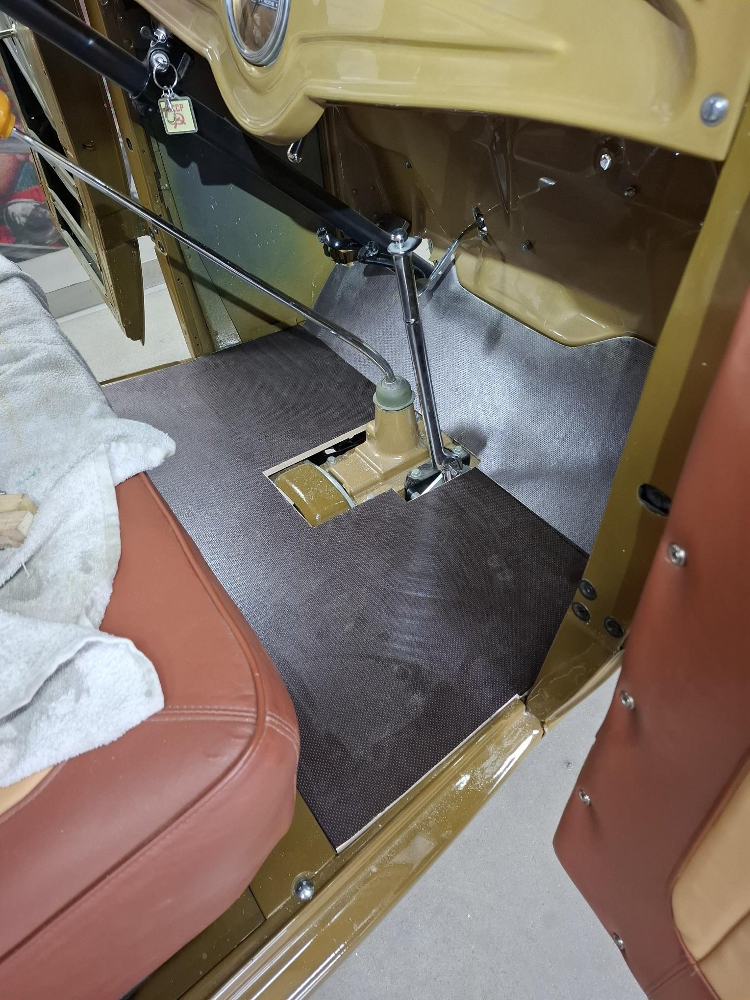

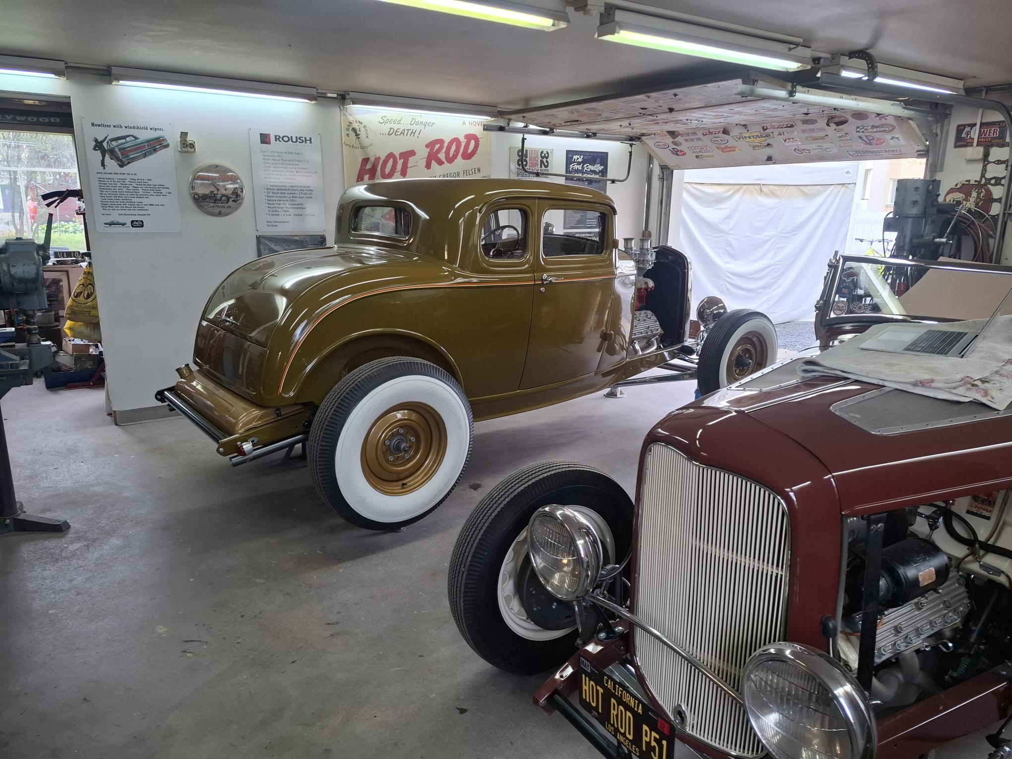

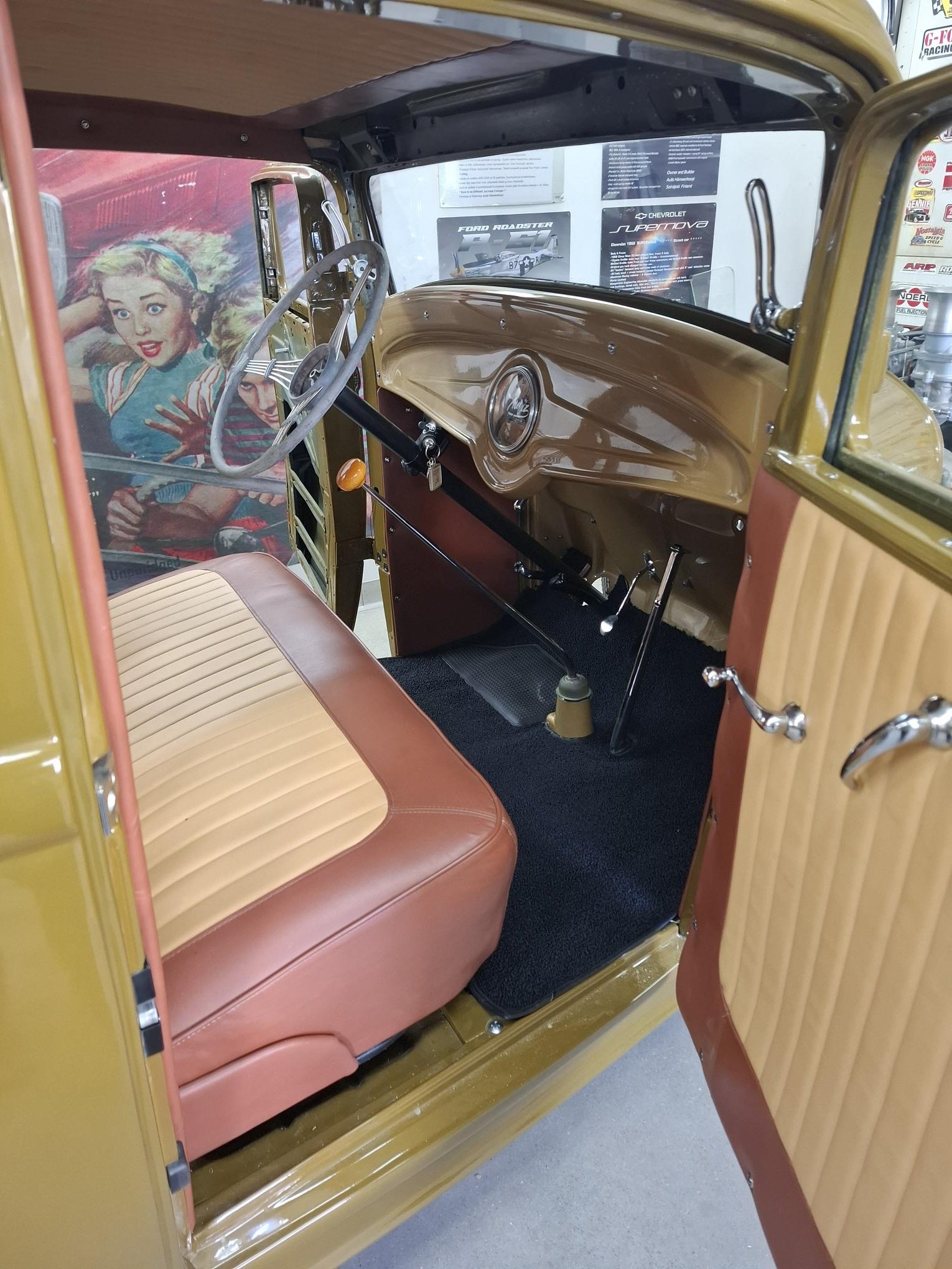

    I was not happy floorboards, so I made new ones.
    Now OK. I found old carpet. I think it was installed my ex 1932 Cabriolet when car arrived from CA. Carpet need to cut and install finally
    I have two different escutheon. One is bigger OD, another is ogirinal 1932 ford "smooth". Im not sure which one I choose.
    Aulis

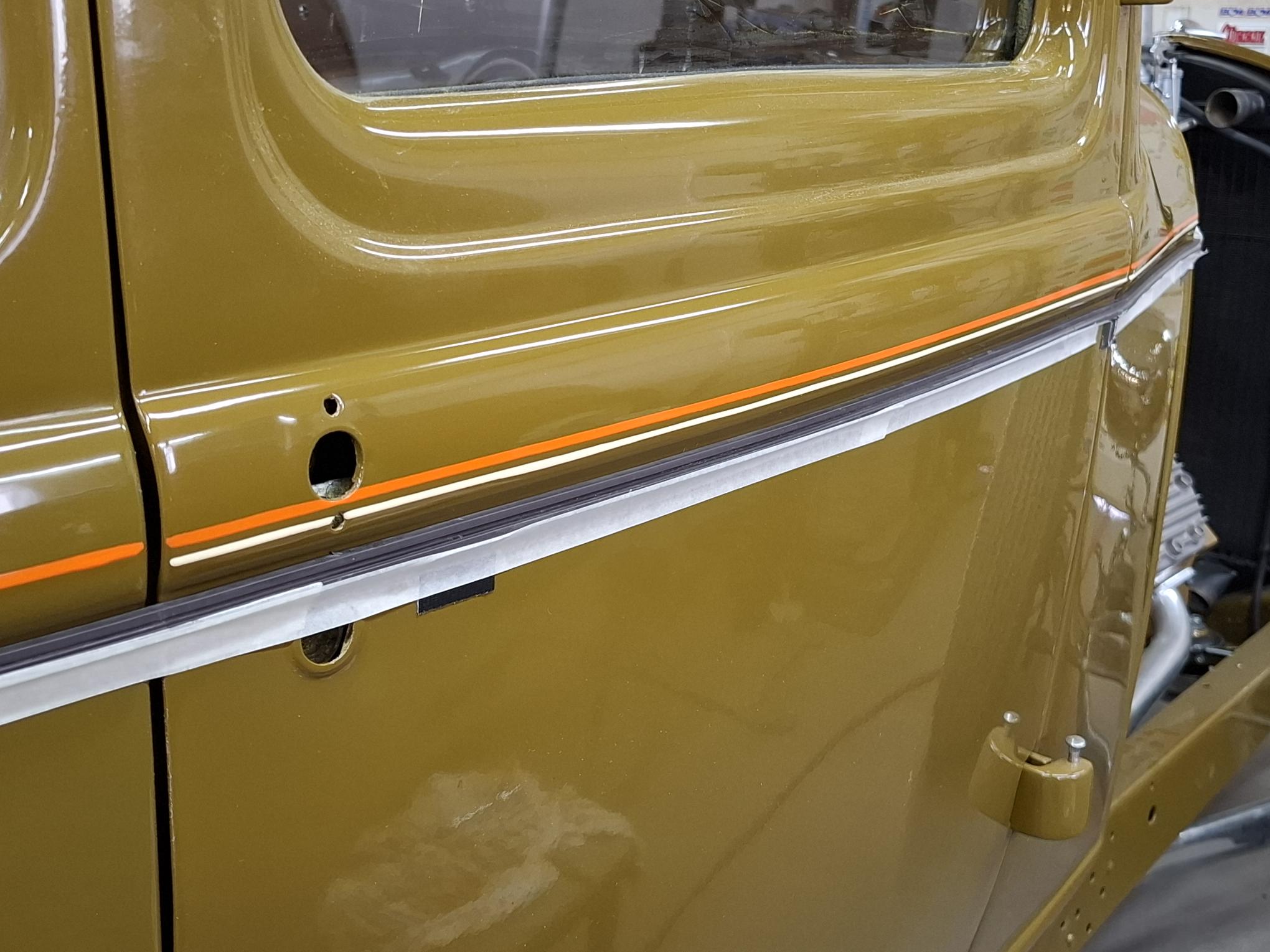

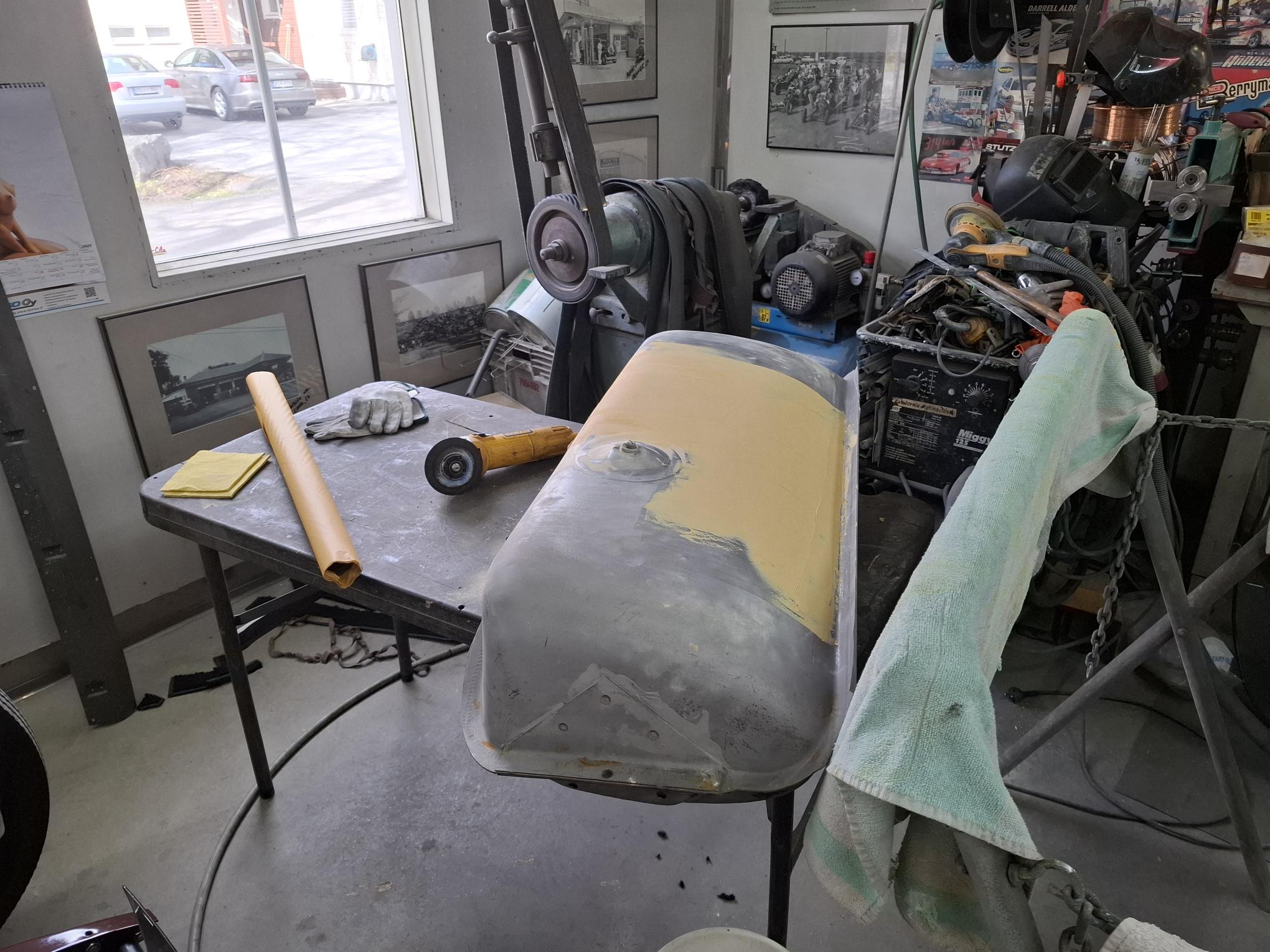

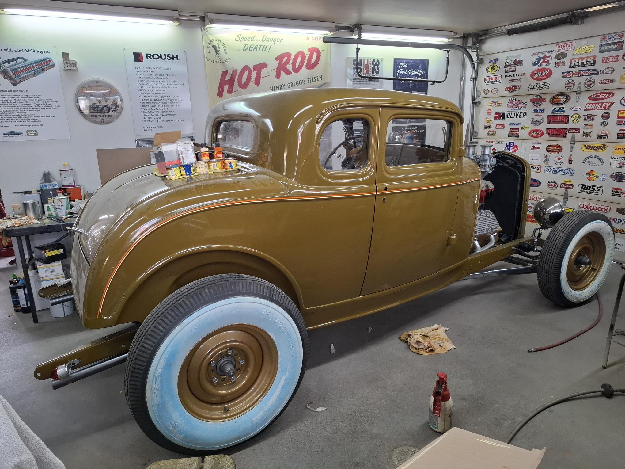

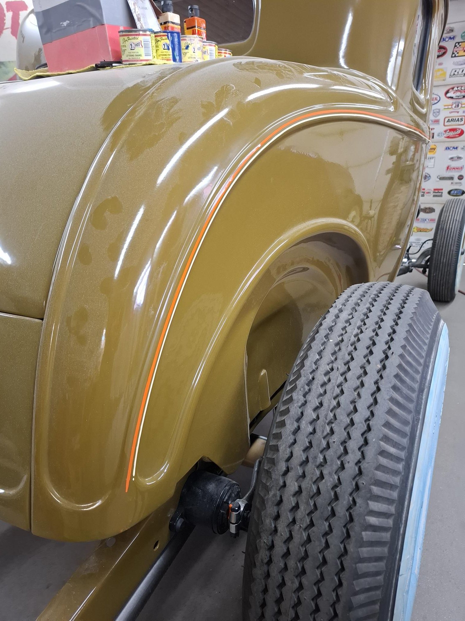

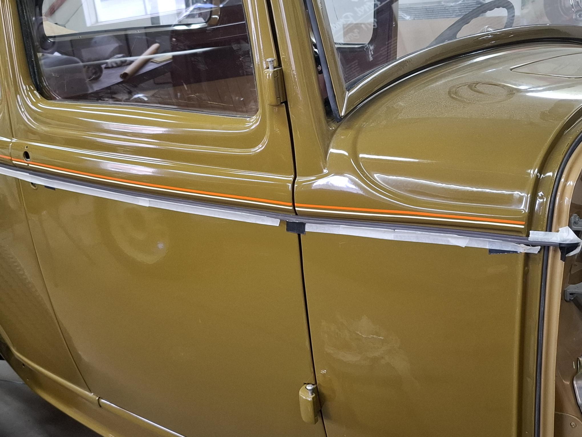

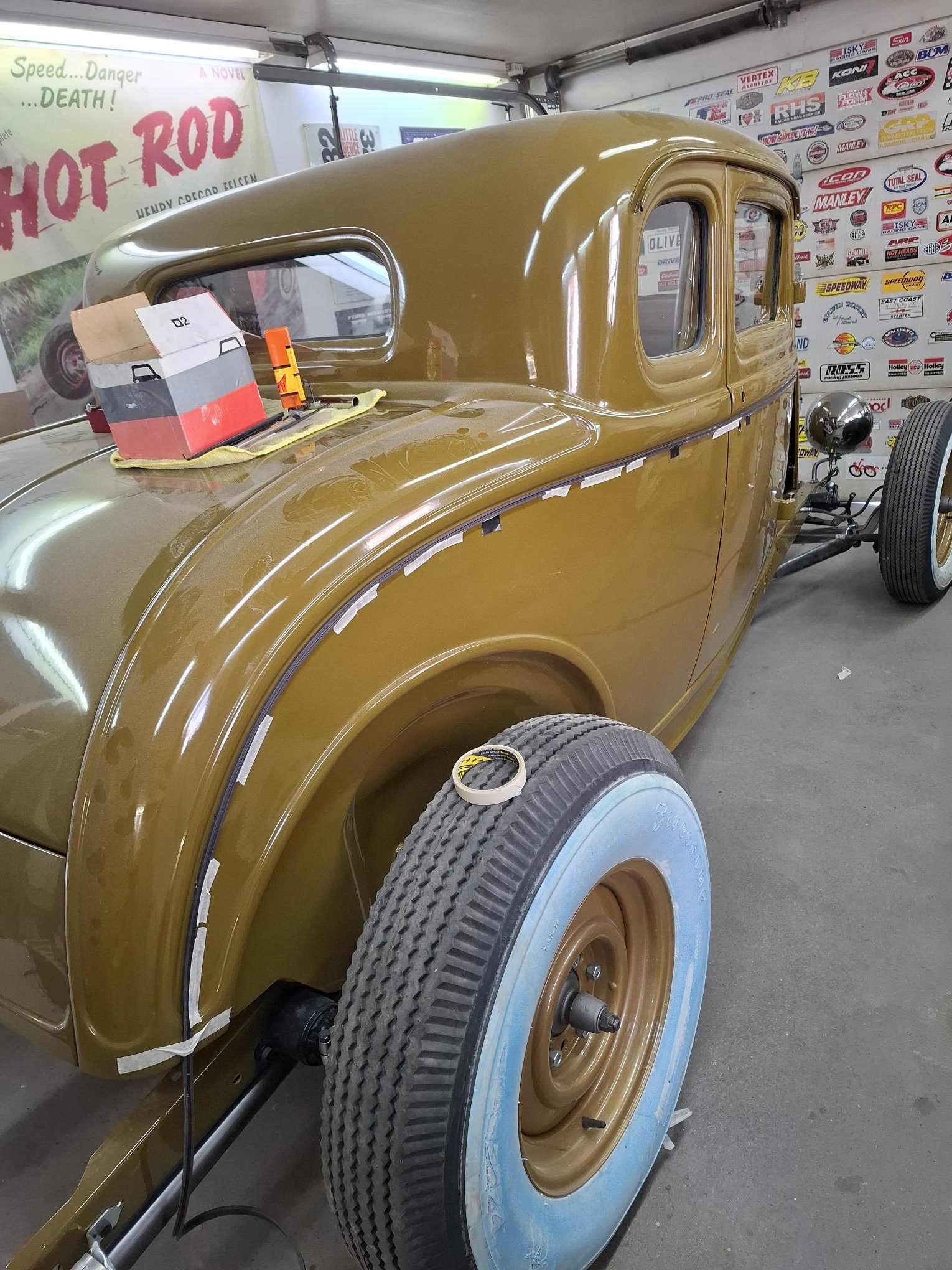

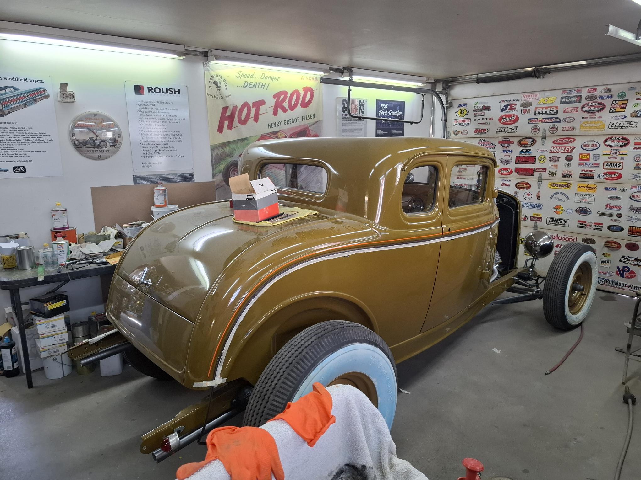

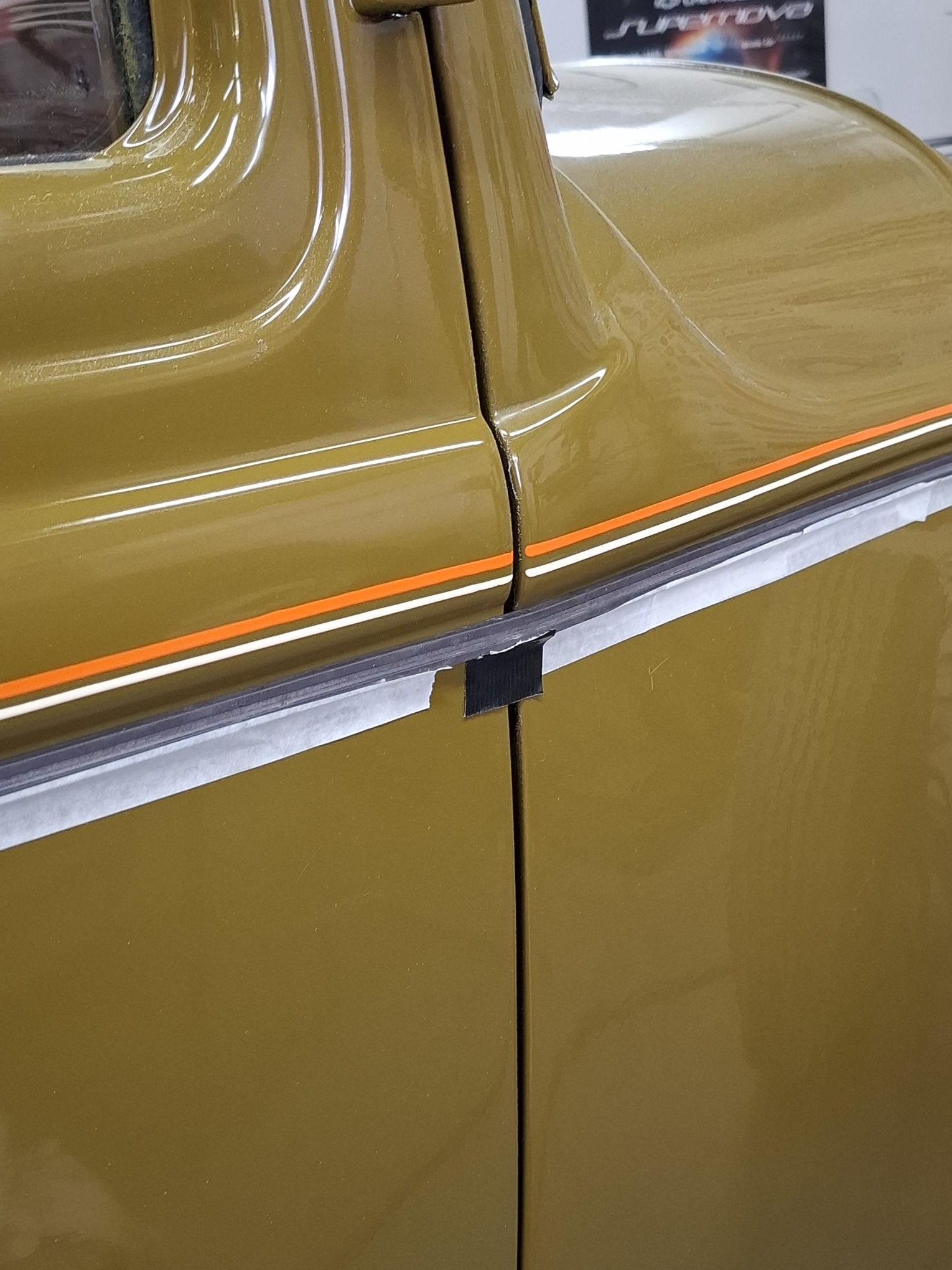

    Too much things to do, I try to keep wheels turning (dayjob, coffee place, hot rods, homeworks...)
    Saturday I give some hot spots fuel tank bottom, 3 times putty + sanded it nearly ready. Upper side is OK. This week need to paint it over (Primer + 500 sanding + 2k acryl).
    Also I cut old carpet to right dimension. Need to sew it ready someday. Floor is still need alum. covers around shifter and emerg.brakehandle and same style cover around pedals + column.
    Today worked little time with pinstripes. Not so nice, but homemade.
    Aulis
    rod-coupe1278b.jpg rod-coupe1278c.jpg rod-coupe1279.jpg rod-coupe1280.jpg rod-coupe1281.jpg rod-coupe1282.jpg rod-coupe1283.jpg rod-coupe1284.jpg rod-coupe1285.jpg rod-coupe1286.jpg rod-coupe1287.jpg rod-coupe1288.jpg

    Hahaaa,.... maybe not. Need to remember that those are only owner´s handmade, not real stripers art.
    I just want to see how outlook is change and if not good, easy to remove. I have only few colour, need to buy someday few colour more those enamel paints....

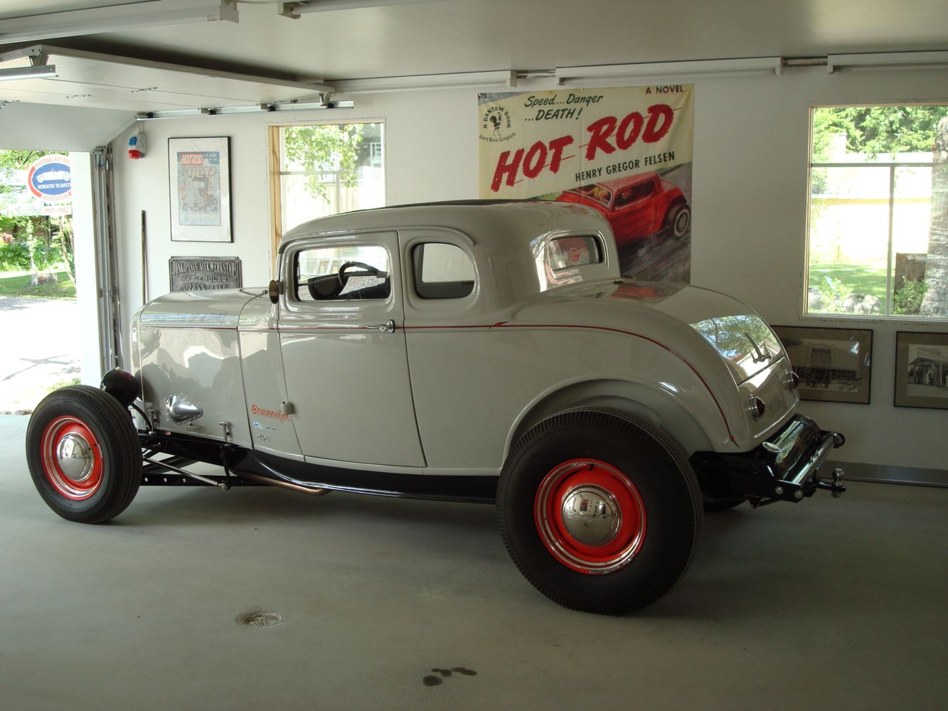

    Here You can see my ex roadster which has Pekka "Wizzz" Mannermaa made. I liked that V8 "racing" logo.
    My ex. 5w coupe. Timo Lindholm made all other straips that car.
    Aulis

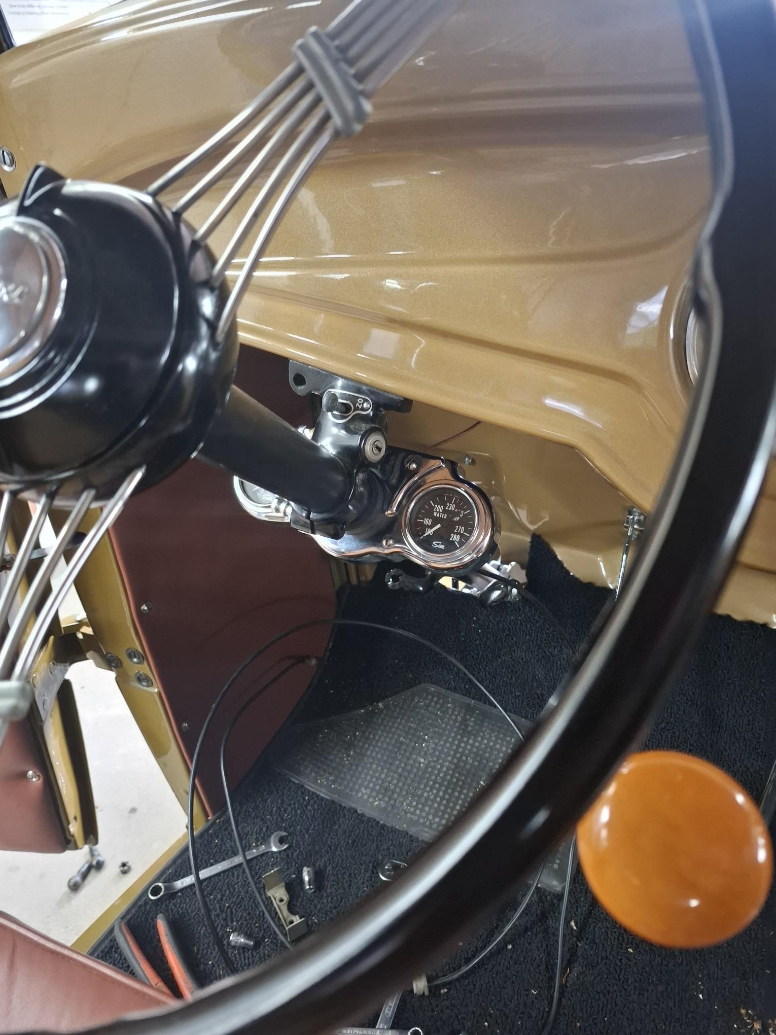

    I havent decided yet, if I open tachometer mounting holes and bolt on gauge on cowl.
    Aulis
    View attachment 6393250 View attachment 6393251 View attachment 6393252 rod-coupe1290.jpg rod-coupe1289.jpg rod-coupe1291.jpg rod-coupe1292.jpg

    Driver side pinstripes ready.
    Aulis

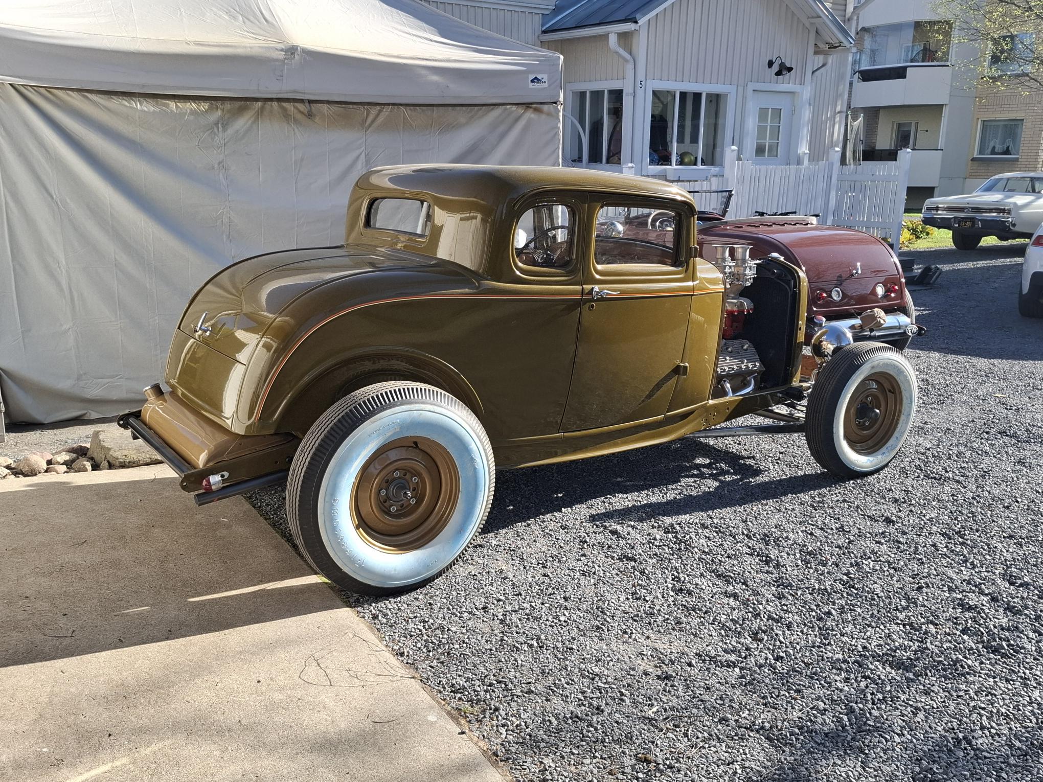

    I try to get this Hot Rod driving condition before end of June.

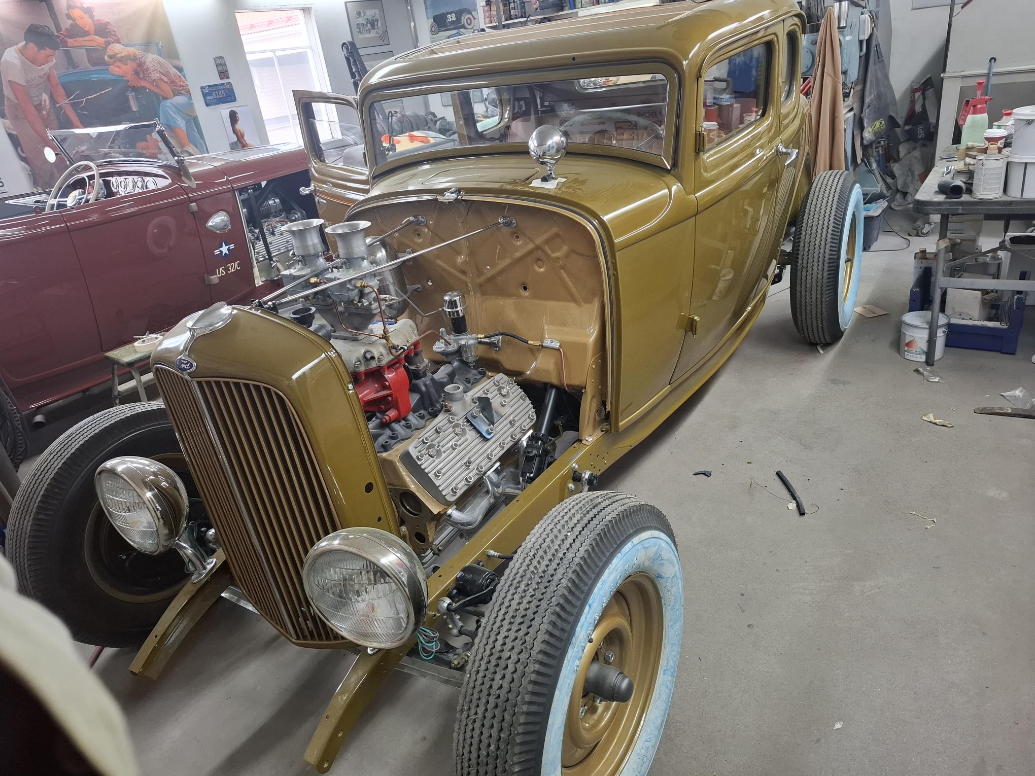

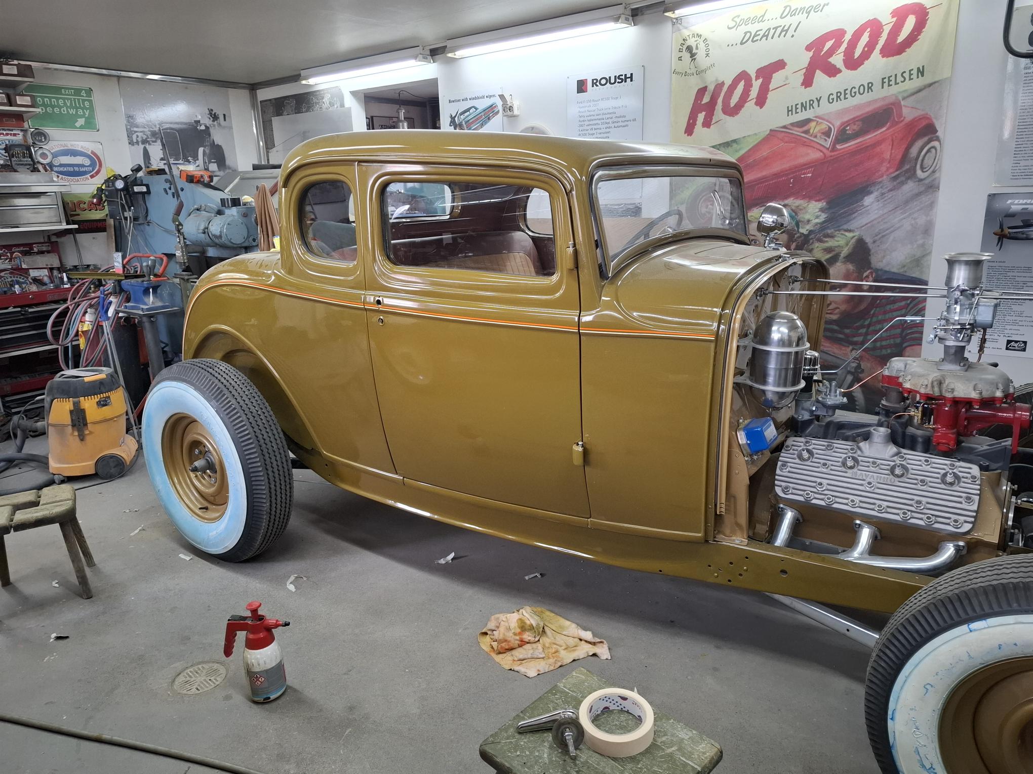

    Today we spent few hours in garage. Mr Oskar own side and I own.
    Tomorrow we take GS Buick out from trailer. We need to install exhaust, change racing slicks to Bf Goodrich because Monday-Tuesday I need to drive car to Inspection.
    Tomorrow I spray primer next parts: Tank, front spearder bar, steering wheel, water pumps.
    Aulis
    oskar-141.jpg rod-coupe1296.jpg rod-coupe1297.jpg rod-coupe1298.jpg rod-coupe1299.jpg rod-coupe1300.jpg rod-coupe1301.jpg rod-coupe1302.jpg rod-coupe1303.jpg rod-coupe1304.jpg rod-coupe1305.jpg
    The 39 guy, Stogy, brEad and 4 others like this.

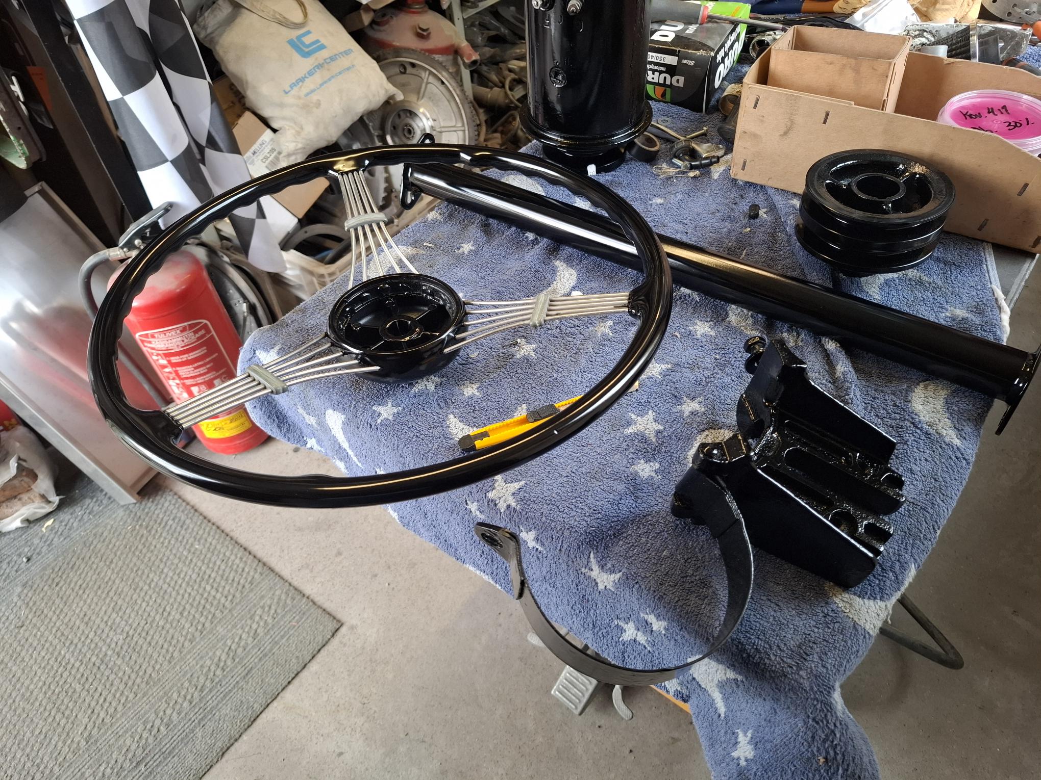

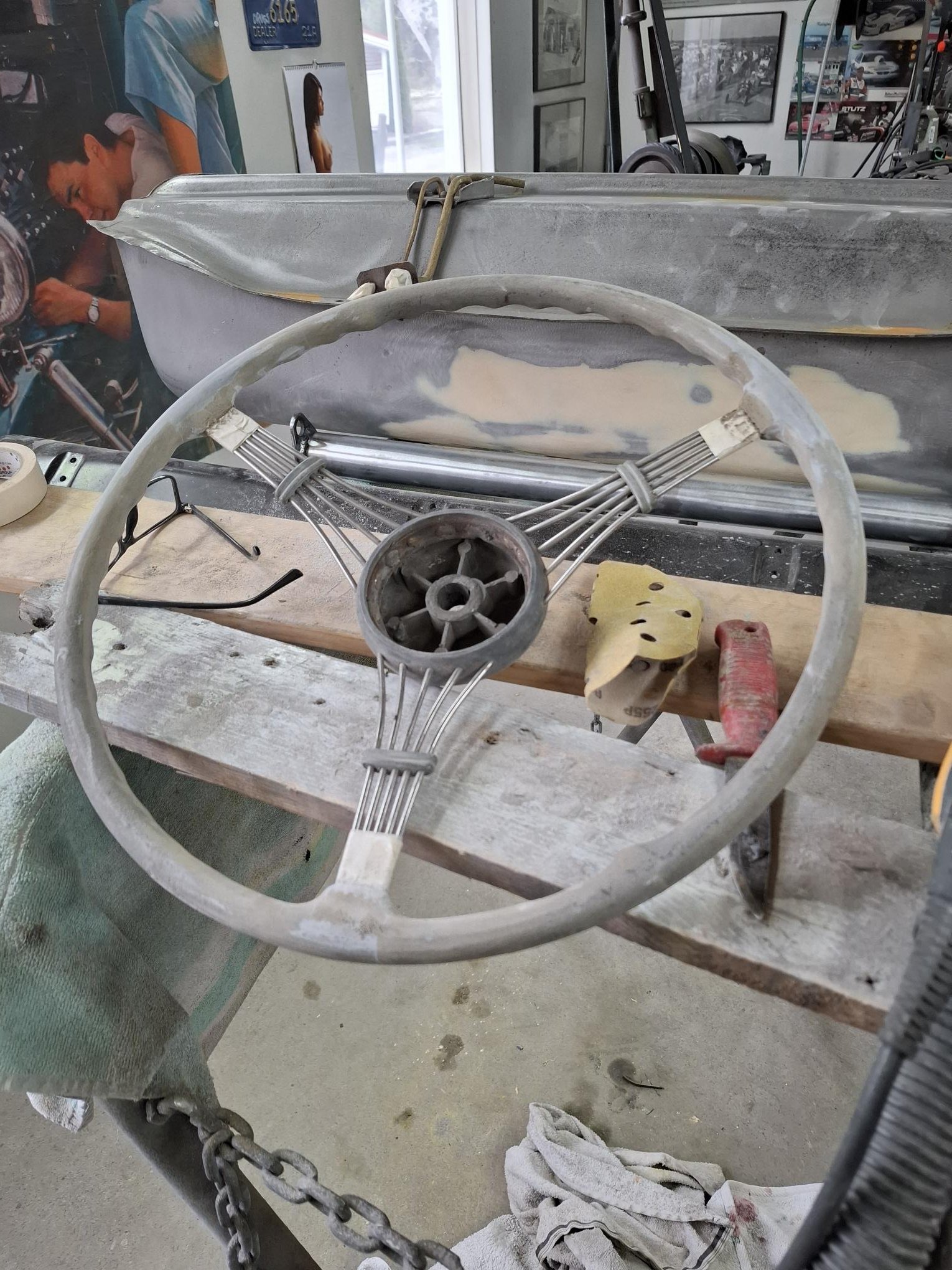

    steering wheel, front spearder bar, fuel tank... are primer painted. Two days and I can sand down.
    Today we worked outside. Also we pushed coupe outside. rod-coupe1308.jpg rod-coupe1310.jpg rod-coupe1311.jpg gs-174.jpg gs-176.jpg hauler-73.jpg hauler-74.jpg
    Aulis
    Denns1989, Lepus, The 39 guy and 10 others like this.

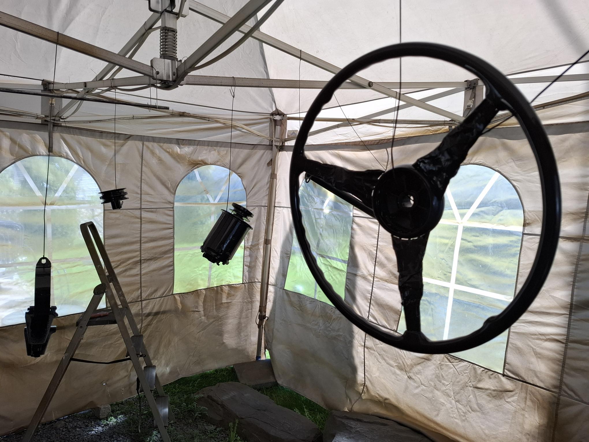

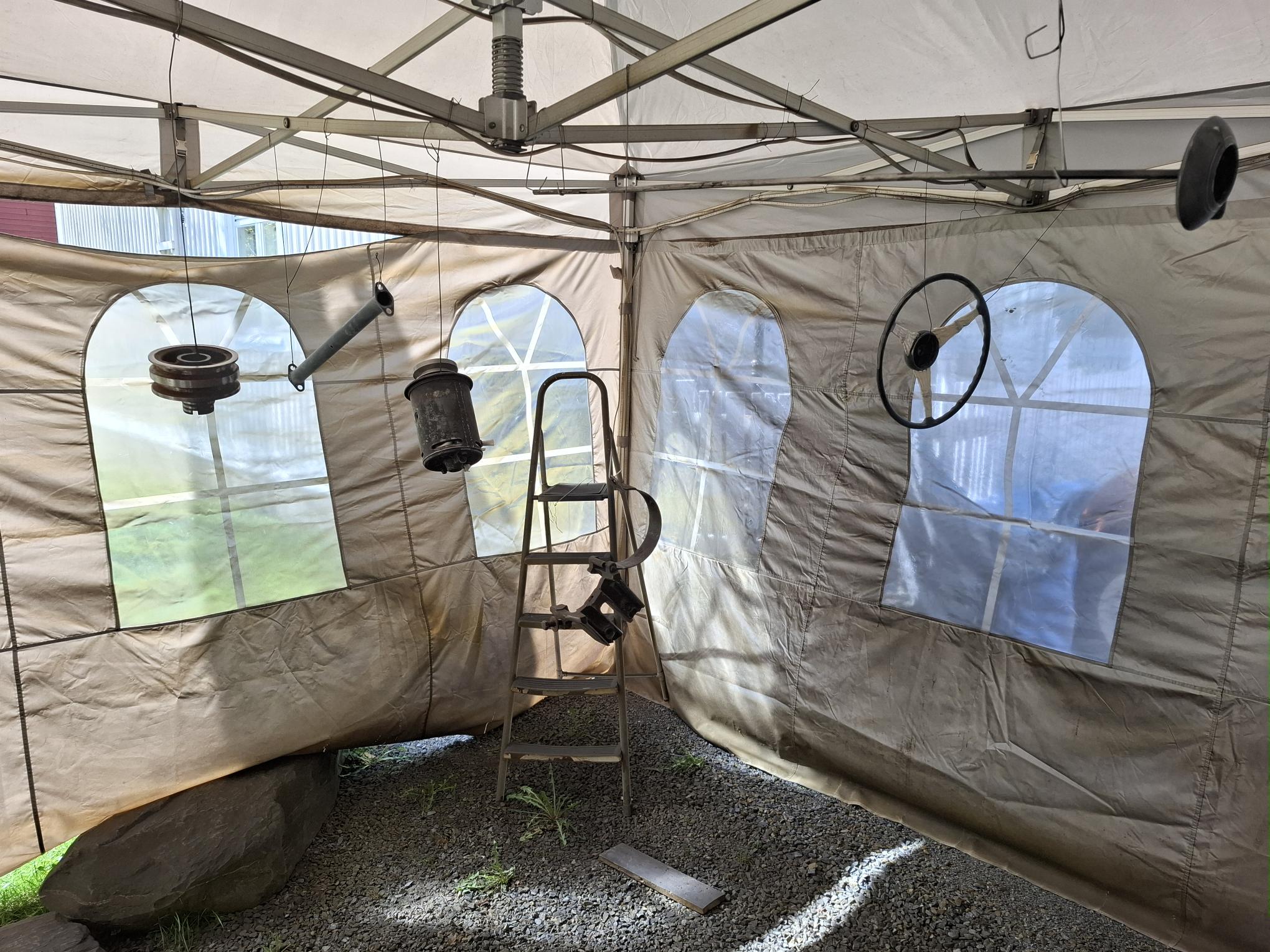

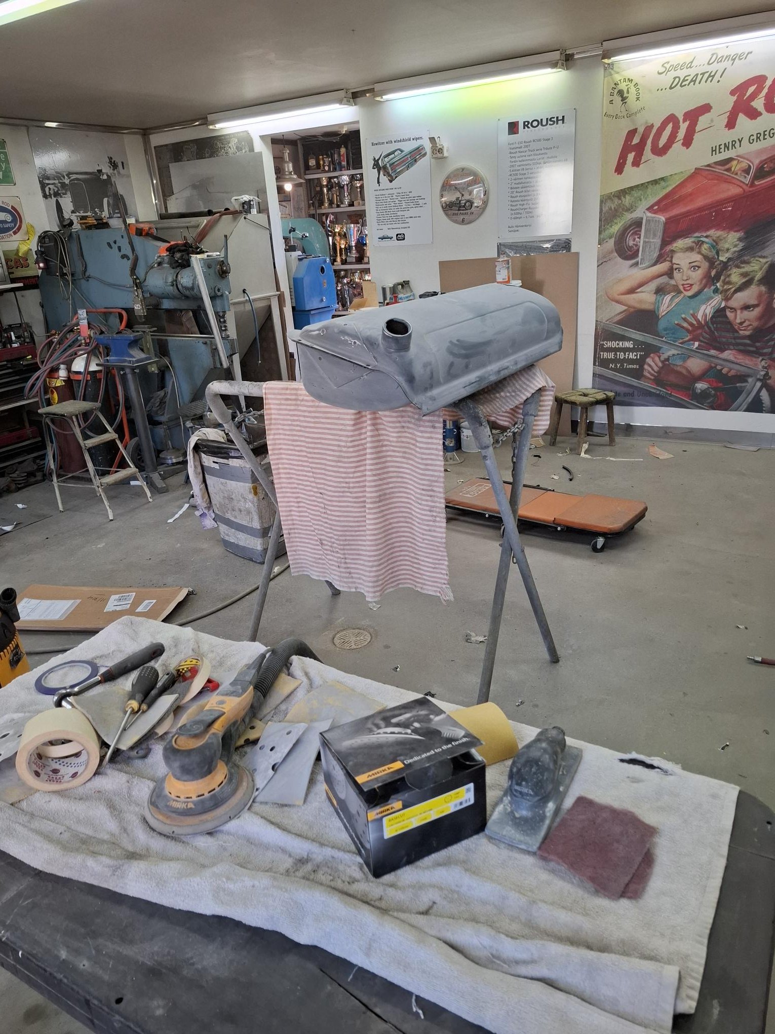

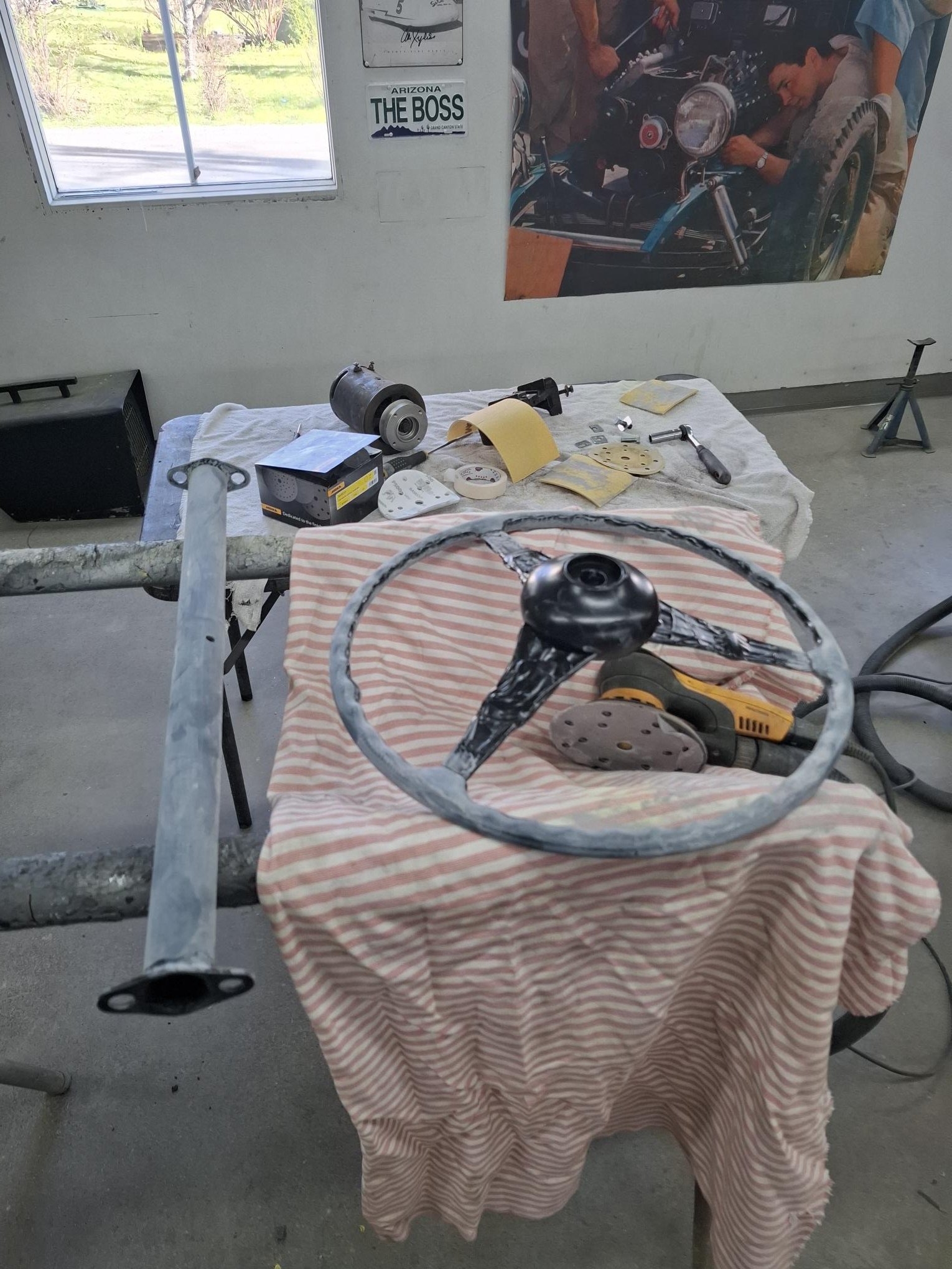

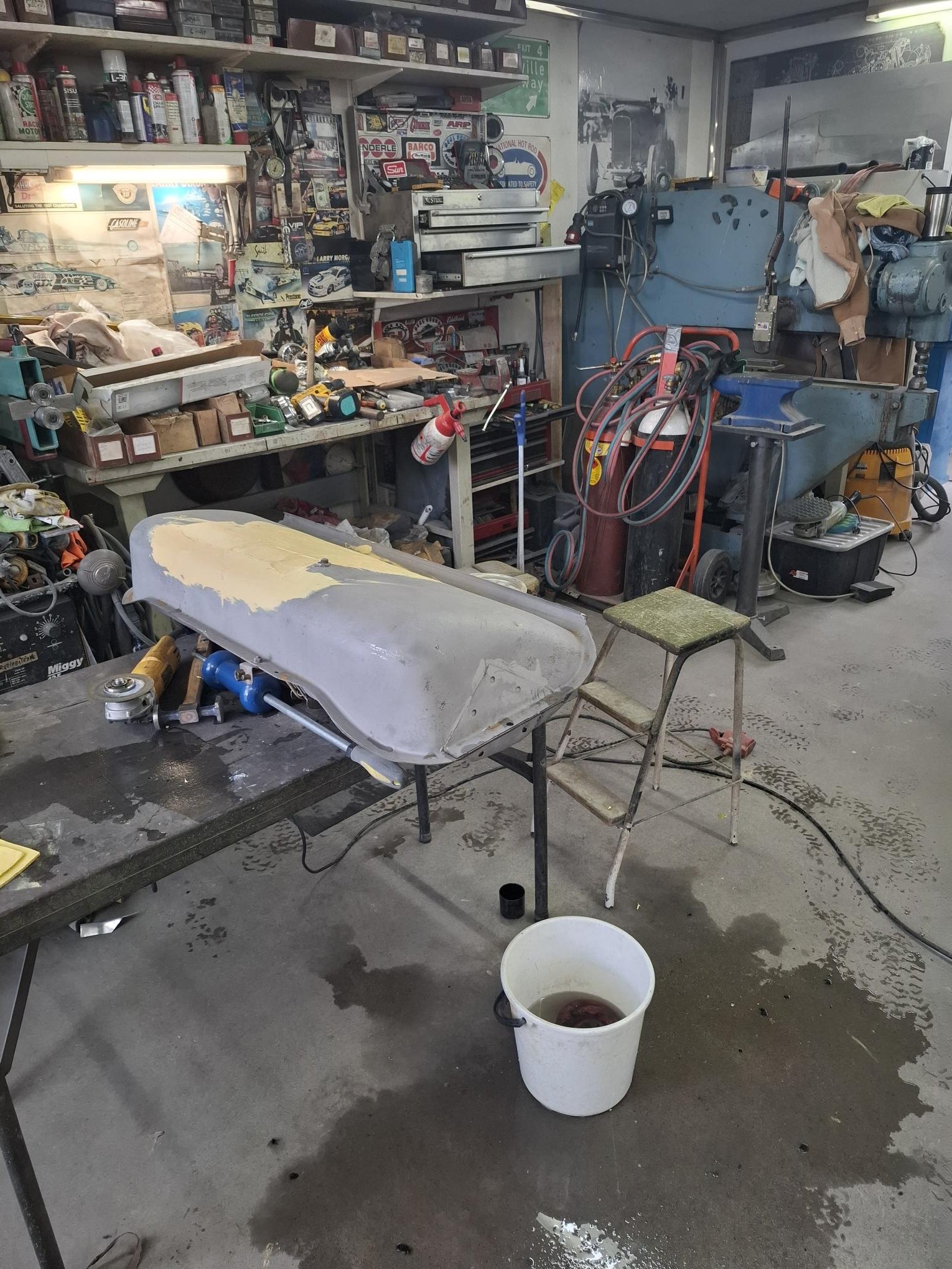

    Today I painted few parts. Glasurit black + 40% matting base.
    Also sanded fuel tank. Tomorrow I paint fuel tank.
    Aulis
    rod-coupe1313.jpg rod-coupe1315.jpg rod-coupe1316.jpg rod-coupe1317.jpg rod-coupe1318.jpg rod-coupe1319.jpg rod-coupe1320.jpg

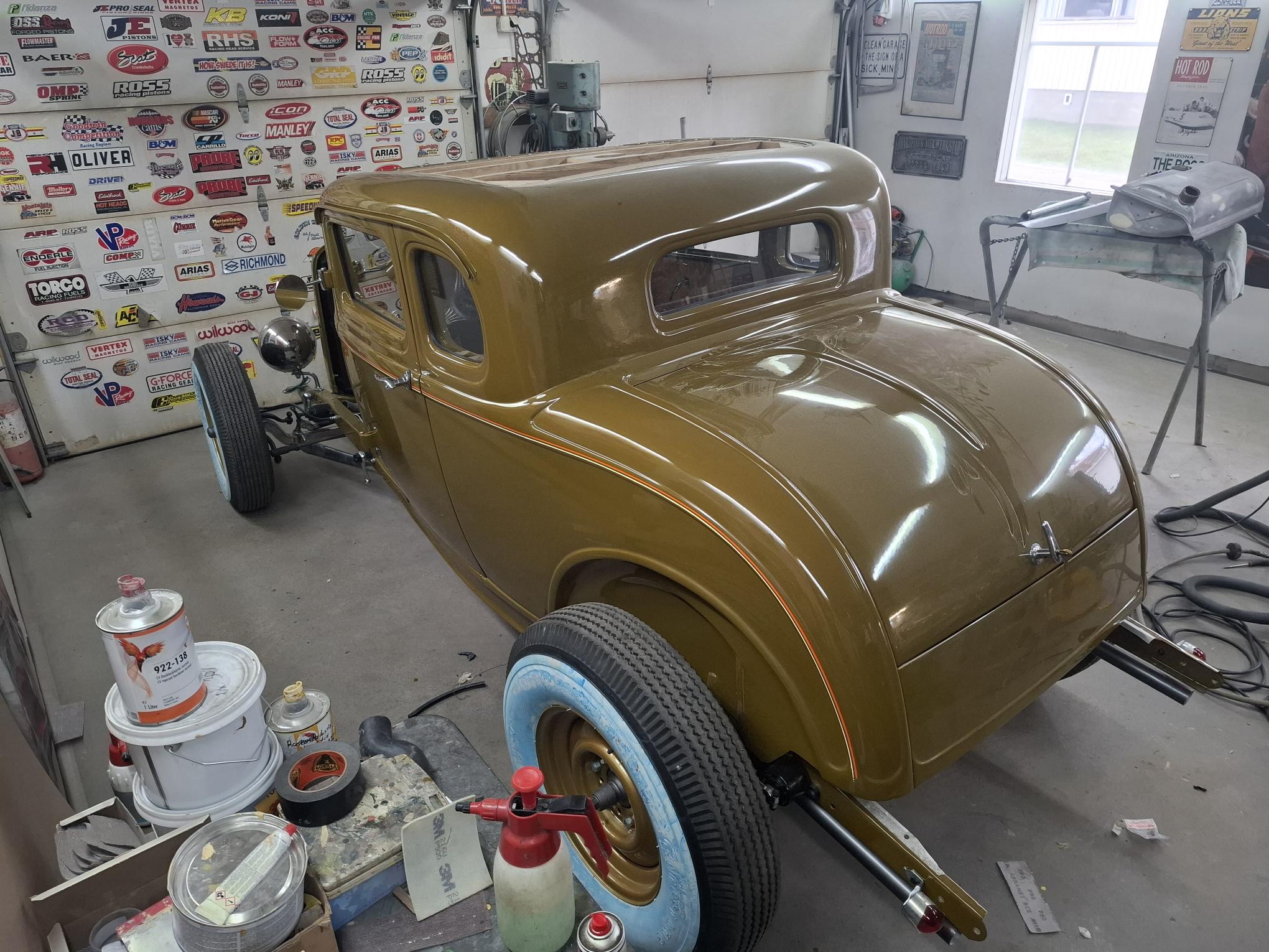

    AULIZ

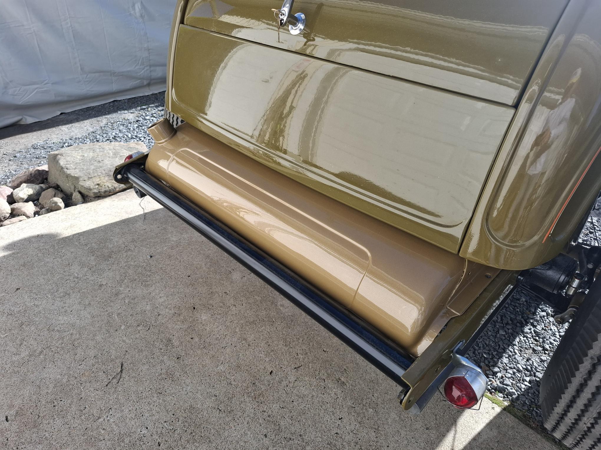

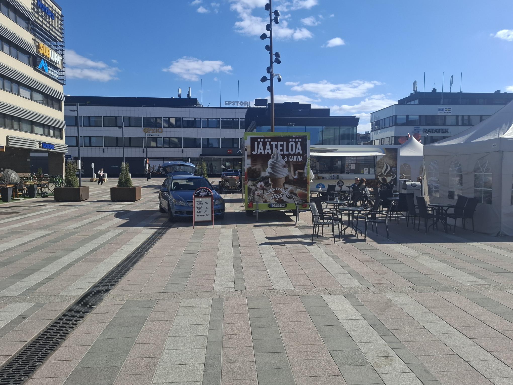

    Today, Friday, I painted fuel tank.
    in one pic You can see my hot rod in Seinajoki market place where I have big coffee shop trailer and my son´s mother is use my soft ice trailer. Hot Rod has own parking place there.
    Aulis
    rod-coupe1321.jpg rod-coupe1322.jpg rod-coupe1323.jpg rod-coupe1324.jpg rod-coupe1325.jpg rod-coupe1326.jpg rod-coupe1327.jpg

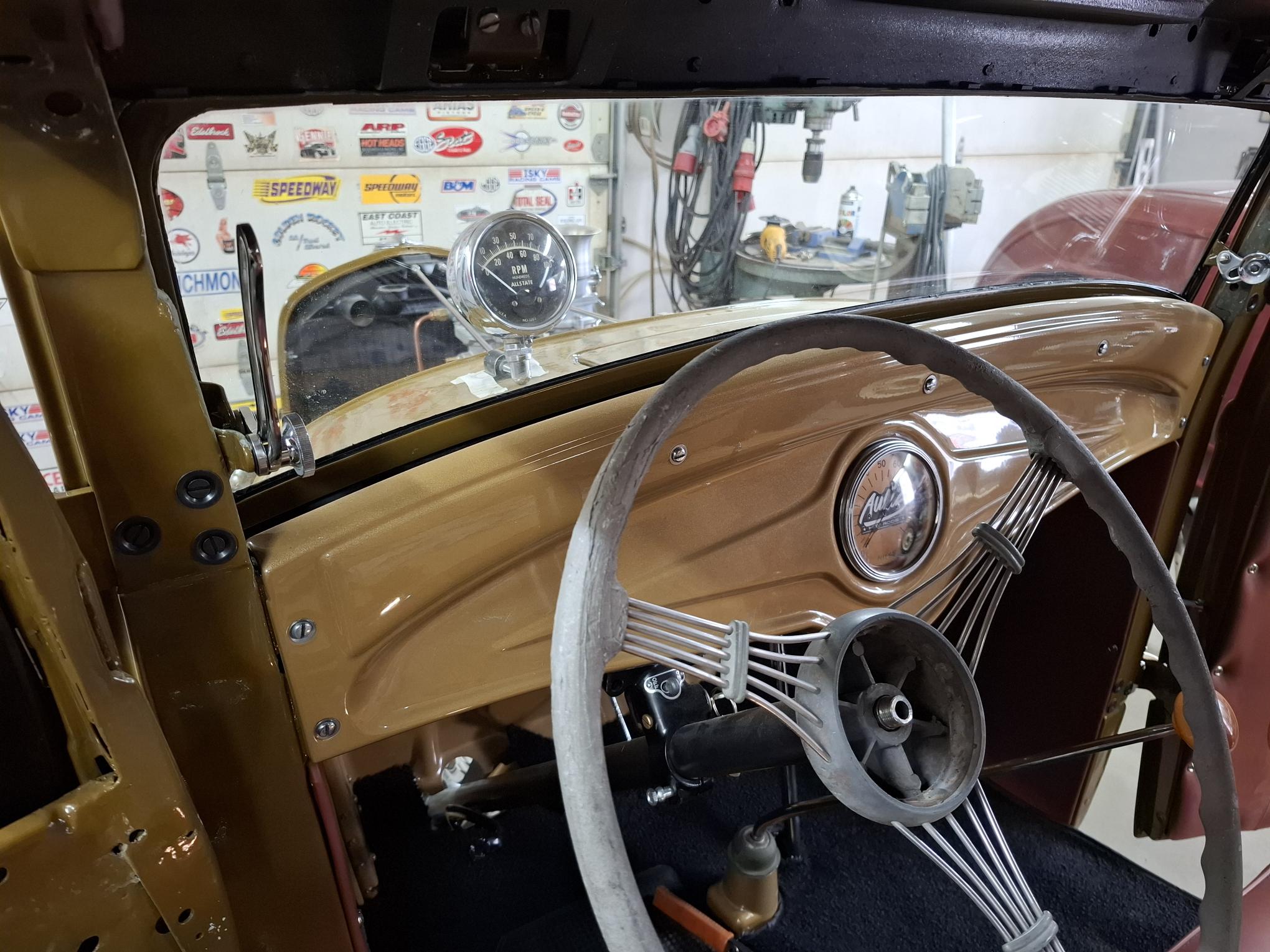

    Sunday I just check and wash all cars on my yard.
    I cleanded whitewalls, opened tach mounting holes, installed fuel tank and rear spearder bar.
    Aulis

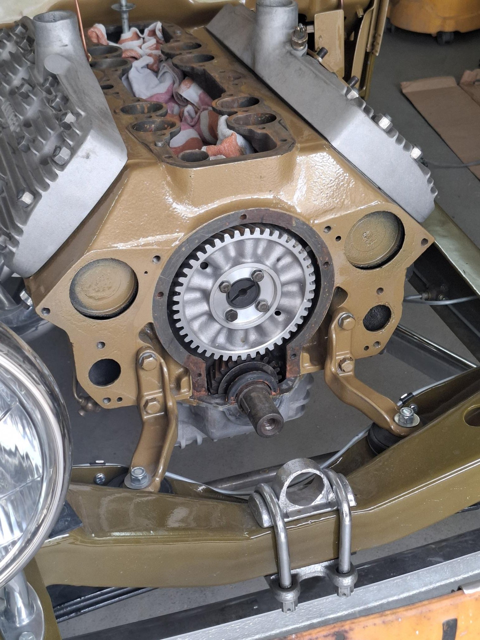

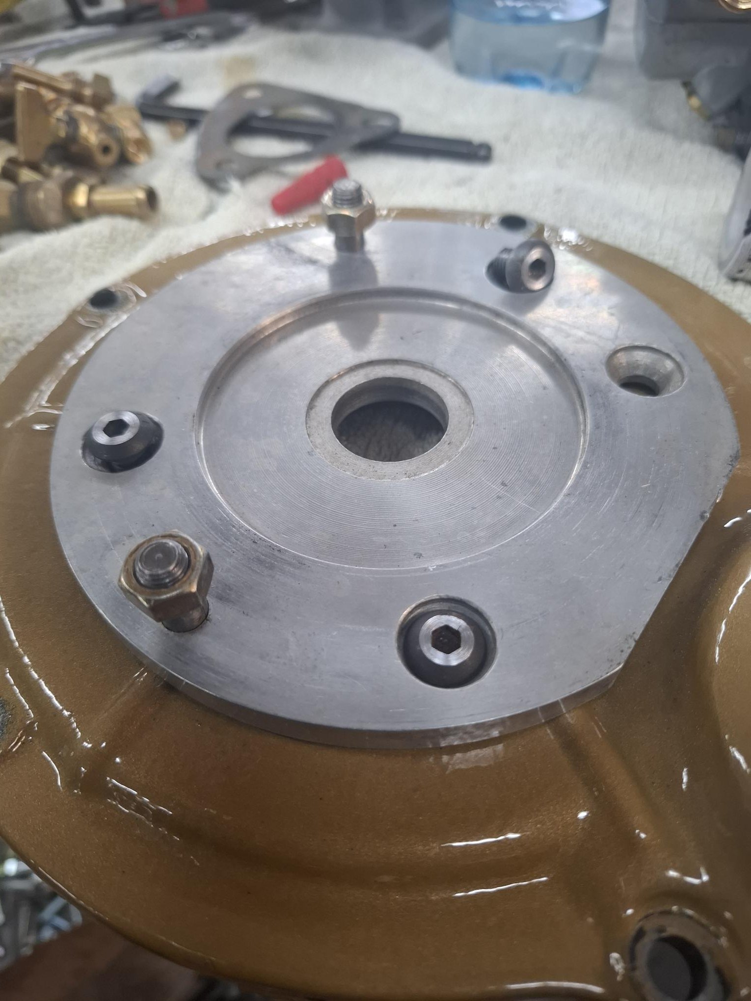

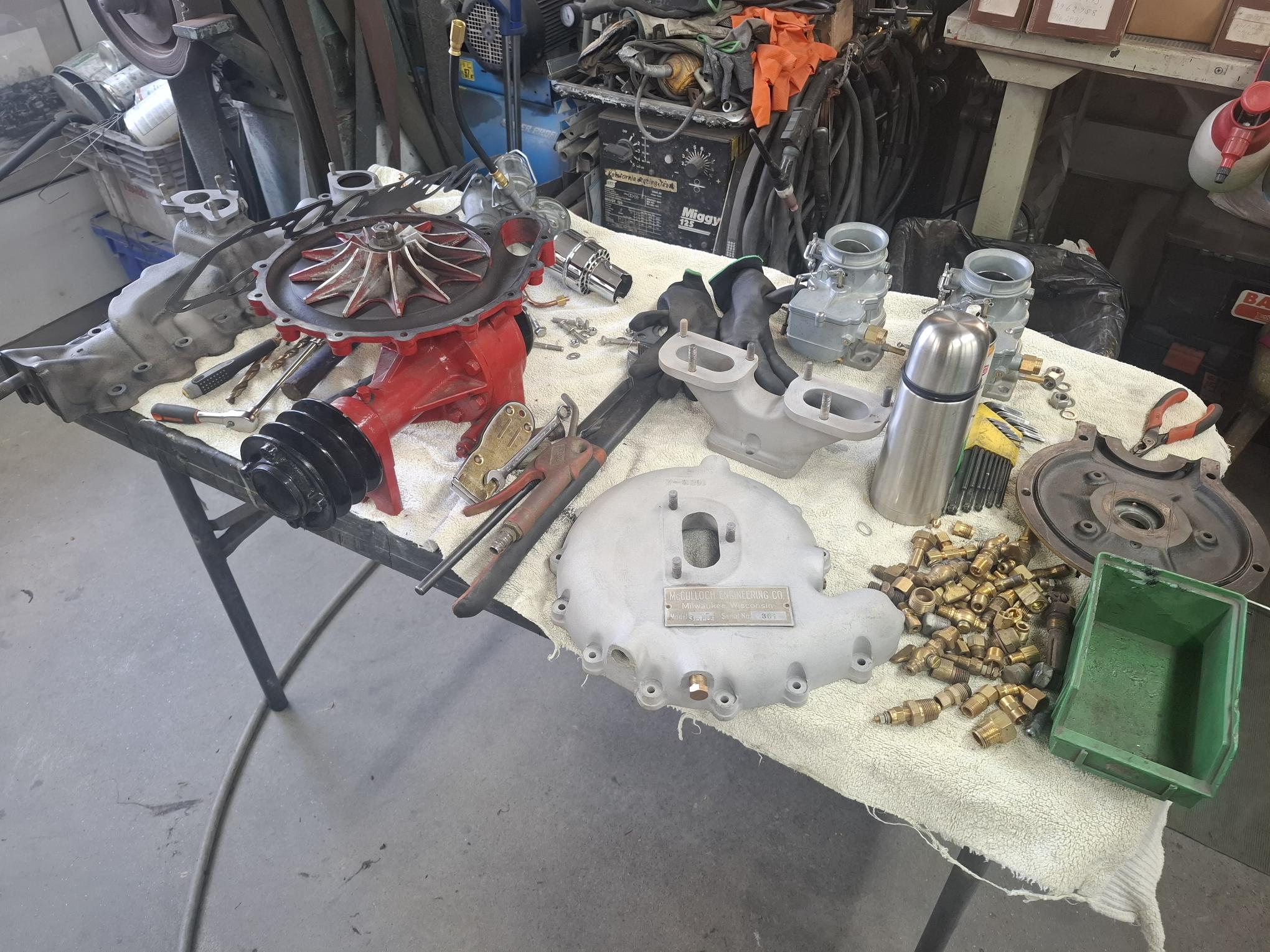

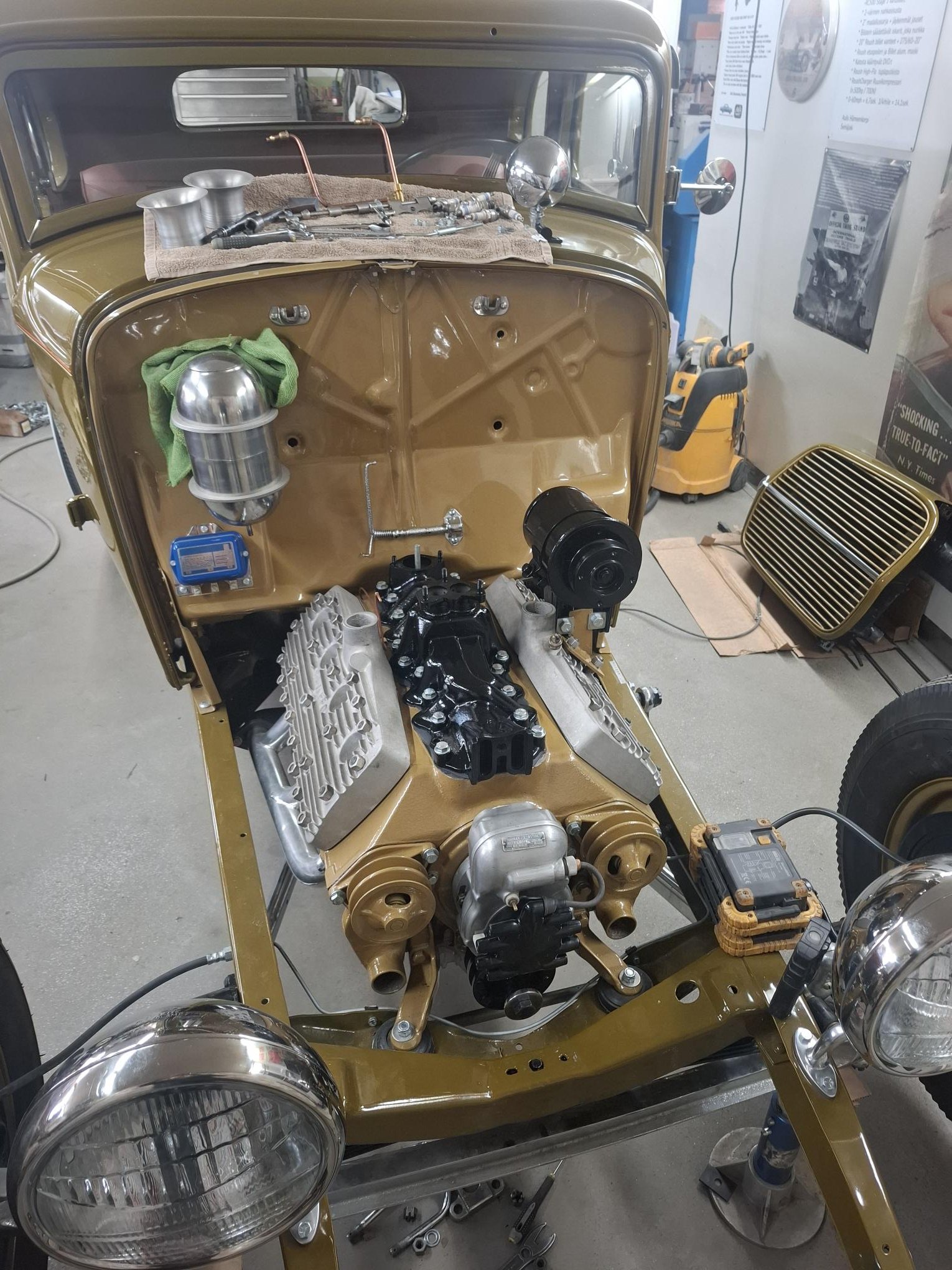

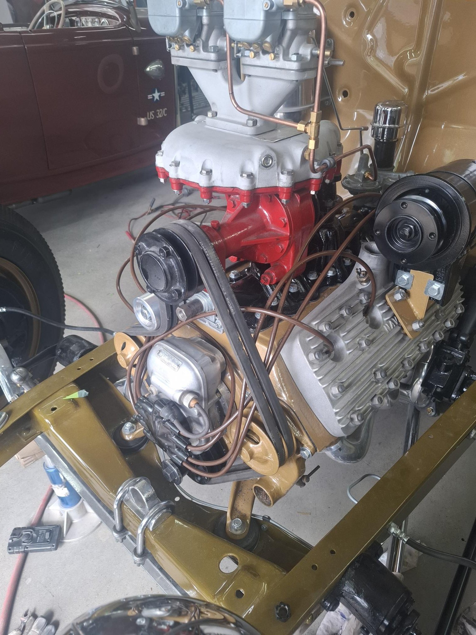

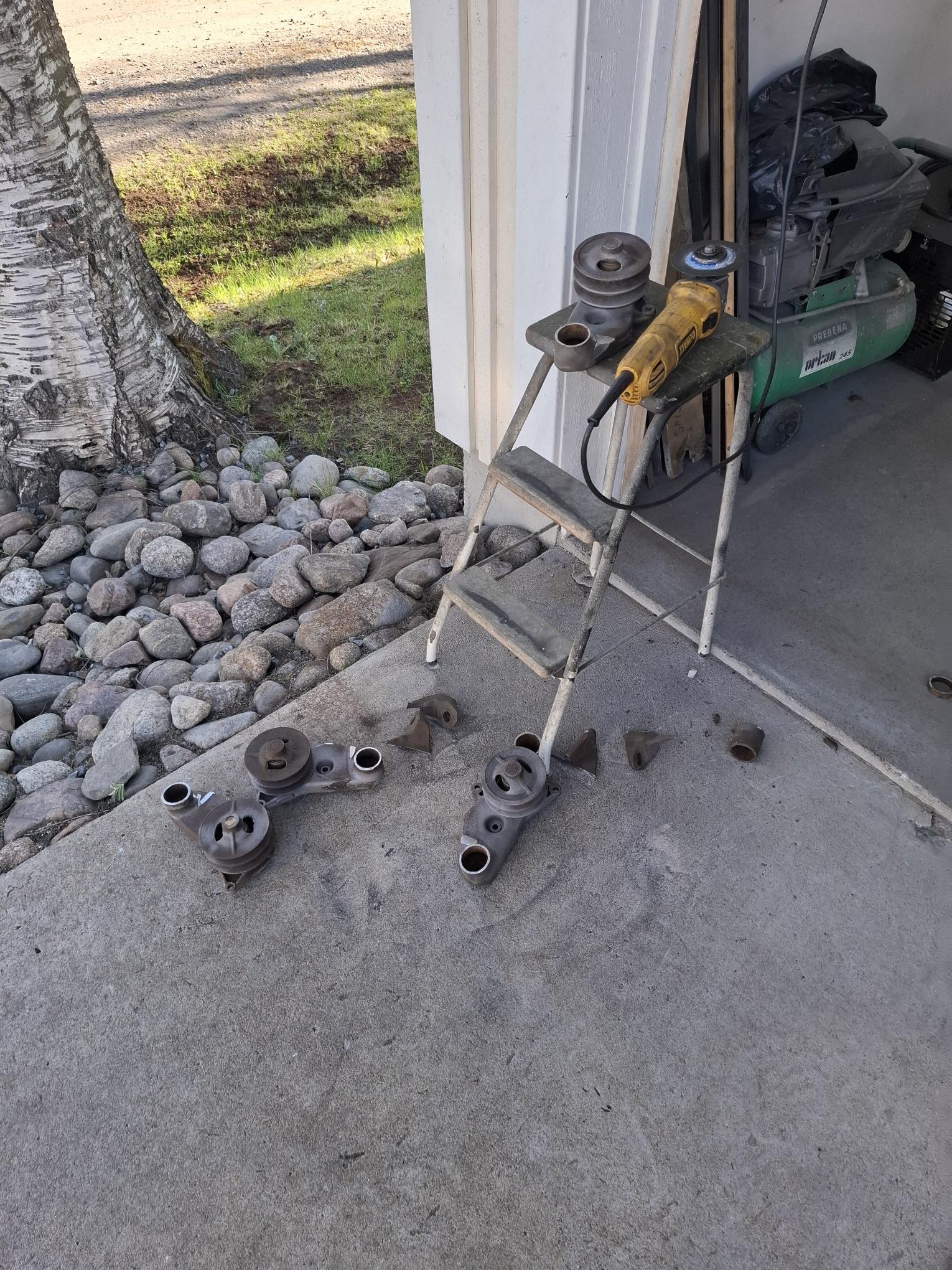

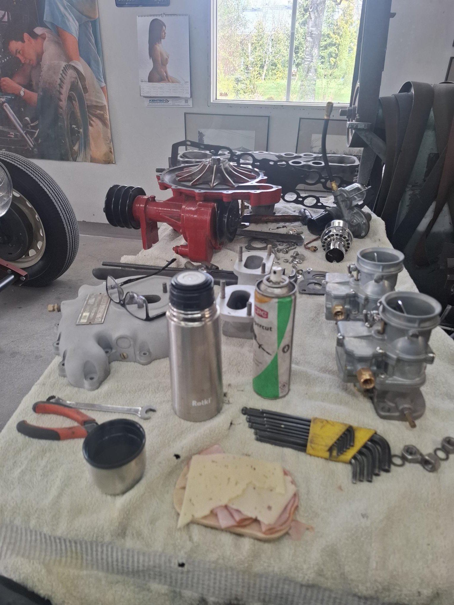

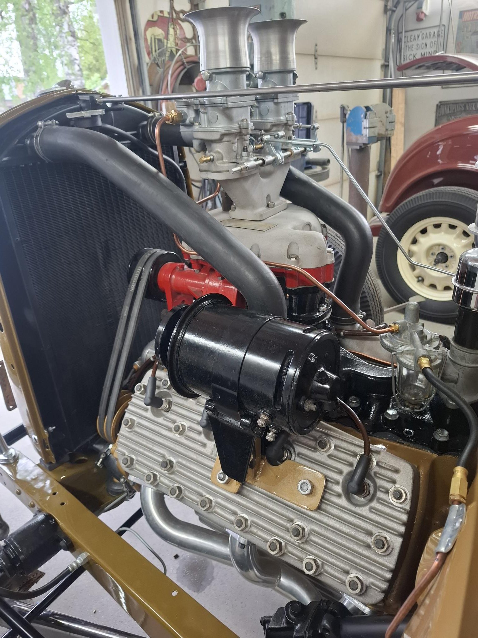

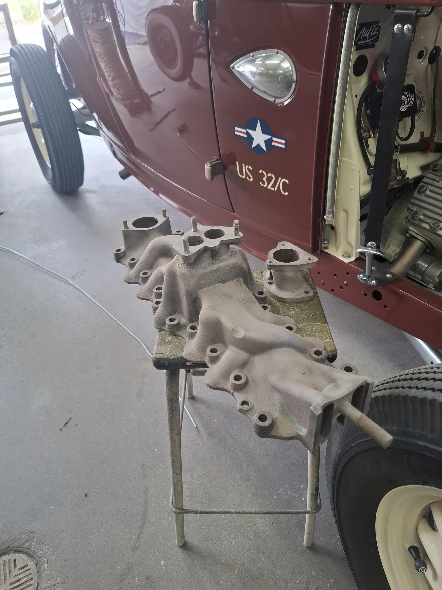

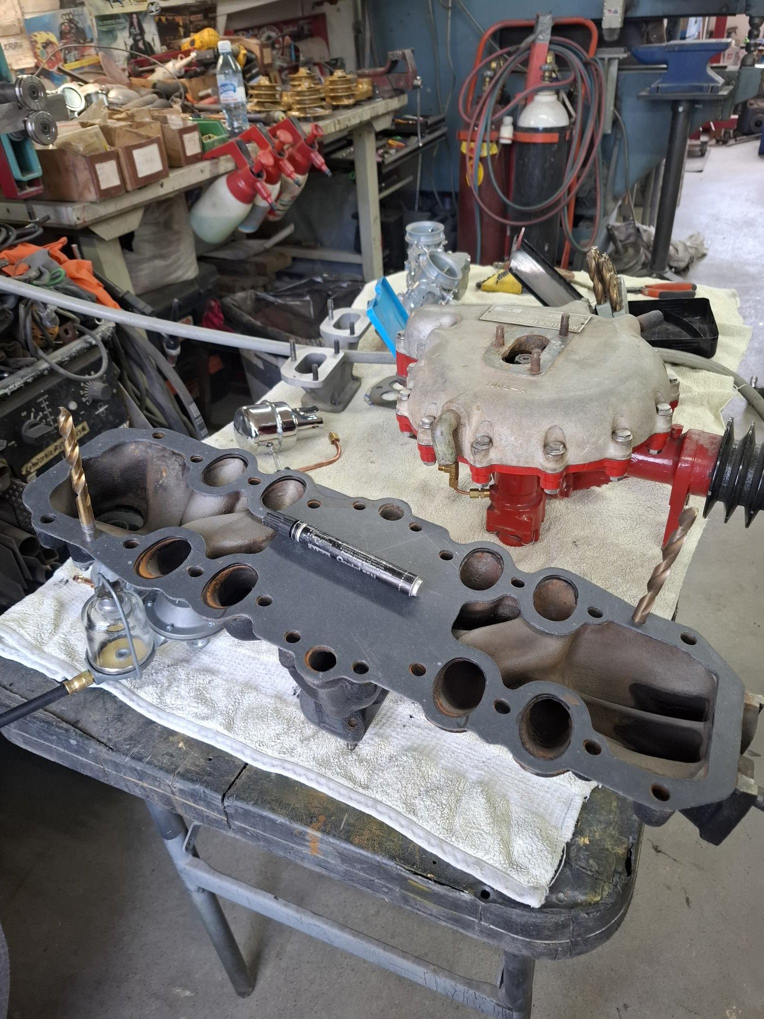

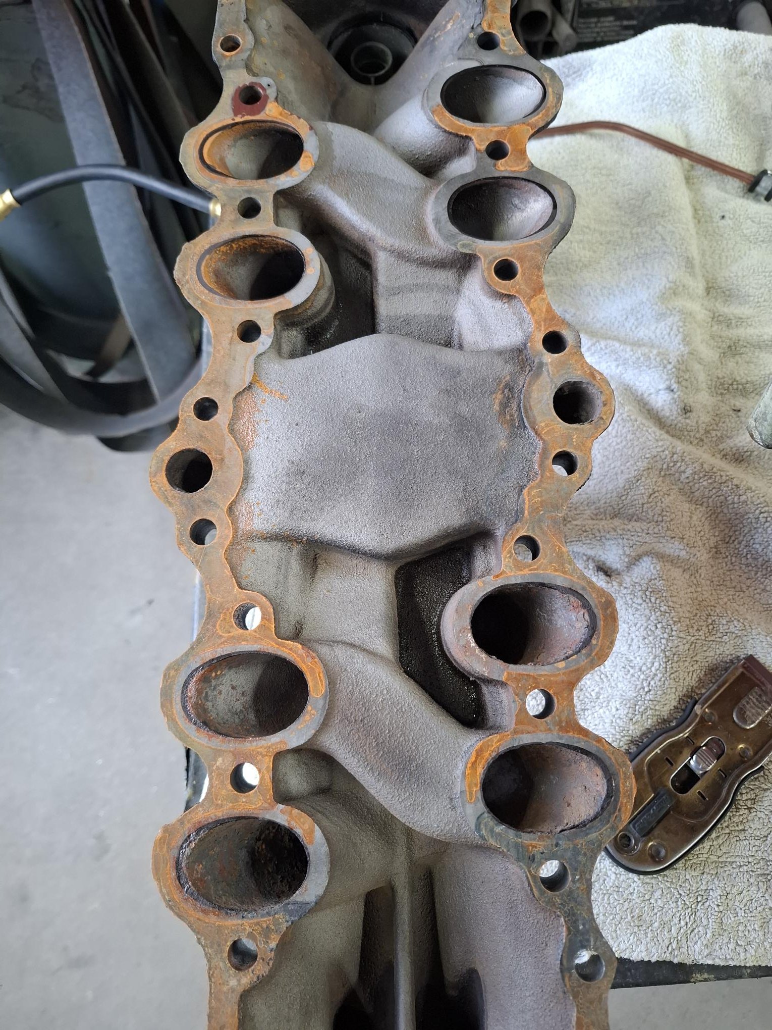

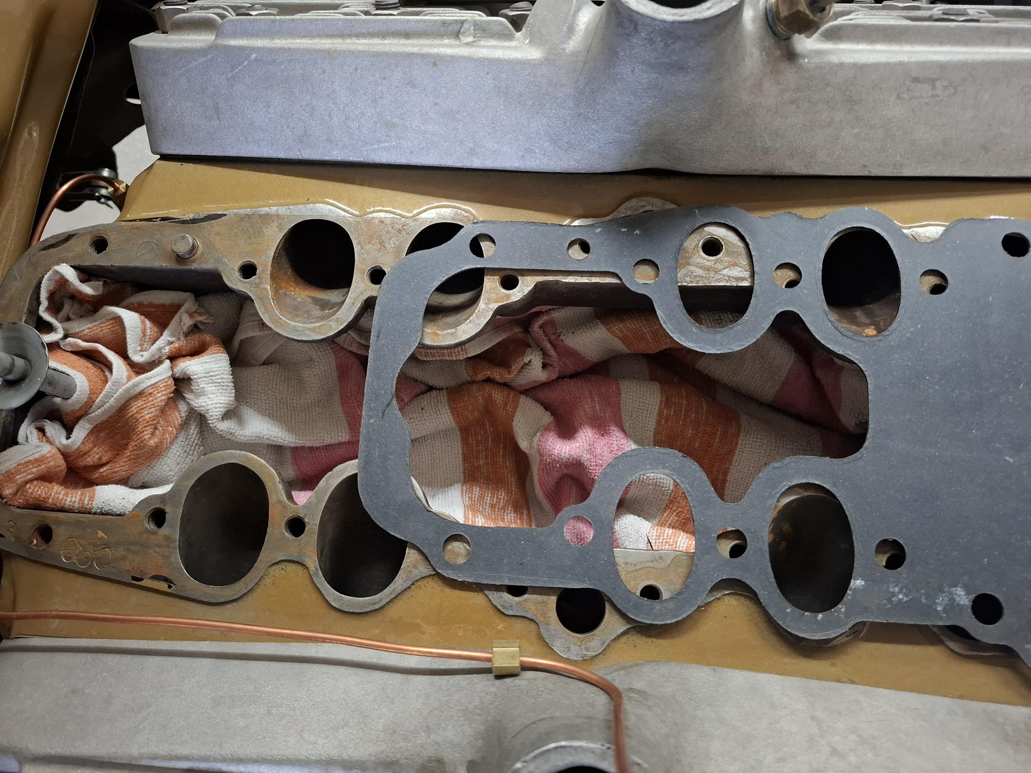

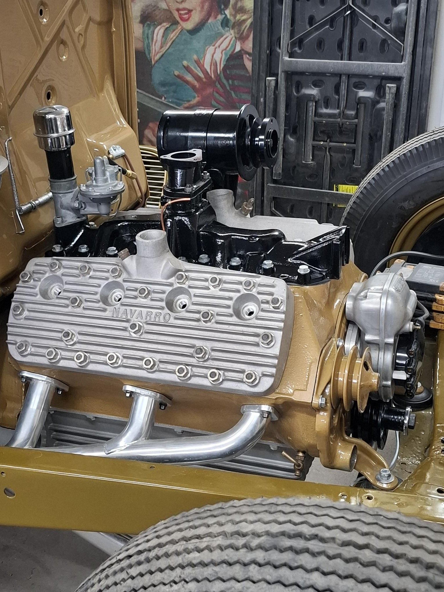

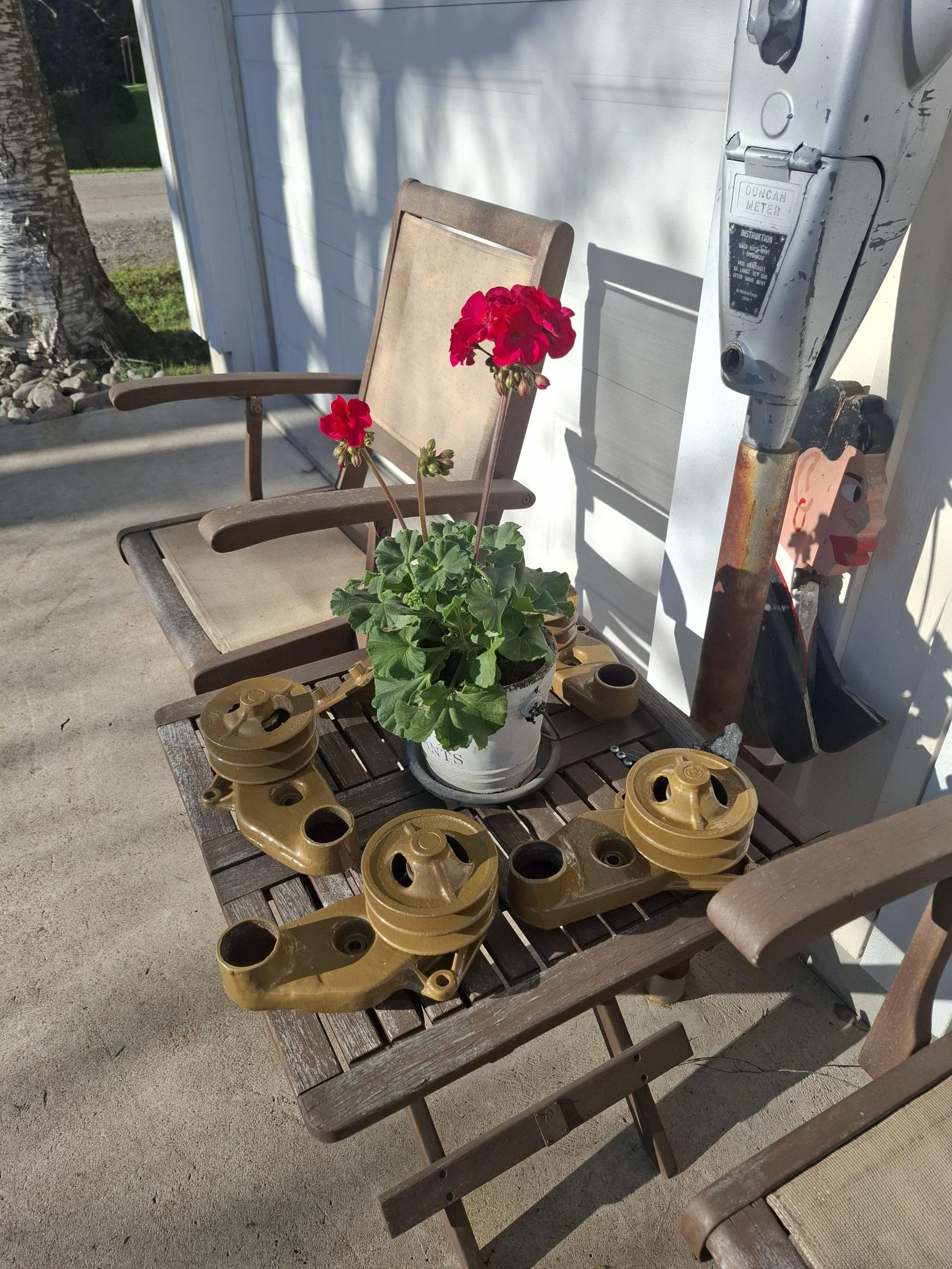

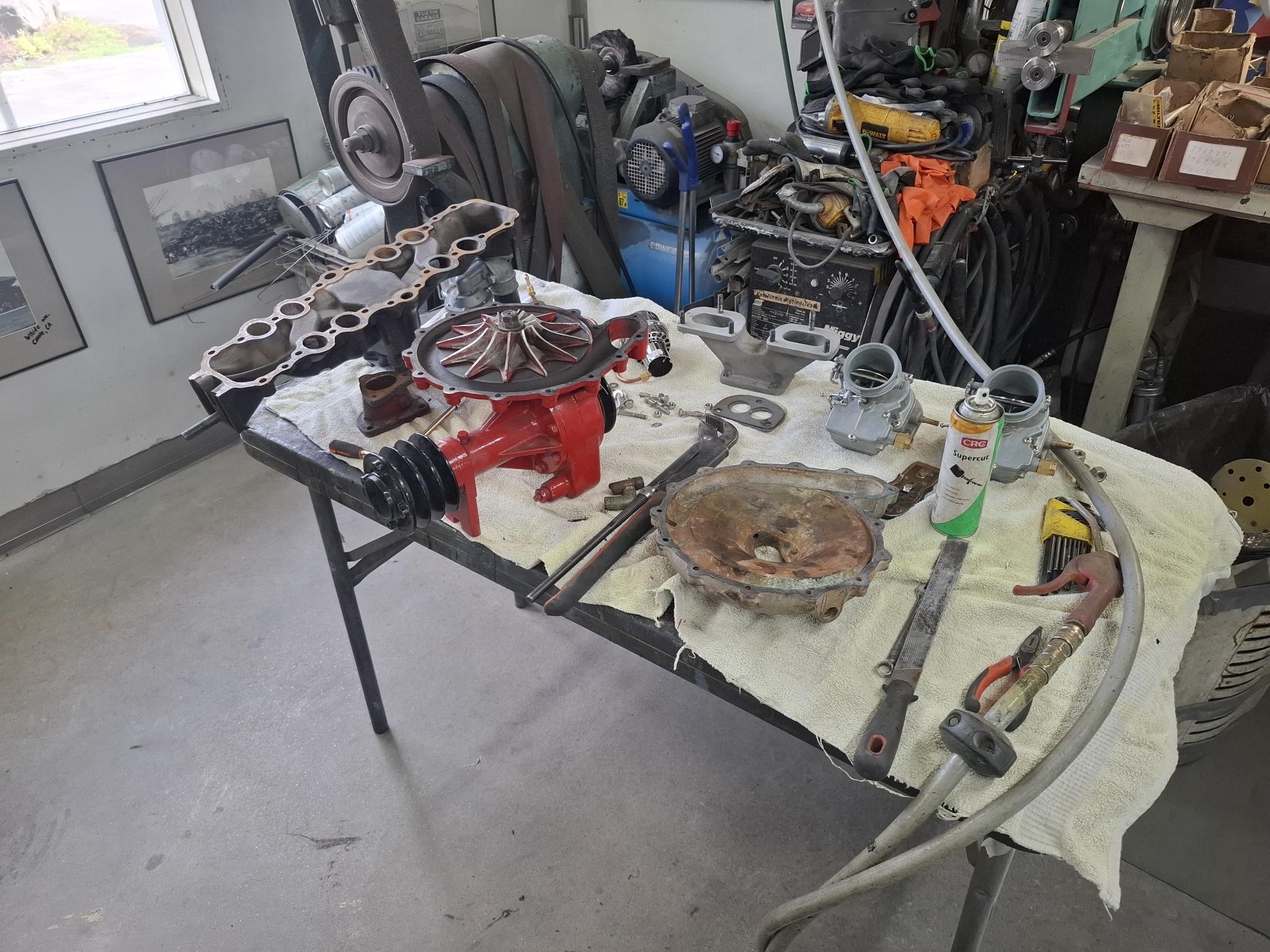

    This week I started to make engine ready for fire up.
    Waterpumps are now cut (I removed engine mounting stands), grinded, sandblasted and painted.
    Today I removed intake & supercharger .... also sandblasted those and painted black.
    Also grinded intake runners bigger. Still my big flathead in runners are bigger than intake runners. After grinded hour or two, intake was ready for paint.
    Tomorrow need to install timing cover, crankpulley, intake.
    rod-coupe1332.jpg rod-coupe1333.jpg rod-coupe1334.jpg rod-coupe1335.jpg rod-coupe1336.jpg rod-coupe1337.jpg rod-coupe1338.png rod-coupe1339.jpg rod-coupe1340.jpg rod-coupe1341.jpg rod-coupe1343.jpg rod-coupe1344.jpg
    Rgds,AULIS

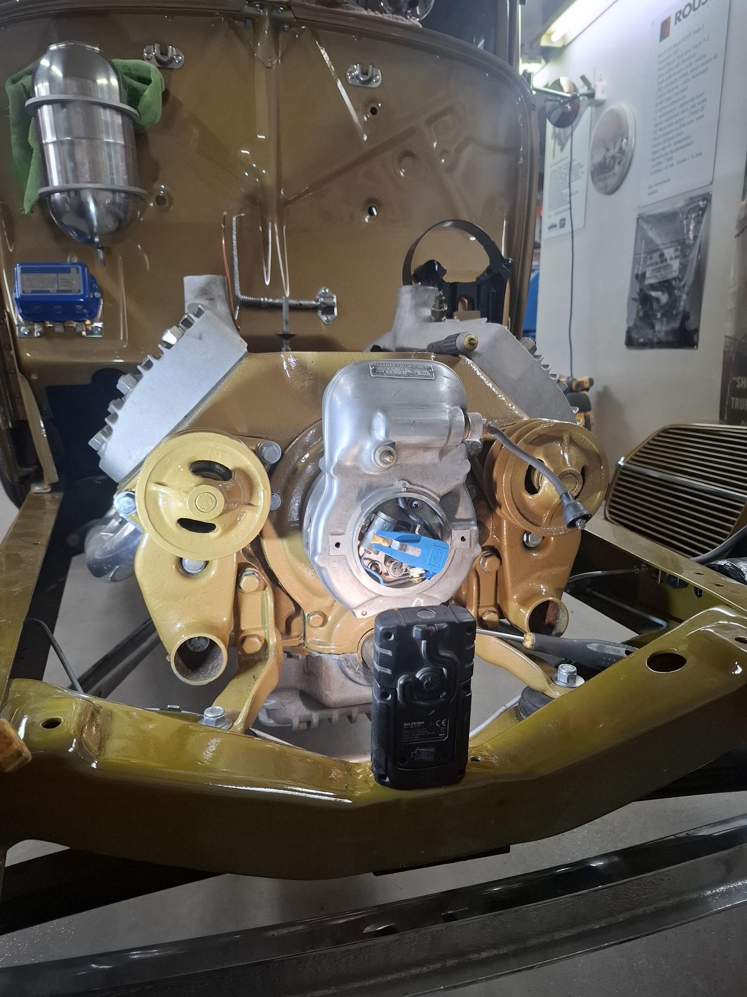

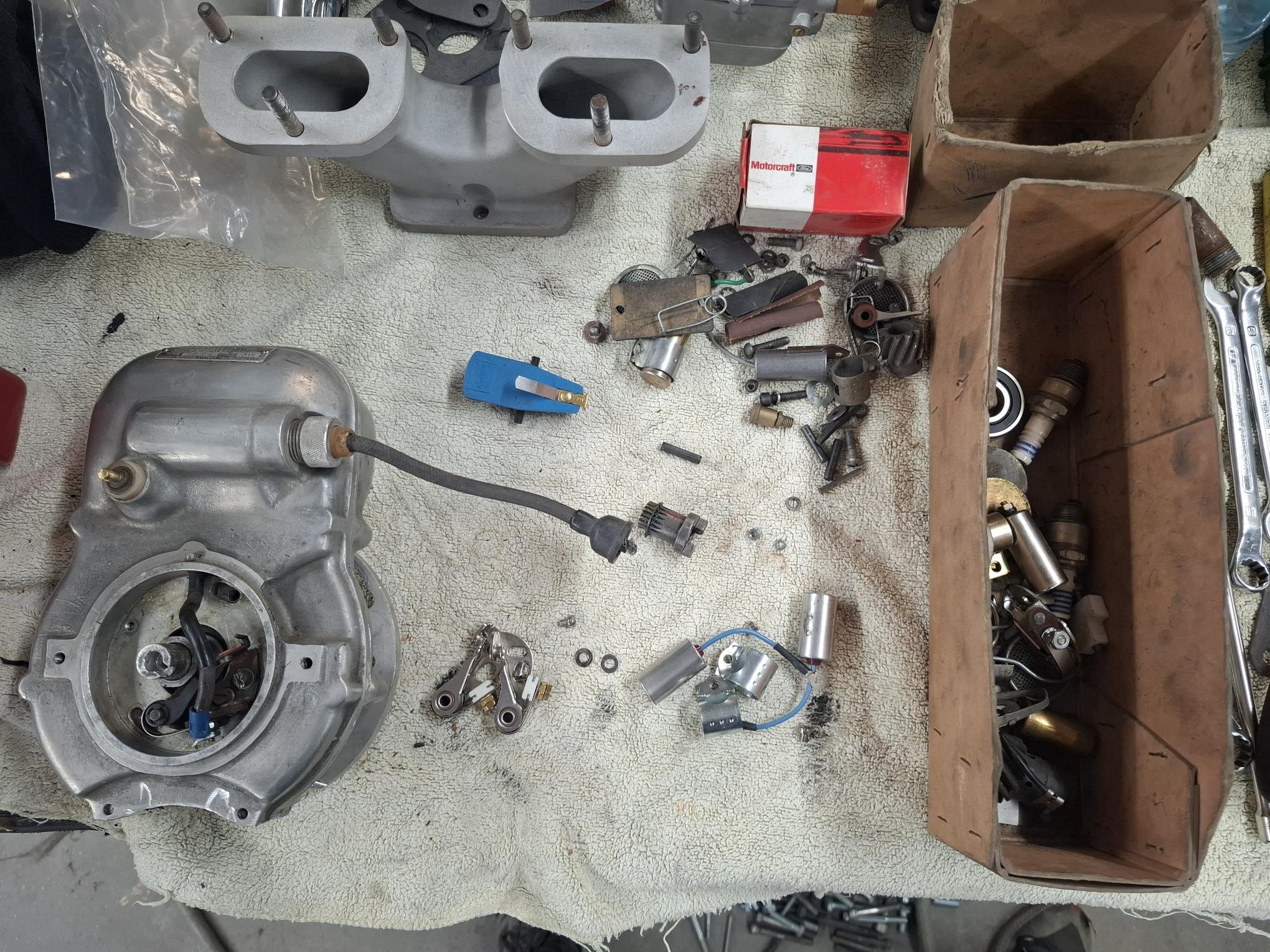

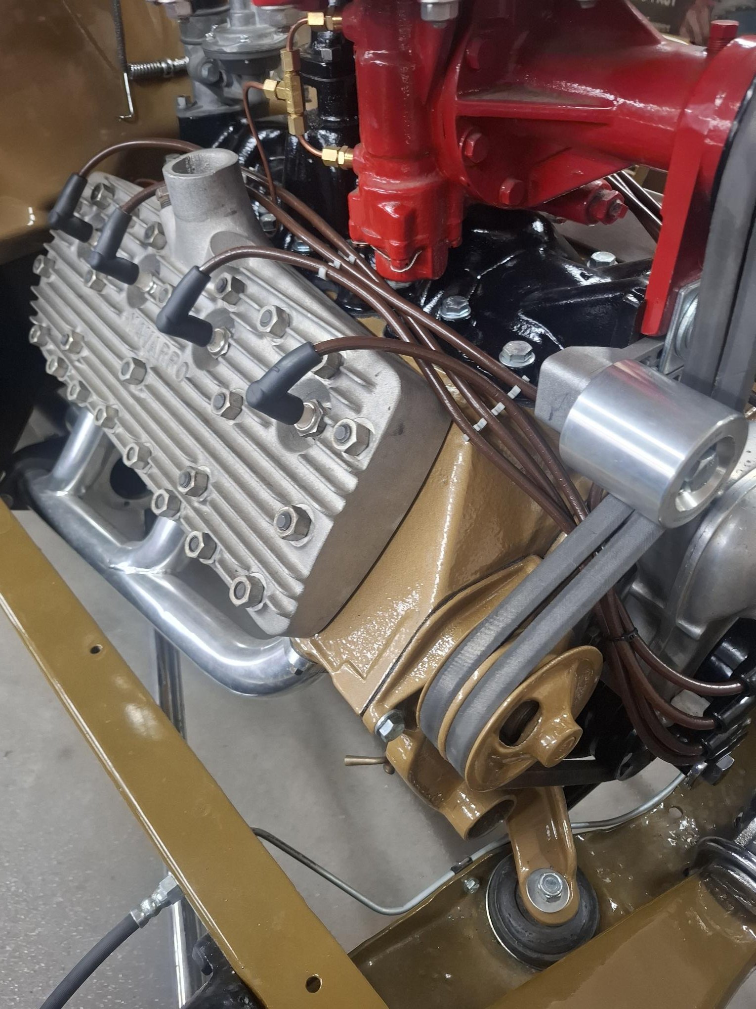

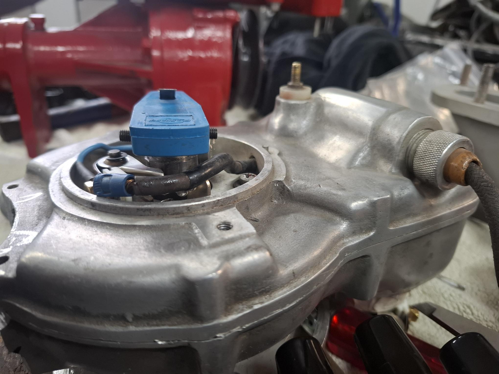

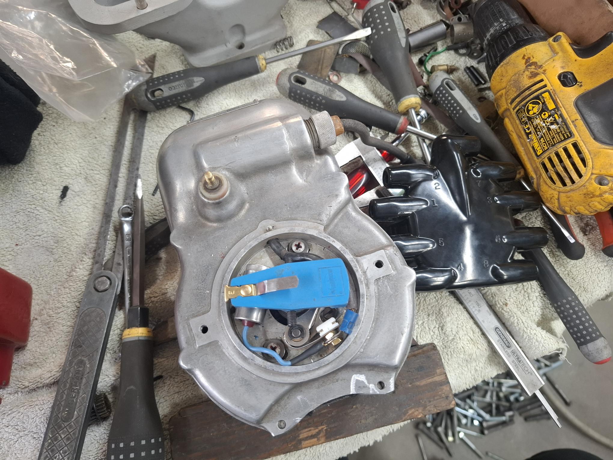

    Magneto (Harman Collins) has been rebuilt. "magnetoman" here in Finland cant reload magnetics (8)..
    so I sent magneto wheel to Tom Cirello (CA). He reloaded it and sent me new points and condensers.
    Today I put all together and tuned up magneto. I use 24-25dec advance. Fixed , because those Harman Collins magnetos are fixed advance. I use adjustable rotor. Im not sure what car rotor is this. I made inside steel sleeve and increased stop screws.
    also installed painted intake, crank pulley....
    Aulis
    rod-coupe1345.jpg rod-coupe1346.jpg rod-coupe1347.jpg rod-coupe1348.jpg rod-coupe1349.jpg rod-coupe1350.jpg rod-coupe1351.jpg

  17. patsurf
    Joined: Jan 18, 2018
    Posts: 3,409
    patsurf
    prob older style v8 ford rotor

    Thank You !
    Yes, I think rotor is old Small Block ford.

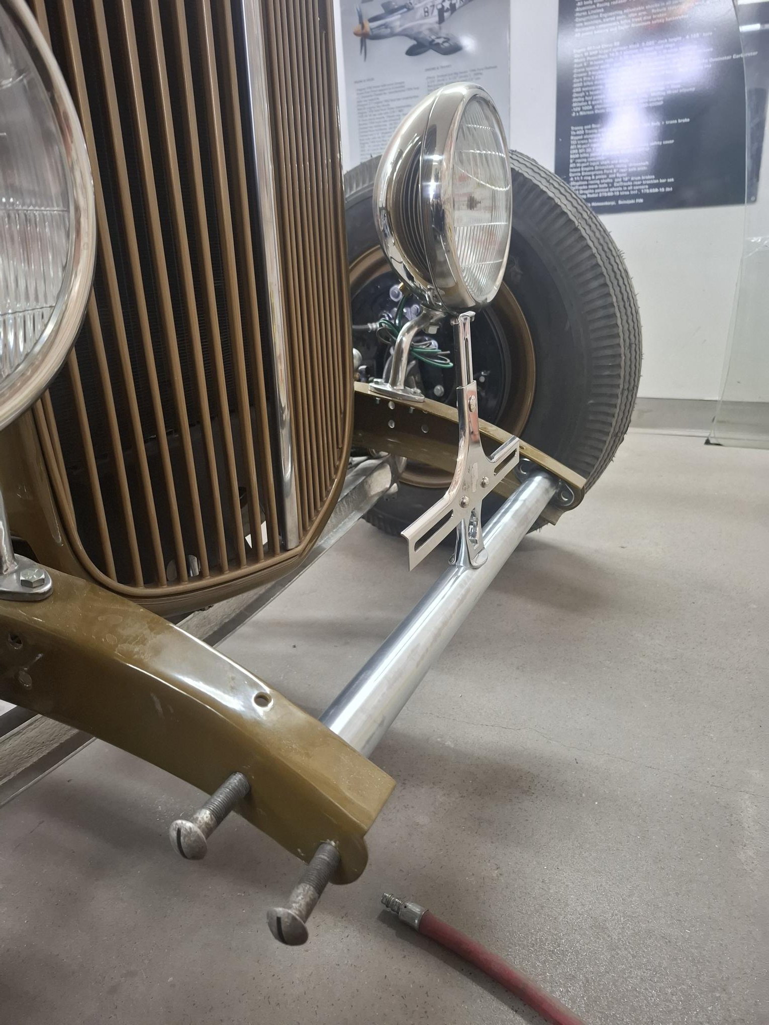

    Last weekend I visit North in "ProForest" -trade fair. Many companies who are buy bearings, power transmission from me/our company.

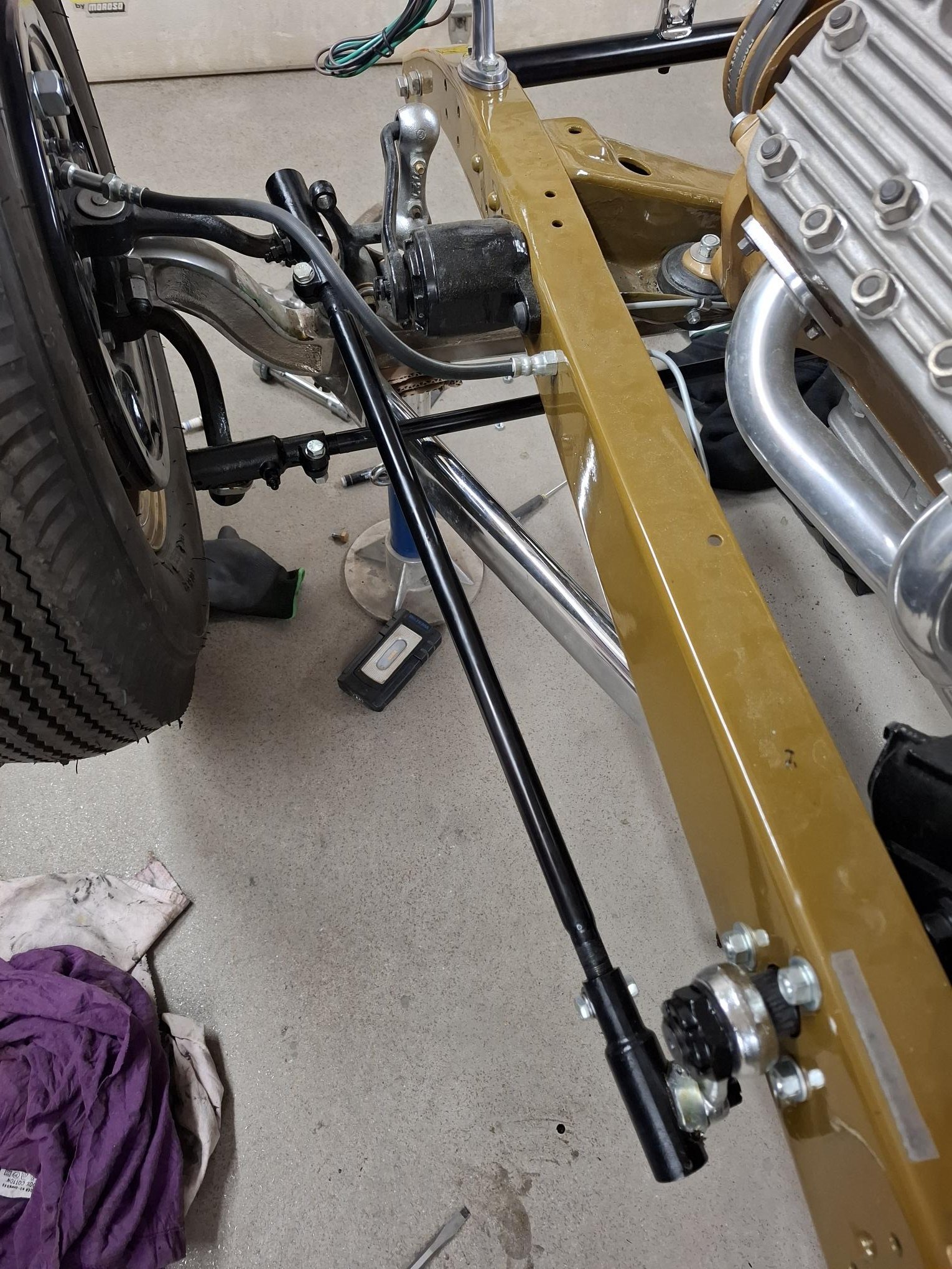

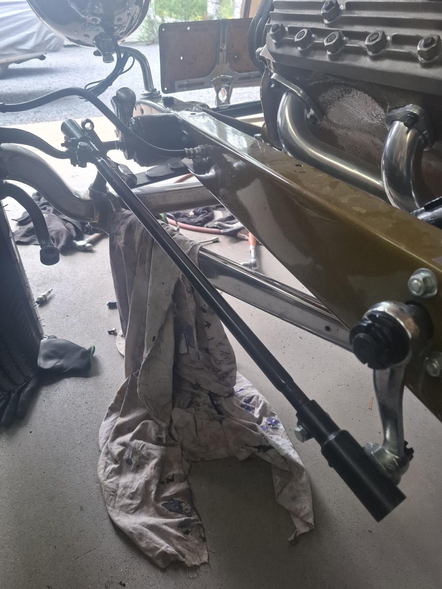

    yesterday I installed supercharger. Today I piece old front end.
    I need tie rod, which I cut pieces and used only those ends where threads are located.
    I made new draglink using those threads + new 20mm OD rod.
    Those are last parts I paint. Maybe next starter motor installation, wirings....
    Aulis

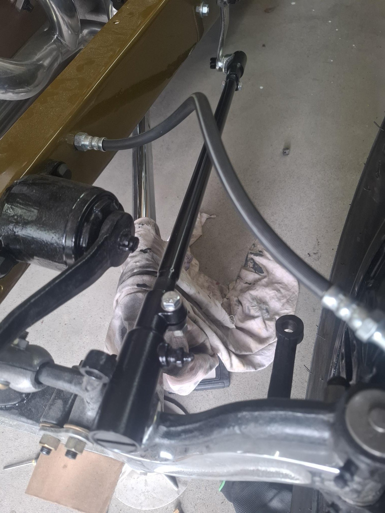

    Yesterday I paint and installed Tie Rod and Drag link.
    Found only two different colour spark plug wirings. Black cloth cover and old "fourty" ford style brown.

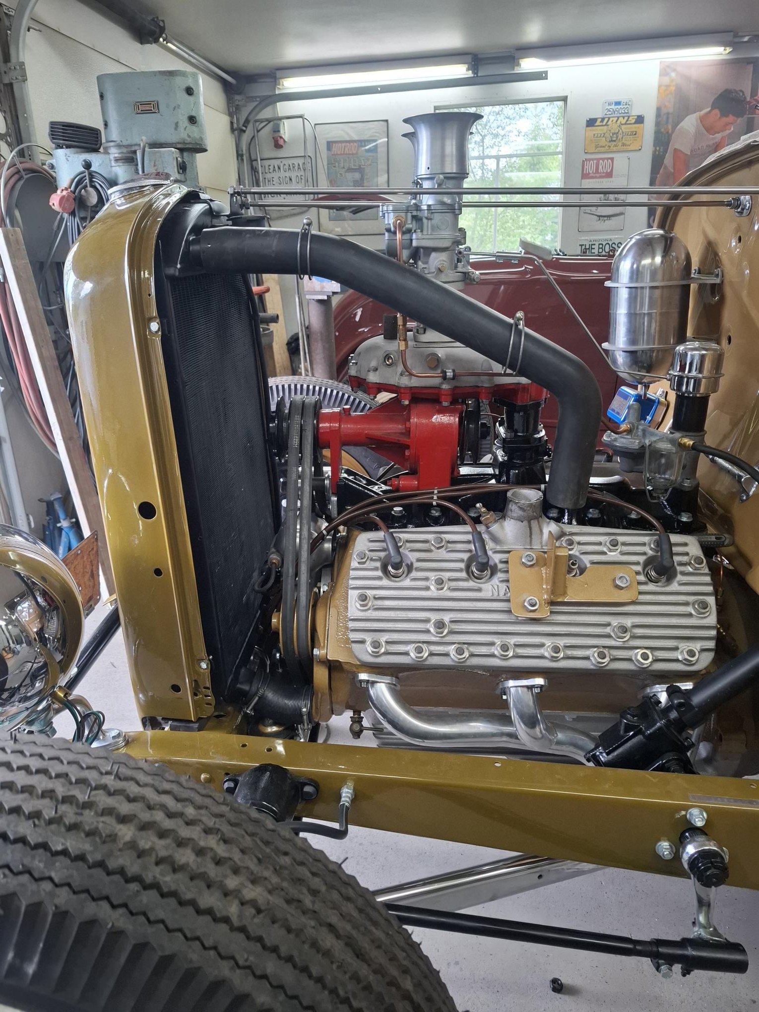

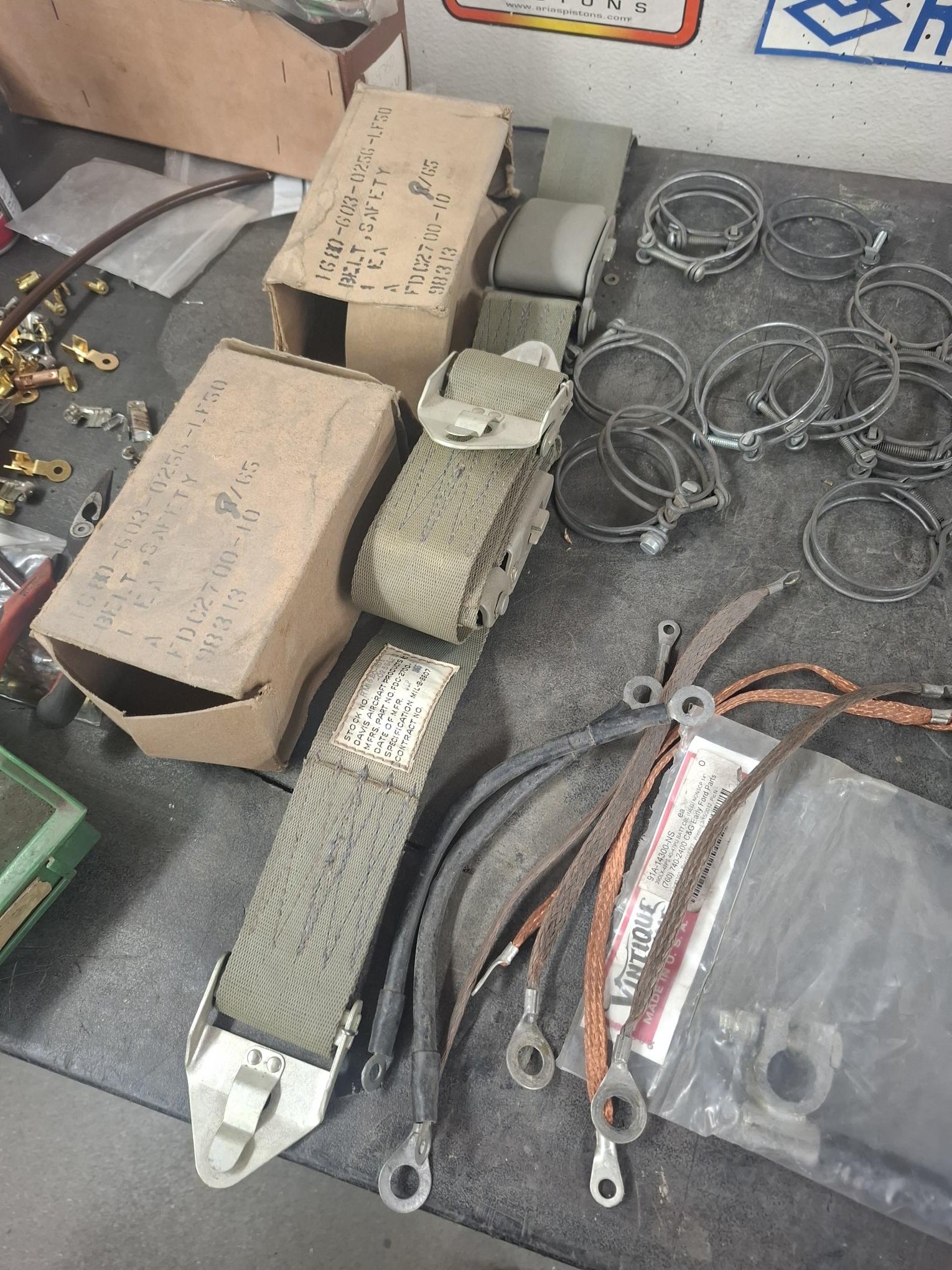

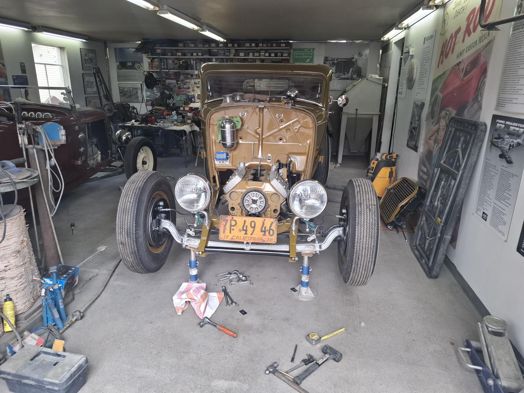

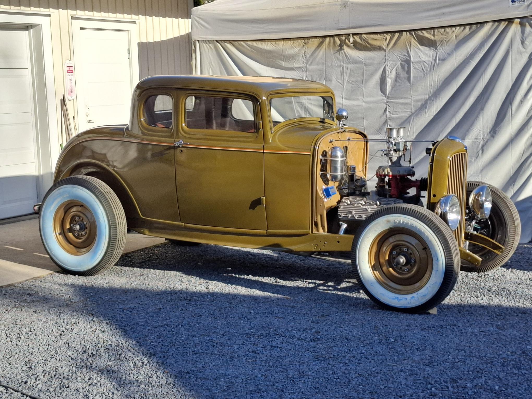

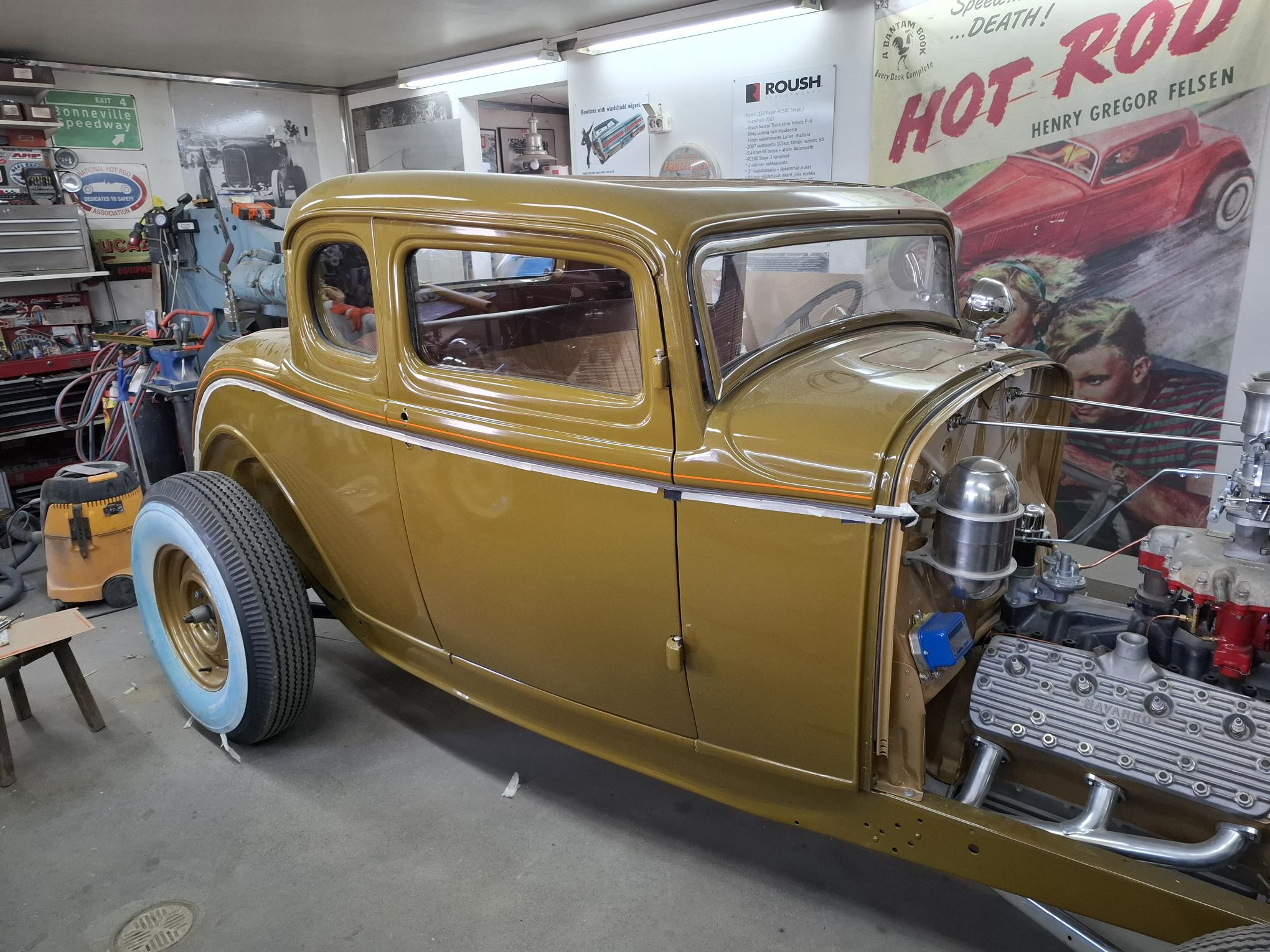

    Saturday 7th of June. Yesterday I was in Helsinki (350km south from here). Nice FHRA Cruising in Helsinki Malmi Airfield area.
    Today continued 5w coupe project.
    First I made spark plug wirings ready. I use old MSD "terminal press. Tomorrow need to byu from swedish BILTEMA shop wire boots to magneto.

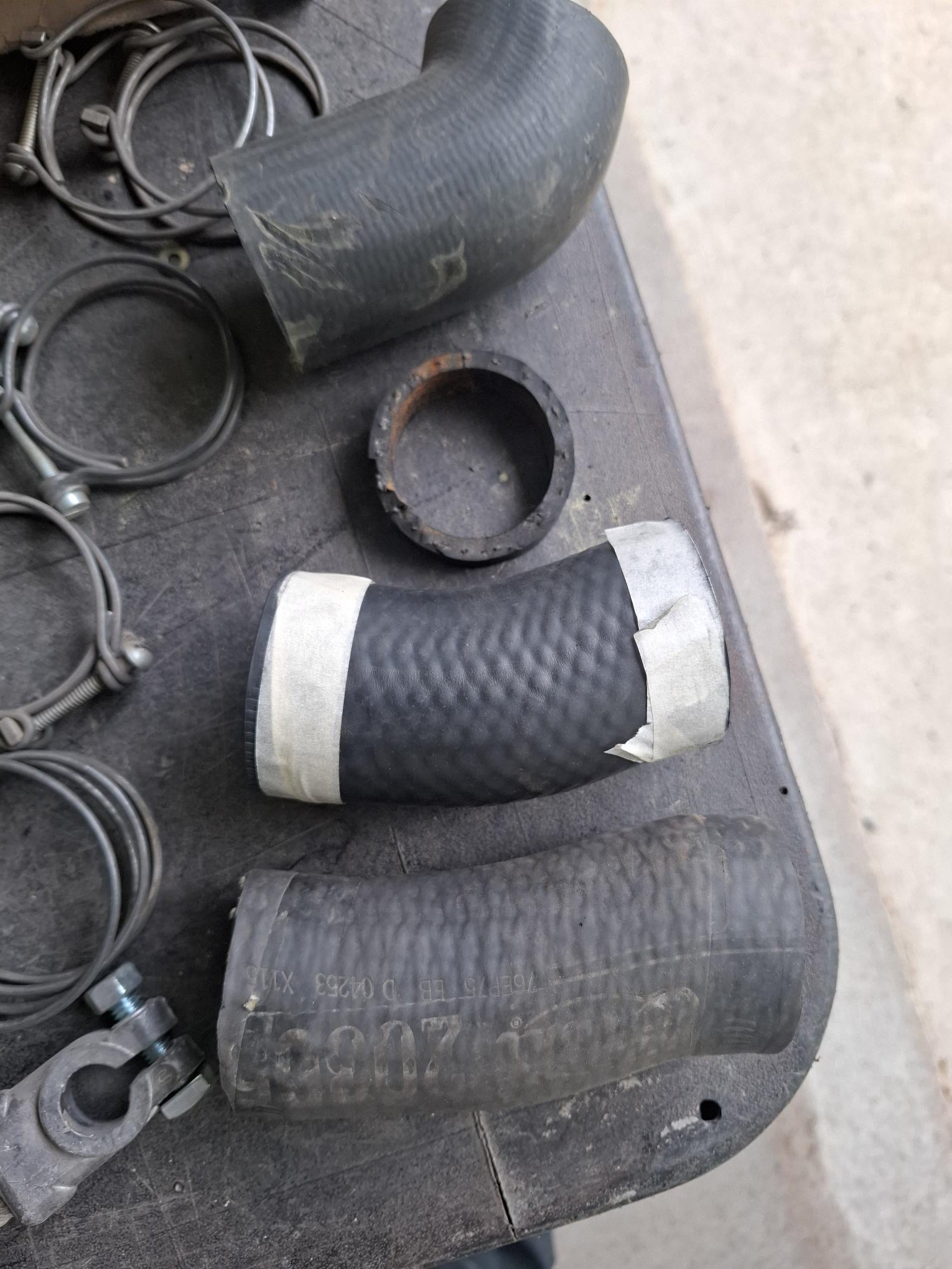

    This is first flathead in 10years I didnt used my S-curve rad hoses. This radiator lower outlets are installed so weird position. I found one old pair and used those. Old style hoseclamps and own upper hoses intalled too.
    Seat belts are NOS stuff. I have two different posibility. I like those green ones.
    From year 1965
    All V-belts are ordered. I want to use this engine BX-53 (53") belts instead of those B-53.
    Also ordered BX 25 1/2" belt for generator.
    Also installed extra gaugepanel. Need to connect mechanical oilpressue and water temp gauges.
    I still have those SUN gauges from early 70´s....
    Sorry, too many pics. rod-coupe1370.jpg rod-coupe1371.jpg rod-coupe1372.jpg rod-coupe1373.jpg rod-coupe1374.jpg rod-coupe1375.jpg rod-coupe1376.jpg rod-coupe1377.jpg rod-coupe1378.jpg rod-coupe1379.jpg rod-coupe1380.jpg rod-coupe1381.jpg rod-coupe1382.jpg rod-coupe1383.jpg rod-coupe1384.jpg rod-coupe1385.jpg rod-coupe1386.jpg rod-coupe1387.jpg rod-coupe1388.jpg rod-coupe1389.jpg rod-coupe1390.jpg
    Aulis
