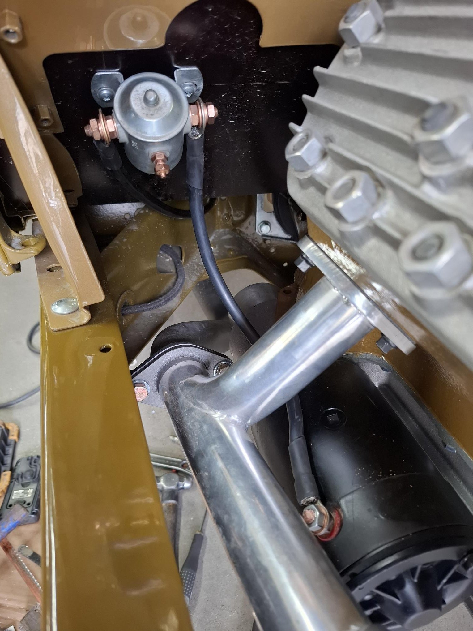

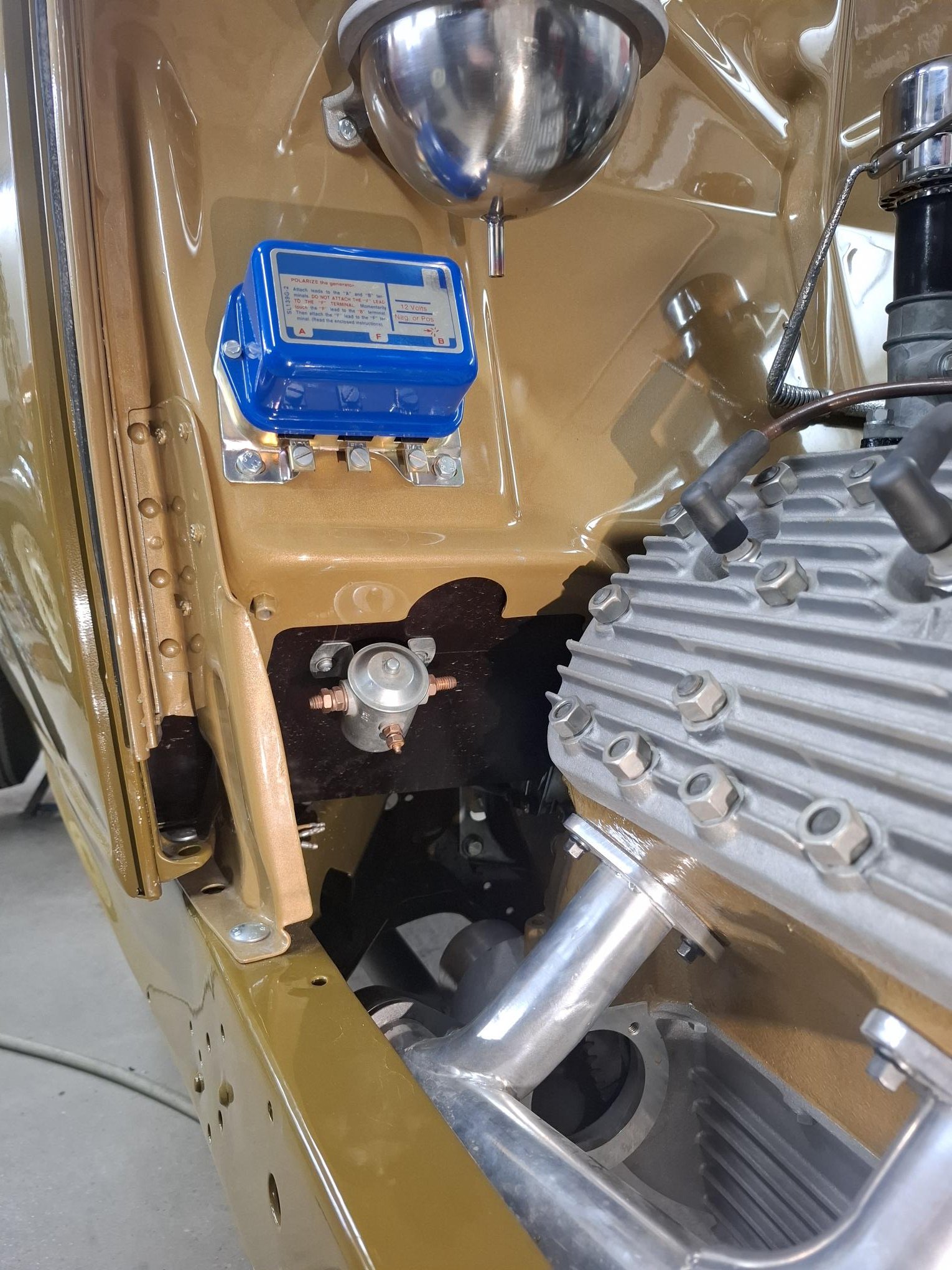

    Sunday, just worked few horus with Rod. We have cold weather here (not remember when we have had so cold and windy summer begining like this year), so I have time to built car.
    Painted and installed starter, made plus and minus cables and installed those.
    I also installed oil press tube and main switch
    Aulis

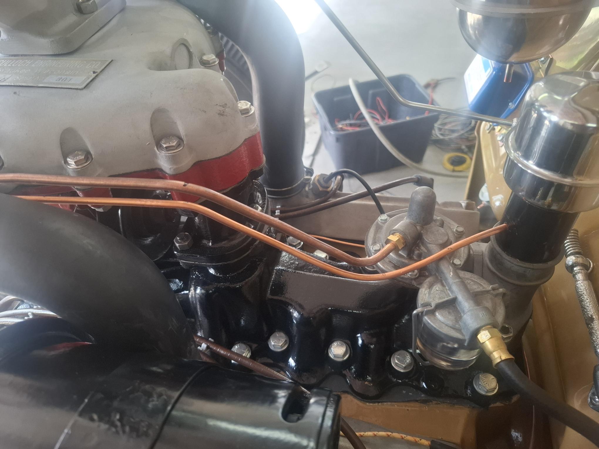

    Today We started up engine few times. All works good.
    Only problem is leaking fuel tank. There is 1-2mm hole near bottom plug.
    I have built oil pressure system to M-36 McCulloch supercharger. Maybe it has been originally "oil filled"....
    There is come in very smal oiltube. Today made empty tube which is little bigger. Im not sure is this OK system... I feel that its better that has engine oil pressure there. Supercharger has approx. 6.4:1 ratio, so it spin rather high rpm

    I changed motor oil. First I used basic 10w40 mineal oil. Good to use car painting filter when empty old oil.
    Nothing big metal s**** or other stuff. Little metal colour, but that is normal when new just bored and honed engine.
    Mobil 80w90 to ****** and rear axle.
    I still wonder that +1mm hole in gas tank... Yesterday we empty (3gal) it and today I sand that area where hole is located. Didnt want to fill it up (water), I used Plastic padding fuel tank rebuilding stuff (2K). I hope it works.
    I leave tank like that. Painted just that area, nothing more. I can repaint it after summer.

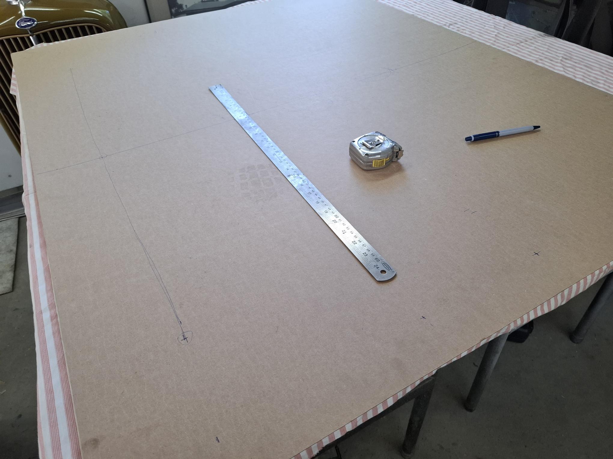

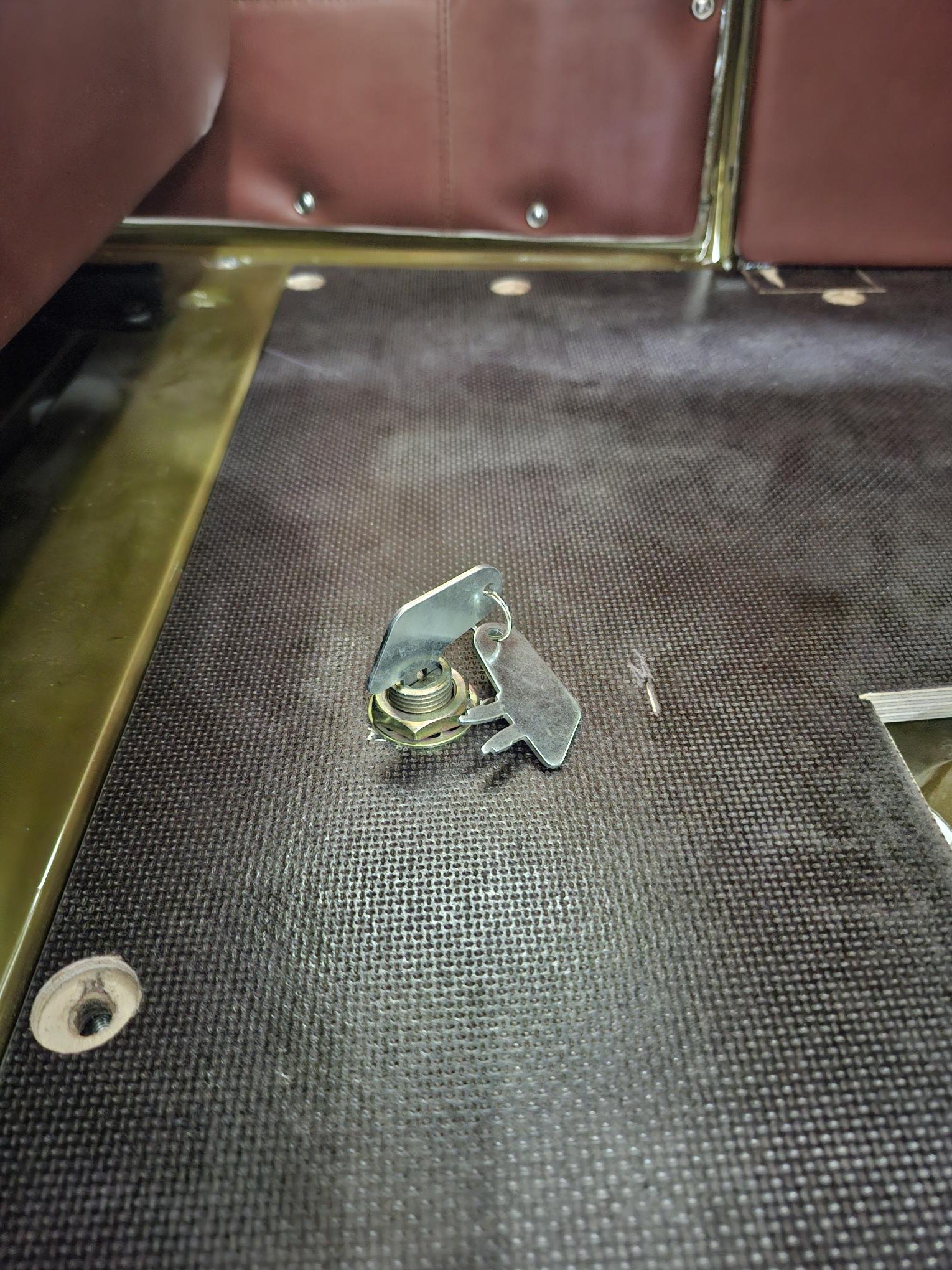

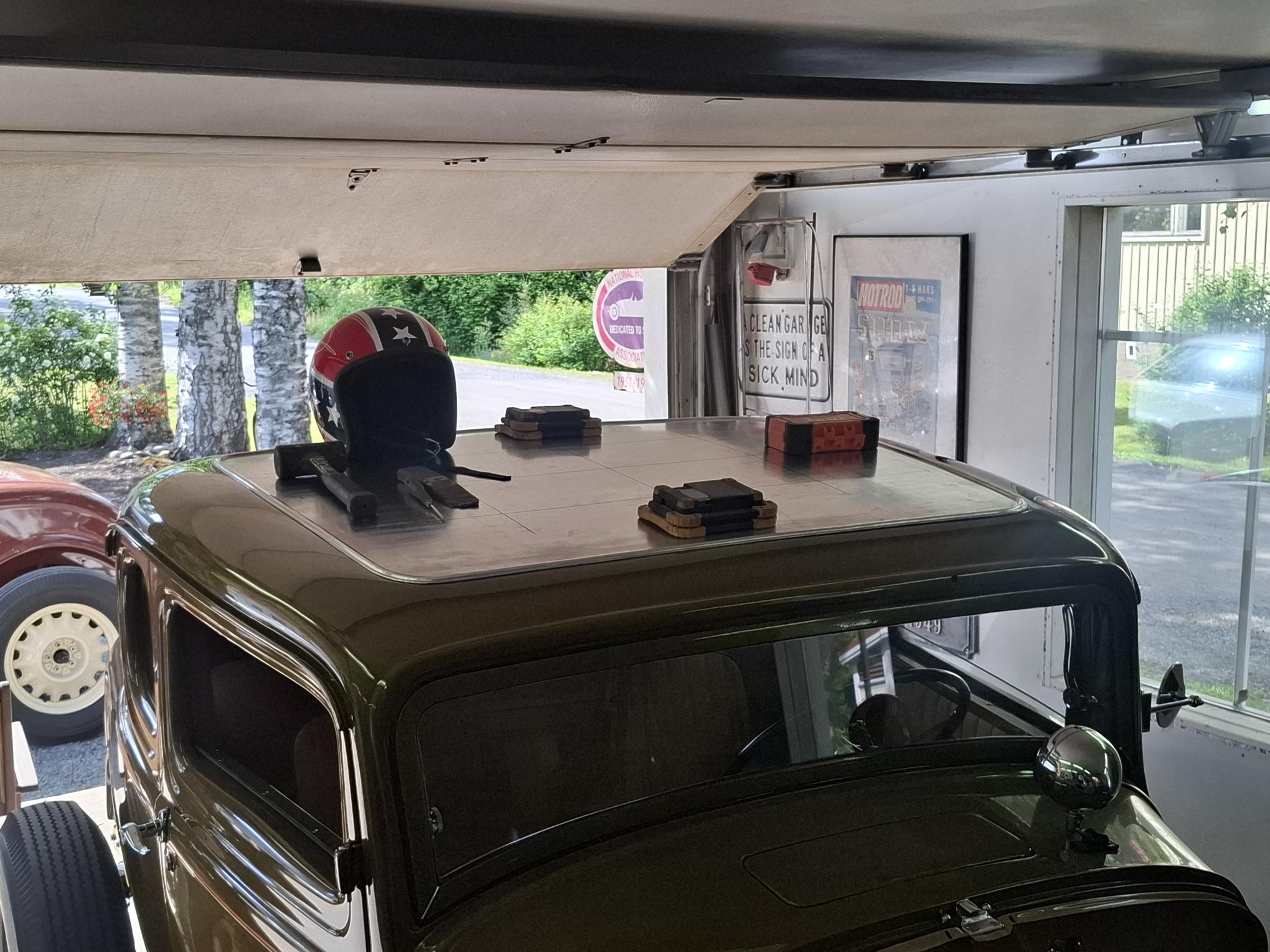

    Today I made top aluminum drawing.
    Also bolted on early 60´s ashtray to the firewall. Good nut, washer keeper.
    Aulis

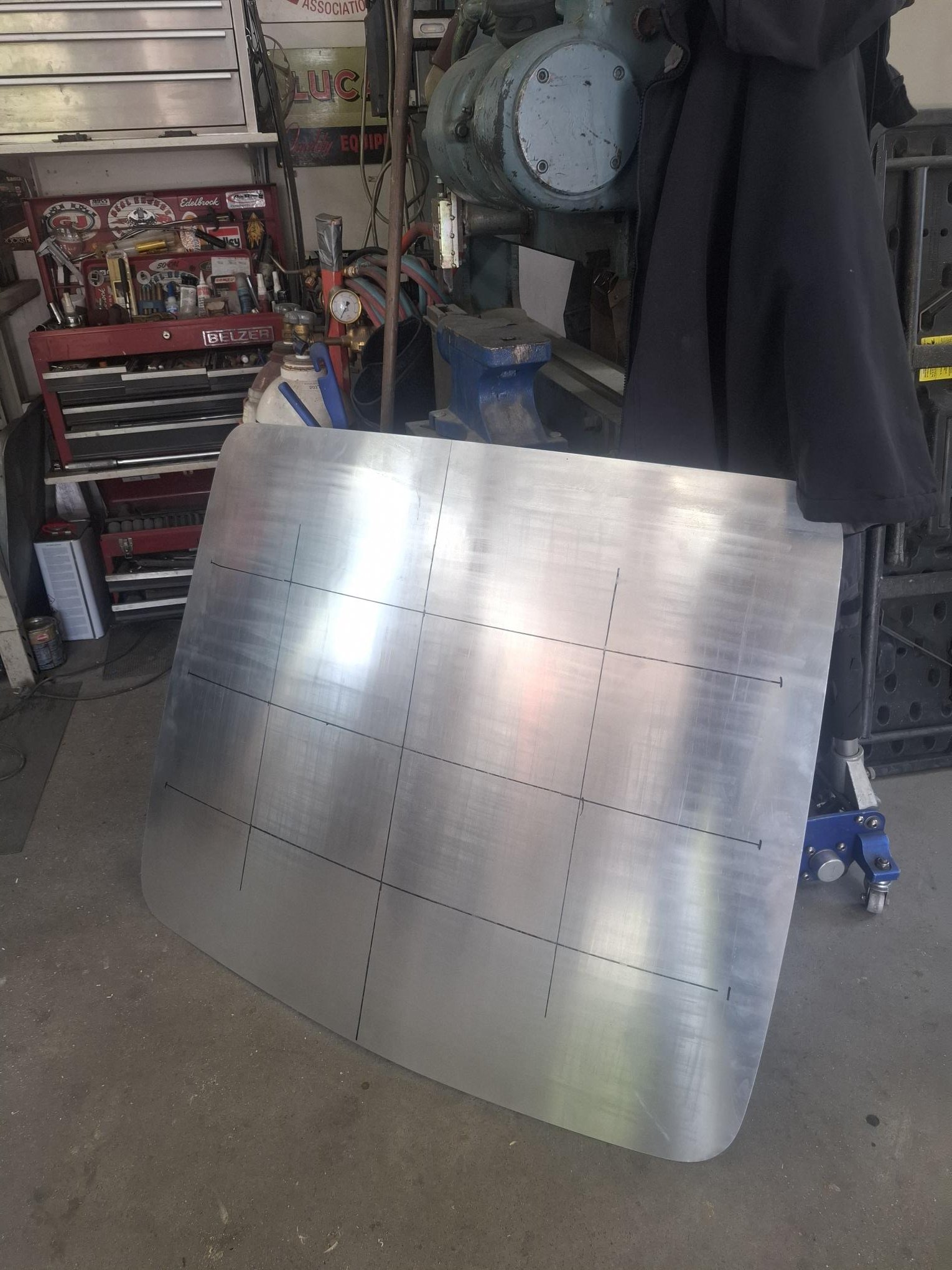

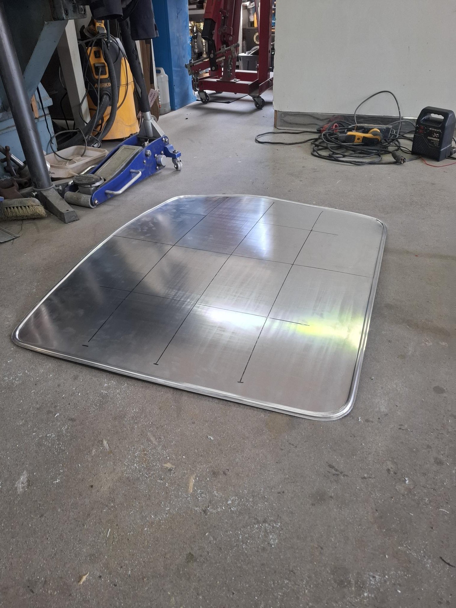

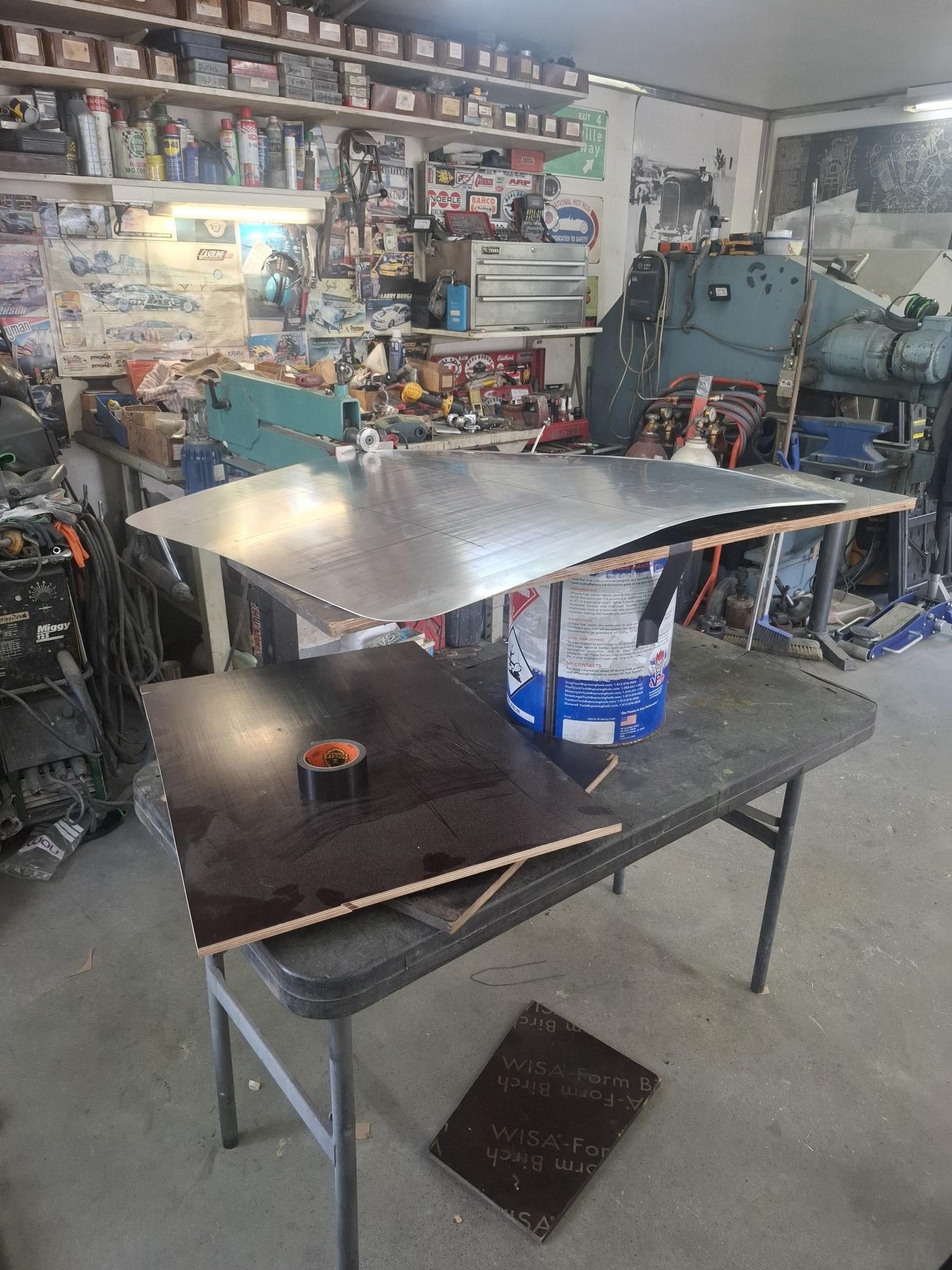

    Few hours and top aluminum is slowly looks top cover.
    Not ideal situation roll alum. alone, but.... rainy day and son is coming home tomorrow so I tried alone my best.
    Tomorrow, when Mr. Oskar is here, he need to help me when I use beadroller machine.
    Aulis

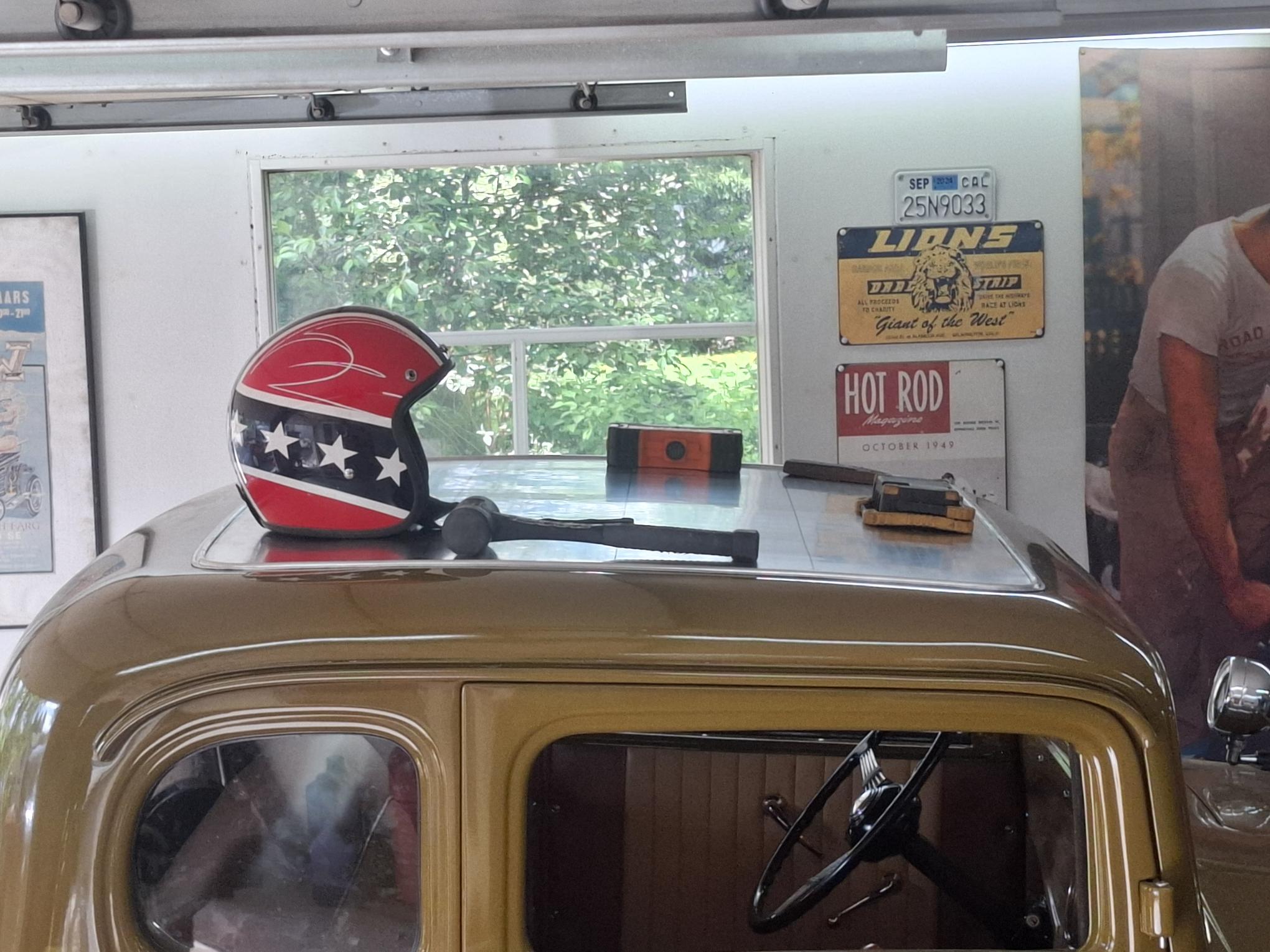

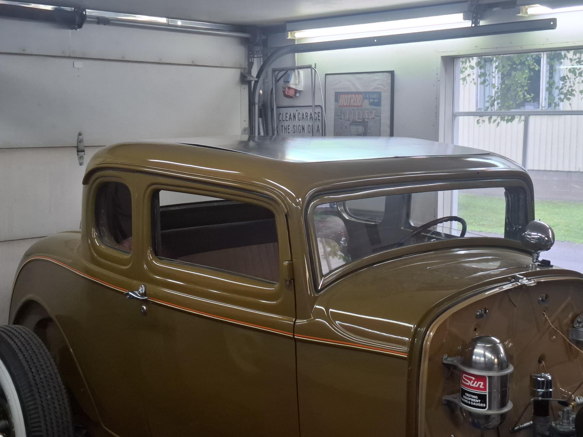

    one pic more.
    Maybe enough curved both way.
    A
  28. patsurf
    Joined: Jan 18, 2018
    Posts: 2,832
    patsurf
    yes i think it fits like a glove!

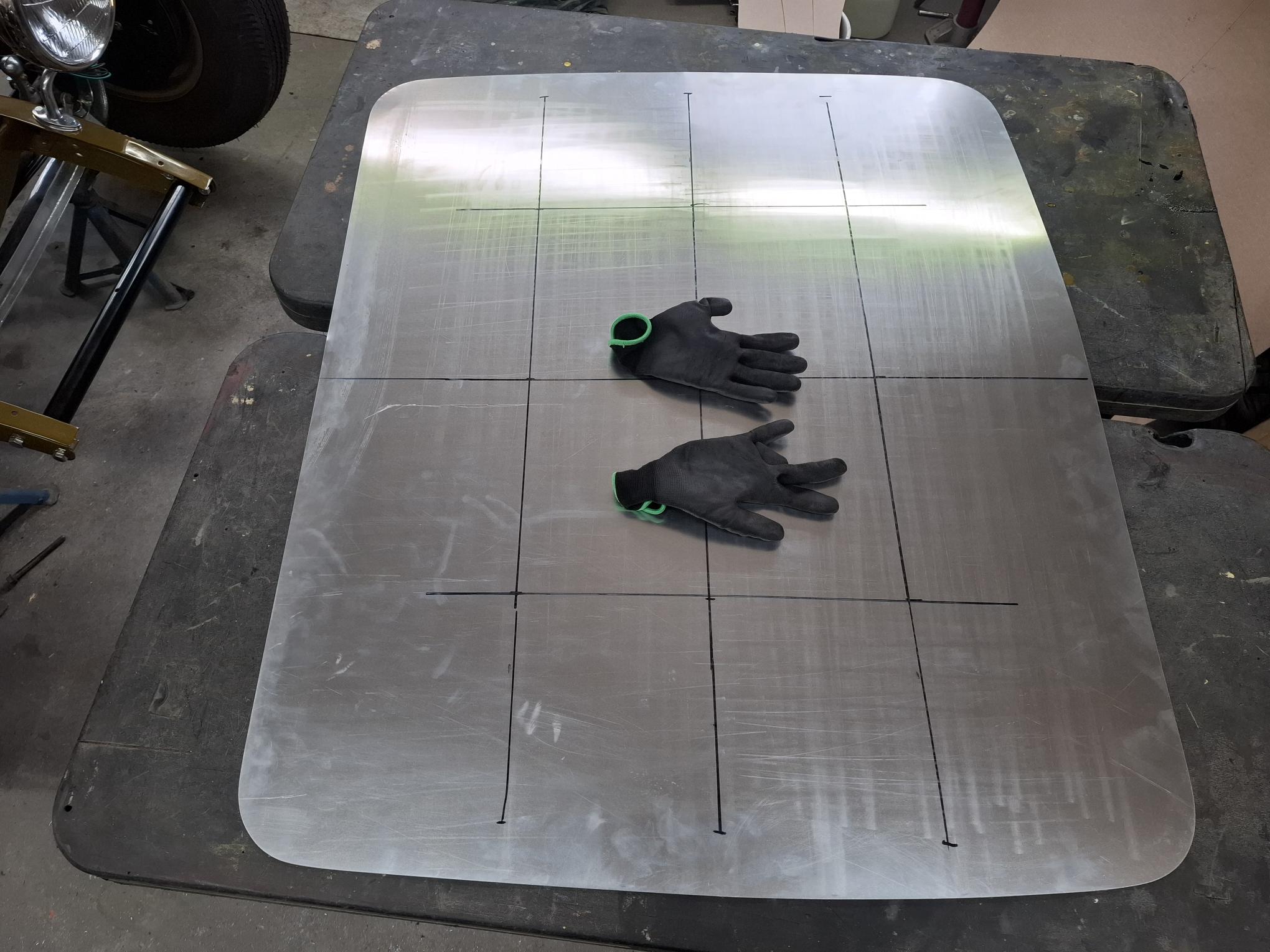

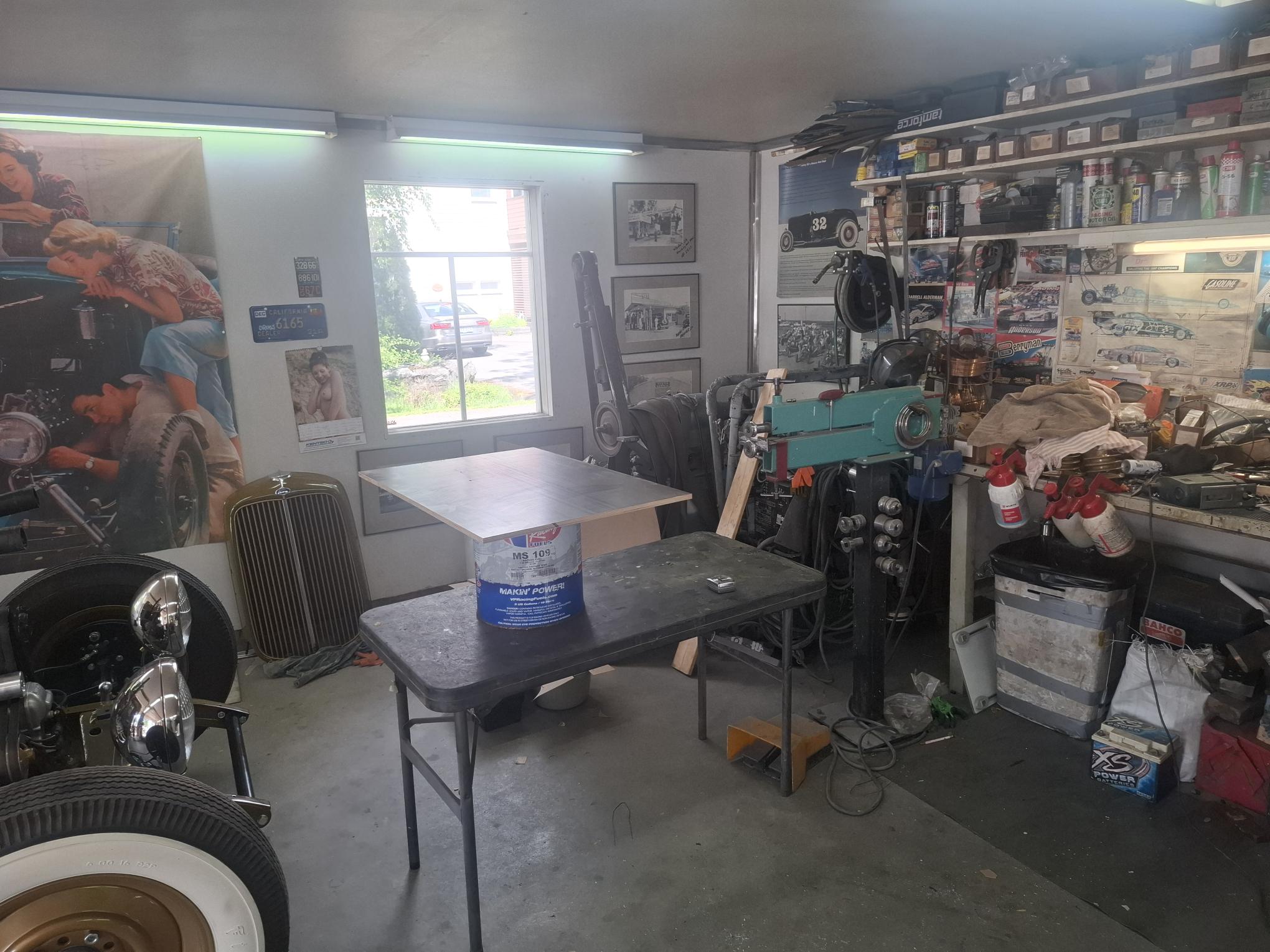

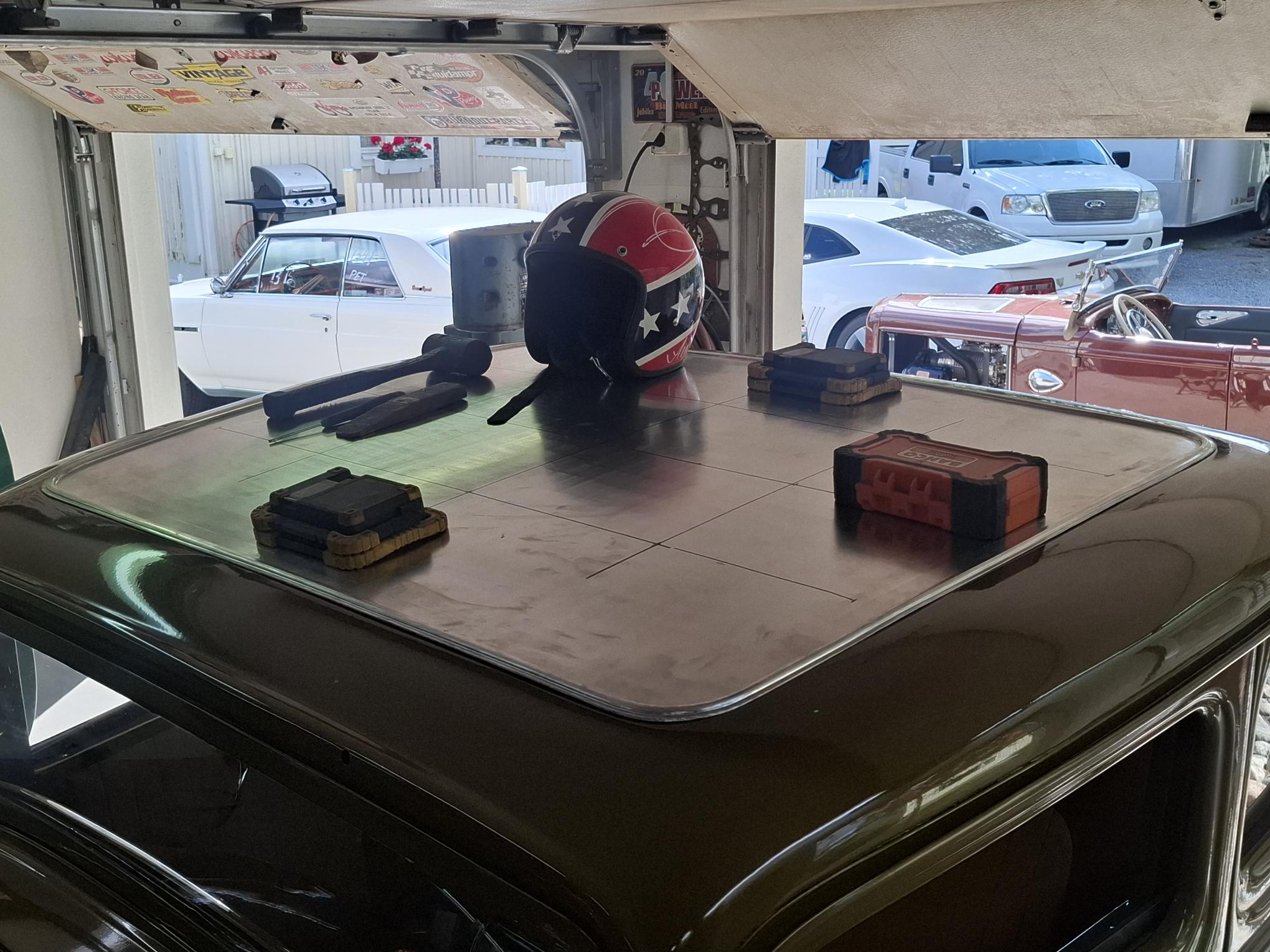

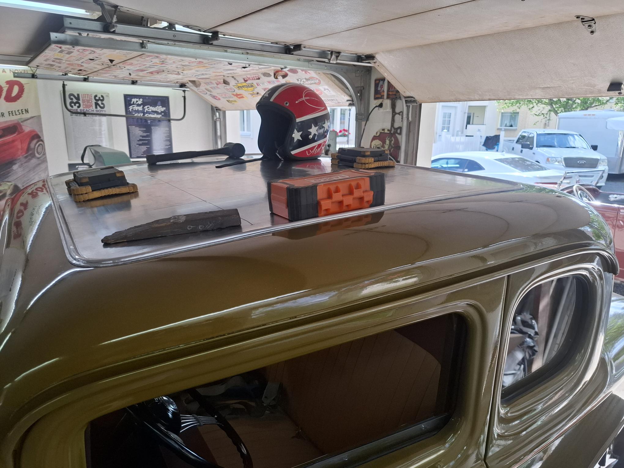

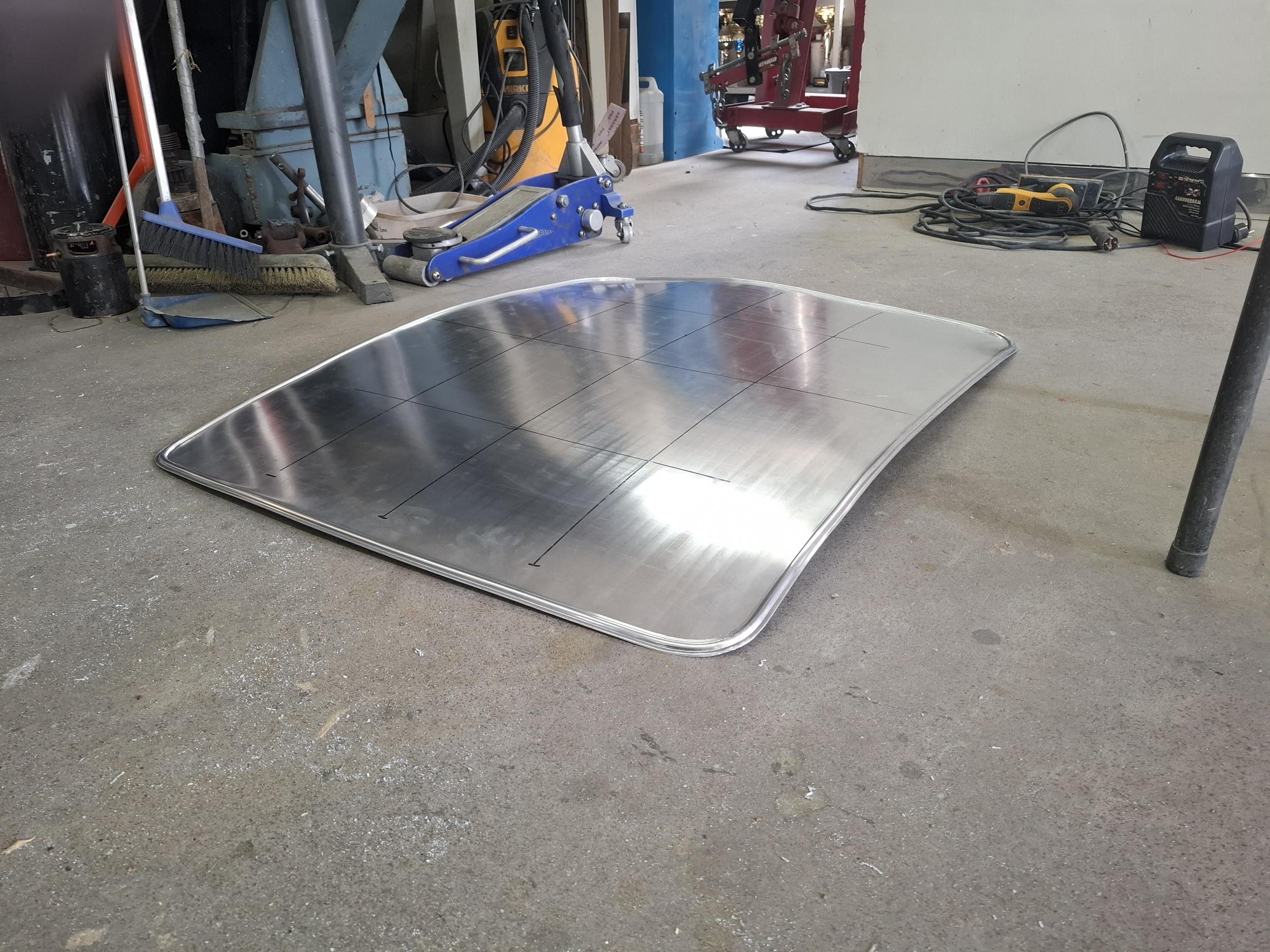

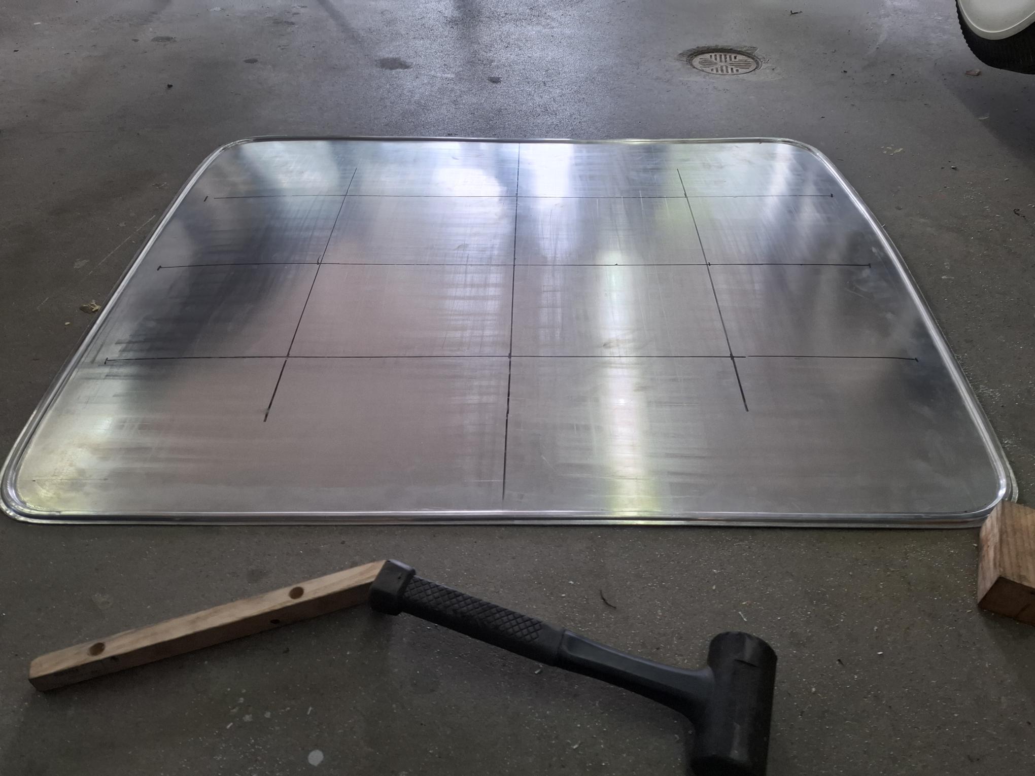

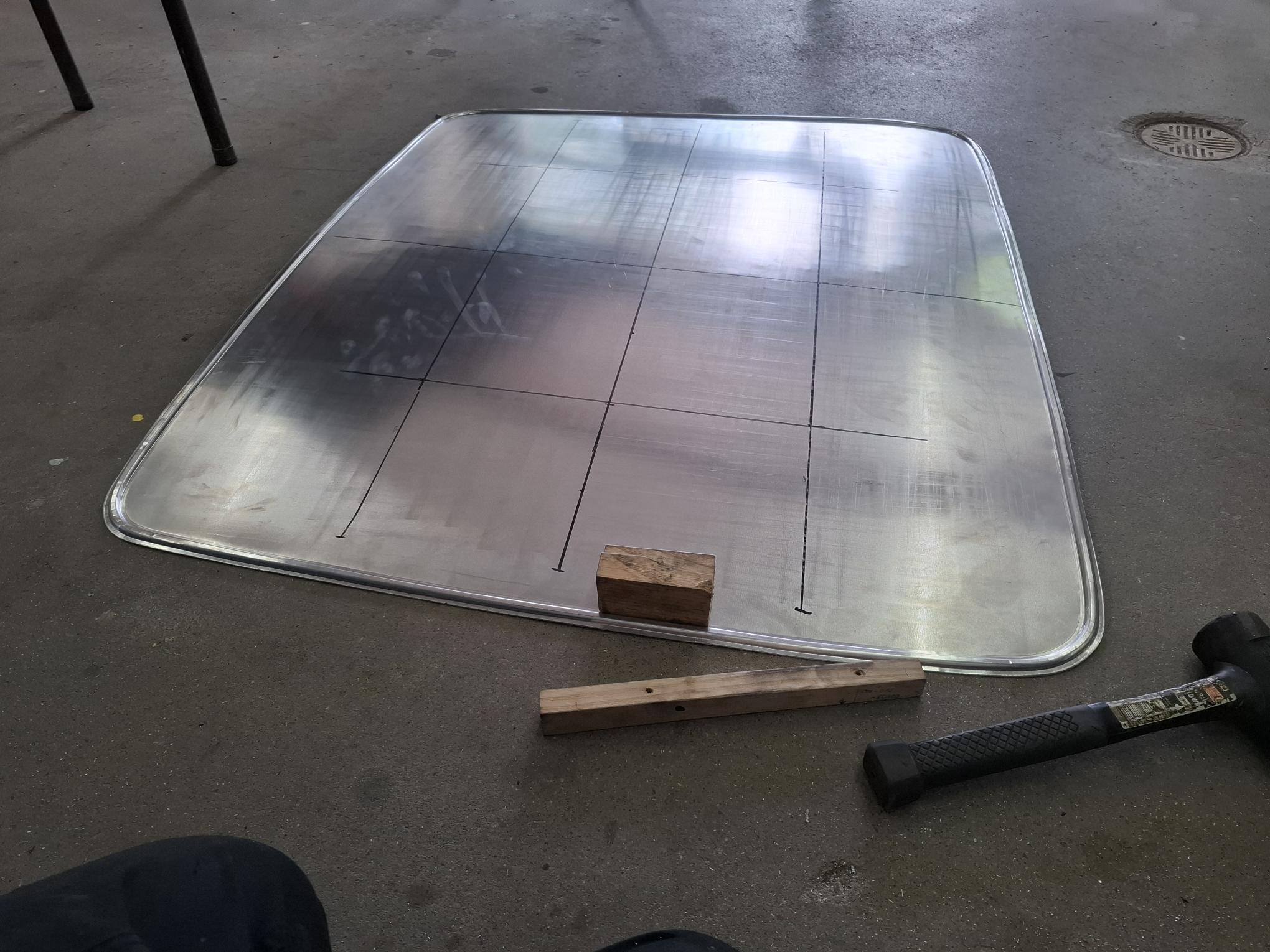

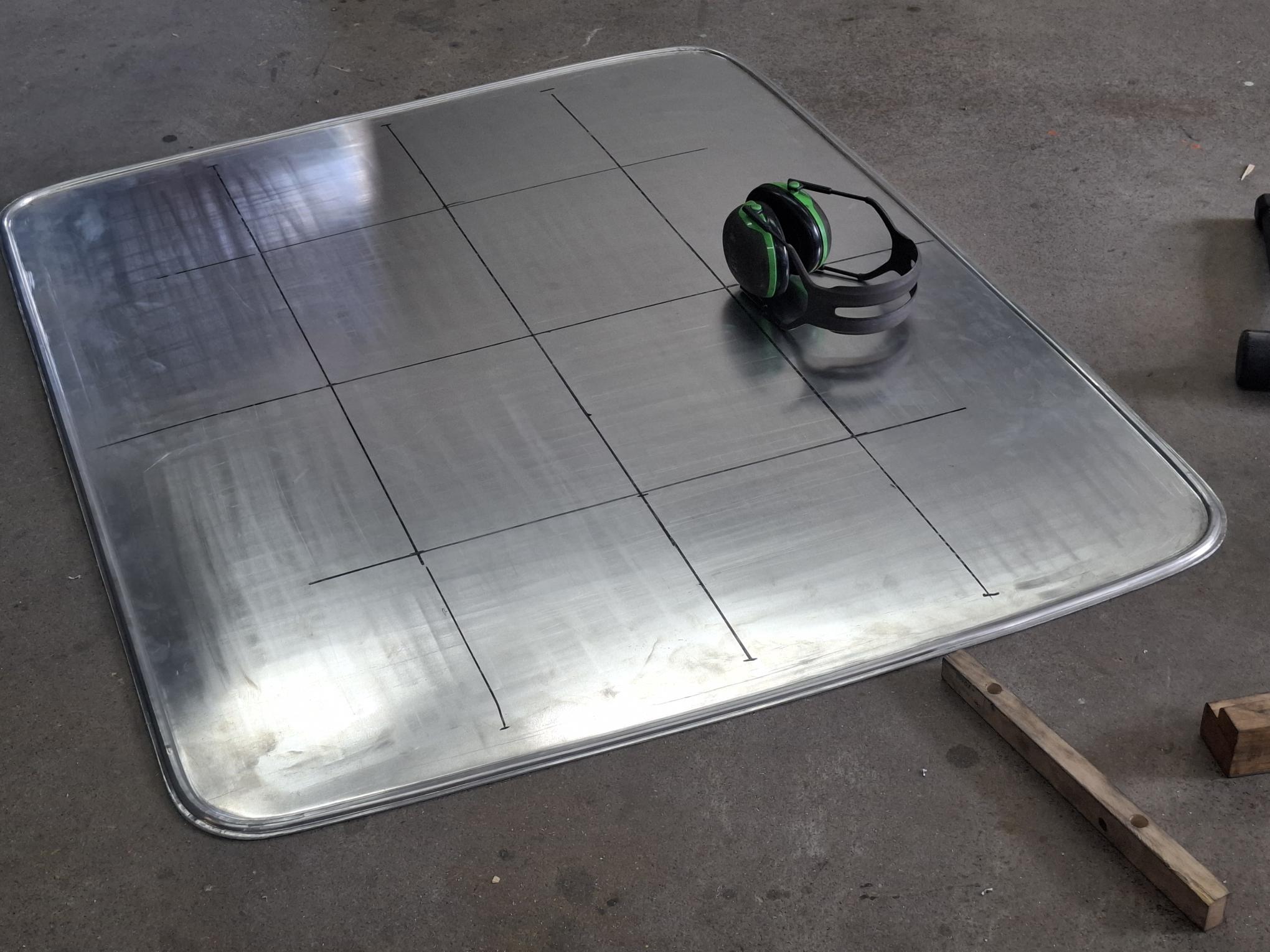

    Oskar is not come back today, so I decided built nice "holder" when made bead using 3 different tools in my beadroller machine. After that many times hammering, while english wheel, hammer, ....... until now is as near as its wortwhile to continue.
    Twice my t-shirt was very wet.... Not so hard working, but need to be so tensed.
    Next I increase round seal to body or panel.
    After that need to drill and install old aircraft dzuz farterns, springs... I dont know how, but maybe its clear when just start to install all...
    Aulis

  30. patsurf
    Posts: 2,832
    patsurf
    oskar will ask --'dad -how did you do this by self?'--well done sir!!
