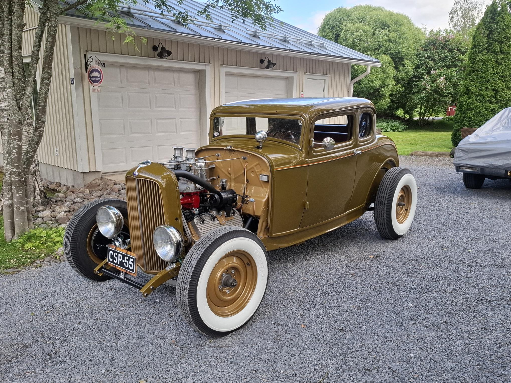

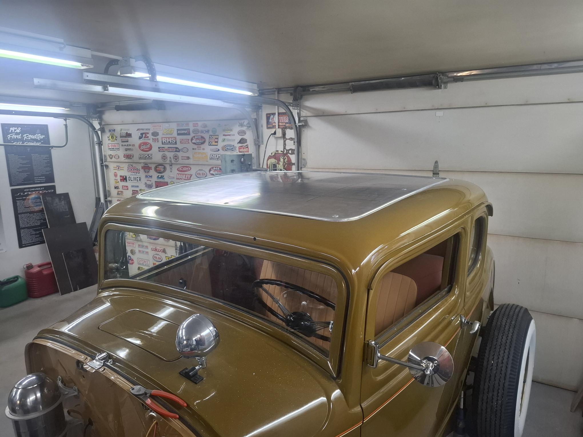

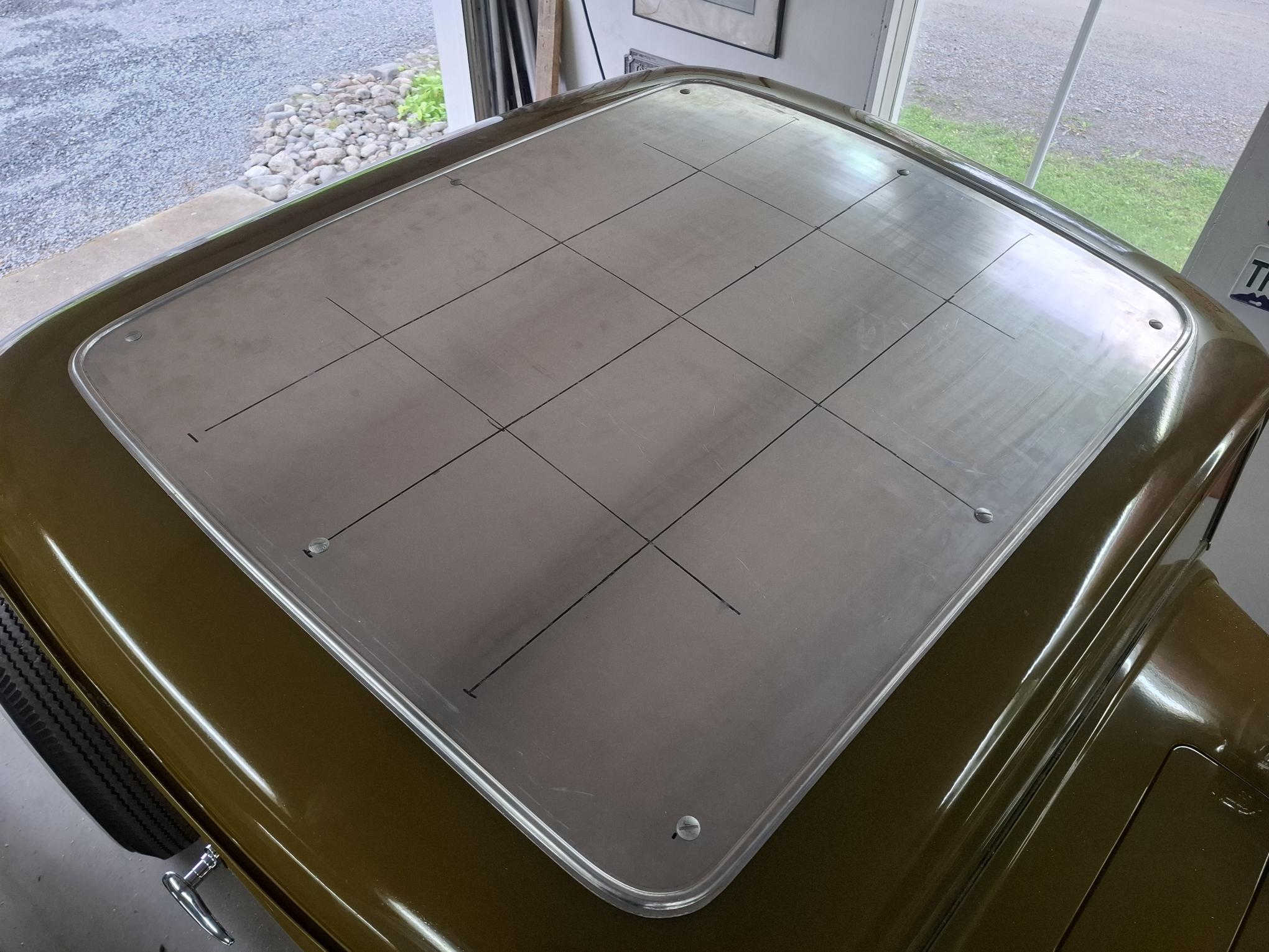

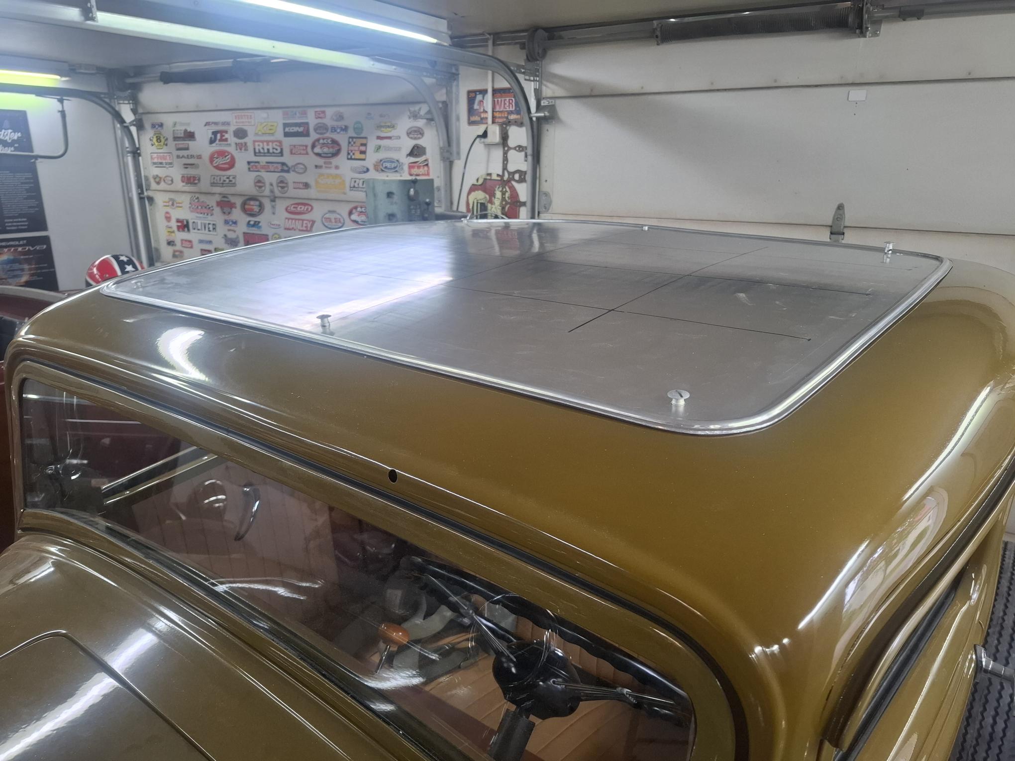

    Today 7hours without any breaks. Now Aircraft Dzuz are working fine. Still need to fix panel.
    I wait that Oskar son is come here. I need to roll panel (english wheel) over. Now You can see there when I have stop rolling halfway.... Fron edge need to hammer down....
    Im gonna paint panel semi-gloss black. Same 2K acryl (40% matting base included) than have painted brakes, steering parts, intake manifold.....
    Aulis

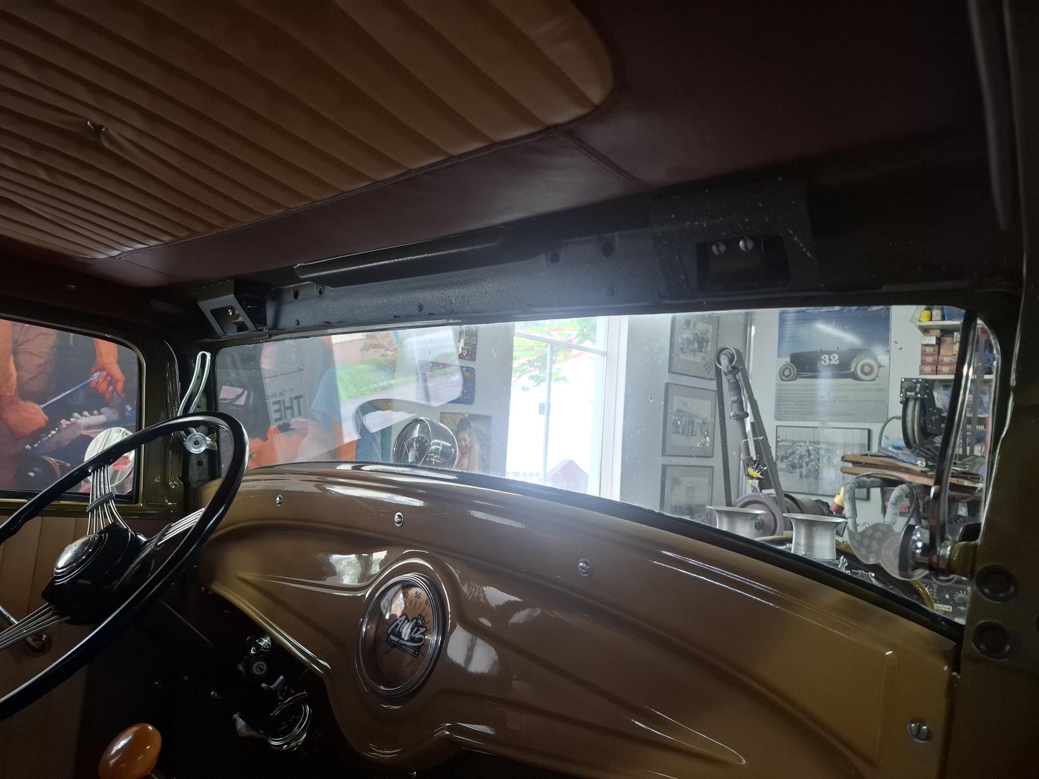

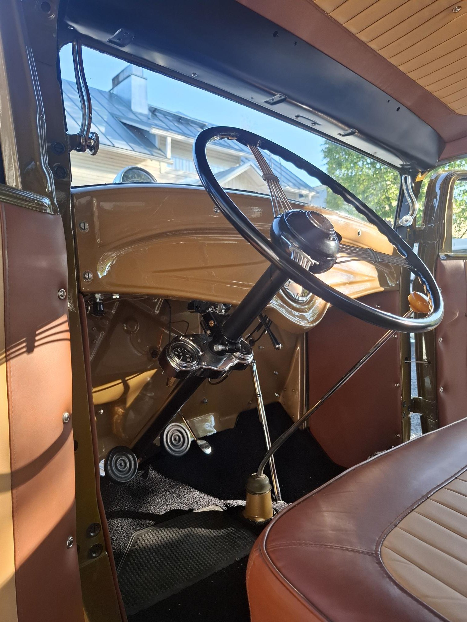

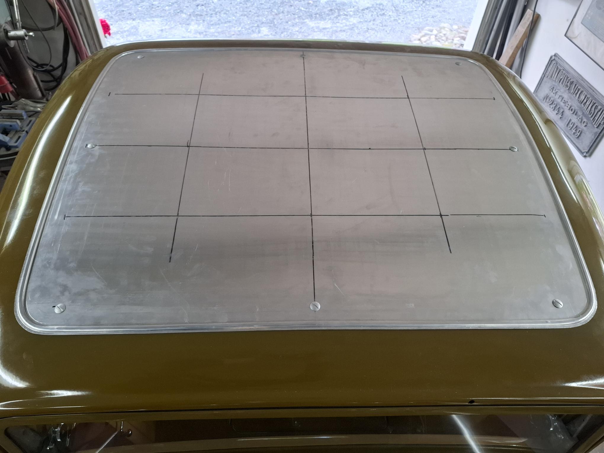

    Today started to make wirings. I use only cloth covered stuff.
    Oskar come afternoon. We roll top aluminum top panel few times. while fitted and continued rolling.
    Now enough good for me.

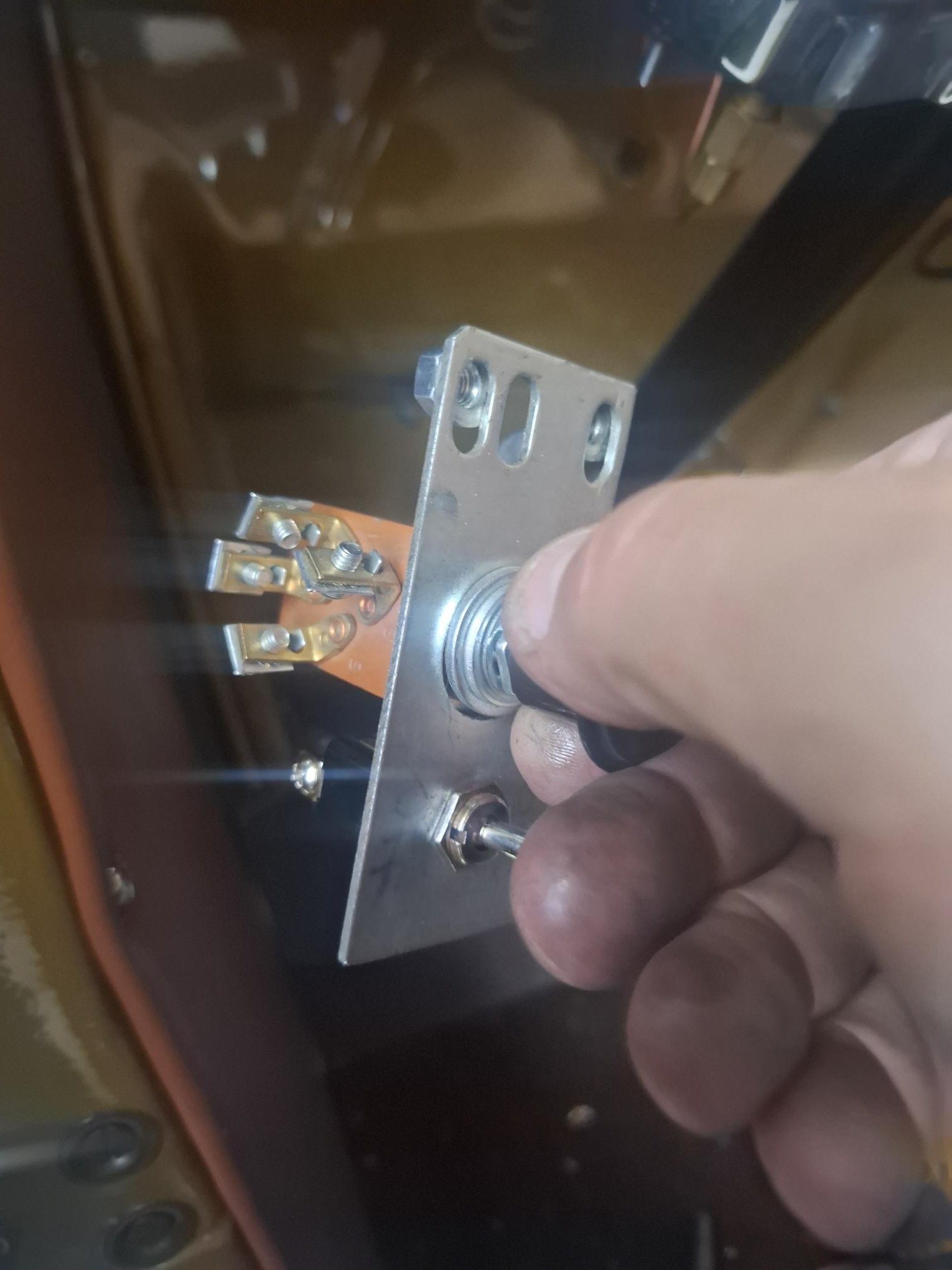

    I install only small switch panel under dash. One speedway switch (ignition, start...)and another UP switch for lights.
    Tomorrow arrive Stromberg distributor + 1.5ohm coil + sparkplug wirings

  7. hotrodA
    Joined: Sep 12, 2002
    Posts: 7,791
    hotrodA
    This is a nifty little switch mounting bracket. Did you punch the slotted holes and mount the flange nuts? Perfect for a *****in car.
  8. AULIZ
    Joined: Oct 28, 2005
    Posts: 1,793
    AULIZ
    that was ready panel. Maybe stuff which has come with Front engine dragsters years ago.
    Just glue nuts and washers there to easy installation.

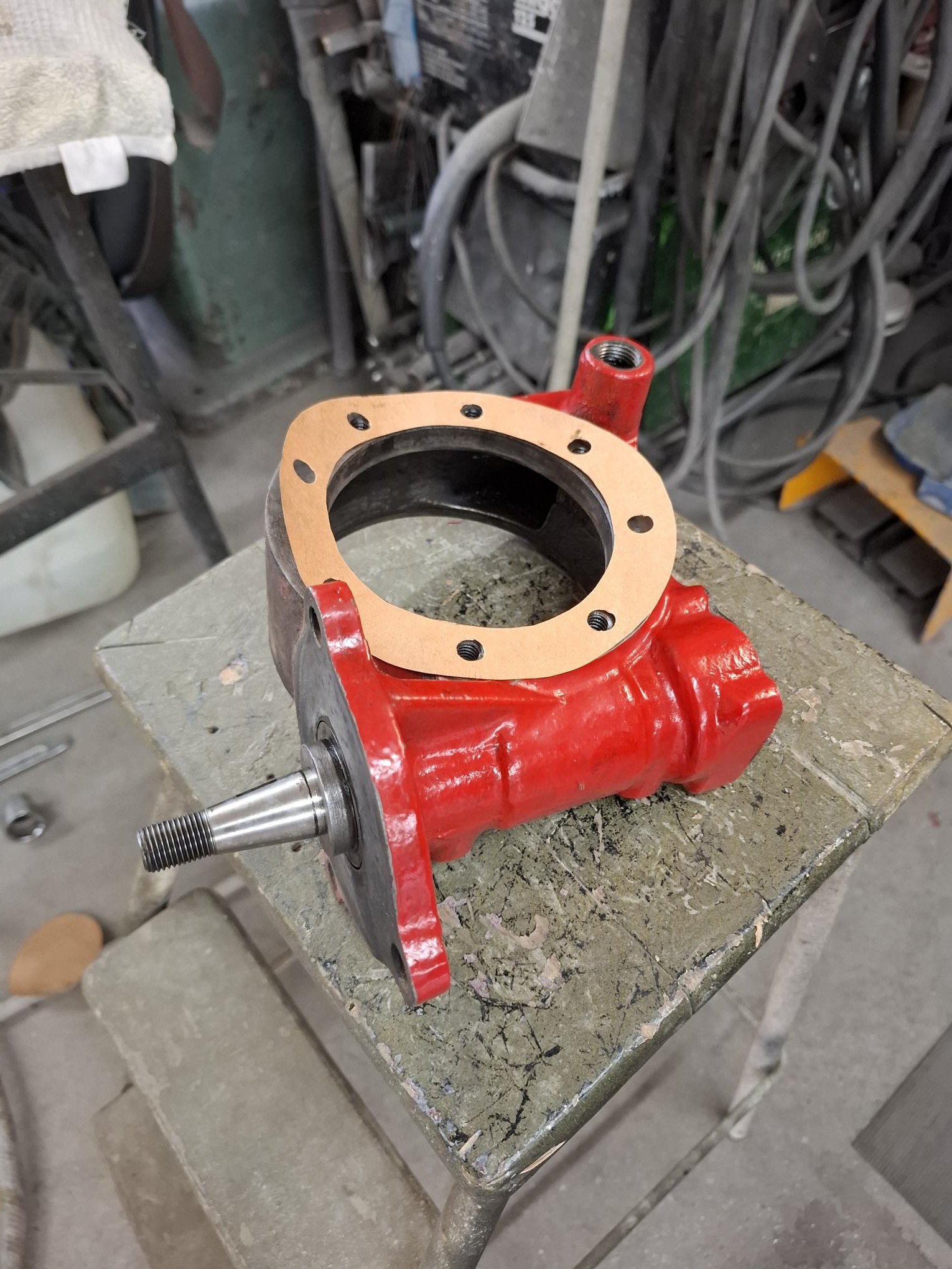

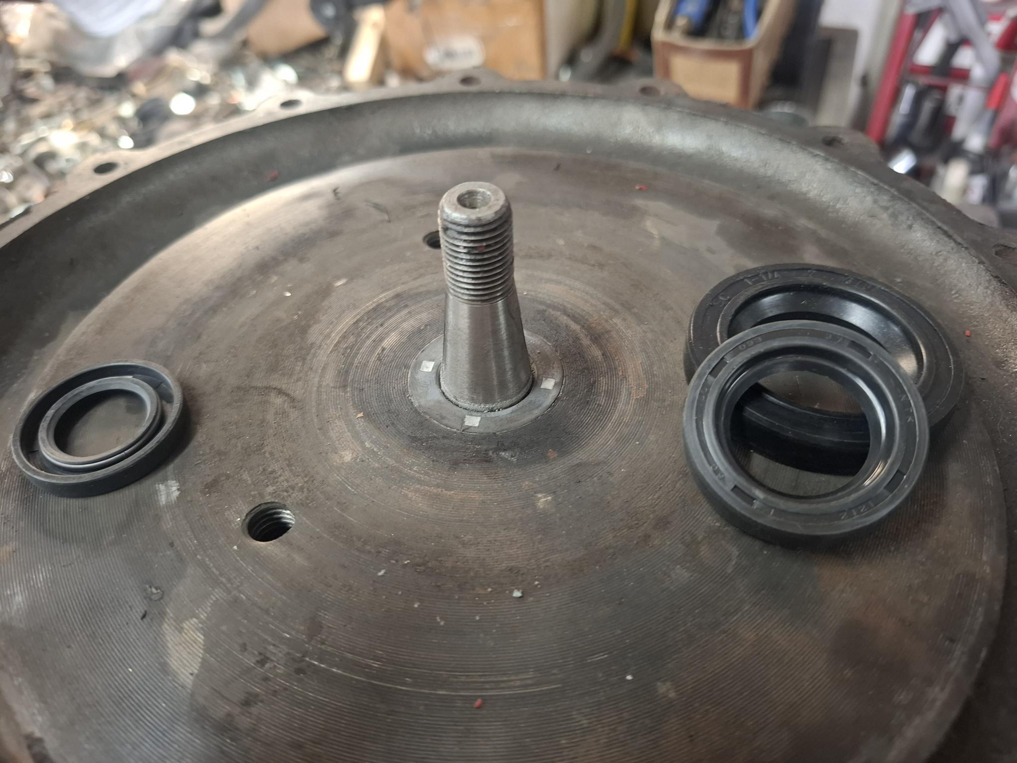

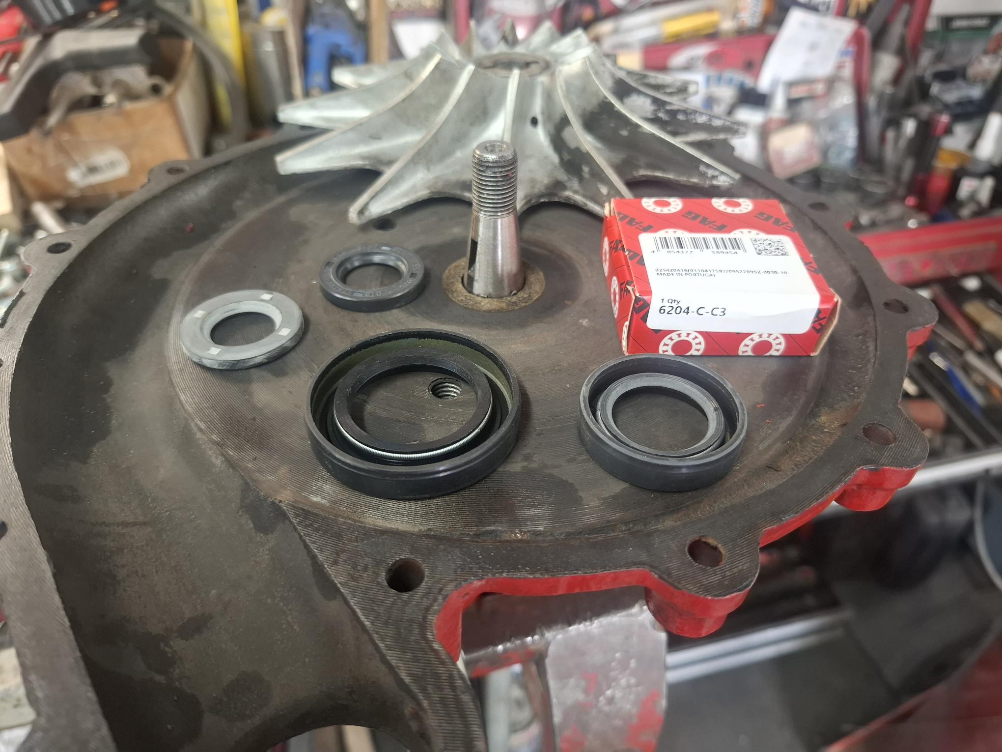

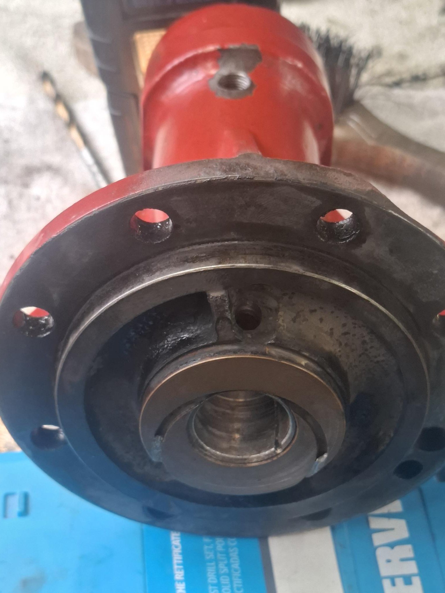

    Today continue put together 36M85 -McCulloch supercharger. I changed snout bearing, all 3 oilseal, made new gaskets using same thickness 0,2mm gasket paper..... I need to make also gasket between rotor and case. Looks that rotor try to touch up there. there was felt ring under supercharger rotor. I lathe real 1lip oil seal there. Now better. Front bearing in snout I used 2RS sealed version.
    Starter need to install and measure installation height, made one new wiring. Earlier I used original 6V starter which worked OK. Problem was that i hear voice when engine was running (solenoid+sprocket touch nearly all the time to flywheel. Maybe Alum. oilpan starter surface height is not same than original oilpans.
    Also note that I need to make new holes + threads to oilpan before can install new hi-torq small starter. Starter solenoid is touch now to header... I turn starter 20-25 dec to up.
    Aulis

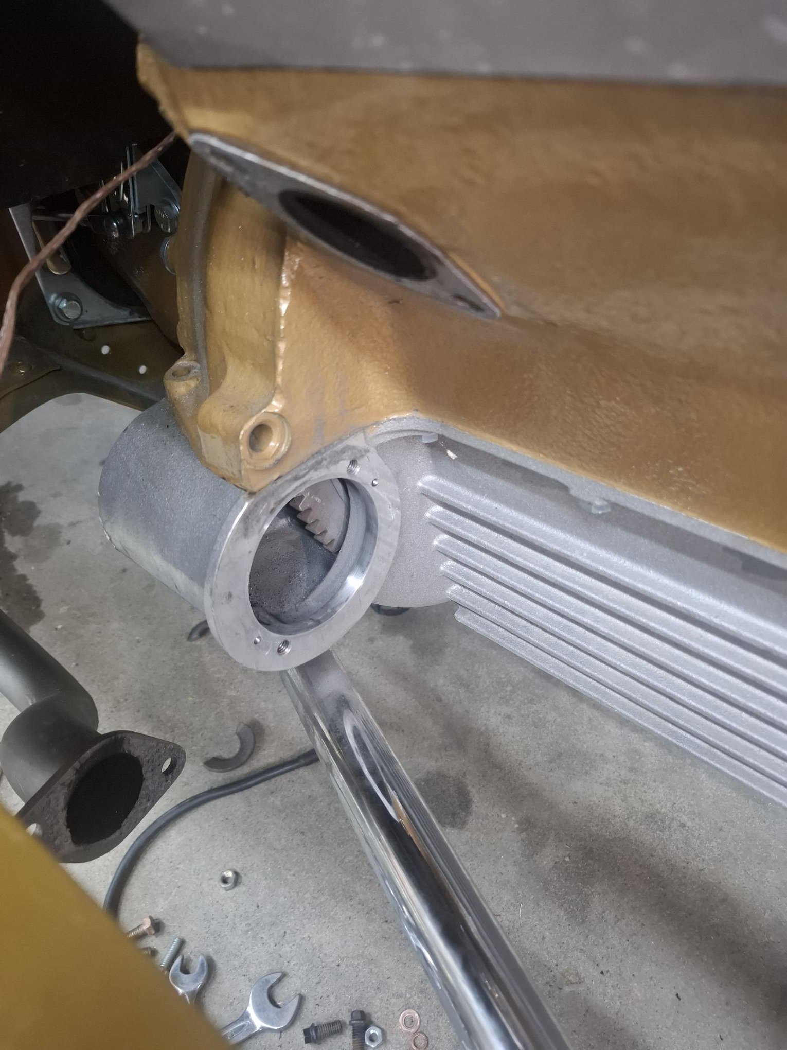

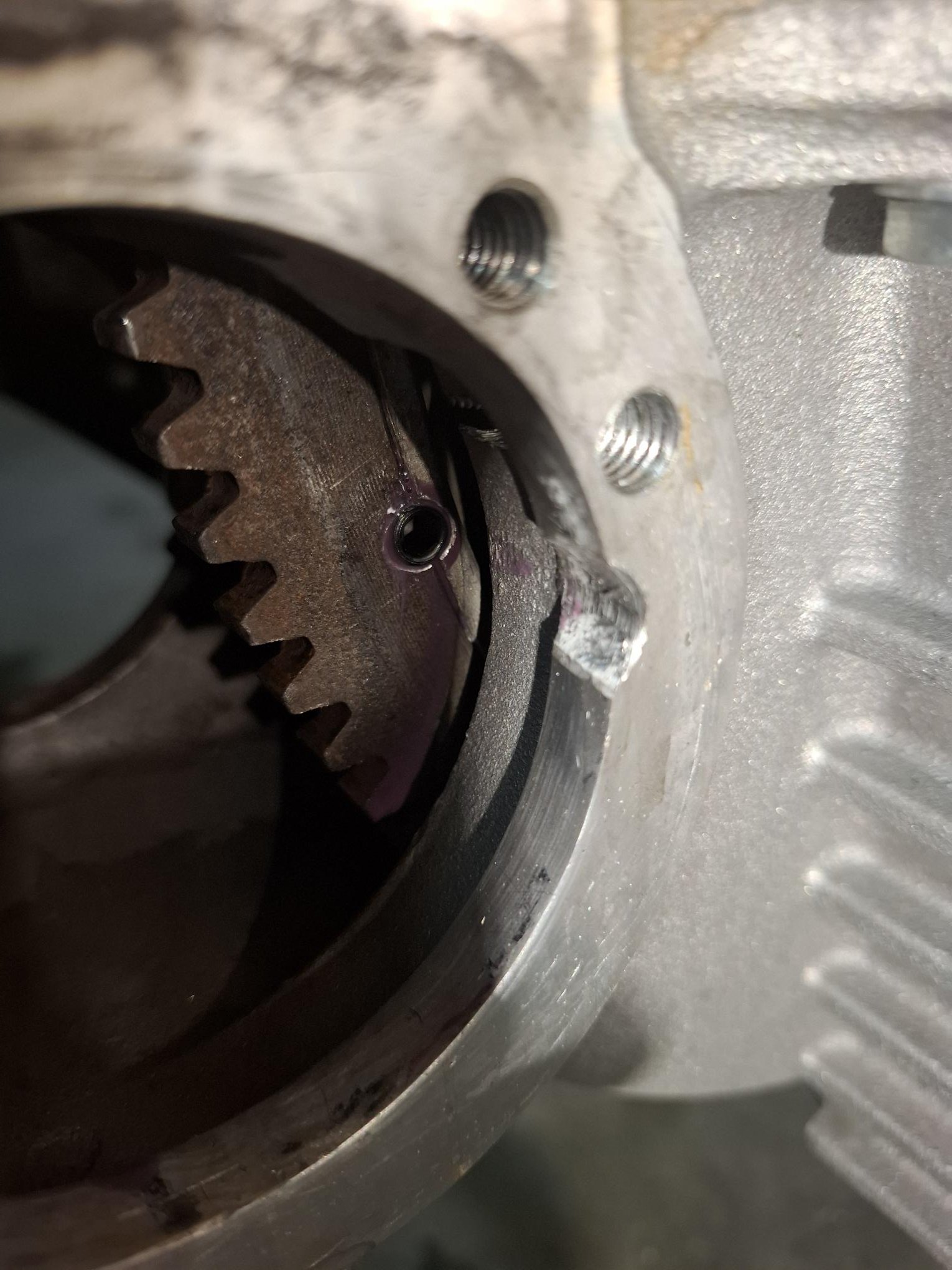

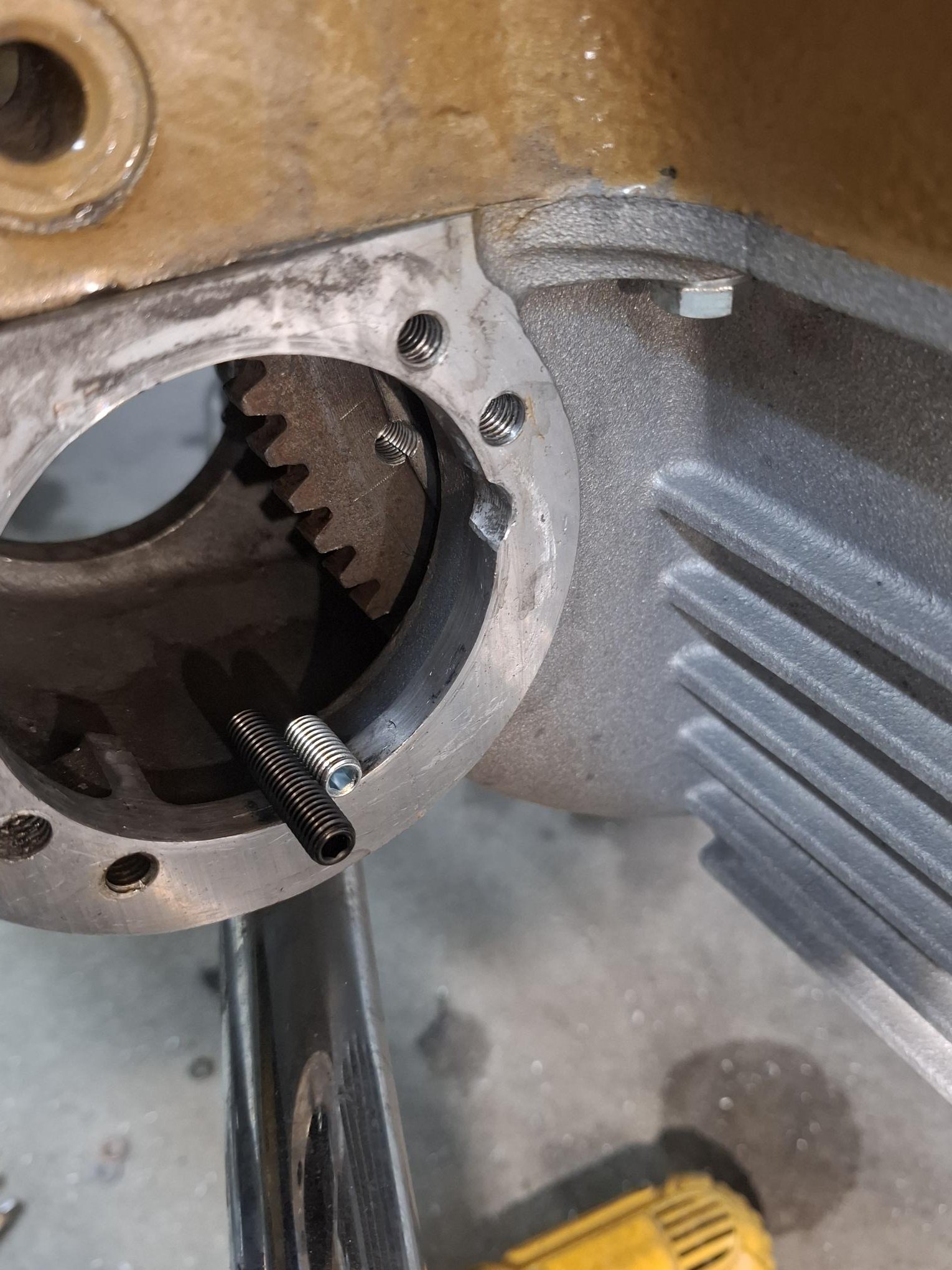

    McCuloch is now put together and installed on its place. Feels good, turns smoothly, no extra clearance...
    Also installed new hitorque starter. I drilled and thread new installation position, didnt want to modify header primaty tube.
    I try to start engine. Same bad sound from engine...... and didnt start.
    I removed starter, found problem. Flywheel gear ring is loosen..... Ou ****.
    I was think that my starter is broken...
    I was also think that supercharger is try to stack when engine was try to stop couple of times...
    problem was only this ring.
    Good that I opened supercharger and learned very much. same time changed seals, gaskets, bearing....
    Hitorque starter is OK investment.
    Tomorrow I try to find solution. Maybe try to drill and made stop screw locking system... Let´s see if I get rebuilt my Schiefer race flywheel without remove engine from hot rod.
    Aulis

    Yes Sirs,
    Now flywheel and ring are bolted together.... I worked few hours and solved problem.
    I drilled hole to "harder material side" so that when hole and thread (M8) is ready, its 2/3 in ring side and 1/3 in flywheel side. Flywheel has L-pocket where ring is sitting. I drilled and threaded thru flywheel and used those 25mm (1") long stop screws.
    sounds good, better. Feels good. Tomorrow I drive longer. My son and his sisters son can follow me driven with my GS Buick.
    Aulis

    now THAT is being a machinist--working thru that little hole!-nice job!!

    Nice solution to a difficult to diagnose and fix!

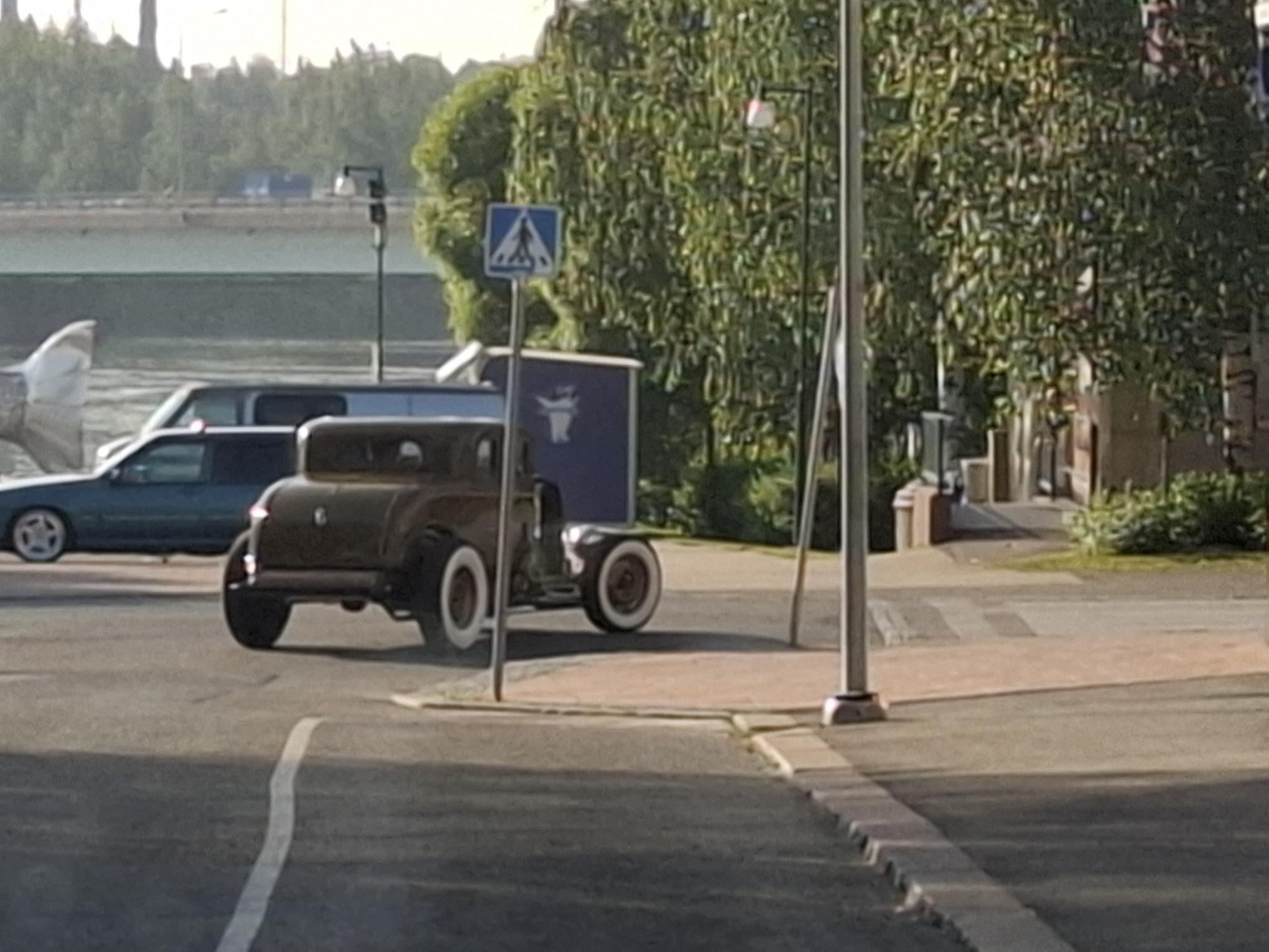

    Last Saturday here in Kauhava Airfield where they race Finnish Championship serie in Drag Racing. My friend 1300cc 1000% homemade 4cylinder nitro TopFuelBike. Twice 5sec in 1/4 mile even in 1000feet belt broken... He is not use gearbox. Small engine, 4kpa boost and +90% nitro.... Top speed is not good due to belt broken. Normally takes 375km/h top speed. But his first 5 sec races.
    I sponsor him.
    And Im coming back home behind my GS Buick. Rope between GS and Hot Rod....

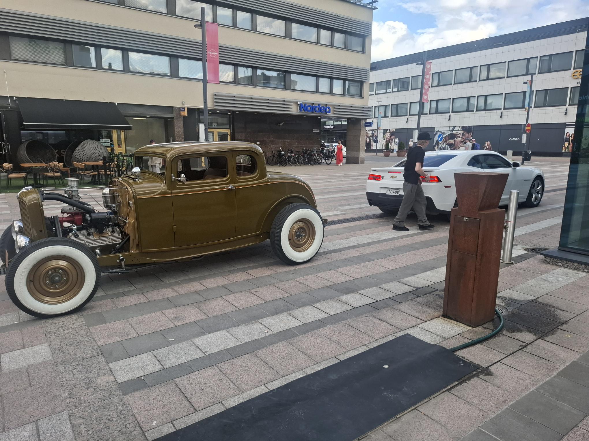

    Yesterday I made some "test'n'tune". Drove 100km (60miles)
    Engine sounds OK, very very much low RPM torque. I like this "Aulis Special" cam which has been grinded for me in Holman&Moody.
    Engines are so different. My Roadster engine I was dyno (nearly 300hp) years ago when engine was ready. That engine has good torque too, but torque curve is higher.
    That engine cam is Potvin 400+,...
    Starter+flywheel works OK.
    Oil pressure is low, but can drive. Cold engine 30psi, warm engine 10-14psi. Not happy about that, but if crank grinder has made "little extra" clearance... works like this. Interested in to see all when open engine next winter.
    supercharger sounds OK, no extra noice...
    Still blue smoke when more RPM. .... Maybe seller was give me wrong oil rings. Cylinder pressure is OK (+100) and I measured piston ring cap clearanse which was OK (under 0,5mm). I guess, broken ring or wrong oil rings.
    I see problem when I piece engine after summer.
    Yesterday I fixed drv side exhaust, it was "knocking" all the time. Also fixed steering angle. I like this maybe 80-100y old angle tool.
    Today I start to make wirings (lights, generator, regulator....) and need to make front header panel (upside of windshield), buy and install wiper (stainless steel 12V boatmodel) in swedish Biltema is something like 30euro..
    Aulis

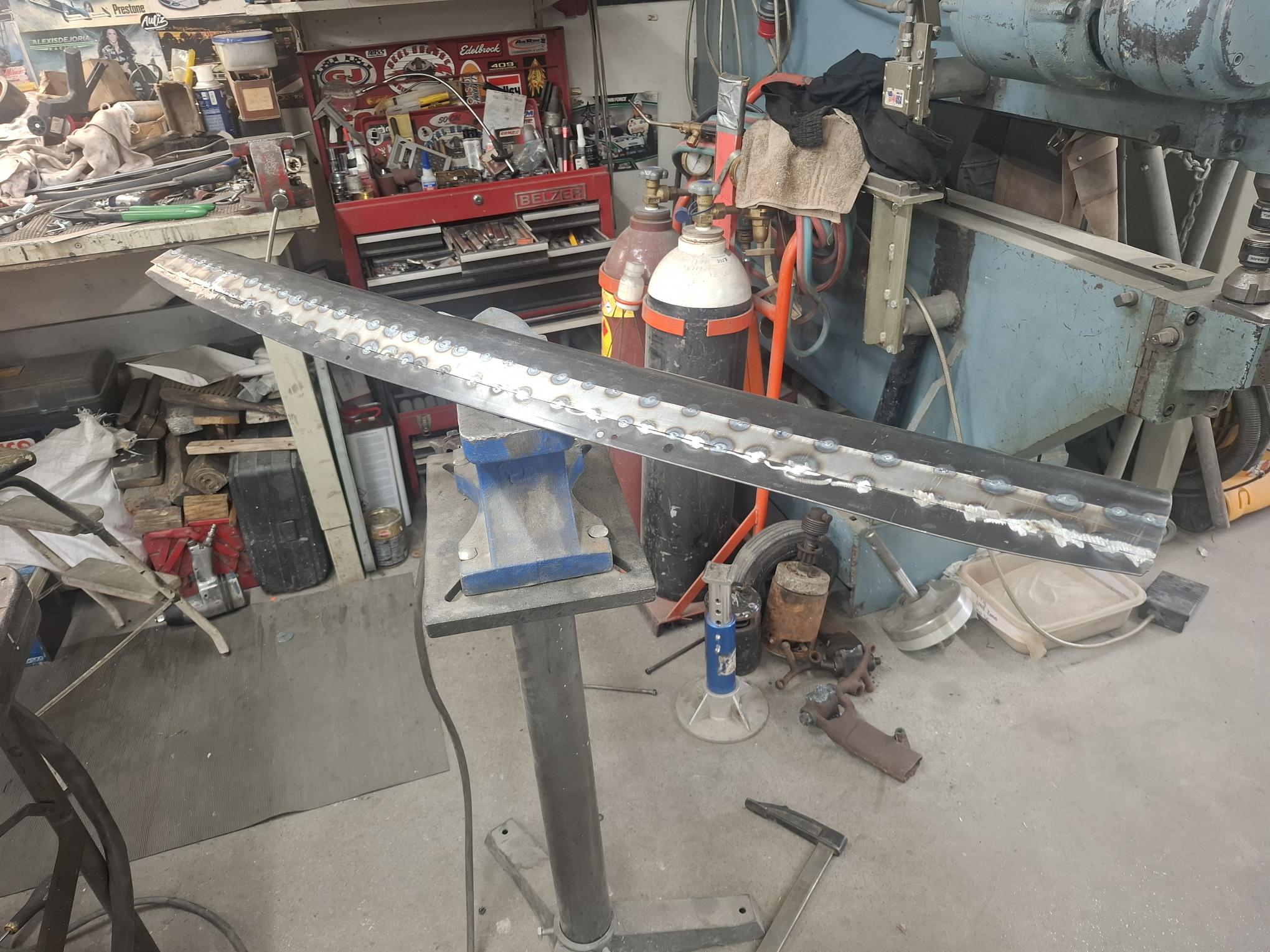

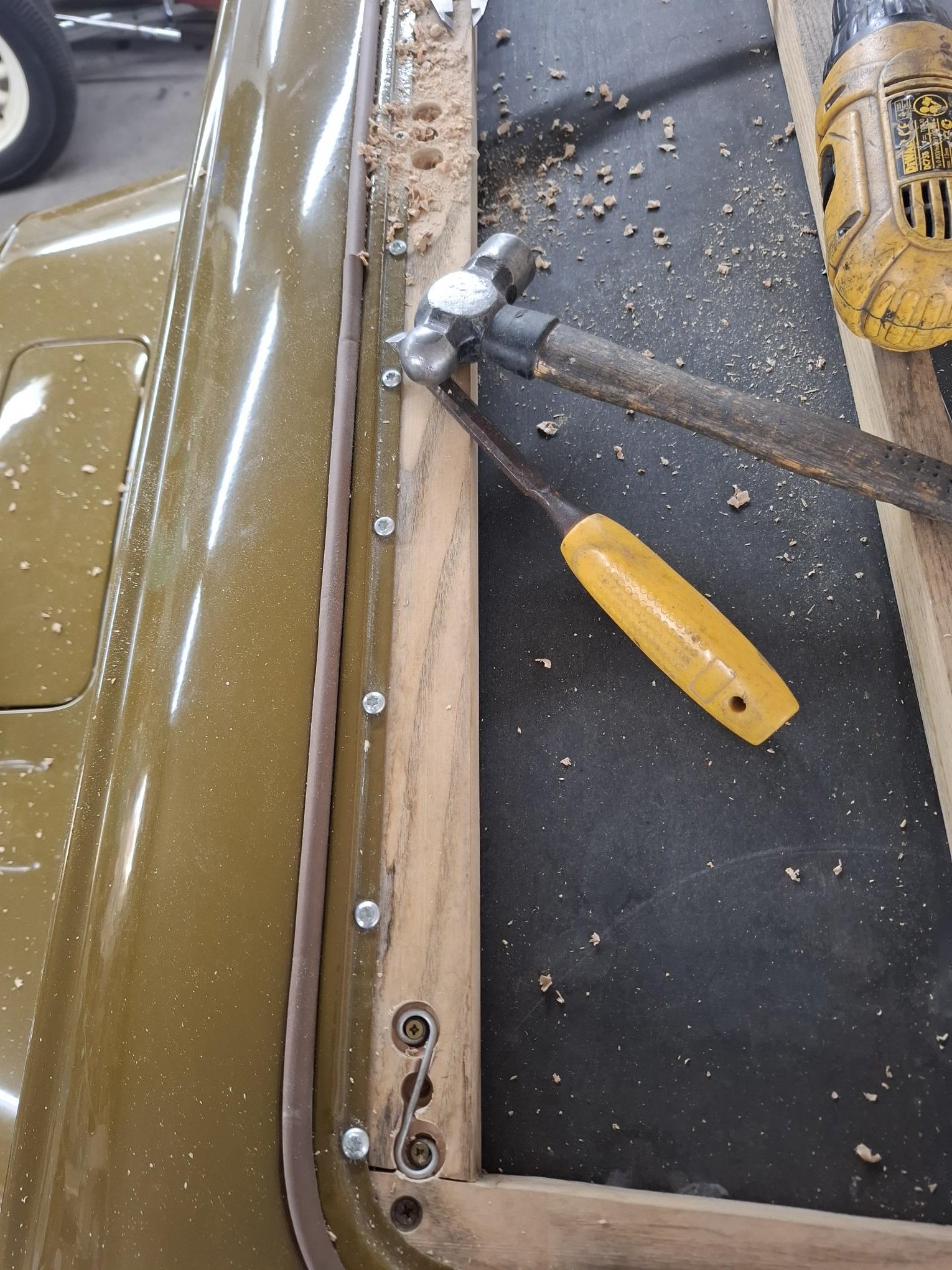

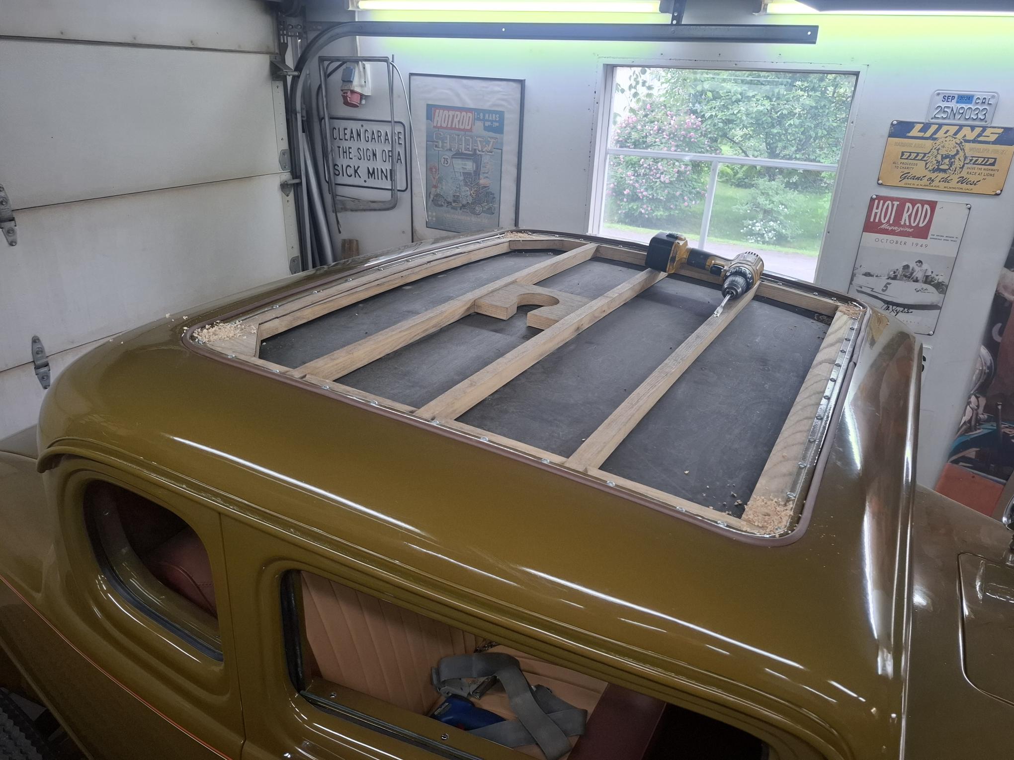

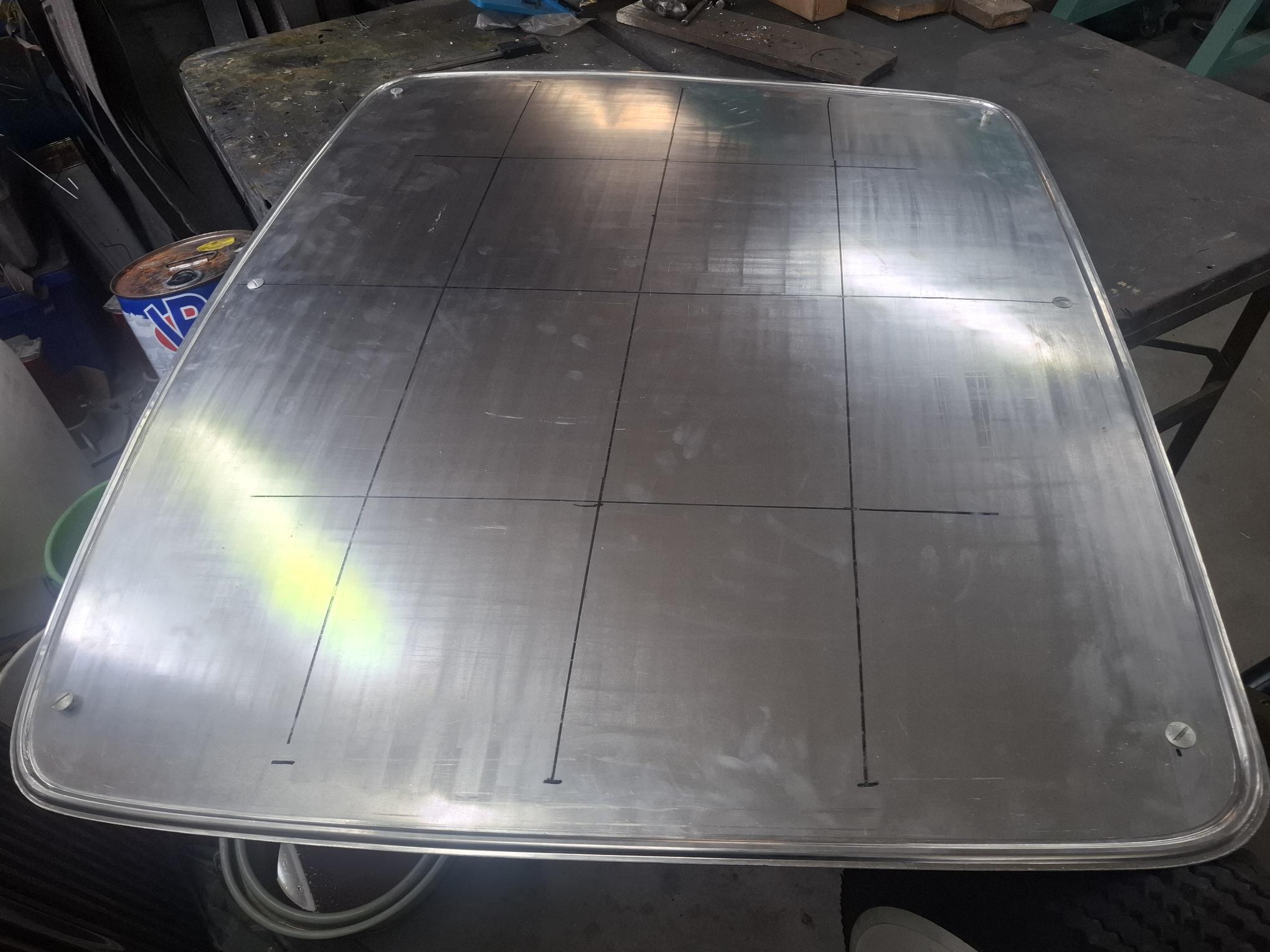

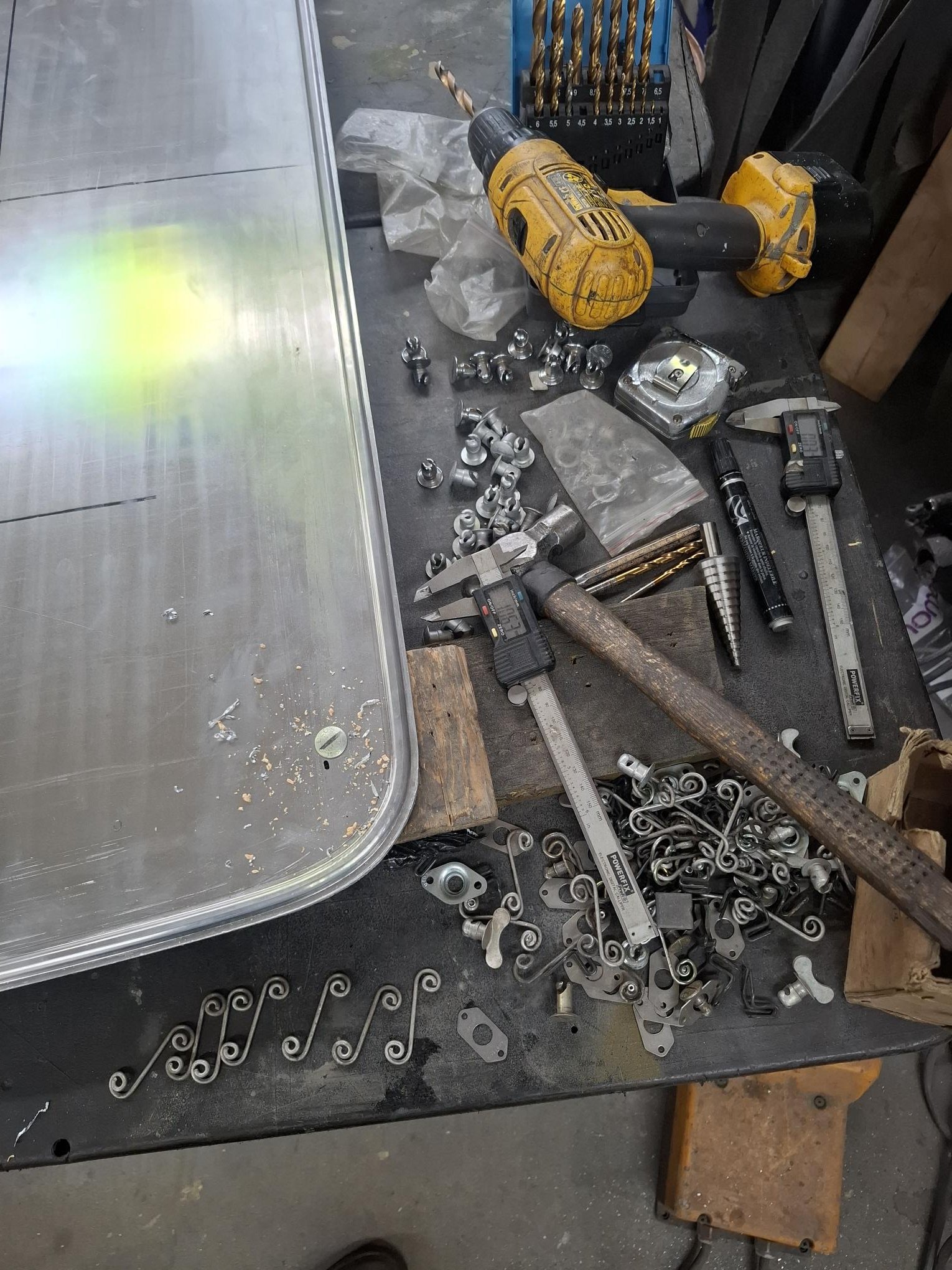

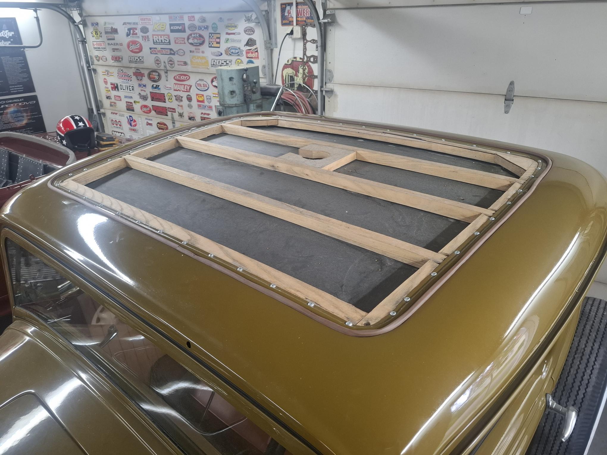

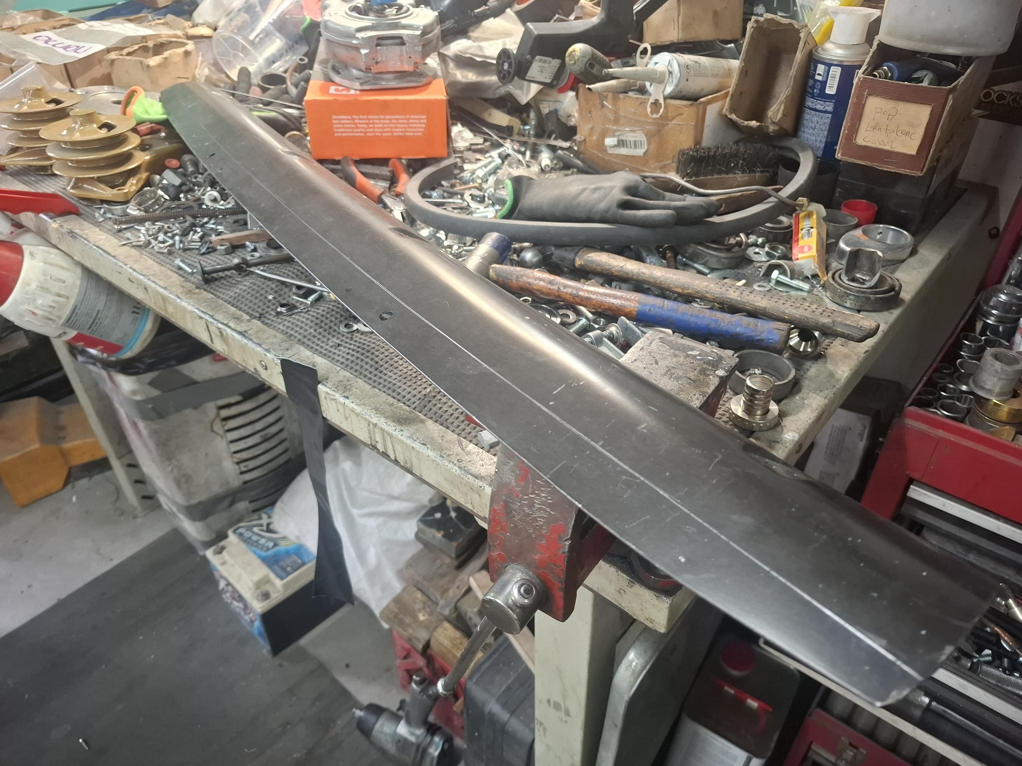

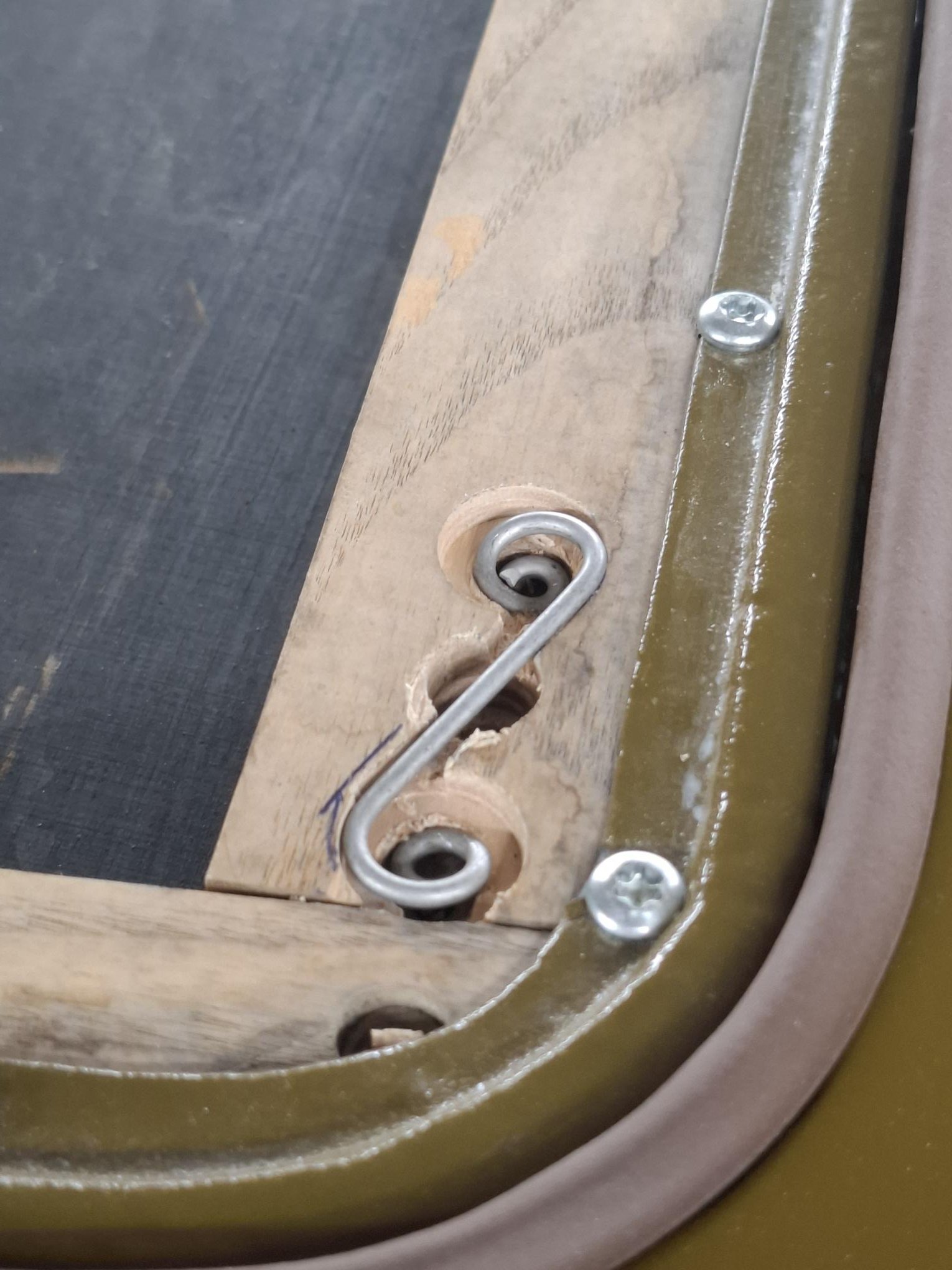

    Today Started make header panel. First installed wood there and modified new UP panel. Wood has been in my garage from Year 2006 when I built my grey 5w coupe with 409cid. Pullmax with shrinking dies is best when need to make this kind of 30mm width curved sheetmetal. 10min and part is ready.
    Im not sure what ring and pinion I installed 6y ago when started this project. Car was so many years pushed away,... Feels that 3rd gear is so long.... maybe I have bought 3.25:1 R&P and installed it same time when I changed rear axle wheel bearings/spring brackets from side to another.
    Aulis

    Have a question
    By tapping with threads
    Does it keep Ring gear from walking
    Forward's & back ward's on Fly wheel
    & slip / spinning.
    Is that why you drilled & tap
    Instead of pinning ,
    Or by tapping was a better option
    The threaded stud To keep from coming out with thread locker .
    Pin would of just been pressed in .

    I ring gear was not stack (it was turn on flywheel), so I decided to fix it without lift engine off. pre 48 flathead its so big job to remove flywheel. You need to remove oilpan before can get flywheel on table.
    Yes, when flywheel is on table, easy to drill straight holes using bigger milling or drilling machine.
    Then You can just press or hit taps. When make holes using bigger machine, You can drill middle of two different material (smooth and hard), Now when I did it by hand, I need to drill all the time in hard material side. Just need 20-30% of hole/thread in aluminum is enough to lock ring there.
    Now when I drill using hand drilling dewalt, hole is never round and never straight.
    Its easier to drill thru and make 8mm thread. Then I can be sure gear ring and locking screws are stay there.
    Flywheel is Aluminum and gear ring is on "L -angle corner". I dont know how to say it english.

    & slip / spinning.
    Pin would of just been pressed in .[/QUOTE]

    header and A-pillar post trims are ready. I made those very fast, not good but ok for this summer.
    Maybe I order new ones later this year and chop those.
    Aulis

    header panel, A-pillar panels ready and installed.
    Aulis
