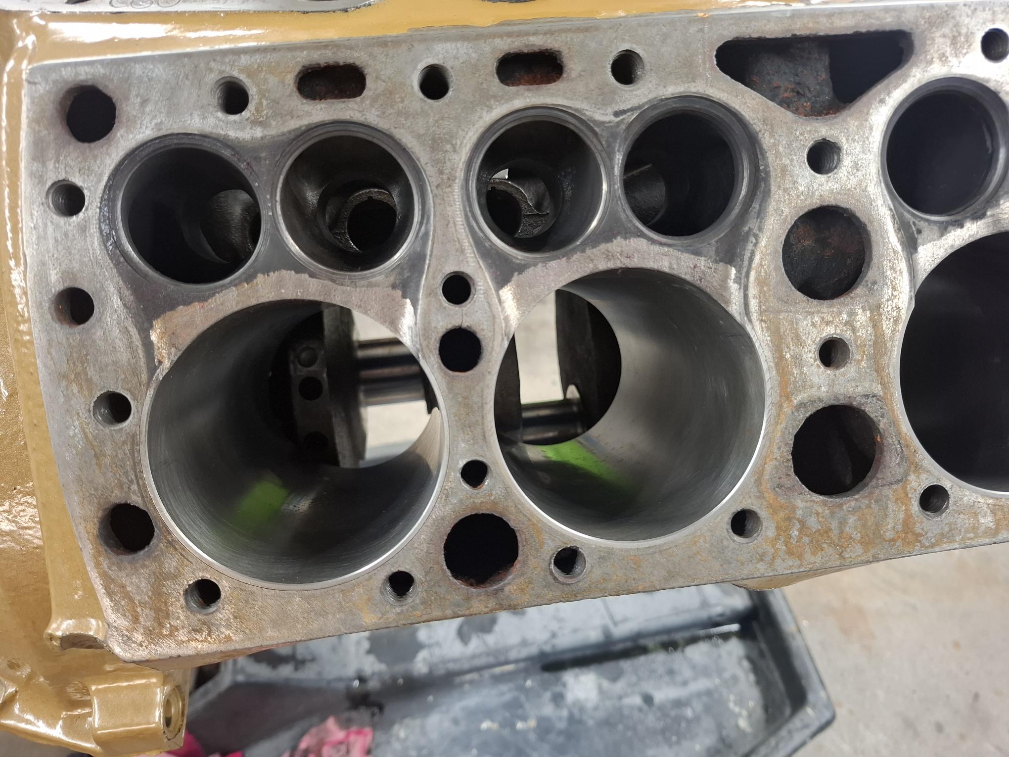

    Finally last week we bored all cylinders, pressed inliners and saturday bored and honed to right dimension.
    Now I have round 100% cylinders, clearance is 8/100mm.
    Tomorrow I cut inliner from that chamber area and start to wash parts.
    Crank is grinded too. Main journals are OK, I have done nothing. Rod journals are now 020 undersize. Clearance is max of that size.... (there is min and max where you can grind journals.
    New bearings arrive from rockauto.
    Aulis
    rod-coupe1551.jpg rod-coupe1554.jpg rod-coupe1555.jpg rod-coupe1556.jpg rod-coupe1557b.jpg

  3. AmishMike
    Joined: Mar 27, 2014
    Posts: 1,568
    AmishMike
    “ I cut inliner “ confused me. - I believe we would say “ deck the block “. Not a cylinder liner expert. Anybody?
    Stogy and Outback like this.
  4. Wanderlust
    Joined: Oct 27, 2019
    Posts: 1,265
    Wanderlust
    You can see where the liner has to be trimmed down in the valve pocket, forth pic up
    Stogy likes this.

  6. AULIZ
    Joined: Oct 28, 2005
    Posts: 1,793
    AULIZ
    Yes, my english is not so good. pictures are tell all.... Today I "open" block chambers as You can see inliner/sleeve need to shape.
    Next I need to install two inliner/sleeve. Im built one extra flathead during next winter. I have new **** 304cid stroke kit, and other extra parts on stock.
    Ferguson FE-35 tractor inliners are good size for these big bore flatheads. Now I keep two of those (30euro, 35usd ea) on stock and have also smaller inliners for smaller piston flatheads.
    This week need to get engine ready. We still have warm good weather here, so need to get few hundred kilometers , I want to see that finally engine is ok
    Stogy, Chris L., nunattax and 5 others like this.

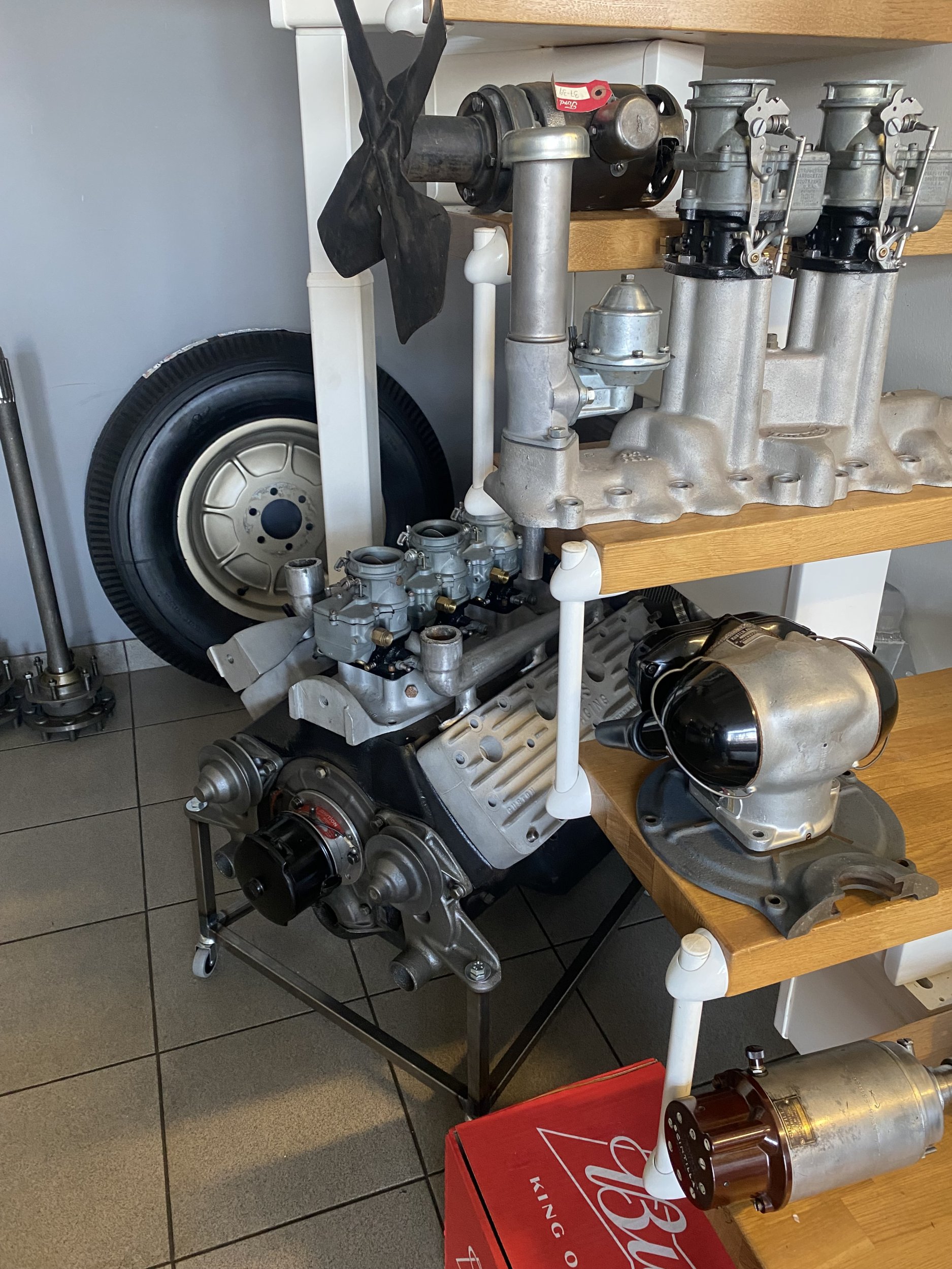

  21. 3w Hank
    Joined: Jan 29, 2022
    Posts: 1,099
    3w Hank
    From Sweden, I has also a 5W and following your thread.
    Your block look great, is it a Merc 40/41 ?
    Portings is really nice and the 1.6” valves is cool.
    I has a equal 41 block that was pro ported in LA back then but still has the 1.5” valves.
    It was sonic tested good but leaked in 1 cylinder and was repair by weld in a crack from exhaust to cylinder ( not fun ) but I needed get that block…
    On the waterpumps, I bought my ( Ford logo ) from a guy in Florida, he rebuilds them with better impellers.
    -I has his contacts.

  27. AULIZ
    Posts: 1,793
    AULIZ
    sorry my english is not so good. Im not professor or technical doctor.... just basic car builder.
    I wrote shortly, to correct misunderstandings.
    This engine:
    - too big runners
    - big torque cam (big lobe, not too much decrees, lift .375...)
    - intake orig 1932-36 small runners, small two carb holes for one orig. 2bbl.
    - very high vacuum when engine running idle (0,5kpa)
    - when more rpm vacuum is going higher up to 0,9 - 1,0 kpa) , normally when there is no "bottle necks intake side" vacuum is going smaller.
    -when so high vacuum IN. side -> engine **** oil where it get it. Lifter valley (inside and outside of valve quide) and little thru piston rings too. Now less, after I have new all around right dimension cylinder inliners there.
    -Bottle necks ( intake manifold runners, only one 2bbl hole between supercharger and intake manifold)...
    -One thing more: Original 1932 - 36 engine has bigger 1row crank pulley. I have smaller 3.5" pulley after I have lathe it small. Reason why done like that: Harman Collins magneto is not fit there if big pulley and if want to adjust magneto (turn LH or RH) need to get little more extra space there. If have original big pulley or this small, I have lost 30-35% cir***ference !!! that decrees very much Supercharger net RPM !
    This engine still smokes (now smoking is dark, grey, maybe little blue) because I have still orig. small intake, 1 x 2bbl carb... carb is not work right when too much vacuum. 0,5 is OK, but carb is not make work when vacuum is very high. and my carbs are "china 97 copy" . Normally engine vacuum is going smaller when trottle is opened more.
    I have now Nr 46 jets there, small hole power valve and when drive on the road for example 40mph and push s**** more down, black smoke behind car --> carb is drop fuel, too much vacuum, too small runners (intake manifold runners are only 50% of cylinder block intake runners).
    This old race-engine needs more intake runner and carb surface area. 2 x 2bbl can be OK, maybe 3 x 2bbl is better.
    2 x Big 97 carb can be OK, but if other intake side surface area is "bottle neck" big carbs are not solve problem.
    This is new for me too, this engine has biggest In flow I have never had. Maybe more race style cam with higher lift, more decrees and smaller lobe would slow flow down in normal driving use, but I like what engine feels now.
    When have more intake surface area (bigger runners), plenium area, 2 x 2bbl carbs with own 2 x 2bbl holes direct to intake, I think engine is OK. Then Jets, powervalves can be changed, and I can tune up engine.
    Now even 2 x 46 jets, engine push out dark smoke when push more s****. Carburetor is now working wrong, maybe drops fuel in....
    Sunday morning. I take 5km walking around quiet city. 1st sunday we dont open coffee place. One week more and my 4years career with coffee place is over. Im so ****ing tired of it. OK, it gives money, but Im never been rich even work 24/7....so my Oskar son mother is continue next 1st of April with that coffee place. I built cars, little racing, homeworks and try to read engine "smoke messages", read colour of spark plugs and tune up engines right way :)
    I wrote this, because some people are send me pm and I know I cant explain what I see and think and of course talk with my old racing friends. There own opinion comes up after all....
