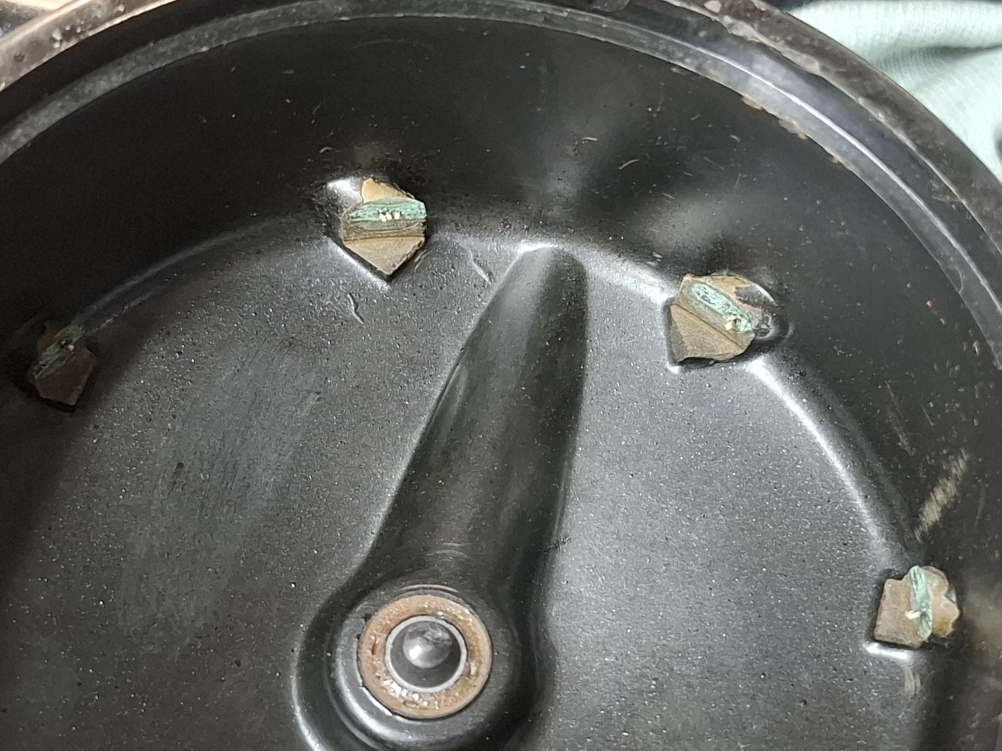

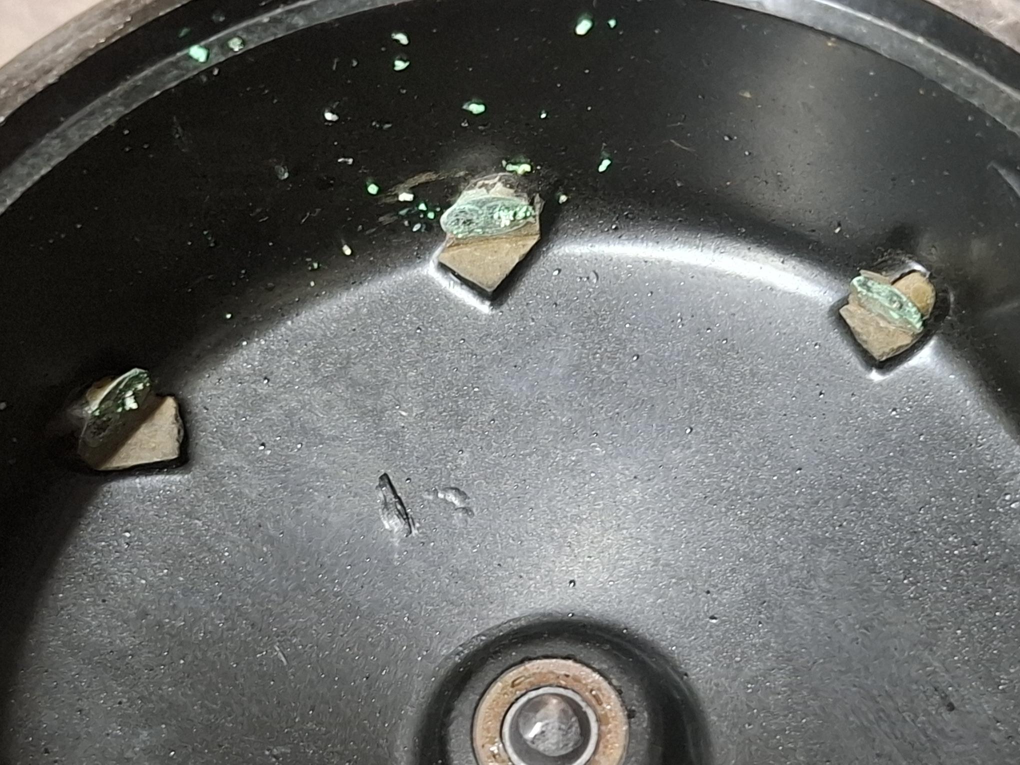

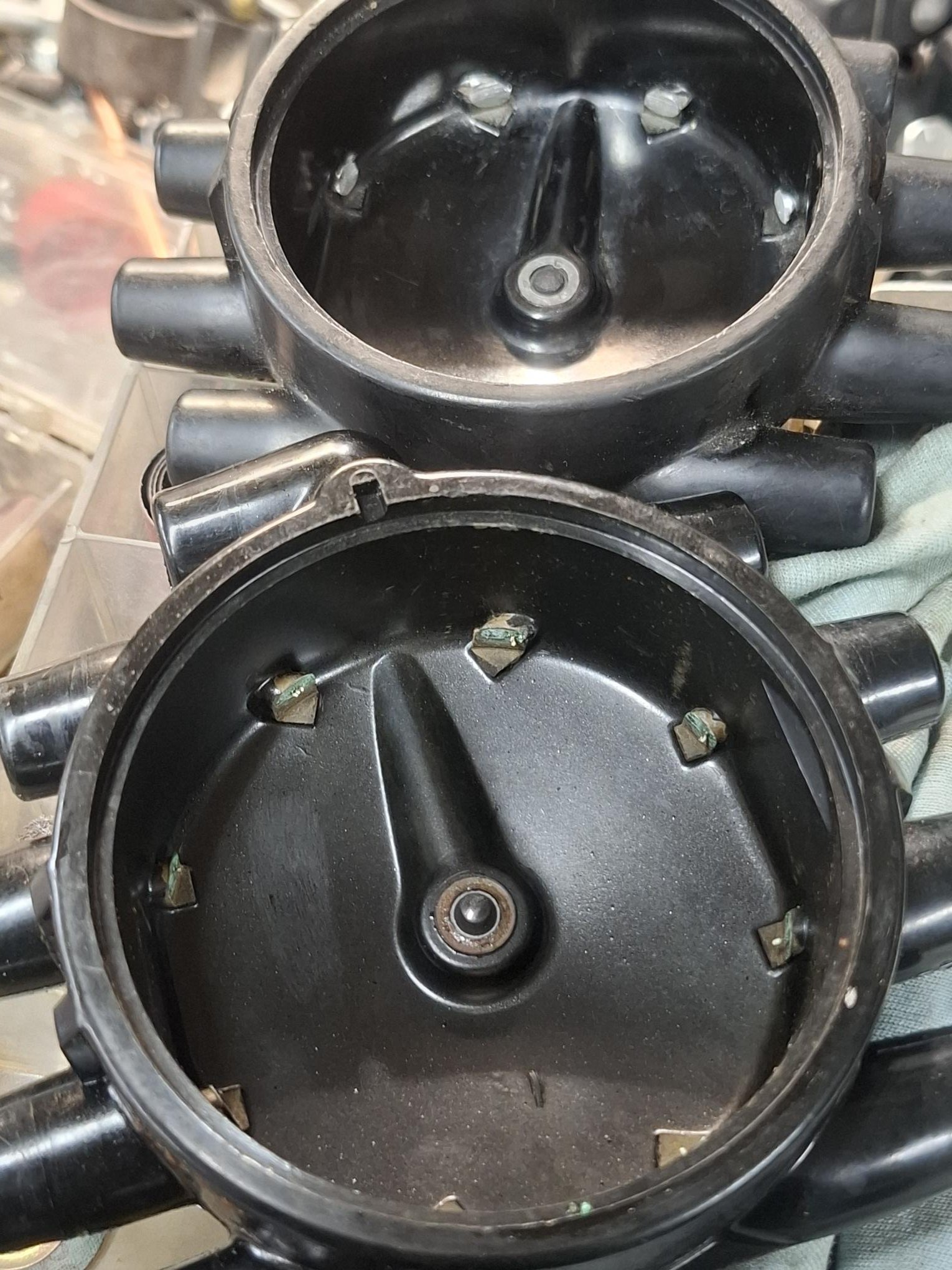

    Now Im very confused. I have try to get it this Flathead psyche.
    Engine starts nice, runs and drives. But,.... I feel in my **** and fingers that engine is not what I want. When it smokes, car is not push like it push when its Neutral or Lean...
    We know that when You are near "too lean" engine runs like crazy.
    there is very strong vacuum, exhaust runners also are flow very very good, which helps in side fill better cylinders, cylinders are empty before intake cycle. I note that I must open very carefully idle screws, or engine sound is change to "heavy" even when it is just idle running. Many engines are not very much change their sound when You open or close those idle screws, but when very strong vacuum, half round is very much open or close way....
    I have try to install smaller jets, change power valves (both way),... still spark plugs are very very black.
    Distributor (stromberg electric) cap look very very bad (see pics) afte 100-200km driving...
    I think that:
    1) distributor is not enough for this engine?
    2) there is somehing elecrical problem in distributor?
    3) this engine needs more carburetors (more trottle area)?
    Feels that engine has huge potential, it tries to push strongly, but when more trottle, rather much smoke behind car ( its rich, not lean), even have normal size 53-55 nr. jets.
    Is there too small trottle surface area? or is this stromberg distributor **** /out of order....
    spark plugs are black even drive very carefully. I take 5min test drives and drive direct back in to my garage.
    Why distributor cap looks terrible?
    I have fix it many times. I have 3-4 caps, I have changed fixed cap too many times.
    I have ready 100% rebuilt Harman Collins magneto with new points, condenser and coil.
    I have installed and adjusted it ready. Must I change it to see how engine works with it....
    I like challenges, no hurry nowhere, but sometimes feels that not "find goal"...

    OK, today I removed stromberg electr. ignition. I check that all has been right position. Cam, crank, distributor rotor... All has been perfect. I wonder why I had need to fix distributor cap many times, and spark plugs are lampblack.
    When magneto was installed, I tune it up slowly, check many times right timing.
    Started up engine. Now engine runs like crazy. No black smoke behind when I pedal more.
    Spark plugs are OK. Engine takes easy Rpm, not dead area when drive, sounds powerful even when run Idle rpm ...
    Ou ****. That stromberg distributor set wasn´t enough strong... They say "its normal oxidize".... Im not sure that its normal if every 50-100km You need to fix distributor cap..... Even, when all fixed, engine didnt feel what it must be.
    Aulis
