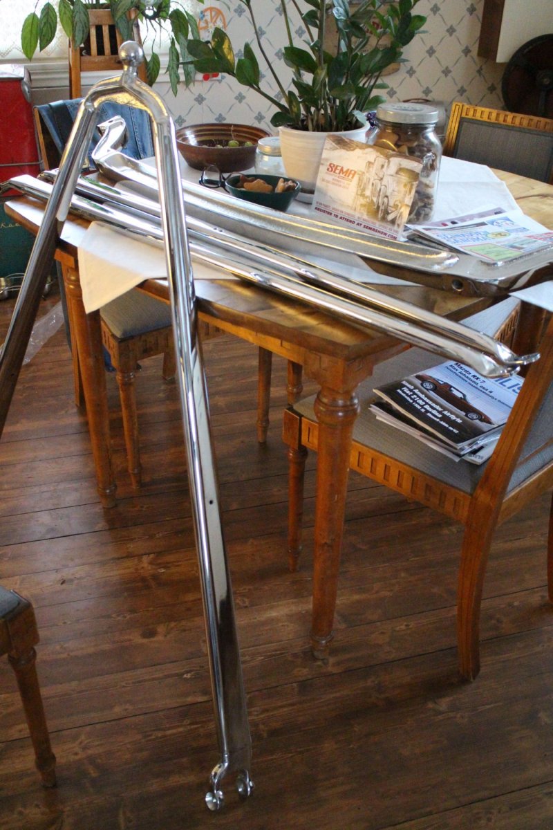

    I was visit in Sweden , Ekens G***ers Swapmeet (Stockholm). Bought some stuff to my projects and to my hot rod shop. Some customers were ordered stuff from my hot rod shop. I promised free delivery there.
    Micke From Dala Krom Ab (Crome plating Company) is very helpful man. He was cromed my wishbone, rear radius rods and 1932 heavy axle. Quality is better than good, exelent! and price is very reasonable !!! 100% service , Thanks.
    Of course price was lower because i made basics here, but I know that there is very much to do (copper, nickel, crome).
