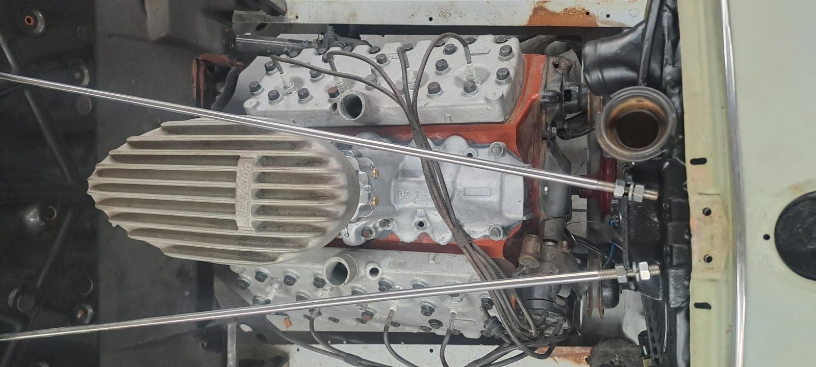

    Yesterday engine drop down to its place. I want to see that all fits. I must built own bracket for 12v generator. You can see that v-belt pulley for generator belt is backside of mcculloch.
    I need to cut magneto angledrive shorter. I use that Tom Cirello 426cid mopar magneto. Need to cut magneto driveshaft and "chop" top of angledrive... This week need to continue welding jobs. Trunk lid is "semiready"....
    I decided that I make one piece hood. Top only. holes for carbs and bead.....

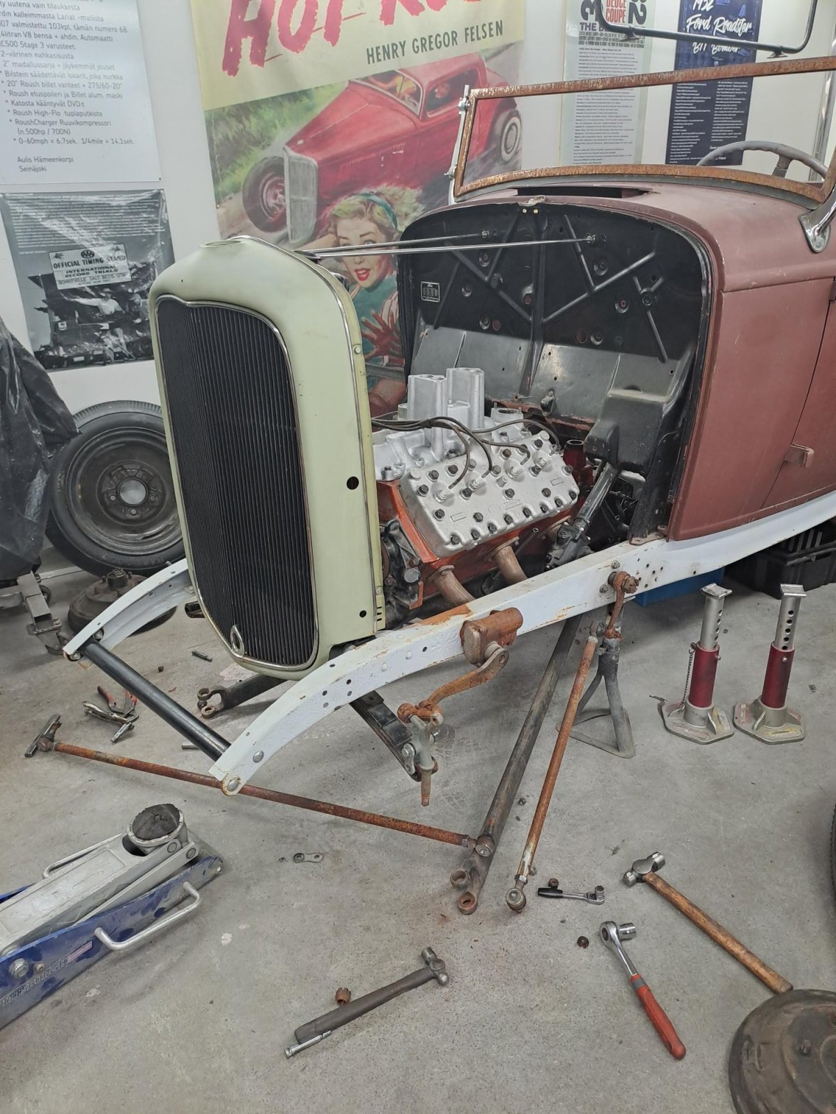

    Generator installed. I decided to use 12v mercury generator. Maybe it has been 12v model originally. They have stamp on it "12V". Other ones are oder pre 1948 model, I have changed those from 6V to 12V.
    Yes, generator is little too much out from engine room. For me its ok, maybe somebody don´t like it.
    Still I can cut brackets in head and generator, so maybe finally generator is 1/2" more near supercharger.

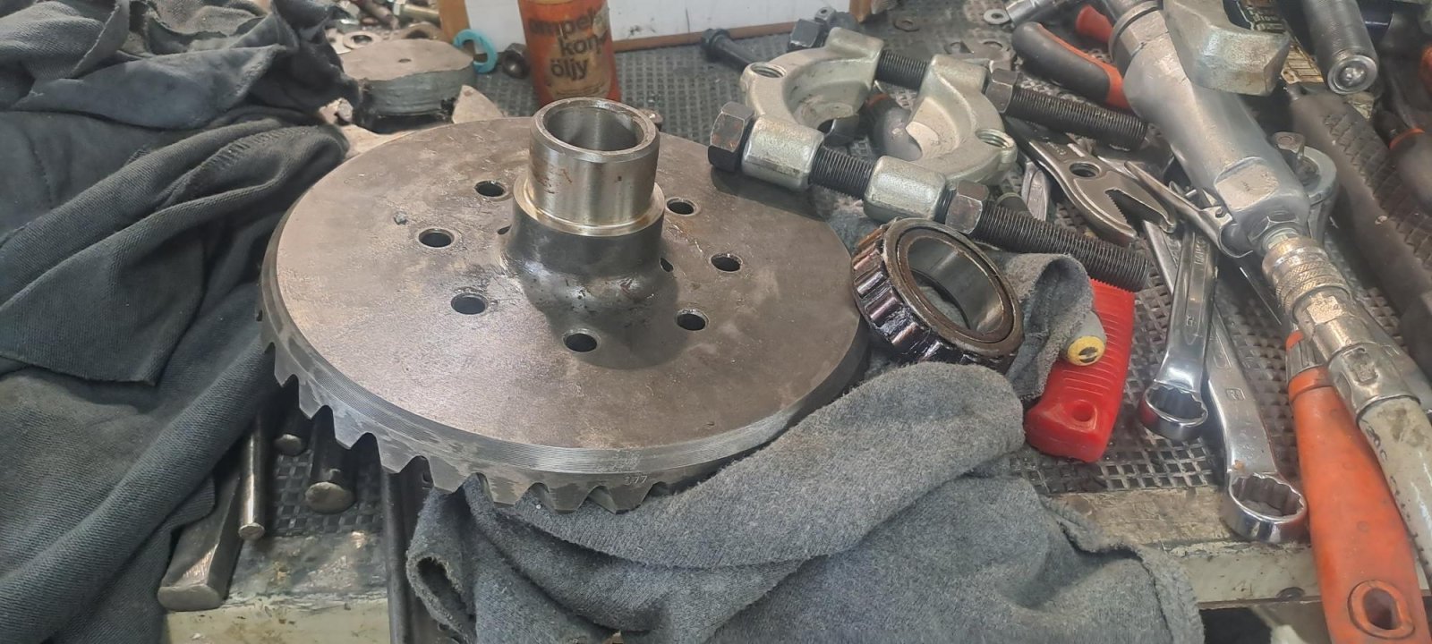

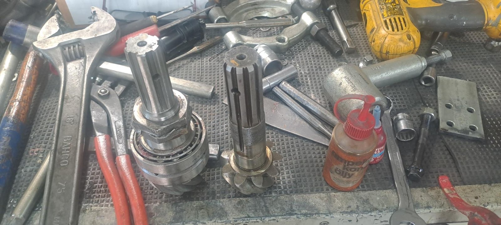

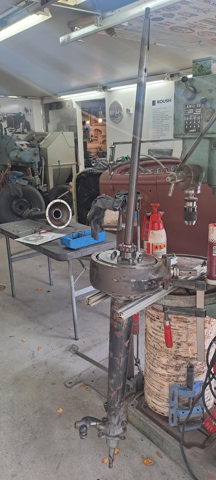

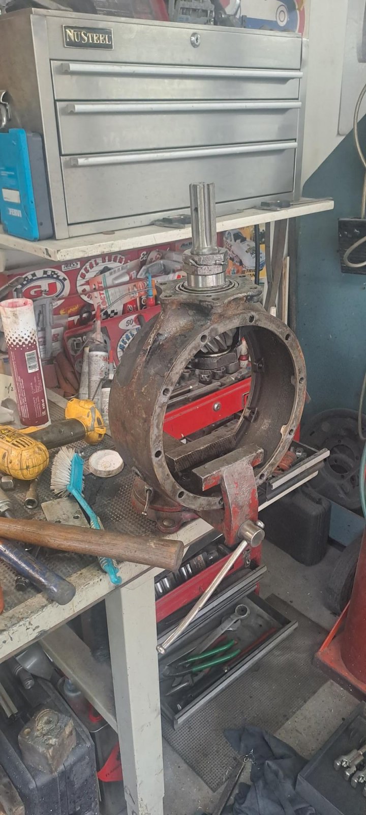

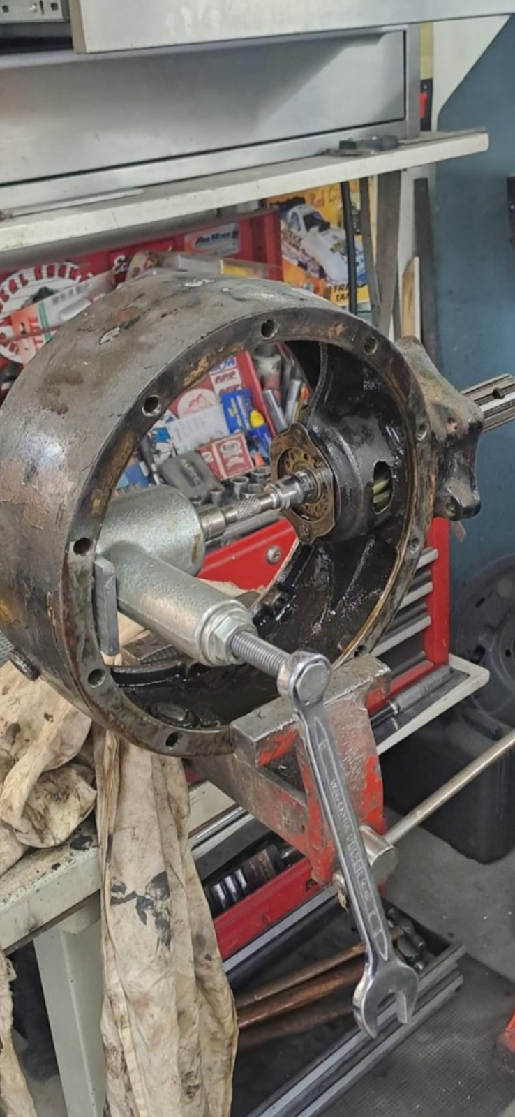

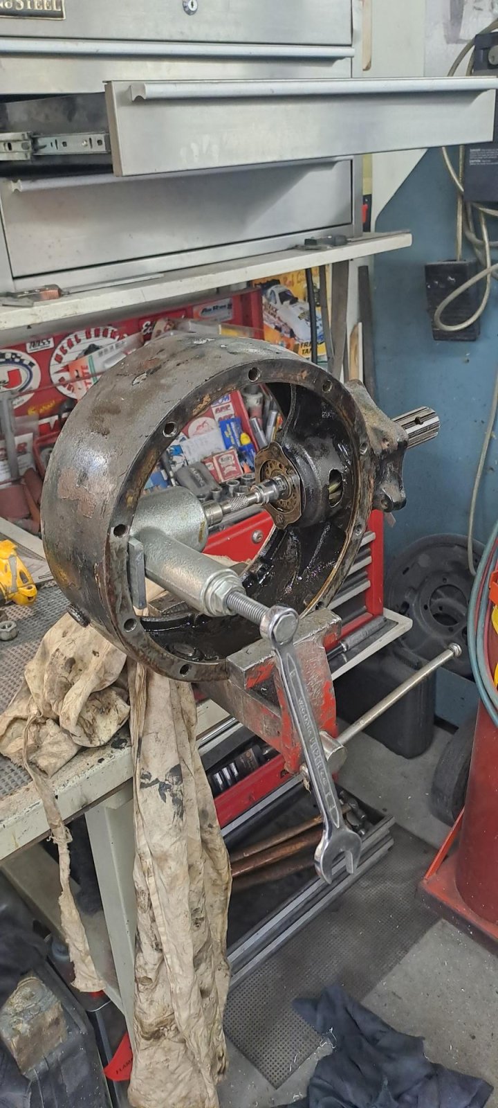

    A Question,
    What type of tool in shown in the picture
    of the Banjo & the pinion ,,,
    Is it a 90 deg press ???
    chryslerfan55, Stogy and Oneball like this.

  21. AULIZ
    Joined: Oct 28, 2005
    Posts: 1,793
    AULIZ
    Please, show me what You mean. I don´t understand.
    What picture and what tool?
    Aulis

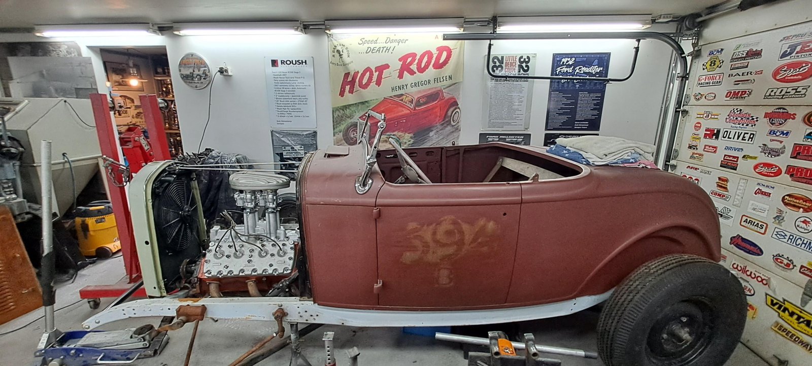

    I like small garage. You get better feeling work there. Radio open 24/7 (cl***ic rock). Yes, it would be nice to own big garage, but here its so expensive because need to have 4" urethane panels or 8" regular insulation on walls + 24" blowed insulation on top.... Everything costs when You have real winter and want to keep garage warm.
    Those prints on wall are made here in one advertising agency. Old drawings from Hot Rod books.
    Have one more which is black and white salt lake picture banner, but not free space for that.
    Framed fotos are from Los Angeles area. One old man sold those when i was living in LA area (2003-2005).
    He told me "I was selling tires to gas stations LA area from 50´s to end of 90`s".

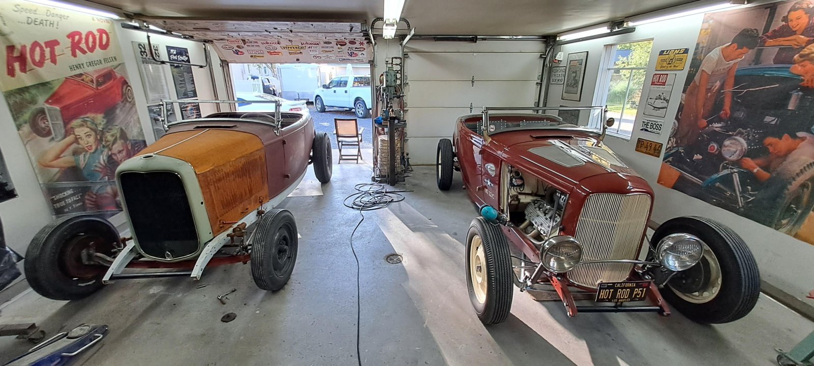

    few own cars introduction prints too. This (see pic) is latest.
    Aulis

    the 90 deg tool shown with wrench,

    I also wondered what that angled tool was. Never seen hydraulic jack like that.
