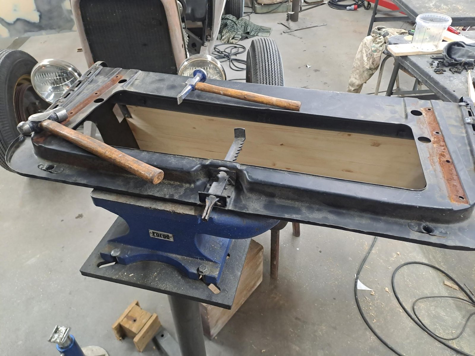

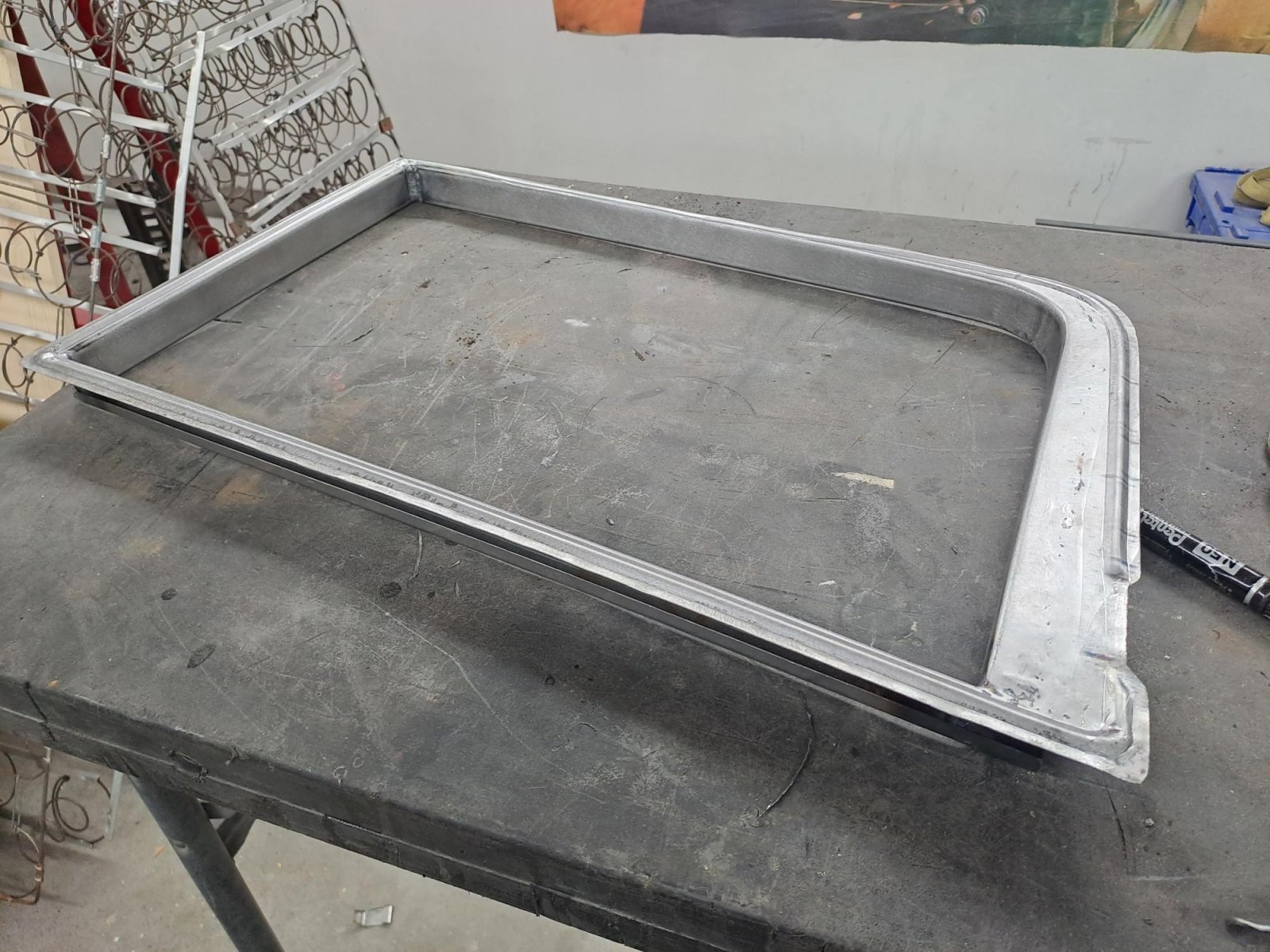

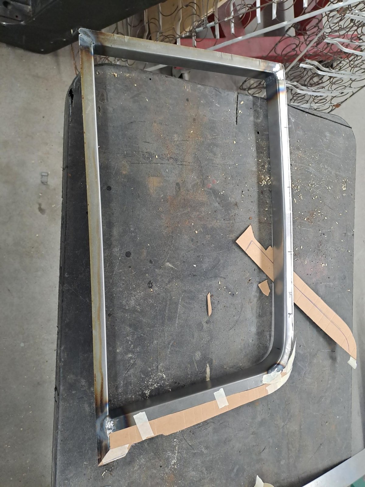

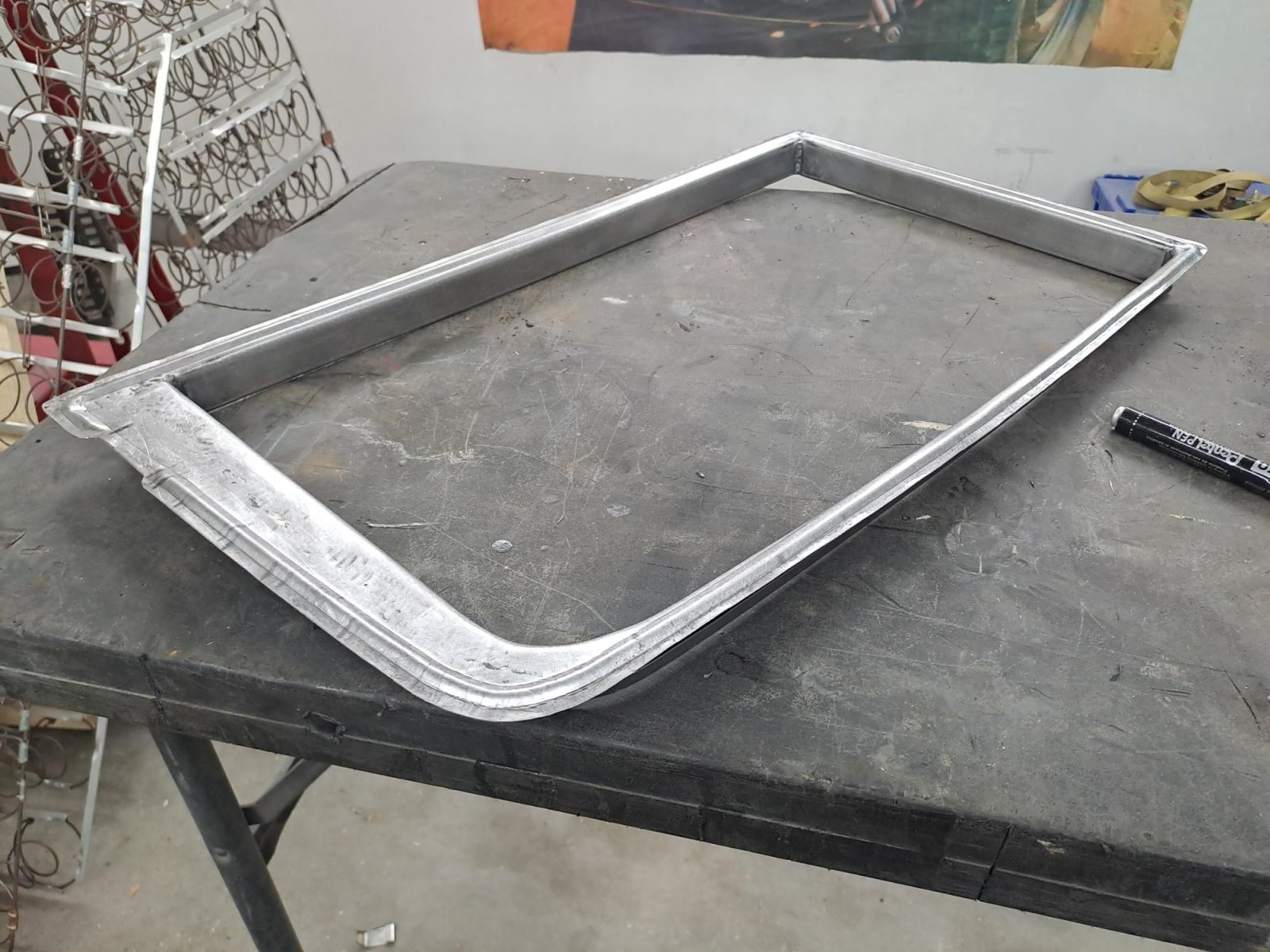

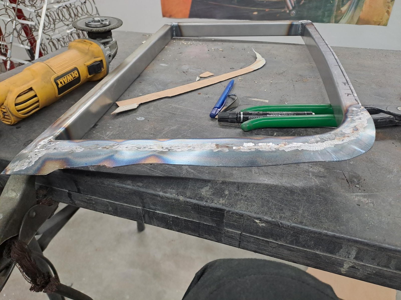

    Seat is ready. I was straighten seat slides and bolt on their places between seat and subframe.
    Sometimes You need to make things twice, maybe three times..... today i installed door window channel kit and note that there was not enough free space between outer skin and garnish moulding.
    I drive to plater company and cut there new garnish moulding material. New sheetmetals are 10mm narrower. I bended those same style than old ones. Another edge 180dec and another 90dec.
    Now, I think, 2nd version is better. Bottom is wide one and upper sheetmetal is 10mm narrower.

    Both doors garnish mouldings are ready.
    Next I install orig. 1932 steering box, dash, orig. 32 column drop, clutch arm.... Next week I continue welding.
    trunk lid, rain gutters... very much to do before Im ready to chop top.

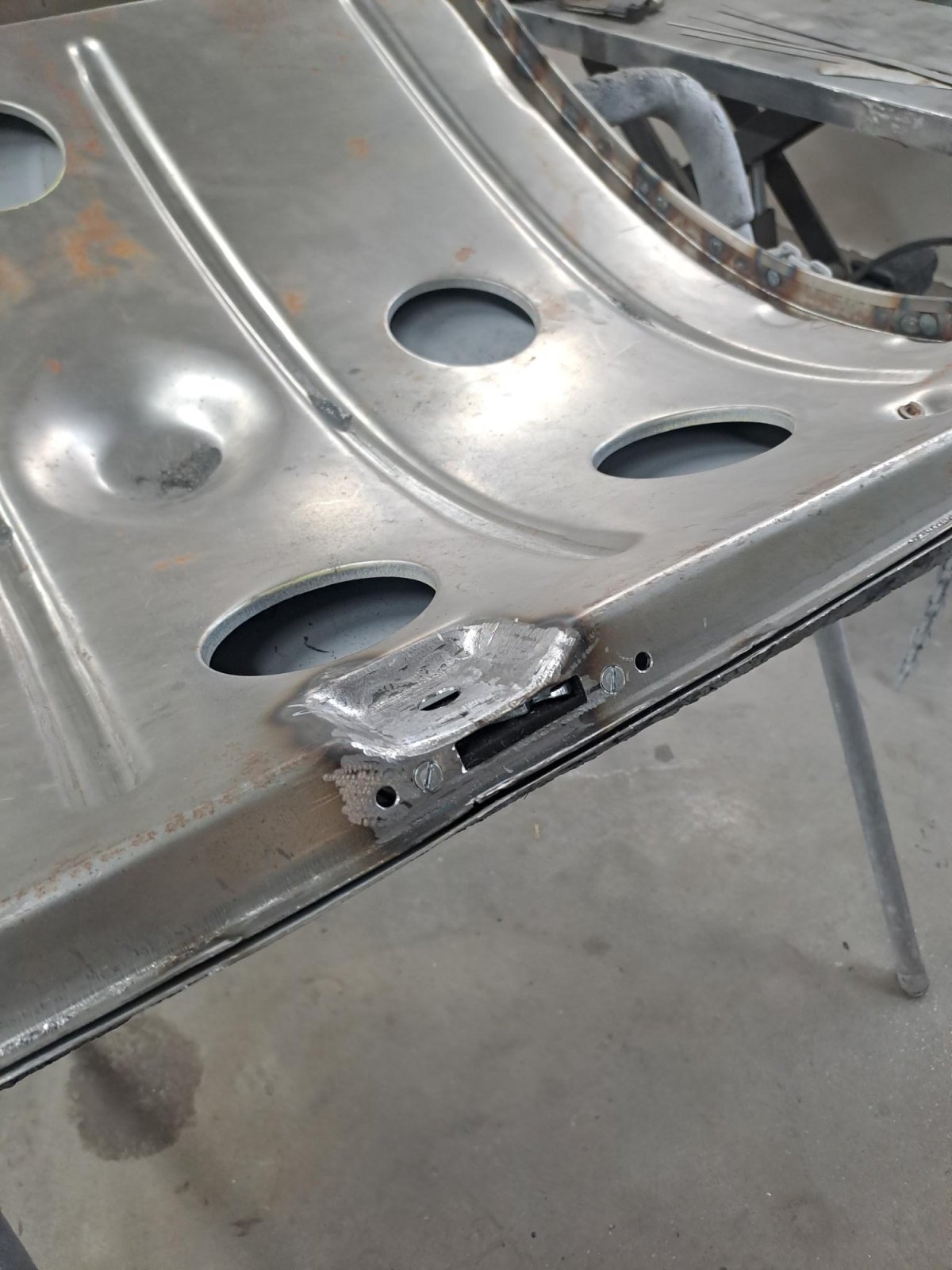

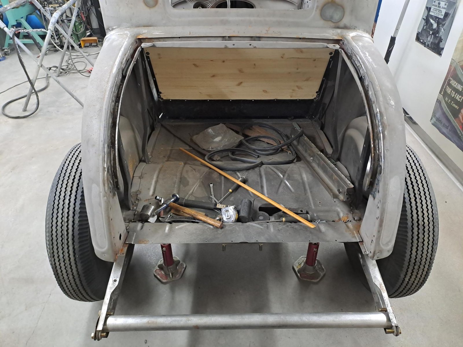

    I have installed door latch, striker plates, female and male dovetails. Found missing windshield frame hinges. Worked few hours with windshield frame. It was twisted, corners turned in. Still upper bar is little "banana" (curved).
    Trunk lid is now "under construction. Hinges, latch, lower edge need to weld and make ready.....

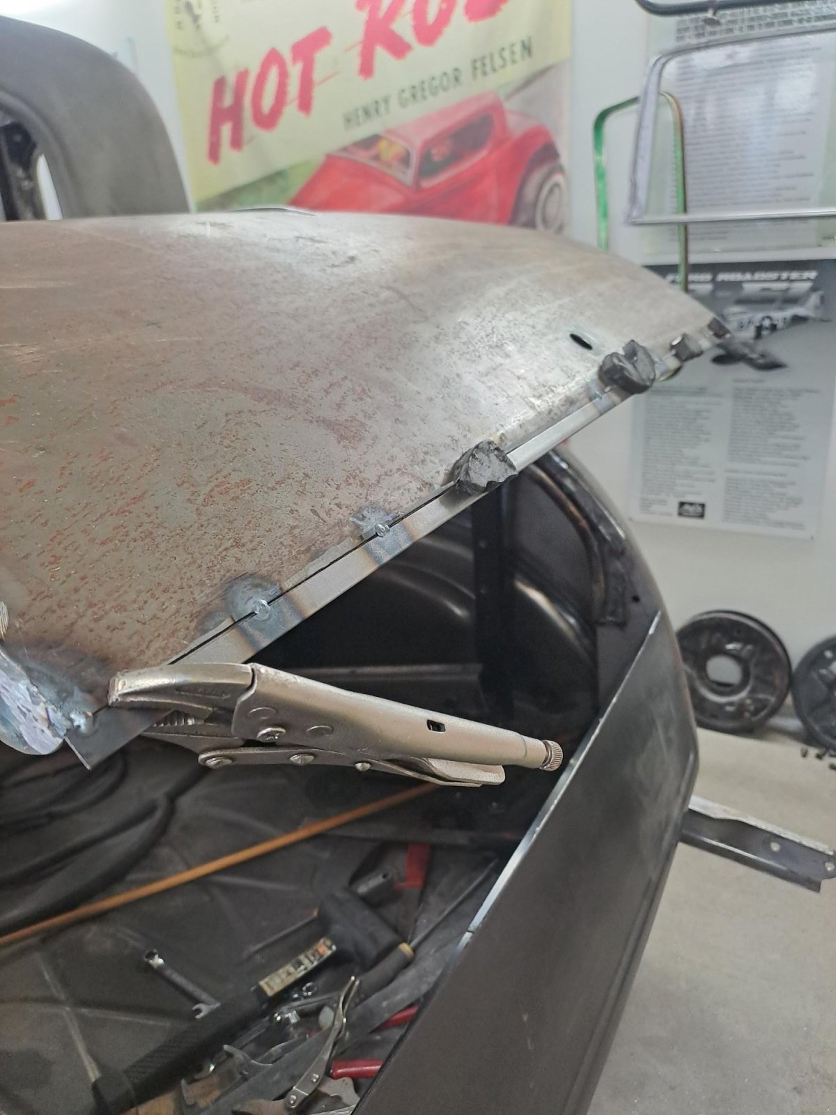

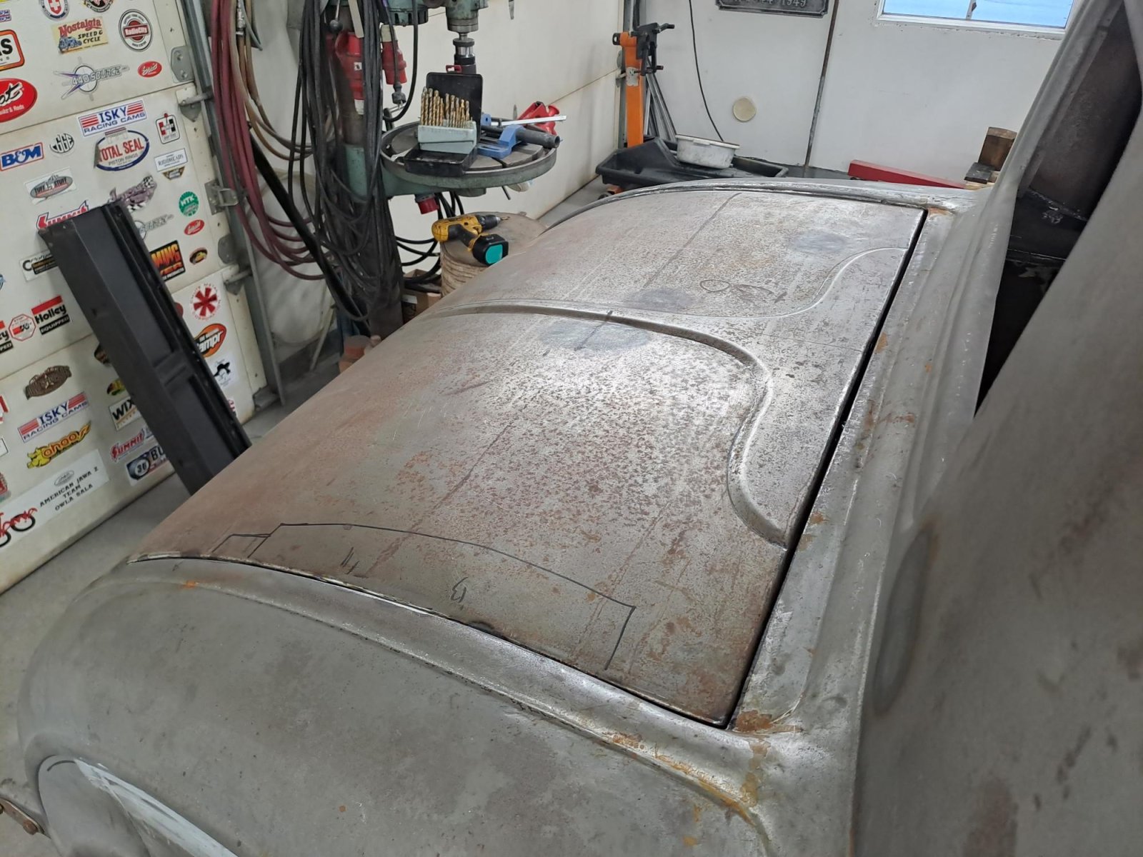

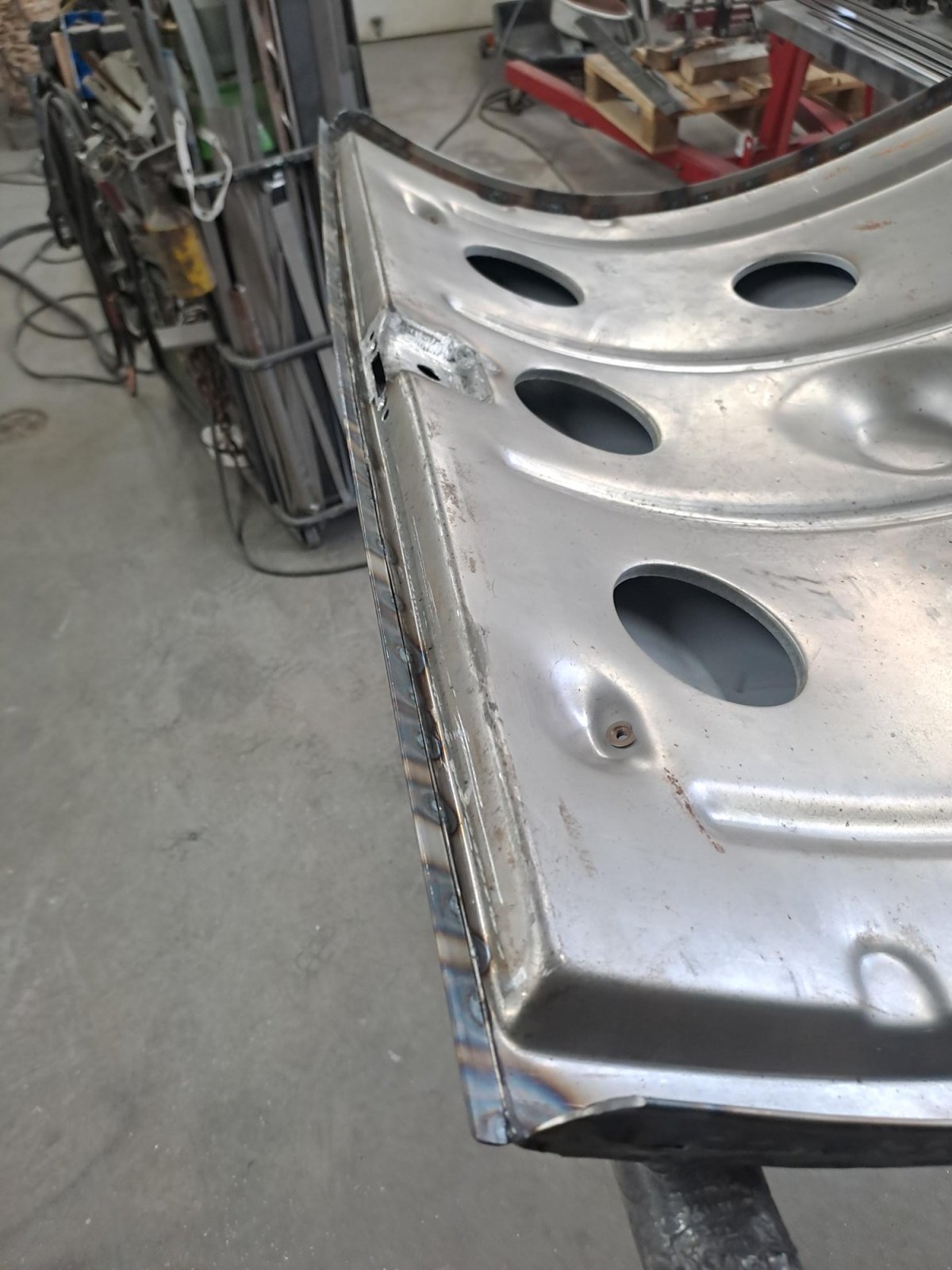

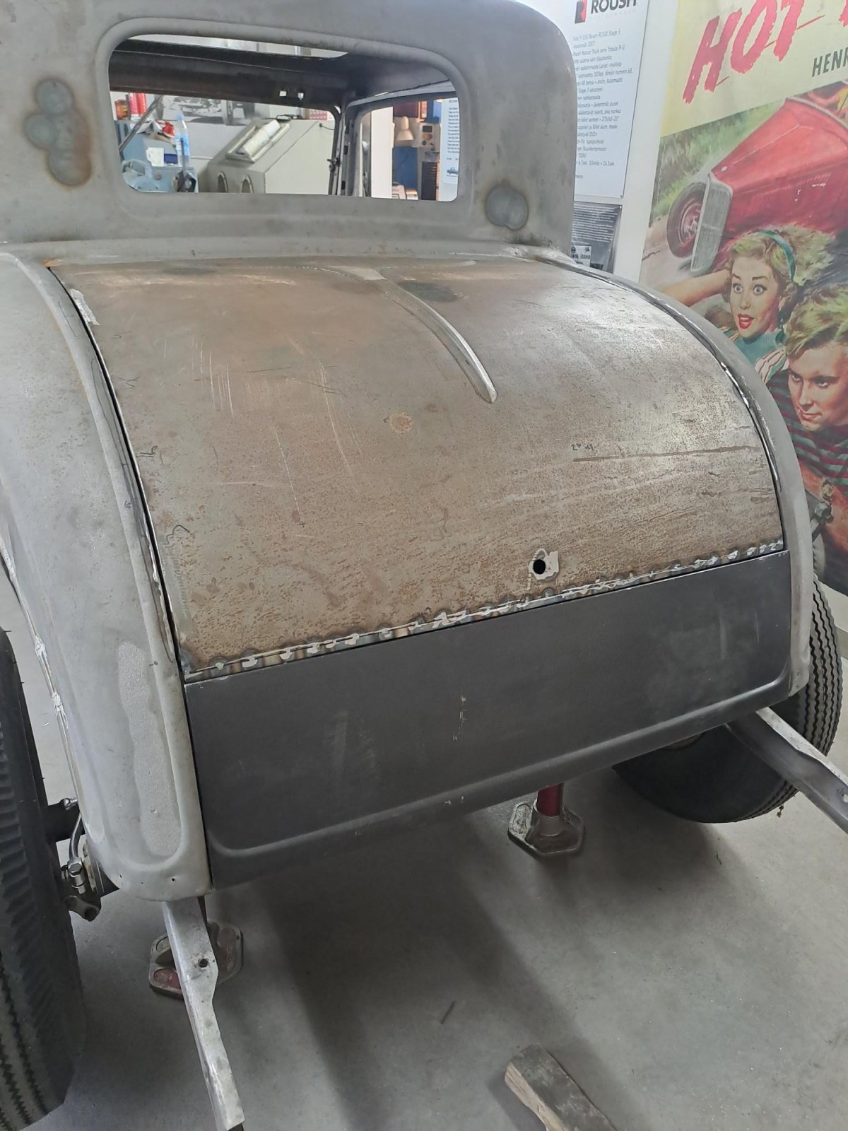

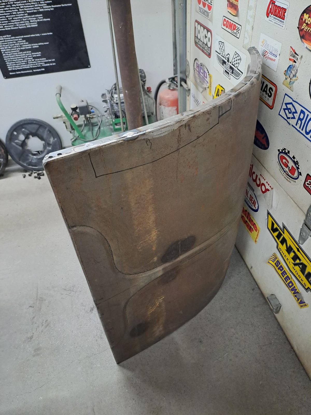

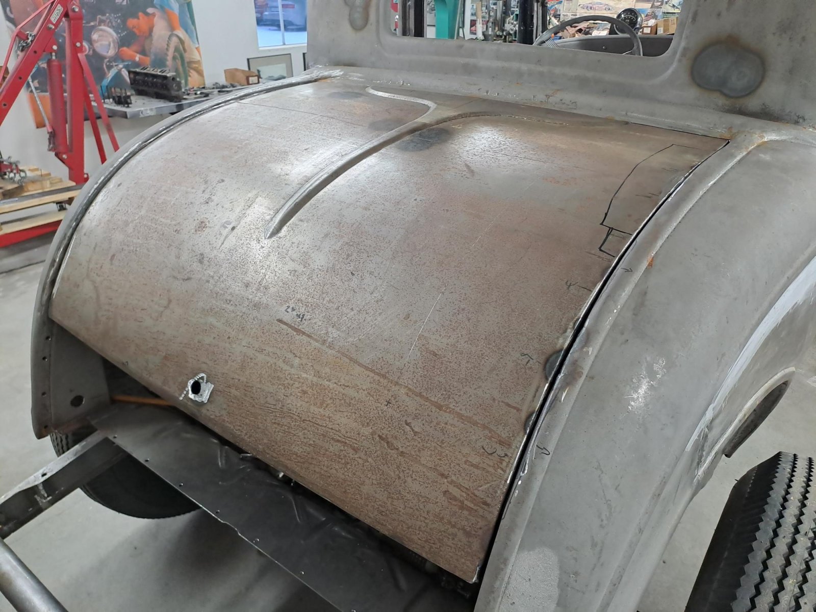

    trunk and trunk lid is cheat me. One day more and it´s ok for me.
    Today I picked up material for grill shell. 25euro (25usd) 20meter 180dec turned sheetmetal and 16meter round tube which has open cut. Let´s see what I get done later this week

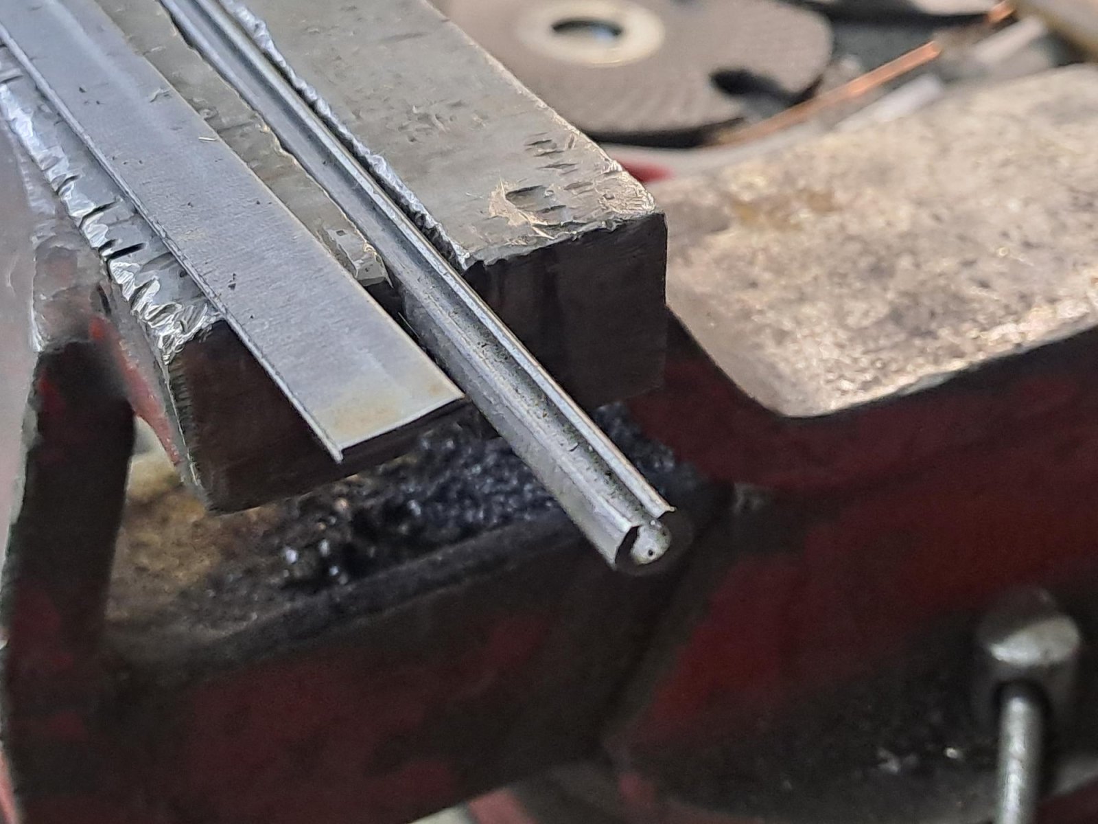

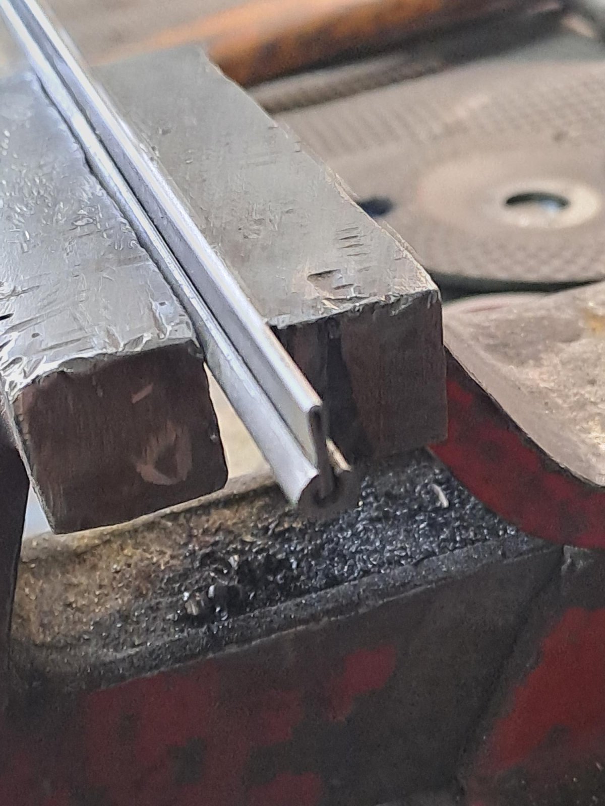

    I don´t know what is name of this tube (OD. 1/4") with crack.... Yesterday evening I was try to find it from steel wholesales websites, but too much products there. I found this one from local company who is made those big tubes on roof (air condition, heat recovering...) . They told me that they used tube when made "sparknets" front of fireplaces.
