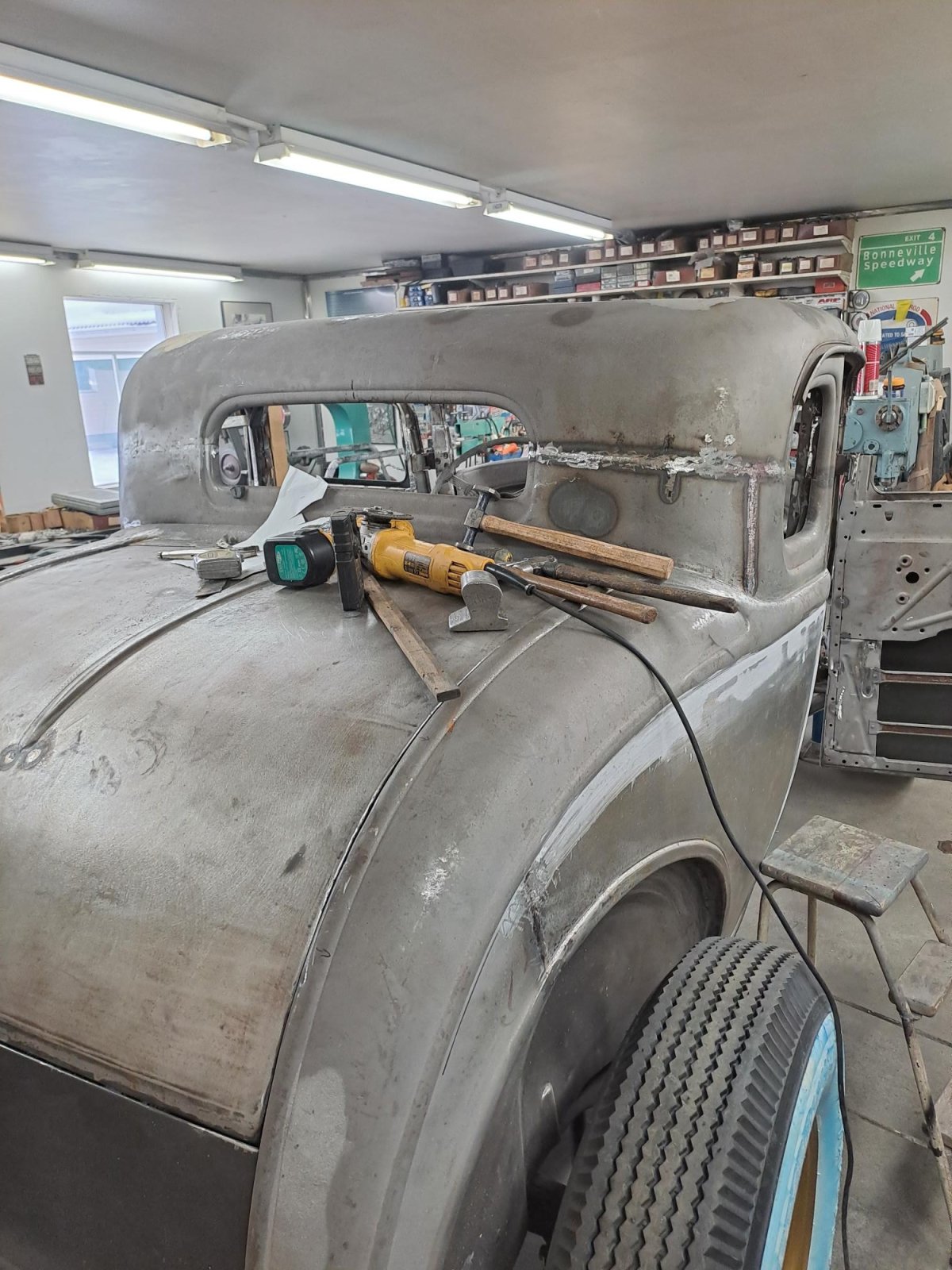

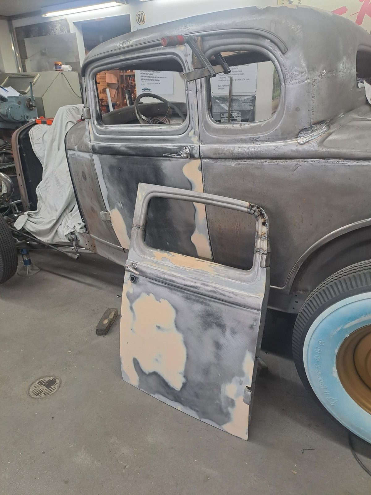

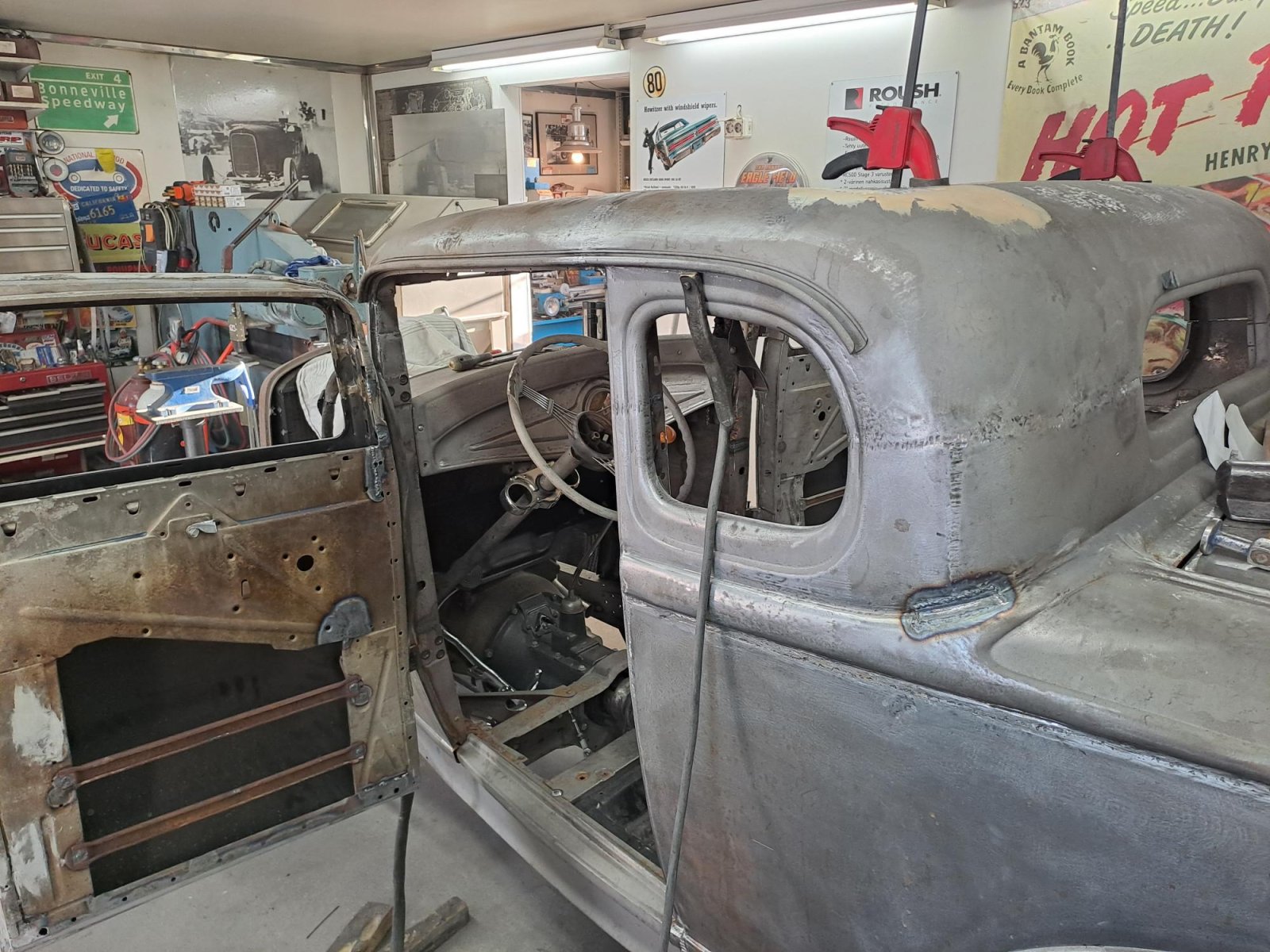

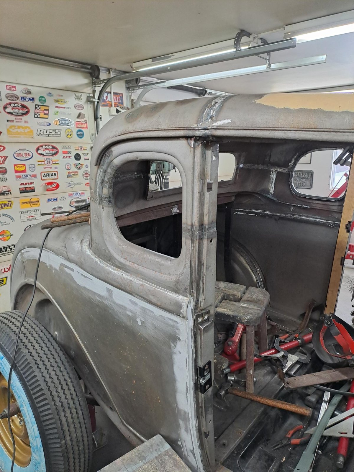

    Drv side: door ready, A-pillar ready, B-pillar ready. C-pillar need to grind and hammer straight.
    Quarter window frame bottom need to cut slice off and weld back.

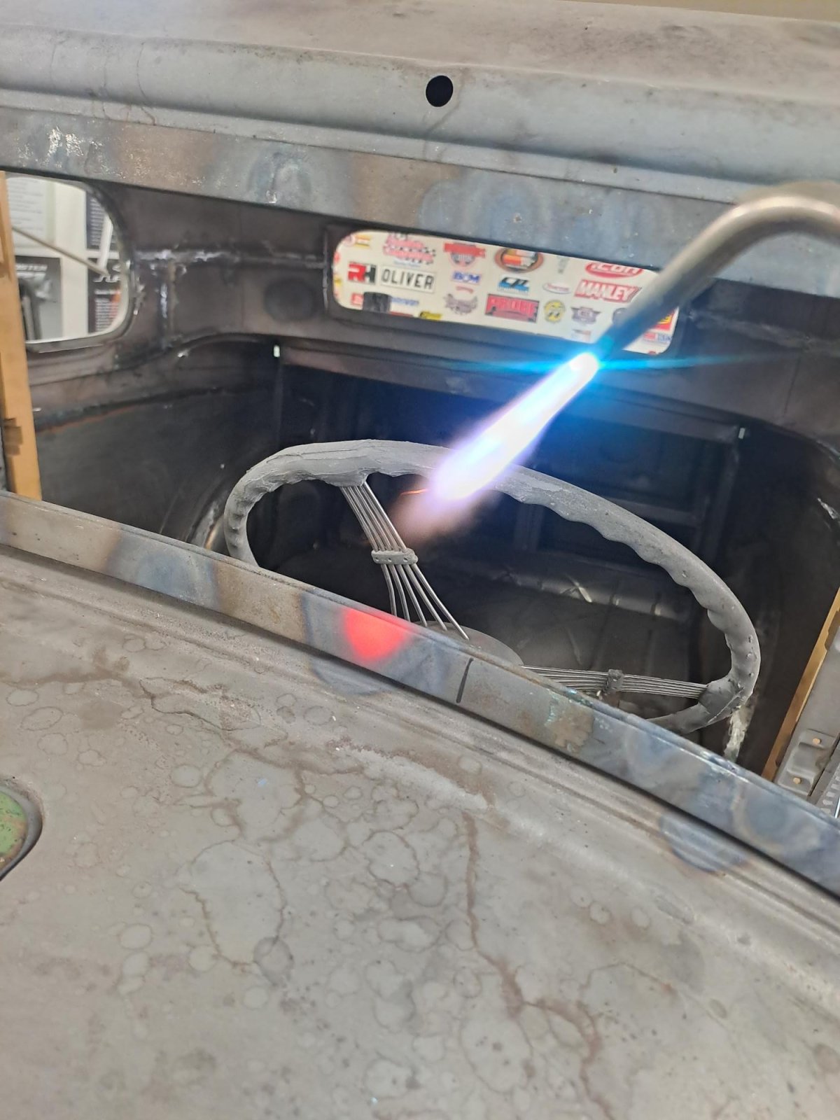

    A-pillar factory gas weldings come out after I warmed lead off.
    What is this welding they used when they put together 5w coupe top (8pieces)?
    Looks like battering ?

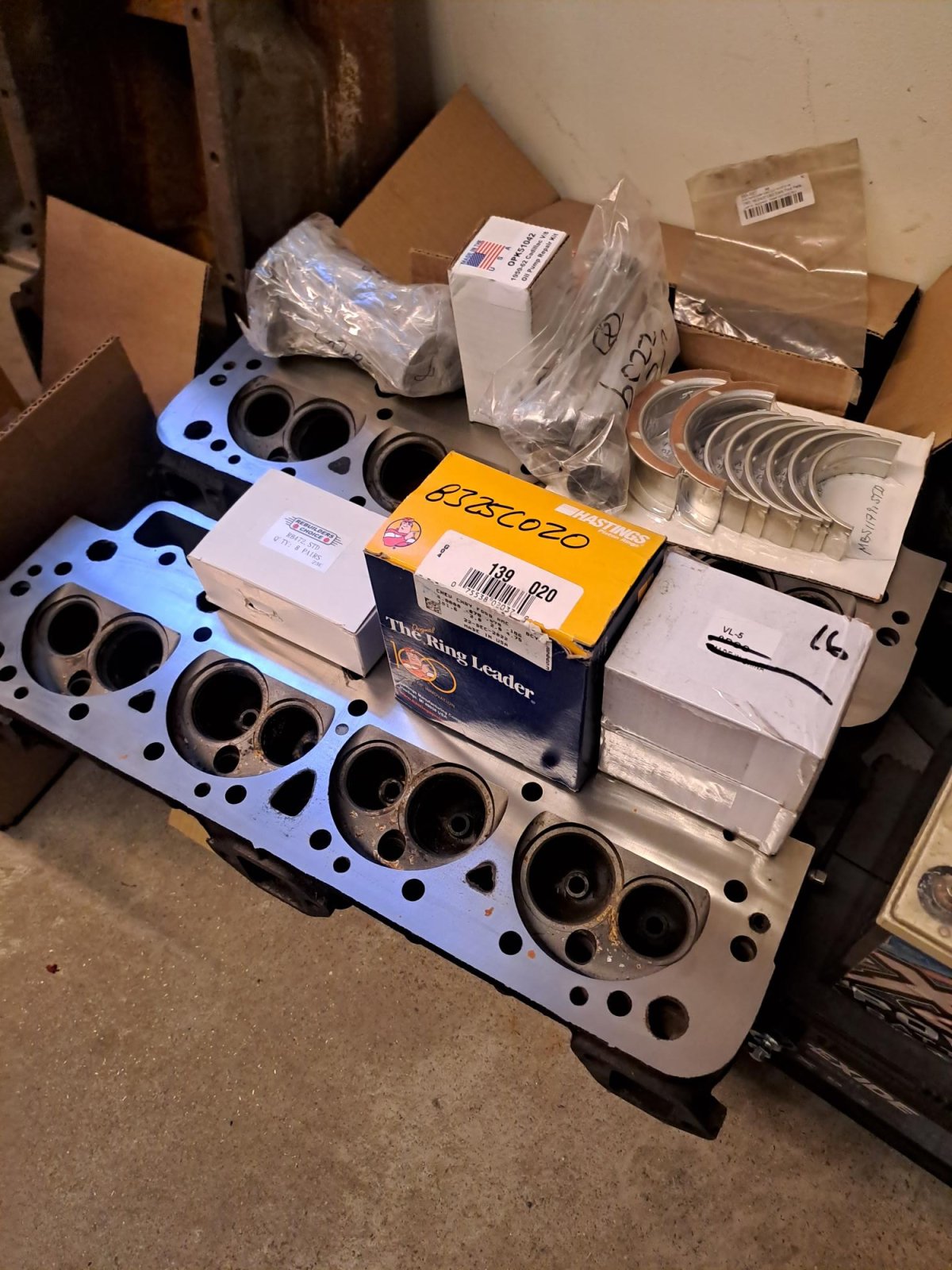

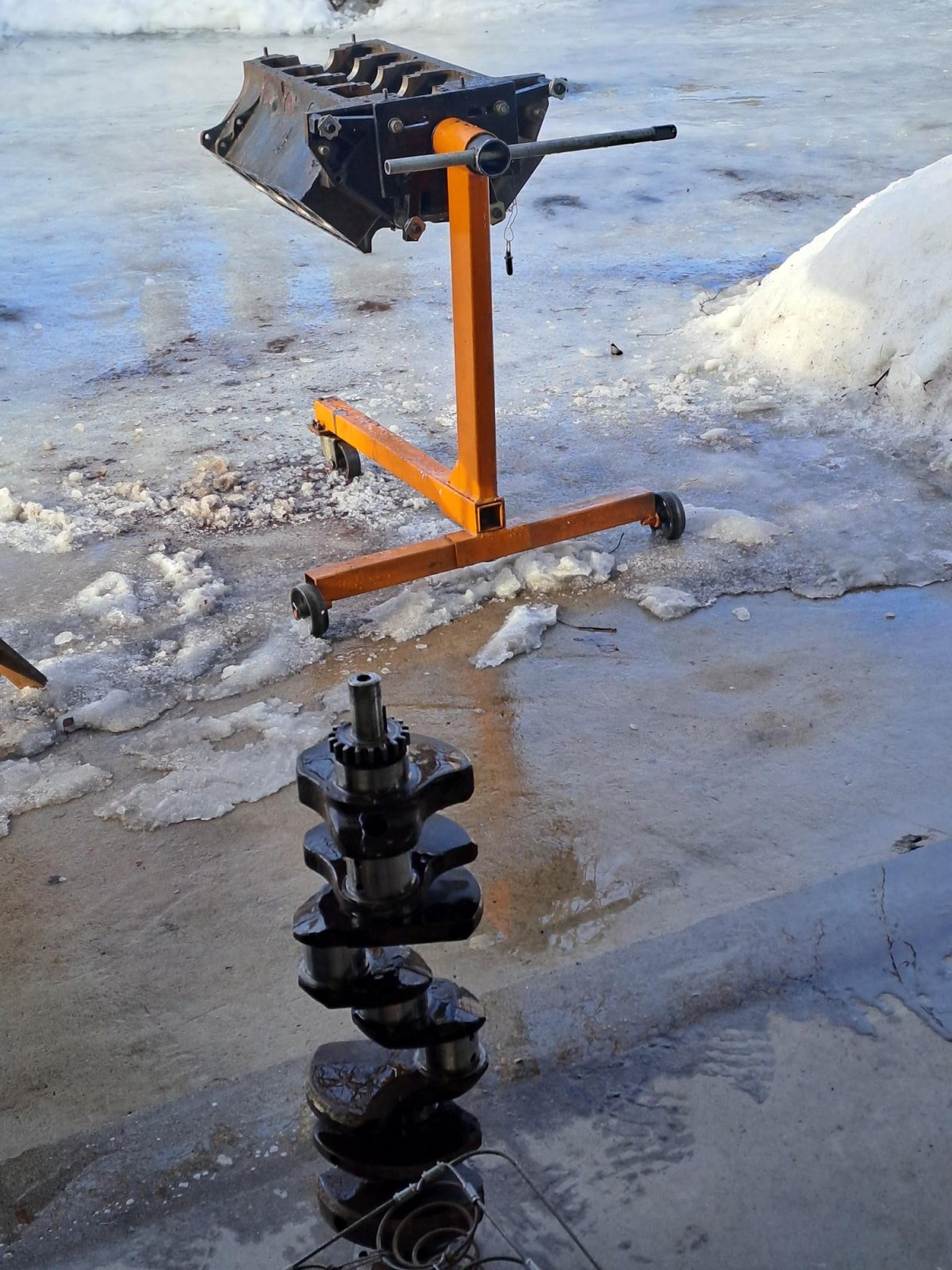

    Last weekend I grinded customers 1959 390cid caddy heads. Also bored from std to 020 oversize.
    Today my friend was hone cylinders right dimension. I bored cylinders 2/100 mm undersize and he has honed that 2/100mm. Last month I ordered pistons, rings, bearings, lifters,... from Kanter. They are still open.... old company. rod-coupe467.jpg rod-coupe468.jpg rod-coupe469.jpg rod-coupe470.jpg rod-coupe471.jpg rod-coupe472.jpg rod-coupe473.jpg rod-coupe474.jpg caddy-6.jpg
    Aulis

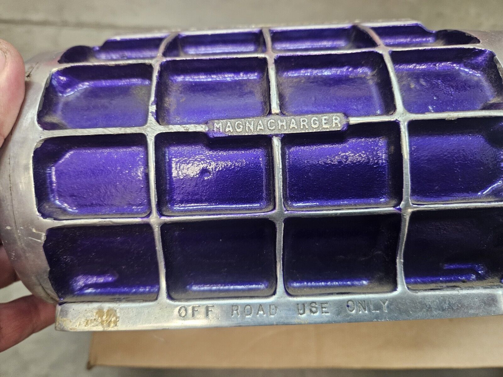

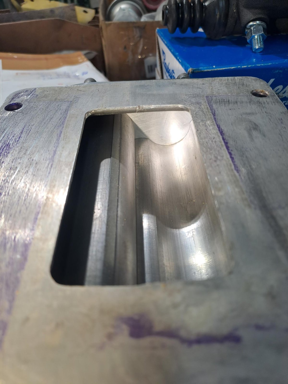

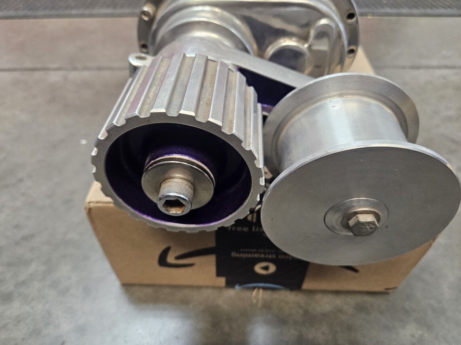

    It was Christmas today. I was help my friend to get Mustang 1968 ProMod from Oklahoma to here Seinäjoki city Finland. He promised that I have free shipping, if I need something from US. Not big needs, but something... Seacontaier arrived today, my friend bring my stuff "door to door".

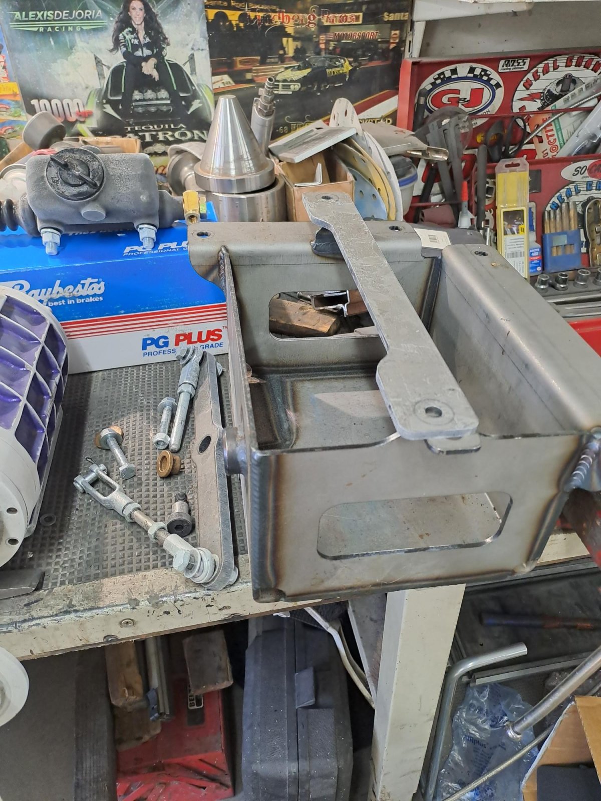

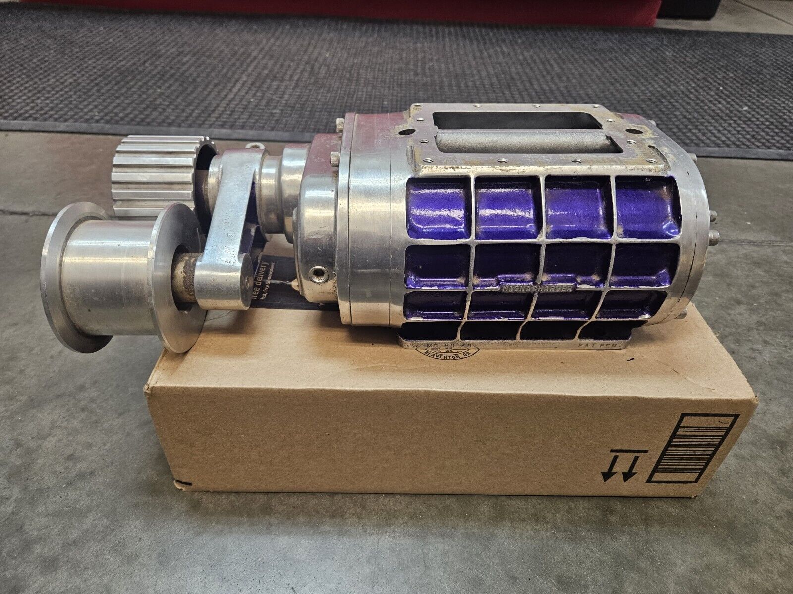

    - New stuff to my 1955 cameo
    - Magnaharger from ebay. (looks very good. maybe not used, only bolted on). Nice size and outlook for flathead use
    - two gauge panel from HamB. Thanks!
    - batterybox with brake maincylinder from HamB. Thanks!
    Today only grinded some weldings and narrowed quarter window bottom size. When top is chopped, thickness of window frame is so much different in upper part and body part. I cut 3mm slice and weld together.
    Aulis

    Auliz, I believe the factory welds on the 32 ford roof bodies you mentioned was commonly referred to as resistance welds, I believe a full description with process factory photos were posted here on the hamb or the Ford Barn some time ago. An interesting observation on the 32 sedans is they were completed the full vertical height of the rear quarter panels on the left & right sides adjacent to the rear window opening with little or no warpage, perhaps some hammer & dolly work but apparently little or no leaded seams.

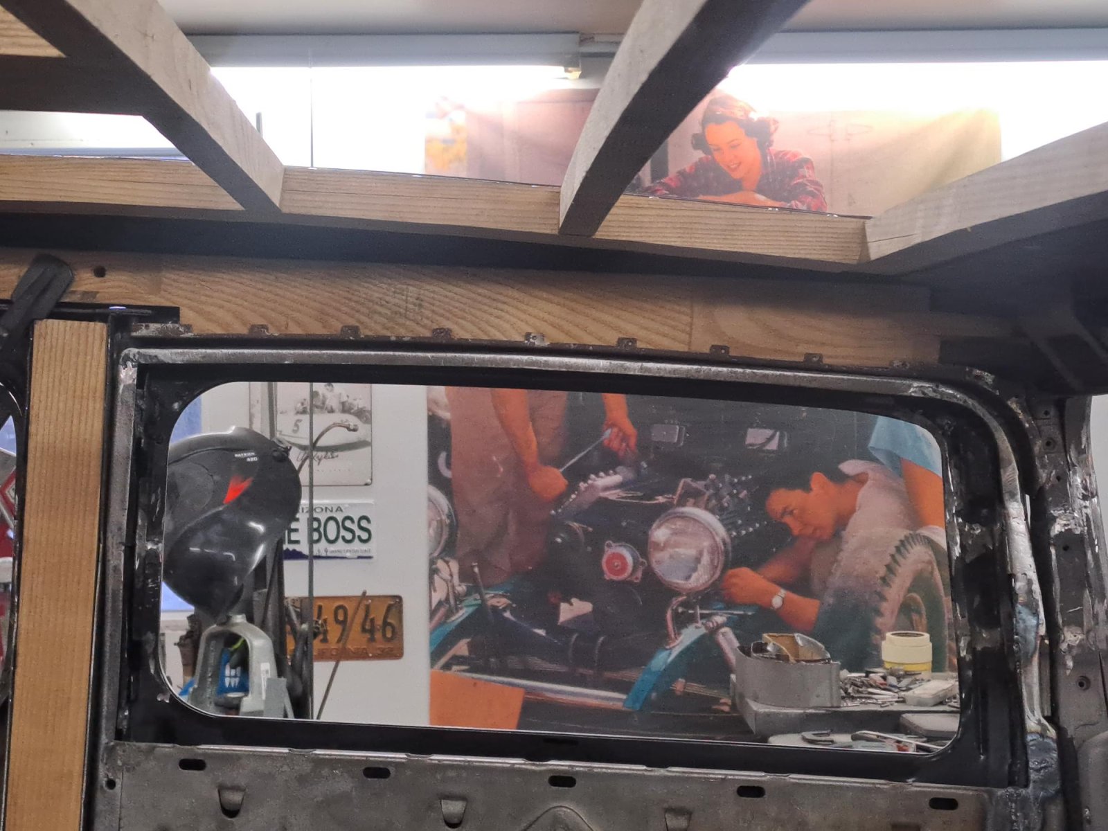

    Started to install woods. I want to see that all fit...
    I bought all wood kit 6-7y ago. One wood set B-20068 is mystery for me?!
    Aulis

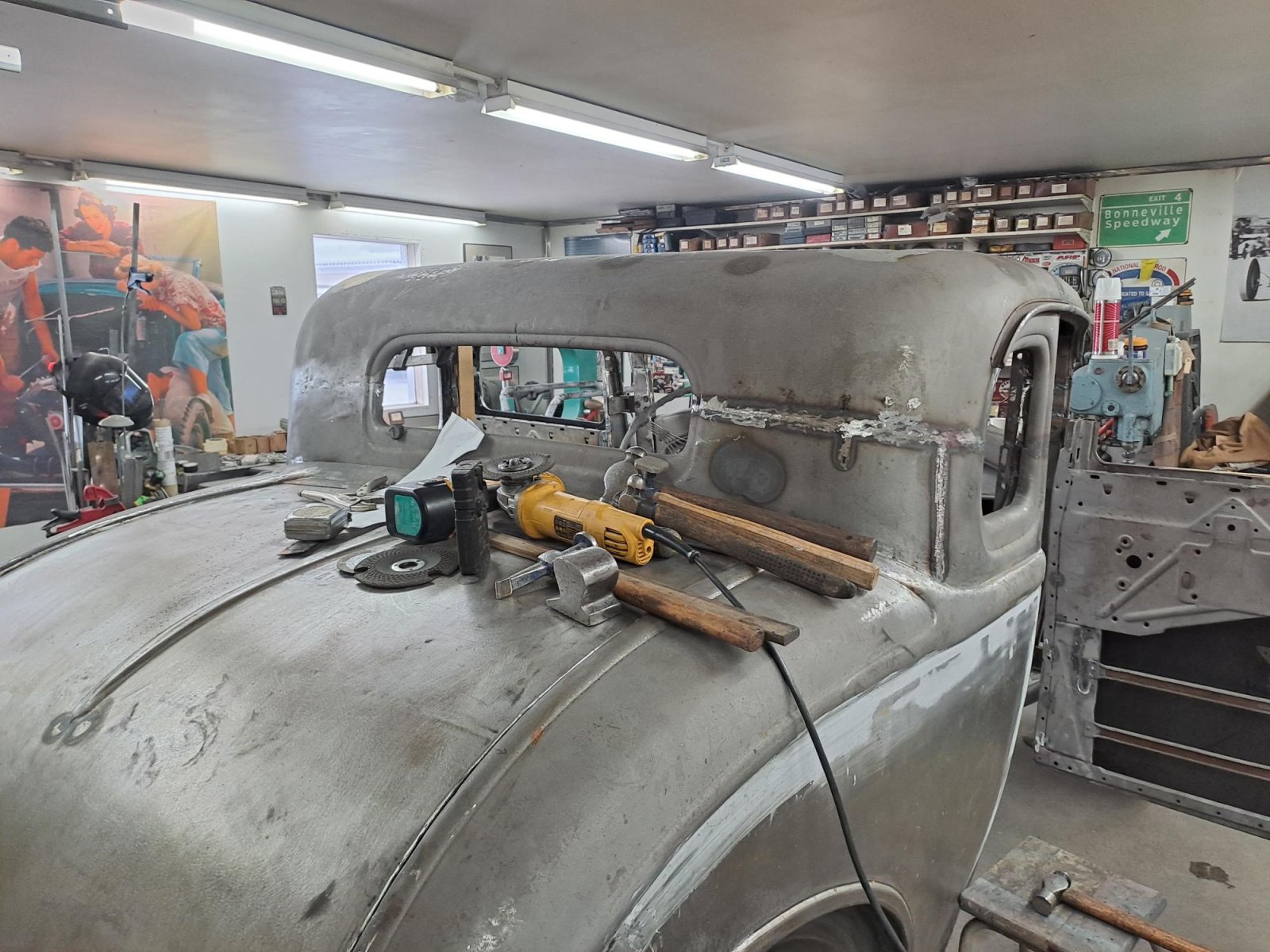

    Wednesday weldings.
    Little more hammering before start to weld door garnish
    Aulis
    rod-coupe502.jpg rod-coupe503.jpg rod-coupe504.jpg rod-coupe505.jpg rod-coupe506.jpg rod-coupe508.jpg rod-coupe509.jpg

    Auliz do you tack with MIG then finish weld with TIG or do you use TIG for all your welding?

    Normally all TIG welded, but when need "three hand" I tack with mig.
    TIG welding is smooth, not crack when hammering...

    I use MIG only when not easy to get all parts on their place with one hand (Another had I have welding burner.
    Like that right side rear corner. There I used MIG only when installed those installation plates.
    We know that MIG welding is harder both side of welding. Cracks very easily if You hammer sheet metal after grinded both sides. Gas welding or Tig leaves welding and both side of welding smooth.
    If weld frame or something You dont need hammer, shrink, strecth... MIG is good and easy.
    30-35y ago when I was working in paperindustry, steel factories, Mining, sawmill we used only ARC welding machines.
    TIG: I use 2mm welding wire and 1.2mm mig welging wire. 1.2mm wire I cut 50-80cm long pieces from end of mig welding roll. In industry they use those over 1mm welding wires (welding robots...) and my friends are leave me those "roll ends". They change new roll before long weldings. For tig I have also welging wire for Staingless steel (2mm) and cast iron (Ferronickel 2.4mm). TIG is best if You weld cast iron (cold welding). No preheating, not need stretch welding,....

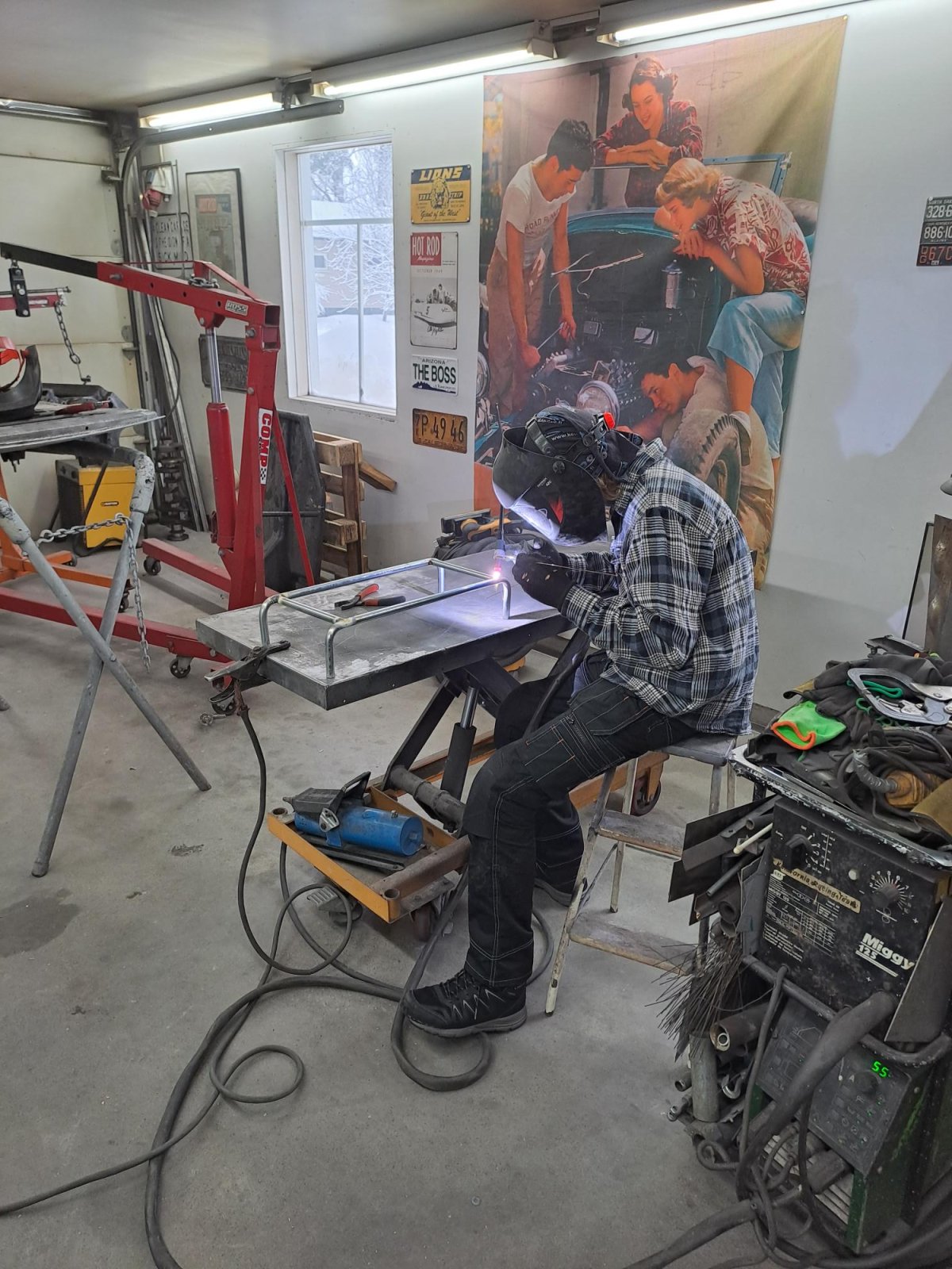

    Saturday Oskar welded in "Aulis welding school" his quitar rack. Iwas made all parts ready.
    Today I welded p***.door ready.
    Also added 16mm to panel above door.
    Tomorrow need to finish A-pillar.
    Aulis
    oskar-87.jpg oskar-89.jpg rod-coupe515.jpg rod-coupe516.jpg rod-coupe517.jpg

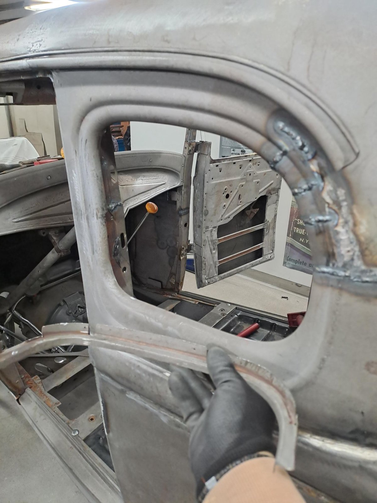

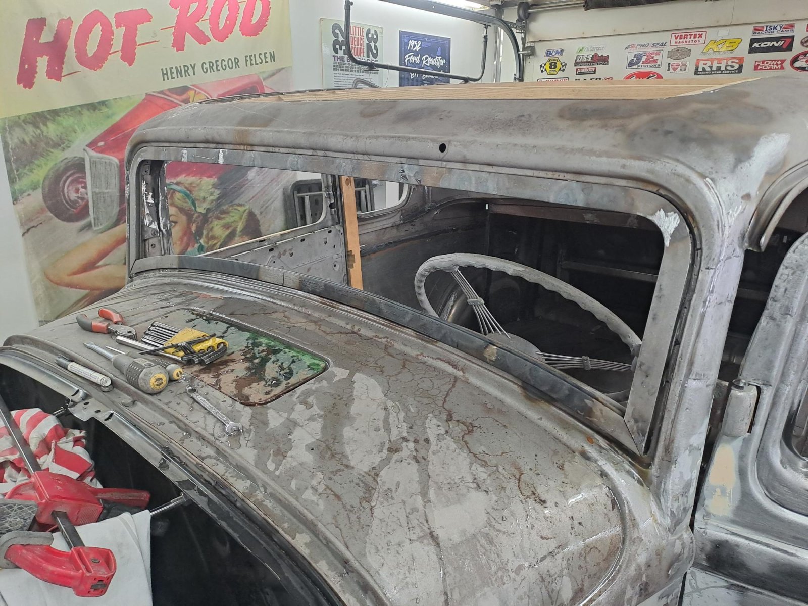

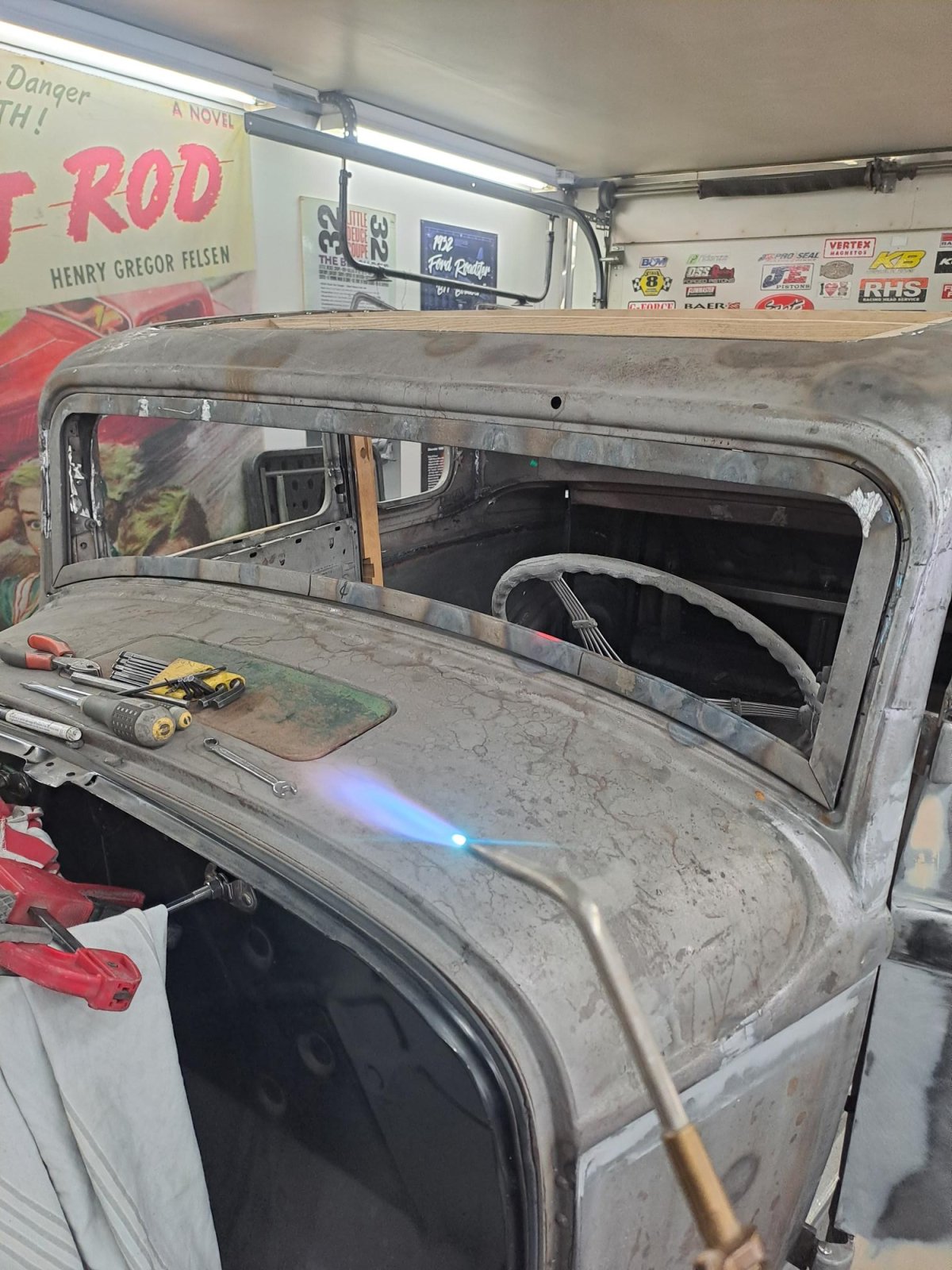

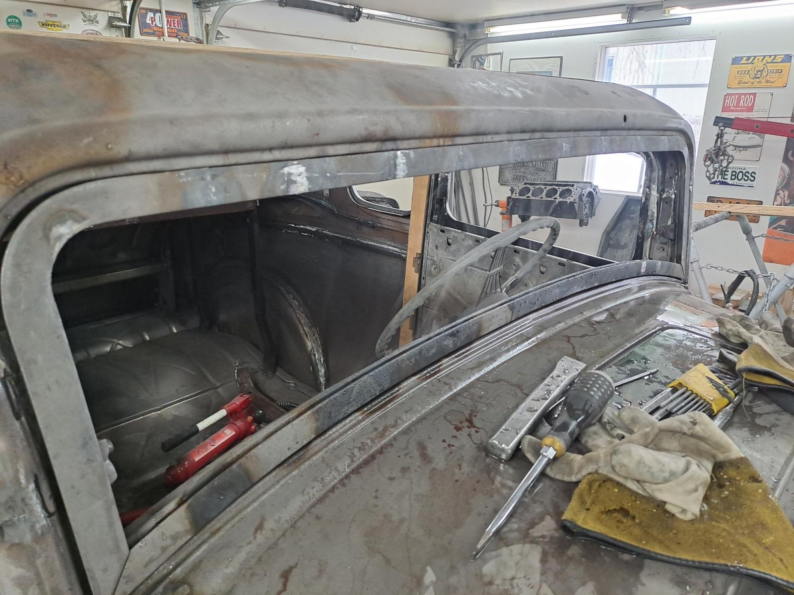

    Today made A-pillar ready and started to straight windshield frame. Chopped same +90mm than top and try to heat frame to right shape. Continue tomorrow morning.---
    Aulis

    windshield frame finally ready.

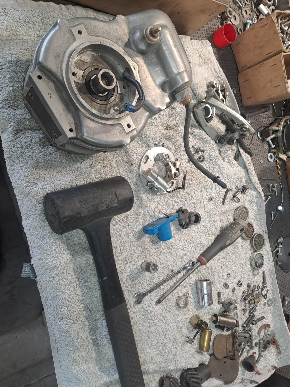

    Tom Cirello fixed my Harman Collins magneto. He magnetize it and send back from sunny California to Finland.

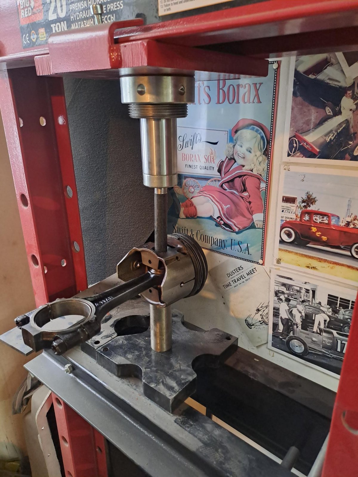

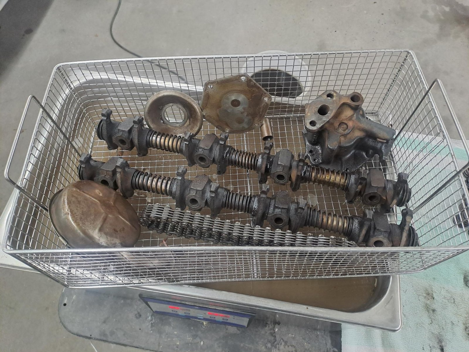

    Couple of days I have worked wit 390cid caddy engine. I want make engine ready before end of next week.
    Heads are grinded, chambers blasted with gl***. Block is bored and honed, crank is polished. I started valve seat grinding and washing parts. Yes, those extra engine buildings and sheetmetal jobs are bring in my hot rod building money.
    Aulis

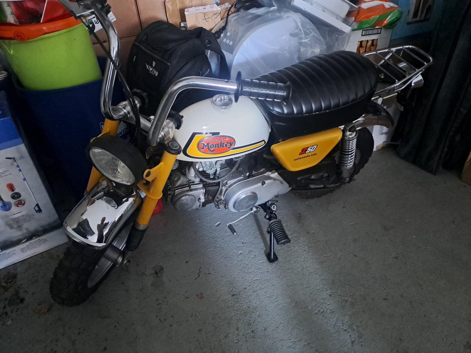

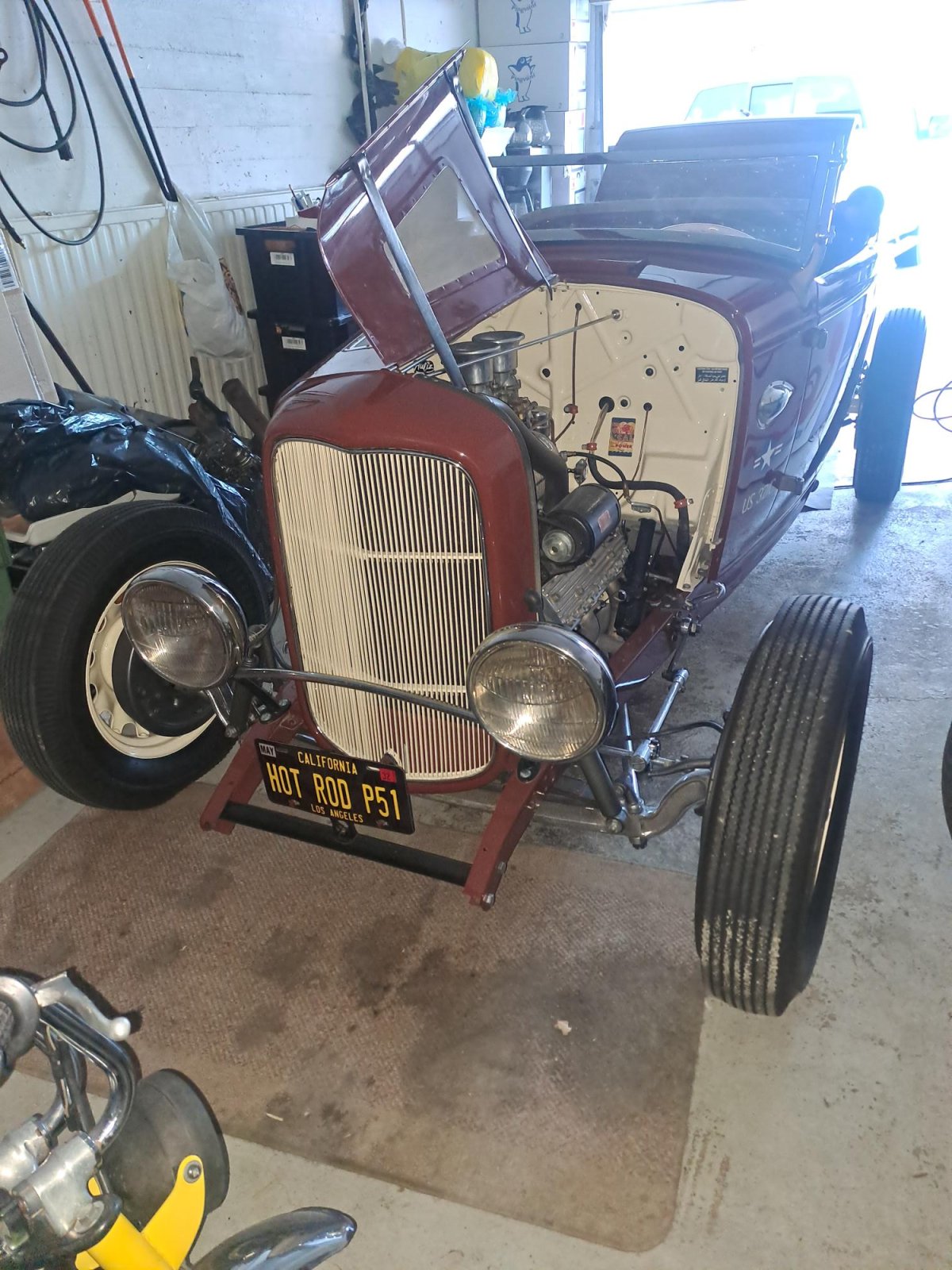

    Today I fired my P-51 italmeccanica supercharged roadster. Than sound and smell.....
    Two pics more.
    I have good videos, but no skills to add here.
    Aulis
