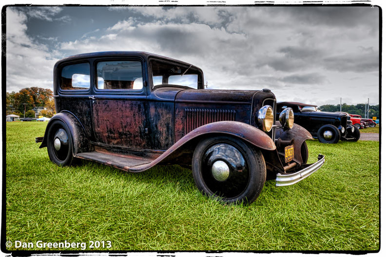

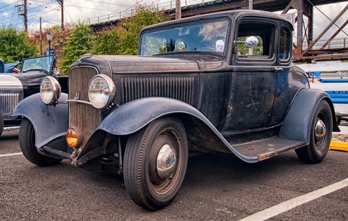

    Many have asked about my plans for the coupe. Since I didn't expect to ever get another 32 it wasn't in my plans to build another. So this car will probably have 2 phases. I'd like to clean it up and get it running, nothing much more than that for the moment.
    Phase 2 will look more like this with a plain looking but healthy built flathead V8, 3.54 gear in the rear and a 39 box.
    Kinda like this coupe and Dan Webbs sedan.

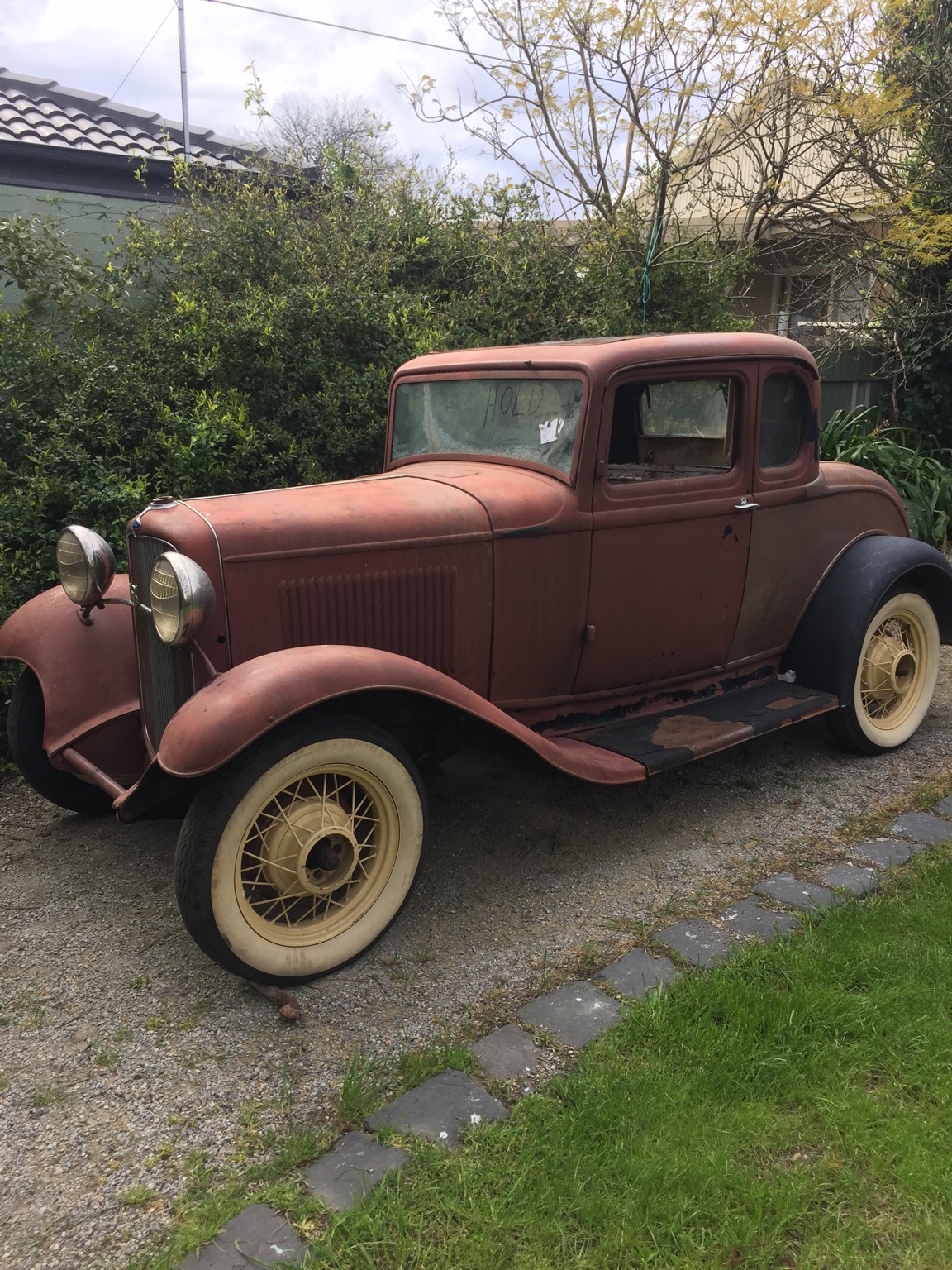

    What a great story and find. I know we're all hot rodders here but sometimes you've just got to be sympathetic with the build for certain cars that we're lucky to come across.
    Doing to much somehow takes away from the history and story that the car holds and tells.
    I really like the plan, doing the same with mine.
    Congrats on the score of a lifetime.

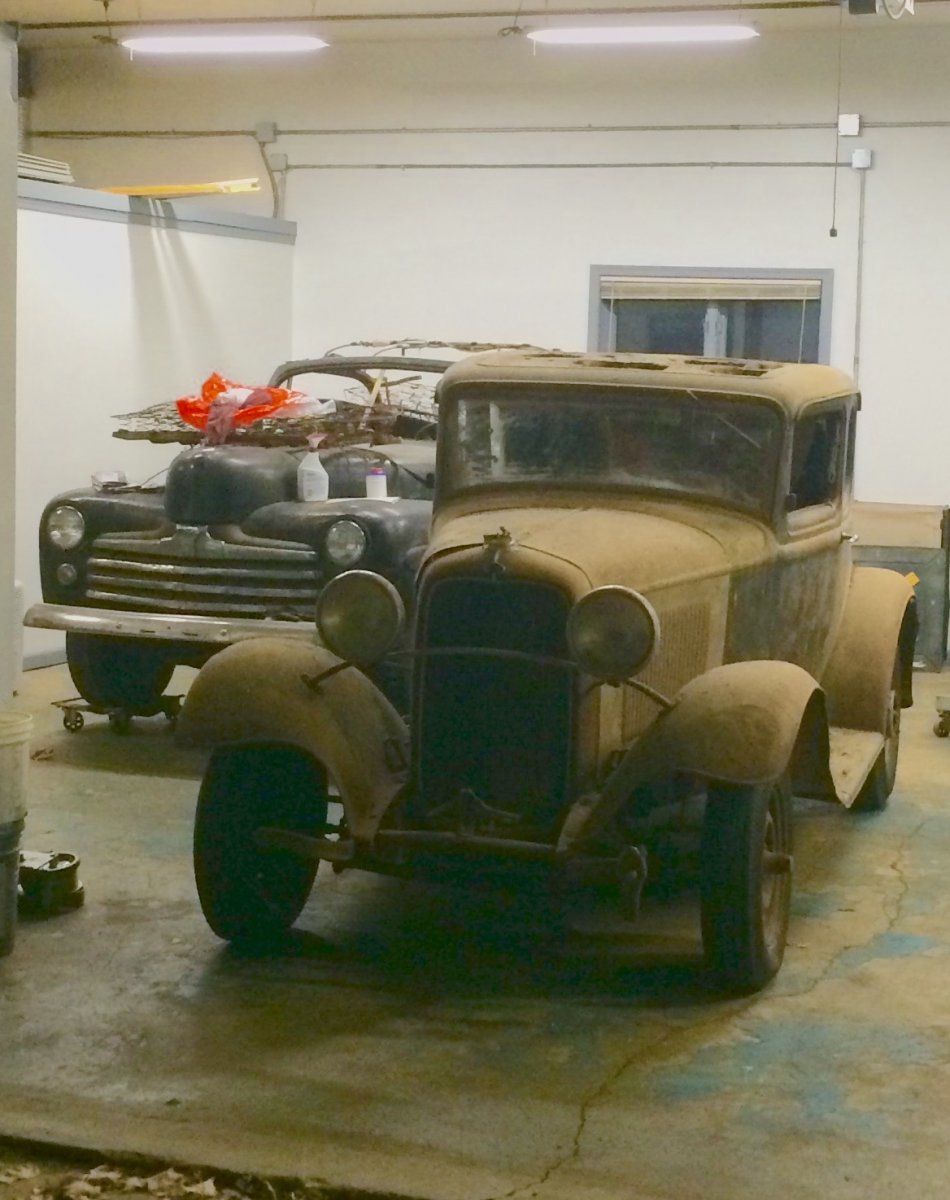

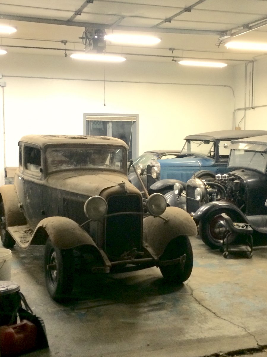

    This weekend I plan on starting the process of cleaning it up.
    Now that it is in my shop i can work on it a little bit at a time. I have a 48 Ford ragtop that needs to get started and finished first.
    Here is a couple of pics of it in the garage.

    Too cool! Looks like it is in good hands!
