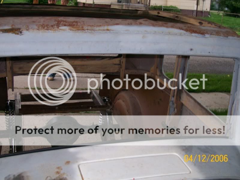

    Looking good dude!! Progress!!! If I may, those front wheels need to come back like a foot and the rear wheels need to be centered in the wheelwell (they may be already but not from this angle). I would press that engine right up against the fire wall and gain clearance for the radiator and grille shell that way. Proportion wise the car need to be squashed up a bit like a weesner painting as we were tlaking before. Keep looking at his stuff for inspiration and add a bit of east coast flavor to that. I took the liberty of a quick photoshop. I could not resist to chop the car about 2"....:D:D

    JJ I like the look of your photoshop,The reason the front end is so long is because it is setup with a spring behind so it pushed it out aways which i really like the look of. As for the wheels they are centered its just that the wheel openings are so big it really makes it look like they aren't.The engine is just set on the frame with some 2x3 so we could get the front end at ride heighth abut it will definitely be going back farther like in your picture.I definitely wanna leave it unchopped though because i'm tired of going to all the shows and seeing so many chopped cars i wanna fight the norm!!!! I wanna stand out and this is one way i have found i can do that.
    POPO the front axle is actually shorter than what it looks, its just the angle that the wife was Snappin pictures at.

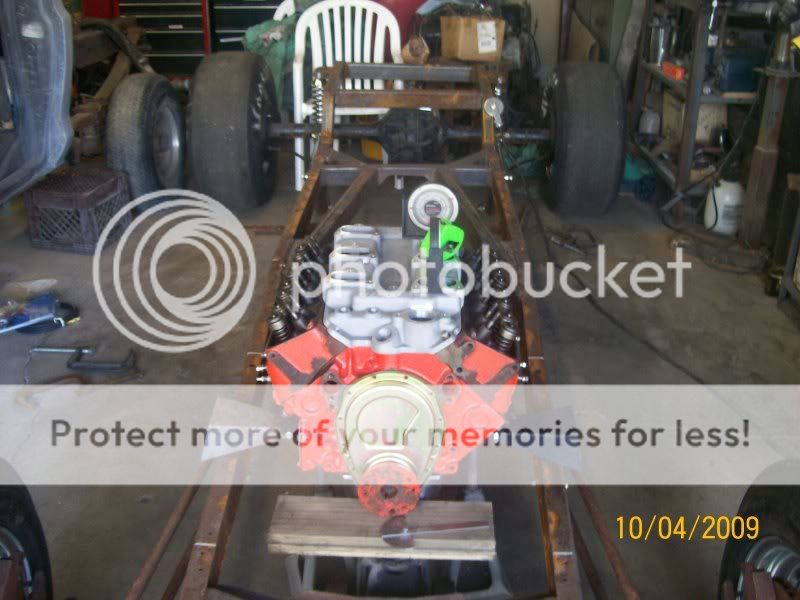

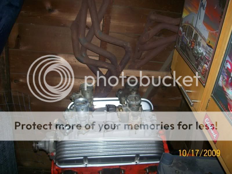

    Well everyone its time for an update. My frame is now almost complete.The engine and trans are mounted although i don't have any pics of the engine mounts welded in.The frame is now boxed the trans crossmember is in along with the motor mounts,the four link is finish welded, the coilovers are permanent, and after alot of consideration we decided to build a sort of x-member to strengthen the frame and keep it from flexing too much if i pour on the power!I also got rid of the Tunnel Ram and bought an Offenhauser 6x2 intake from Exeter Auto Supply.So far i have 4 Holley 94 Model 59's.I am in need of two more now if anyone wants to donate to the cause!LOL!!!I also added a new Moroso aluminum water pump tp help keep things cool.Here are some pictures of the frame and engine now without the body.
