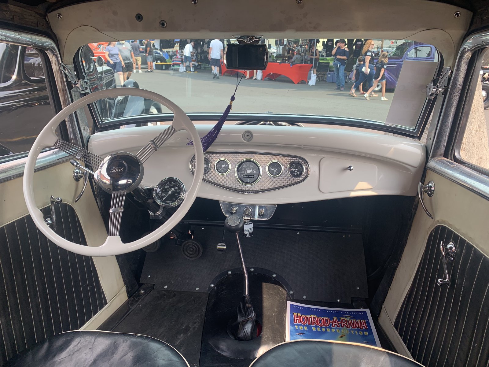

    That will be a much nicer dash. Bob

    Great work, That saved some $$$!

    Nice save on the door cards!

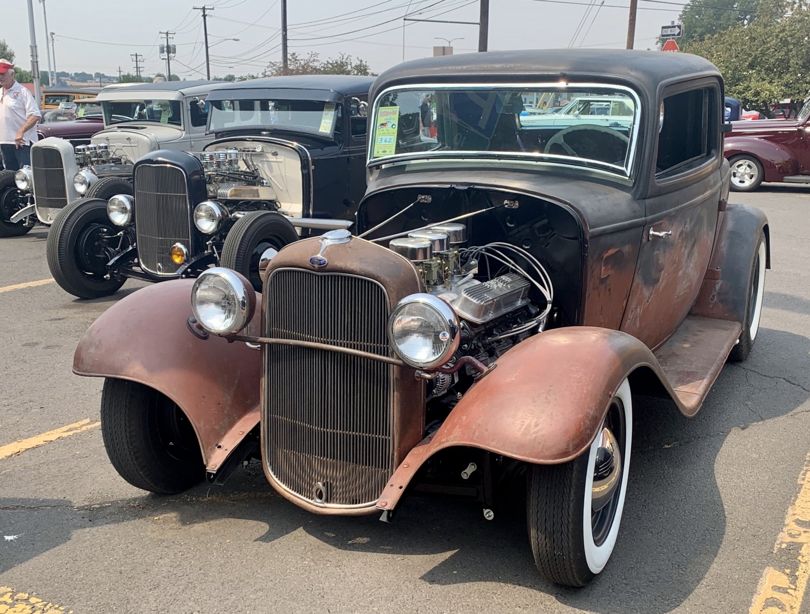

    Fun to drive, really fun. Still lots of odds and ends to fix/complete. It drives great, rides like a tractor, and is noisy as hell....So perfect. I am having issues with the carbs and back firing anytime I really put my foot in it. If I really jump on it, it will start running rough and back fire on down shifts. If I pull the plugs and clean them it will run good as long as I am "nice". I also need to figure out a better fan set up as I am overheating in traffic. So typical issues for a rebuild I suppose. Went to 2 car shows last summer, and I am really looking forward to Deuce Days in Victoria this year. One really cool part of the car is the shift knob. The 50 cent piece was found in the car (1945) and Dads ashes and a picture of him with the car are in a hollowed out spot under the coin. 388.jpg 348.jpg 349.jpg
    slayer, bchctybob, mvee33 and 18 others like this.
  27. Stogy
    Joined: Feb 10, 2007
    Posts: 27,207
    Stogy
    I often refer to mine as a wagon with an engine and noisy yupp...backfiring has never been an issue for me...different league though...94's and smallblock...2 of six...I've had dirty plug syndrome...fixed...
    Your carbs and just about everything in the engine department look new so looks like uni-syn time...maybe you've done that already...the general consensus is get it running well on the primary then work on the others but I'm no wizard in that department and furthermore it could be something else completely...hope you get the issue ironed out as backfires can damage things...
    Wow those last two shots are money man...
  28. Looks rad, for your overheat issue I would try to get the fan closer to the radiator core or throw a fan shroud on it. The WOT problem could be a great number of things. The air cleaners look suspect, some of the available ones just don't let enough air into the intake and that would be the first place I would check, just run it without the air cleaners on and see if the problem goes away. I really like how it turned out, I love cars that look mean just sitting there.
