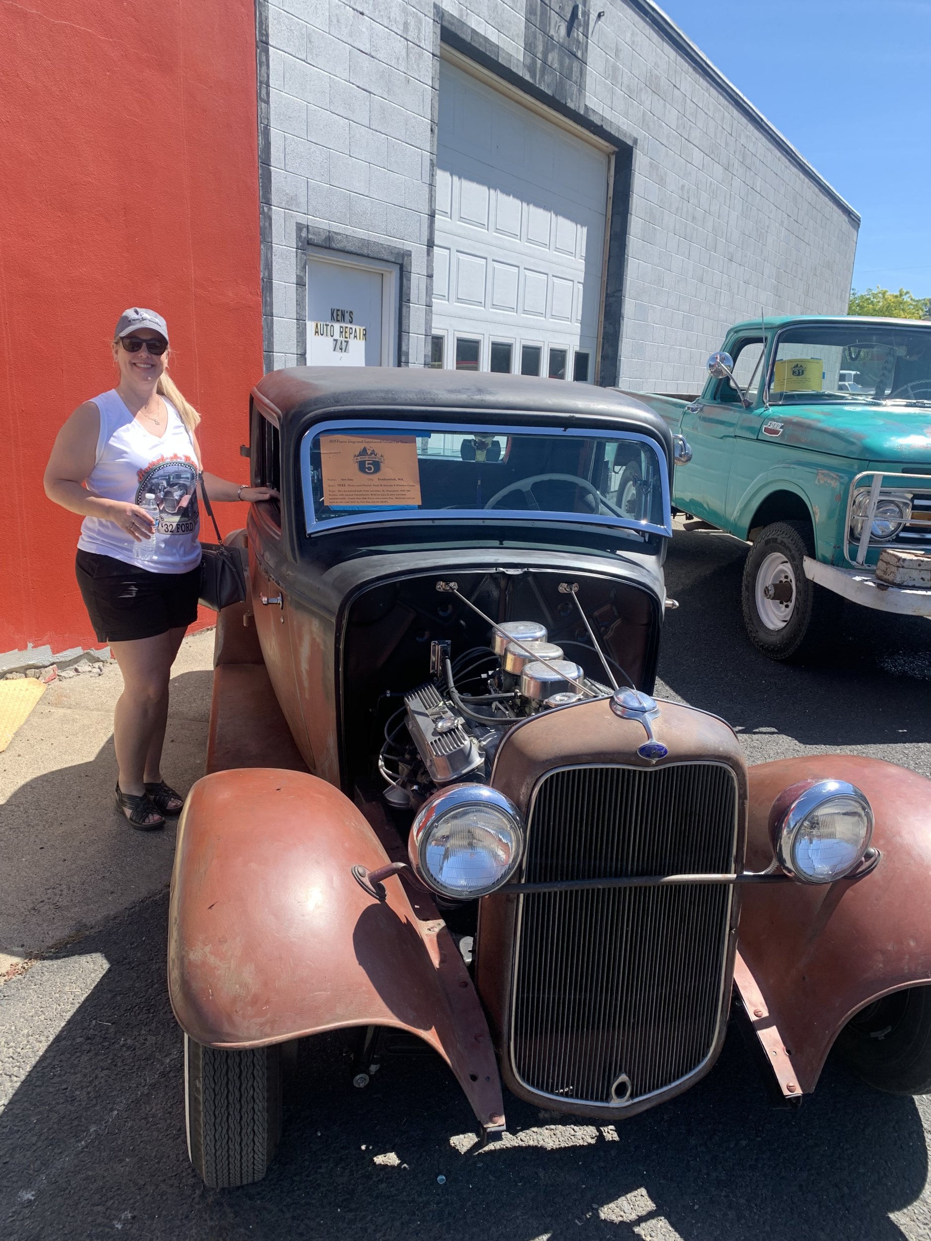

    Super busy summer but did get after a couple issues. Ripped the engine out and fixed the freeze plug issues. I tried the advice from the HAMB and added a spacer for under the carbs to try to help the heat soak non-start issue. I also wrapped the exhaust pipes. I think we got the death wobble fixed, was able to get it up to 90 mph without the radiator shell looking like a gymnast on crack. I was toed out a little so we adjusted. Gonna put the Bias tires back on but I feel confident they were only a small part of the wobble. Replaced the linkage on the tri-power and the new setup is much more snappy. I was invited to go on a Poker Run with the Coffin's and had a great time even in the rain. Ton of really cool rigs. I think my fix on the engine oil pump worked as I had no oil pressure issues and I have a 1000-2000 miles on the engine since I replaced the oil pump, fingers crossed! 2025 9.jpg 2025 10.jpg 2025 12.jpg 2025 11.jpg 2025 1.jpg 2025 3.jpg 2025 2.jpg 2025 13.jpg 2025 14.jpg
