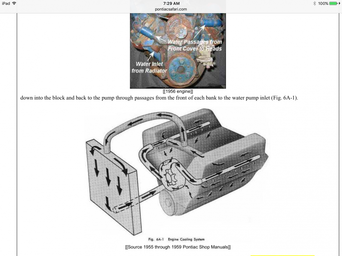

  6. With the water pump connected to the front of the heads, (reverse flow cooling) it's much earlier engine than '68
    1955-1959 - 59 was the last year
    This link will get you started
    http://www.pontiacsafari.com/EngineCooling/
